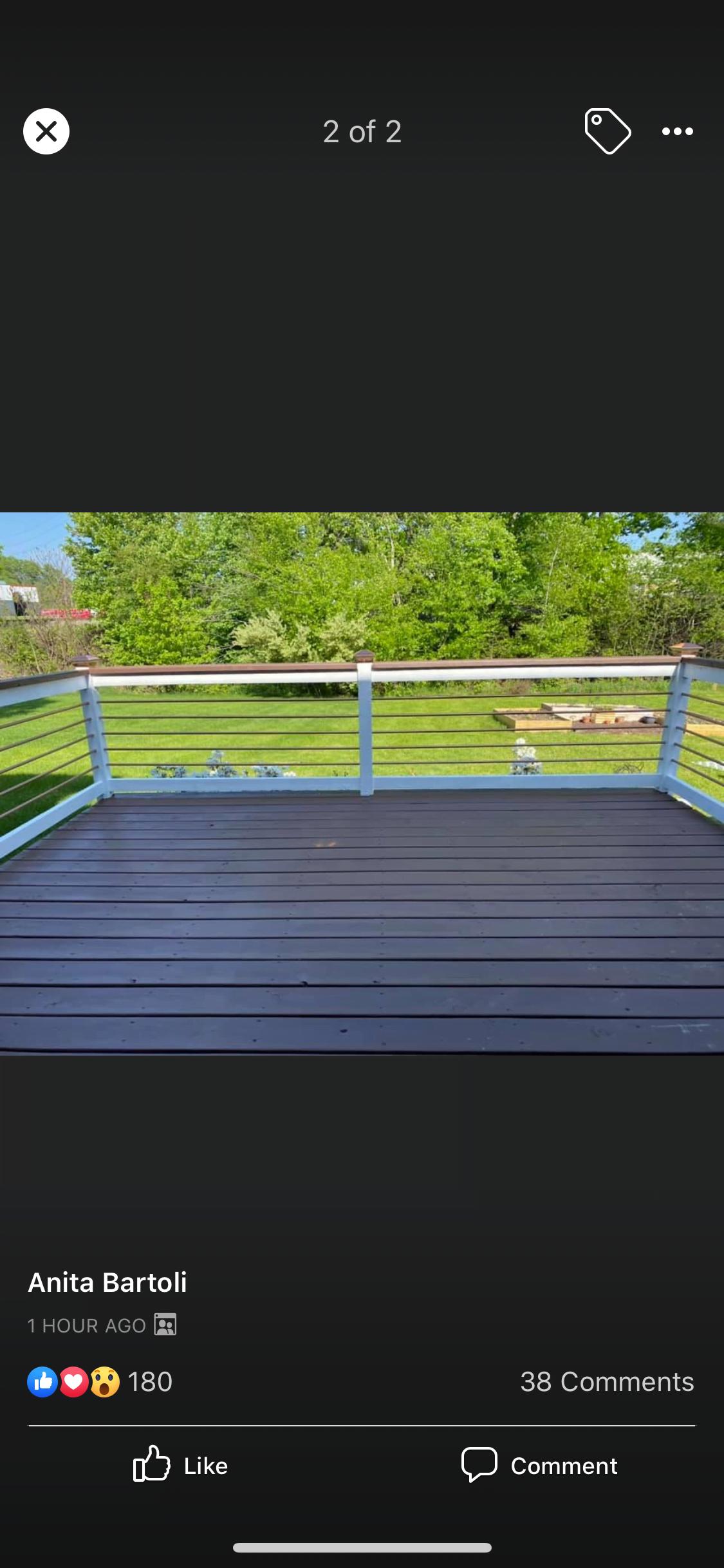

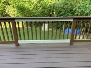

What should I do if someone just power washed our deck thinking that was enough, then stained a darker solid color over the top of the old chipped stain? He used Behr solid deck stain. And, he started to paint the posts cream to match our house trim as I wanted that contrast look, but it looks horrible. All the cracks and bumps in the wood show. He thinks we should stain it a lighter solid Behr color instead of painting it because the stain fills the cracks in the wood better. What would you suggest for both of these problems?
Attached 2 pictures, One of our deck with the floor and top done in the new dark walnut stain. The other picture is what inspired me to do the contrast look. If it would be better to keep it all dark, I could do that. Any help would be greatly appreciated. Thank you!
E.K. Dean
E.K. Dean
If I decide to do a lighter color on the posts, do you think I’m better off with a stain or paint? And, do you think the imperfections show up more the lighter the paint or stain?
