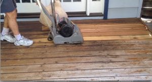

Sanding is usually unnecessary to prep a wood deck for a new coat of deck stain. The best way to apply new deck stain without sanding is to clean the deck, strip the old deck stain, and apply a wood brightener. A final rinse should be done on the deck before applying the new stain. This is typically more effective, less time consuming, and requires less effort than sanding a deck. However, if there are stubborn areas spot sanding might be necessary.
  • Skip sanding in most cases. Clean the deck, strip old stain, and apply a wood brightener for the best prep results.
  • A final rinse after stripping and brightening is essential before applying any new deck stain.
  • This clean and strip method is faster, easier, and more effective than sanding an entire deck.
  • For stubborn areas, spot sanding may still be needed, even when skipping a full sand of the deck.
  • Restore-A-Deck is a recommended wood deck prep and cleaning system for staining a deck without sanding.
What product is best to deck stain without sanding?
Deck stain experts recommend cleaning and brightening a deck over sanding it for best results in mostSanding A Wood Deck cases. One of the best ways to clean and prep a deck without sanding is to use a wood deck prep and cleaning system like Restore-A-Deck.
