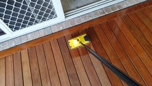

Do you need two coats of semi-transparent deck stain?
Whether or not you need two coats of semi-transparent stain depends on several factors. Different brands of semi-transparent deck stain have different application instructions. Apply a second coat when the deck stain instructions indicate you should do so. Some decks need two coats depending on the color, type, age, and condition of the wood, what type of stain was previously used, and proper maintenance. Most semi-transparent penetrating deck stains do not need a second coat on well maintained and prepared decks. New decks typically only accept one coat of deck stain as it is harder for the semi-transparent stain to penetrate into newer wood.
  • Whether you need two coats of semi-transparent deck stain depends on the brand, wood condition, color, and prior stain used.
  • Always follow the specific deck stain instructions provided by the manufacturer to determine if a second coat is recommended.
  • Most semi-transparent penetrating deck stains only require one coat on well-maintained and properly prepared decks.
  • New decks typically only accept one coat, since newer wood is denser and harder for stain to penetrate.
  • Older decks or those with specific wood types, colors, or maintenance histories may benefit from a second coat of stain.
