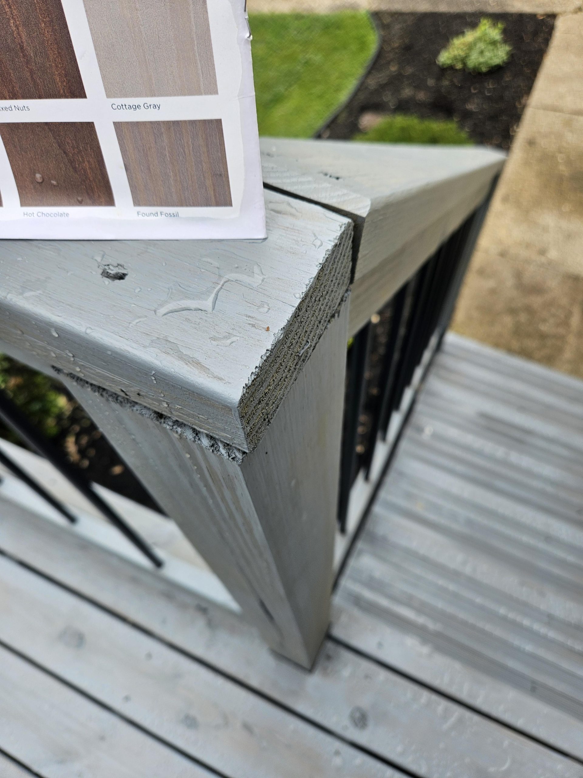

I had a new pressure treated deck build last year. The company came back and stained it with a semitransparent stain this spring. The stain was either not mixed correctly, or the chart sample was way off, and the color is just awful. They want to make it right. Do I have need to go with a solid stain to cover? Paint? How do we proceed?
Add some pics in the comments of the deck, and what stain brand did they use?
It was Valspar Found Fossil.
Looks more opaque than semi-transparent. It would be very difficult to strip this to bare wood. A solid color stain would make it more uniform.

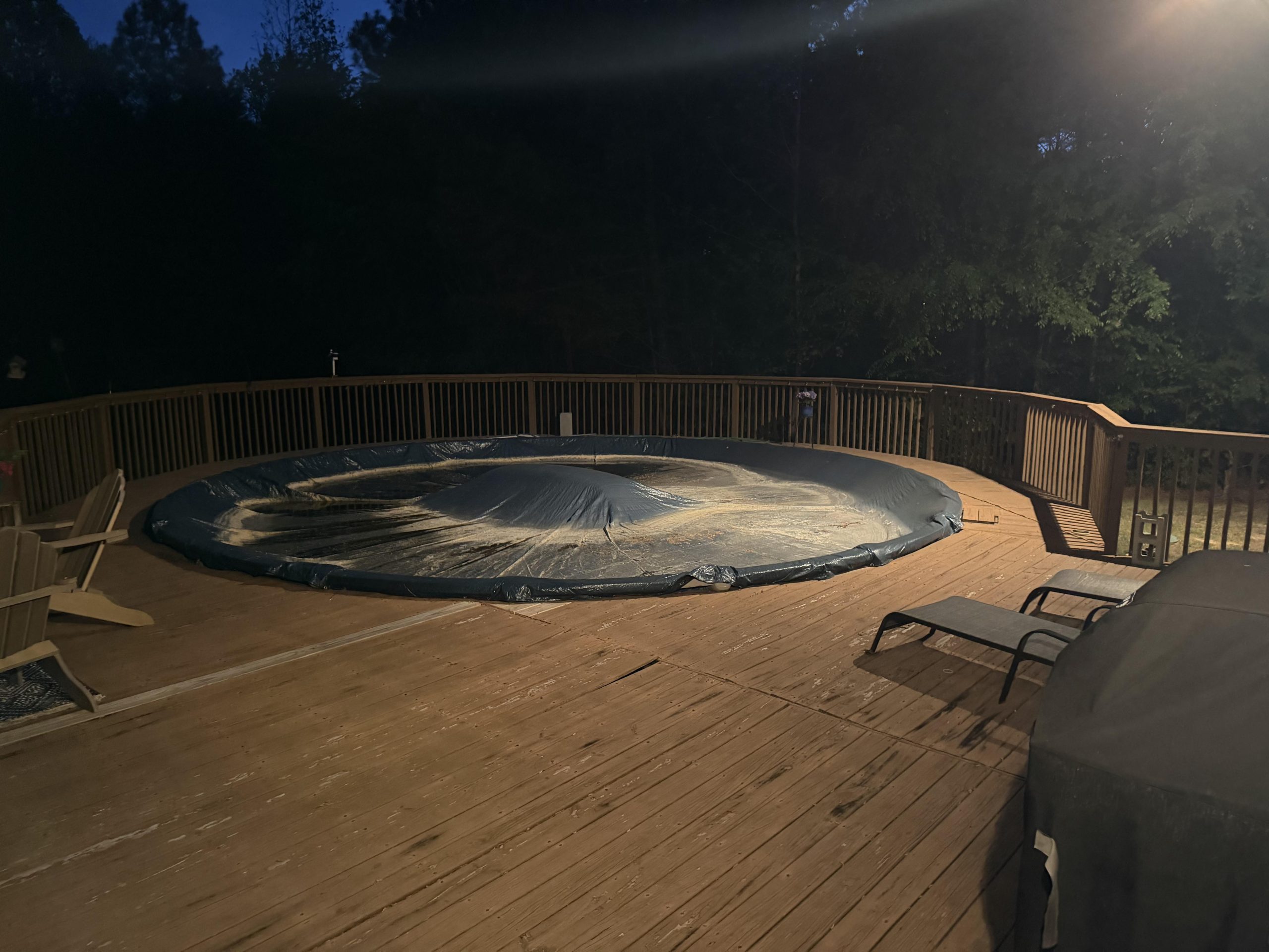

I have 6 year old Flood Solid Color Stain on my 12 year old redwood deck. The deck gets full sun most days and wraps the house and is about 20 feet above ground level. We have lots of landscaping and garden beds under the deck so I am concerned about using any stripper that will damage plants. There are some peeling areas that I can spot sand to smooth out but I’d like to know if I can just use a good deck cleaner (which one?) to clean and then reapply same solid stain? Do I need a brightener after cleaner if I’m not stripping the wood and I am reapplying a solid stain that completely covers wood grains? Or do I need to sand entire thing? Thank you. Photos attached.
The goal here is to clean the wood from any dirt and mildew and remove all the loose or peeling solid stain by sanding or spot sanding the peeling areas. You can then cover the intact solid stain with your new solid stain coating. You do not need to apply a brightener for this project.

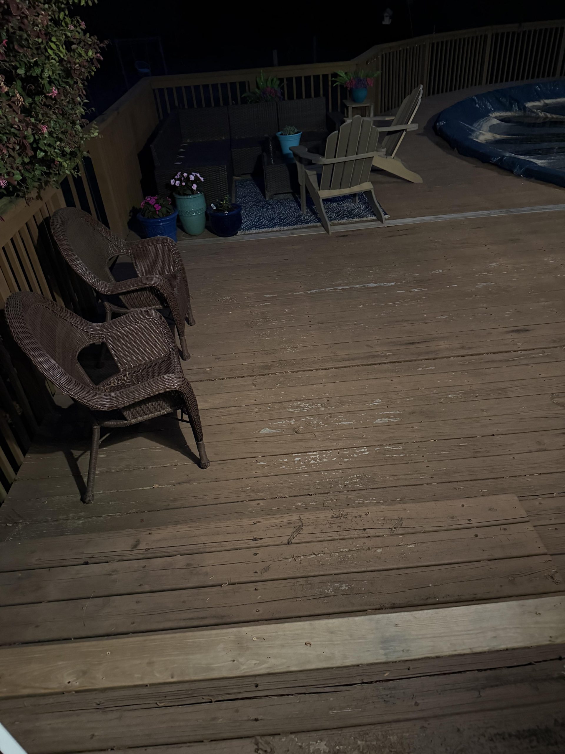

Solid stain applied 3 years ago and looking at applying the same product and color. I’ve power washed and sanded. Is this ready for stain?
Yes, as long none of the current solid is peeling and is fully adhering to the wood.
