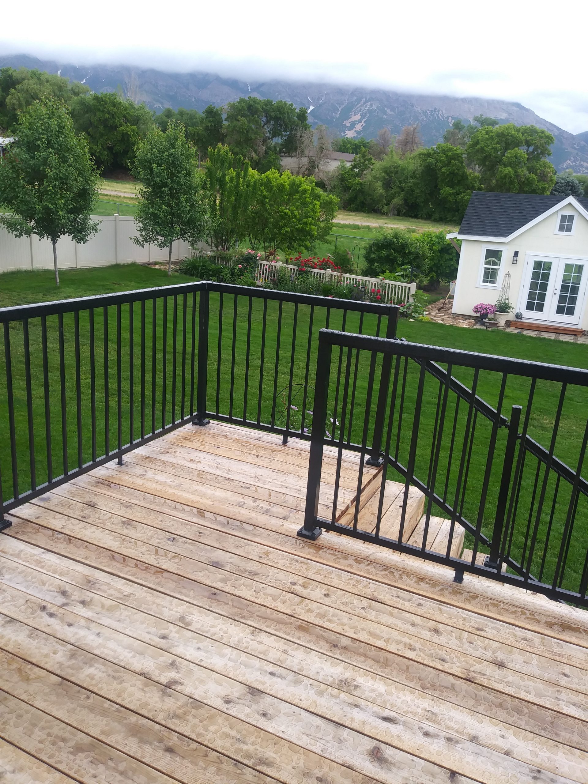

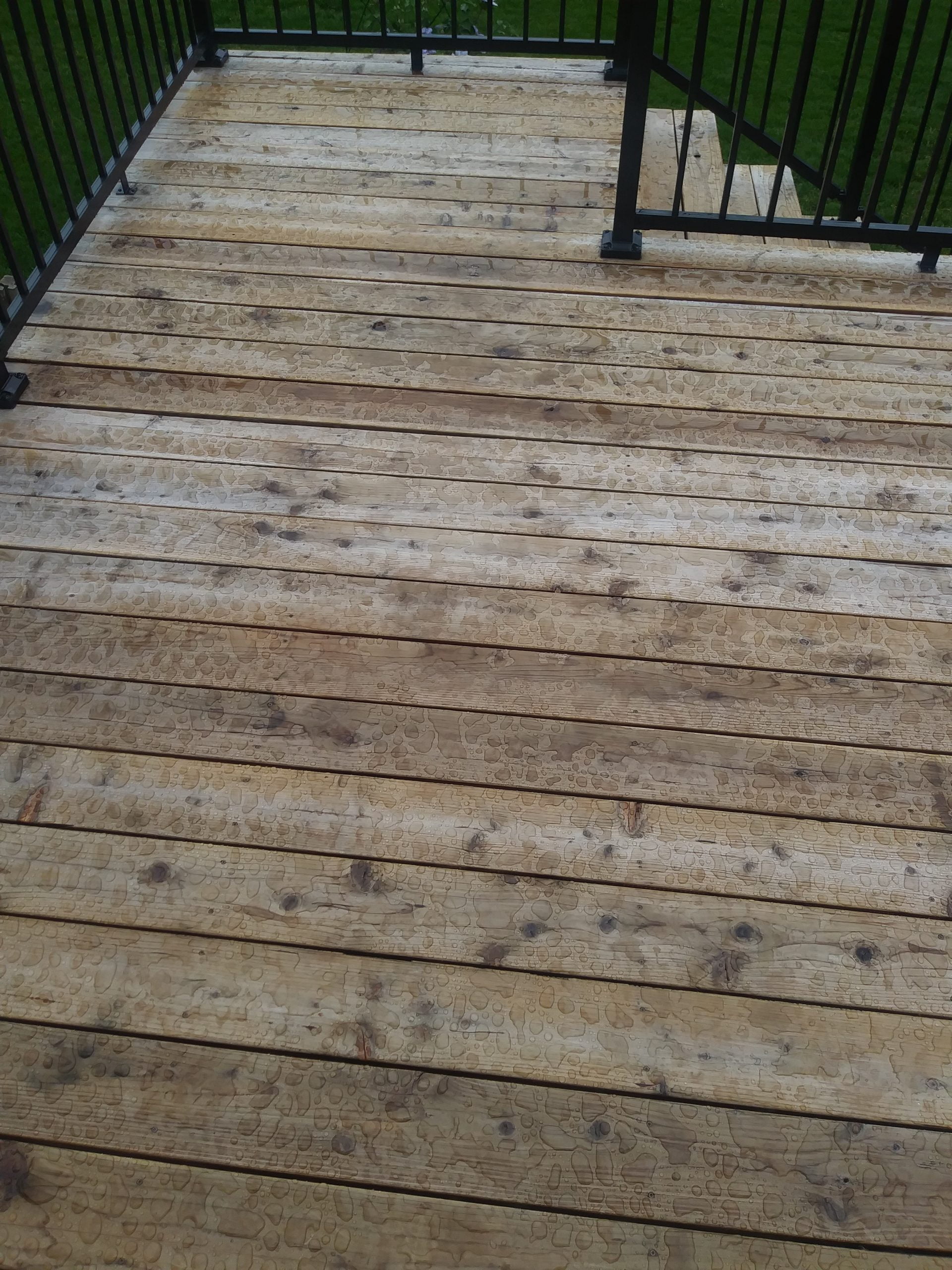

I have a 10 x 12 redwood deck built last fall. Two weeks ago, before finding your product, I ended up at a big box store and was talked into using Olympic Waterguard Clear wood sealer. I wanted less color but a “wet wood” look. I was told this product would be what I wanted. Since it was water clean-up and no where on the product did it mention it was an Acrylic product, I gave it a try.
The result was a disaster. It doesn’t even look like I did anything to the deck other than the water beads up on it. I now realize it is an acrylic product. Will your RAD Stripper product strip off the sealant? My railings are black metal and so I am concerned about using paint
stripper products possibly damaging the rails.
I do have a pressure washer, Any suggestions? Any help would be greatly appreciated.
Post some pics of the decks current condtion for help with prep.
It rained last night. Thanks again.
