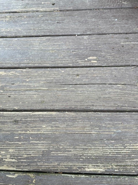

Matthew stullich
2 months ago
15 year old solid color stain want to put a semi solid or solid back on what is the stripping method you prefer? A squirrel ate that top coat off wish he would have kept going!

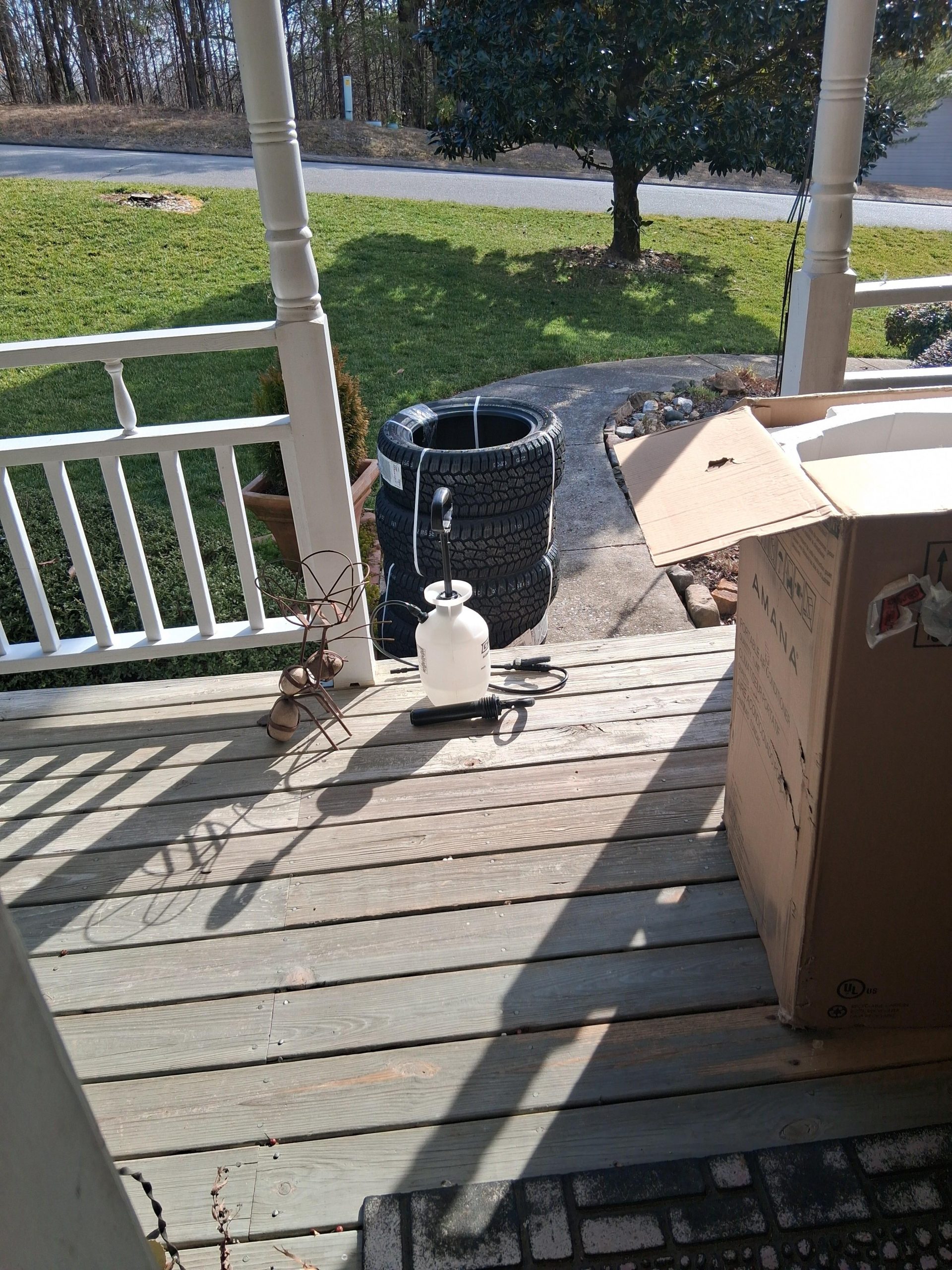

I used Messmer’s UV Plus Clear Weathering Formular on my wood deck this year for the 2nd year in a row. The first year I put 2 thin coats and it was great. This year I put 1 thin coat and the whole deck is tacky. I’ve tried using Mineral Spirits and a rag to lift the tackyness Didn’ help! What can I do? What caused this? What a mess! Thank you for your help

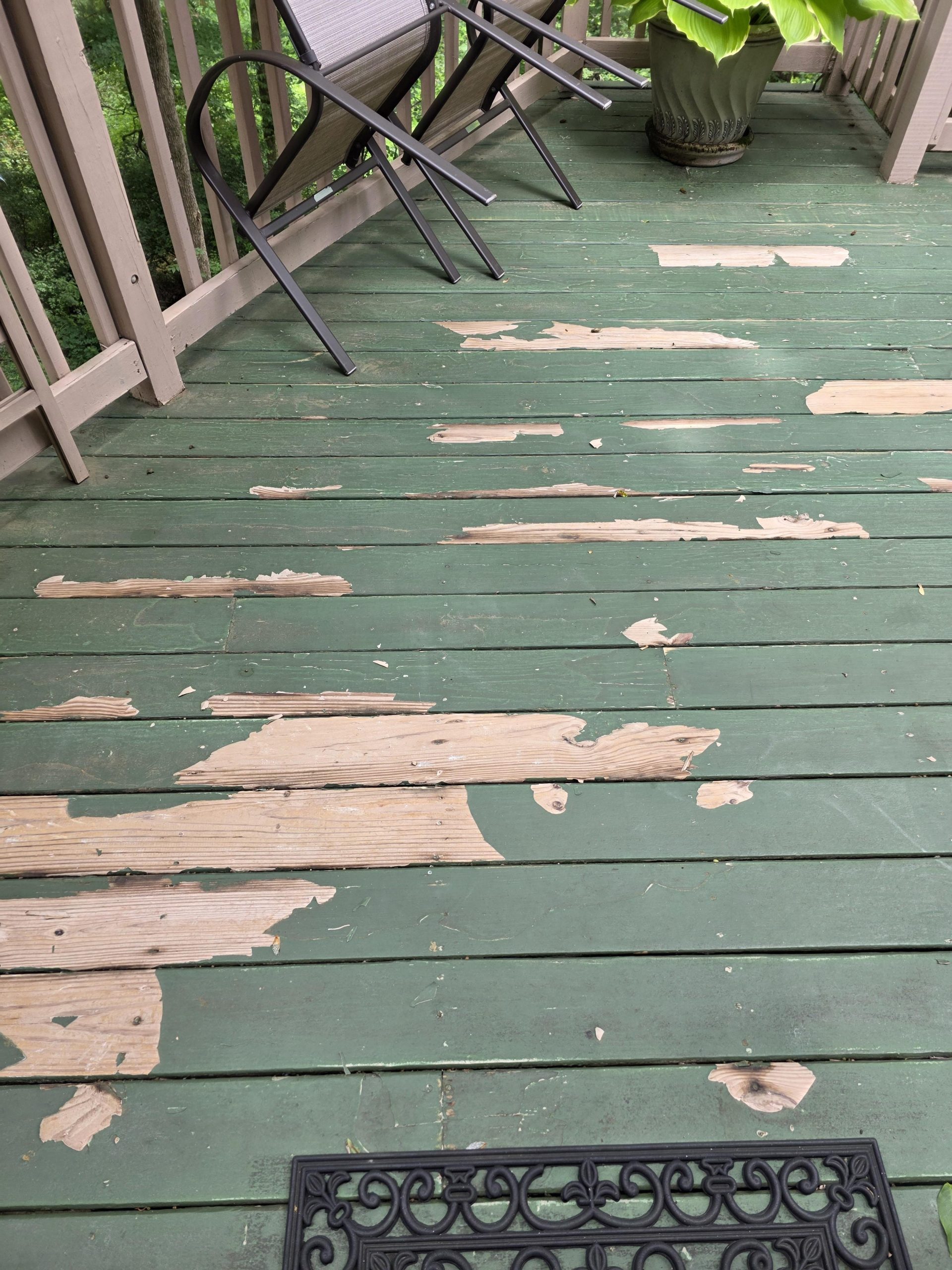

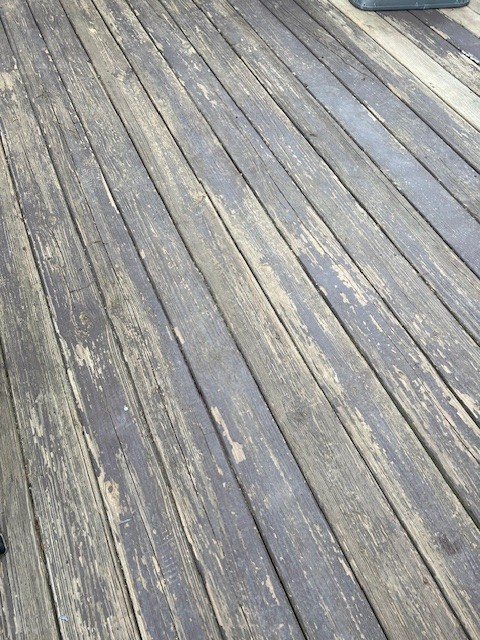

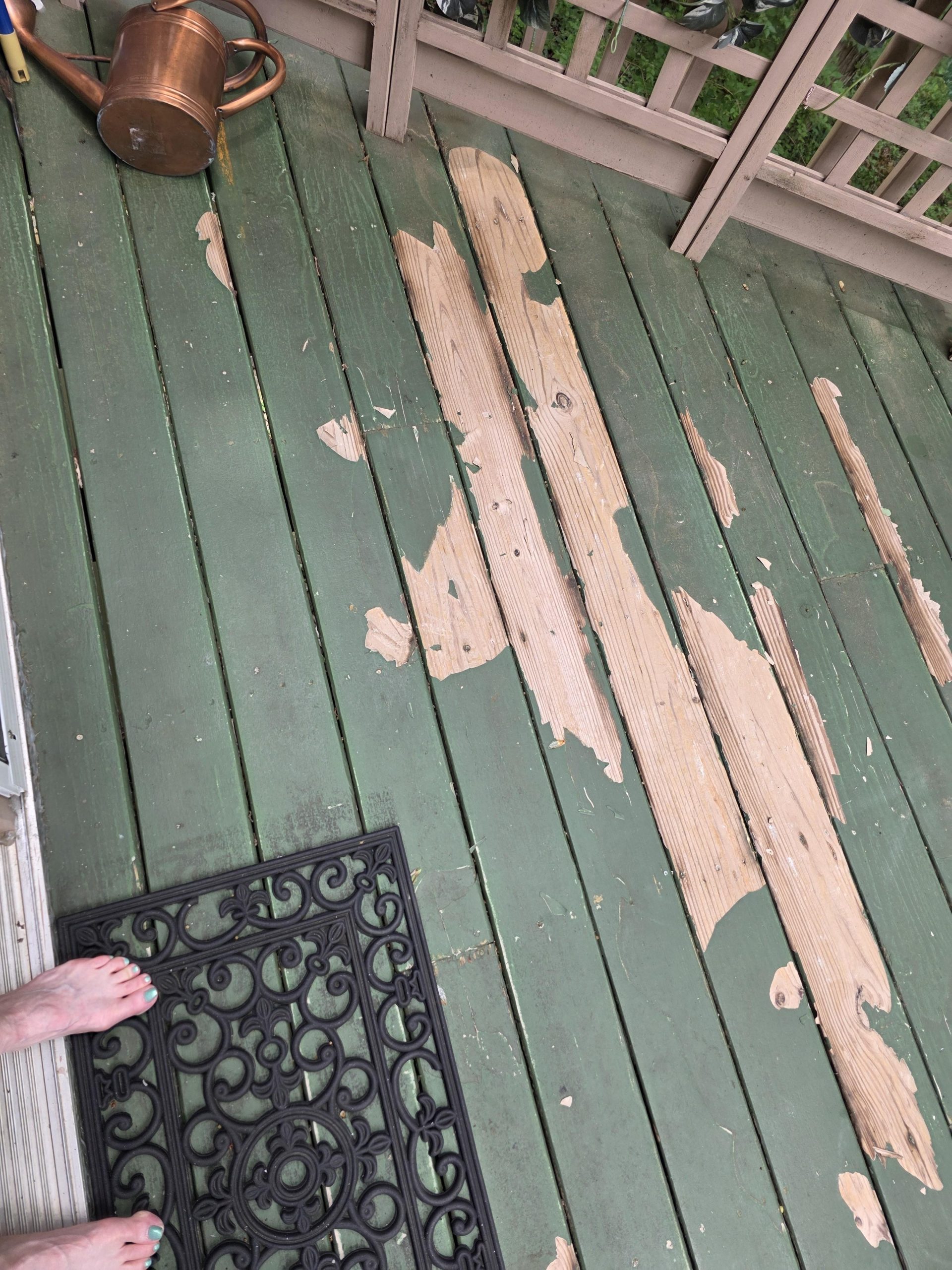

Debra
10 months ago
Do you recommend RAD for thus deck

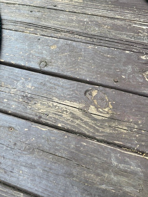

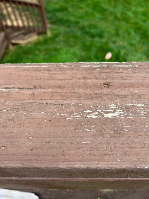

Jonathan J.
Hi Scott! This deck was neglected by the previous owner and It will be my big spring project. There are no clues as to the brand of stain used previously. I’m trying to figure out if I will need to use RAD PaintStrip or if another paint stripper will work. I plan to clean and brighten after stripping. I would also love to hear suggestions on specific stains to use. I included a picture of the railing that better represents the color of the previous stain.
