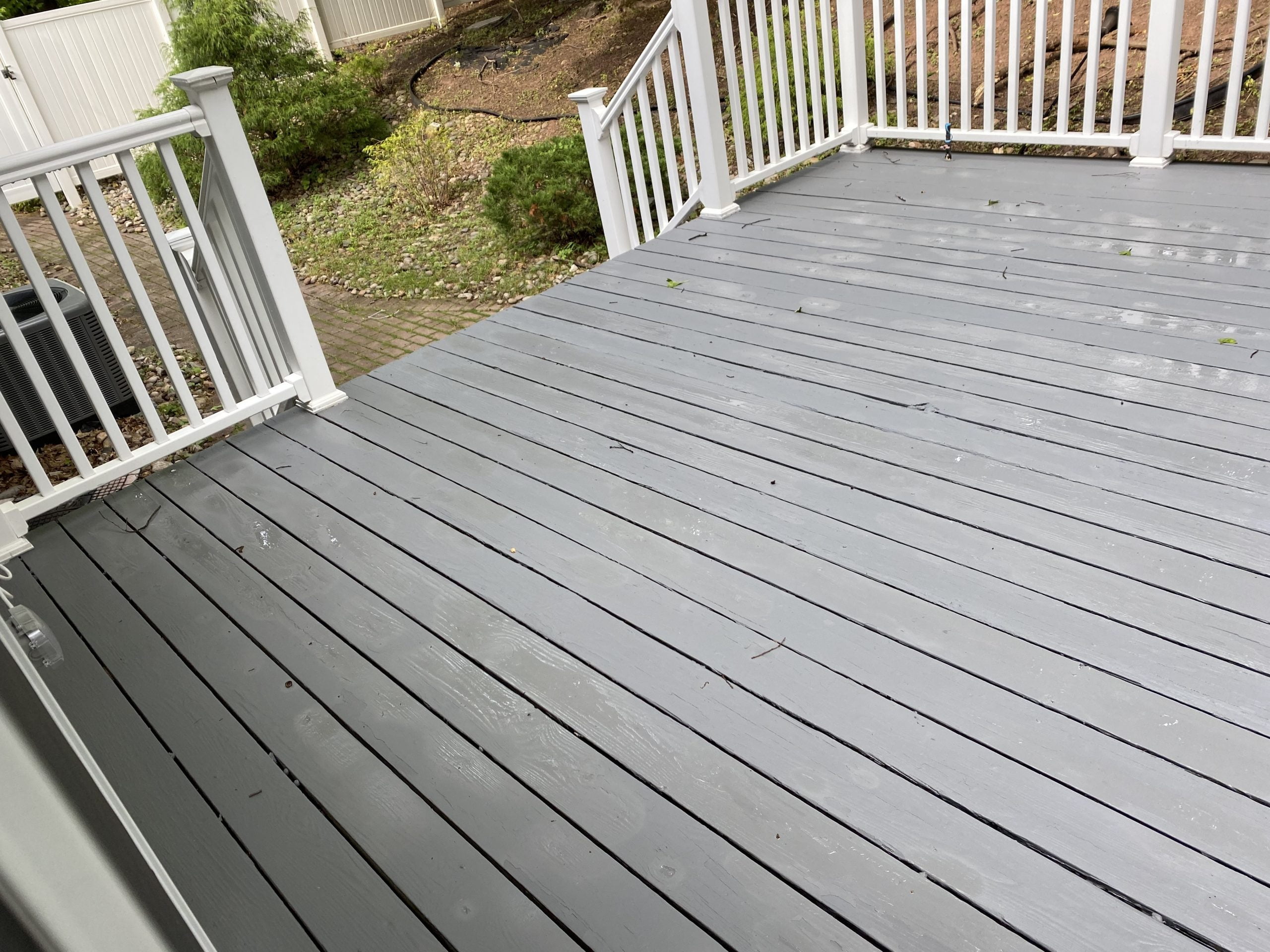

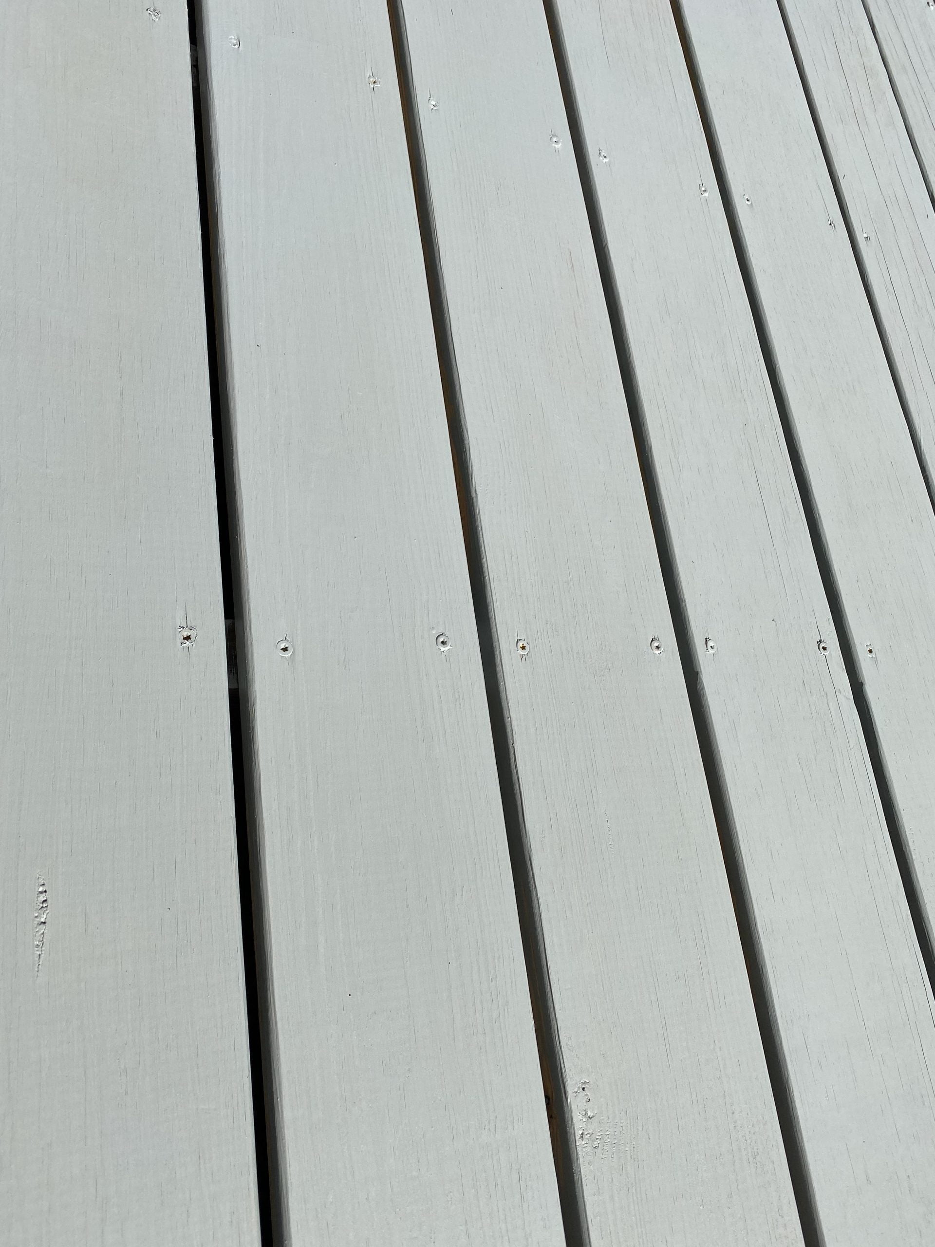

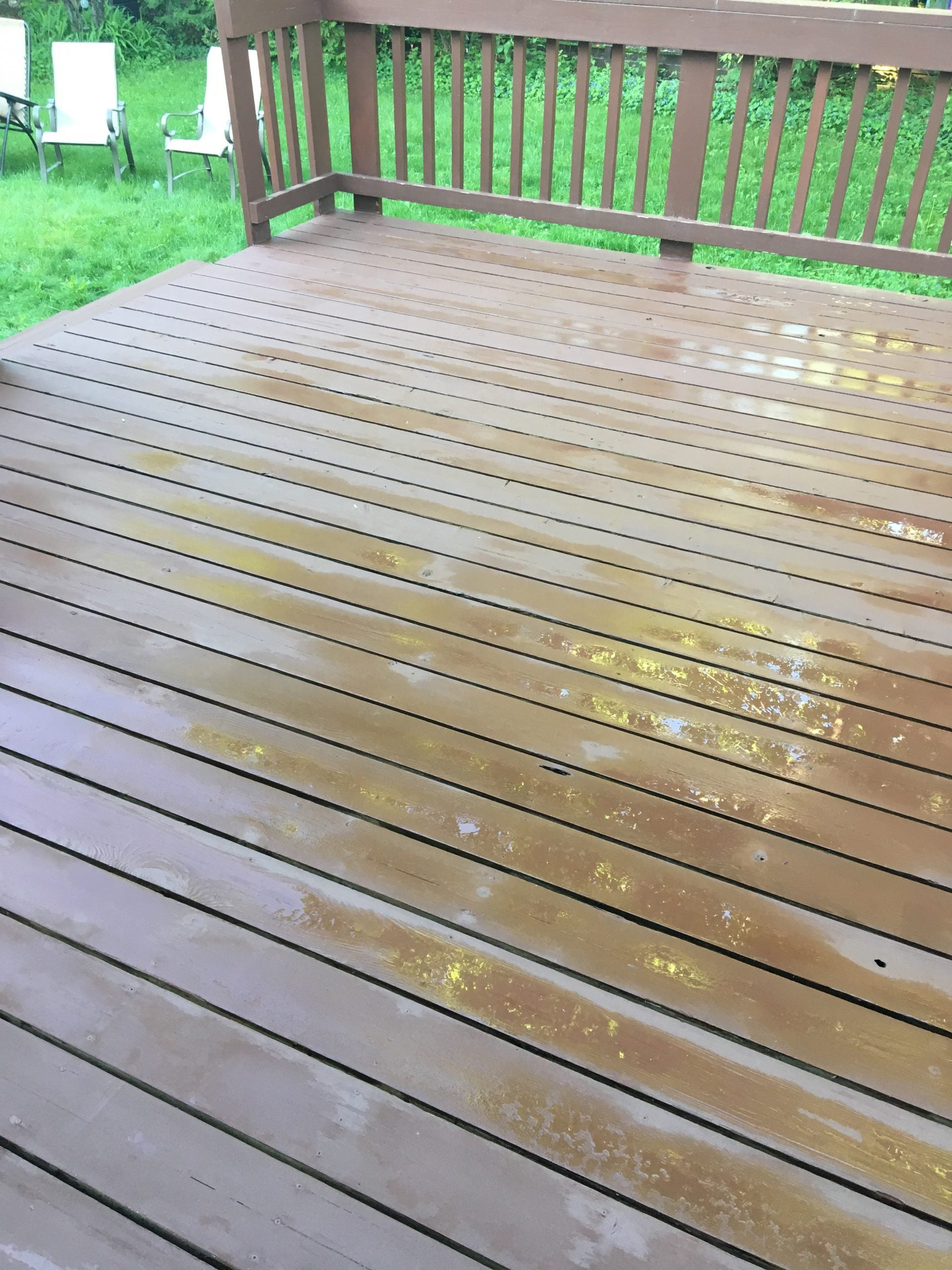

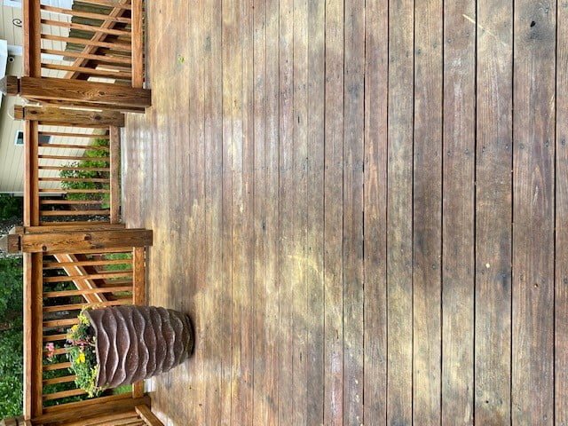

Stained the deck with dark gray/ brown solid stain. Got two coats on the deck but only one coat on the stairs before had to quit for the day. 24 hours has passed with high of 91, low of 67. Now a heavy downpour. When the stairs have time to completely dry, is it safe to do a second coat of solid stain to even the color?

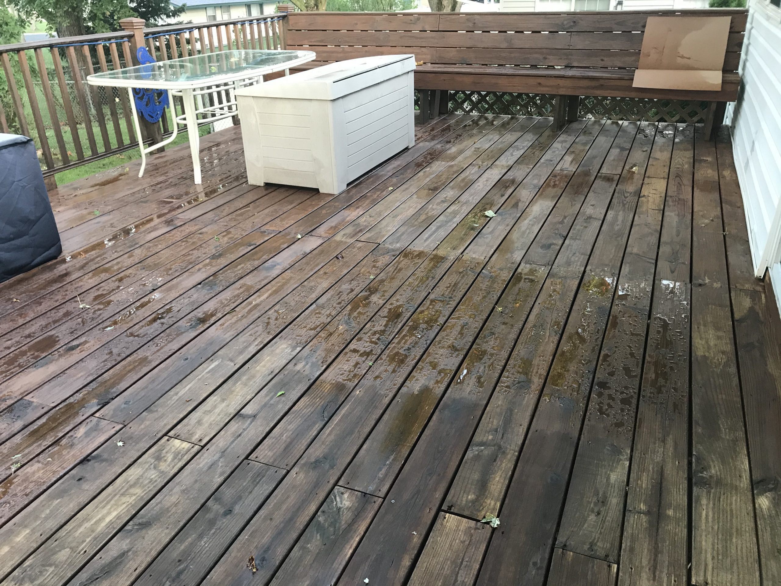

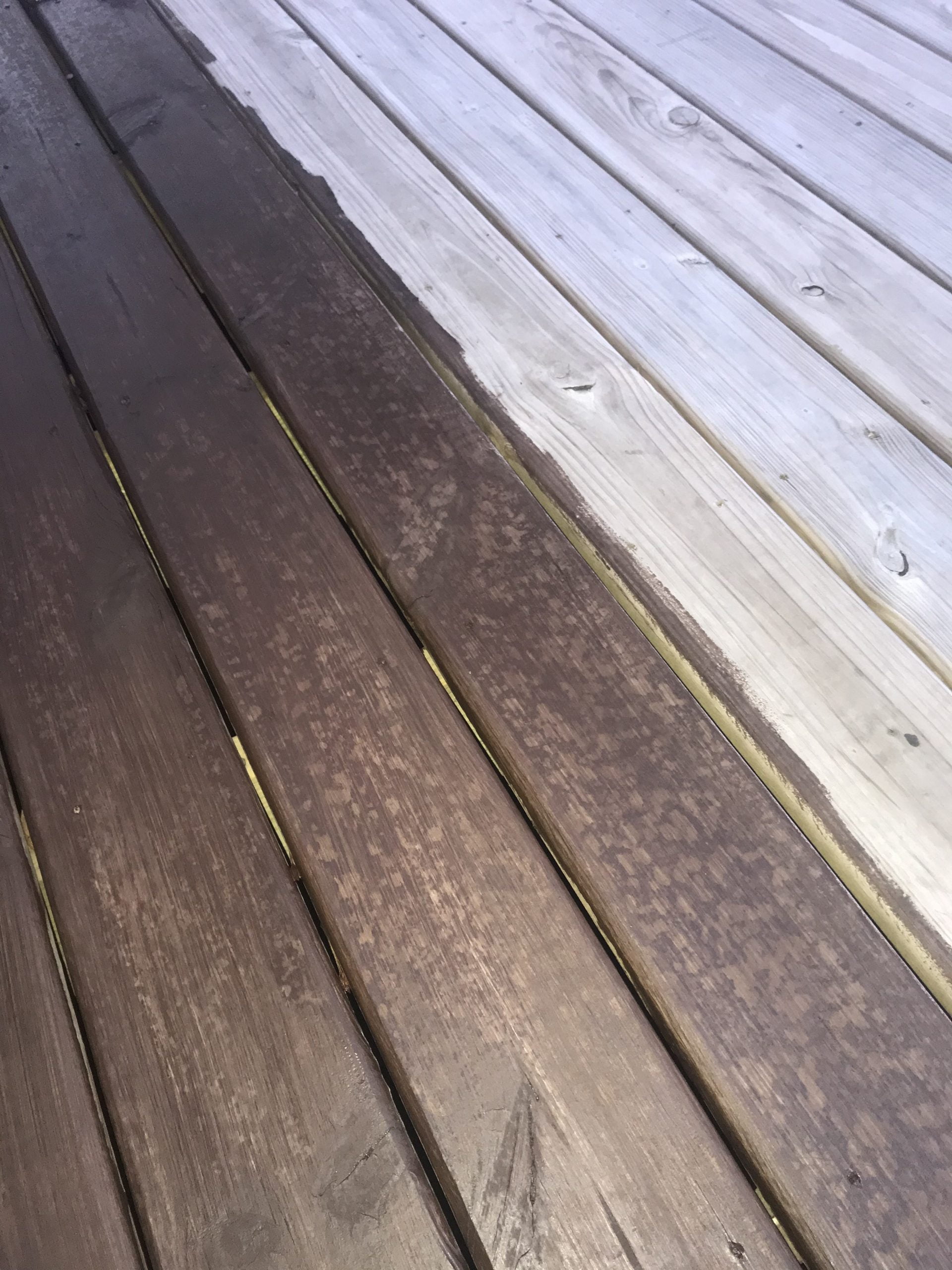

I stained the far left side of the picture 2 days ago. The right side I stained last night and it rained 5 hours later. There is a whole section that doesn’t look good-no beading of water! I didn’t even finish-but I know I have to wait for the wood to dry out completely. Ugh-any suggestions on what I should do about the boards that don’t look good?
You would have to strip it all down and start over to fix this.

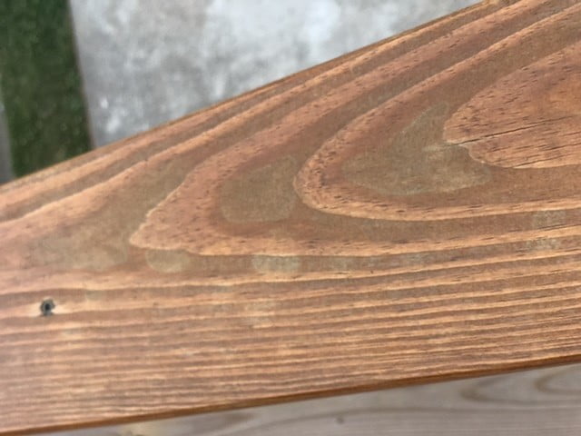

I stained my deck using Cabot Gold (moonlight mahogany). It cured for two days before it rained. Now when it rains it looks dirty and you can see white water spots. They wipe right off but I’m wondering why it’s doing that. I originally sanded the whole thing. Sprayed it down and allowed it to dry before doing the first coat. Then the second coat 24 hours later. And like I said, 48 hours after that it rained. How do I get rid of water spots and keep it from looking so dirty?
Send a picture.

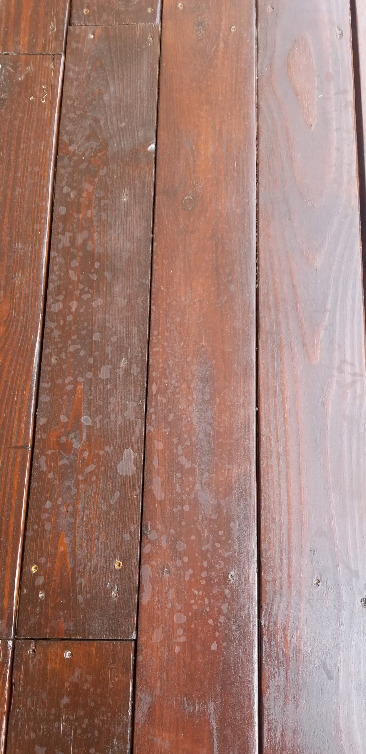

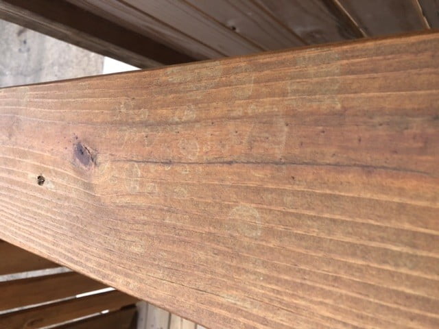

Here is a picture of the water stains. Everytime it rains this is what it looks like. It’s stressing me out because it looks so dirty everywhere.
That is mineral deposits from the water. Nothing you can do but wipe them off.
Thank you! Sorry I just sent another comment because I didn’t think this one went through so you can disregard.

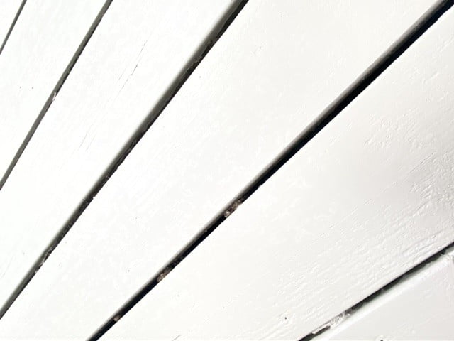

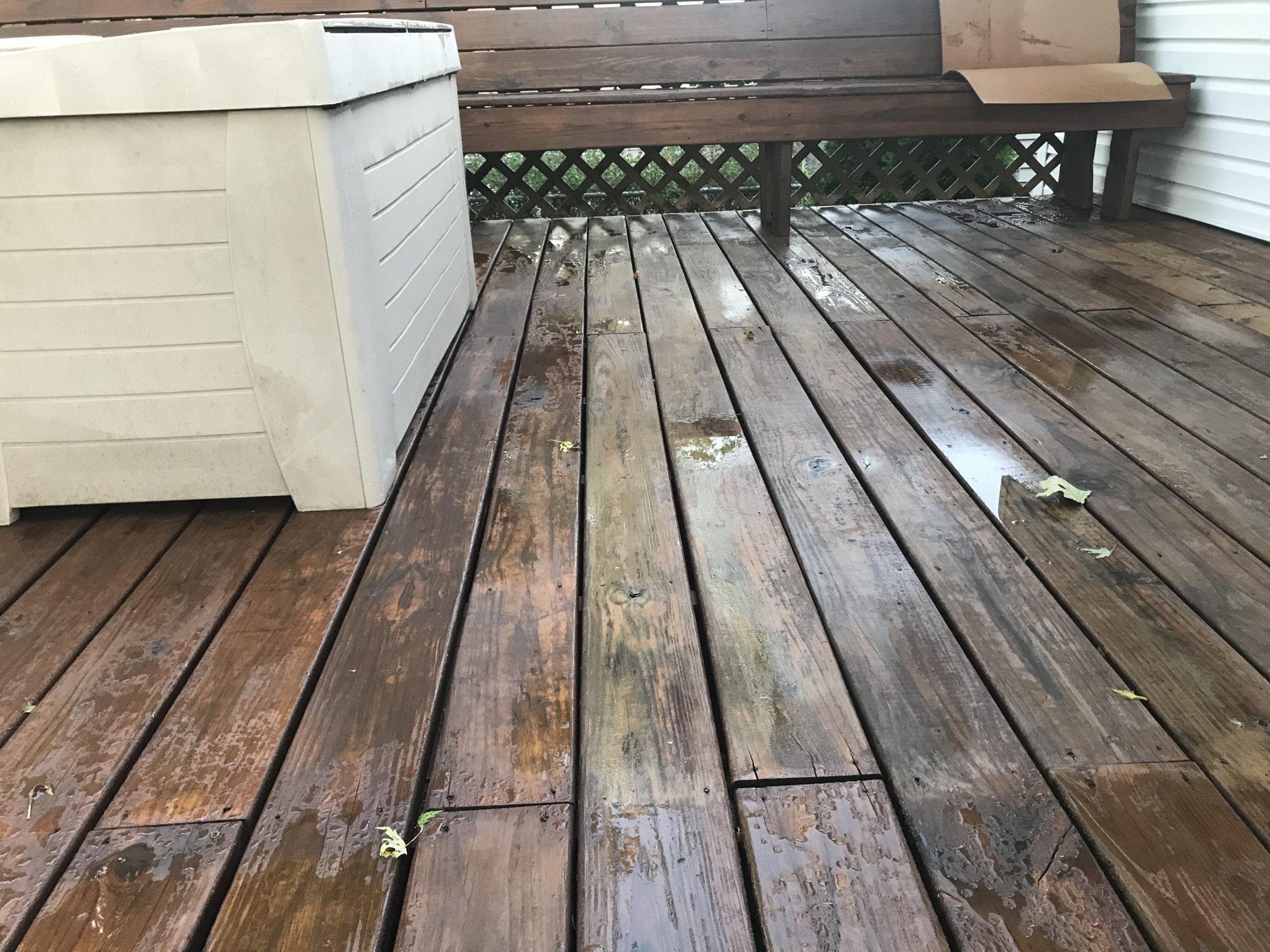

Sent this once but doesn’t seem too have gone through. These are what the water stains look like. They wipe off. My problem is everytime it rains or I try to spray it down to rinse off any dust, it just does it again. Not always in the same places. Will it ever stop/blend in? Or will it always look dirty? What can I do to make it look better? It’s like rain here in Illinois is dusty. Even my table gets dirty when it rains.
Hi, just got my deck rebuilt. It rained when they were building so they left and came back to complete. They waited two days to stain because it was raining. After they stained and it dried, it rained again for hours. I noticed a piece of the wood looks like it is cracking and some of the stain may have faded a bit. Not to much… Any thoughts or suggestions on what I can do to fix? Should I call the guys back that built deck to fix?
You cannot even stain a new deck right away: https://www.deckstainhelp.com/staining-a-new-deck/
They should remove it and follow proper directions.

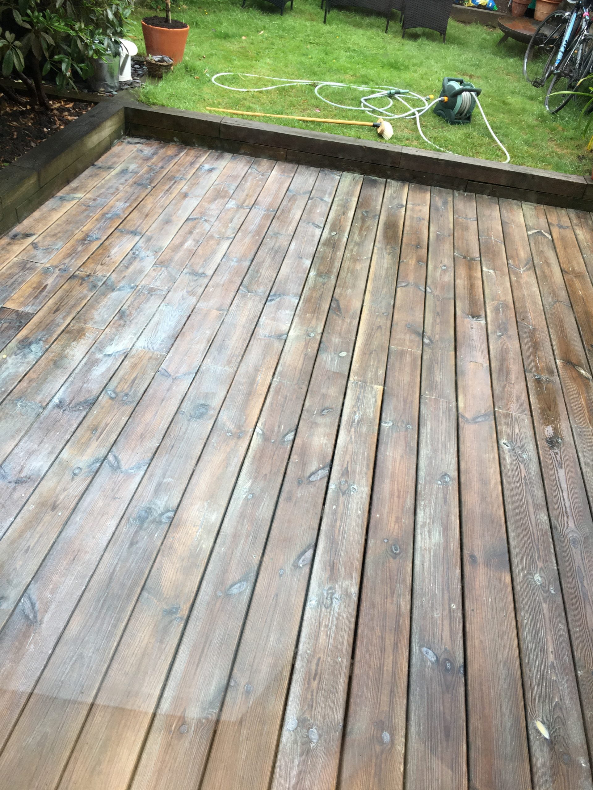

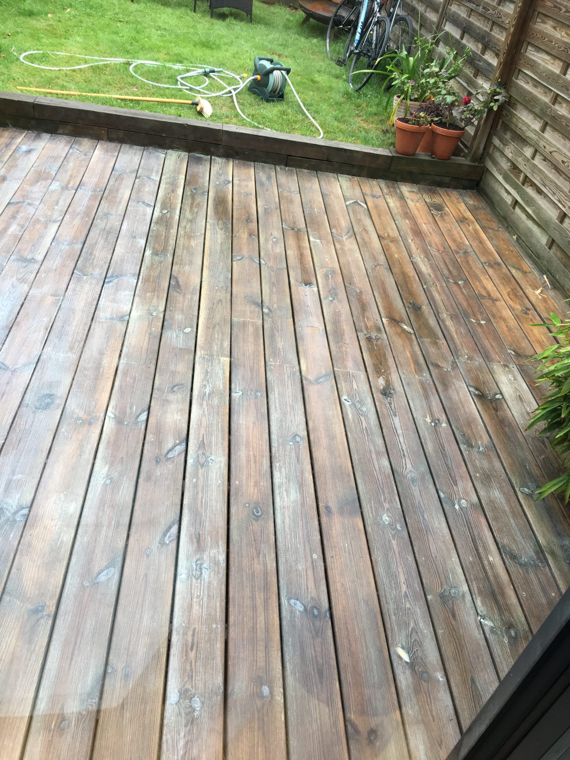

Hi i painted my decking with cuprinol decking stain
In a light grey last night.
Some areas have gone patchy from showers that came through the night
Would it be ok to just patch up the areas that are patchy before adding a 2nd coat?
No, you cannot spot apply, it will not blend.
What do I need to do
Re paint the whole decking again?
Probably but you will run the risk of it not curing correctly.
Hi- I stained and actually did a second coat and it rained about 6 hours later-light rain but will it be fine since this happened after the second coat? Best semi-transparent oil based .thanks!
What until the rain dries to assess if an issue or not.
Thank u. It is a bit sticky still. If it’s patchy would I be able just to restain the whole thing or just the patches?
Depending on the brand but typically more stain is not better and if you had too much it does not cure or dry correctly.
It is behr transparent oil based. I hope giving it a second coat didn’t mess it up.
It probably did. The Behr has many issues and one is that it does not cure correctly when over-applied. Sorry.

Can I do another coat over this to get rid of the rain spots? It’s semi-transparent.
No, and probably would not blend the spots anyhow.

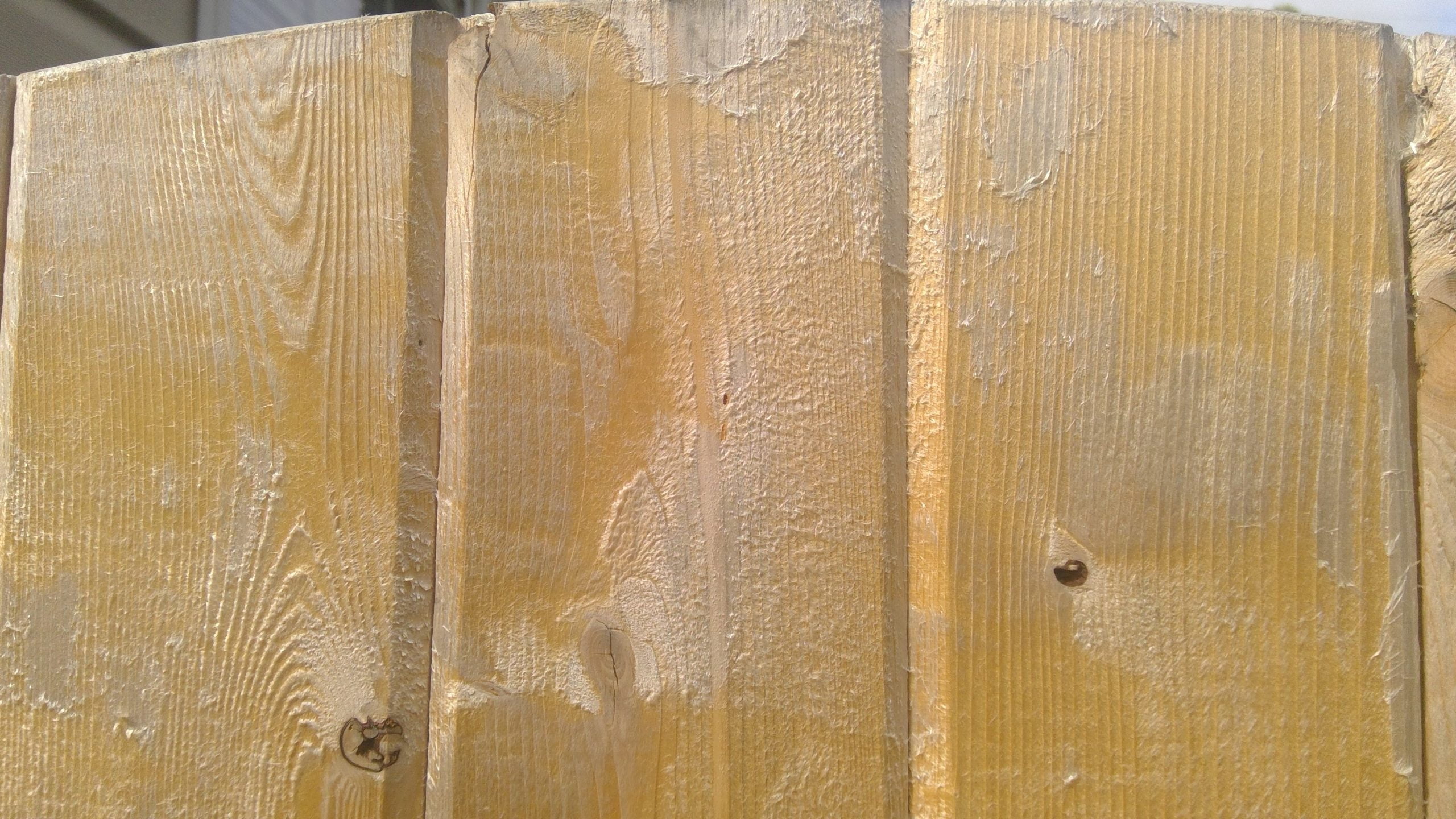

I put Behr honey gold water seal on my deck and in less than an hour it came an unexpected downpour which lasted almost 30 minutes. It is sticky . What do I need to do
Remove it all and start over.
What do I use to remove it
Post a picture.

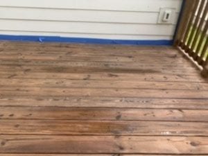

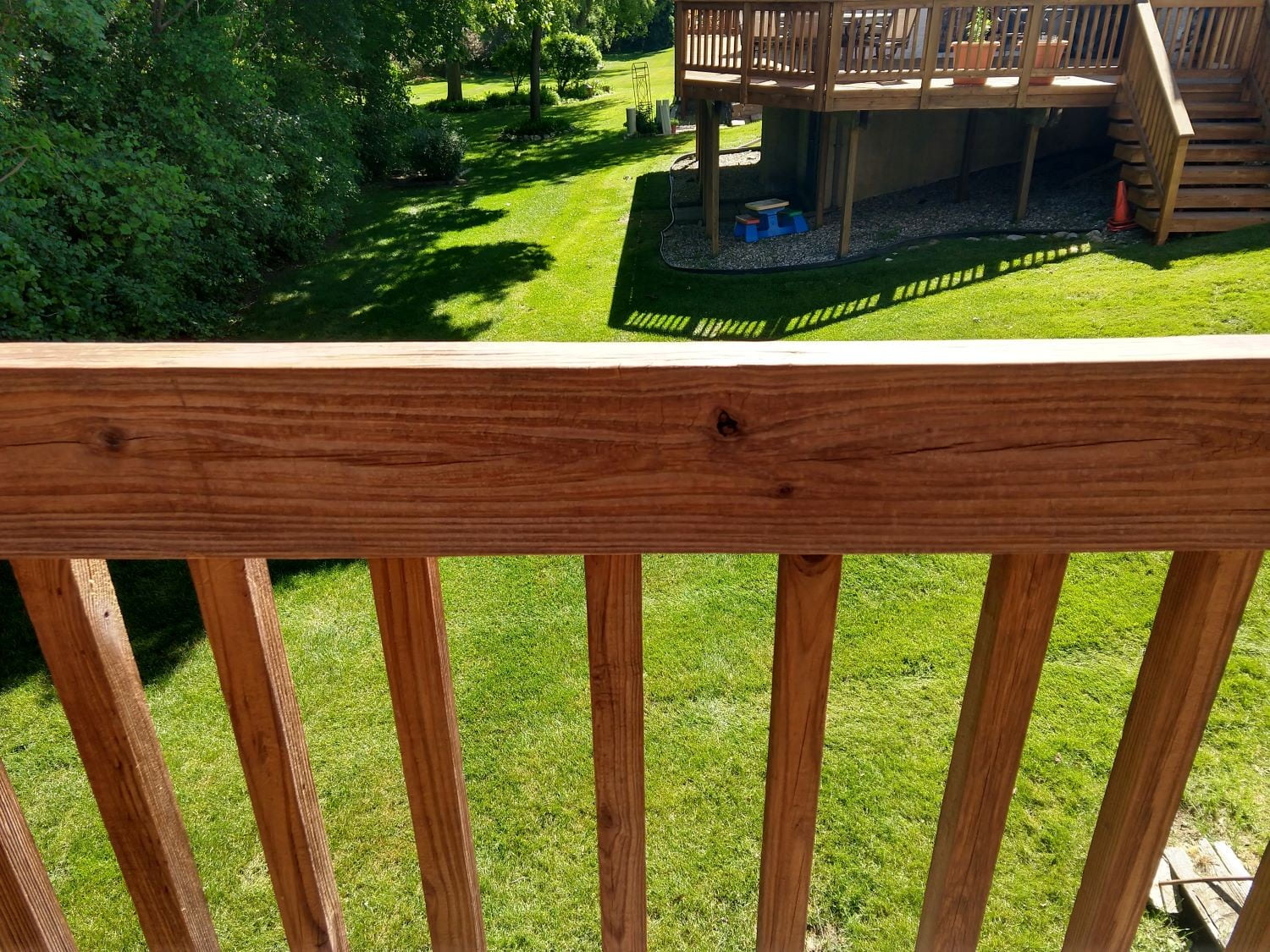

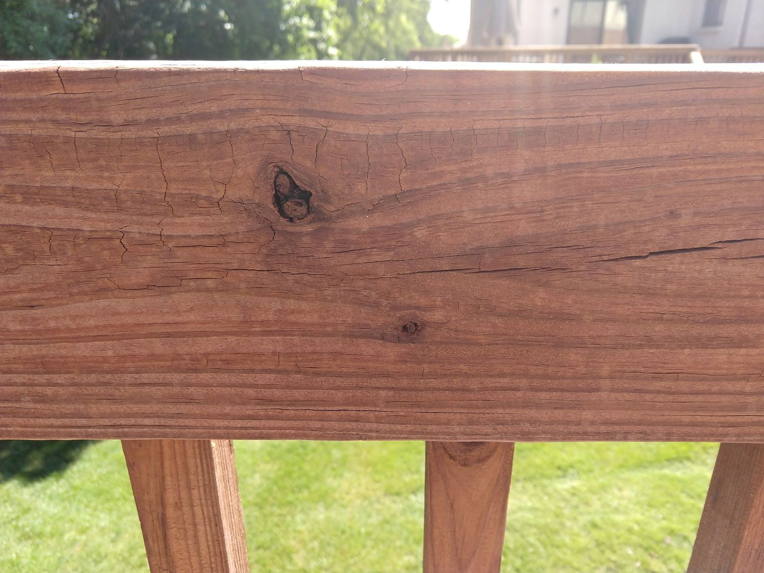

I stained the deck yesterday with a transparent stain looked ok when i was finished however when i woke this morning from it raining I found this. Took pictures to see if it will dry out as the sun warms it. Didn’t know it was supposed to rain. Not sure if it’s a total loss. I’m about to paint the house so excuse the back splash
Give it a few days to dry out and see if that evens it out. If it does not, you would need to remove all and start over to fix.
Thanks it actually evened out as soon as all the water was dried surprisingly. I will recoat it aftwr a few days to get it all to settle in. Thanks for responding
We would not add more stain. Leave as is if it evens out.

I put on a first coat of Sherwin Williams oil based semi transparent stain on my deck. As I rolled the last drop of stain it started sprinkling. Which it did for hours. No downpour. 24 hours later it’s still tacky and not completely dry. The stain went on over a worn down solid stain. Supposed to be dry and seventies for next few days. Will it ever dry ?
Doubt it. You cannot apply a semi-transparent over a solid stain for one plus it never had a chance to cure.

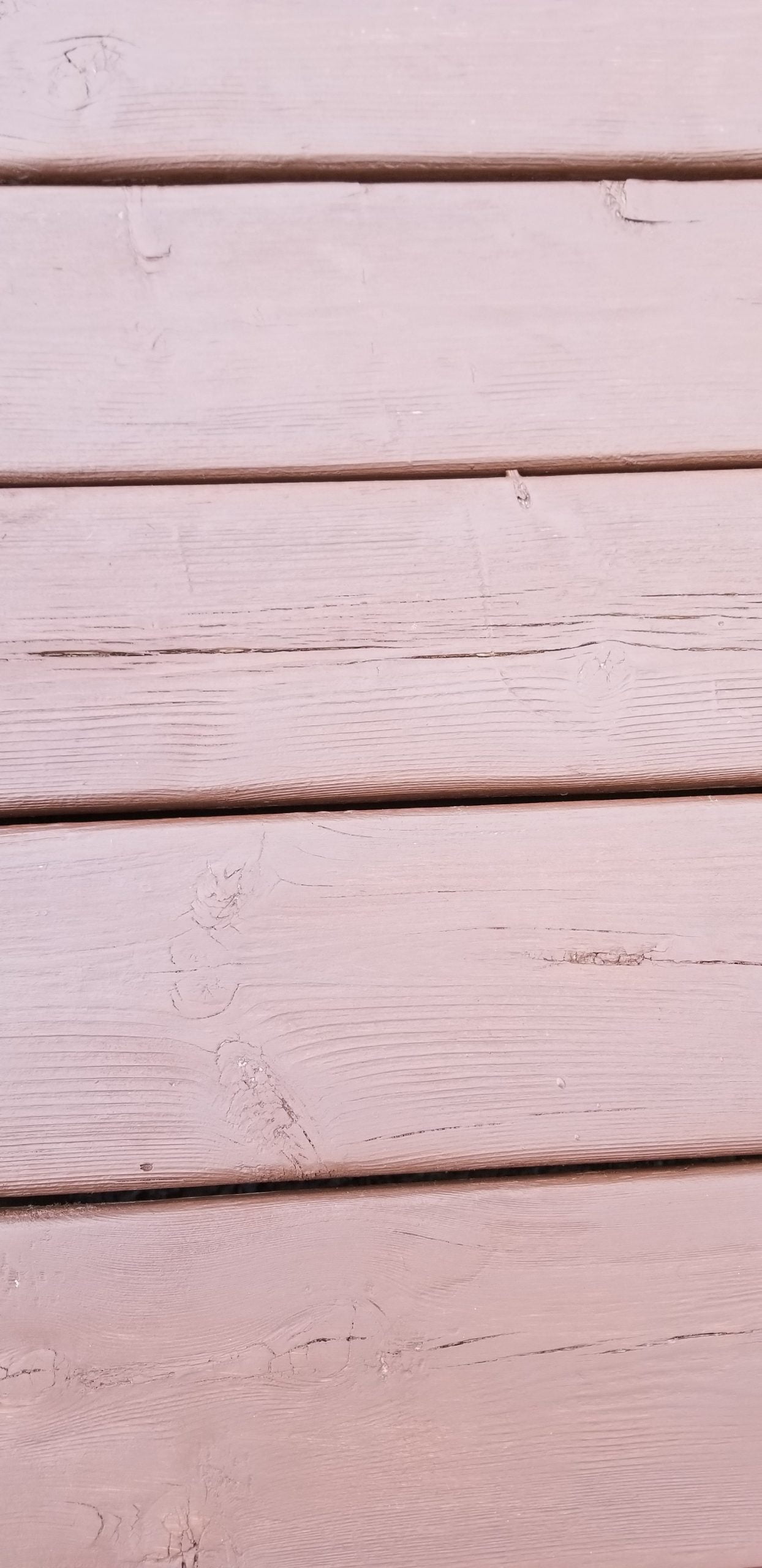

Rained within 12 hours of staining deck. Color is lighter almost pinky when wet. Is it ruined? How can we make sure the color stays the color it’s supposed to be? Put another coat? Put a clear coat?
it is probably fine. Let the water dry off then assess. You can never clear coat over a deck stain.

Did light power wash and clean of deck yesterday morning. Got good sunlight all day. Got some light rain this morning. Gonna be sunny and 75 today. Since I’m not applying to raw wood, I have i layer on from last year (cabot oil) can I do the job later today after 6-7 hours of sunlight exposure?
If dry you should be okay to apply the Cabot again.

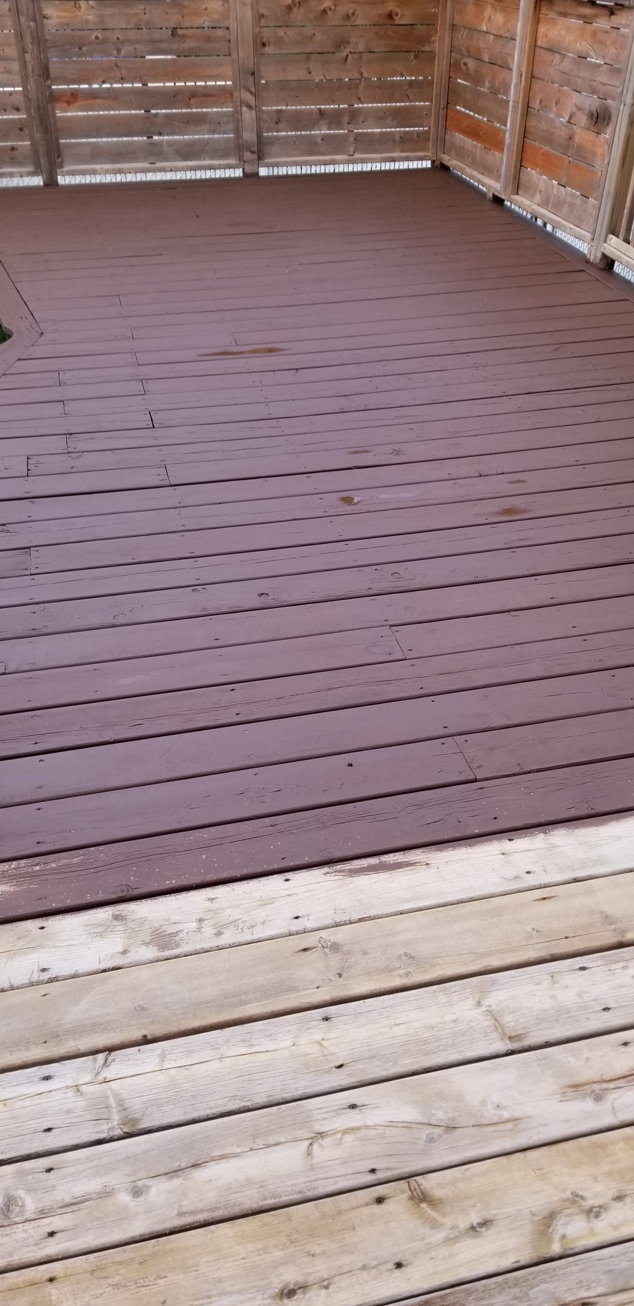

Hi—we just sanded our wooden covered porch. We used a light grey water based stain that was way too light. About 6 hours later we applied a dark oil based semi permanent stain. It seems to have started beading up? Like it didn’t soak in yet. It has been about an hour since we did this. Will this even dry? Help!
Most liley it is not going to dry correctly. You will have to remove all and start over.
