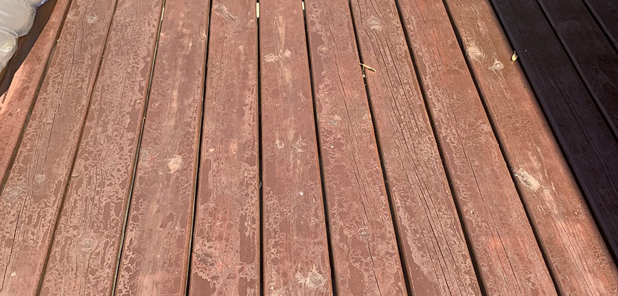

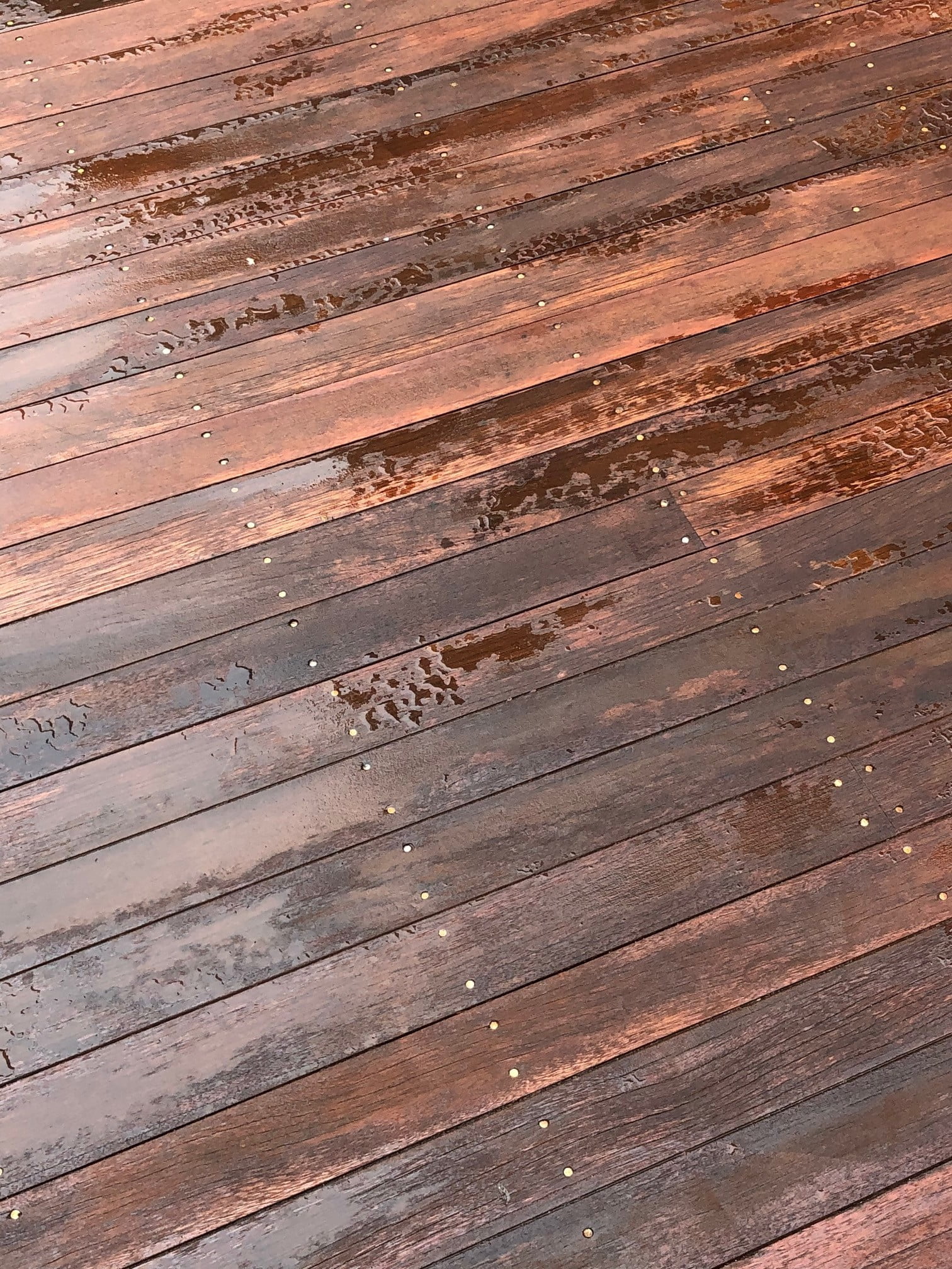

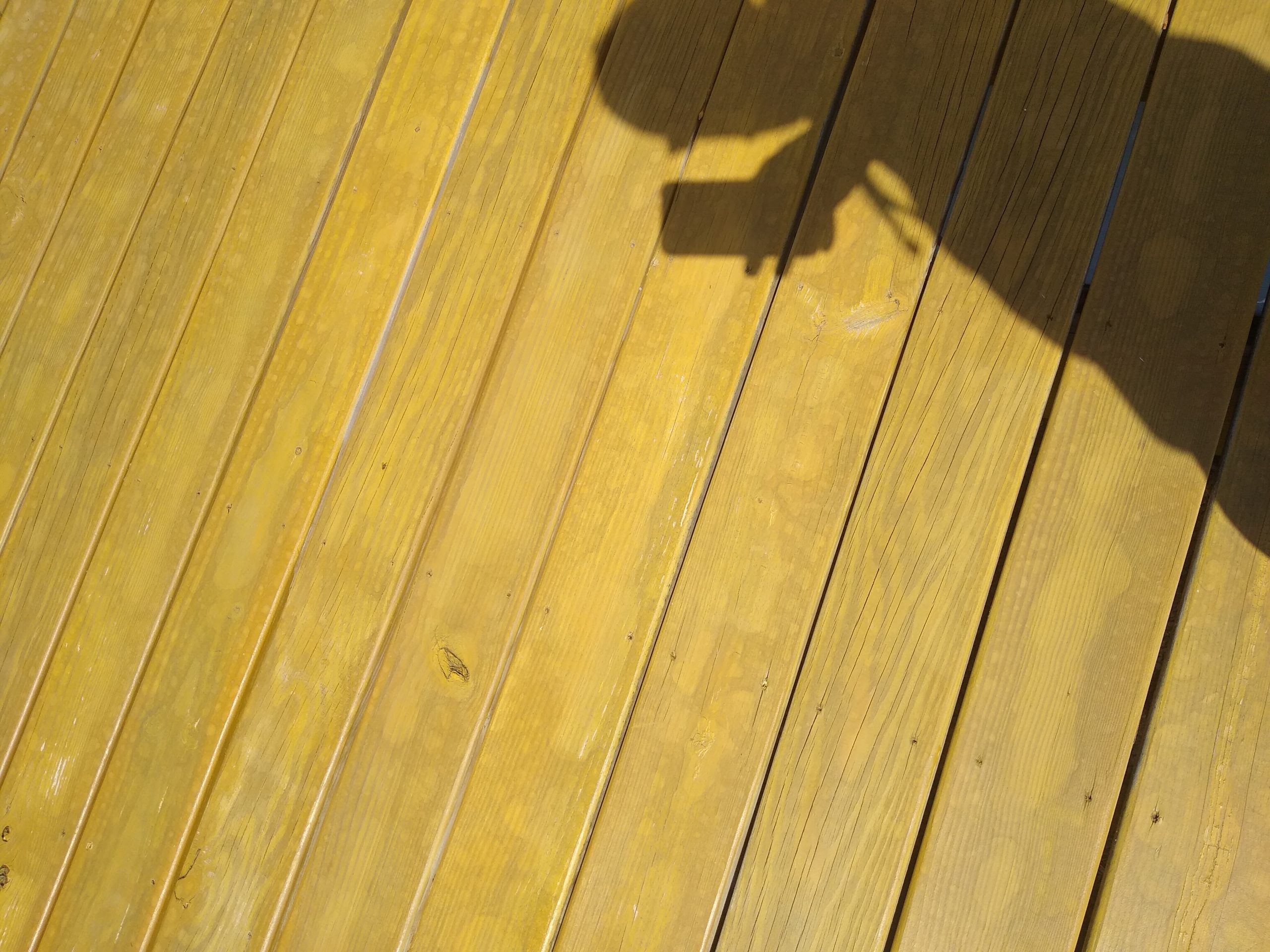

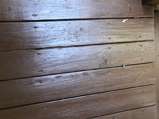

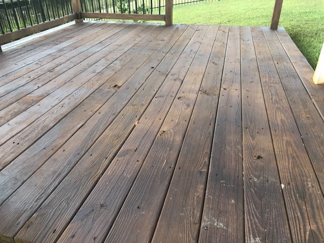

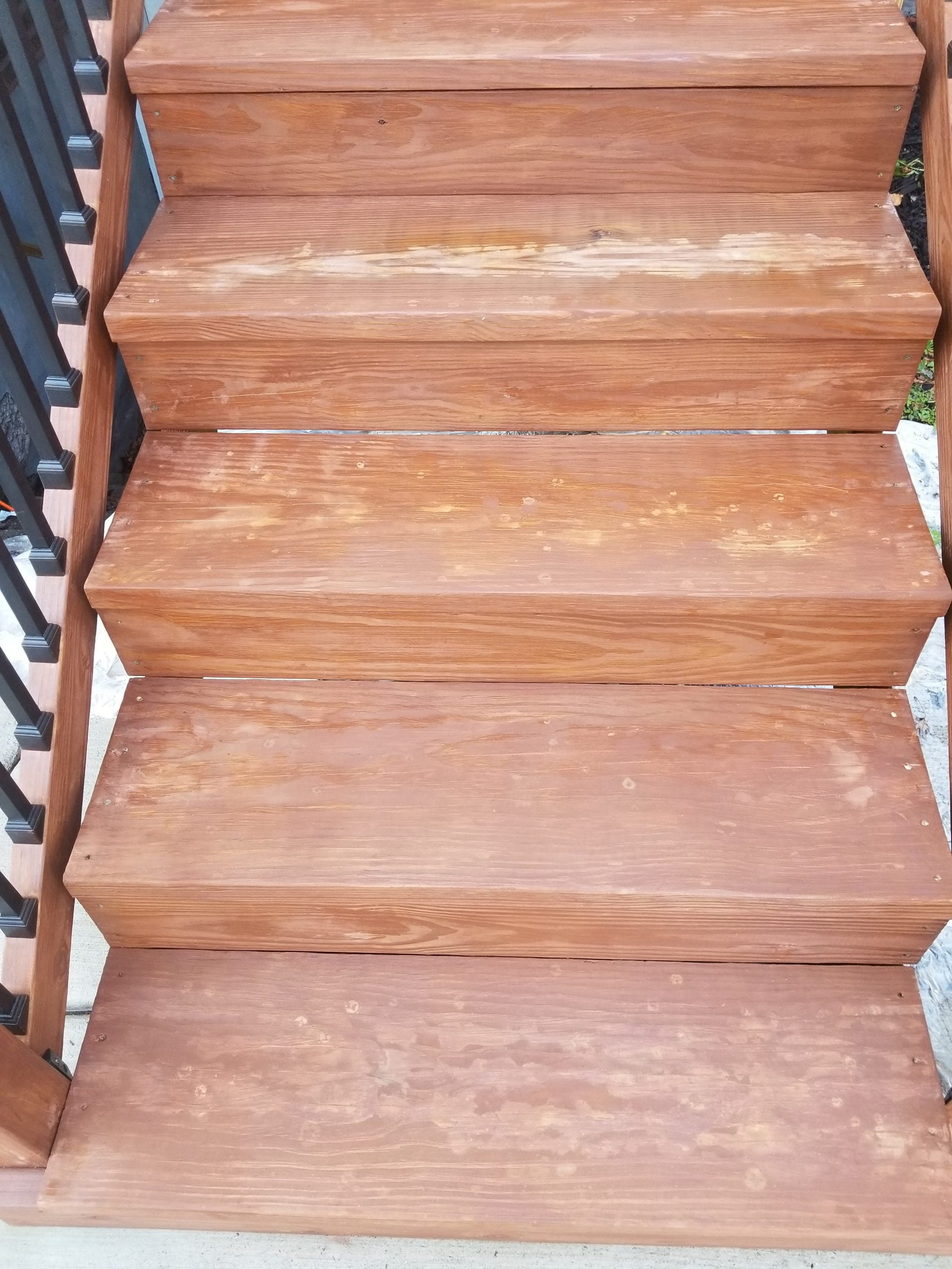

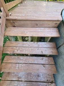

I stained a deck with Sherwin Williams super deck waterborne semi-transparent exterior deck stain. I finished at 4pm. By 8pm a light mist was starting that turned into a drizzle for several hours. It’s been wet ever since and now it looks splotchy (see the picture attached (left side of the image is not stained yet) . Do I need to strip everything and start over? Can I just recoat?
IMG_1997
Bill Robinson
Bill Robinson
3 months ago
I stained a deck with Sherwin Williams super deck waterborne semi-transparent exterior deck stain. I finished at 4pm. By 8pm a light mist was starting that turned into a drizzle for several hours. It’s been wet ever since and now it looks like the picture attached (left side of the image is not stained yet) . Do I need to strip everything and start over? Can I just recoat?
Bill Robinson
Bill Robinson
3 months ago
Added a picture above, thanks!

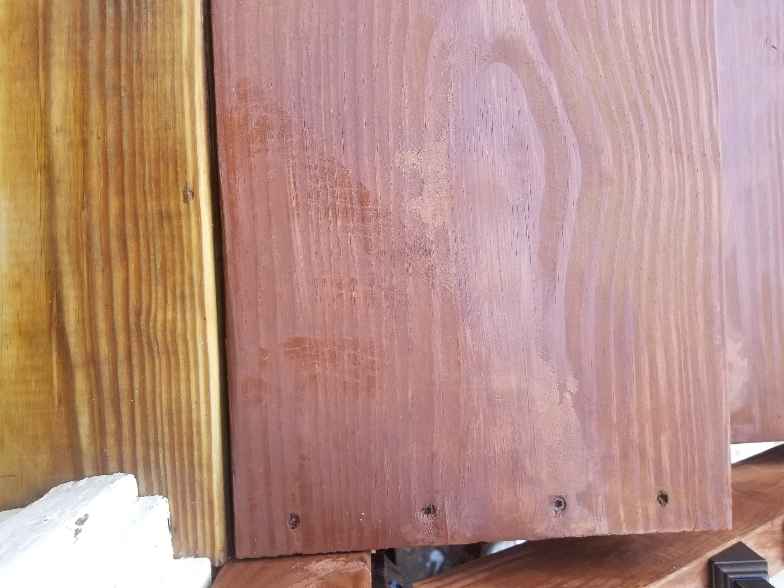

I just finished putting a coat of Cabot Australian Timber Oil Natural on my yellow pine deck and now it looks like rain is coming. What can i expect with this product.

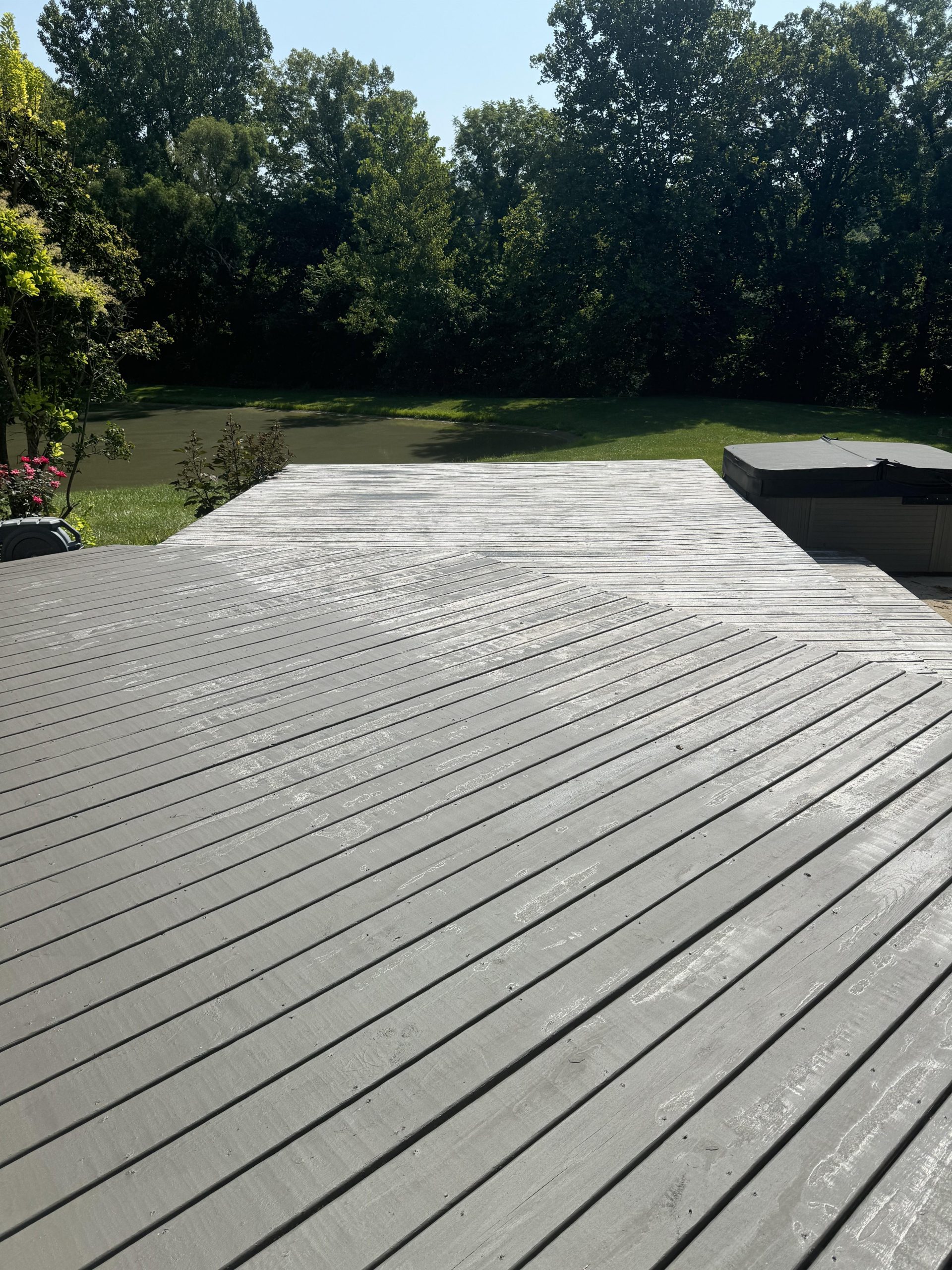

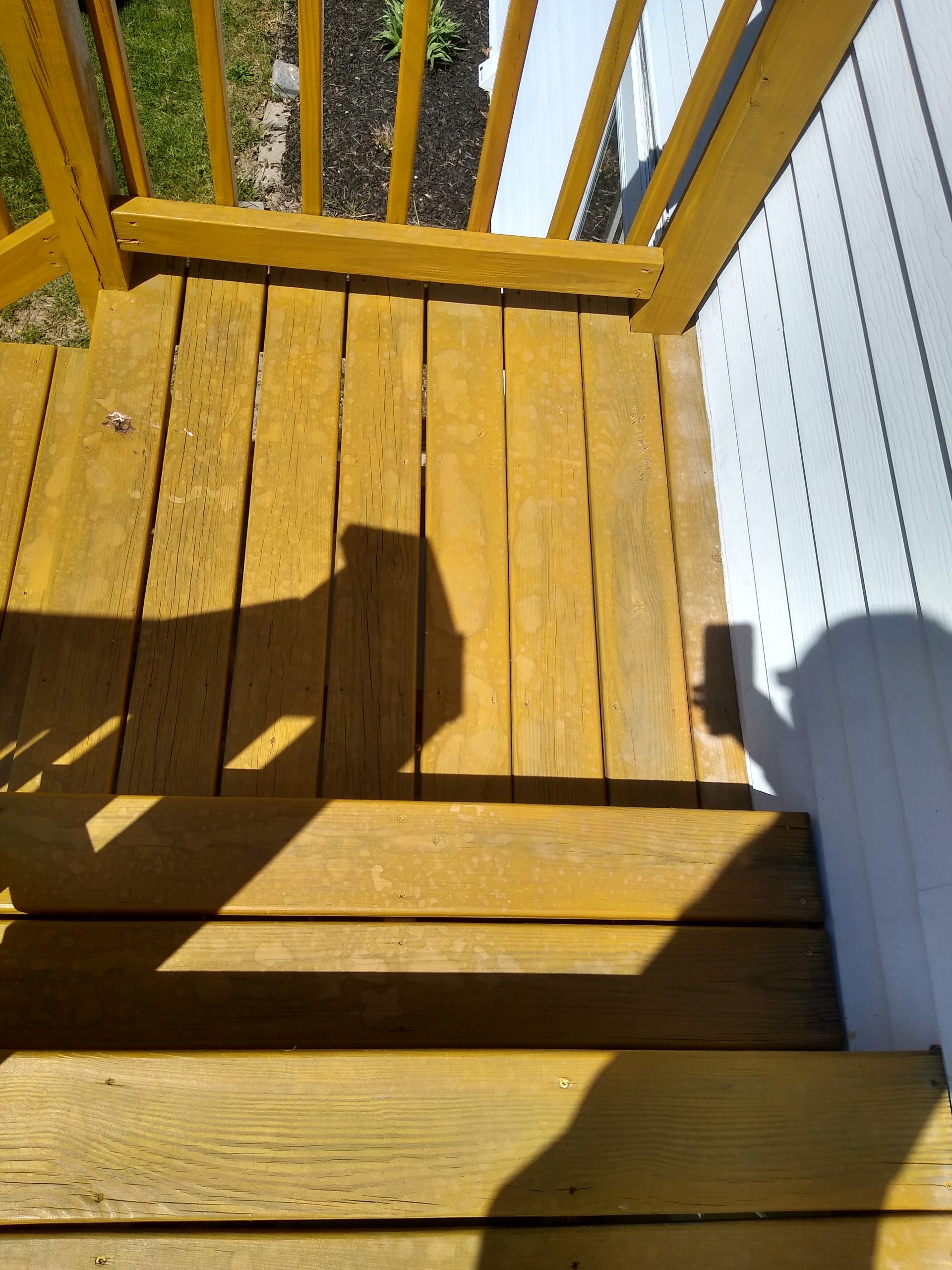

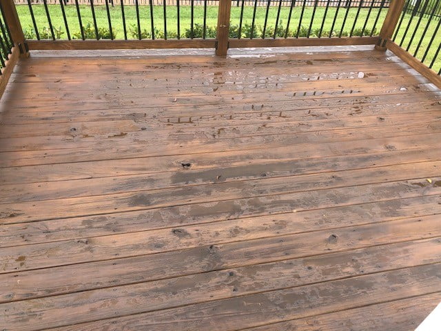

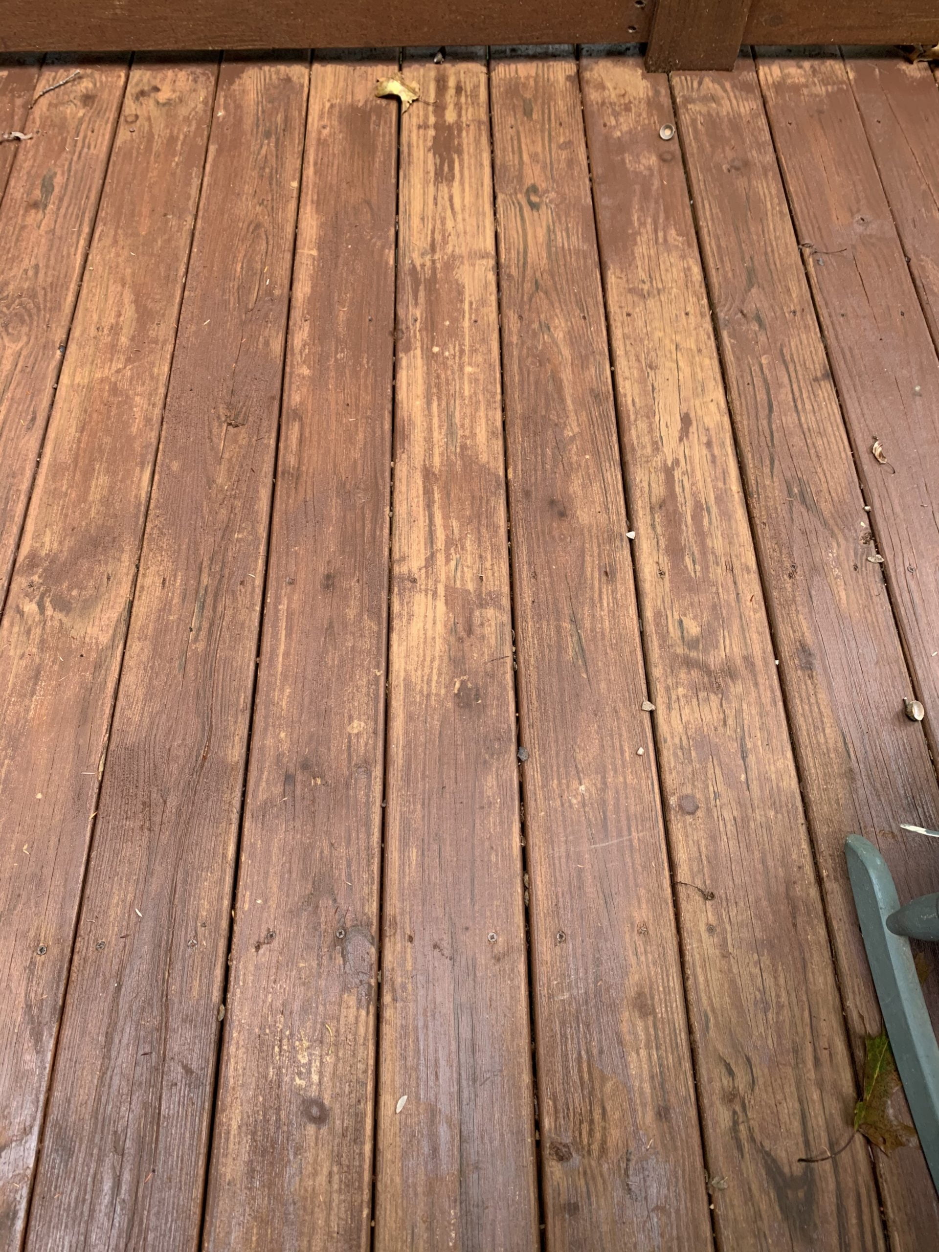

What is wrong with this? I just had it stained. The upper part has a second coat. Looks awful!

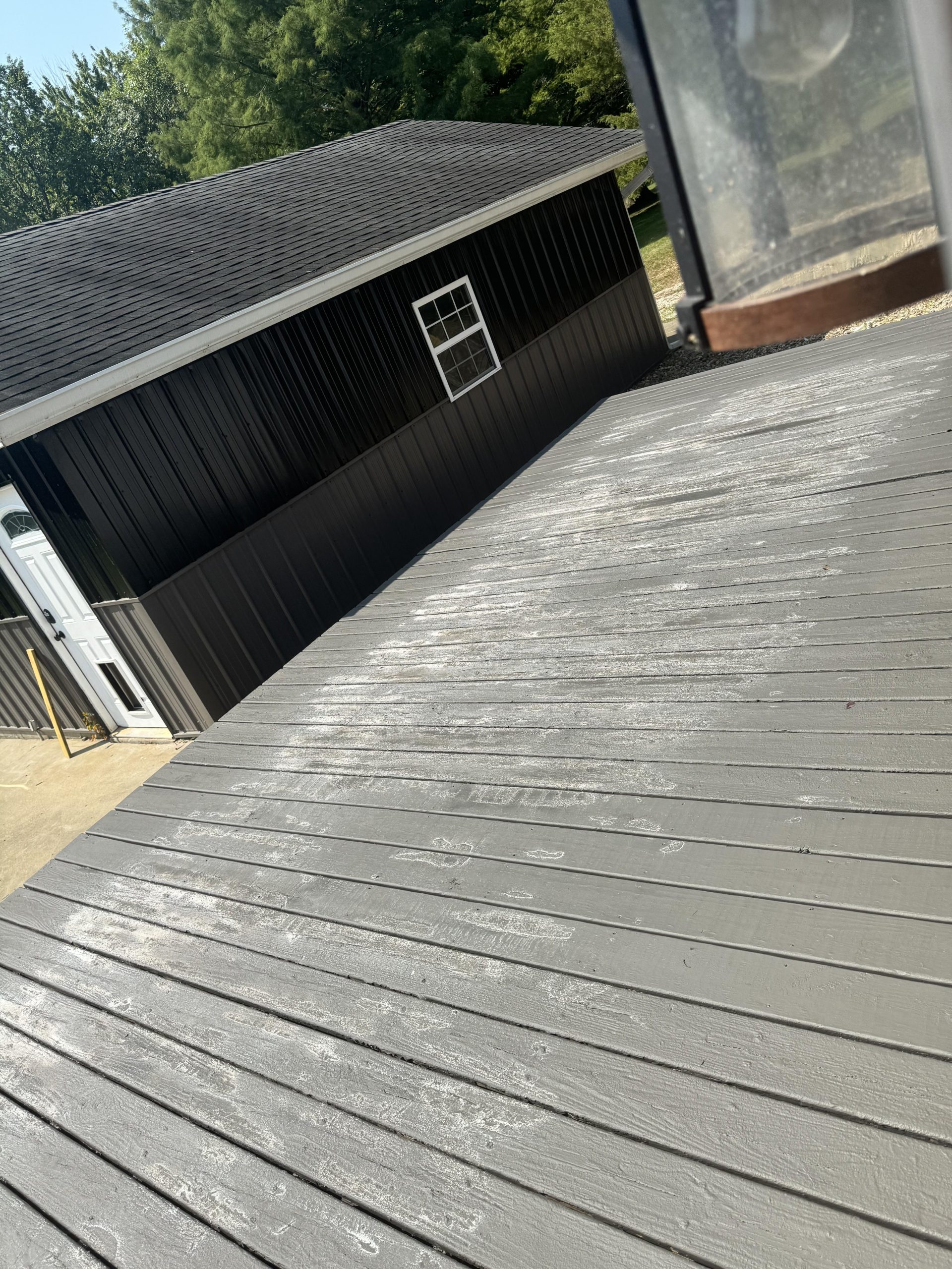

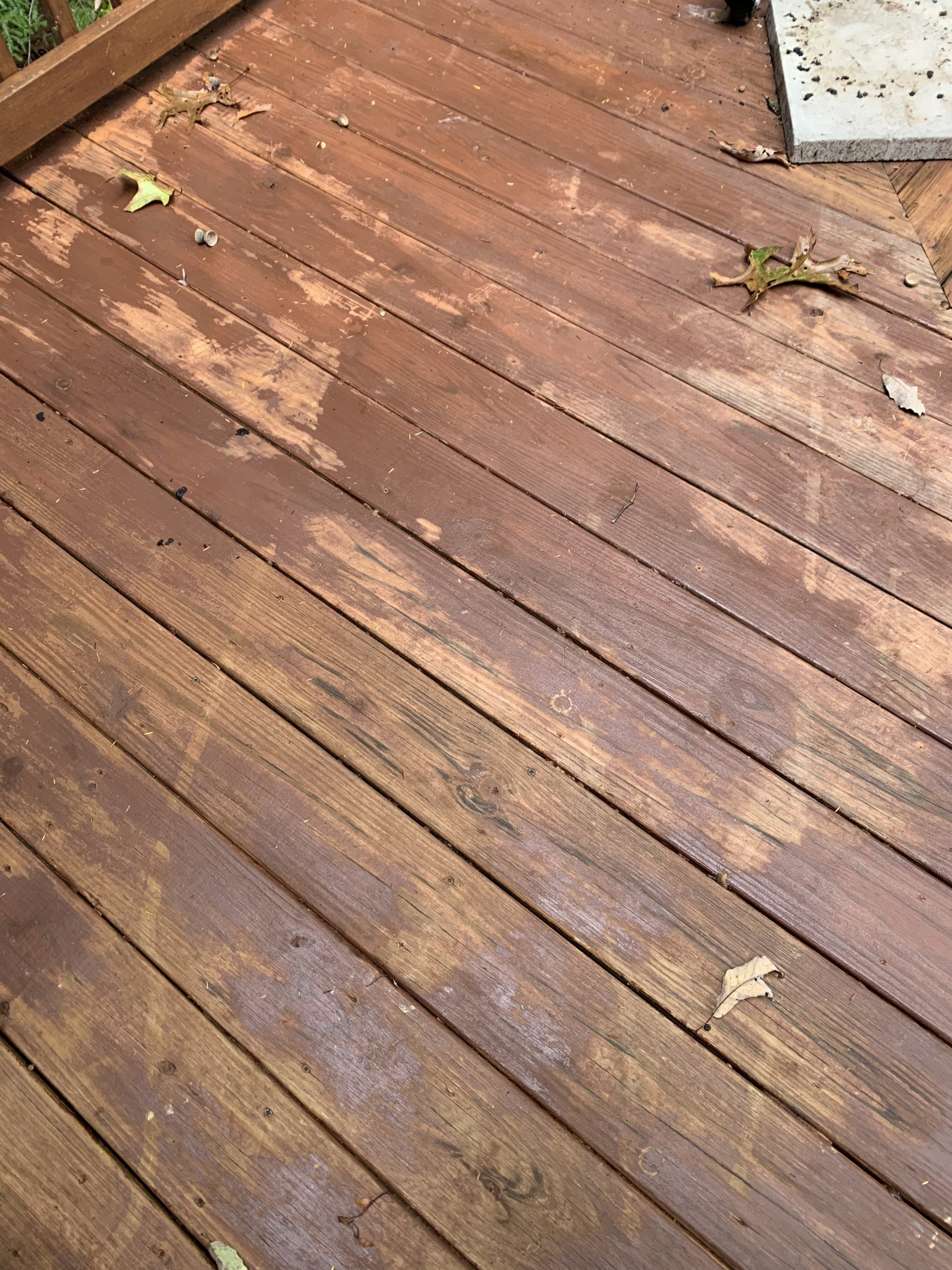

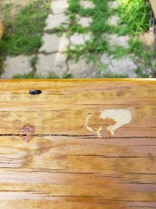

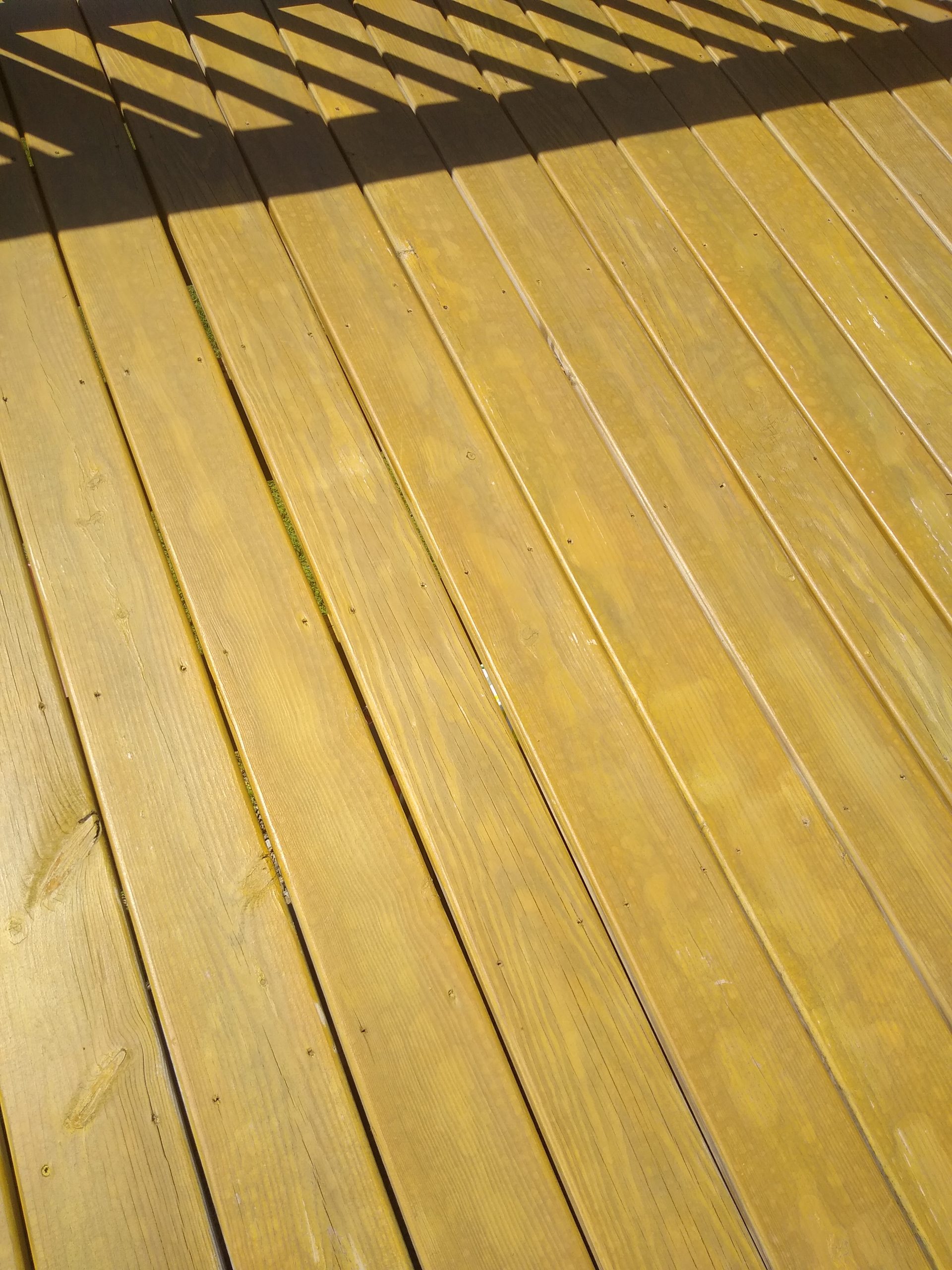

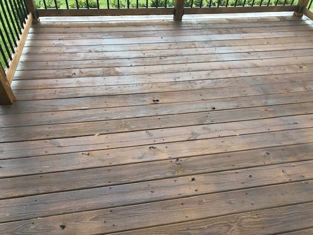

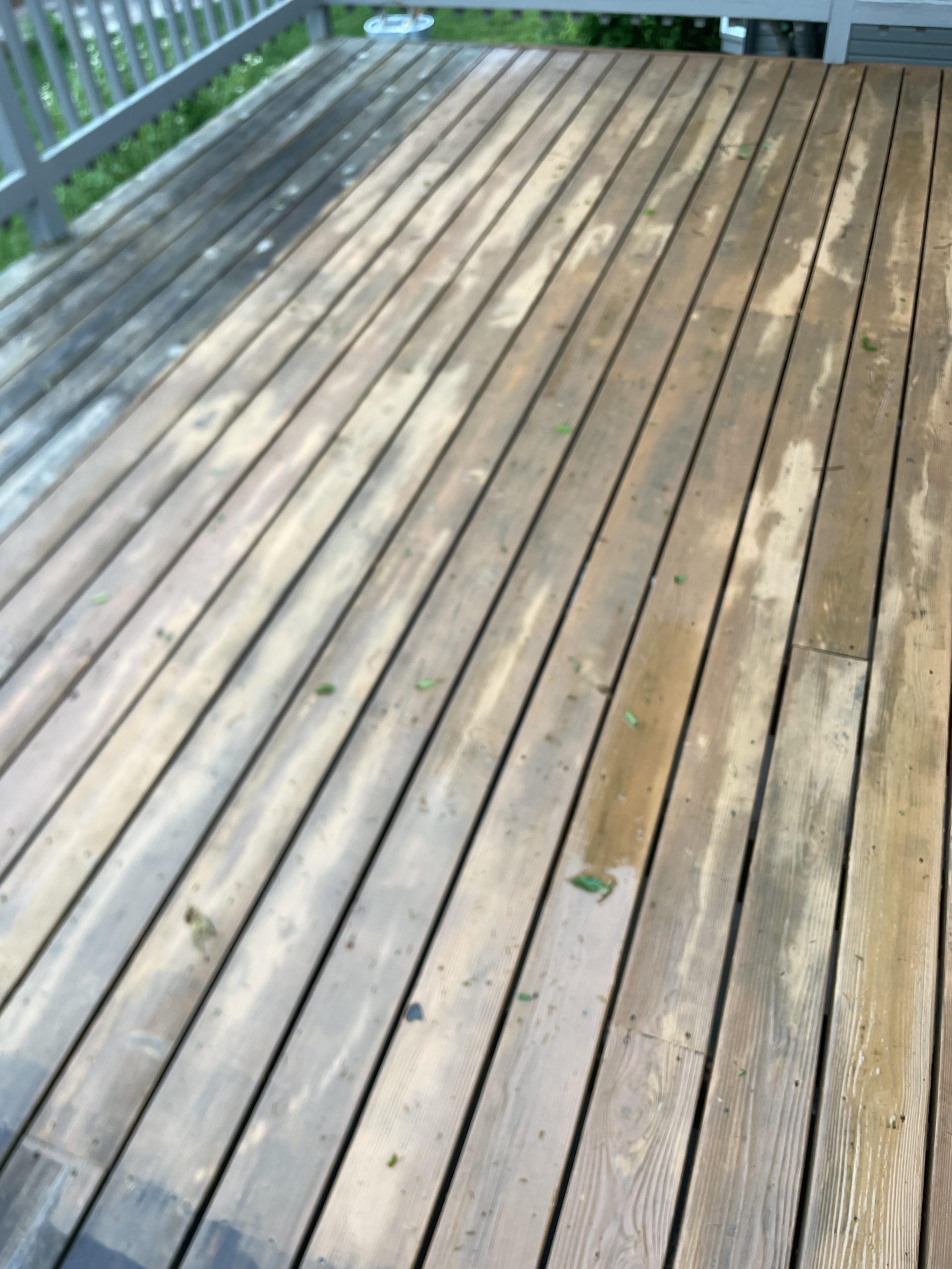

Hello, I’m trying to figure out if this was ruined by rain or if this is white washed and needs more time to cure. I finished around 8 pm and it rained unexpectedly at 4 am. This is what I woke up to. I read on the manufacturer website that if it isn’t fully cured then you shouldn’t put another coat on. If it is rain damaged then I want to recoat asap. We are trying to list our house for sale and the new deck looks awful.
IMG_0865
IMG_0864
IMG_0863

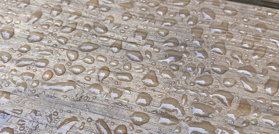

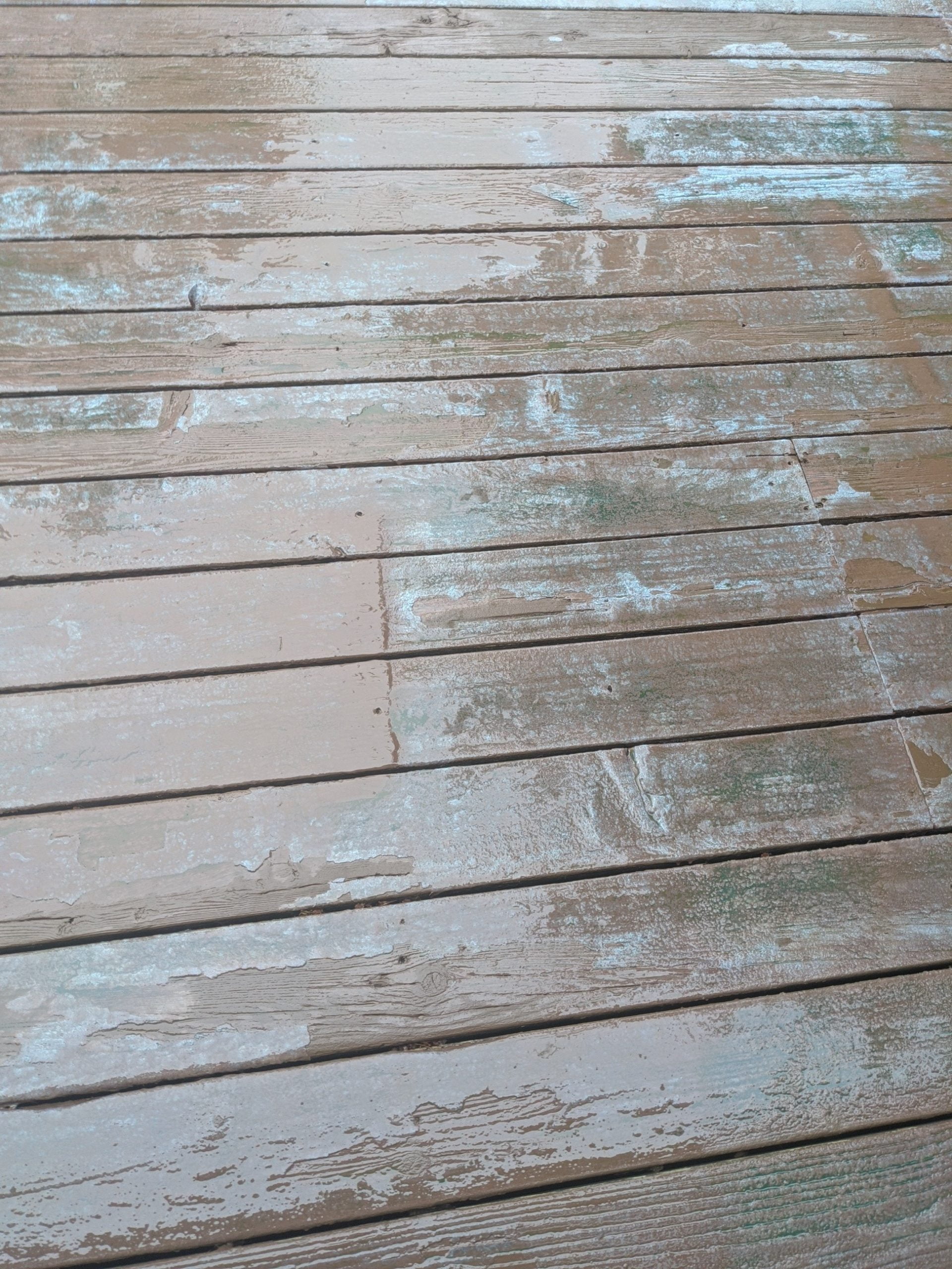

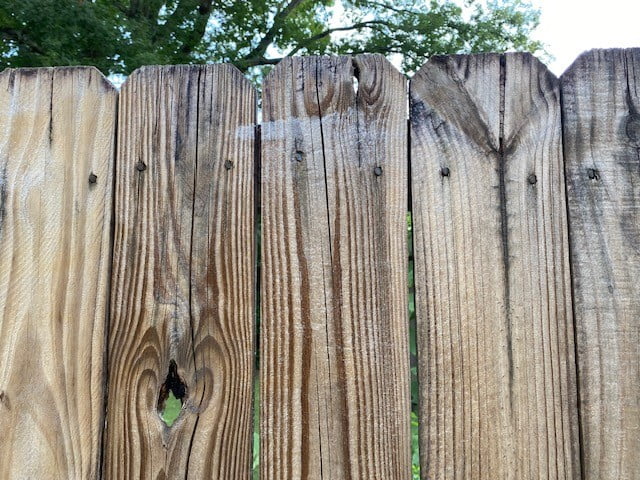

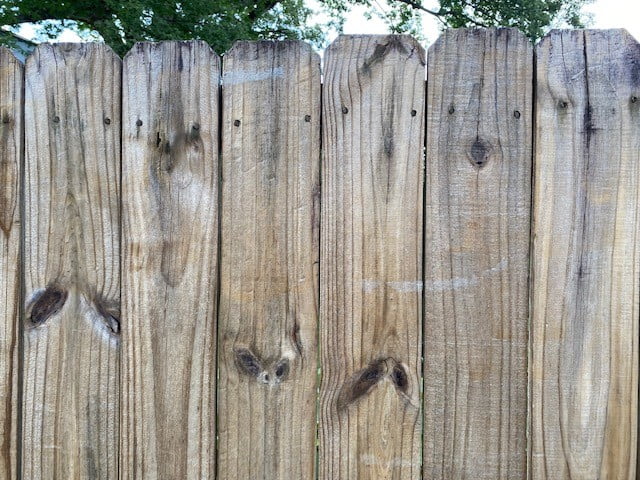

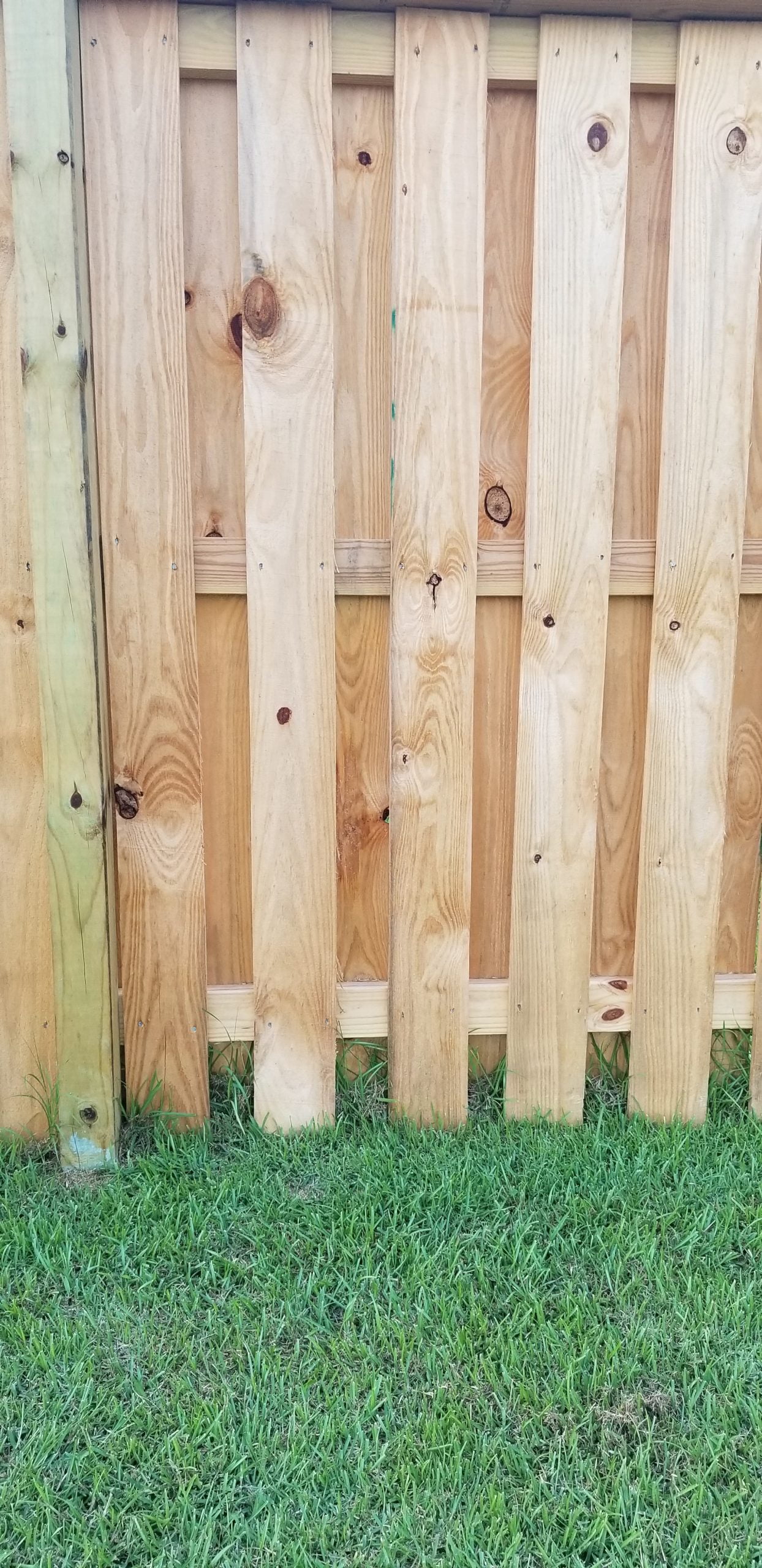

Why does one board on a recently stained deck puddle like this? Very odd. Does it mean the product didn’t adhere to this board?
IMG_2381
This was not new wood – about 15 years old and sanded – first with 40 grit and then 80. Cabot’s Australian timber oil was used. Sorry please remove triple post.

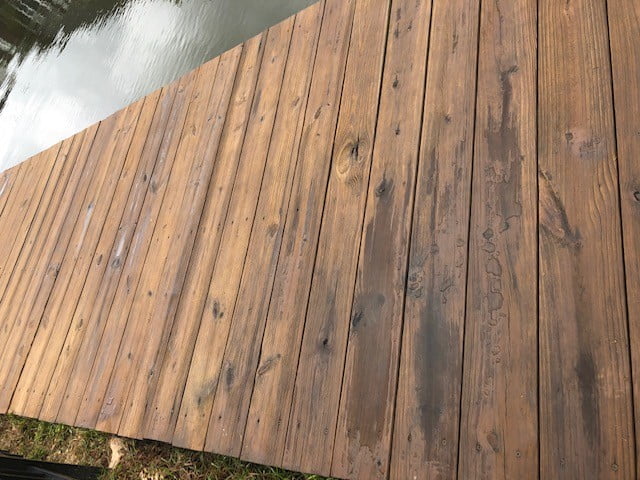

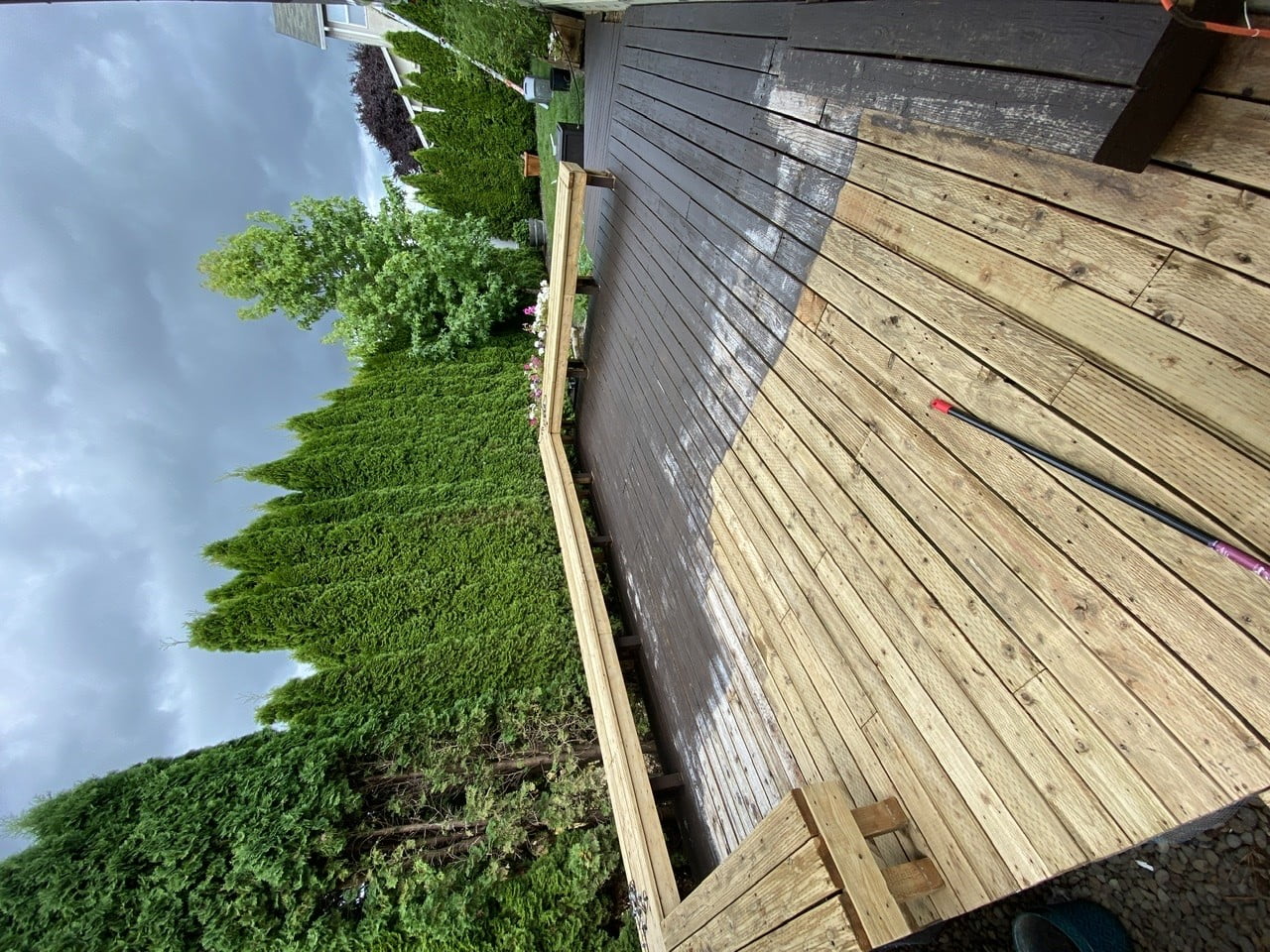

Stained deck with semi transparent olympic PPG stain. We live in Alaska so its been raining a lot. We stained, it dried for over 48 hours and now its raining for the next week. If you touch the stain it is coming up on our hands, shoes , and dogs feet. It is raining for the next week and can’t just wait it out. What can we do right now to fix this?

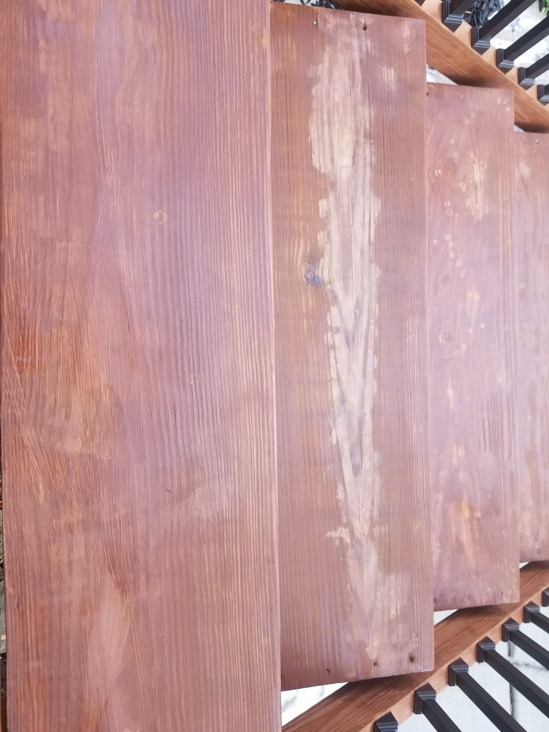

It rained all of a sudden while staining the deck using Olympic maximum semi-transparent stain
20240725_114206
John Cammalleri
John Cammalleri
Sorry, forgot to add photo.

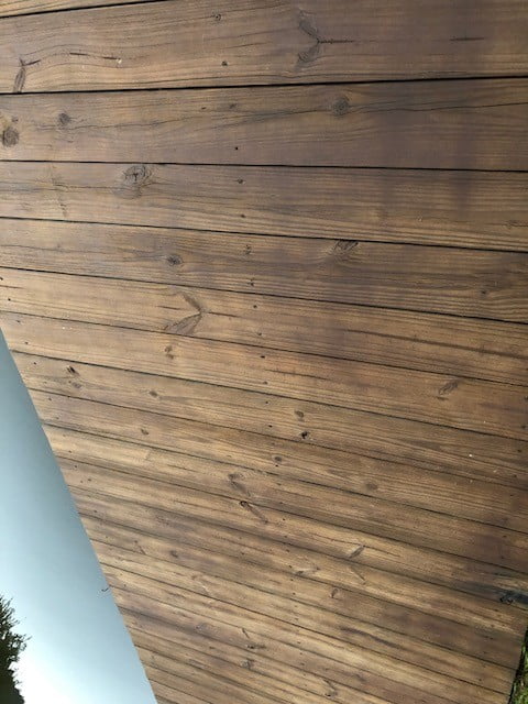

Hi Scott. First of all, thanks for all the valuable advice you provide. I’ve had my deck restained, and it looks great, EXCEPT:
there are darker areas around the perimeter, where a hand brush was used. (Photo attached.)
How do you recommend we fix that? Do we need to sand and redo? If so, do we still need to use brightener? The deck was cleaned thoroughly, stripped, cleaned again, then treated with brightener, before stain was applied. Hoping a sanding will suffice.
John Cammalleri
John Cammalleri
Thanks for your help. A thorough sanding is not sufficient? Reluctand to use stripper/brightener because the outer deck, railings and gazebo are fine. Don’t want runoff from stripper to ruin those.
Thanks again.
John Cammalleri
John Cammalleri
Thank you for your help. That’s what we’ll do.

We had some dew drip down from an overhang the night we stained and found this the next morning. We used Messmer’s UV+. Should we try and add more stain to these spots, sand the boards down and stain them again, or something else? Thanks!

Hello, similar story to others here: I think unexpected rain might have messed up the deck seal we applied. Either that or I was a bit heavy handed in applying the deck seal.
It’s a new deck and we used Behr transparent deck seal. It rained maybe 6-8 hours after we sealed the deck. It was overnight so I couldn’t tell how hard it rained but there was water pooled on the deck the next morning.
Question is: should we pressure wash and re seal it or is it okay for the upcoming winter? What do you recommend?
Shannon
Shannon
Sorry I thought the pictures were loaded! Here they are.
Shannon
Shannon
Notice in some areas the colour is more saturated and shiny despite it feeling completely dry.

What do I do? Here’s pic of white blotches and some still wet after 24 hrs.
Lori
Lori
Thank goodness it’s on the railings. I will do that (pressure wash then recoat). Thanks for your quick reply. Truly appreciated 😊

Here is the pic
Phil
Phil
Can anyone suggest a remedy for this…this is the second coat of Cabot deck correct and it rained 10 after applying.

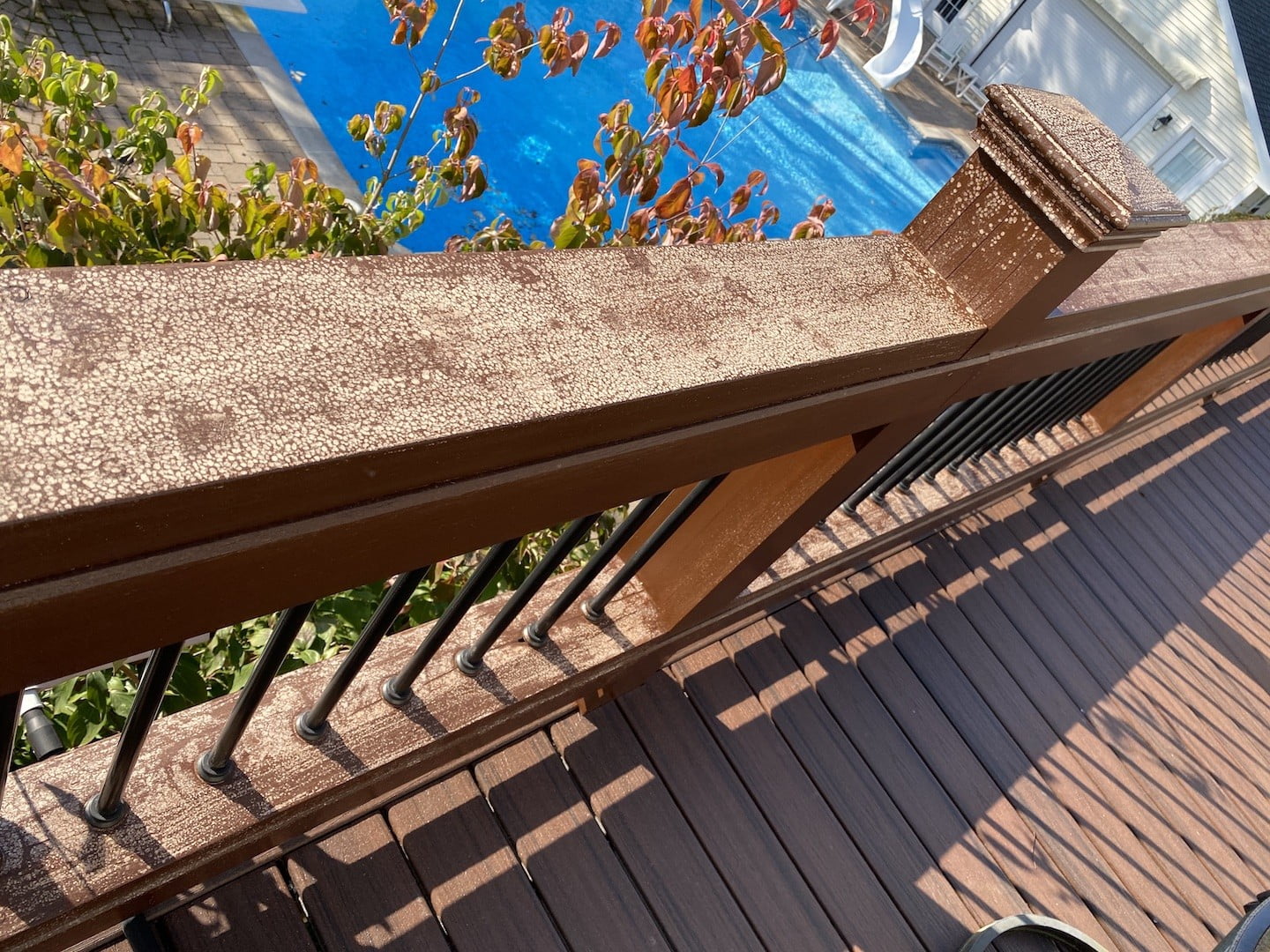

  1. Contractors cleaned and re-stained our deck with Sherwin Williams SuperDeck semi-transparent oil based stain. It rained about 4 hours later, a quick downpour, and then cleared up. The water sitting on the deck made the area under it look pinkish when the sun hits it (first picture) but looks perfectly fine when dry (third picture). I waited a full day (recommendations on the can say not to apply within 24hrs of rain) after and put some more water on the area and got the same pinkish look under the sun, but the wet deck out of the sun (second picture) looks normal . The contractor has agreed to come back and sand and refinish if we want, but I am wondering if that is necessary if the deck looks good when dry.

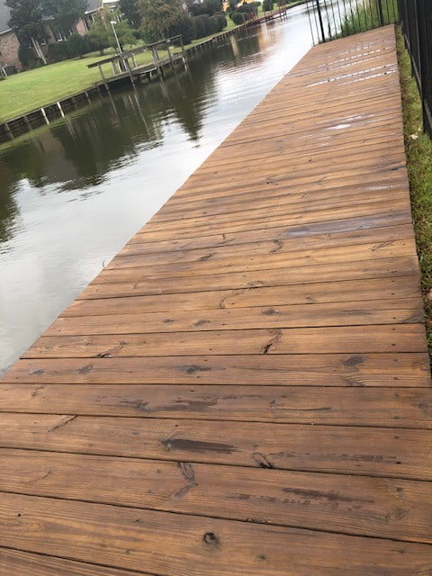

I used SW Super Deck IR reflective semi solid stain on my boat dock. It came a downpour about 4 hours after applying. There are a few bare spots now and the rain didnt bead up like i thought it should. The bare spots dont concern me terribly as I can touch those up but shouldn’t the rain bead on Semi solid stains???

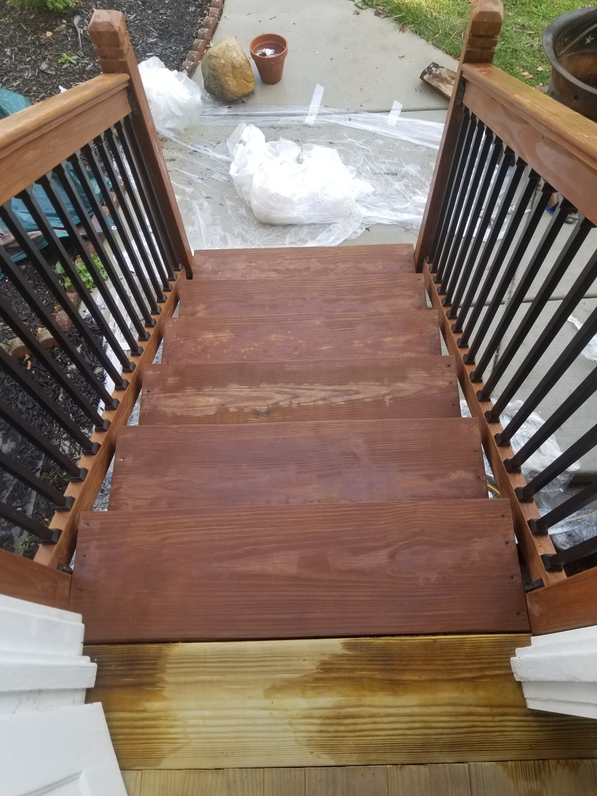

We stained our back steps yesterday and according to the weather report were clear for rain within the 8 hour window the stain requires before it’s waterproof. However a huge thunderstorm storm came in just as we were packing up last night.
I tried to put a tarp over it as best I could, given the situation, loud swearing and cursing the sky was involved, but a lot of water still got in.
We used Olympic Maximum semi-transparent stain + sealant.
Some parts are still tacky 22 hours later. Should I try and get covered again before the next rain tonight or is the damage done and I shouldn’t bother? Will it get worse if it gets wet again at this stage?
Once the rain has left am I able to repair the damage or do I need to start again?
We may not have idea weather again until spring will it be protected with what’s on it now for winter?

Water has dried off. Here are new photos. Thanks.
Omey
Omey
The water has dried off. Here are new photos. Thanks.
Omey
Omey
Reply to  Omey
The water has dried off and here are new photos. Thanks.

Angela Huang
Angela Huang
Thank you for the quick response. Attached a photo for the areas between boards. A little bigger than I’d like to see. No need to touch up at all?
I have some very fine bristle brushes used for oil painting that can reach deep down there. I can try not to touch the areas already stained. Worth trying?

Pressure washed and sanded our rather old mahogany deck. Applied Australian Timber Oil in Mahogany Flame. We had unexpected rain about 16 hours later and it’s lasted for 2 days. Now some boards are still beading but others look very flat. With fall rapidly approaching I was wondering if the deck would have enough protection for the winter and I could resand it and stain it in the fall, or if it’s completely shot and I need to redo it this year
Alex
Alex

Hi I started the process of water sealing my wood fence with cabot clear wood stain it hadn’t rained 48 hours before and wasn’t supposed to rain for 48 hours after however I live in NC and the weather is all over the place so the weather could call for no rain and 10 minutes later it could change. I got 1/3 of the fence done and it started raining in the process 😭 it had only been on for 30 minutes now I dont know what to do I am a novice at this. We had a good down pour for about 3 to 5 minutes and now I don’t know if its ruined and if so how do I go about fixing it. Your help is greatly appreciated! Thank you 😊
Lara Horn
Lara Horn
Hi here is a picture you were asking for 😊 I’m using Cabot clear wood protector on my backyard fence. It had only 30min to dry when it started raining. It rained pretty hard for about 3 to 5 minutes but this is normal weather here I never know if it will rain or not the weather changes so fast so often. Any advice is greatly appreciated!
