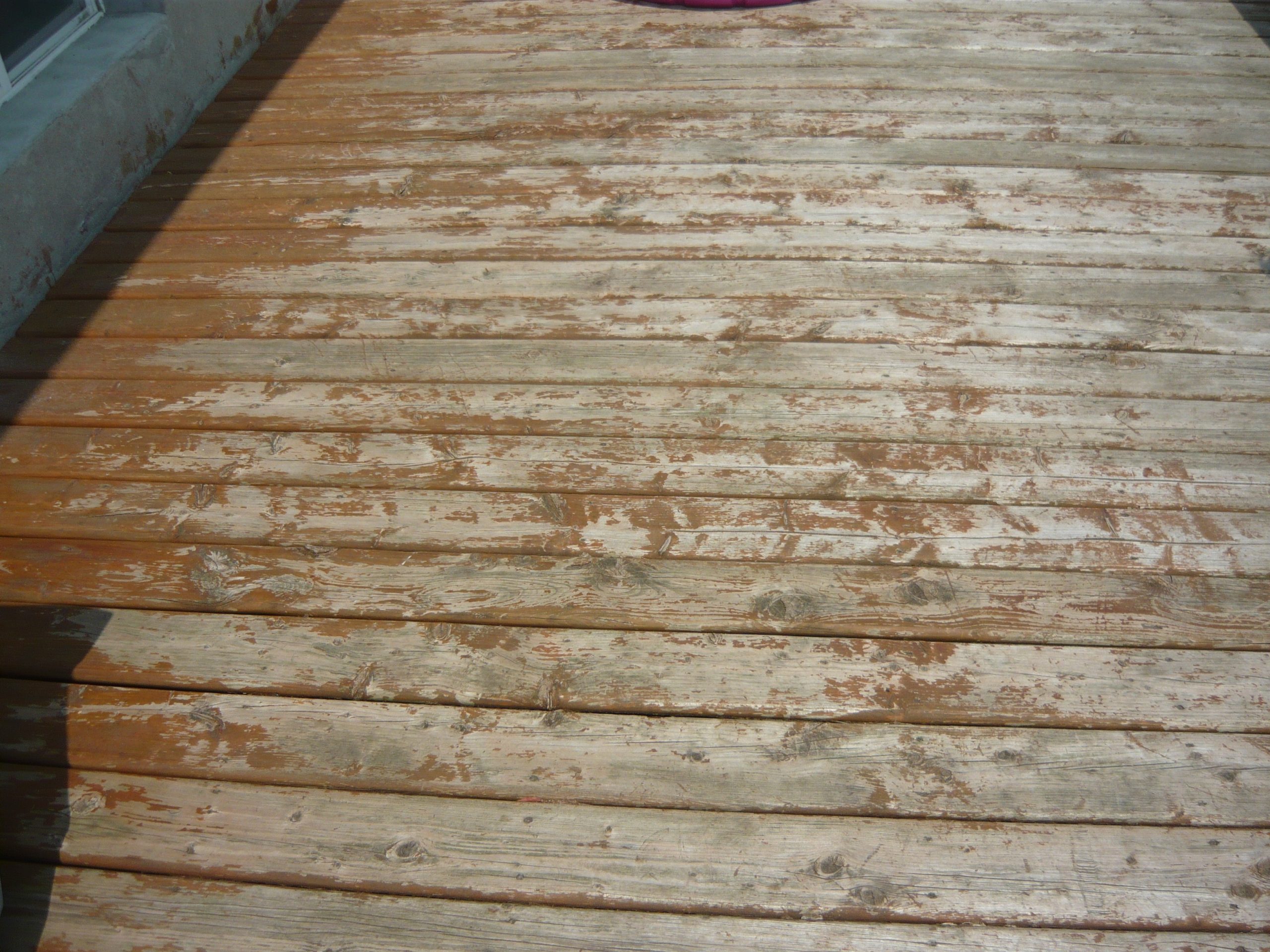

I used Olympic Maximum Semi Transparent Cedartone on our 600-700 sq. ft. PT deck 2 years ago. This is a good time to submit a review as I've had some experience with it and done tons of research on this (excellent) website. While I no longer see this product in my local Lowes (it appears they are now calling their product "Elite"), I do see it still for sale online. So, I want to let others know about my experience before they consider this product. Hopefully the Elite will do better.
For the most part, it applied with little problems. I used a pad for the deck boards and brush for other sections. Despite my best efforts, the stain pad did leave several overlapping marks that were impossible to mask. Pretty frustrating. Like others who have posted, I was not happy with the color (more "orangey" than shown on the sample at Lowes). But the worst part was the peeling. If I recall correctly it started peeling in parts within 6-9 months. Now it's possible that I didn't prep it perfectly (I used Olympic Deck Cleaner with a pressure washer and let it dry for a few days). It did not require any stripping as outside of a clear protectant a year earlier (soon after it was built), I had not stained it. I did not bother using a brightener either.
I put up with the peeling for another year and a half and finally began considering stripping and starting over. By this point, it had peeled in several other spots and I started seeing some cracking in the deck boards. Not sure if this is b/c the stain had not done it's job or not. It does get a good amount of sun. I visited Lowes and they confirmed that the product had not performed so well. I filed a warranty claim with Olympic and sent them pictures of the peeling. They refunded me my $ for the 2 gallons I had bought. Too bad they can't refund the time I spent!
I recently began stripping and brightening the deck (Restore a Deck products). For the most part, the stain came off (pressure washer). However, there are still some areas where I'm going to have to sand. Will be using something better this time around (Defy Extreme…prefer the water base). I would say if you have a small deck, small budget, prep it properly, and don't mind possibly redoing it in a year or two, go for this product or their Elite. However, I suggest spending a little more $ and going with something better from this site (TWP, Defy, etc.).

Six year warranty, I don't think so. Pealing and flaking less than one year later. Deck prepared prior to application.
Same issue last year and received free replacement, same product. Applied again and same issue. Don't use this product.

Jason, oil based stains penetrate into the wood. Water based Olympic films on top of the wood.
Sandi, the water based version is not the same and cannot be applied on top of the old Olympic oil based version.

Bill, hard to say what the issue was. It could be poor prep, improper application, or just the stain in general. You need to strip it all off now and start over with a better stain that soaks deep into the wood instead of lying on top of the wood like the Olympic has a tendency to so.
Same thing happened for me, Bill.
We had the same experience. Our huge massive deck system including pickets and railings are all pealing. It looked great when we applied the product after cleaning the deck as instructed. In places under extended roof overhangs where the deck is not so exposed to the elements, the Olympic Maximum stain and sealant in one is not peeling but the more exposed areas are peeling in a mere 6 months. This was a huge undertaking to stain the deck and now it is all for nothing. We are left with a huge mess. We purchased the product based upon the salesperson's performance claims about the product and the stain can label claims. I think Lowes and Olympic have a greater responsibility to those who used such a faulty product and should not at this point be limited to the cost of the stain. What can we do as consumers to get satisfactory compensation for the issues Olympic's product has caused?
Used the Cedar Naturaltone this past weekend and hate it Hate it HATE IT. Very uneven coverage but what's really awful is the color- think the color of puked up carrot puree. It's super orange, not even close to the pressure treated sample in the store. Very likely we're going to have to strip and start over. I wish I could sue Olympic right now. I did not spent a whole day stripping and brightening my deck to put this orange mess on it.
I actually loved this color on my pine siding and so does everyone who saw it! Matter of taste I guess. My question though would be at what point did you LOOK at the color you were applying? Every paint or stain I have ever used says to test on inconspicuous area first. Should have stopped after the first few brush strokes. Just sayin….
We bought the Sierra stain, and it is just as bad. The coating is so completely on the even that it is an embarrassment. I just spent $6000 to have this deck belt, and don't even want anyone to see it. I agree, would like to sue Olympus for this one. Don't have the time or money to continue to try to fix it! Disgusted!!!!!!
Last October, we built a new 350sq. ft. redwood deck in Southern CA. It's been about 6months now. I've stained it twice so far with Olympic Redwood Tone. It looked great for the first couple of weeks but now, after one brutal (ha ha) San Diego winter, the wood looks terrible. The color is gone and overlaps in the application are more evident than before. Not at all happy with this product. Will likely sand it all off and start over with an oil based sealant.
Scott, I would look at Armstrong Clark or TWP 1500 for CA.
My contractor stained the new decking he had constructed blue with this water-based product without asking me. Could I just paint a darker coat of stain over it, or would it have to be removed first?
May, remove it first.
