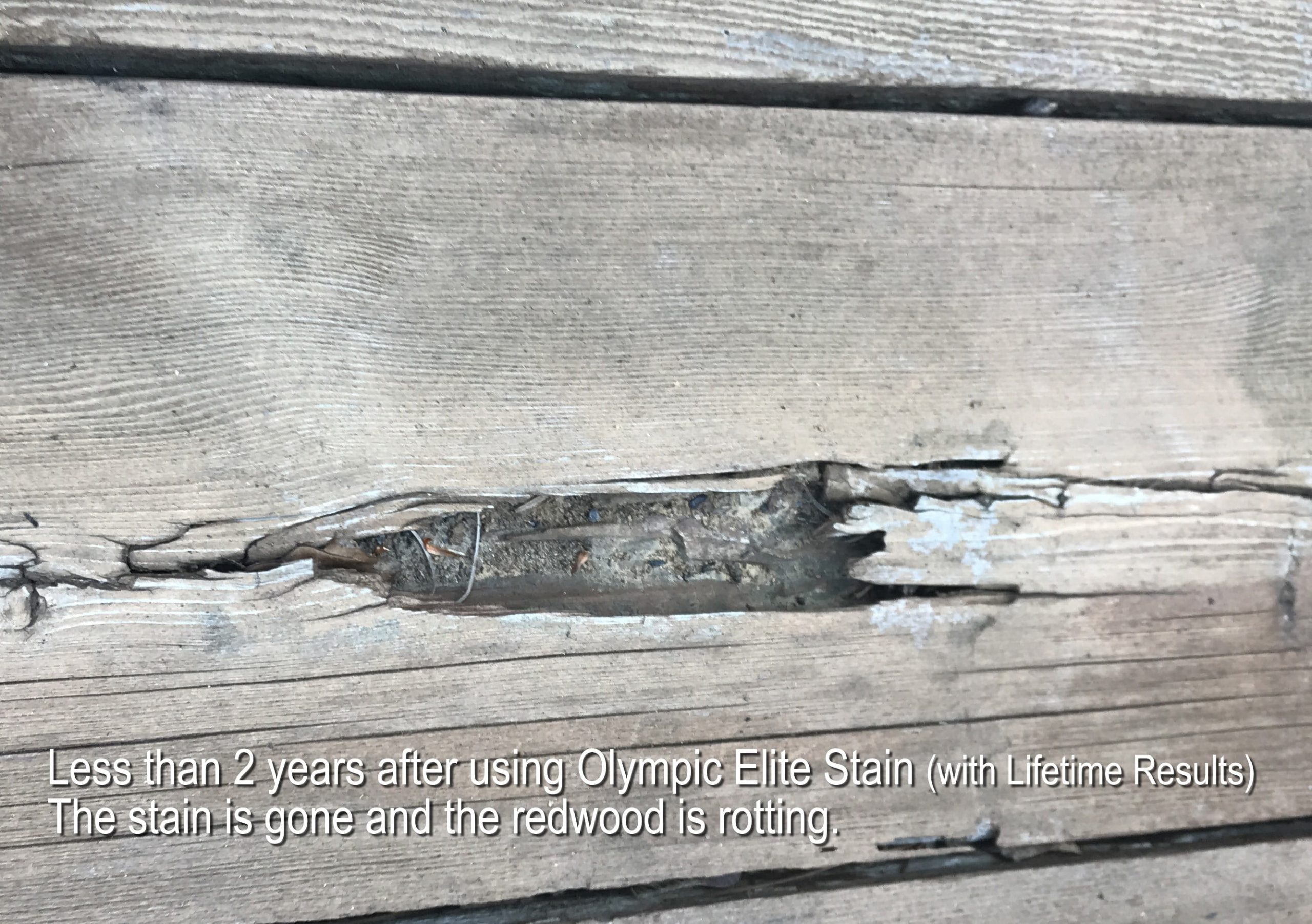

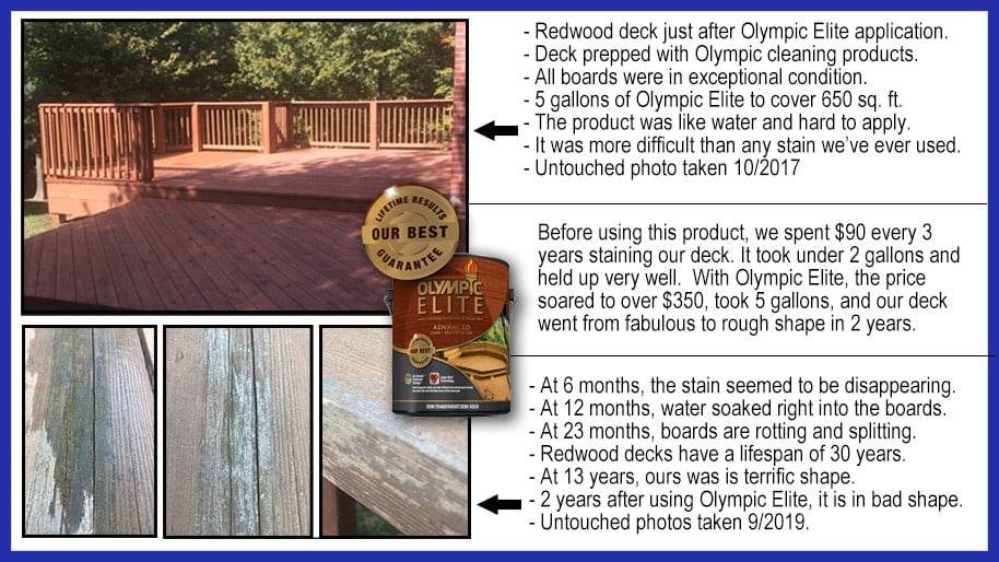

Update on this post: A PPG rep just called me back and said, “We don’t think the stain penetrated the wood and that was your problem”. I explained that I prepped the deck extremely well and it soaked up 5 gallons of the stuff. She offered to refund my purchase price. I asked her to talk to her manager, price out about ten 16 foot Redwood planks that need replacing because of this products failure, and have her manager call me back tomorrow. I’ll update again as I hear back. I really don’t think the way they market this product is fair or even legal. I think it’s more than just advertising puffery. I believe it goes way beyond that when they claim on the label it’s their best elite product with a lifetime warranty. It failed miserably after less than a year. Judging from the threads below and numerous others I’ve found it seems obvious that I’m not the only one having this issue. We used Olympic Elite Advanced Semi-Transparent Stain and Sealer on a very nice redwood deck in Oct. 2017. PPG shows a “Lifetime Results Guarantee” right on the can. The price was much higher than any stain we’ve used before. It required nearly 4 times as much stain. It wore off in less than a year (less expensive stains lasted 3 times longer), and in less than 2 years our redwood deck went from a really nice deck to several boards rotting. We are waiting to hear PPG’s response. Even if they do refund our money, it doesn’t account for the damage done by what I consider deceptive advertising claims and an incredibly inferior product. I’m convinced our deck would be in much better shape if we wouldn’t have used anything at all versus this product. How can PPG get away with this? They are advertising a lifetime warranty and guaranteeing this is their best “Elite” product when they surely must know their cheaper 3 and 4 year products last far longer than this one, cost far less, and actually protect wood instead of ruining it. The deck was scrubbed and prepared very well with Olympic deck cleaner. It was lightly and evenly power washed, allowed to sit for 2 days, then stained while all instructions on the Olympic products were followed. The deck was in exceptional shape before application. The product didn’t even last a year and water was soaking right in. At less than two years, several boards are rotting and splitting and need replacing. Redwood decks are tough and rated for 30 years. Ours isn’t even half that old. Several of our exposed boards went from perfect to poor in less than two years after using this product. The stain went on like water and required over 4 times more stain than we ever used before. It seemed to soak past the top layer of the wood, then wore off the surface within a few months. So because of this product, I think… Read more »

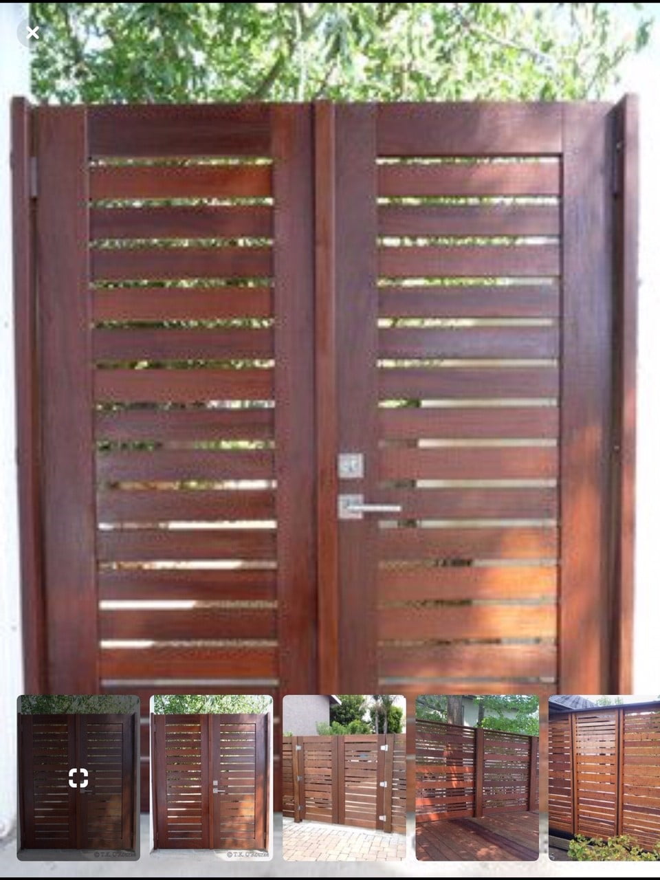

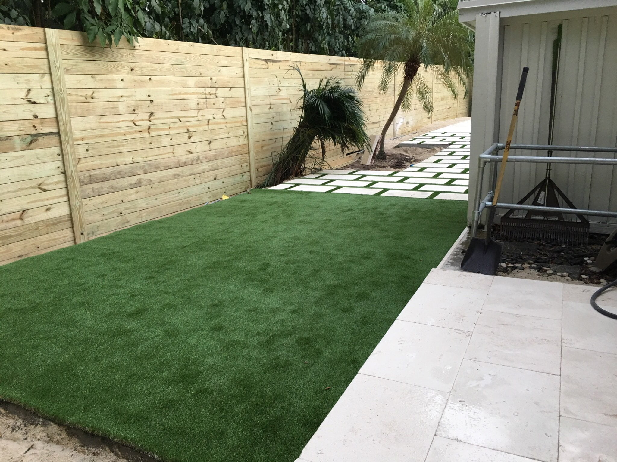

How is this PPG stain different than the Olympic Elite Woodland Oil Stain? I live in Miami and trying to decide what to put on a brand new, pressure treated pine fence (see photo). I would like a warm cedar color (see photo). What color and type do you think I should choose: Olympic Transparent Woodland Oil, Olympic Semi-Transparent, PPG Transparent or Semi? are stains with Acrylic to be avoided?
