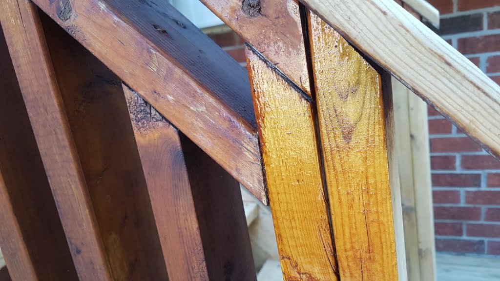

I moved into a house with a deck and I wanted to restain it. The old home owner left me the old can. I also purchased more cans of the same stain. When I applied the stain it looks like a completely different stain. Do you have any suggestions what may have happened?

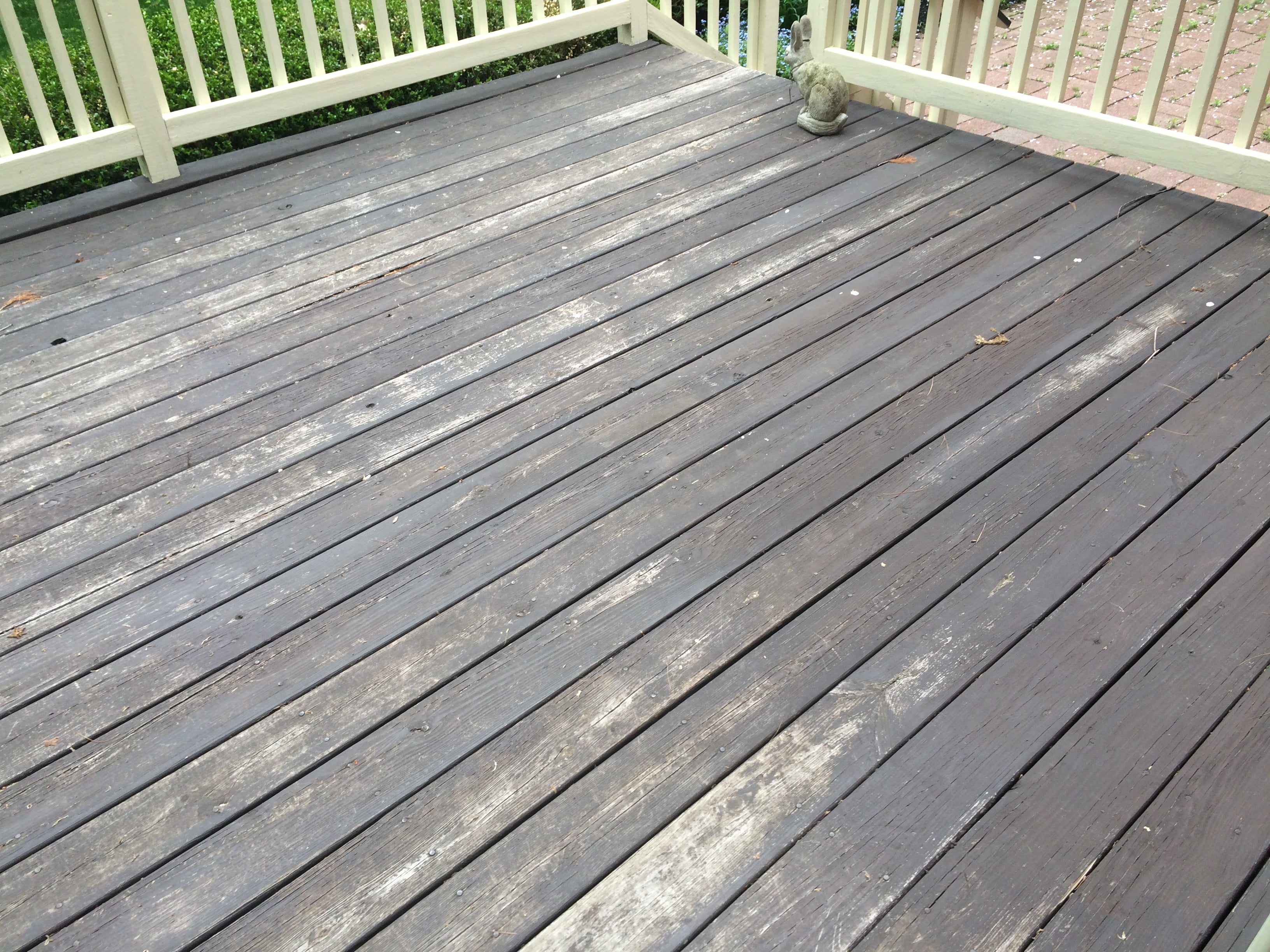

Deck location state: MA
Full sun for part of the day
Pressure treated wood (not sure what type of wood)
No mold/mildew issues
Reason for previous stain failure: N/A
Previous coating: Cabot Oil-base Semi-Transparent Deck and Siding Stain
I plan on re-staining this deck (floor only; I did the fencing last year) with the same Cabot stain (in same color). Condition of the old stain shown in attached photo. Do you think I need to sand before staining, or will cleaning/brightening be enough?
Thanks in advance for your advice.

Thanks for the reply. Was this change in formula for VOC compliance, or has Cabot made another change, and do you have some idea of when they did so? I used the Cabot low VOC stain (16300 series) the last time (four years ago, if memory serves), and the stuff that I see available now has exactly the same can/labeling, etc. If it’s the same stuff, I’ll use it, but if not, I’ll re-evaluate which stain to use, since I’ll have to sand.
Stuart Munro
Stuart Munro
Okay, I’ll go with that and just clean before application. Thanks again for your help.
