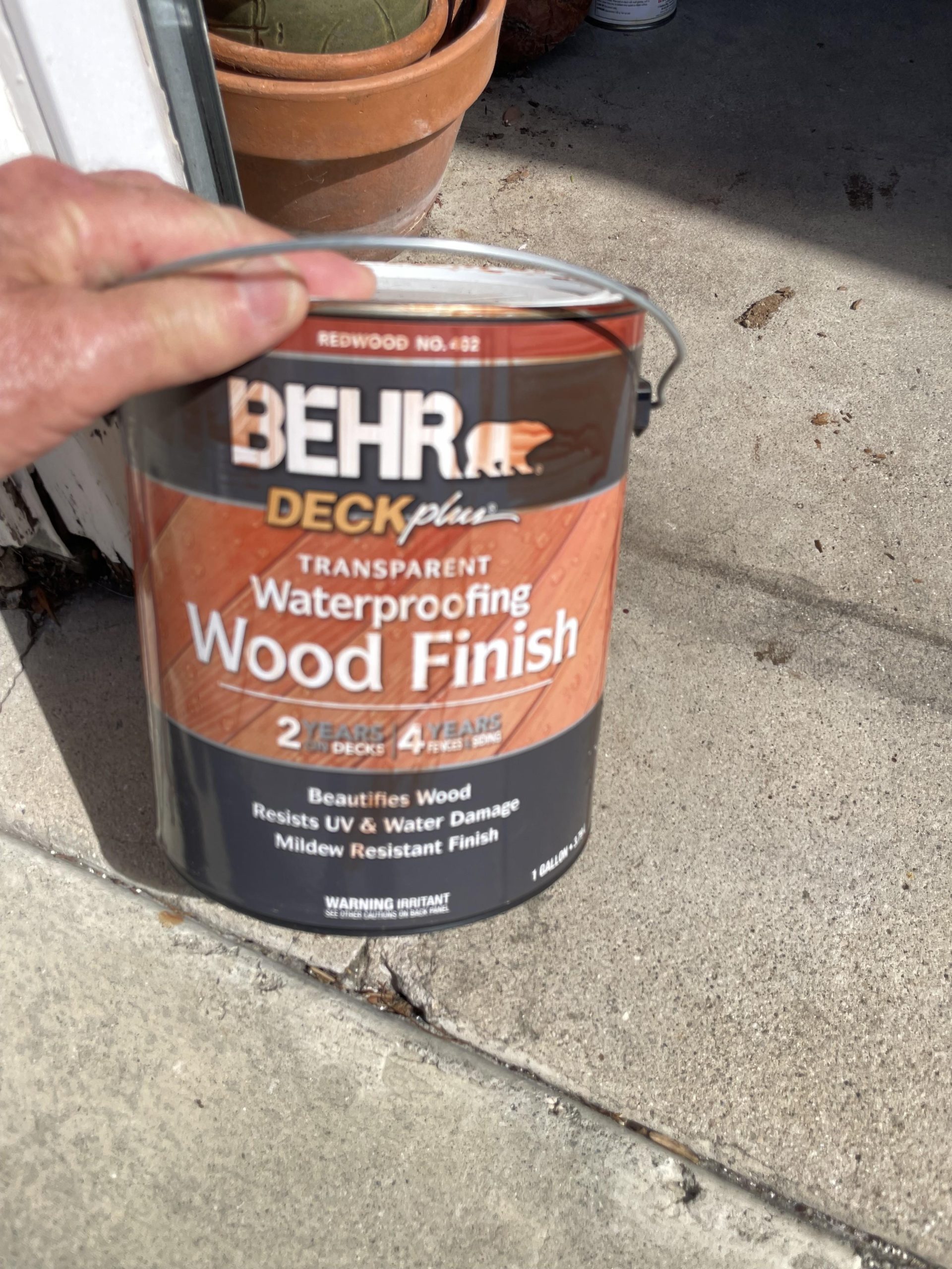

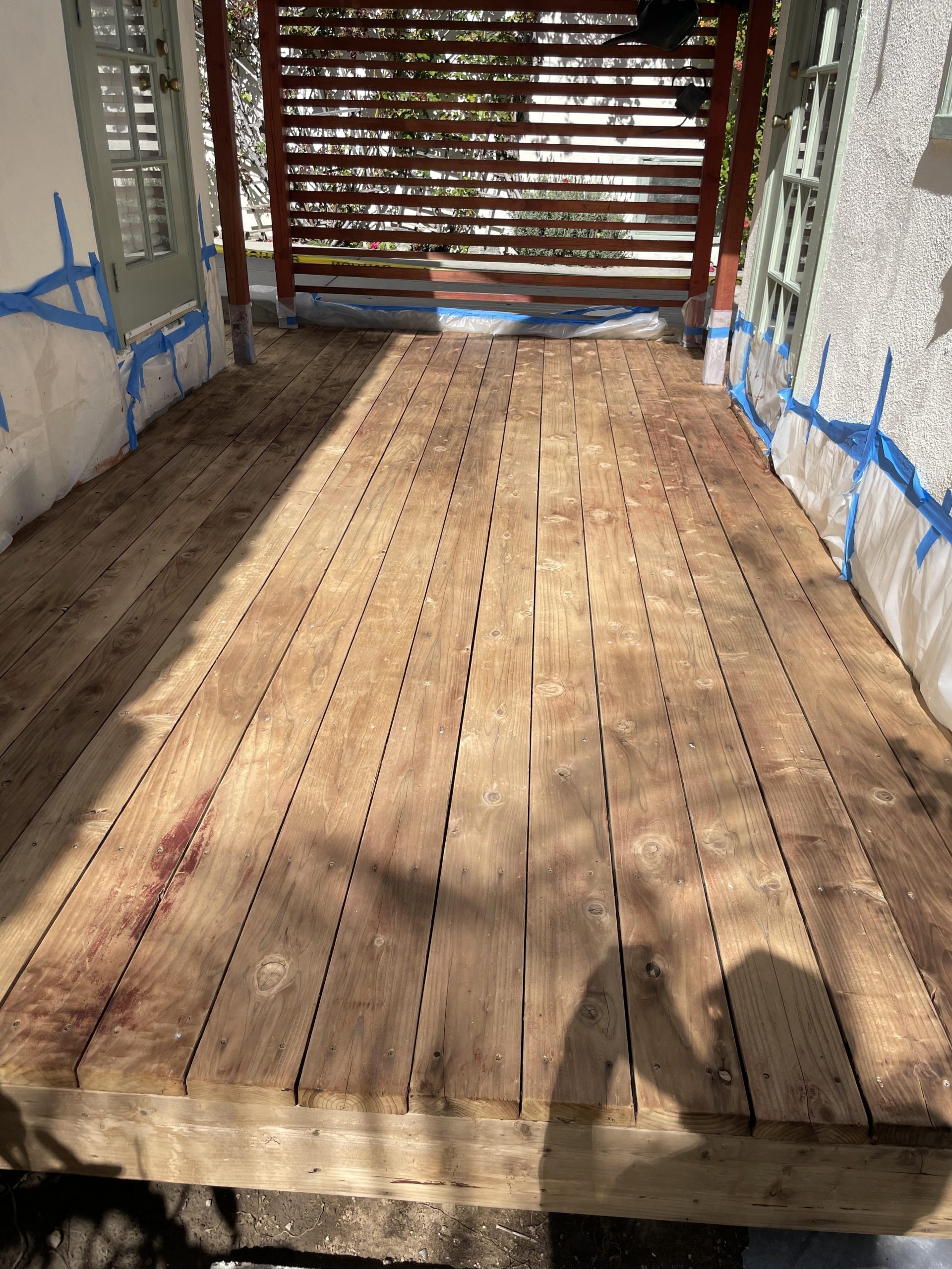

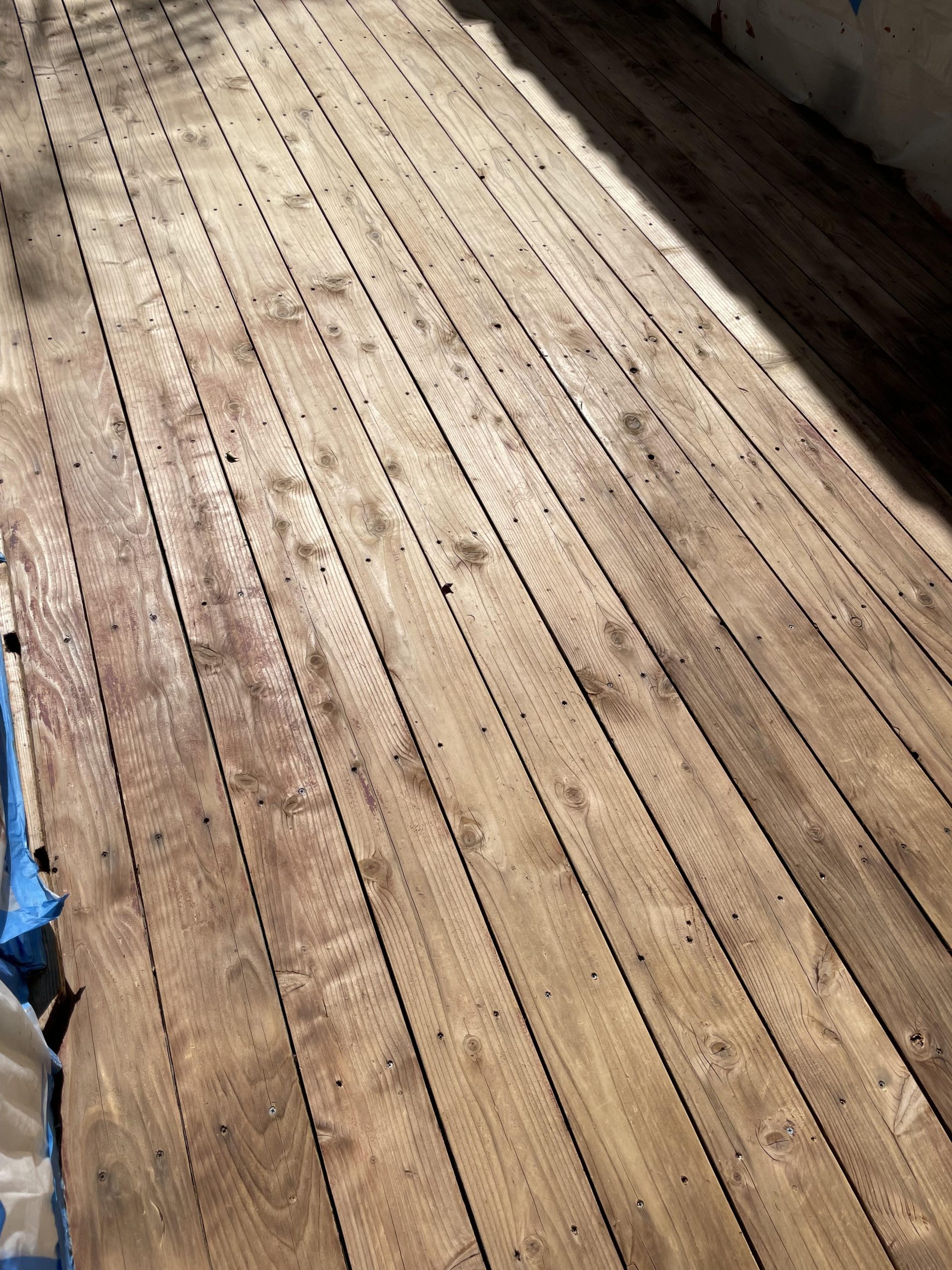

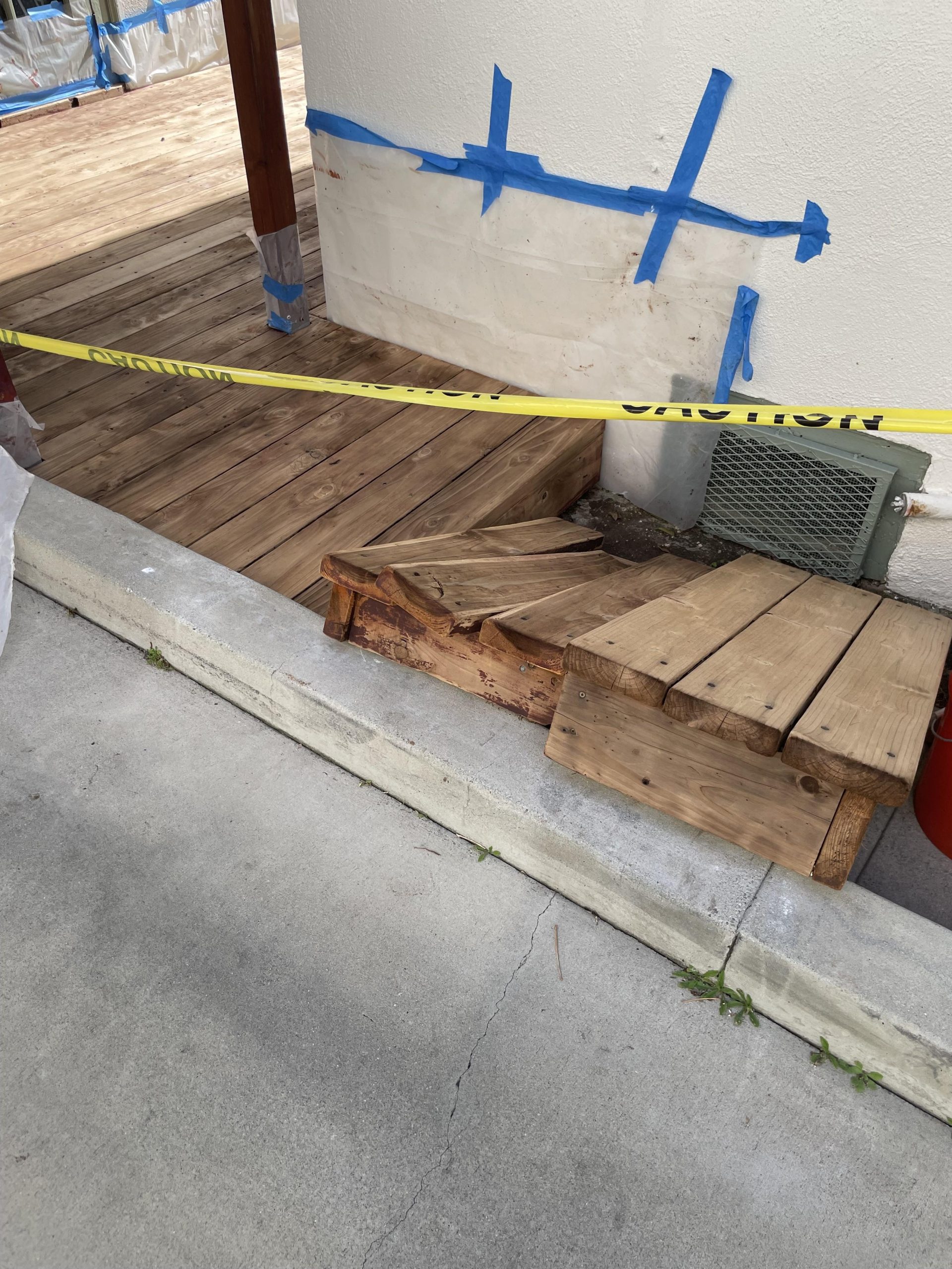

I have stained and stripped my redwood deck several times in its 26 year life so far. This year I can’t get the stain removed. I applied Behr stripper five times using six gallons of their stripper. Then I read Woodrich would take off layers of old stain. I applied it twice, scrubbing and scraping and there’s still stain on the deck.
I’m about to rent a six inch hand held belt sander to get it off. Once I do, I don’t know what to do next for I don’t want to sand my deck every four or five years.
Post pics of the deck, and what stain brand did you use last time?
If you zoom in you can see red stain on every board. Behr semi transparent stain was applied twice, it was too much and looked bad after it finally dried. Should have immediately taken it off back in October 2021.
90% or more is off. You can sand the rest, or you can try stripping with the RAD Paint Stripper. You can spot apply this as needed. Make sure to pressure wash (not just scrub) to get it off.
Also, neutralize all wood with a wood brightener when finished.

I am just completing our redwood deck. I want to seal the deck, but not necessarily stain the deck. I have used sealers on other projects in the past that left an oily residue and collected a tremendous amount of dirt (I want to avoid that on this deck). Eventually I ended up putting a clear urethane sealer over it that seemed to work well but I wasn't sure if that was the proper product for a redwood deck. Any insight would be appreciated.
Putting a urethane on a deck is a bad idea. It will peel, trap mold, and blister. It will also be very hard to remove as strippers will not take it off. You will need to sand it off. In addition a clear product will offer zero Uv protection from graying. You must have a tint/stain for this.
