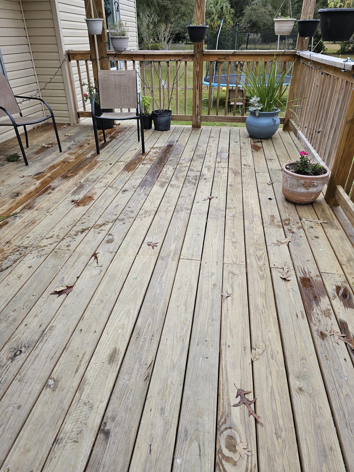

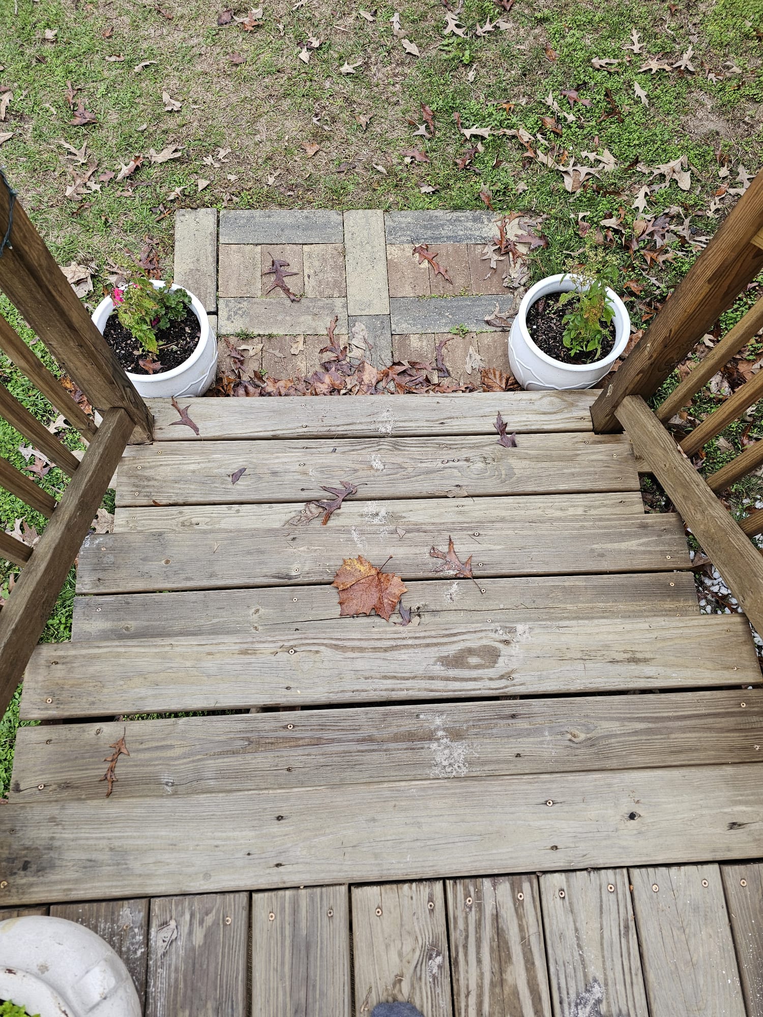

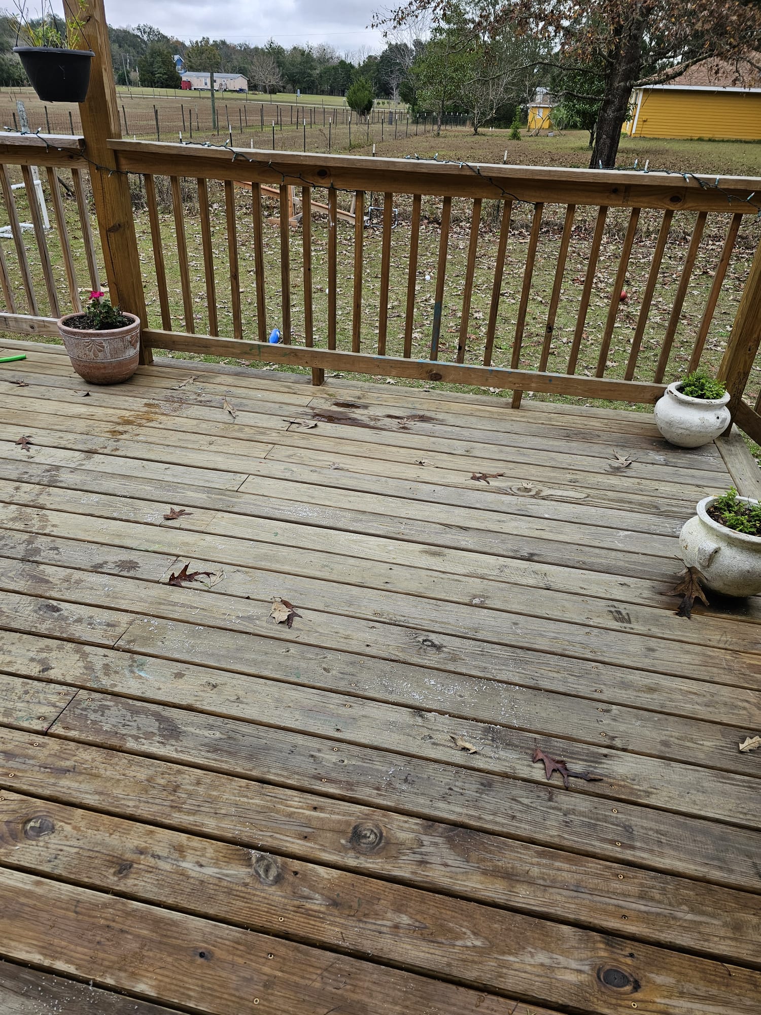

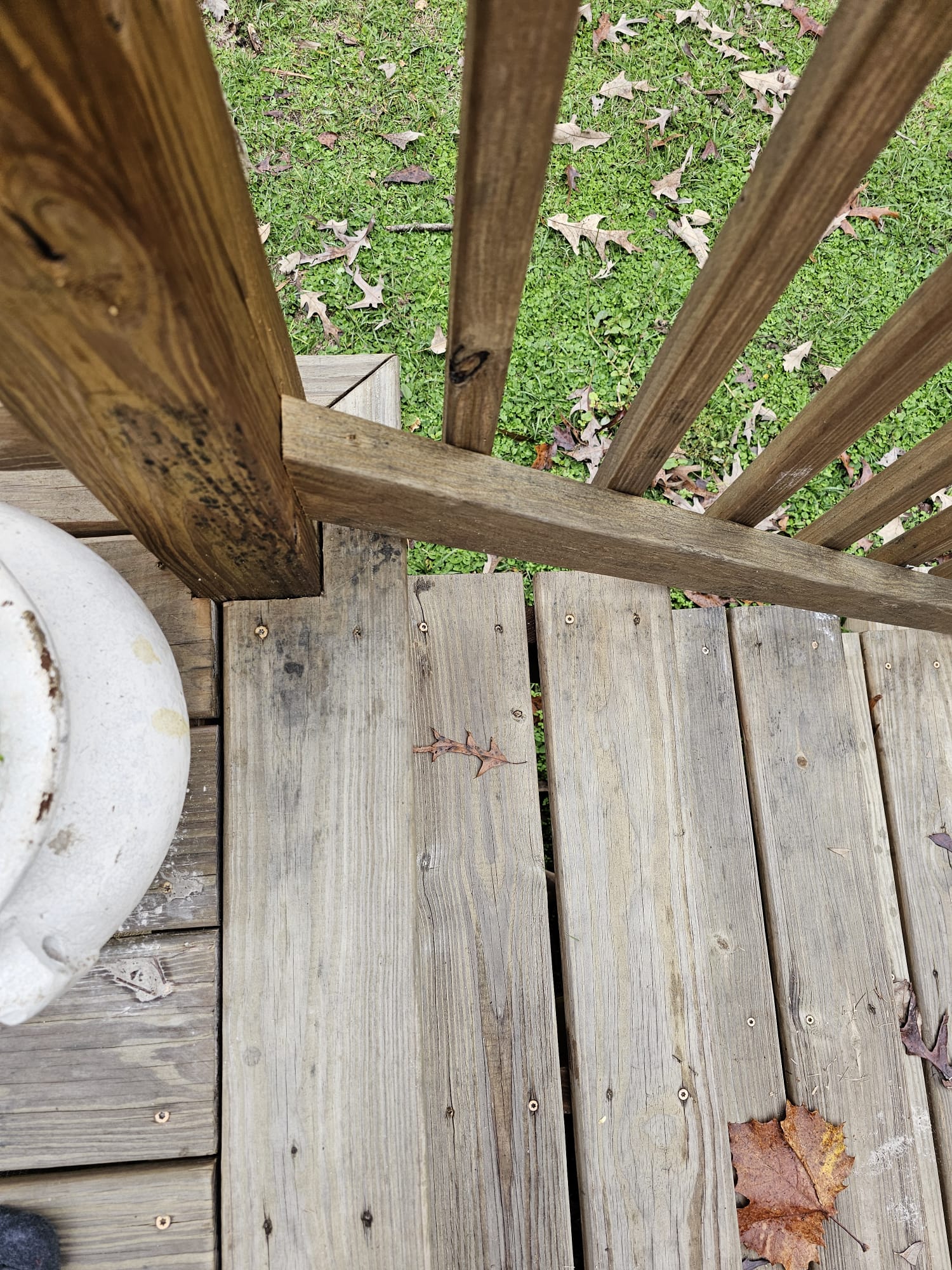

Hello. I am in north/central Florida, I had an 180 sqft deck built about a year and a half ago. I sealed it with oil based Olympic Maximum clear sealer about 6 months ago, never used any kind of stain, just clear sealer. Now it’s looking gray and dull, theres is also some mold/mildew on some spots. How should I prep it for staining?
I’m not sure what product I’m going to apply once its prepped yet, i have to decide wether i want to use solid stain or semi transparent. What will require less prep work? And maintenance in the future. Thanks so much.
Strip and brighten for prep using the Restore A Deck kits. Best is to stain with a semi-transparent penetrating stain:
