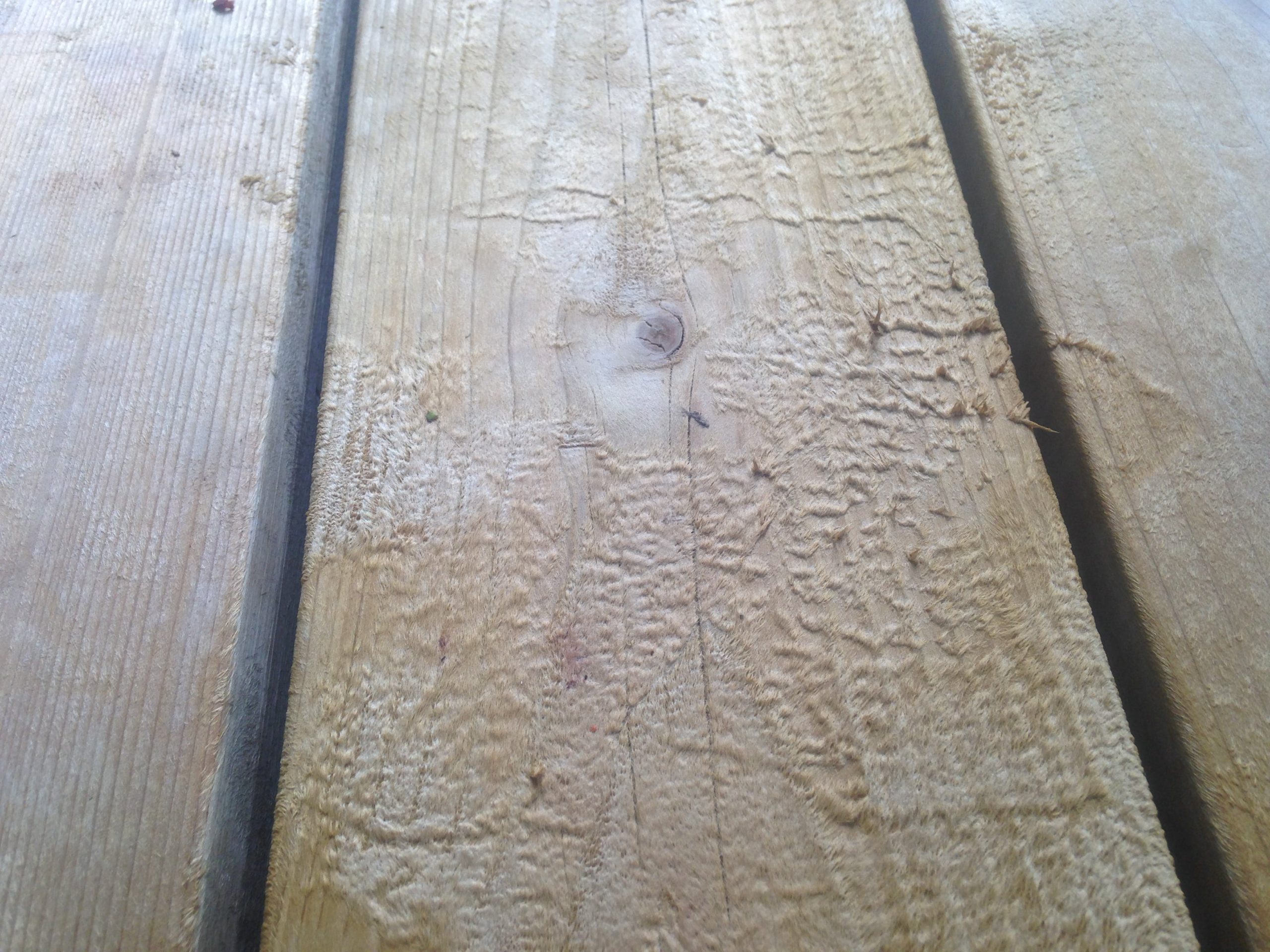

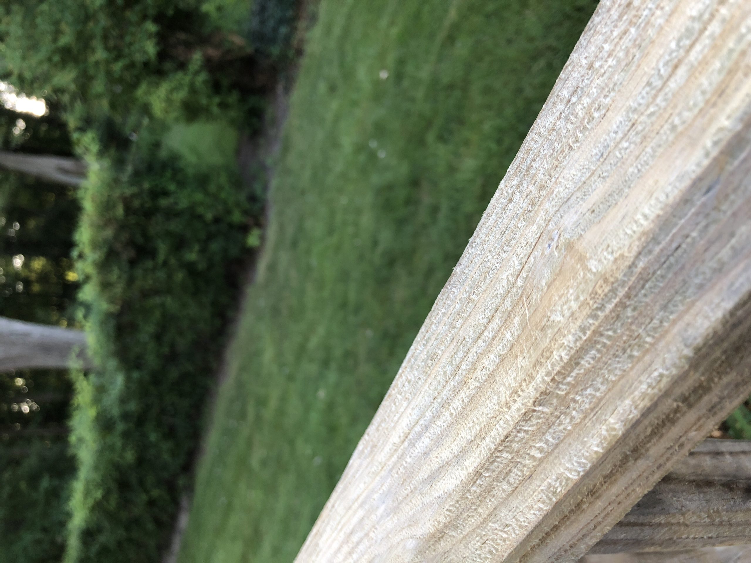

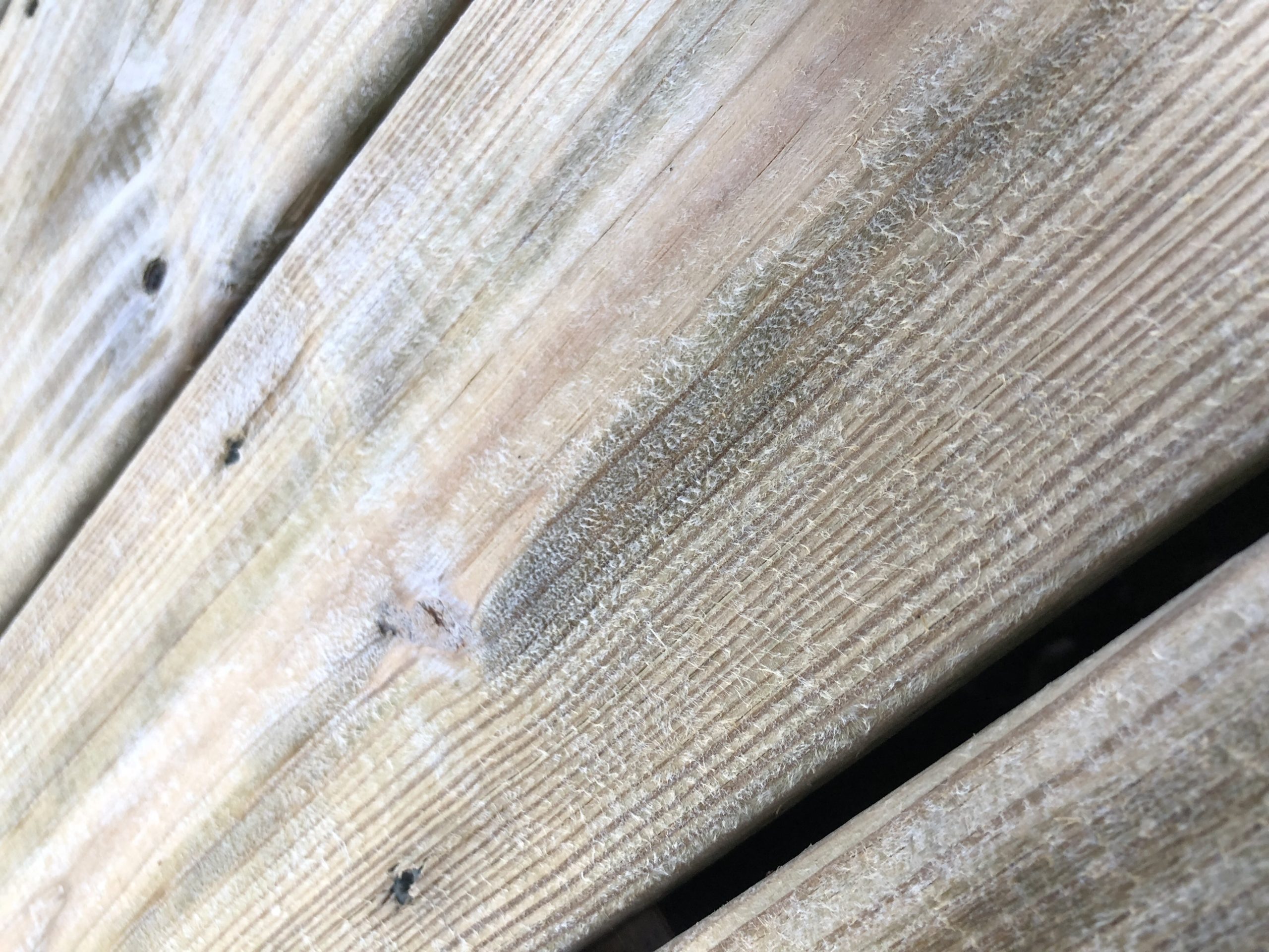

I used an oil based clear sealer about 4 years ago. I bought your complete kit, pressure washed the deck which removed the majority of the old finish and left a light residual coating. I used your stripper twice on one board to test and all it did was trun the old sealer to a gummy mess that even the pressure washer won’t budge. I applied stripper again, let it sit for 30 minutes, scrubbed with a fairly stiff nylon brush. again it turned to a gummy mess that the brush would move around but it can’t be washed off.
Please post a picture of the board you are having an issue with.
I plan toter this board over and not use stripper in the rest of the deck.
That is raised wood fibers, not old stain. Just sand this board at 60-80 grit to remove the fibers and you will be okay.
Actually it is old sealer. Still gummy from yesterday
Sorry but no it is not. You are seeing wood fibers, not sealer or stain. When the wood is over stripped it will do this to the wood. Sand it and it will be fine.

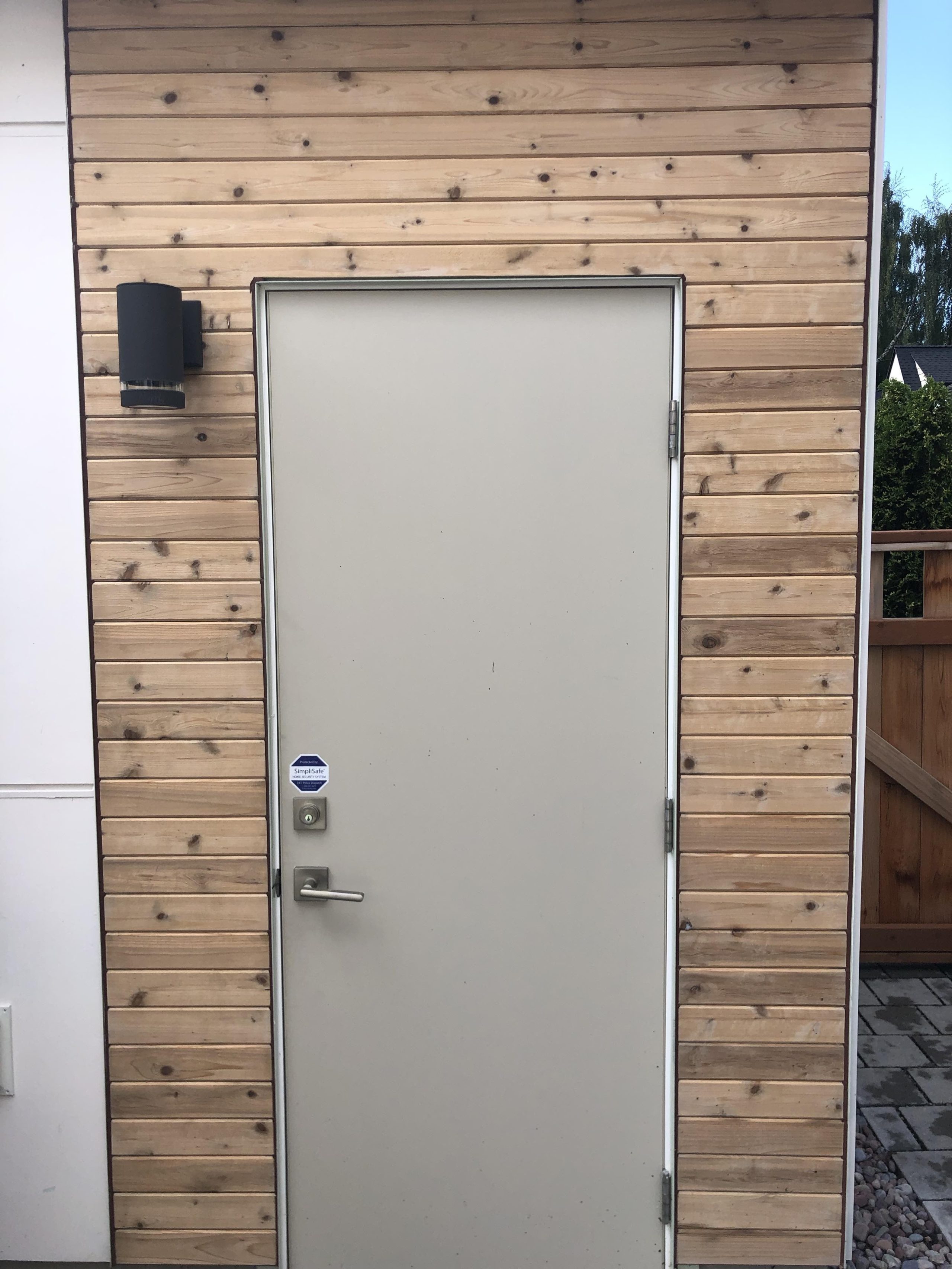

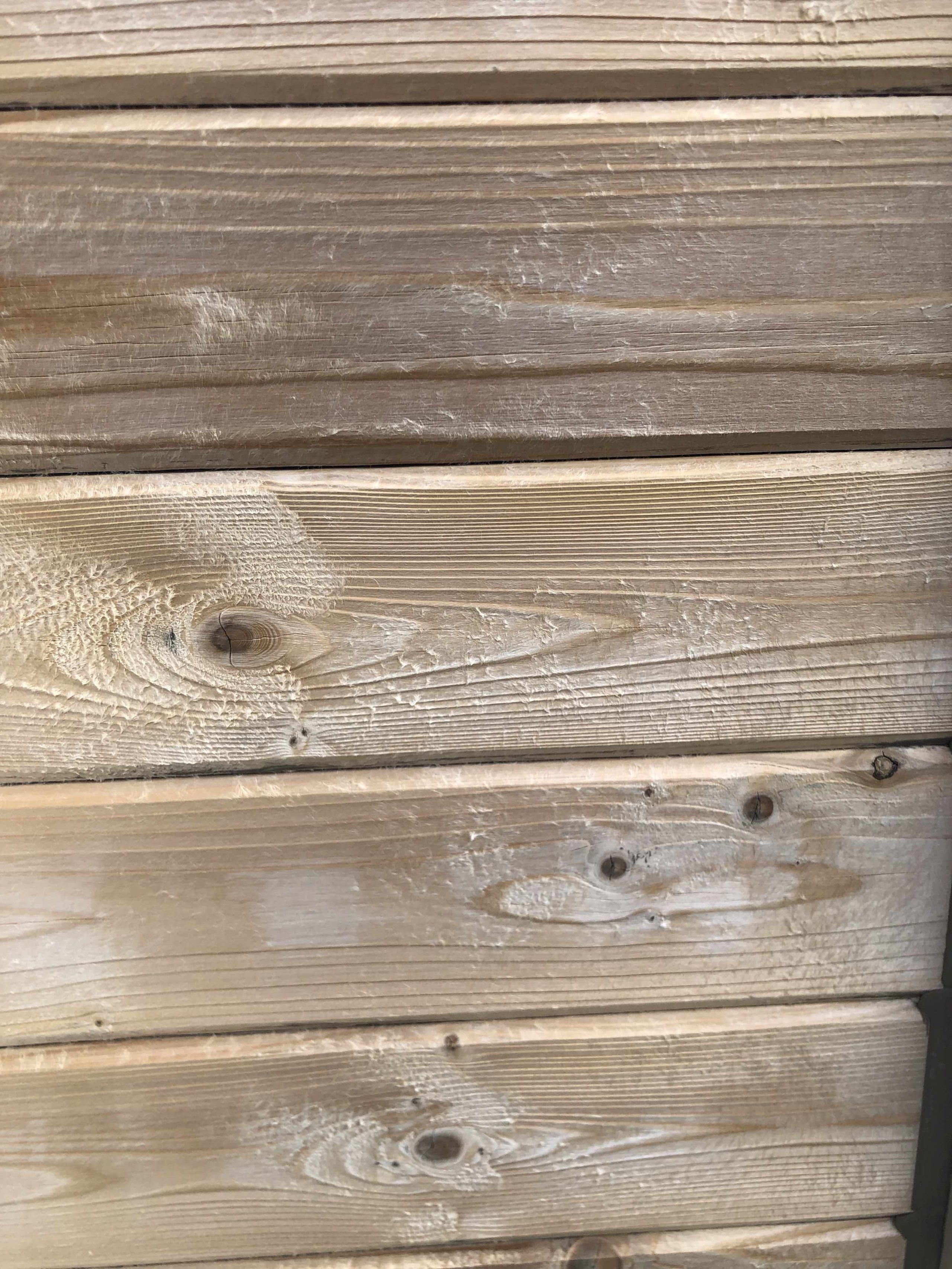

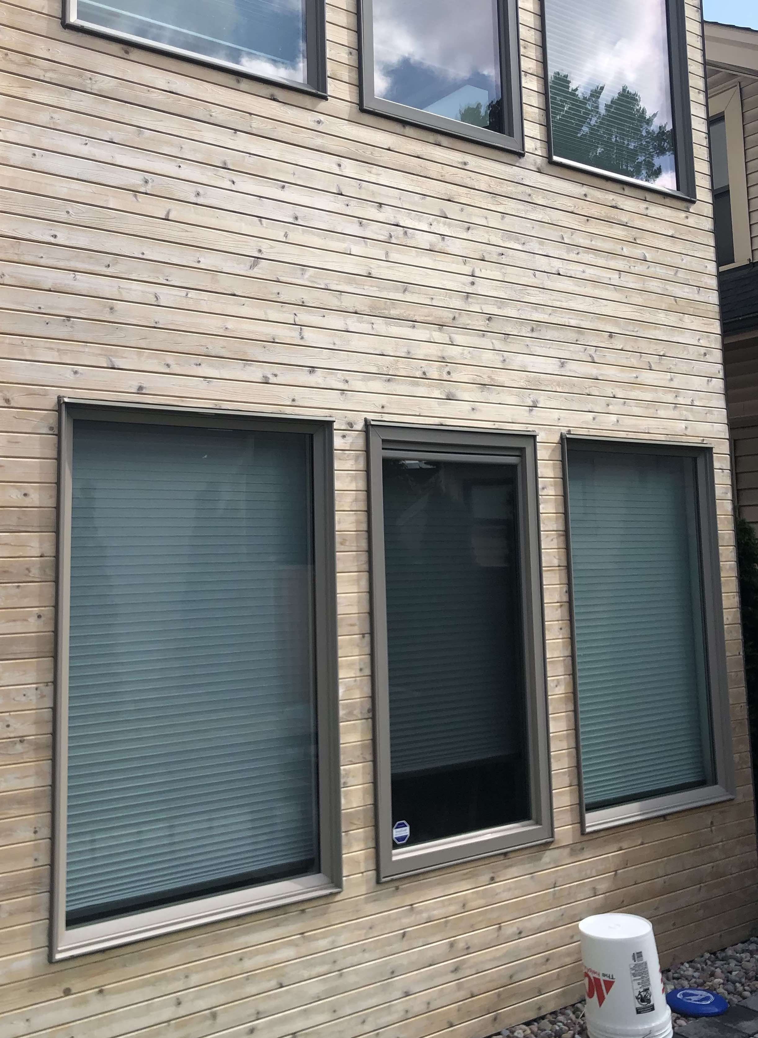

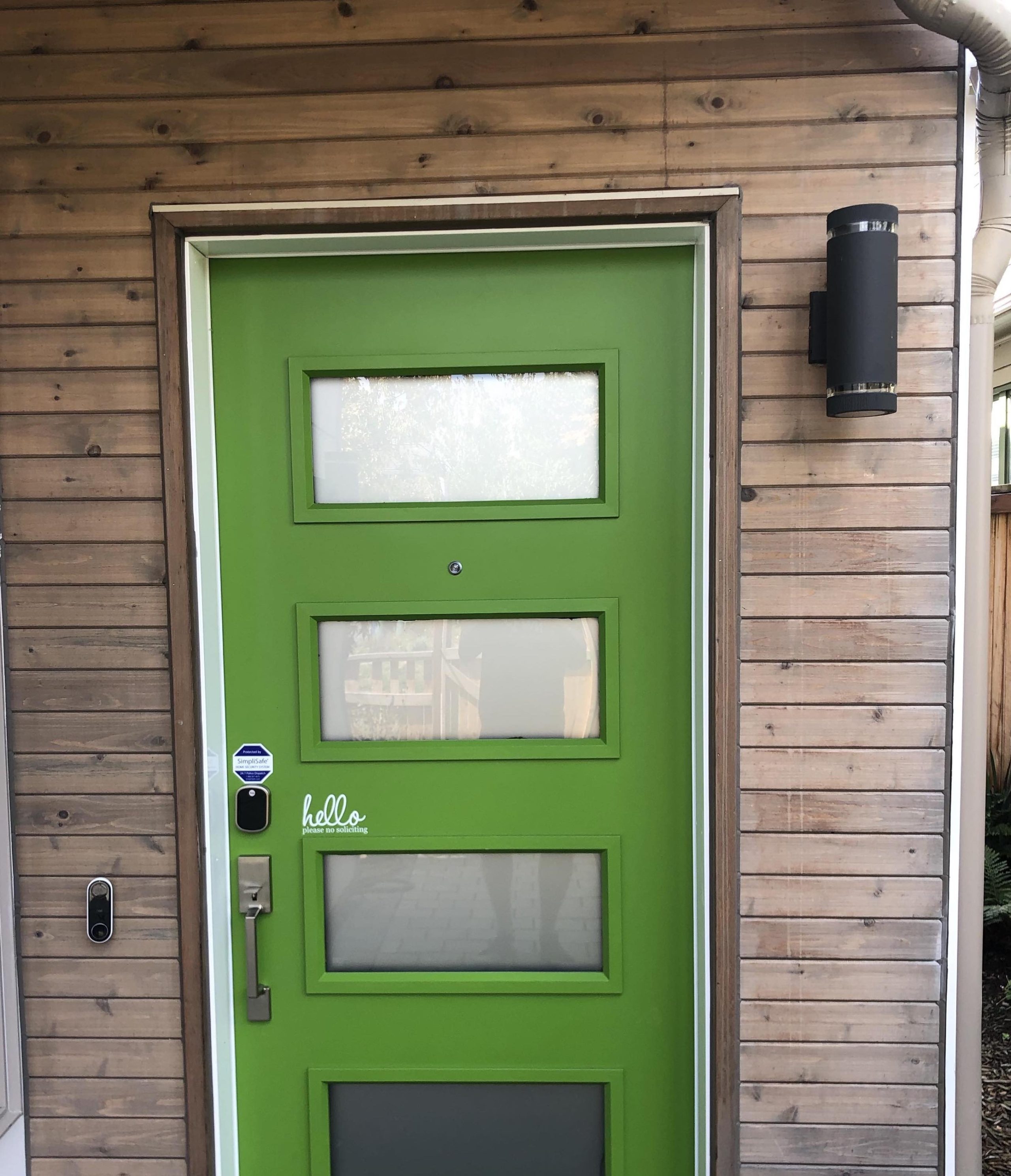

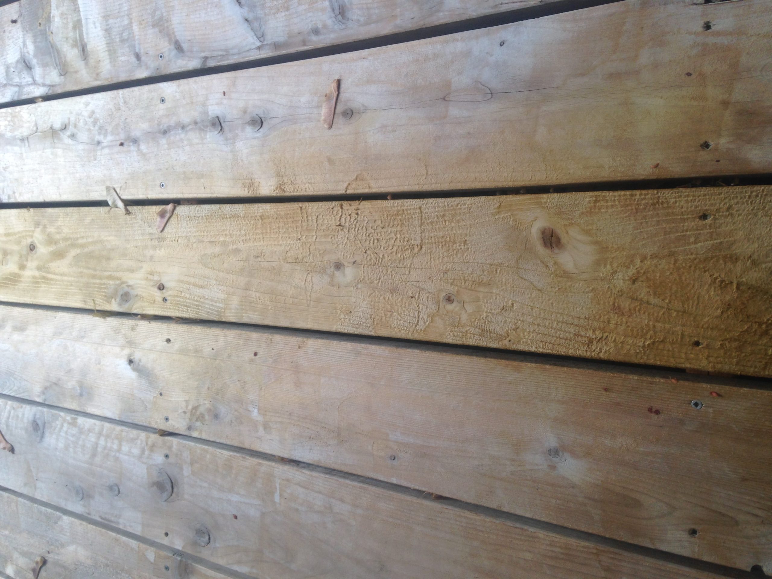

I have the same issue on my cedar siding. When you say that it is ‘over stripped’ does that mean I used too strong a solution when I stripped it? Left it on too long? What can I do to prevent this in the future? I’m only halfway through my project, so I’d like to avoid doing it again.
Post a picture and what stain are you removing. There is not always a way to stop this from happening but maybe you can minimize it.
Here’s a closeup of the cleaned section. The white door picture has been cleaned, the green door picture has not yet been cleaned. I believe the stain was Sherwin Williams SuperDeck. I’ve done a few passes on them. First with straight sodium percarbonate. That left some stain residue, so then I purchased Ben Moore Remove and Restore. They have both been through a full cycle of Sodium Percarbonate, BM Remove, and BM Restore. Thanks for the help!
Actually it looks pretty good. Try using half strength of the stripper and see if that still remove but furs up the wood less.

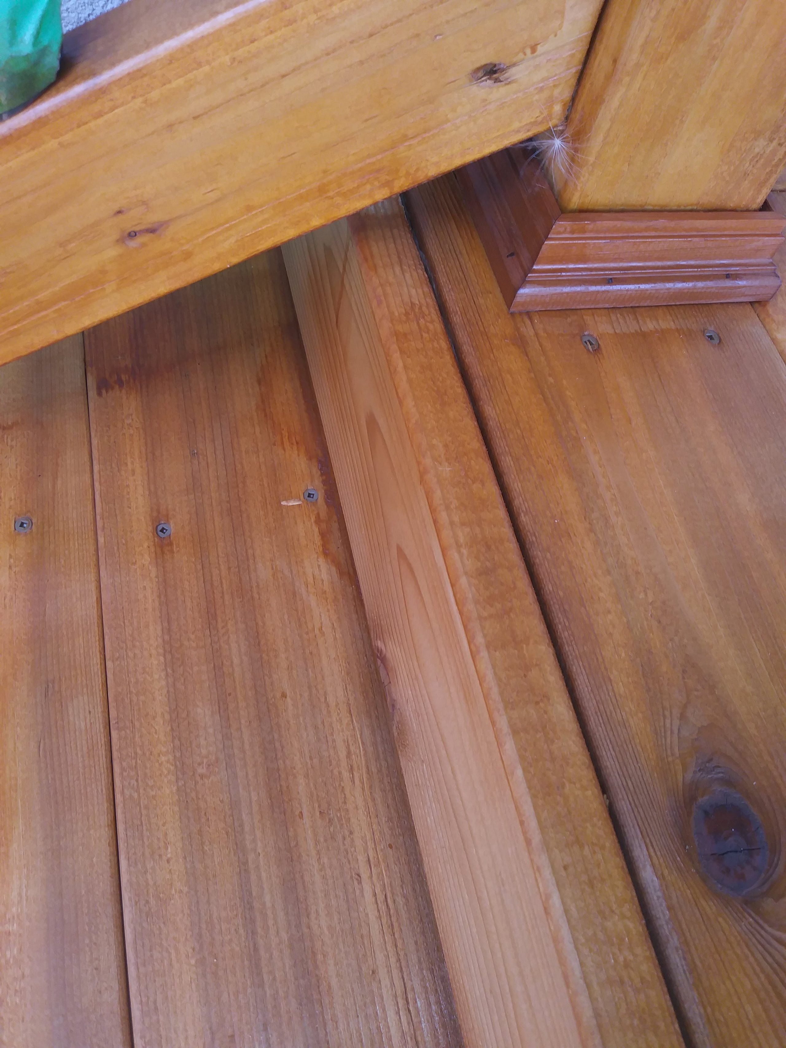

Used the stripper and brightener today. Deck isn’t even dry yet but very happy with how fresh it came out, however now we have a lot of ‘hairs’. Especially on the railing. Do we stain as is or need to sand? Not all of the decking boards have it, or seems concentrated to a few boards… but the top railings are bad.

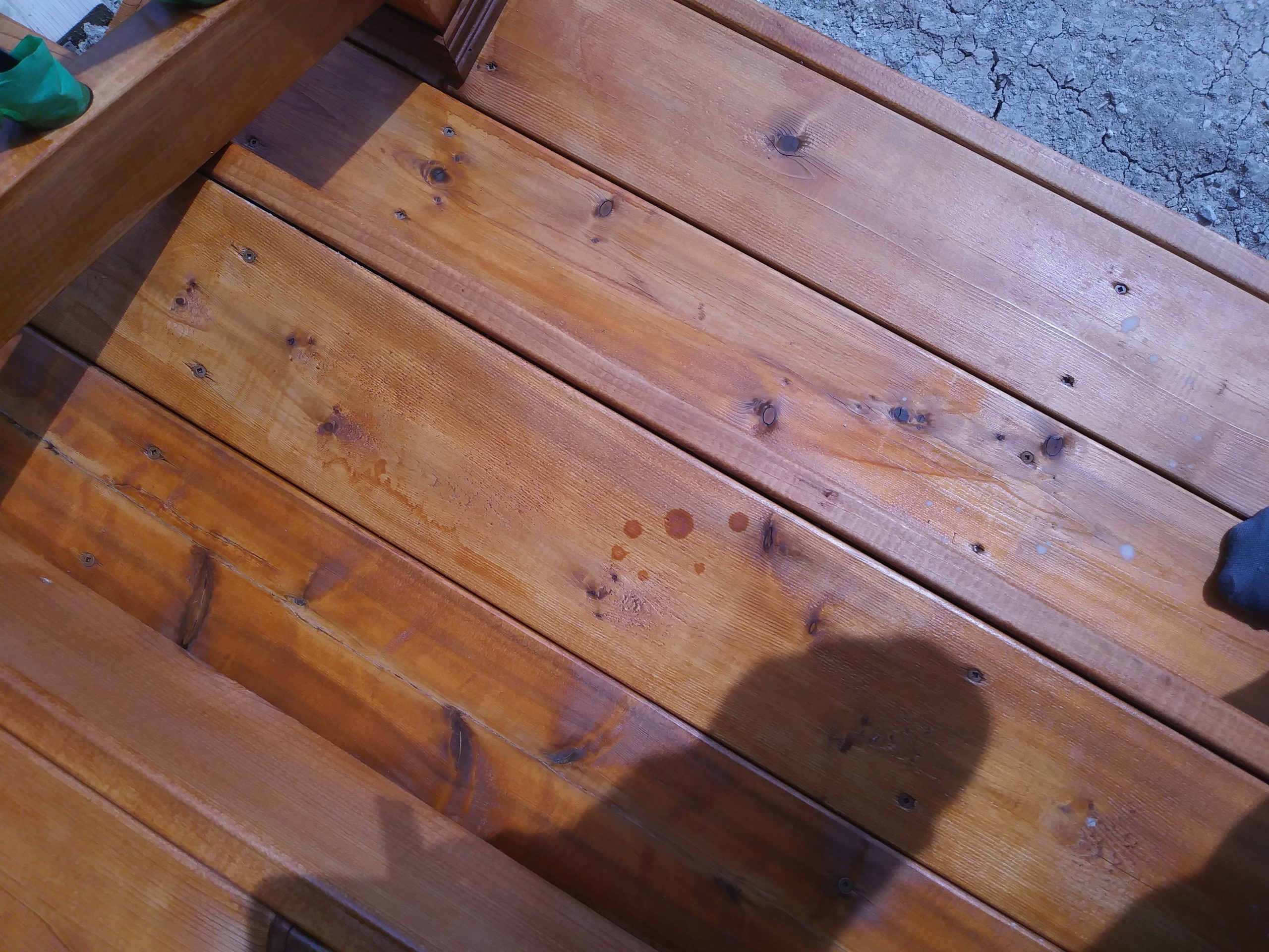

Found few stain droplets fall on the deck while staining. Found out after it dried. What grit sand paper do I sand it off? Do I do it manually or use rotor sander? Some areas applied thicker than others, what do I do. Wait till next year and top up even ?
What stain brand? Post a picture.
TWP 101 cedar stain where i have stain drips

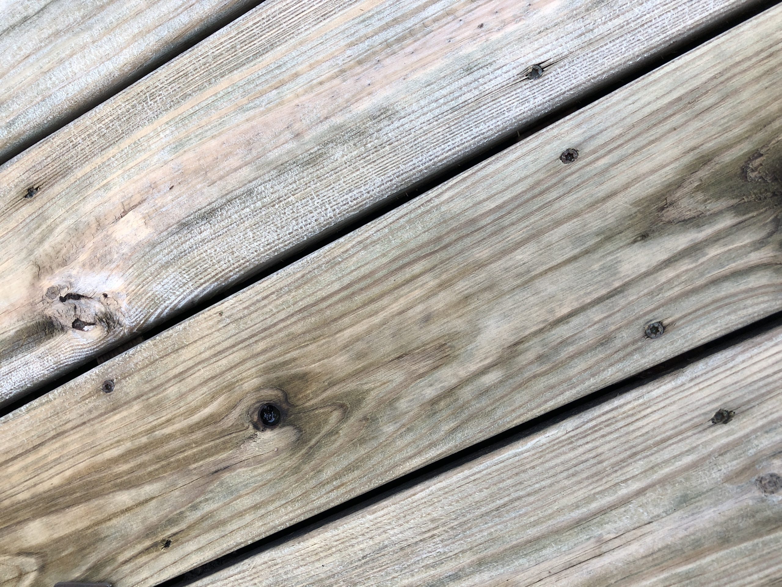

Curious, did you let this new wood weather and did you prep before staining? https://www.deckstainhelp.com/staining-a-new-deck/
For the drips, You cannot spot fix this. Best to redo that entire step. Sand it off and recoat.
Yes it was weathered for about 3 months . Moisture meter showed less than 12 pct . I think the wood was sitting in storage for a while for moisture content to be that low. The wood was cleaned and brightened using Restore Deck cleaner and brighter . What grit sand paper do you recommend ?
80 grit.
Thanks. Based on the picture you don’t think it weathered enough?
Not really. TWP wants 4-12 months. Looks like it may not have soaked in very well since it was only 3months. Not the end of the world though, just clean and reapply a light coat next year if needed.
Was planning on doing another stain next year . Thanks for all your help .

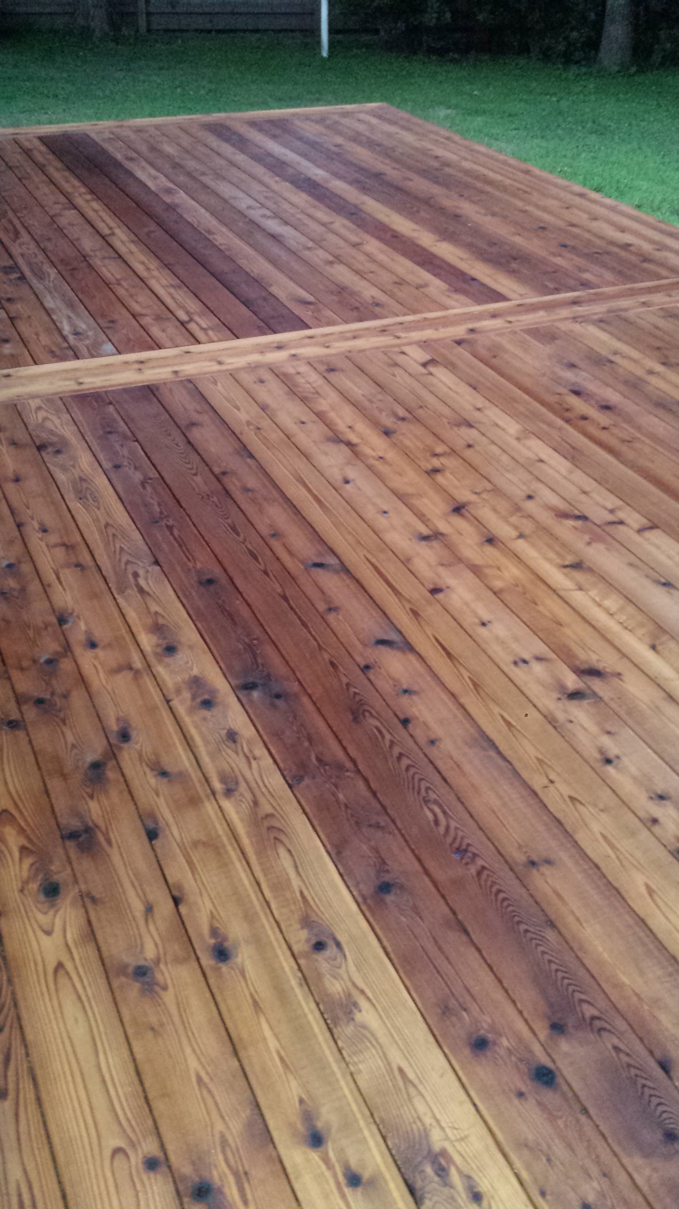

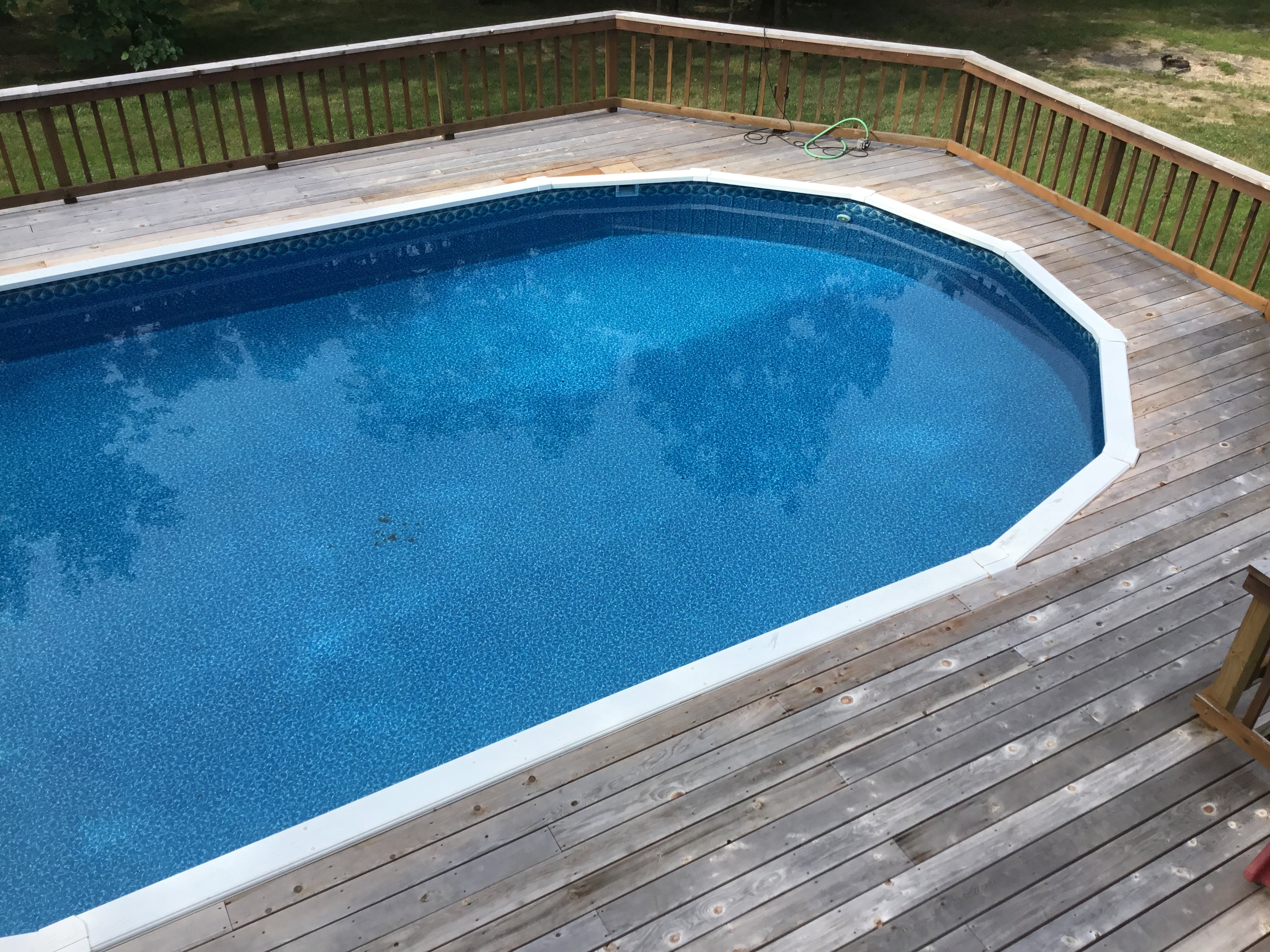

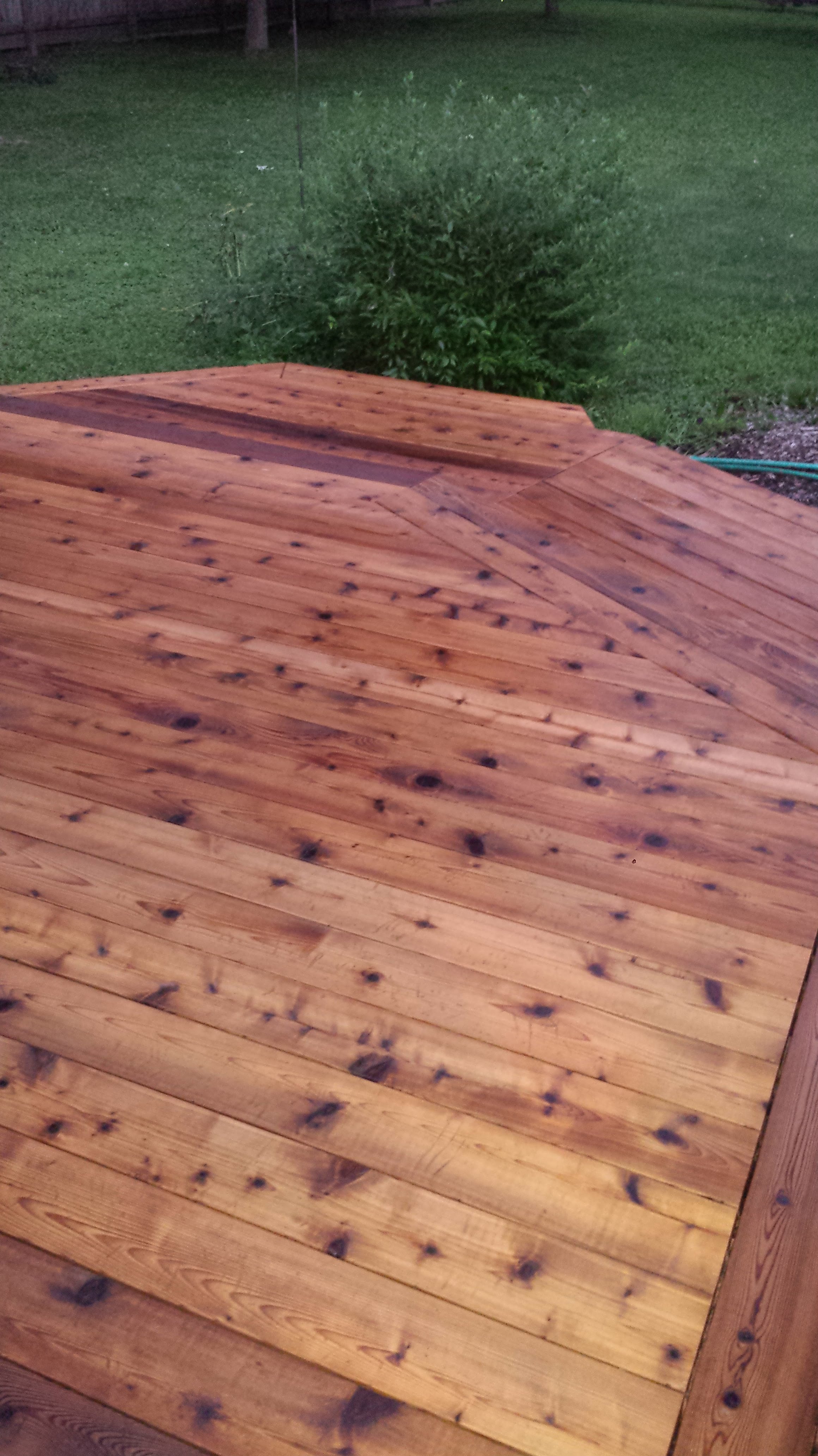

Didn’t use the system. Used the RAD stripper on a cedar deck and then the RAD brightener.
After spraying on the brightener the change in deck appearance was almost instantaneous. This product made the labor of stripping a deck worth the work. Definitely satisfied with th he results.
Easy application and clean up.
Pics of the deck about 2 hrs after brightener was rinsed.
Looks great!
