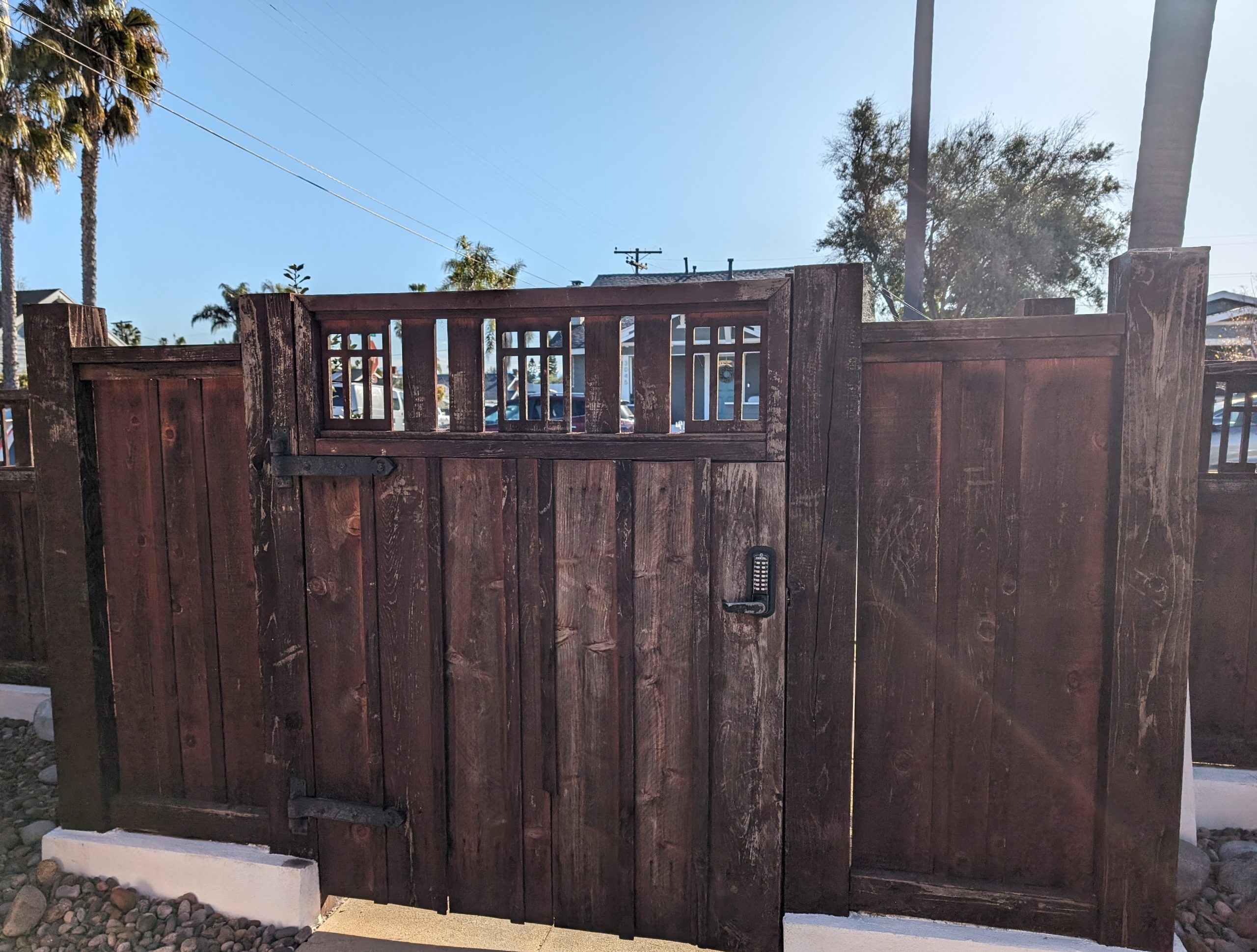

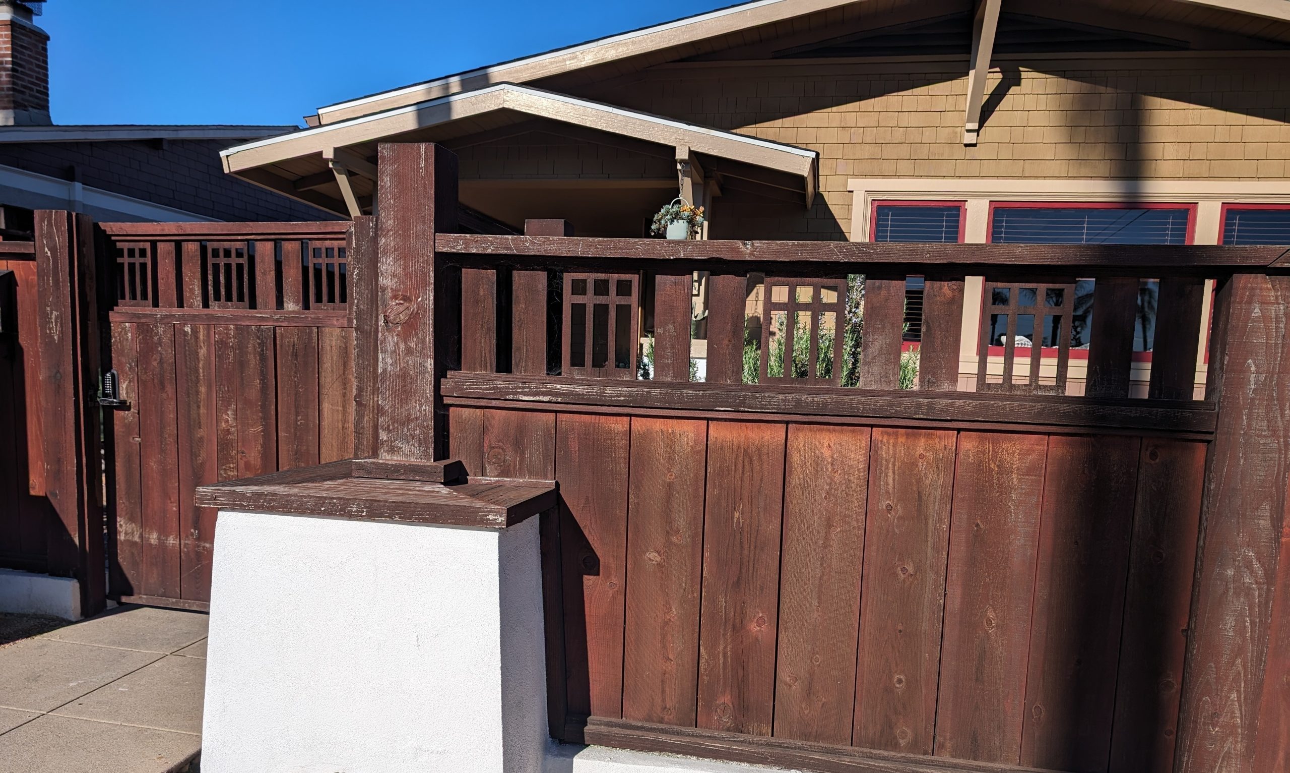

How does the solid espresso look after applying to a fence? More black than brown? How does it look in the full sun? Full sun photo on their website looks gray.
It looks dark brown in shade and slightly less brown in the sun.

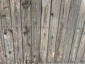

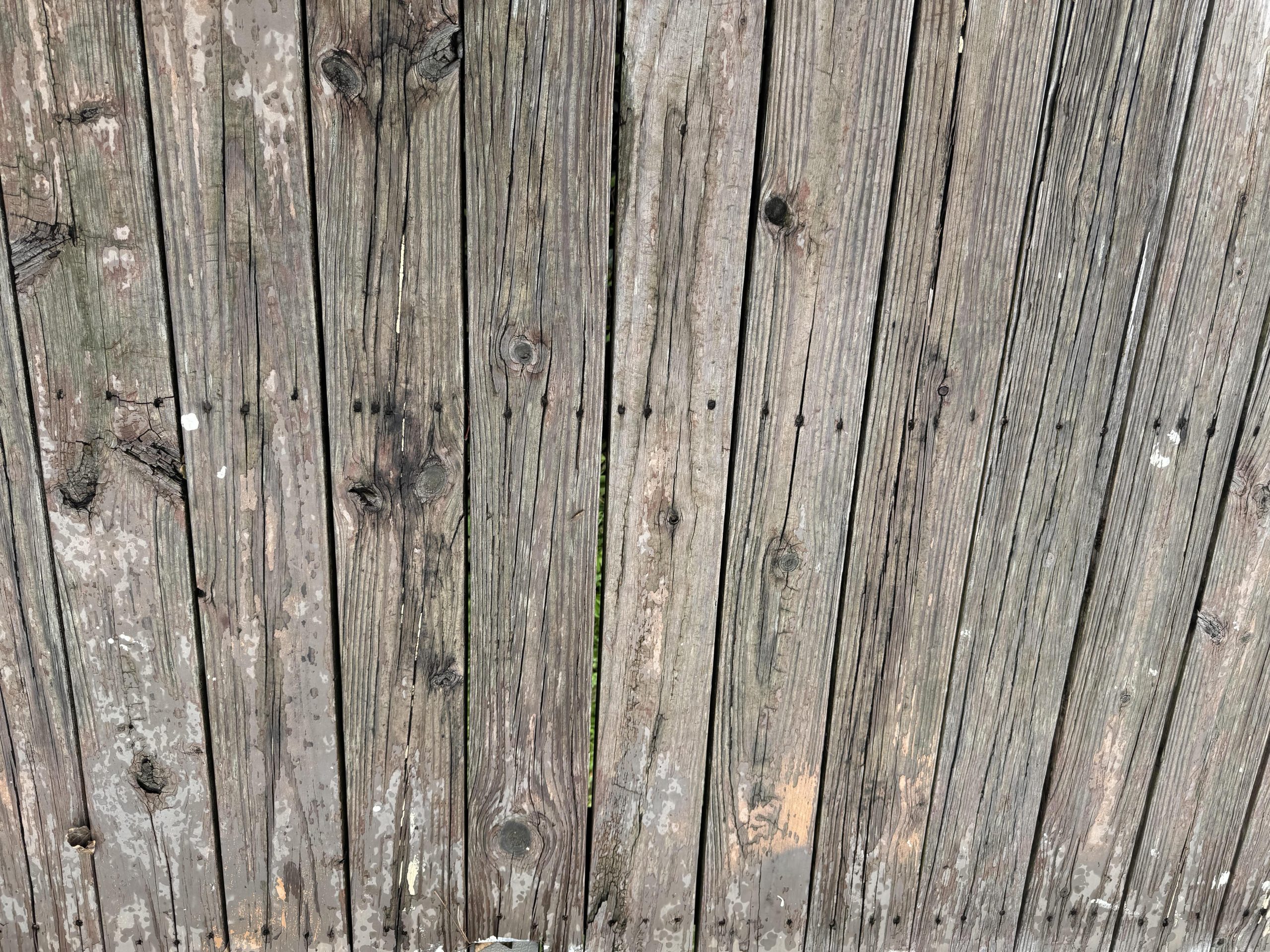

Thanks. Sounds like no gray tones. What would you suggest for this fence after strip with both additives and brighten?
Varies based on how well it strips. Post pics after this is done.
Will do. In the meantime what’s the pros and cons between semi and solid stains. What are some pros for choosing a solid stain besides covering up imperfections
Varies based on the brand. This may help explain the differences in stain types:

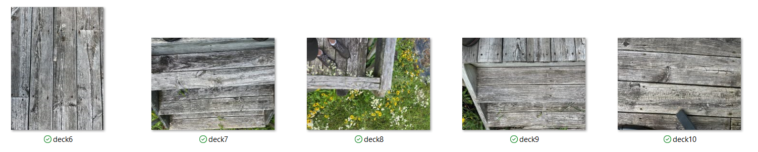

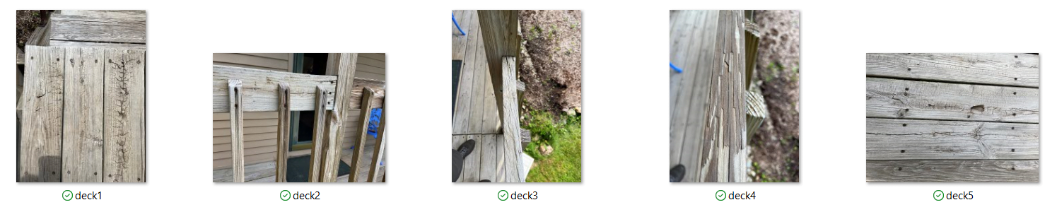

I have two decks that are 28 years old at my home. They were never stained, just pressure washed. Are there some boards that I should change before I stain the deck? Or should I just change all the decking surface since the deck is so old? I would use the Restore-A-Deck. I attached some snapshots of the worst looking boards.
I want to extend the life of two 28 year old decks at my home using Restore-A-Deck stain, I am wondering what existing boards should be changed before I stain it. Or should all the decking be replaced (reuse everything else). Decks were never stained, but were pressure washed. Attached are photo examples of deck.
We would just prep with the RAD Cleaner and Brightener Kits and then address the handful of checking boards after if needed to replaced. Most will cleanup just fine.
Would you recommend pressure washing before doing the cleaner and brightener kits? Thank you!
No, you pressure wash while using the kits.
