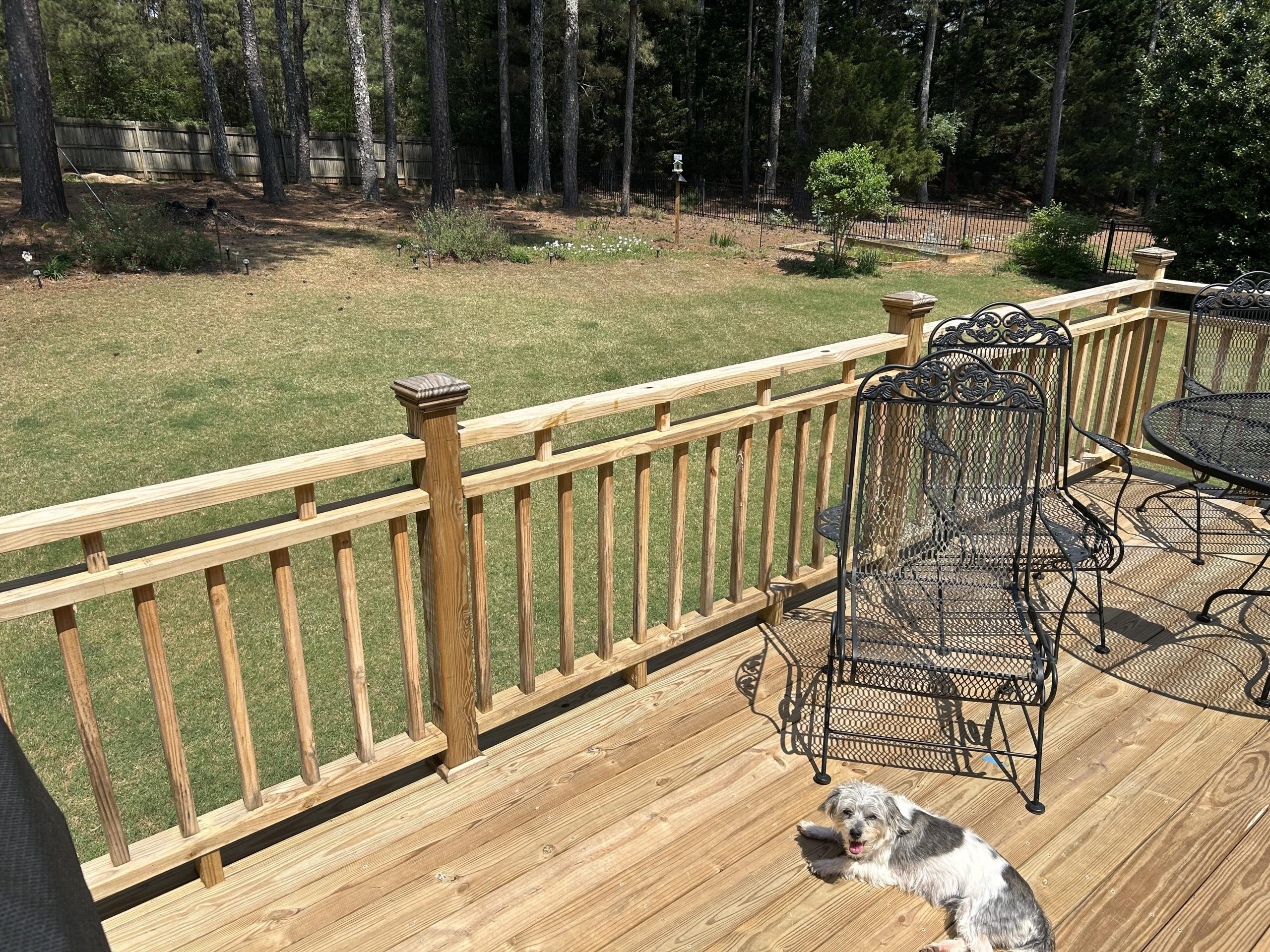

Hello, we have 9 mos old pressure treated pine deck here in Georgia we will be staining soon. I am looking at an oil based stain, the deck is an extension of our covered porch that is also pressure treated pine deck with a 10 year old oil based Olympic stain. Can I clean the porch deck and apply the new stain on it or does it have to come off?
Strip and brighten to remove the old stain. It has to be removed.

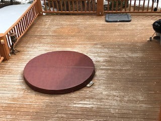

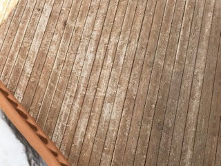

In Montana there is no such thing as re applying in 2 to 3 years. EVERY year or you’ll be down to bare wood. I’m not happy with this product as compared to the reviews I see. Pic below is one year skipped! Odd how similar this site is to the TWP website. Now I get it….
The pictures in the photo show wearing due to the TWP not soaking in when applied. If it soaks in fully then it does not wear. Looks more like an application issue than a stain issue. Also, that looks 2-3 years old and would be time to prepped and recoat. We restore over 4– decks with TWP and never seen issues like this after 1 year.
As for this site, the very first article on the home page will answer all questions to who maintains this site.
