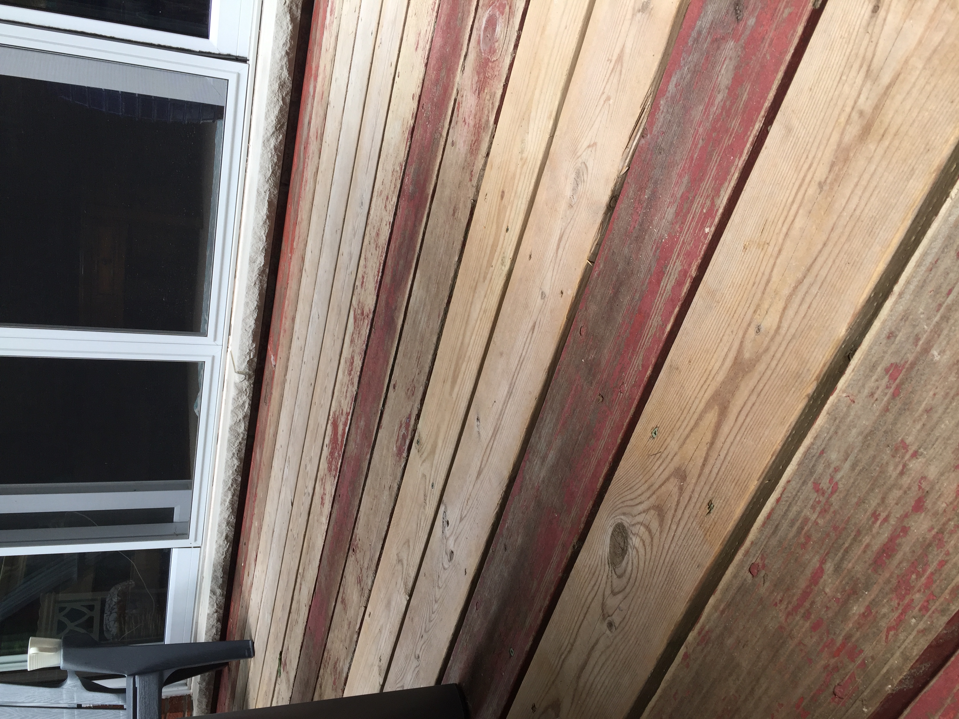

I used a deck stripper and am in the process now of sanding the deck before I apply a stripper (I started a month ago and it’s been extremely rainy so I haven’t been able to really get it done). My question is i don’t think I got all of the stain from the old wood out. I live in a city with tight yards and I got a lot of the old stain out but I couldn’t power wash it out as it’s splash onto the neighbors (or my) house/windows/etc. How clean does it have to be to apply new stain? We are going a shade darker than the last of that helps. I’ve also attached a pic.
The old stain has not come out much. It needs to be fully removed.

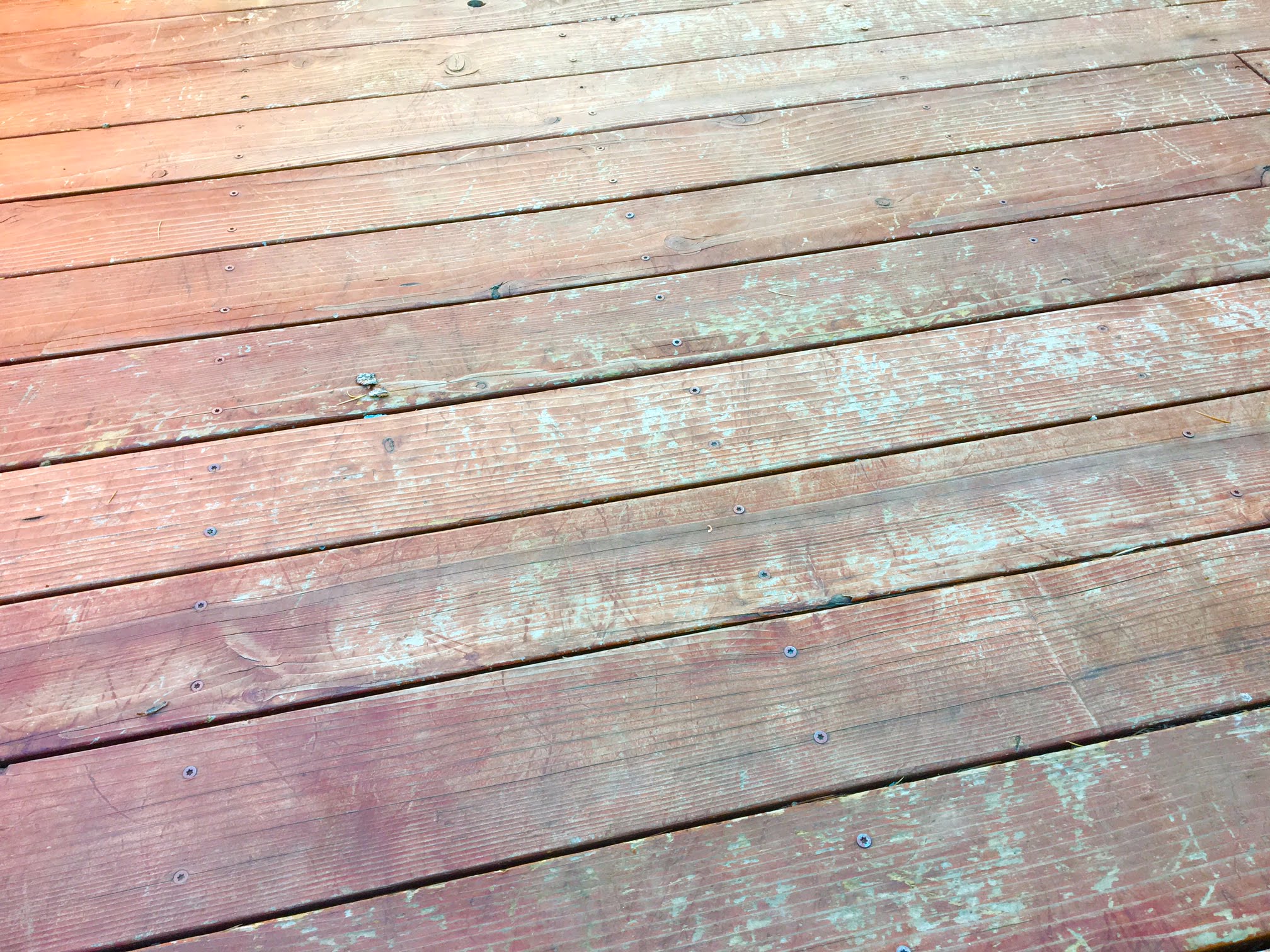

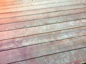

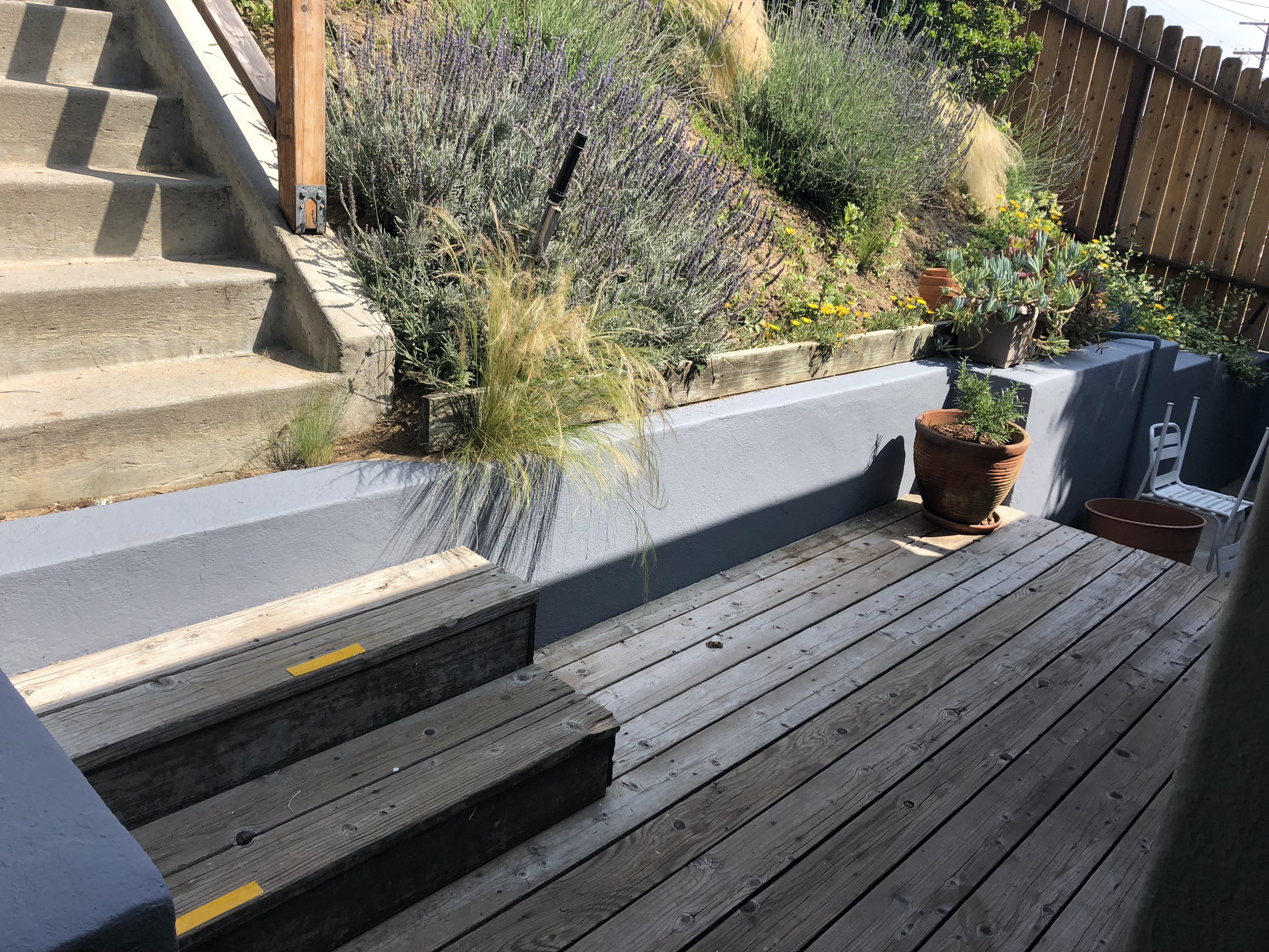

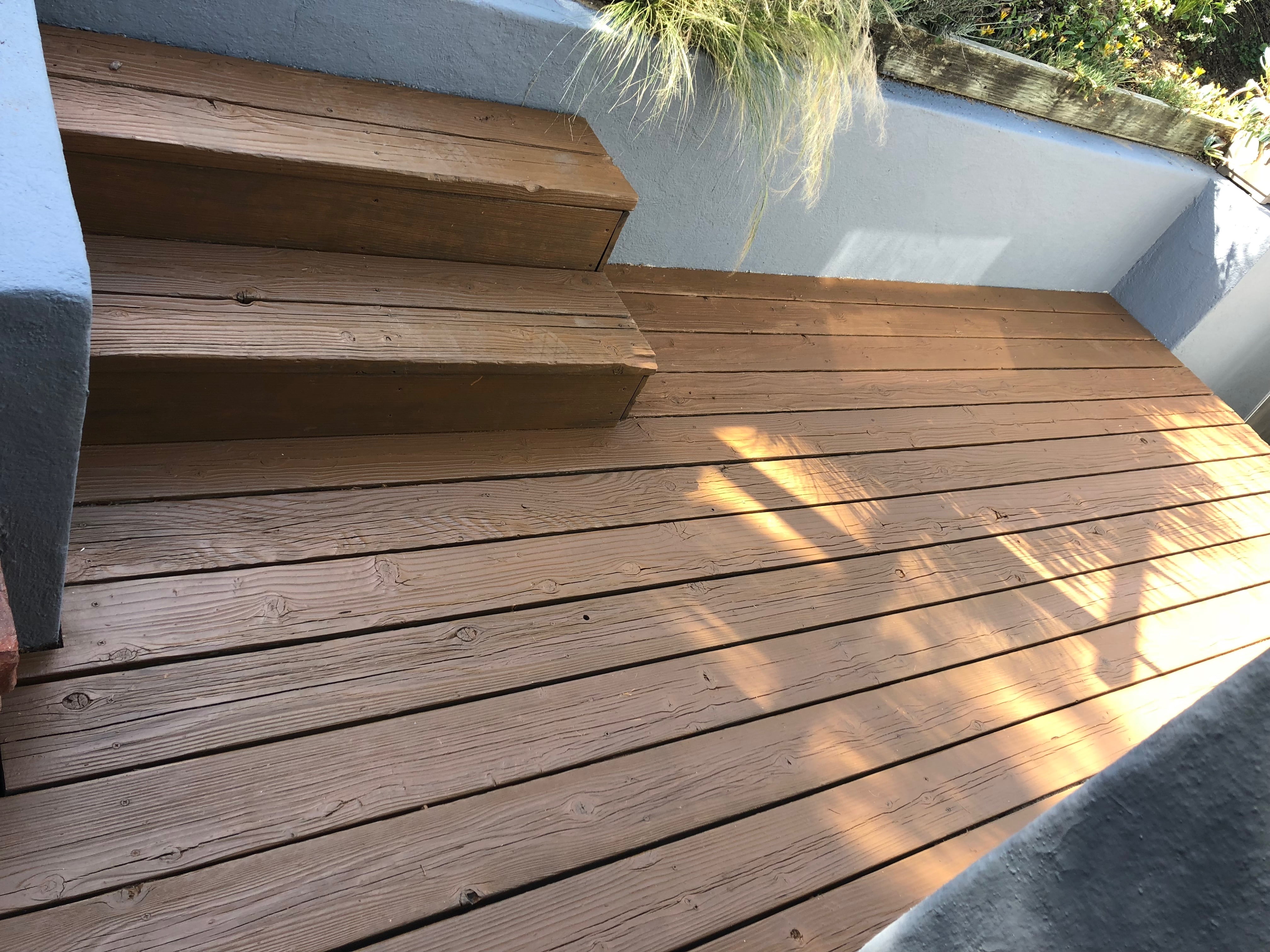

Hi! I have 2 large green treated decks, about 10-12 years old. Last summer they were completely sanded, power washed and cleaned. They did dry for several days. Then Pittsburg Ultra Advanced Stain and Seal In One, Solid Color for Decks was used. Says it was also a “Advanced 2-way Waterproofing” Stain and Sealant. They both looked fantastic for Fall! We had a horrible cold, snowy Minnesota winter, but no metal shovels were used on either deck. The stain is ALL peeling up and looks like it hasn’t been done for years. It’s horrible and disappointing. So much work went into redoing both decks and i have no clue what possibly happened. Obviously it’s all going to need to be redone, but were the products not the best for the wood? Should other steps have been taken? We followed all recommendations. Any help would be appreciated!!! Thanks.
It did not take for some reason. Feel free to post a picture.

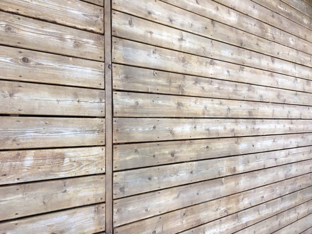

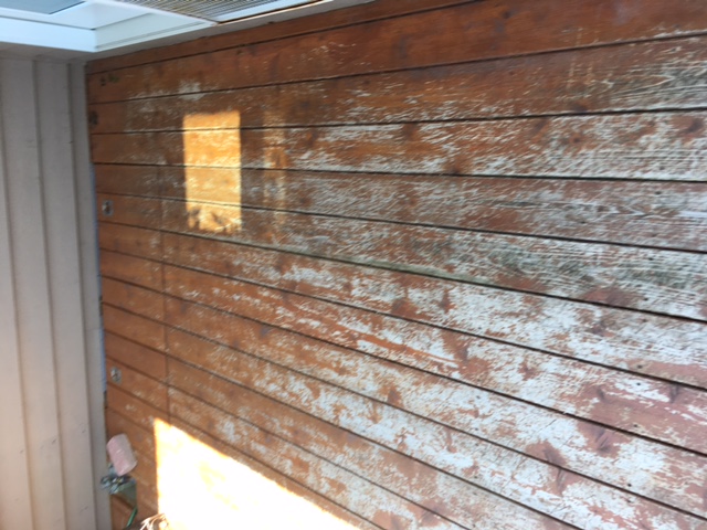

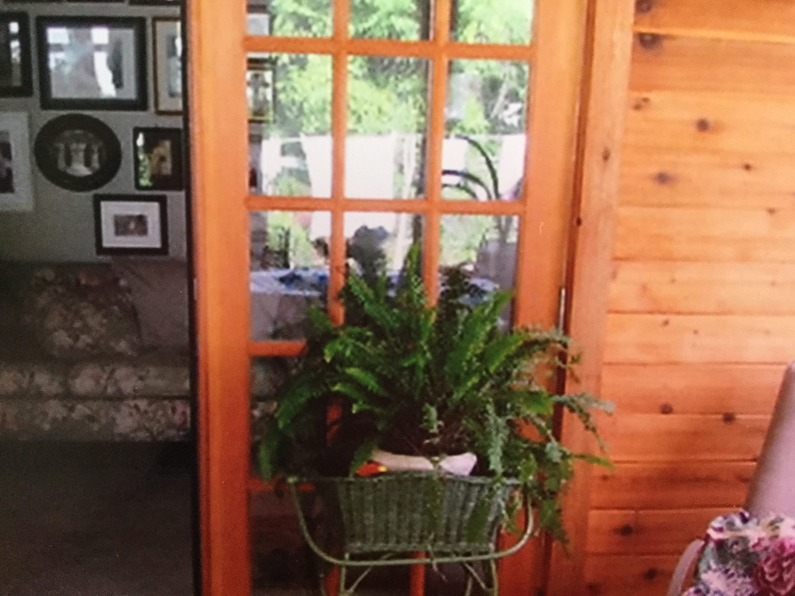

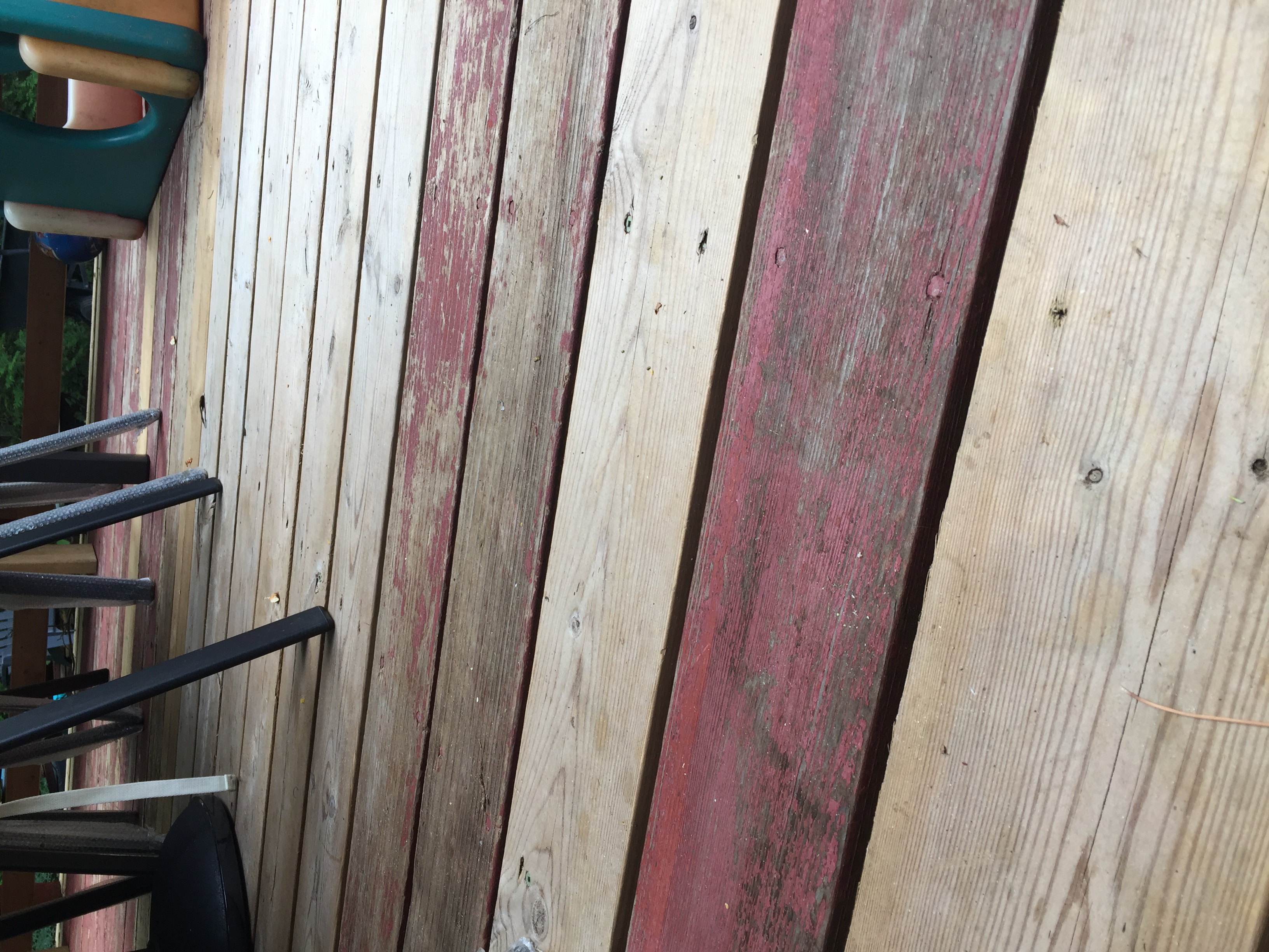

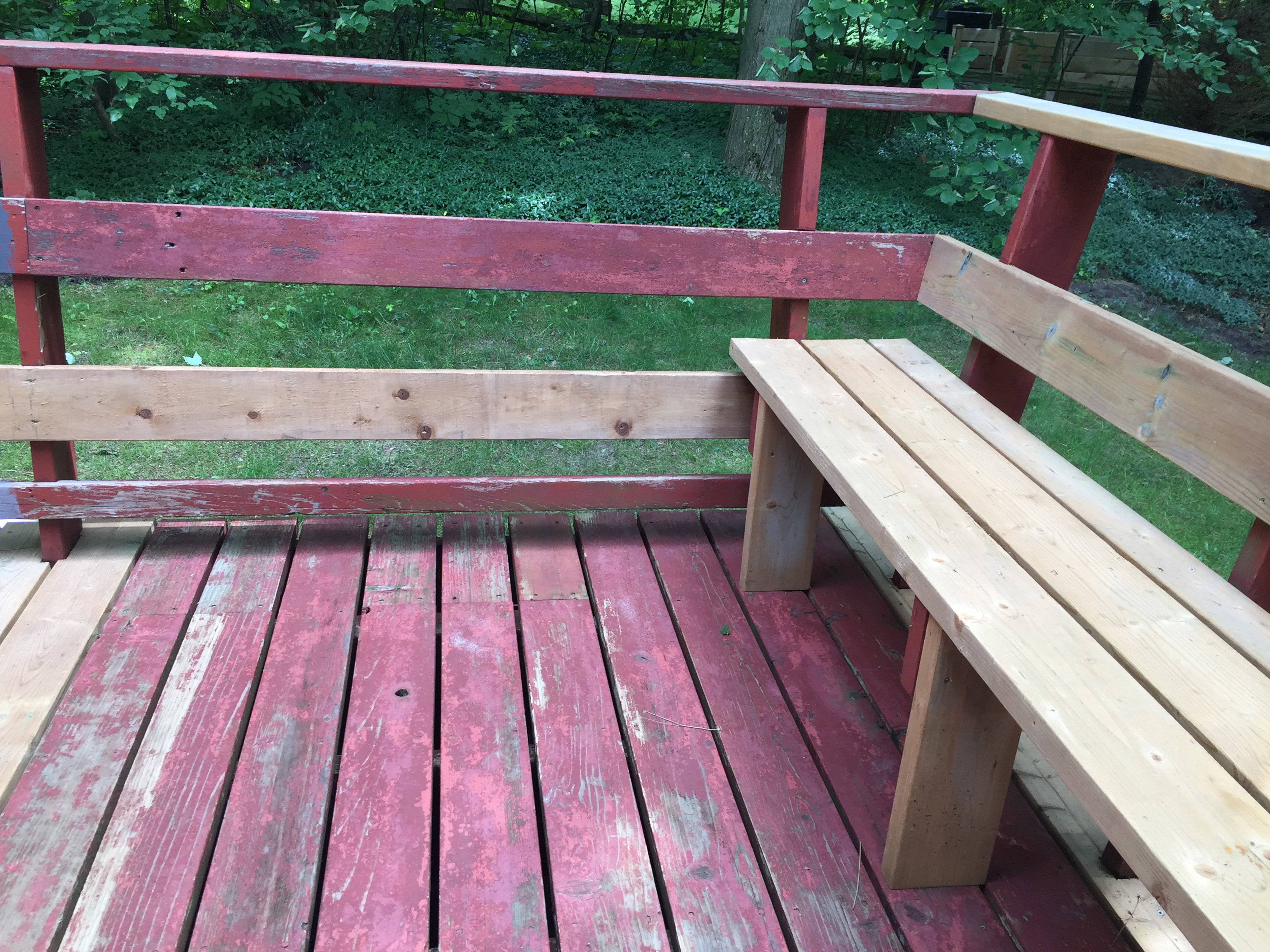

I’ve got a cedar porch, about 12 years old. We had it stained at least four years ago wit Cabot semi-solid oil finish stain and as soon as the job was completed, I thought it looked terrible….just so dull and flat. I want to redo it now and am so confused about what to do. Is there any way to brighten up the wood, like how it was when the porch was first built? We are also planning to re-stain the interior, which hasn’t been touched since we built it. At least it still looks fairly close to how it looked back when we first built the porch, although there are water stains. How do I remove those? The floor, stained four years ago, is also just dull! No luster to the wood. Strip? I just want my porch to look like it did when we built it…wishful thinking?
Indoor pic taken 12 years ago.
Other pic is of the exterior now.
Strip and brighten all wood for prep. Stain with TWP or Restore A Deck Wood Stains.

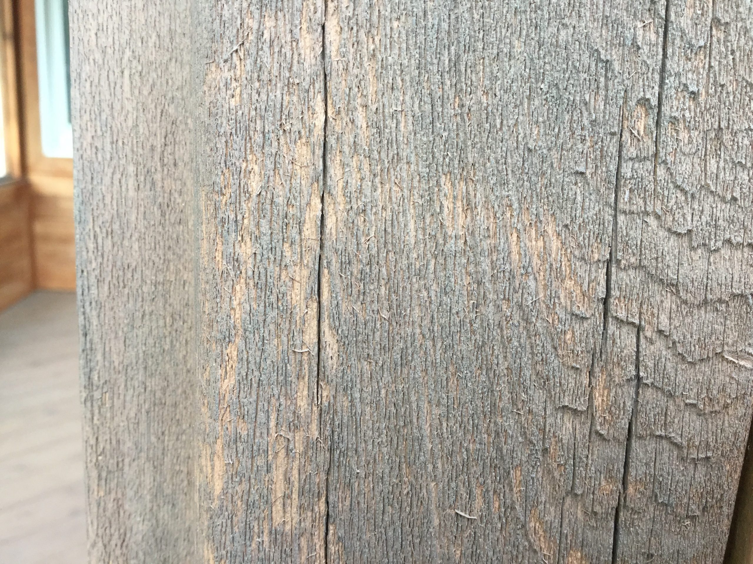

We have a log home we purchased 5 years ago near the twin cities in Minnesota. The logs are northern pine with pine plywood and rough cedar battens. We also have green treated decking around a large part of the perimeter that has been all stained the same. We found a empty 5 gallon bucket of Defy which I am assuming is what they used. The condition of the logs are varied with some sun beaten and very little stain and other areas under the overhangs looking very good. I have several questions:
1) What prep would you recommend if I tried to use the same Defy product?
2) If I were to strip everything what stripper and brightener would you use?
3) For the climate and various surfaces and species of wood what stain would you suggest?
1. Use their Defy Wood Deck Cleaner and pressure washing.
2. Defy Stripper and their Brightener.
3. You could use the same Defy. Works very well for vertical wood. Other options would be the Restore A Deck Wood Stain or TWP.

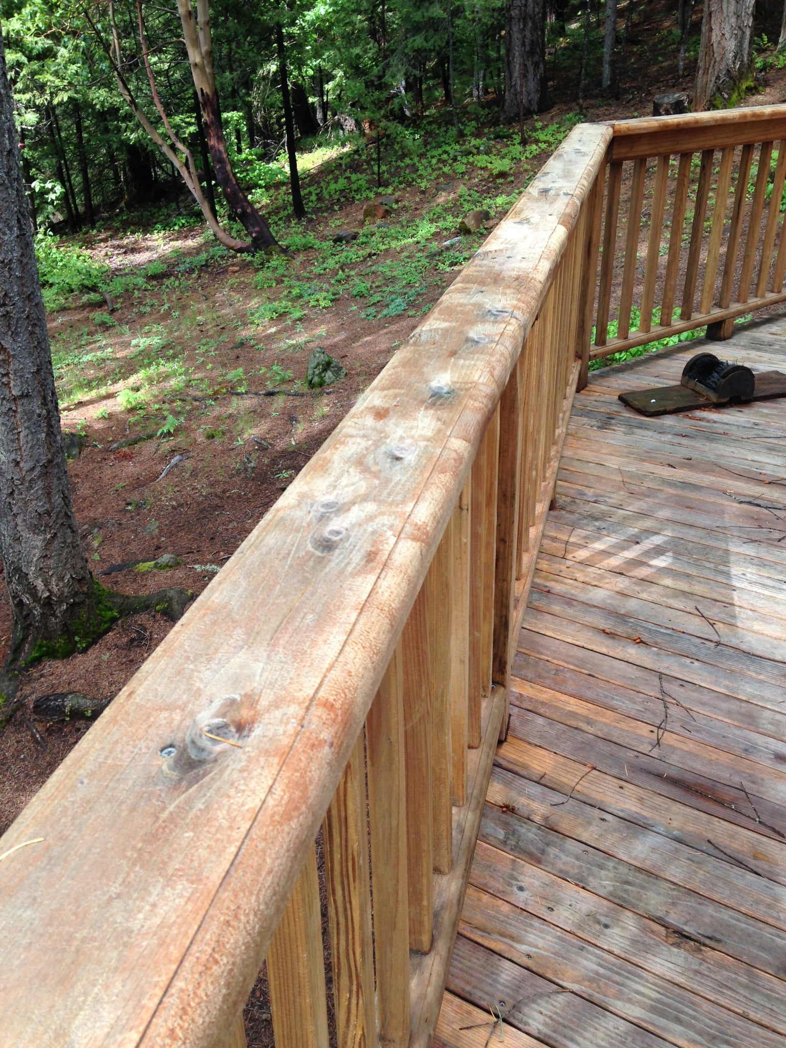

I used stain remover followed by a brightener on my Redwood deck. Some, but not all, of the top railing has a yellowish residue (no matter how much I rinsed it). I want to stain it but am concerned about how this area will turn out. Any thoughts?
Sand those railings tops and see if that helps.
Thanks. I’ll give that a try.

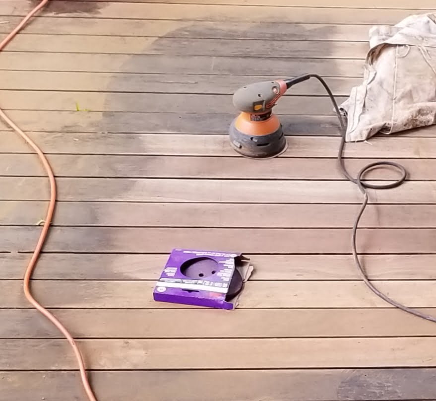

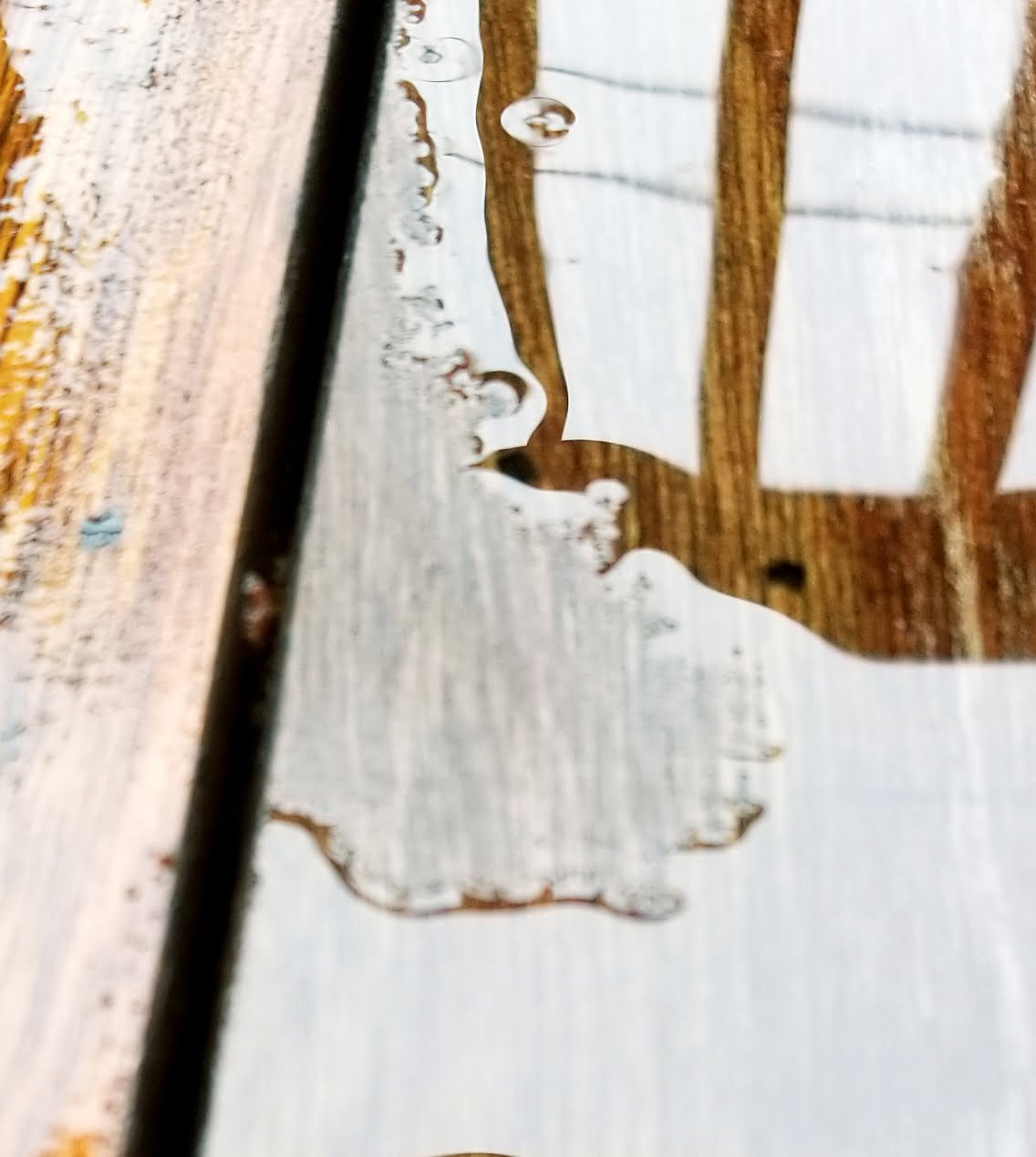

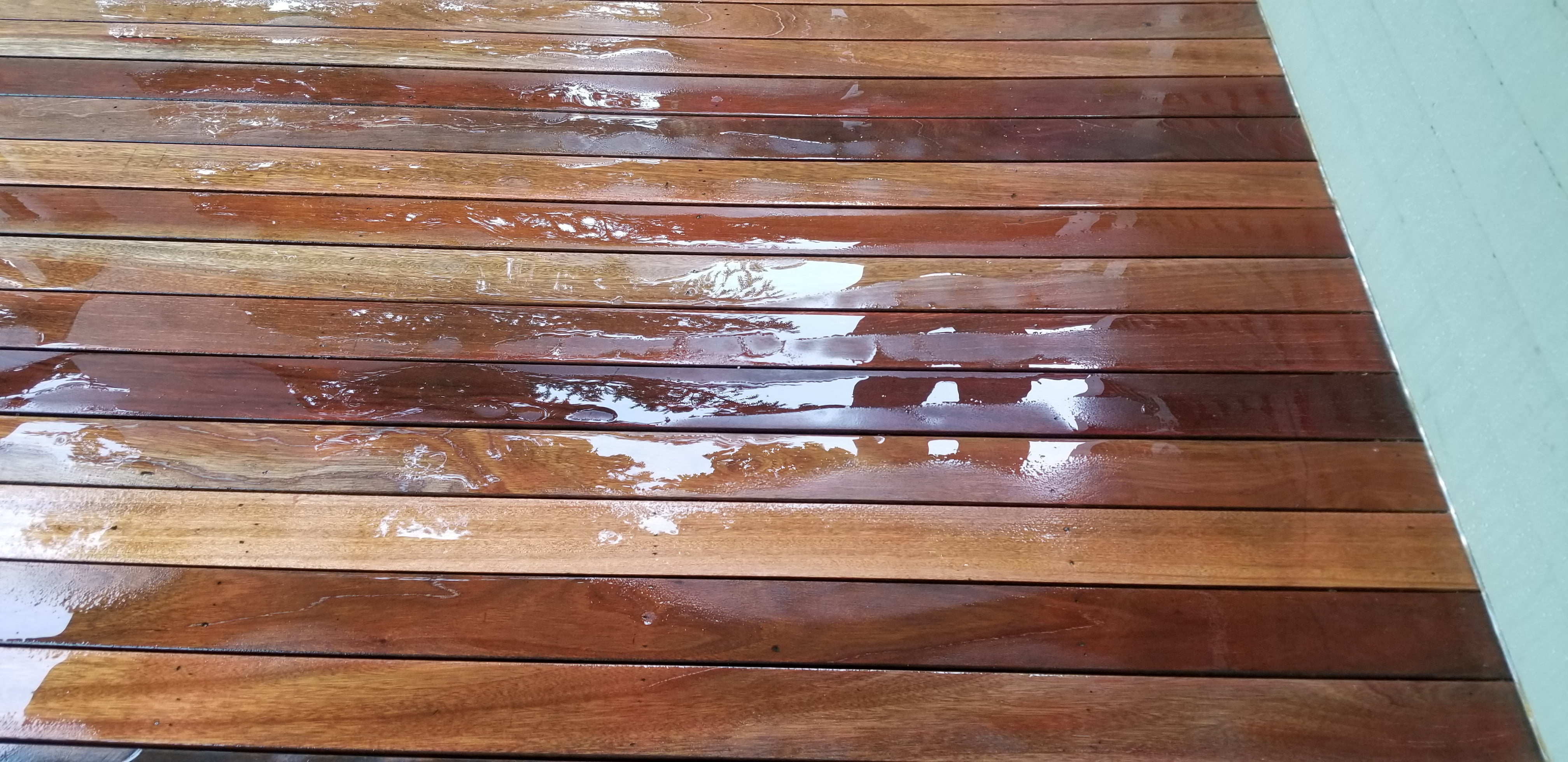

I’m stripping a deck of unknown tropical hardwood using 60-80 grit sandpaper on a random orbital sander. The deck was done years ago with Cabot’s Timber Oil that turned black. My plan is to use either an oil based stain or tropical wood specific oil to show off the wood decking once I have removed the Timber Oil.
After hours of sanding I rinsed off the deck to remove the dust and look for water beading on the wood, which I saw.
Would it be a good idea to give the hardwood a dose of deck stripper, and brightener, to remove any residual Timber Oil lurking in the wood, or should I re-sand the areas where the water isn’t absorbing immediately?
Sanding closes the pores of the wood and could be the cause of the beading. Do a light cleaning and brightening of the wood and then 1 coat of the stain.

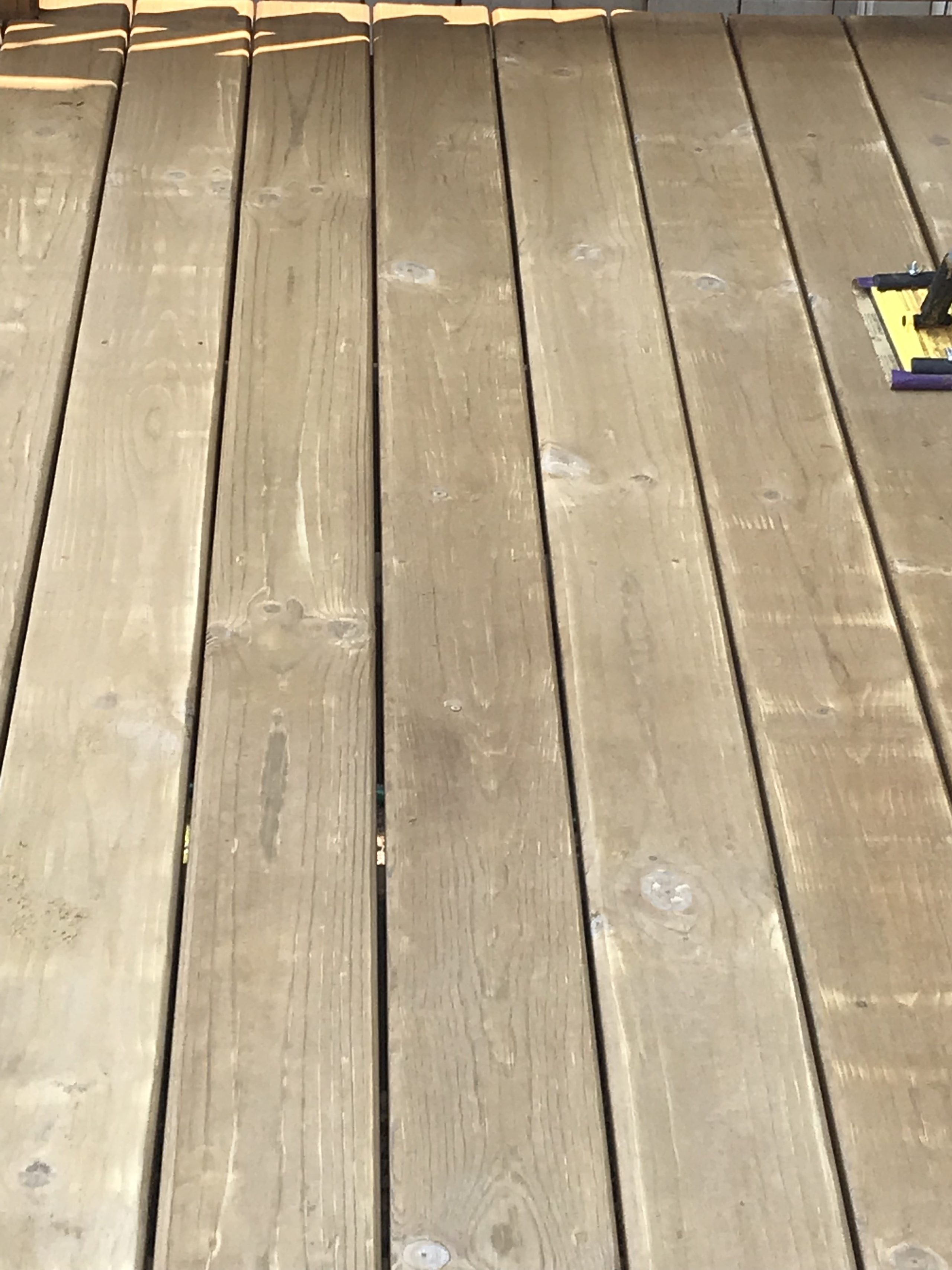

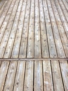

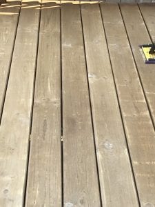

Ive removed the old stain with stain stripper and power washer but now have wood fuzzies. Is this normal or did I ruin the wood? I plan to sand after another 2 warm days to let the deck dry and remove any remaining stain that was stubborn. Hoping I can sand to repair any rough areas as well. Then I plan to use a semi-transparent Oak tinted water based stain, but want your suggestions on the best stain to reduce future maintenance as I’m not eager to do this again any time soon! Oil based? Solid? What would you use?
Fuzzies happen and is not a big deal. Rent a floor buffer and get a “white” sanding pad. Buff the floor and it will all come off. Very easy. Try the Defy Extreme or Restore-A-Deck wood stains.

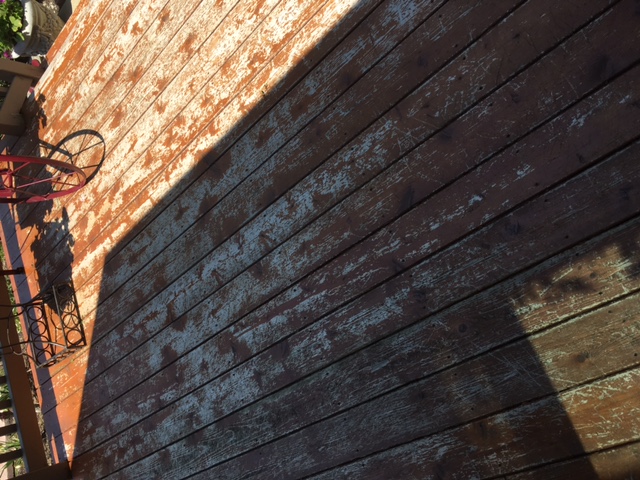

We need to refinish our cedar porch that has Sikkens stain for over 20 years on it. Some places on the porch have and are peeling and some places have not peeled. What do you suggest?
Best to remove all and start over. Strip off as much as possible, sand the rest of needed, brighten the wood when done.

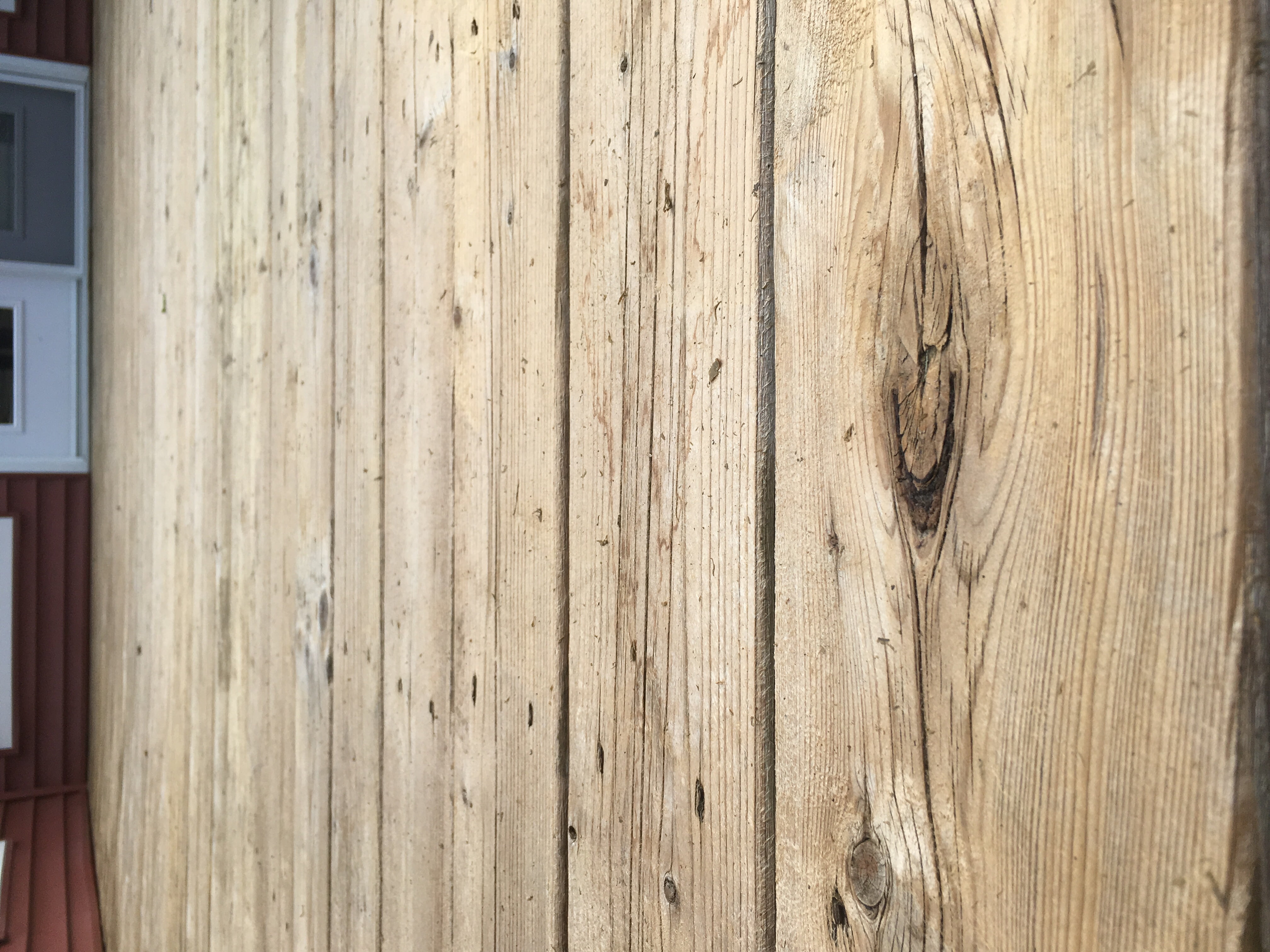

Thank you. Pics attached. Here are pics. What do you think on removing the Acrylic?
Apply a stripper and pressure wash off. It will remove much but not all, especially around the edges of the house where it is thicker. Sand the rest off and then apply a wood brightener. Rinse well when done.

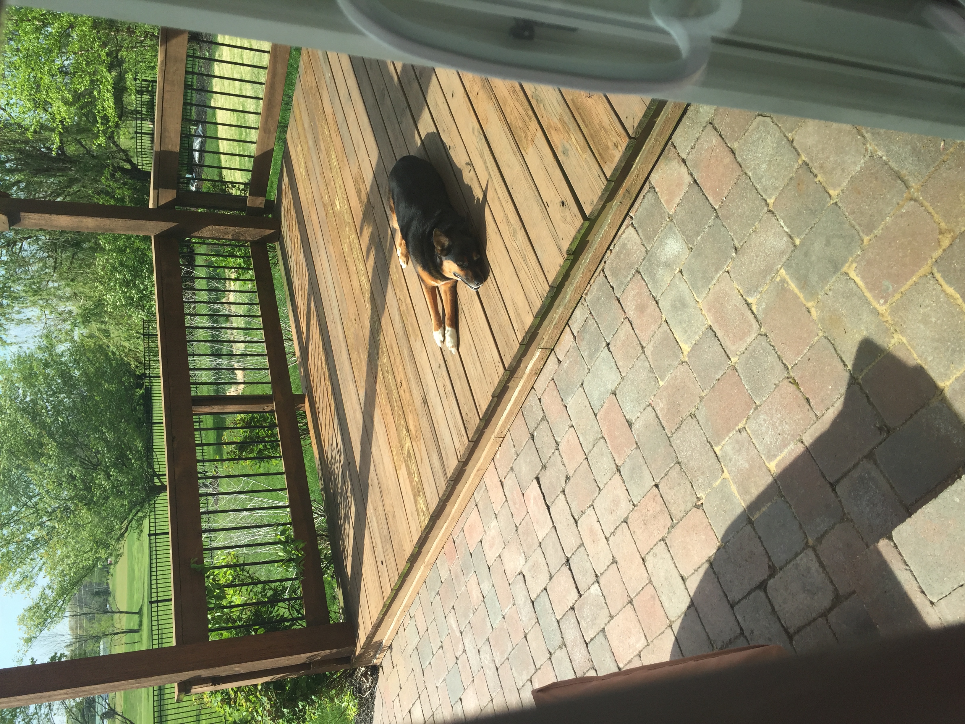

We are trying to remove deck stain that was done (most likely quite a few years ago) by the previous owners of our home. There is visible dirt and stain we need to remove so that we can re stain the deck. We have also replaced a few boards last year and stained them and it did not match well – which is part of what started this whole project. What is the best way to remove the stain and dirt? Should we power wash and then sand? Is it okay to just power wash? Or just sand? I powerwashed a small area and it removed some of the dirt and stain well and then was creating grooves in the boards in other places. Recommendations of what to do and/or products to use would be extremly helpful!!
Post a picture, please.
This is the best picture I have at the moment.
Remove the dog, apply a deck stain stripper and pressure wash off. Repeat if needed for stubborn areas. Sand lightly after and apply a wood brightener the wood.

We built our IPE deck last year and used Penofin. I was not happy with the stain, since every time it got wet it left stains behind. I would like to use IPE Oil this year. Do I need to strip the deck before, or is a cleaner good enough? Thanks a lot
Strip the deck would be best. All the Penofin should be removed. IPE does require annual maintenance.
