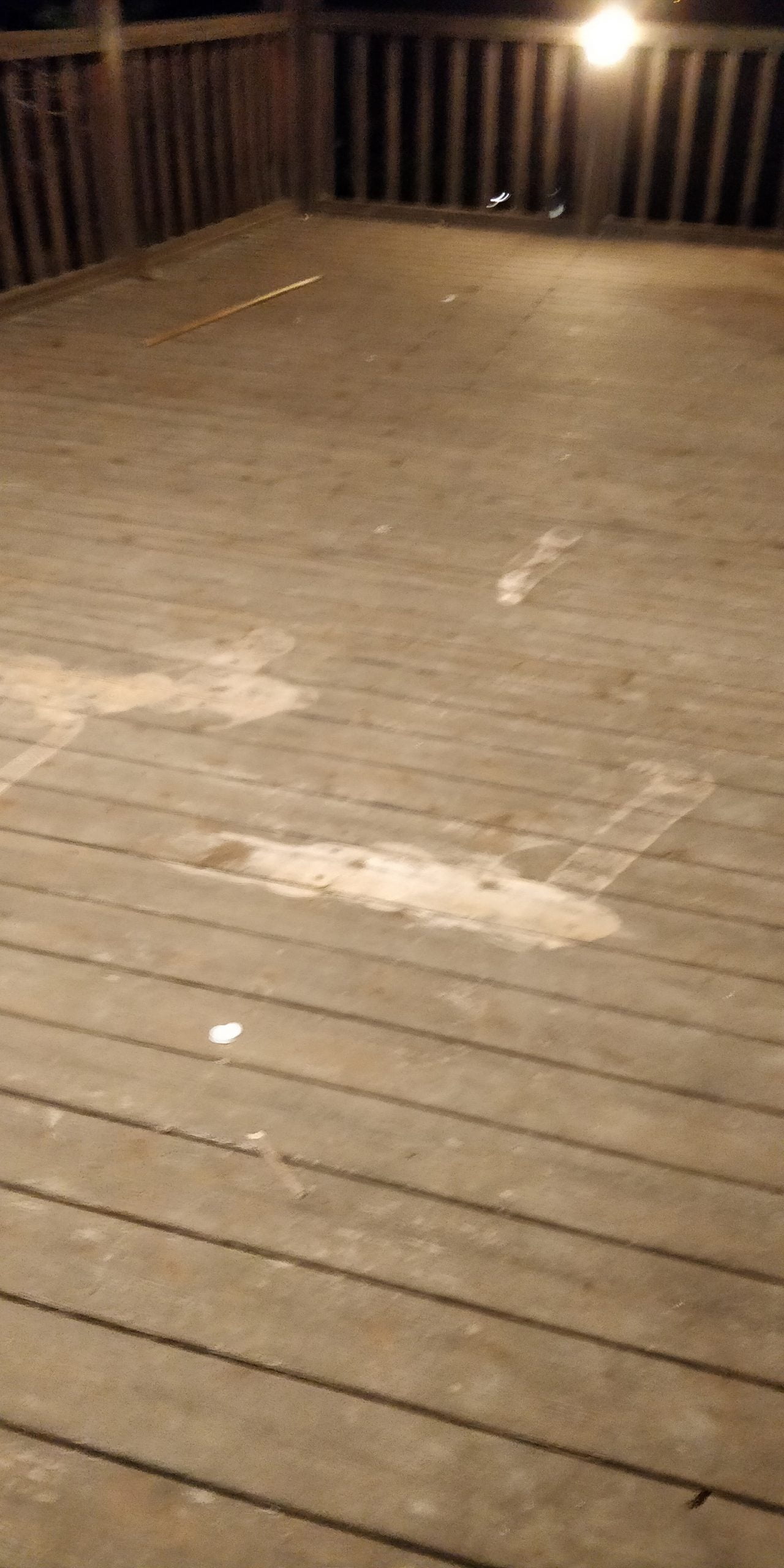

Thank you , maybe you can advise me if I need to strip in the first place or can manage with just cleaning. I am enclosing a picture including what yiu see was caused by a test of our pressure washer which seems to have brought back rhe original color of our cedar with just water…
In any case i would appreciate if you can correct the steps as I understand it, i am looking also to be efficient , as this is a large deck around 1000 sq feet.
1) sweep and wash with presdure washer
2) apply cleaner or stripper with a broom.
3) wash off with pressure washer
4) apply brightener with broom ( i see flood advertises all purpose cleaner that also brightens, will that save me steps?)
5) wash off with pressurr washer
6)
Wait 48 hours
7) apply sealant
Thank you :)

Thanj you! Can you please advise if I need stripping at all or whether cleaning is enough? The picture was taken nearly one year since the last time I used Flood transparent UV , the marks were caused by water which was applied on Friday accidently through a pressure washer which seemwd to have revealwd the origibal cedar. The deck is a large one, would appreciate understanding what tools I can use to be efficient without losing effectiveness. Is there a link which explains the best way to ho through the process from cleaning to brightener to sealant ? Thanks!!
