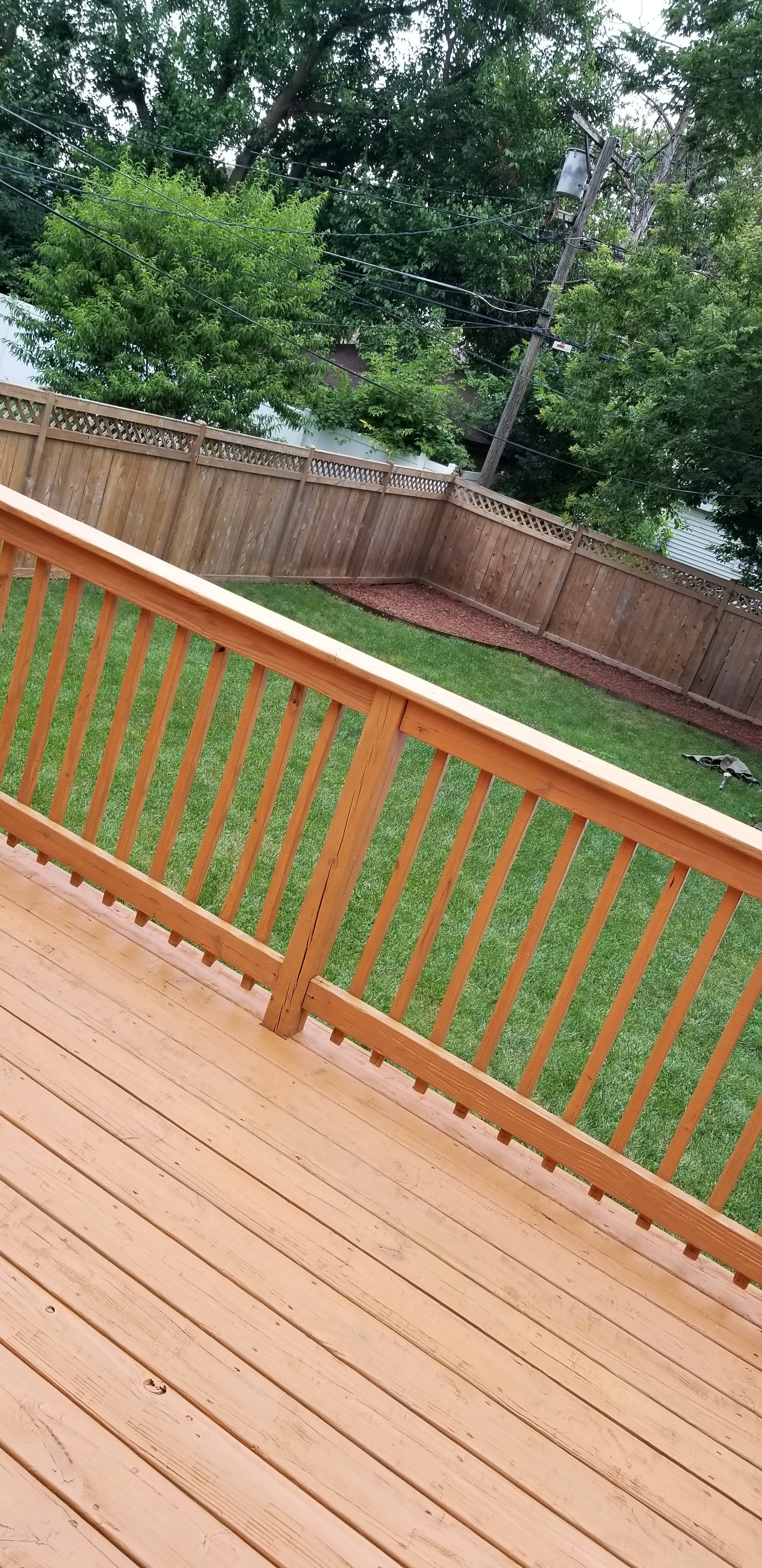

As a comfortable painter. i just used super deck oil transparent heart redwood 1 coat. it looks great. 800 square ft. i used atleast 12 good rags to wipe down and brushes only. it even started to sprinkle as i was leaving and im sure there will be no isssues. LB Painting WA
