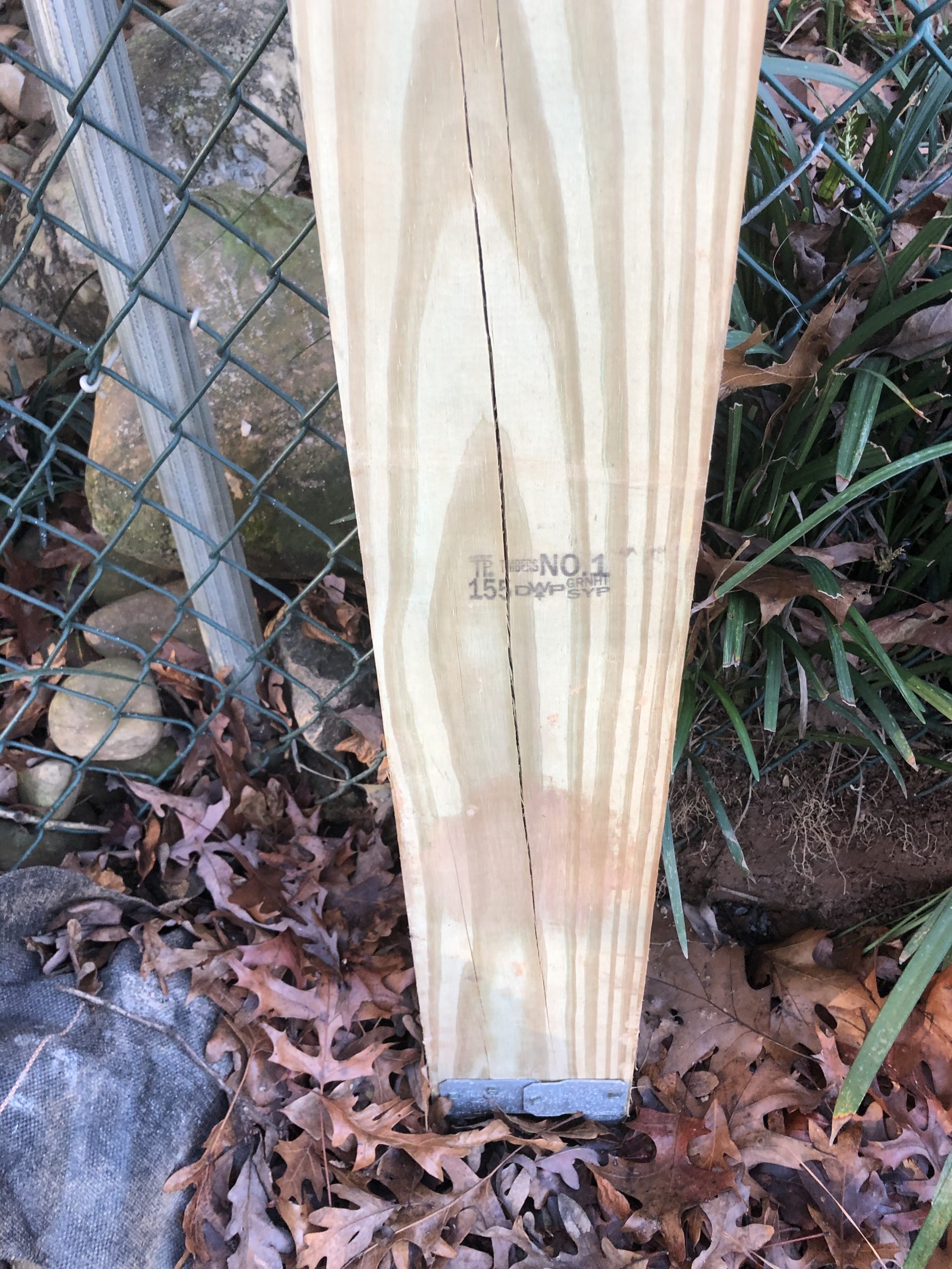

I have Cracks in My Deck Support Posts. Should I Repair?
It’s not an issue! Deck support posts are made of pressure-treated pine, and pine wood generally shows cracks after a few years outside. This is completely normal, and your deck support structure will not have any issues.

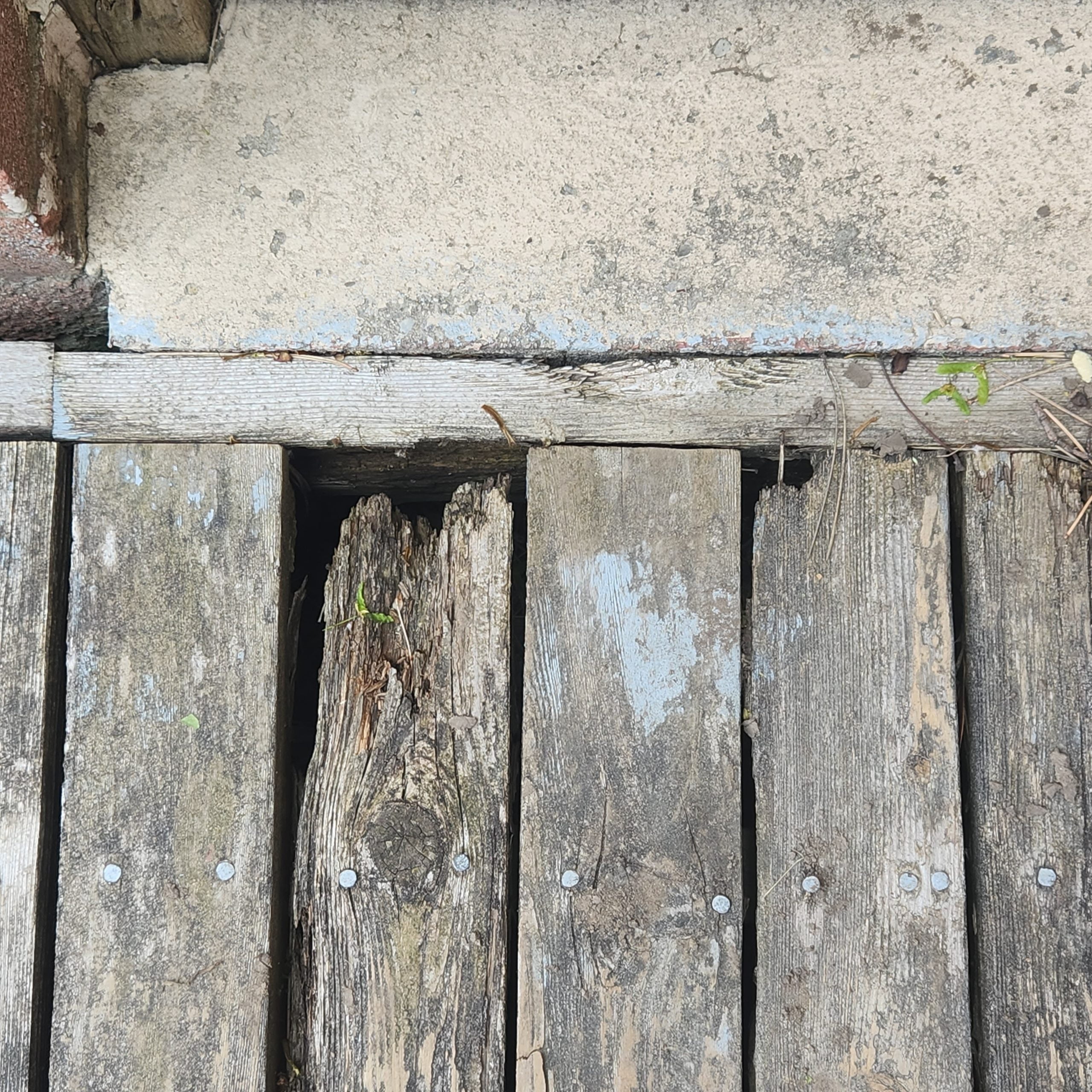

My deck is 40 years old, lack of maintenance. Lots of rotten wood. But base is good. Have rotten knots too and big holes. What to do?
Use wood hardener?
Use primer?
Can I use primer over some leftover paint from five six years ago?
Then stain?
Then paint?
Please recommend brands too.
Appreciate your advice and time.

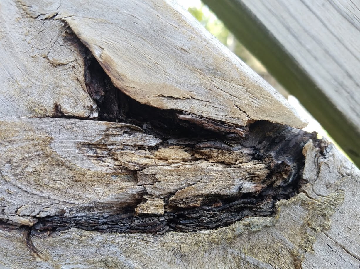

Post pics in the comments for prep help and advice.
Attached are four. More to come
You should replace all our bad wood and rotting boards now as they cannot be fixed. Let the new wood weather until Fall after install. Prep and restain all with a solid color stain.

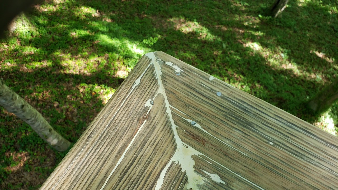

So Bondo and or pro bond by Elmer’s you claim is not needed for deck repairs do nothing is your opinion. Their claims are what false?
Their filler will not stain to blend with a transparent or semi-transparent deck stain. It will look like white blotches all over your deck under the stain where you use it. They also have a tendency to crack and break out if used in a state where it freezes.

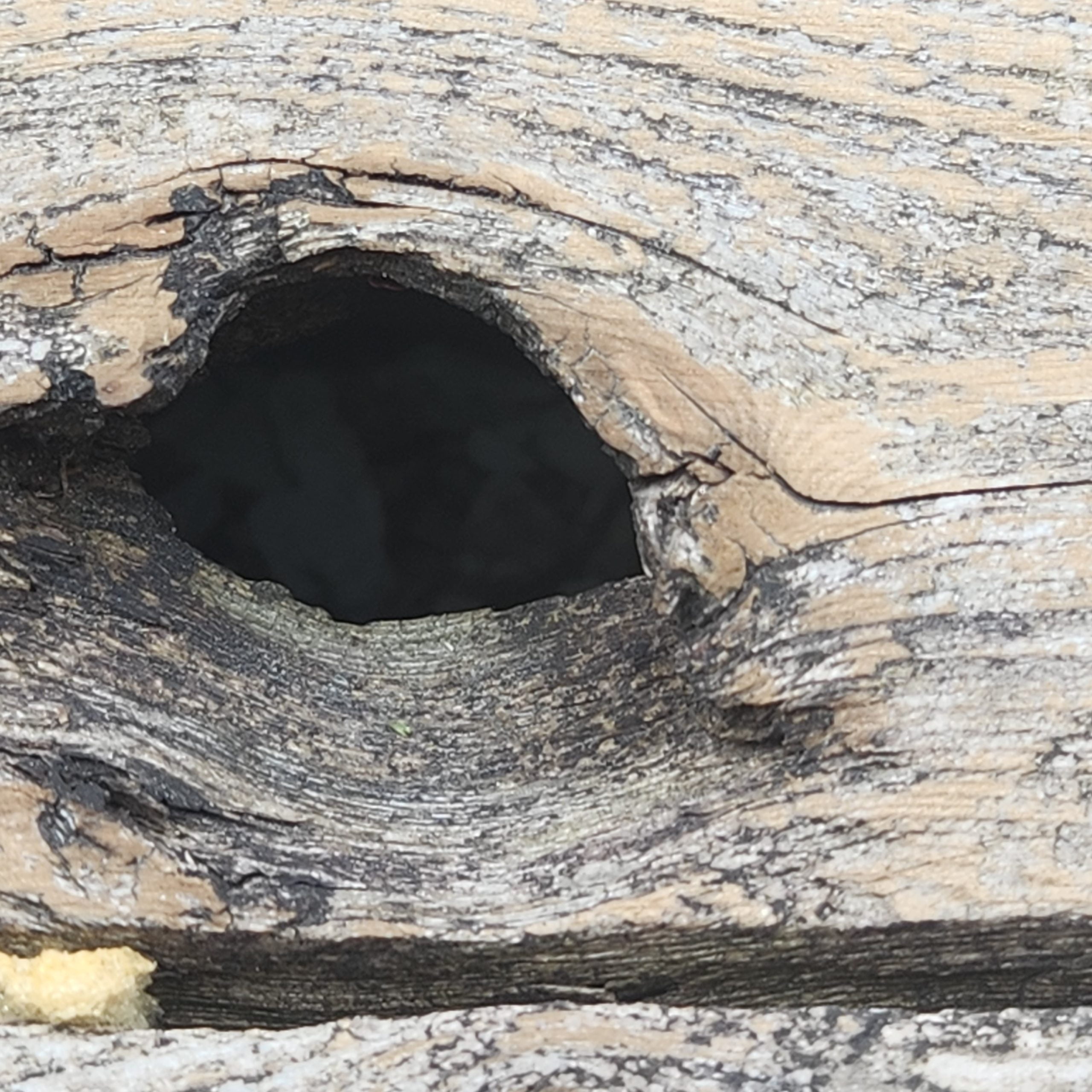

Regarding filling knot holes etc., the guy at the store suggested epoxy. No disrespect; but I had to ask.
Epoxy will not stain to blend. You can find a caulk that is similar in color to your stain and use that.

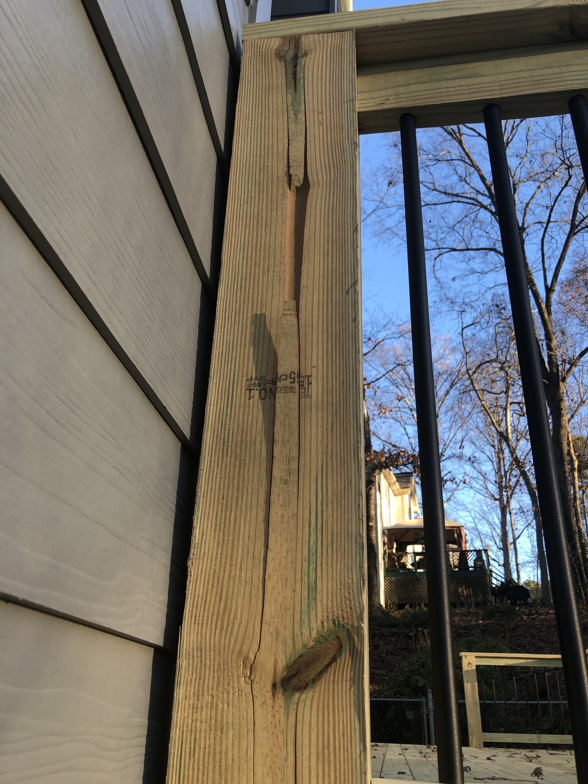

Hi there. This is all really helpful, especially seeing that the vertical cracks are normal. Here’s where I need some reassurance: I live in a place where we get ice in the winter. I kept thinking I needed to fill the variety of cracks so that the expansion of frozen water within those cracks would not worsen the condition of the wood. Is that a concern or are you saying no, it either won’t do much damage or it will do damage but there’s not much to be done about it and eventually replacement would just have to happen? I appreciate your time. Thanks so much.
Cracks are normal so just leave them as is.

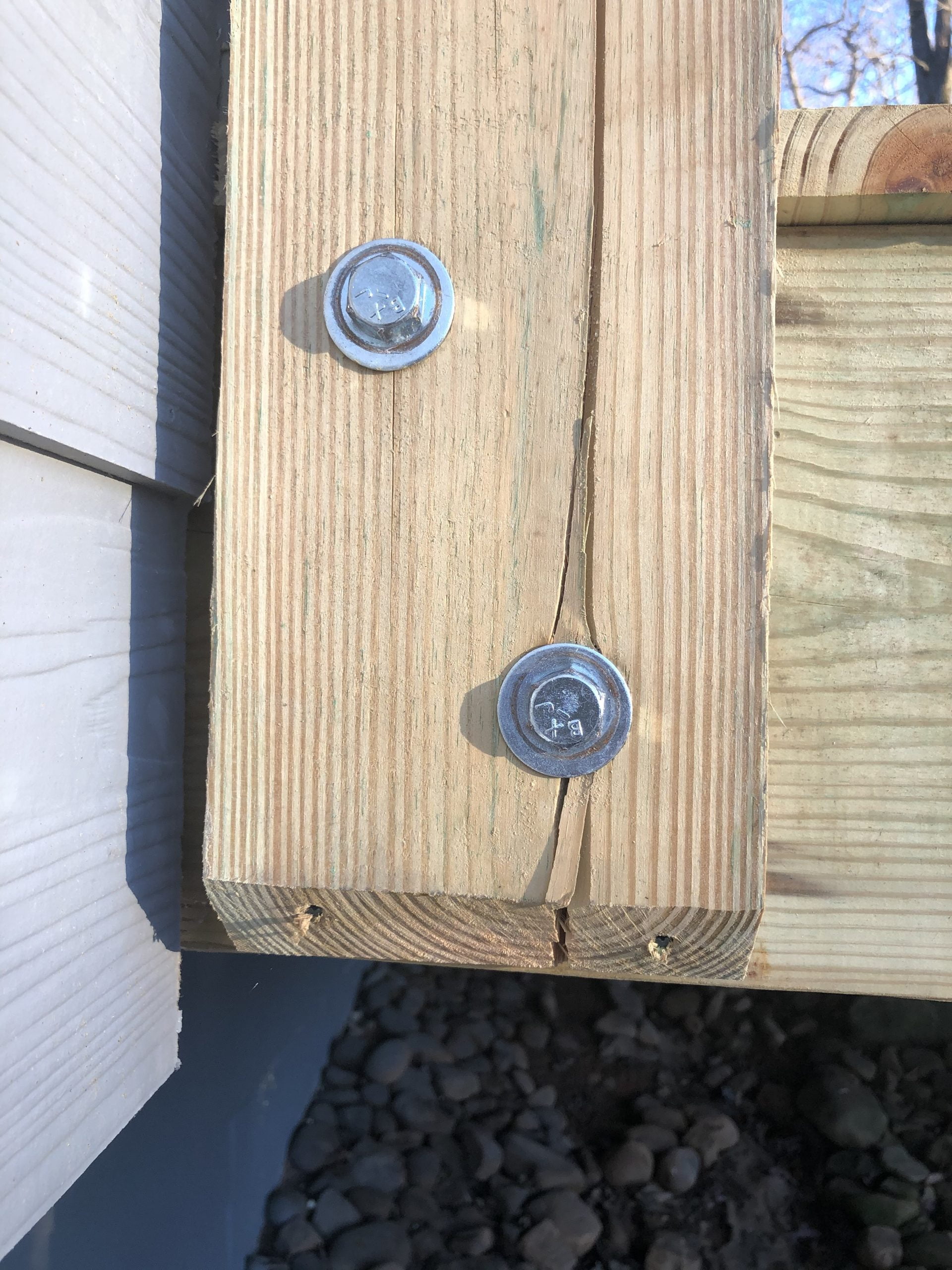

We had a new deck installed in November 2021 (we live in Georgia). The wood is pressure treated and it now has long cracks down the posts some of them look deep. There are some cracks on the deck boards as well. What should we do?
Nothing. Cracks are normal in decks. Just leave it as is. See here about new wood and staining: https://www.deckstainhelp.com/how-long-should-you-wait-to-stain-a-new-deck/
Even when it looks like this?
Yes, that is normal.

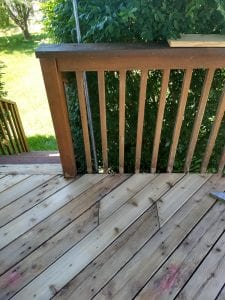

how can I restore this deck?
Pictures?

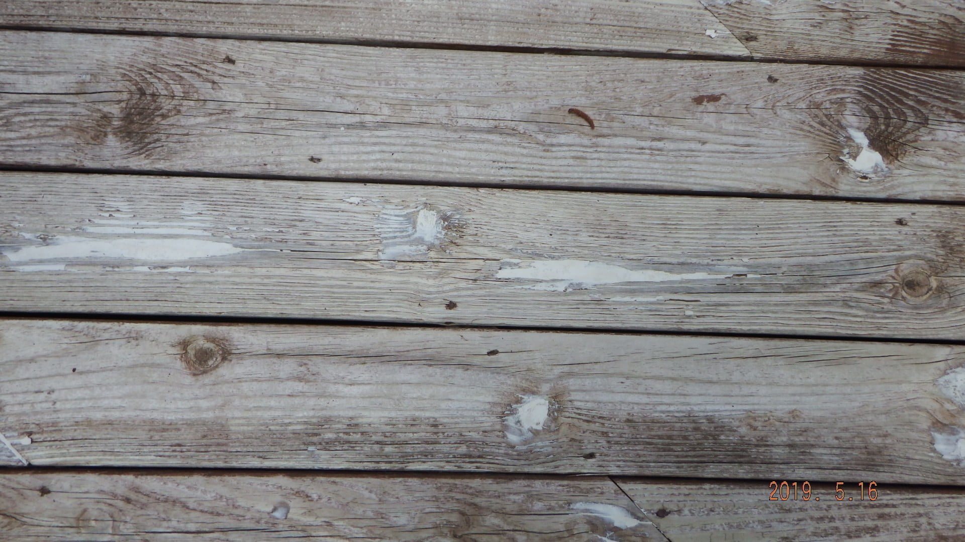

What can I use on the old boards before the solid stain is applied to fill in the weathered cracks? The replaced boards are obviously new and solid and I want them to blend better than they will as is; I’ve already purchased the solid stain it was mixed at Sherwin Williams.
It will not work. The filler will fail and crack out on exterior wood.

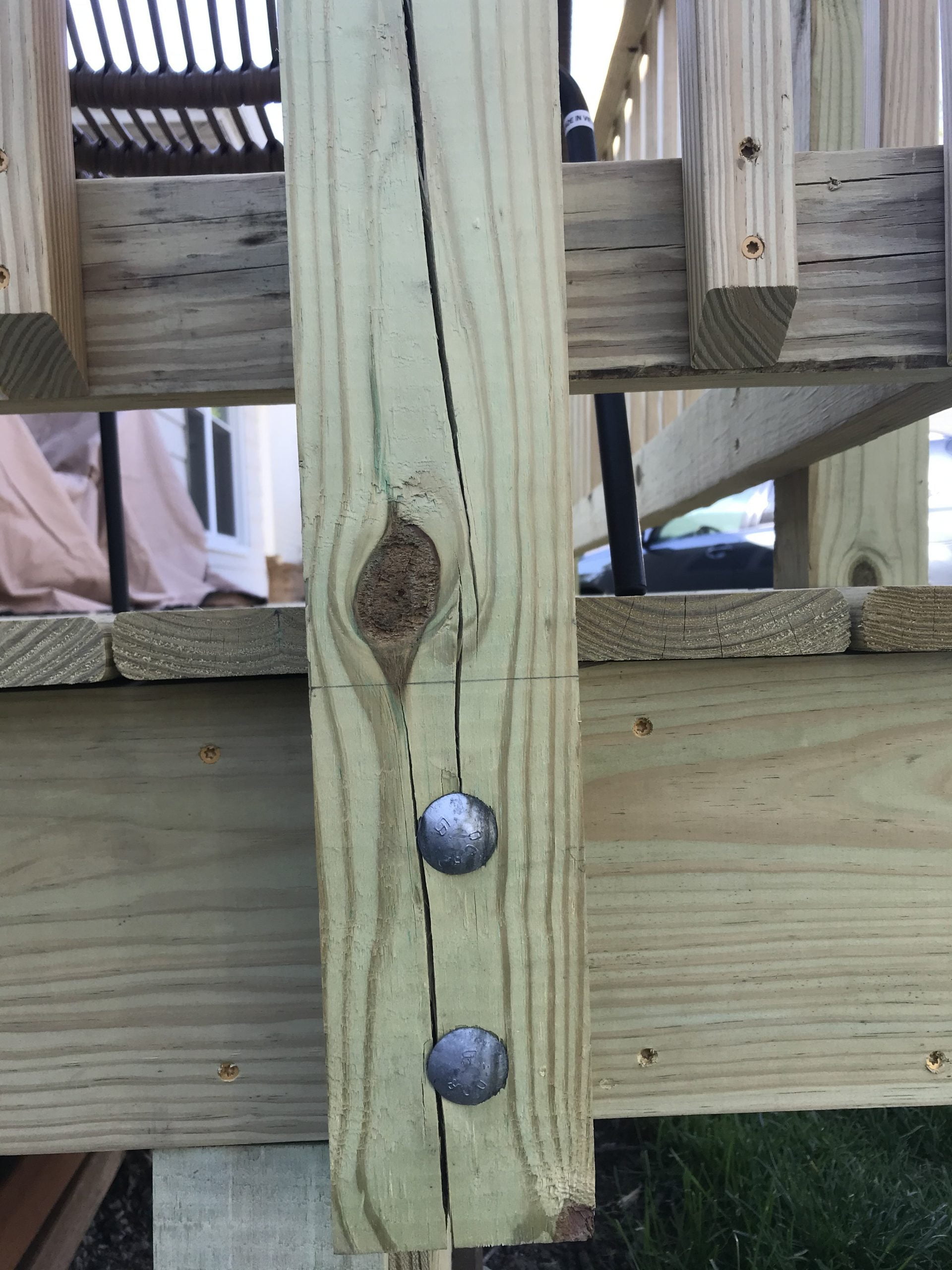

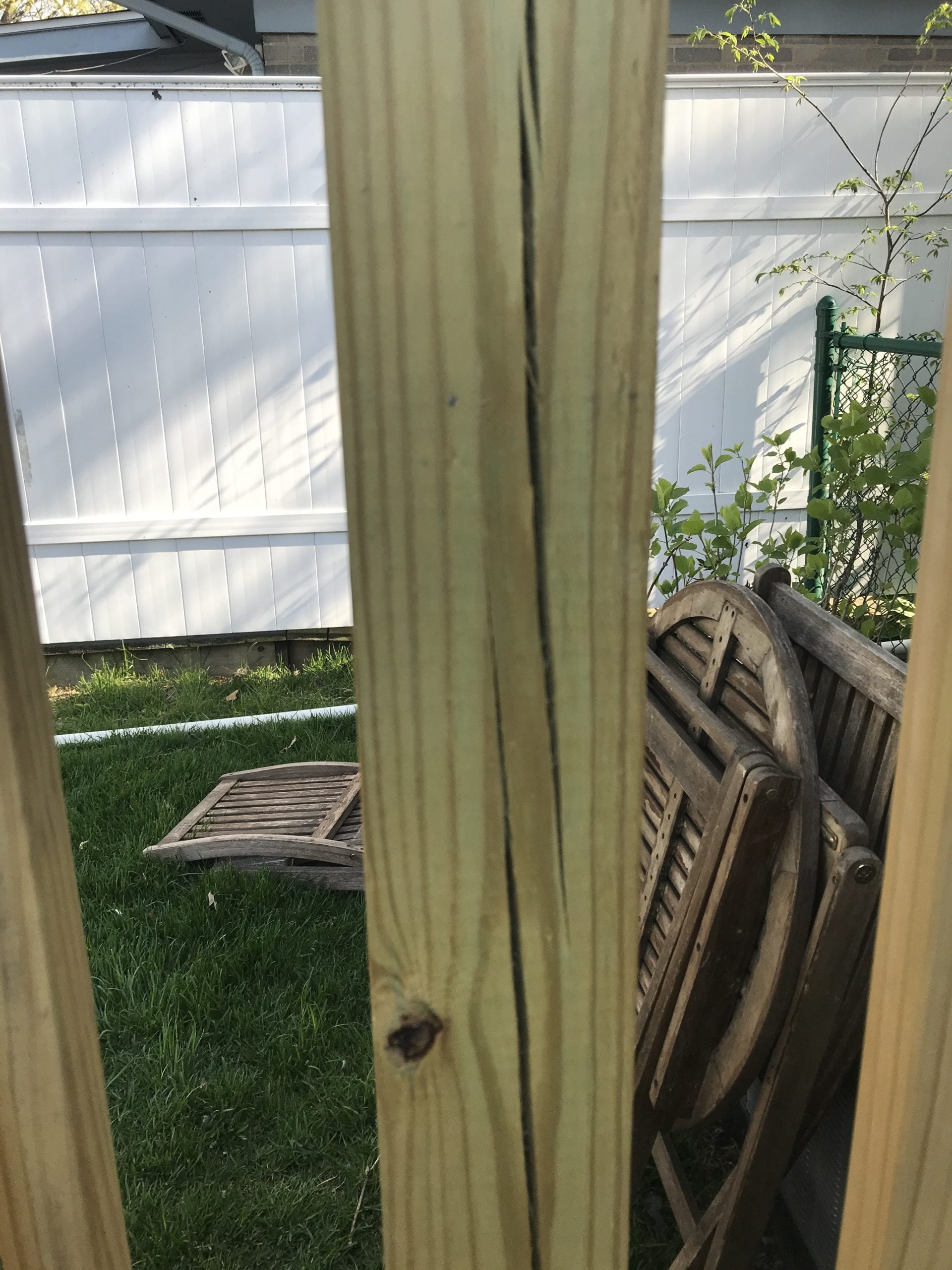

My deck posts are showing such cracks as in the pic. My contractor recommended to apply this exterior coating before painting/staining. Will this help for cracks to stabilize and not propogate faster and is it generally recommended to apply on the floor of deck before paint/stain?
Deckover peels and cracks are normal in wood. Just leave as is.

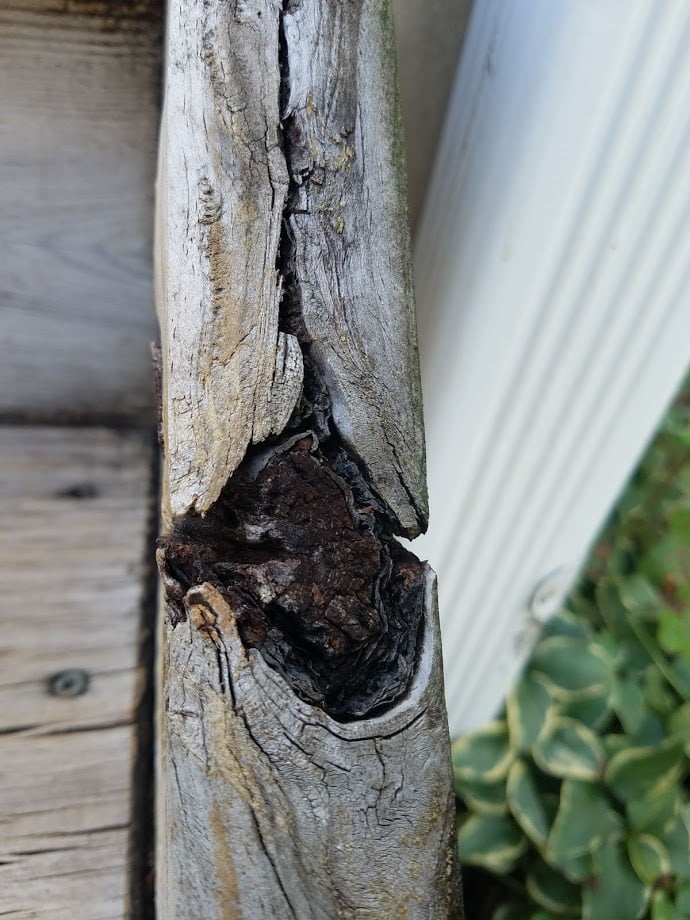

I have a main Cedar post on my deck that’s in concrete. It’s older and one side is chewed up due to a gate that was on it & pulled out over time. Can I add a thin cedar board over it? I notice some that are a 1/2 inch thick or less for indoor use.
Was thinking it might protect the holes from the weather?
Yes, you can wrap the post with cedar boards. This is very normal.

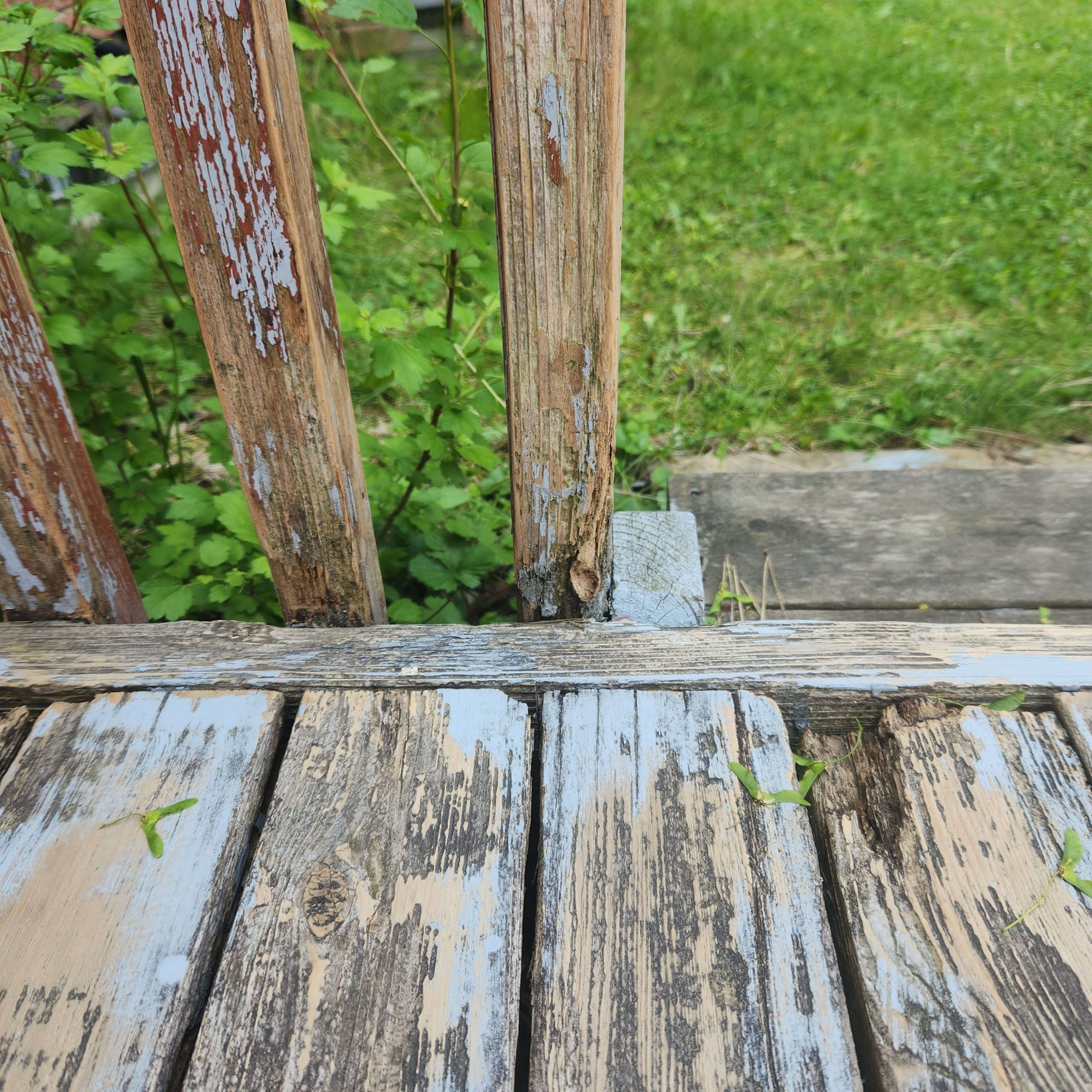

The only spots it has is where the boards end against a 2×10 on a ramp for wheelchair.
Is there anything I could put in the board end to prevent this from getting worse. Like an outdoor caulking etc ???? Thanks
It will not work well or stain to blend with the deck stain.

I have a deck project were there are some severe cracks on the main support posts. They are long and deep. Since fillers and caulk are not recommended, what can I do to prevent these cracks from getting any larger over time after I redo the deck…?? As of now, the deck will be re-stained with a dark brown colored stain. Also, I have read that you should not use colored stain on the floor of a deck but instead you should use a semi transparent. Is this correct…?? The homeowner wants the deck all the same. What is the best way to stain the floor so it lasts for several years….??
You cannot prevent cracks from getting any worse. If they are bad, then replace those boards. If you want a semi-transparent dark brown then look at TWP in Dark Oak or Armstrong Clark in Rustic Brown. Penetrating stains like those will not be prone to peeling like a solid stain. Just clean and recoat every 2-3 years,
Unfortunately the cracking is on the main posts and not the floor boards. The deck has a lattice roof and would be virtually impossible to replace without excessive cost involved.

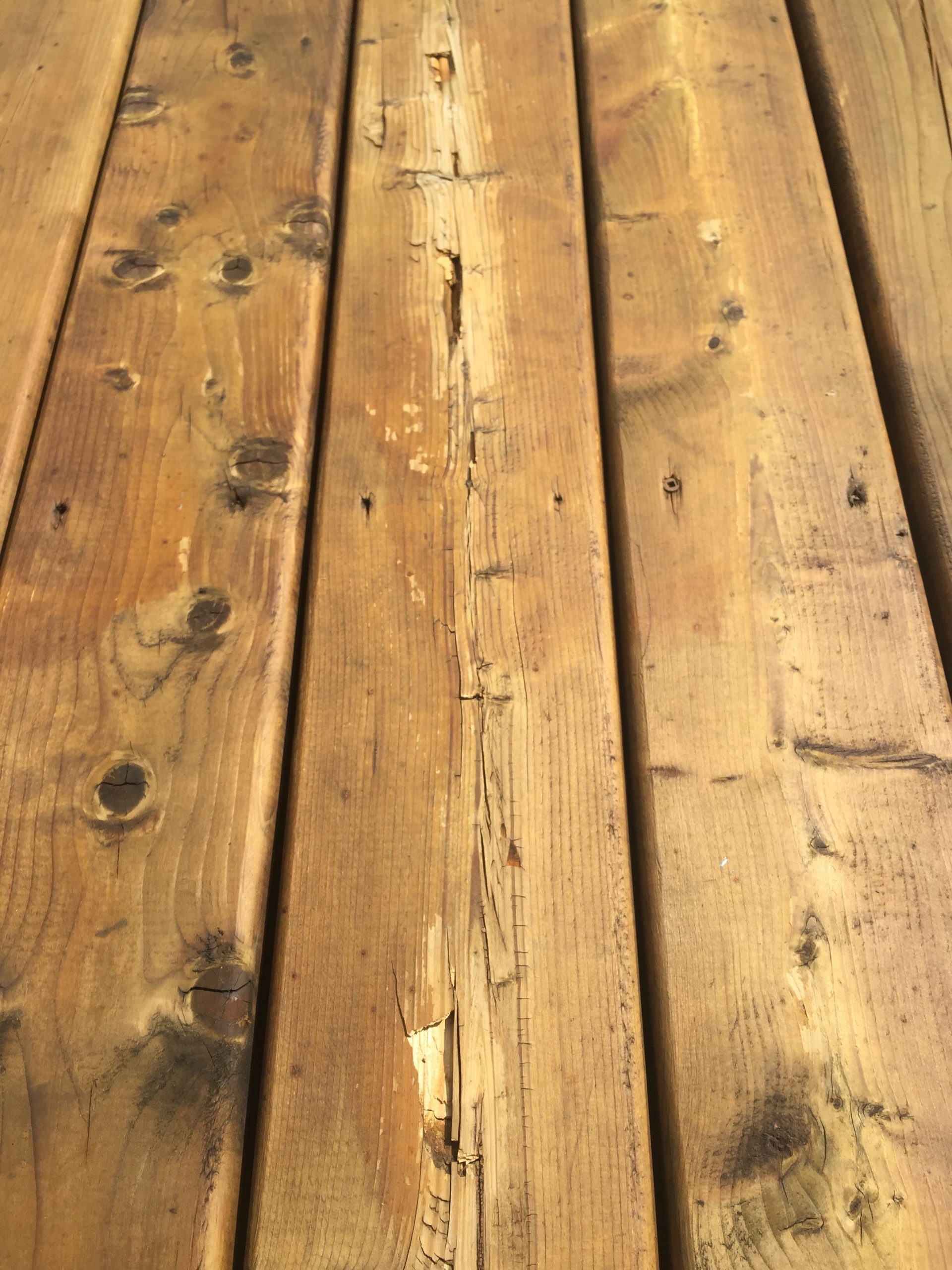

I have a deck board with removed splinters from a chisel. Would it be ideal to sand, then stain over those parts? Wood filler them? Or replace the boards? Climate is harsh winters.
Never use a wood filler on a deck when using a semi-transparent stain. Spot sand the areas, then strip all the deck down, brighten the wood, then stain.

i have 4 x 6 supporting posts on my wood awning that have developed surface splitting( not all the way thru). what do you suggest to use on these splitting surfaces?. I want to stop any further progress of this condition. the posts and awning are about 9 yrs. old.
Splits are normal for exterior wood. Just leave them as is. No harm will happen.

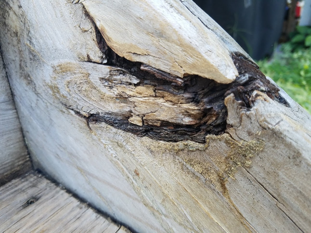

What do you recommend for a knot that has started to rot? I see you don’t recommend fillers but worried to just stain this area like the rest of the deck.
Any help would be greatly appreciated!
See Permafill by Gulf Synthetics. It is not stainable with a semi-transparent stain but it will work to fill your issues with your stair stringer.
