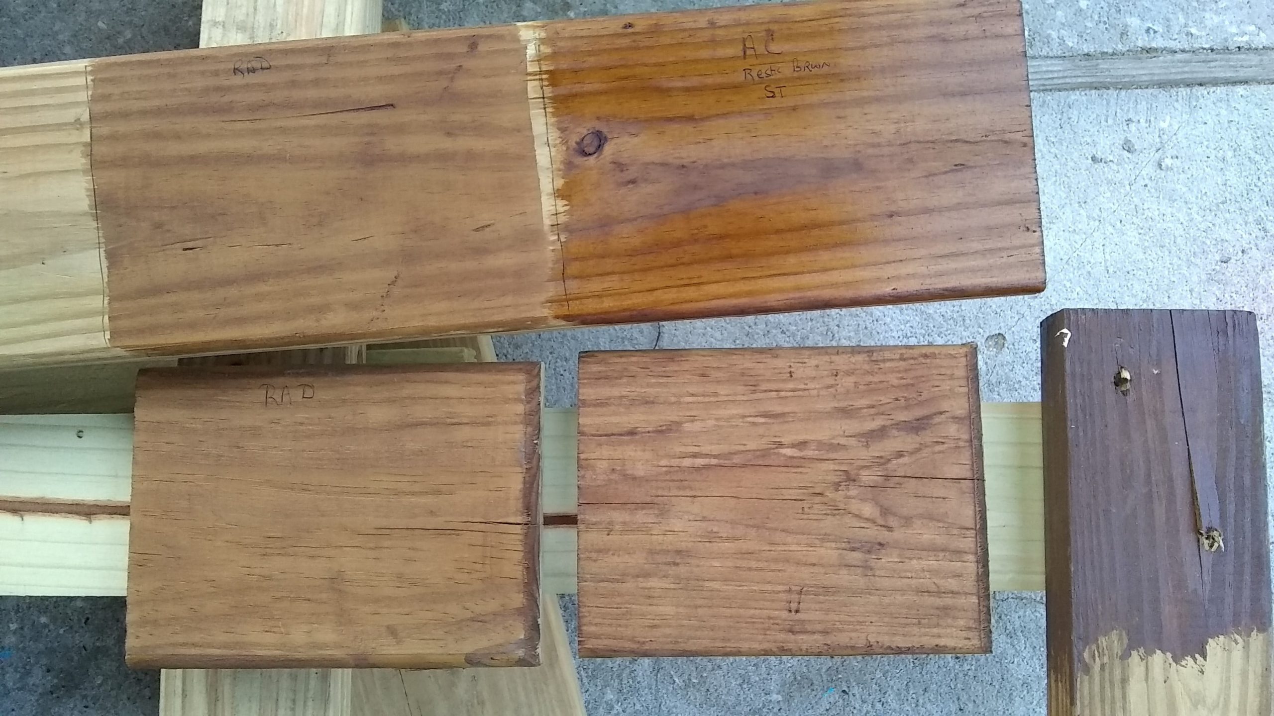

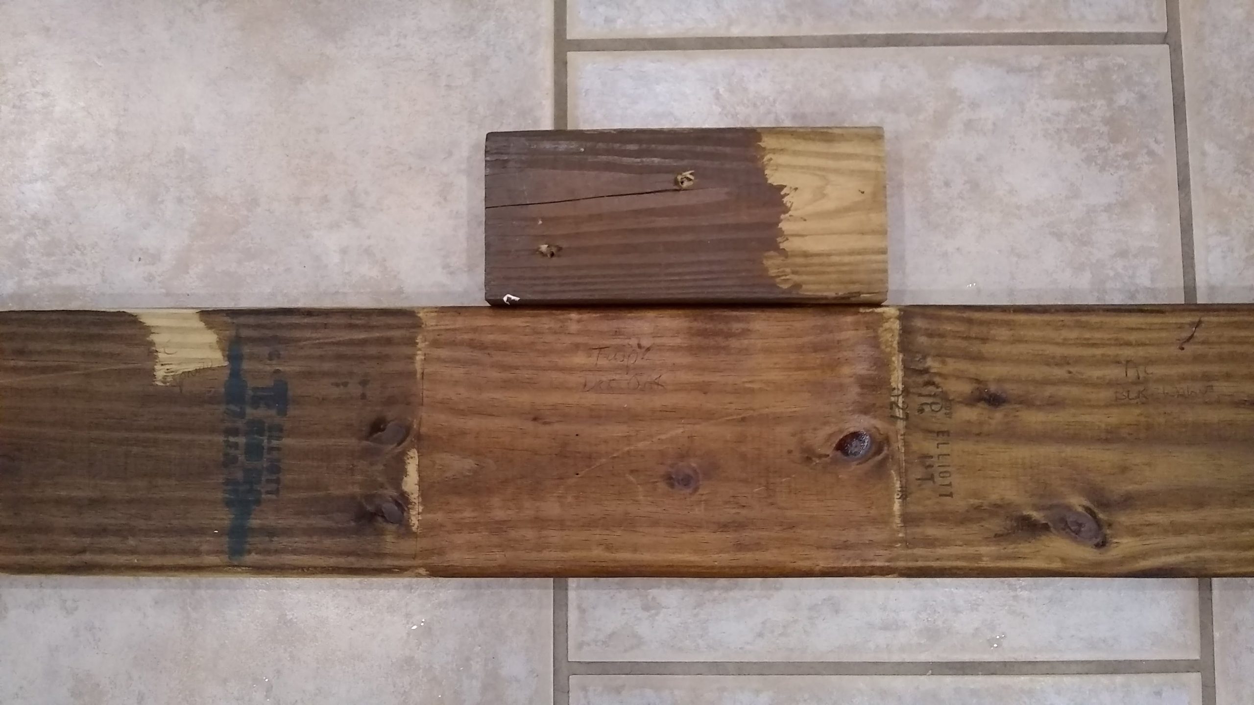

Right now I have a sample of the AC ST Rustic Brown which in the pic looks close to where I need to be, but applied it is very transparent and more red than brown. Also, this product seems to go on and just sit on the wood and not soak in. I tested it on 10 year old lightly sanded but not washed deck plank. It pooled on the top and got spots. I am assuming Mill Glaze?
Also tried the RAD Dark Oak sample on the same board. It soaked in much much better upon application, but was basically the same color and the darkest color available from RAD
I also have a sample of TWP Dark Oak 100 series, but not holding out much hope on the color.
Where can I get a Dark Color? I guess the AC Semi-Solids are out for my use (deck with steps and chairs). AC says I can mix colors, but could I mix the Rustic Brown ST with a darker semi s0lid. or perhaps there very dark Black Walnut Transparent … or just use that alone, but it too may be too light?
Here are the samples I have so far. Pic #3, RAD on Left in Dark Walnut (bottom same) / Center AC Semi-Trans Rustic Brown (bottom same not dry) / Far Right Olympic Maximum Semi-Trans Tobacco (where I’m trying to be). I have an older deck in back and staining 2 newer decks in front. Trying to match them close but not perfectly. And I dont want to use the Olympic if I dont have to.
Pic #1 is where it is going. Pic #2 is the deck Im trying to match, but one is in the front of the house the other in the back so it does not have to be perfect.
Any ideas? If I do a 2 coats will it darken? Or will the same color darker a year later in a refresh?
You can only apply one coat to new wood and yes the AC suggests waiting a year for their semi-solids. I would go with Black Walnut semi-transparent in AC. One coat this year and another in 12-18 months if needed.
Do not mix AC semi-trans and semi-solid for wood that is less than 1 year old.

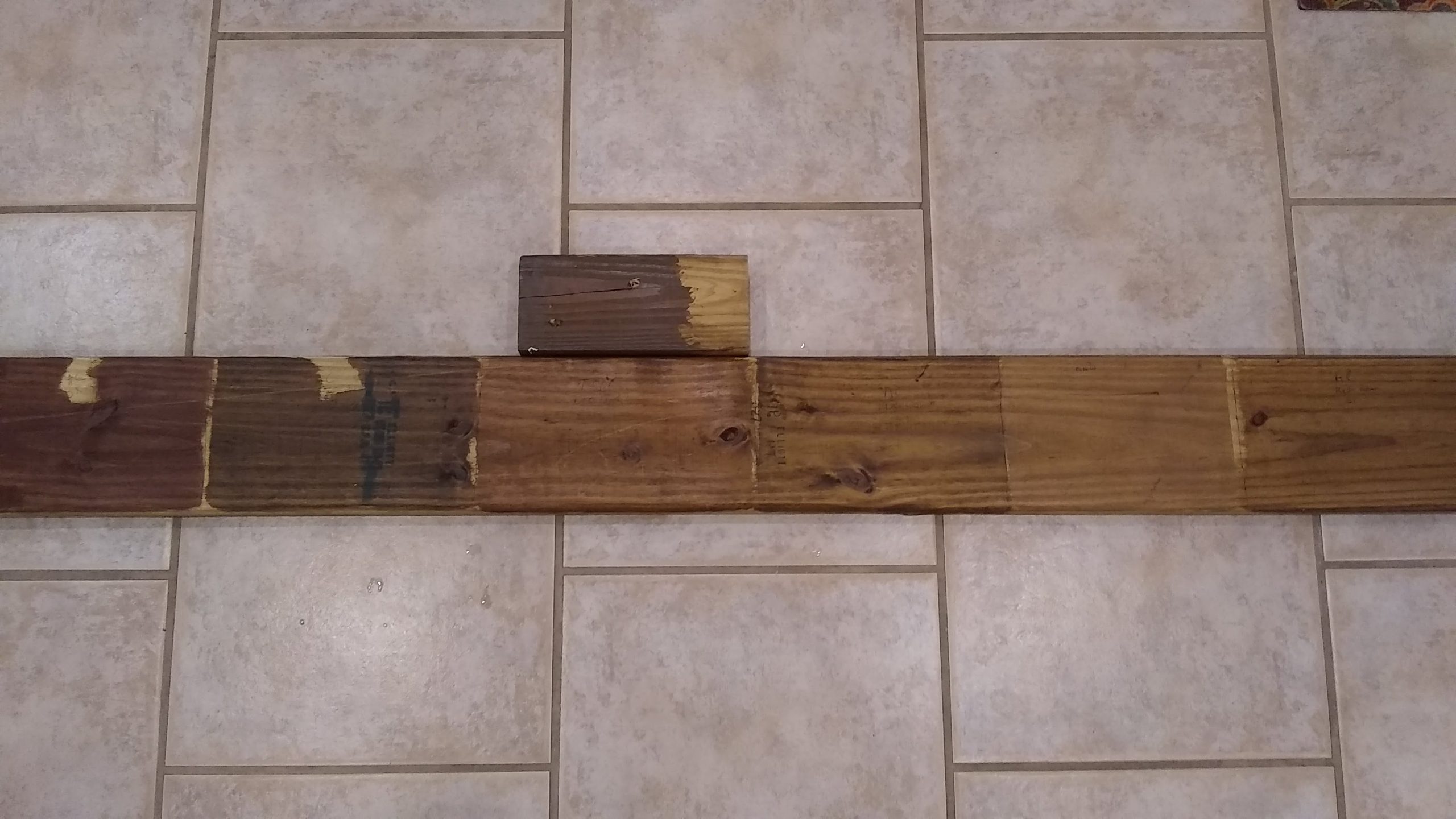

Here is my sample plate. Lone 2×4 is where I am trying to be – Olympic Maximum Tobacco.
Full aged deck board shot Left to Right: AC Semi -S Oxford Brn / AC Semi-S Espresso / TWP Dark Oak / AC Semi-T Blk Wlnut / RAD Drk Wlnut / AC Semi-T Rustic Brown
Close up Right to Left: AC Semi-S Espresso / TWP Dark Oak / AC Semi-T Blk Wlnut
I’ll do Blk Walnut on the new wood decks this year and Espresso next year.
I actually like the TWP as a product better. Seemed to go on better than the AC, but the Dark Oak is the darkest color I saw from TWP

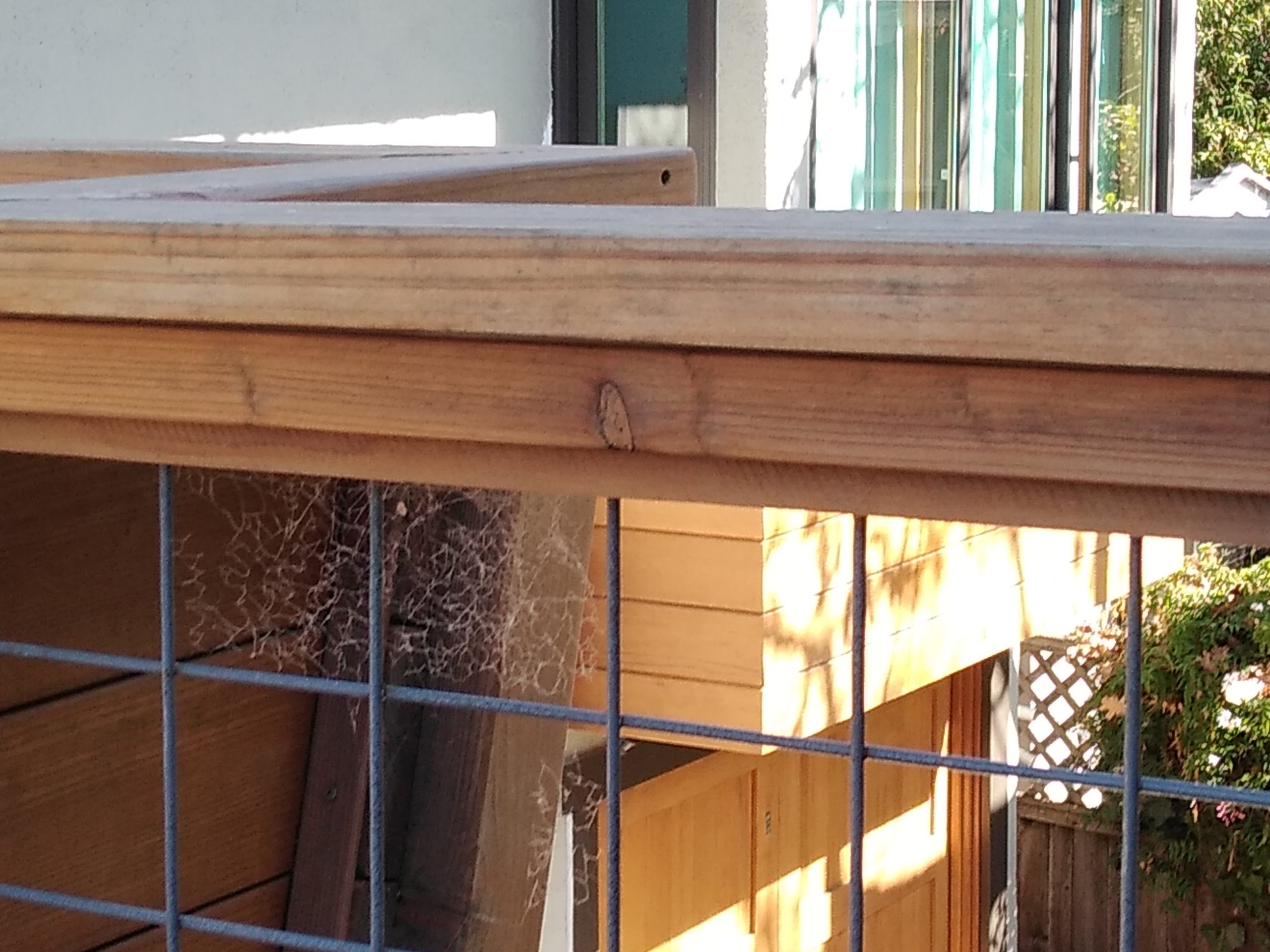

Completing the construction of adding a new redwood railing ( top/bottom rail approx. 50 ft. total and two 4 -step stairs ). I desire to retain the natural color. Since construction began the wood has discolored slightly due to the weather. Upcoming forecast here in So. Cal is rain from Wednesday 3/20 – 22/2019. My research on the best solution for treating the redwood has rendered the following; No Varnish/Urethane or Oil based finish with the exception of Quality oil-based finishes, including those based upon linseed oil, containing mildewcides, and are appropriate for use on exterior redwood. With this information what would you recommend for recapturing and retain the natural hue of the wood?
Marvin
Armstrong Clark would work very well for this. Any color that you like.

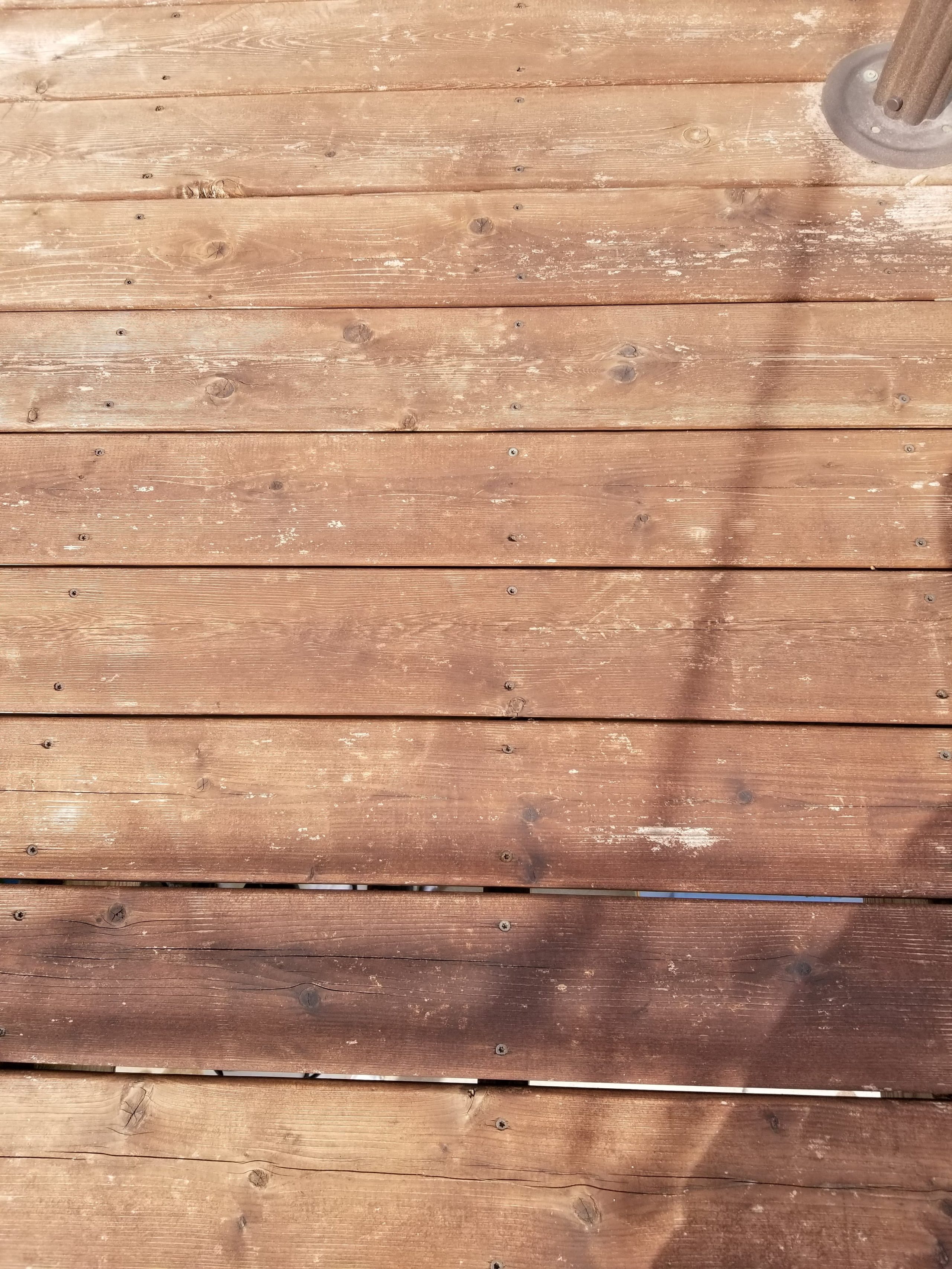

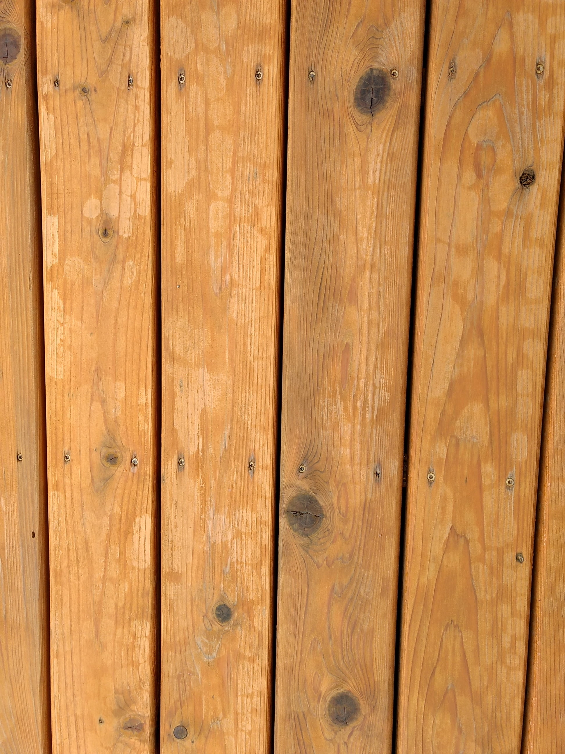

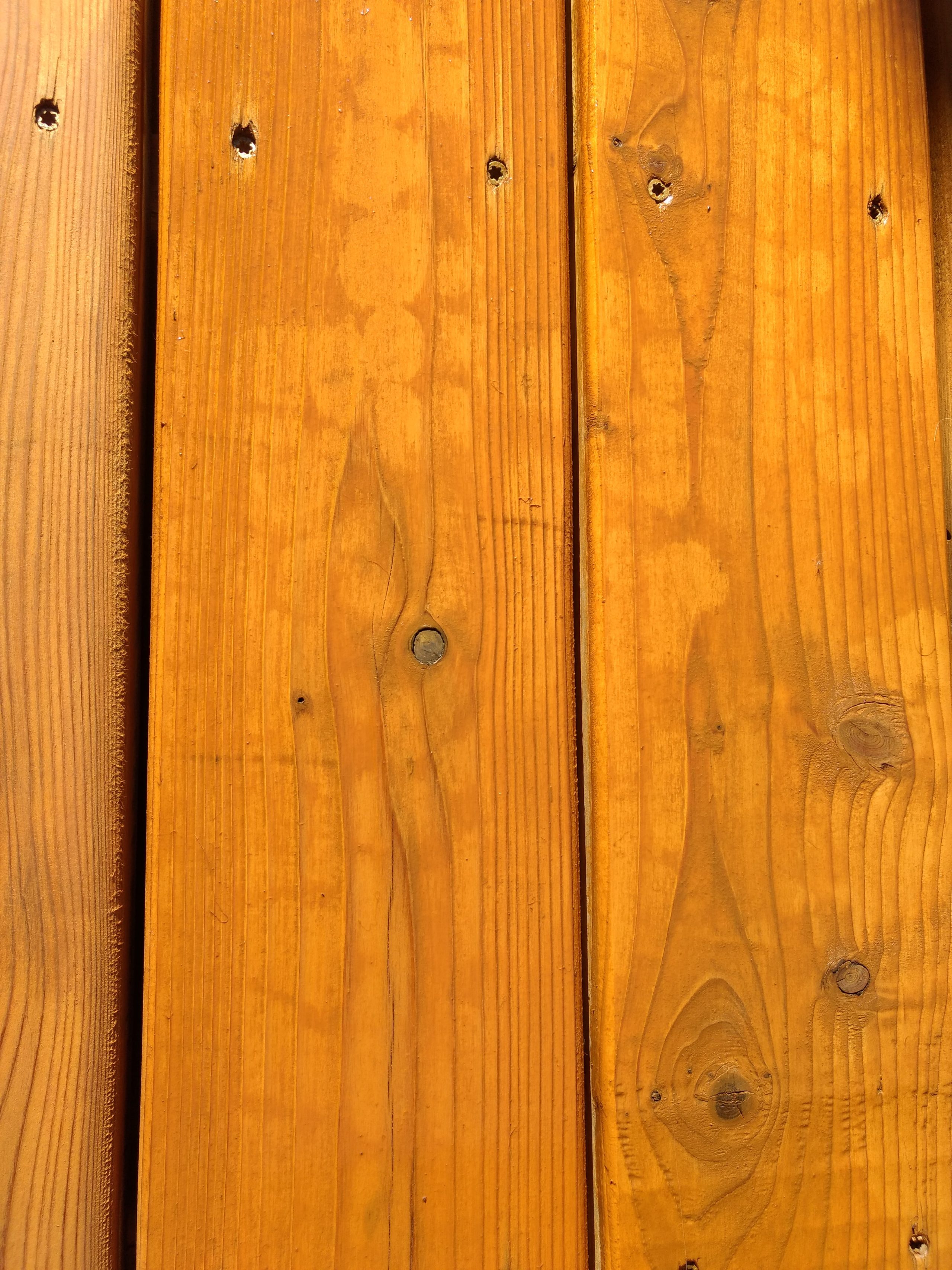

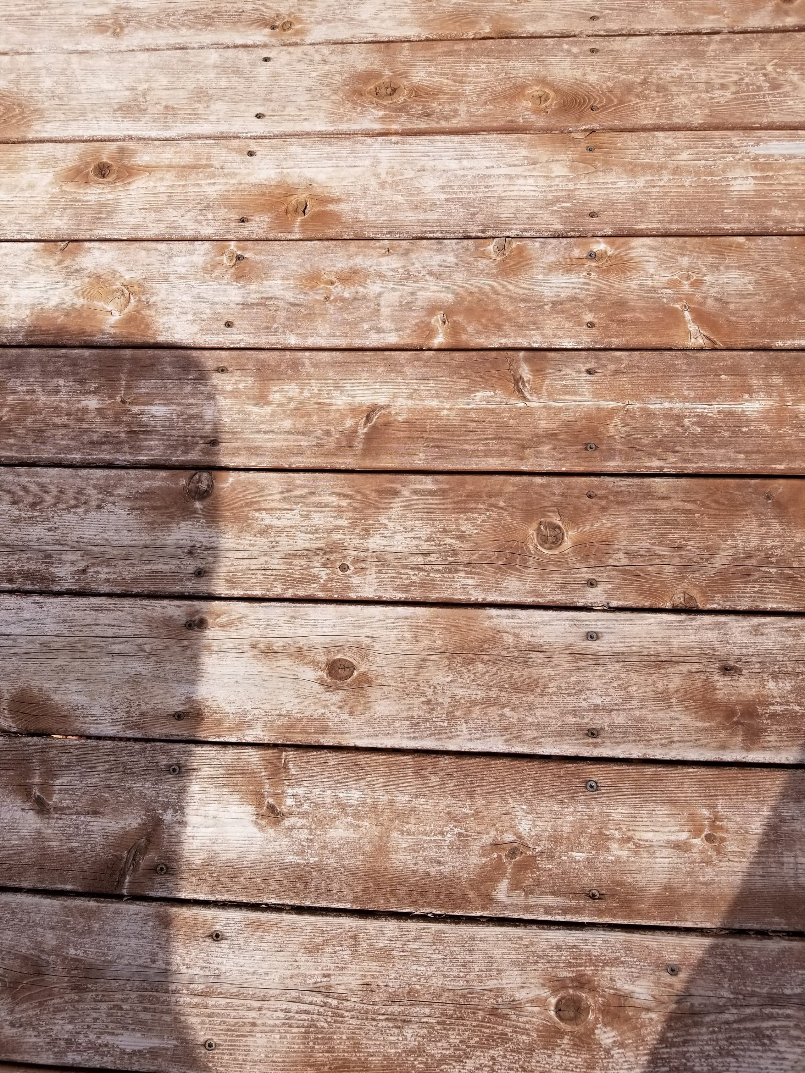

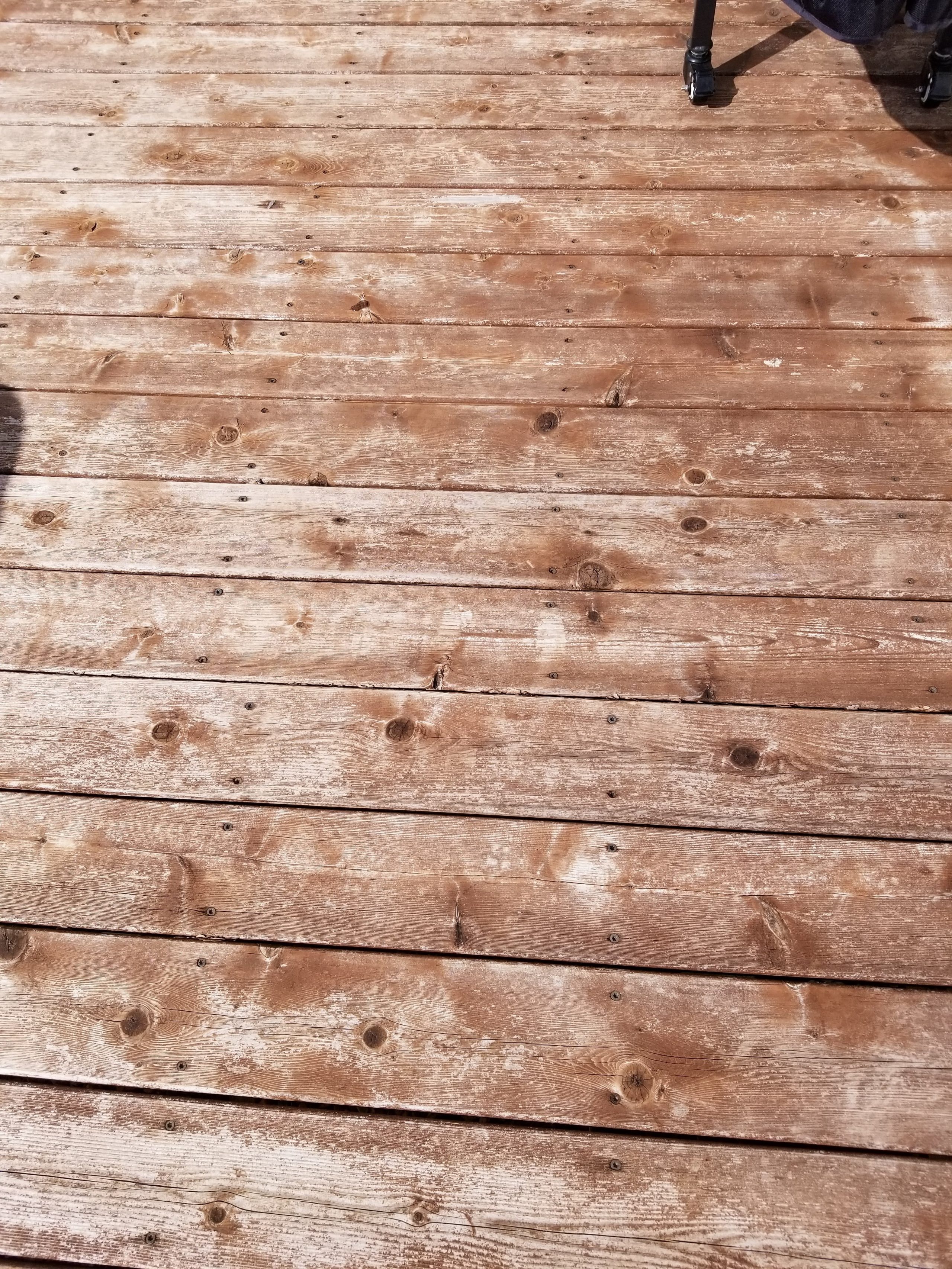

I applied the Armstrong Clark semi transparent stain in the color chestnut about 2 years ago. Part of my deck is covered all summer and that part has maintained the color rather well. But the other part of the deck is exposed to sun and has little stain left on them. I want to reapply the same color this year. Do I just have to use a cleaner and brightener then stain, or since there is such a variation of color on the boards should I do something else in addition to using a cleaner and brightener.
Can you post a picture showing the variation?
Here’s the pics
Use the Restore A Deck Cleaner and then the wood brightener while pressure washing for the prep of all the wood.
I guess I don’t understand what you mean. Do you mean I need to put the cleaner in my pressure washer then do the same thing with the brightener.
Directions are on the prep containers. They are used while pressure washing but not in the pressure washer.

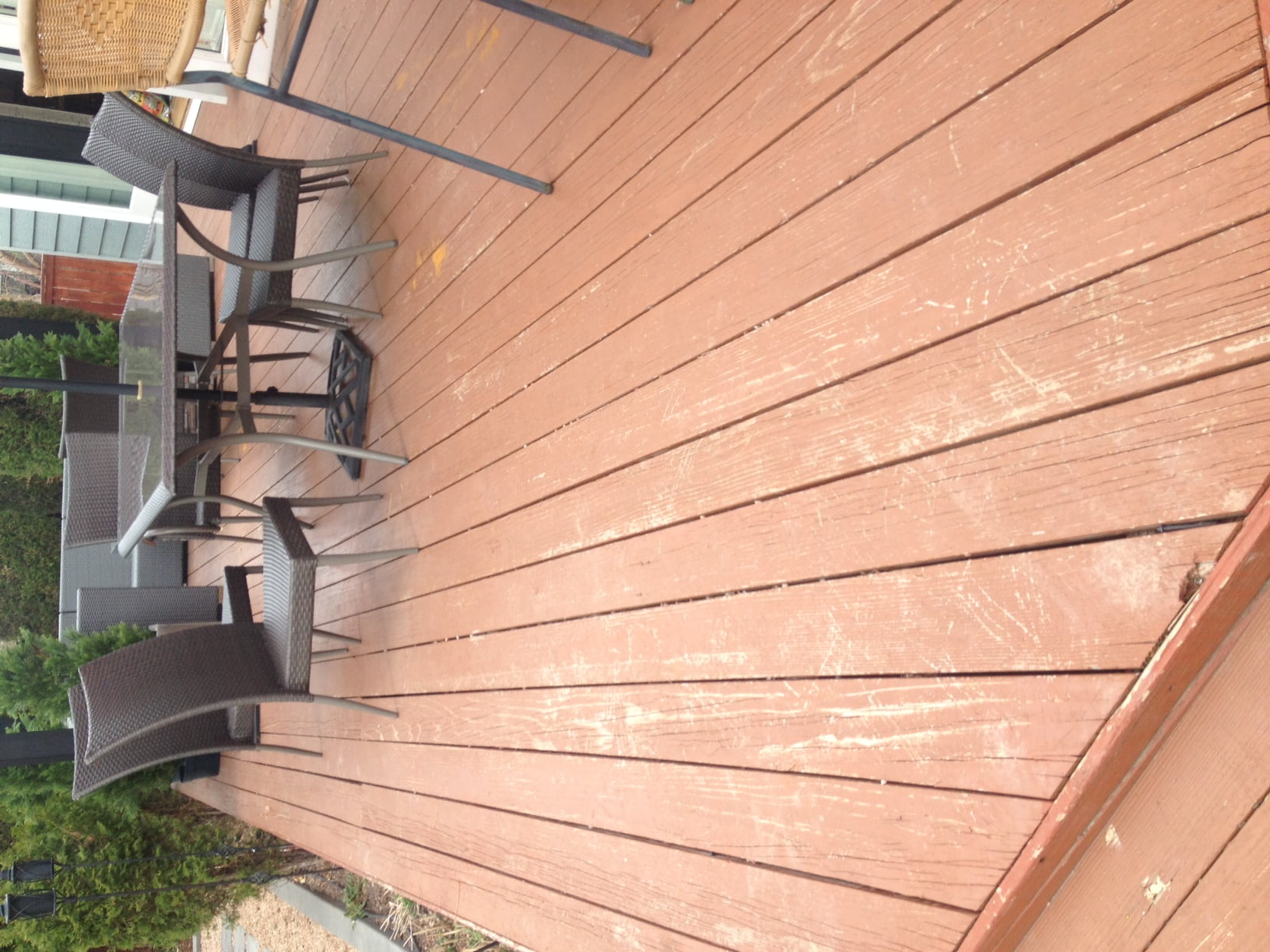

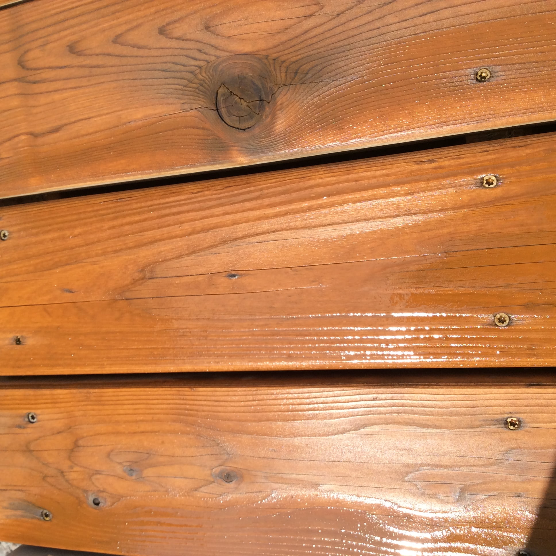

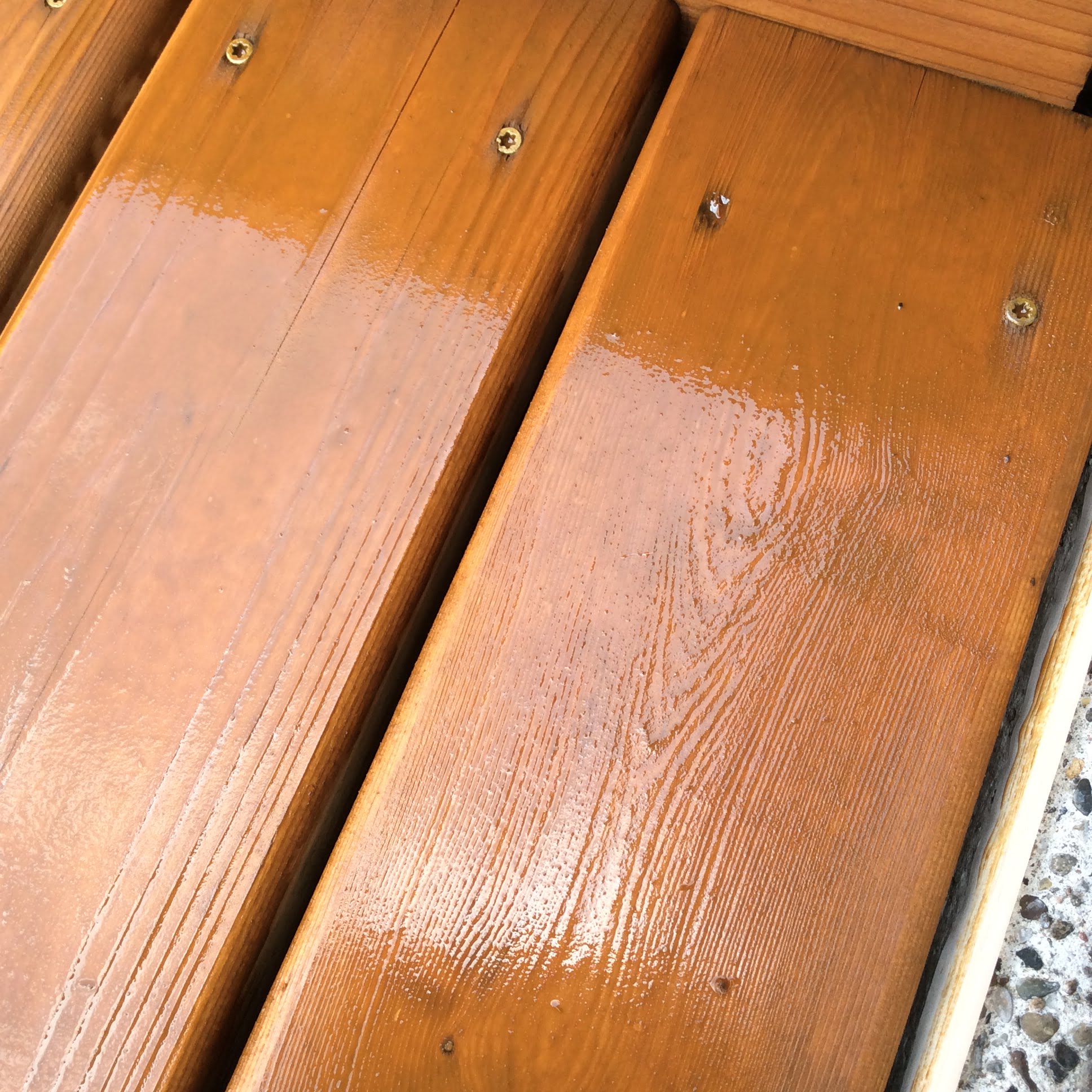

We applied per the directions about 10 days ago Spray then rolled out. No puddles, etc. It’s slick. Help.
That means it was over applied and possibly not prepped correctly. Try rinsing the excess stain off with a pressure washer. If that does not fully remove the excess stain, use mineral spirits and rags to wipe down the entire deck. Very important to saturate all oily rags in water when done and lay flat outside to dry. This avoids accidental spontaneous combustion.

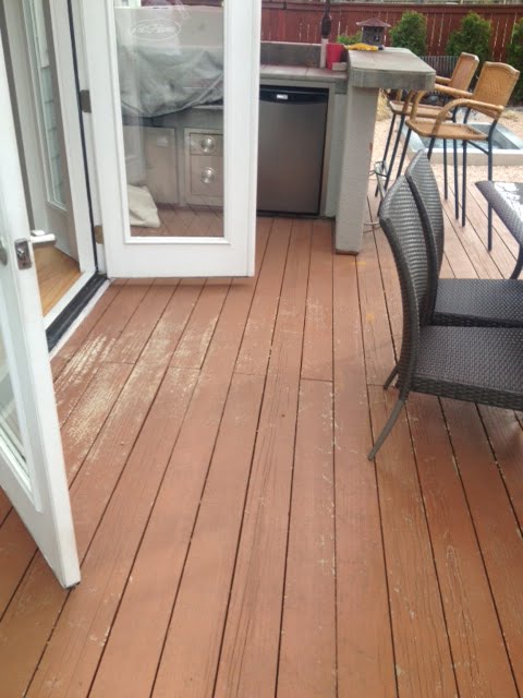

Had redwood Deck stained last year with a cheap transparent product, it has failed and I want to apply an oil based Mahogany from Armstrong and Clark, I am sanding the old stain and now the wood looks good to apply an oil stain, what about areas under the deck that are hard to reach, if I can get sand paper to it, will oil stain adhere to the wood
In these pictures, the old stain is not removed. You will need to remove this old coating fully before using a different brand like the AC. Try Stripping and pressure washing. Use the Restore A Deck Stripper/Brightener Kits.

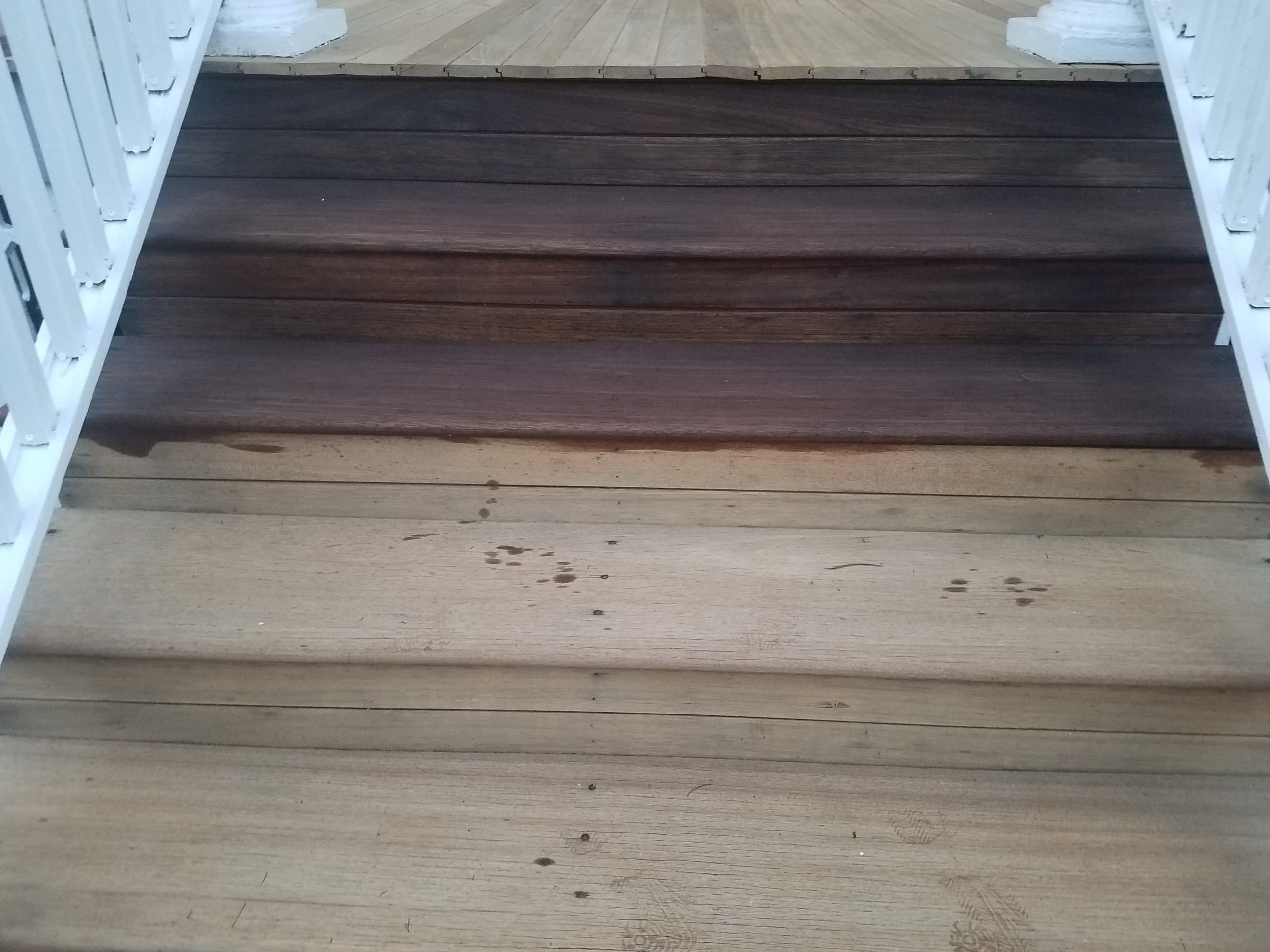

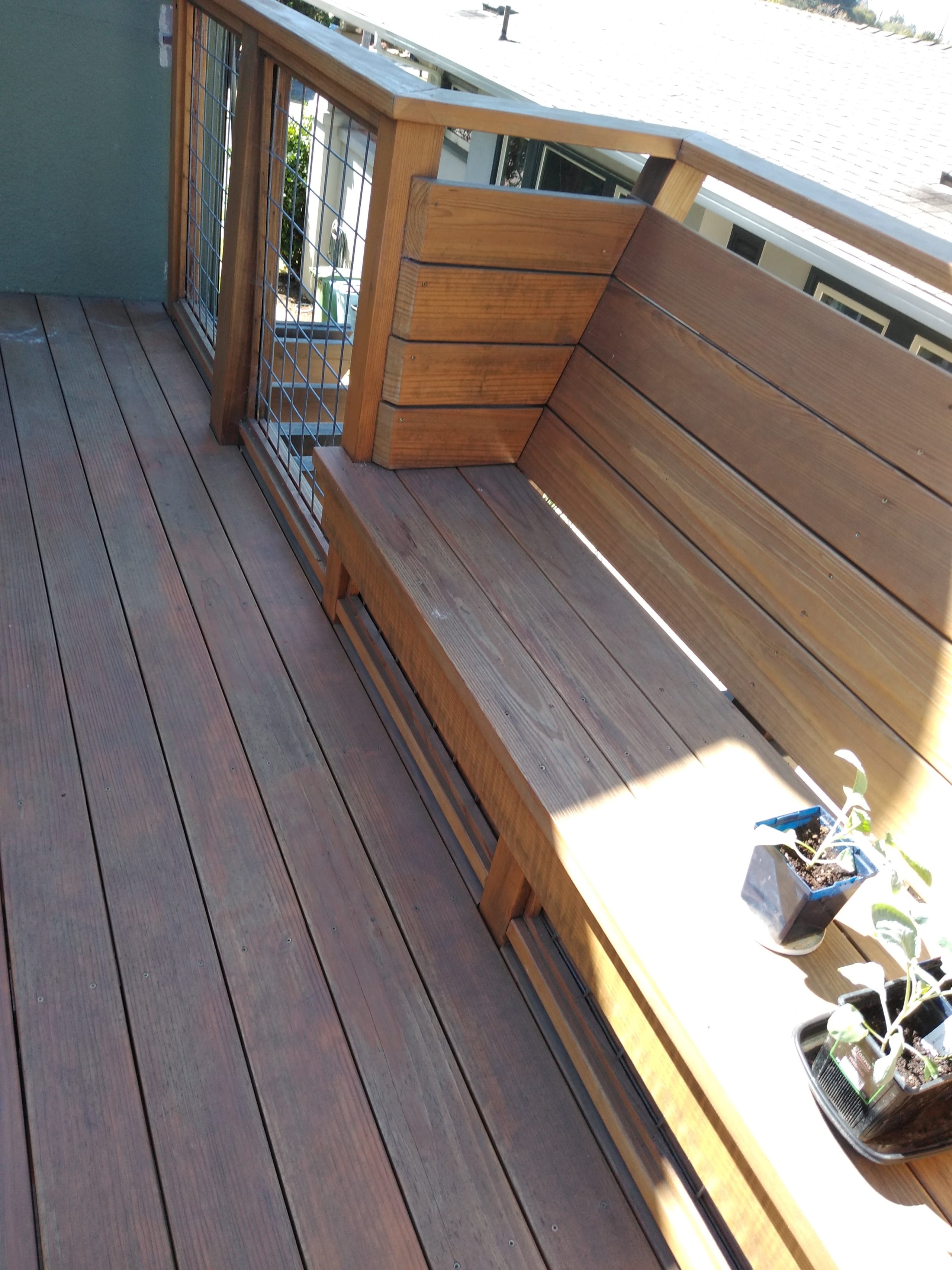

I stripped and belt sanded a nice old mahogany porch and purchased the AC transparent natural tone wanting the wood to show its true beauty. These are pictures when I applied to a couple of the steps on my porch. I must say for natural tone, this appears rather dark. To me that was ALOT of work to see these results hoping that natural tone would allow the wood to speak. Any suggestions?
That looks normal as the Mahogany wood is a dark red when stained.

My question is: Just finished sanding my redwood deck down to bare wood. Had to replace a few boards with new wood. sanded all to 60 grit. smooth not rough cut. Most of the old redwood is still darker than the newer wood. Would it be best to let the deck go thru the winter and rain in the unfinished state? and use a cleaner and brightener in the spring and then stain? will letting the wood get wet effect the outcome? If I sand again will I have to wait again or will the cleaner and brightener open the pores enough to stain. Planning on using AC semi transparent stain
Yes, you can do this. No need to sand again in the Spring.

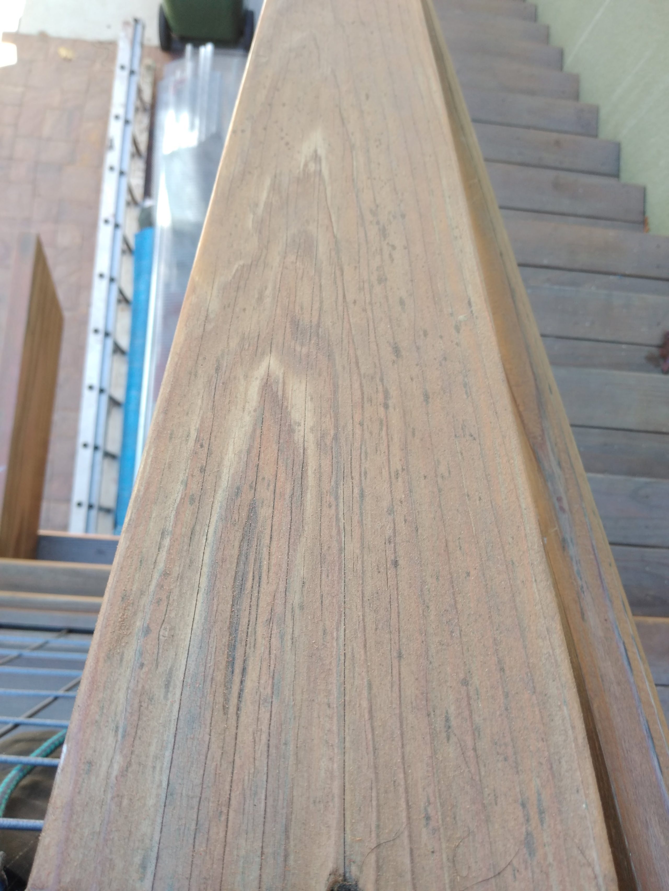

Another question in reference to my original question. The rains came last year so I never stained. I just did today after cleaning and brightening earlier this week. I stained with AC and a pad this morning 4-5 hours ago, and there is definitely excess stain still puddling in many areas. Since I can’t back wipe per your earlier reply, how do I get the excess puddling stain off?
Should I just run a dry brush over the whole thing?
Leave alone until tomorrow and then back wipe if needed.
I did as suggested and back wiped except I used a dry brush on a pole. There wasn’t really much to wipe as by the time I did it, it has almost all soaked in except a few areas that had a bit of gummy surface oil that wiped up. However, now I have an even bigger problem! The day after I stained, it rained! The can of AC says rain is ok 60 minutes after stain penetration. This DID NOT turn out to be true. The stain is now blotchy where water sat. (I did sweep the beaded standing water off but it sat overnight first). I have worked so hard to get this dang deck stained and I am hoping I don’t have to strip and restain. What do I do to fix this?
Try a light coat to even it all out.
ok, I used my moisture meter and it came out at 7% so I went ahead and brushed on a light coat in a test area. That didnt work as the spots are still there. Does this mean I have to sand the finish off completely and re clean, brighten, and stain?
crap
Picks of the stain I am referencing. Also one more question if I do need to brush up the excess stain do I wear socks or is OK to wear tennis shoes and will I leave tennis shoe tread marks all over if I do? I don’t want to mess up the stain by walking all over the wet areas and then tracking it elsewhere
You will not harm the stain when walking on it with shoes,

Hello we prepped our deck (power washed, deck cleaner and brightener) applied Armstrong semi-transparent stain onto dry neck using roller and brush. Stain dried fine. However once dry when we walk on the deck stain rubs off onto our feet. Two years later stain still rubs off on hands and feet. Wondering if we did not have stain mixed enough before applying? Ordered 5 gallon bucket. Two years later need to re-stain and want to make sure we are doing everything correctly so that the stain does not rub off this time.
You may have had issues with the prep not being done correctly and or back wiped off the drying oils which is a no-no.
It would be best to remove and start over. Strip and pressure wash. It will come off easily. Brighten all the wood after. Make sure to only apply the one coat and do not back wipe.
