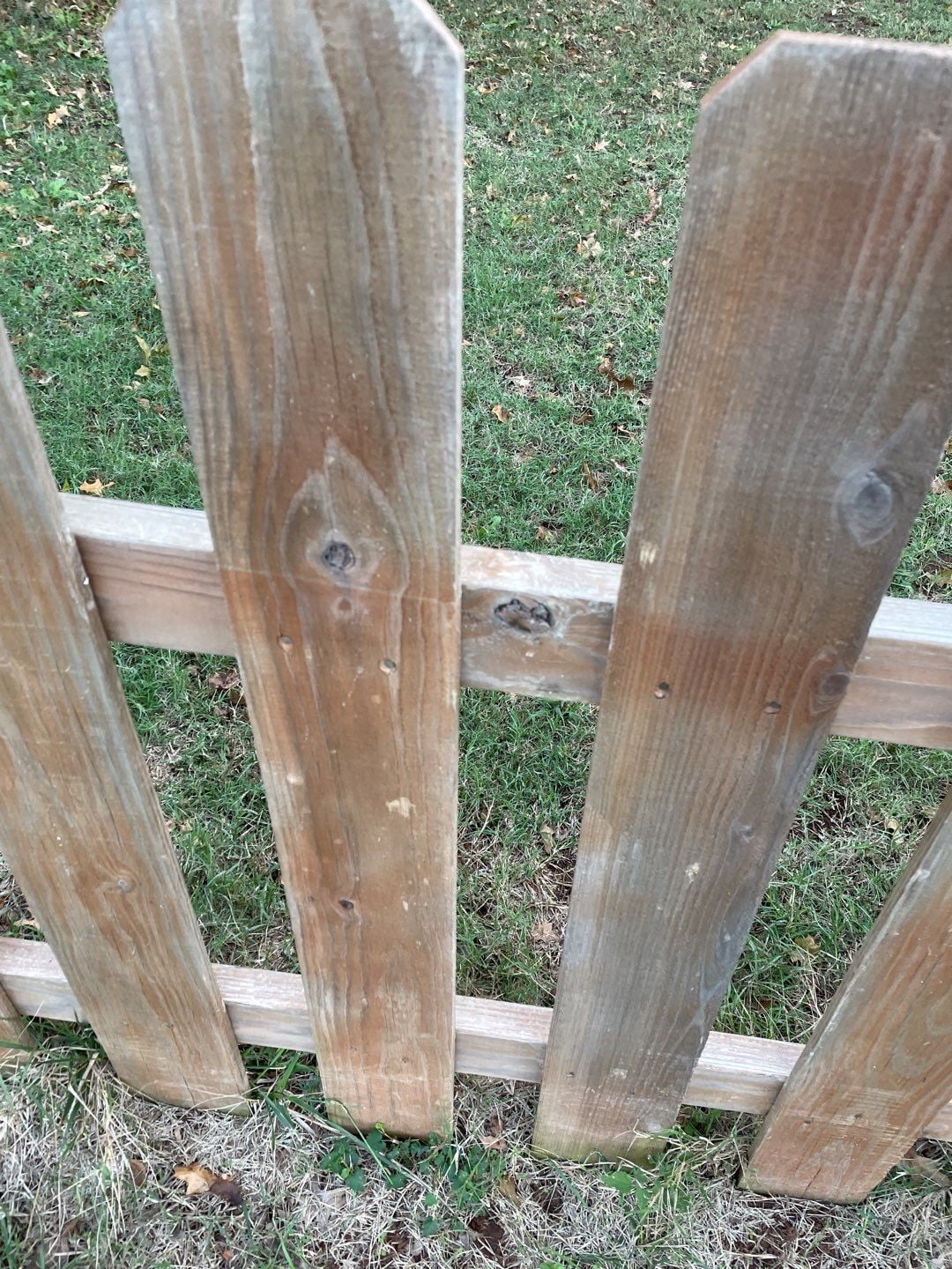

can you tell if a fence has been stained in the past?
