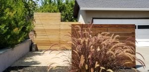

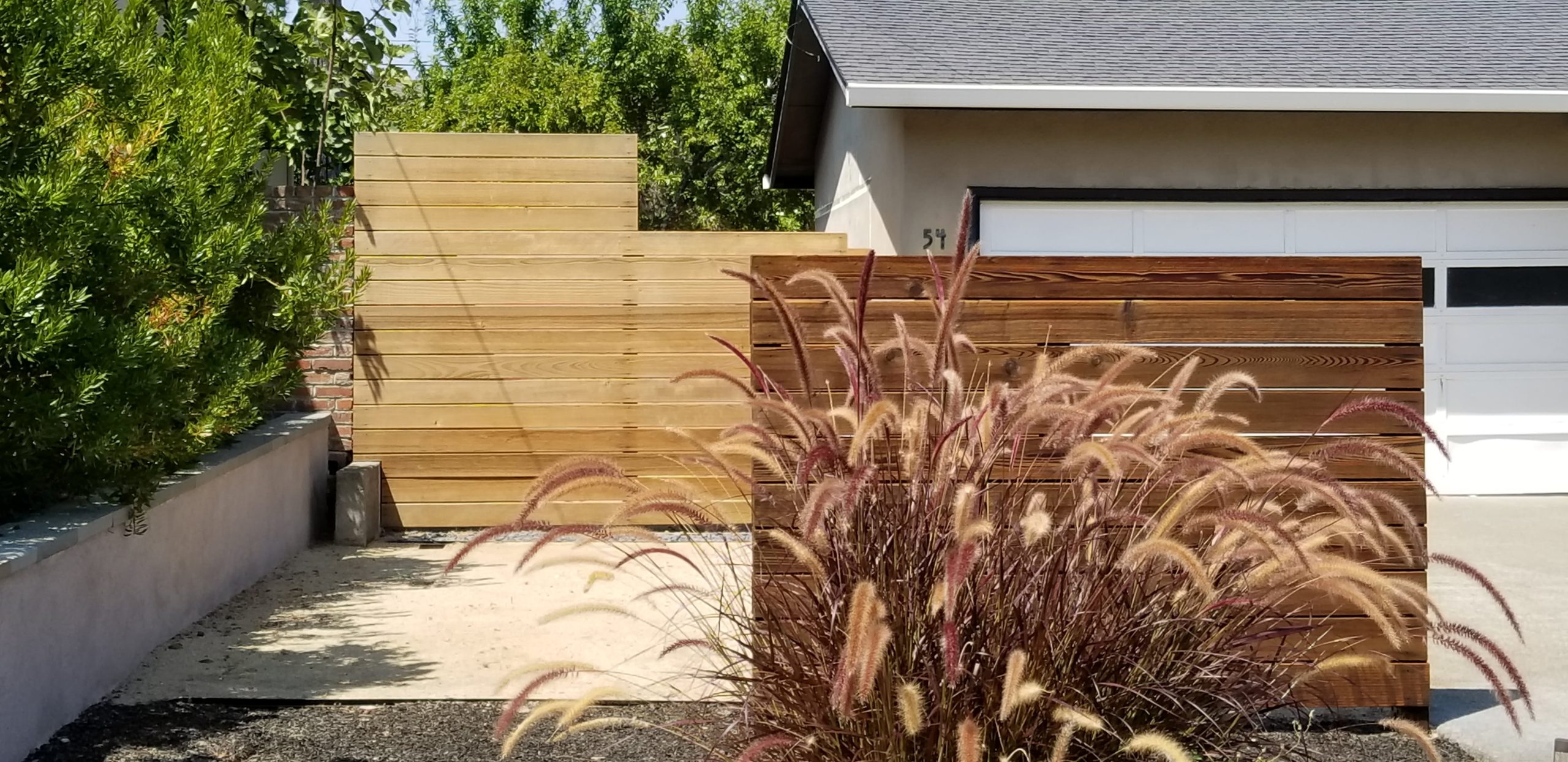

Picture, please.
Here is a pic of privacy fence (front) after Thomson’s Waterseal. It looked much lighter (like the back fence) after cleaning with Behr all in one wood cleaner.
Use the Restore A Deck Stripper/Brightener Kits.
