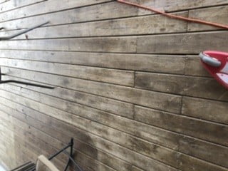

I have a 10 year old ipe deck that I generally clean and stain with Cabot Australian Timber Oil. Due to knee replacement surgery 3 years ago, I missed my 2-year cleaning. I used Penofin Cleaner but it looks like I need to do a second application as I can scrape crud off some of the boards with my fingernail. Is it okay to use Cabot wood brightener after the cleaning or should I stick with the Penofin brightener?
I will be using the Cabot product again for staining.
Peter
Pictures?
the first 2 pictures are before using Penofin cleaner, second 2 are after using cleaner. you can see the one board still has a lot of crud
You need to strip and brighten this for prep. Cleaner is not sufficient prep.
Interesting, Ive never stripped the stain before. If I use the Penofin stripper, will I need to use the cleaner again or go straight to brightener?
Can these be done one after the other or do I need to wait a day?
This is due to the very uneven appearance and random “black” stains. The end results will be much better.
Do you recommend applying a second coat of the Penofin Cleaner after using the stripper?
No need, just brighten after stripping.

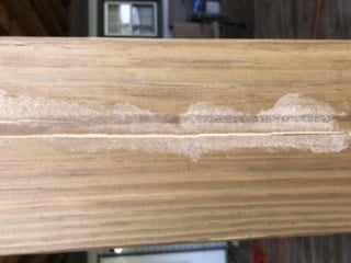

I’m going to stain my deck floor and the pillars supporting the covered deck. I believe they have both been stained before. The old stain isn’t peeling but still shows through lightly in some areas.
What do you recommend I do about the little bit of old stain and any recommendations on what stain to use for the pillars and deck floor?
What stain brand and type did you use? Pictures would help as well.
It was stained by the prior owner so I am not sure. Here are two photos. The pillar has had a crack filled in with stainable wood filler.
A wood filler will not work on a deck and it will not stain to blend either with deck stains.https://www.deckstainhelp.com/wood-filler-for-decks/
For the prep, use the Restore A Deck Stripper/Brightener Kits. Stain with the Restore A Deck Stains or the Armstrong Clark stains.

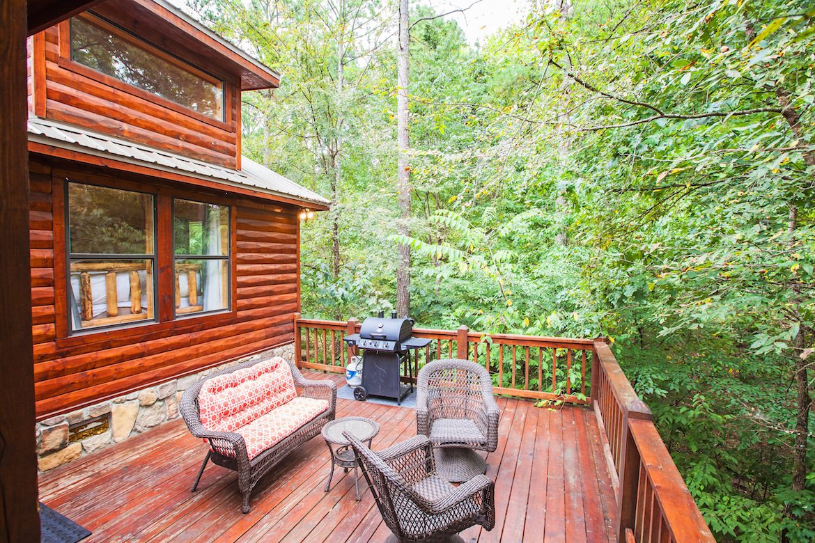

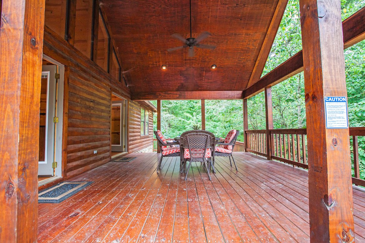

I have a 5 year old cabin, pressure treated wood stained with an oil based Sikkens transparent stain. It is peeling on the horizontal high traffic and sunny areas, and on a few vertical rails near the chlorinated hottub. Can I just pressure wash and apply new coat of Sikkens or do I need to strip it first? I want a durable finish for the horizontal finish, or at least one that can be reapplied in a few years without stripping again. What do you recommend? Are solid stains more durable than transparent or semi transparent stains? Have you seen anyone use solid stains on the horizontal surfaces and transparent or semi transparent on the verticals?
Best to remove all and use a penetrating stain: https://www.deckstainhelp.com/the-5-best-deck-stain-reviews-and-ratings/
If I strip and apply Restore A Deck water based stain, can it be simply cleaned and a new coat applied over it after 2-3 years (the TWP 100 review mentions it can be)? Do solid stains hold up longer than semi-transparent stains in horizontal sunny traffic areas?
Solid stains tend to peel in horizontal areas. The RAD Wood Stain can be cleaned and recoated as needed.
Here are pictures of the current deck
That is the shiny version of Sikkens. To remove and switch brands, you would have to sand it all off. It might be easiest to clean and reapply the same Sikkens so it matches your house.
I called Sikkens and they said I could use Flood Wood Stripper to strip the old off of the horizontal surfaces without sanding and then apply a single coat of SRD. I just want to make sure I am getting the information for a solution that works and can be accomplished over Labor Day weekend. Do have a better stripper recommendation?
I highly doubt that the Flood Stripper or any stripper will remove this. You will need to sand to fully remove.

We have a new 1year old seasoned PT pine deck. We live in southwest Ohio, in the Dayton area. Our deck is a covered deck, with one side and steps facing partial sun and blown rain. Just finished priming and painting all the rails, deck spindles and posts and were getting ready to stain. Here is our problem! To keep paint from getting on our deck while painting, my husband covered the necessary area with brown paper, BUT, taped it down with masking tape….oh lordy! Now we have the gummy glue from tape on our deck floor and a dark stain left from tape. How do we treat and get this glue off without damaging the deck floor? I sure hope you can help us. We are going to use Defy or Clark semi-transparent stain. Any suggestions is welcomed.
Sorry but no idea. Maybe Goof Off?
Tried Goof Off and it did not work. Worried, if sanding off, stain would not cover the sanded area.
Stain would cover the sanded area provided you sand it with the same grit sandpaper as you sanded the adjacent wood pieces when you originally stained the deck. Also, you will have to do full boards. Do not try to stain only a portion of any single board. It will never match. Sand the whole board and restain it. Take the board off if you have to and just reattach it after you sand and stain it.
