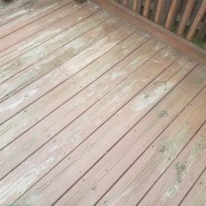

Thanks for the review on DEFY. The stain stripper and then brightener really did the job. We have a 600 + square foot deck, stained after a new build with Penofin (at the recommendation of a contractor and another knowledgeable person). 2 1/2 years later, the finish was peeling, and needed to be removed. After doing research on this site and others, decided on Defy liquid stain stripper and Defy brightener. It was stripped and cleaned and brightened today, see the photos to see the difference. Stain (with Armstrong) will be done early next week.
Deck after stripper and brightener
Jan Mc
Reply to  Jan Mc
Just FYI… In the product stats, it says that this product sells for $19.99 per gallon. We had to buy from Amazon, because we could not find it locally anywhere. It is $34.99 per gallon on Amazon. Used a little less than 3 gallons for the deck.
