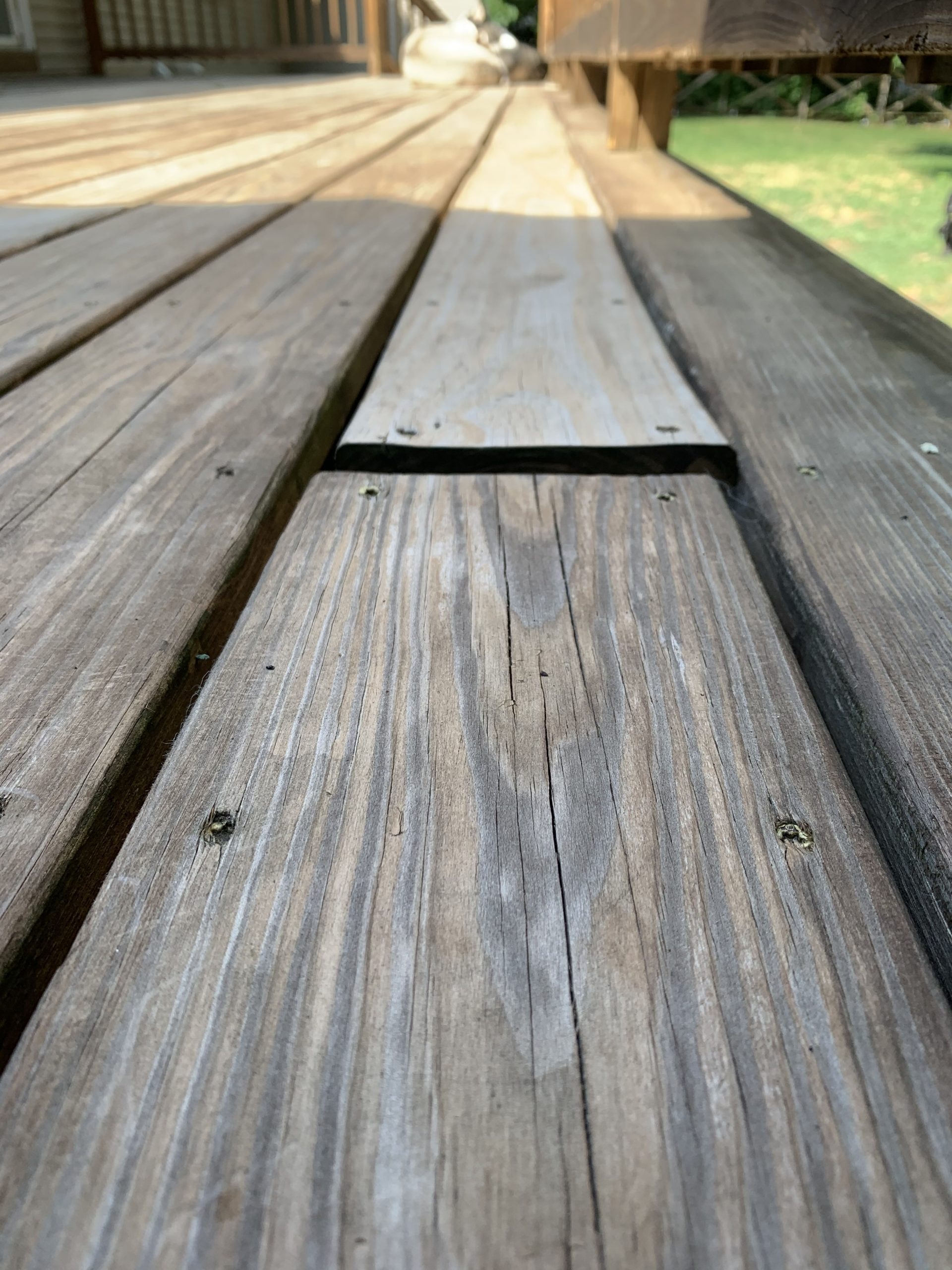

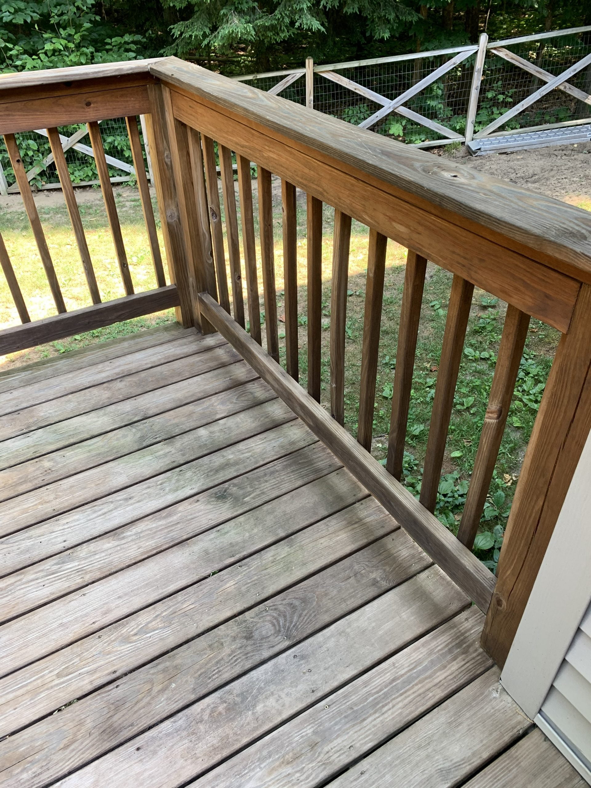

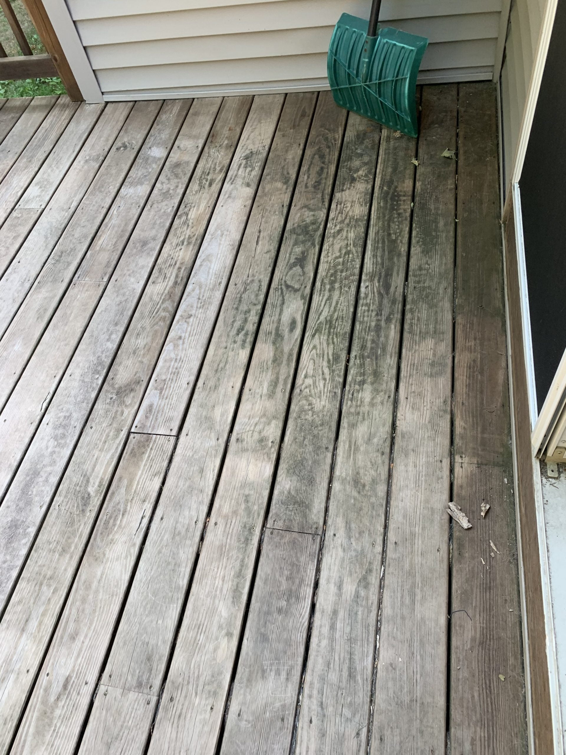

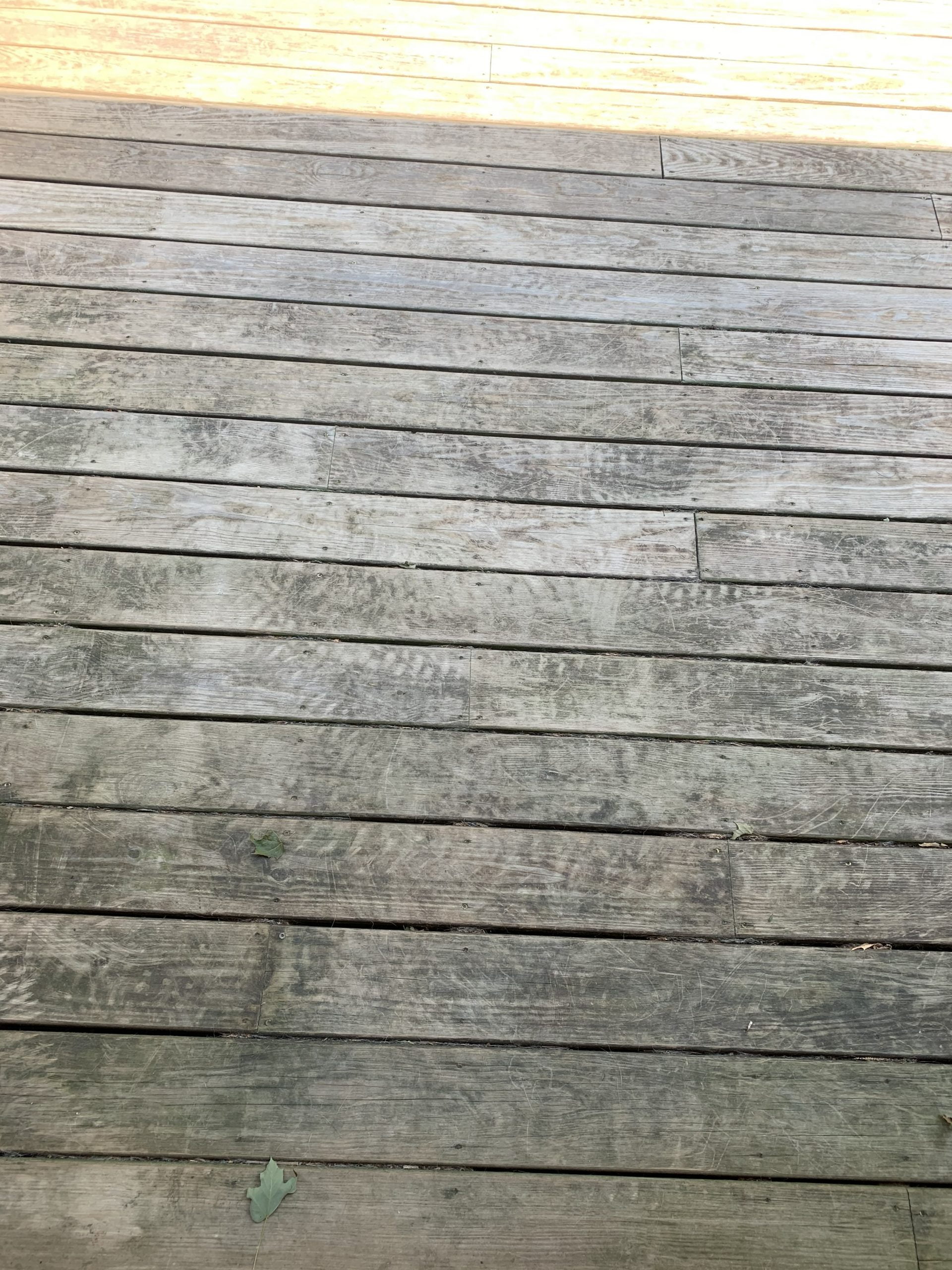

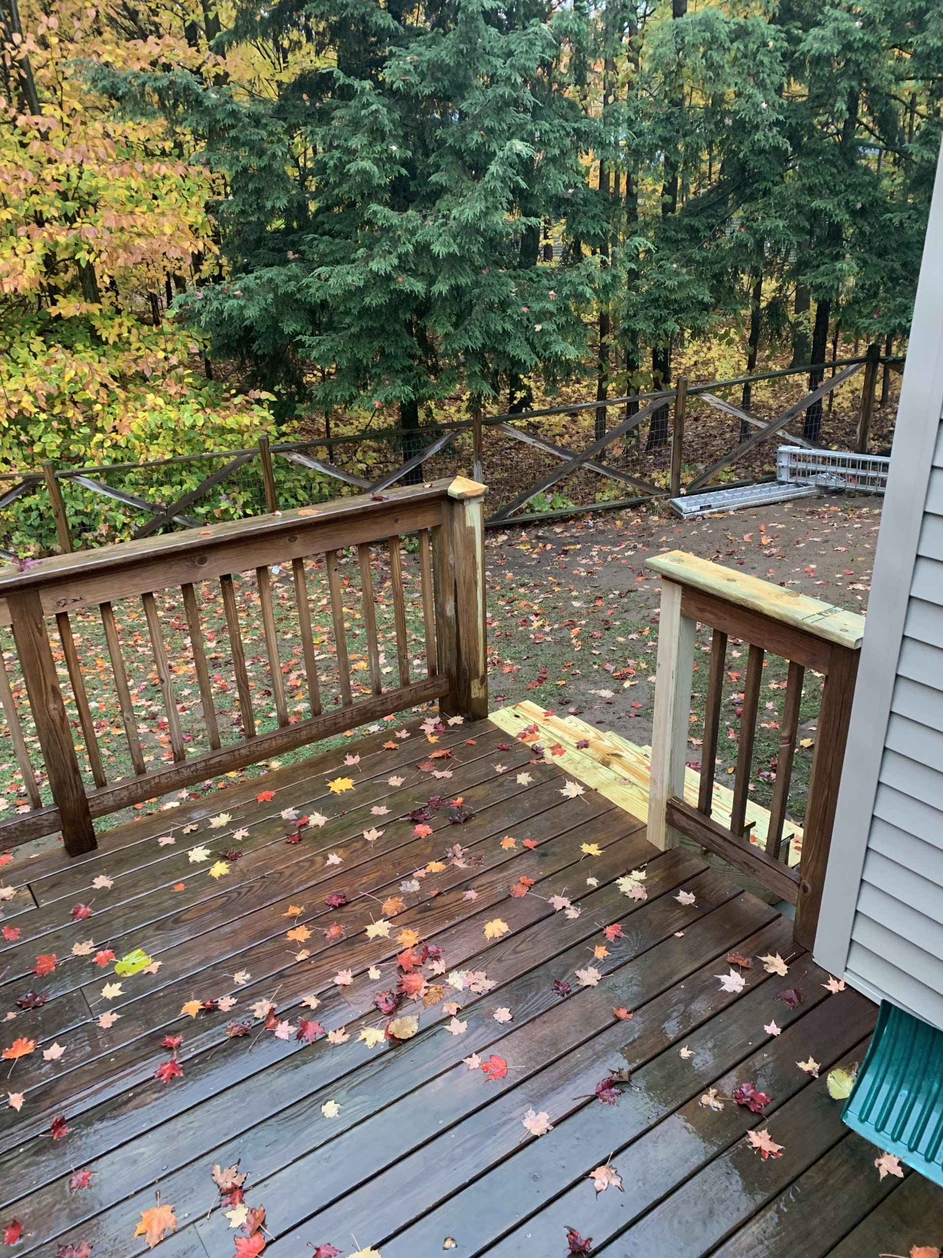

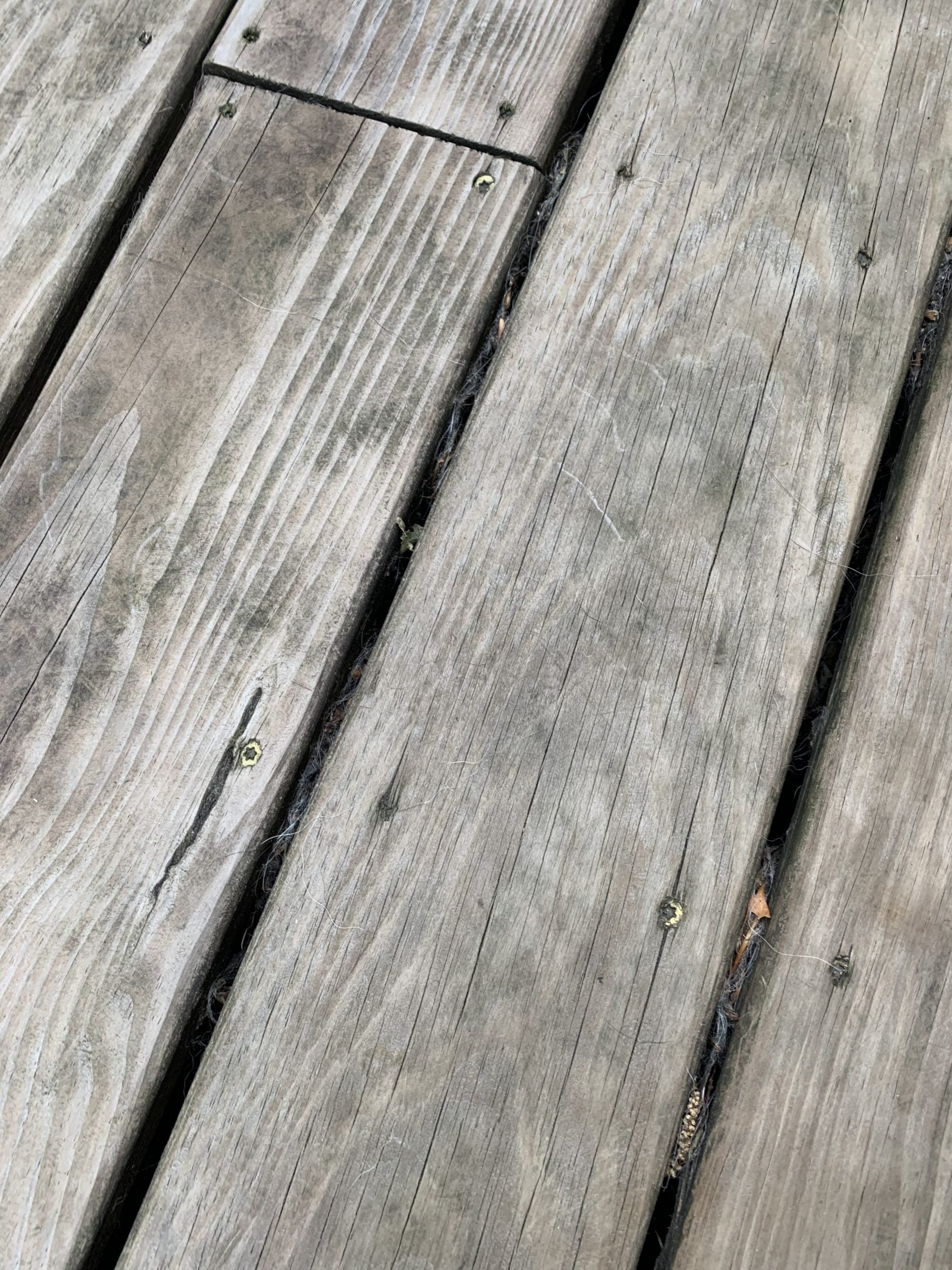

I have a 12ftx35ft all-wooden deck with approximately 55 feet of wooden railing. The deck is approximately 4-6 years old. I was fairly certain it had never been stained and the deck was definitely at least 1 year old when I stained it last, approximately 2-3 years ago. I read review after review from other websites and it seems there was always conflicting advice (oil vs water based, order of prep, brightener, etc), but no one has as comprehensive of a website and ACTIVE advice as you guys, so thanks for what you do! This is what I tried: Did a deck cleaner, then power washer, then had a ton of fuzzies that looked terrible, so I tried using a combination of a belt sander (roughly 3 inches by 14inch wide belt) and a 6 inch orbital sander to get rid of the fuzzies. It. Was. A nightmare. I used a deck pad applicator and paint brush on each spindle/post/railing. Total time was probably about 30 hours over a few weekends, of course having to redo a step or two because rain forced me to wait (and I have dogs that transit the deck from dog door to back yard while I’m at work). I used Thompsons WaterSeal Timber Oil (Teak). While I loved the color, it did not last long and I did not maintain it the way I should have. There is zero water beading on any horizontal surfaces with 5 second water test. Can’t tell on vertical surfaces but they seem more resistant (and darker). The dogs are very hard on this deck, as you’ll see from pictures. We average about 40 inches of rain a year and about 102 inches of snow. My dogs sometimes pee or poop on the deck. I’ve tried to stop it, but not a lot of luck. My top problems with the deck are: a) It gets INCREDIBLY slippery in wet/snowy weather. So much so that it makes it hard to even snow-blow the deck in winter because tires don’t want to grip. This is worsened by my laziness at promptly cleaning deck of leaves and performing annual cleaning/brightening and annual/semi-annual re-staining. I plan on fixing this in the future. b) Thompson stain seemed to last about a year or less. c) Mold/mildew/Algae grow incredibly fast on the deck even though I try to clear of snow often. I’m looking to do either TWP 1500 (live in NY) Semi Transparent (Rustic) or RAD Water Based Semi-Transparent (Cedar) and definitely leaning more towards the RAD option because trying to line up 2-4 days of no rain, warmer than 50, cooler than 80 or 90 with lower humidity is incredibly hard, especially when it means I have to keep my dogs inside during the process and come back from work to let them out. After reading other reviews and answers, my plan is to strip the deck with RAD, use pressure washer (2800 PSI, 2.3 GPM), apply the brightener from RAD, check for… Read more »
More Pictures…
1. No need.
2. 6-10 inches.
3. 15 minutes or so.
4. Only if fuzzies and only if bad otherwise just leave alone.
5. You are forcing the buffer. It is a delicate balance between tipping up and down. Very easy once you get the hang of it and will not tear up the pads.
6. No.
7. It will be close but should be enough. Only one coat the rails and two coats on floors applied wet on wet.
Awesome, thank you. Should I get the stripper booster gel stuff or not necessary?
No need to booster or gel additives for this one.

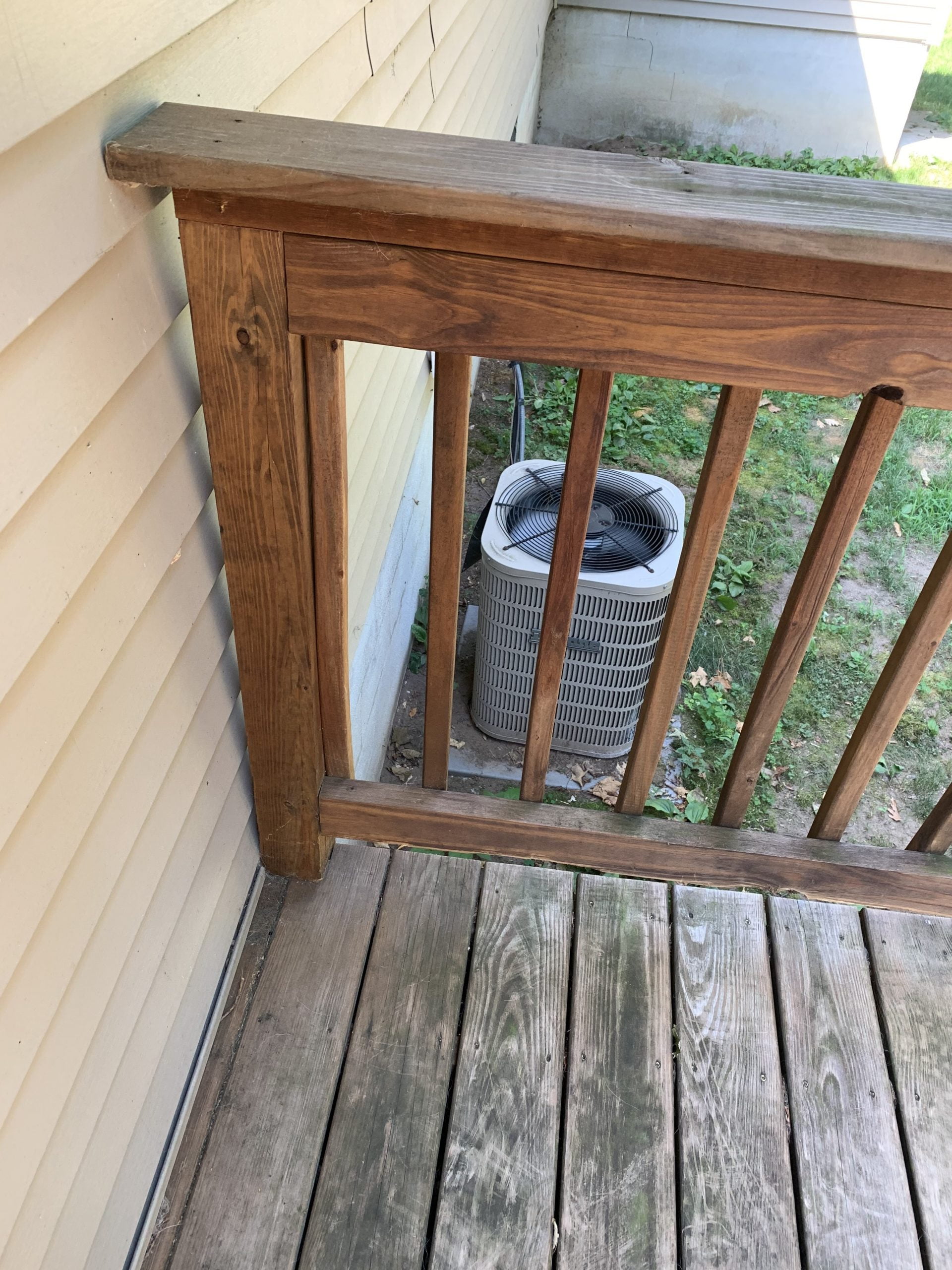

Currently my deck has Glidden Endurance oil based semi transparent redwood deck stain on it. I am looking to restain but it appears that Glidden no longer makes this product. What prep do I need to do before I switch to a different brand of oil based semi transparent deck stain of same or similar color? The stain is pretty much intact.
Post a picture.
Here is a picture of what it looks like now. I haven’t done any prep or cleaning yet.
That is a solid stain. You will need to sue a solid stain again unless you want to power sand it all off.
