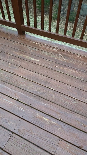

Please post a picture of the current condition.
Really appreciate your help
Sorry for the double pictures. Had a hard time posting them
That is not an easy strip. The coating is heavily applied to the point that is almost like a paint as it is sitting on top of the wood. You can strip some or most but you will have to power sand to get it all off.
Try Restore A Deck Stain Stripper with the Booster and Thickening Gel Additives. As I mentioned, it will not get it all off but it will give you a head start with the sanding.

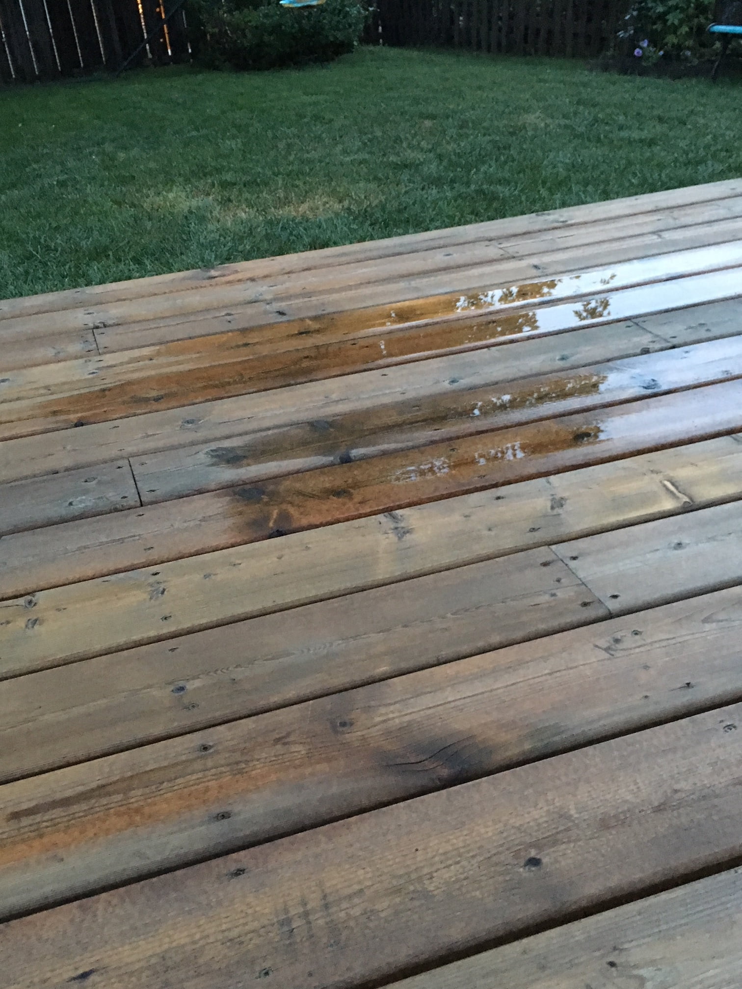

Hi! I used a Behr oil stain on my deck. After the first rain fall, I noticed that the water doesn’t bead like it would on a water based stain. It appears that the water sits on top of the wood, and in some areas, looks like it’s actually being absorbed by the wood. Is this normal? What is water supposed to look like on an oil stain? Thanks in advance!
Yes that is normal and correct.

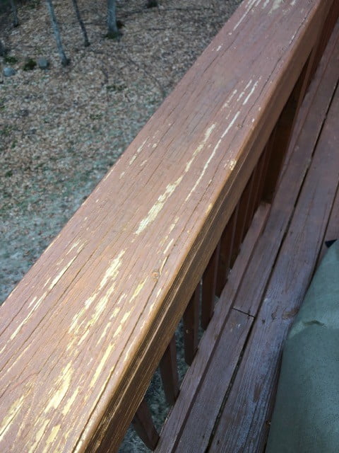

Cedar fence installed one year ago. They stained oil based, however, it was wrong color. They went over it with darker water based stain, now, washing away in places. We are getting ready to have it re-stained due to hail damage. Any suggestions after power washing it? Will oil base penetrate or too late?
You will need to remove all and start over. Please post a picture.
