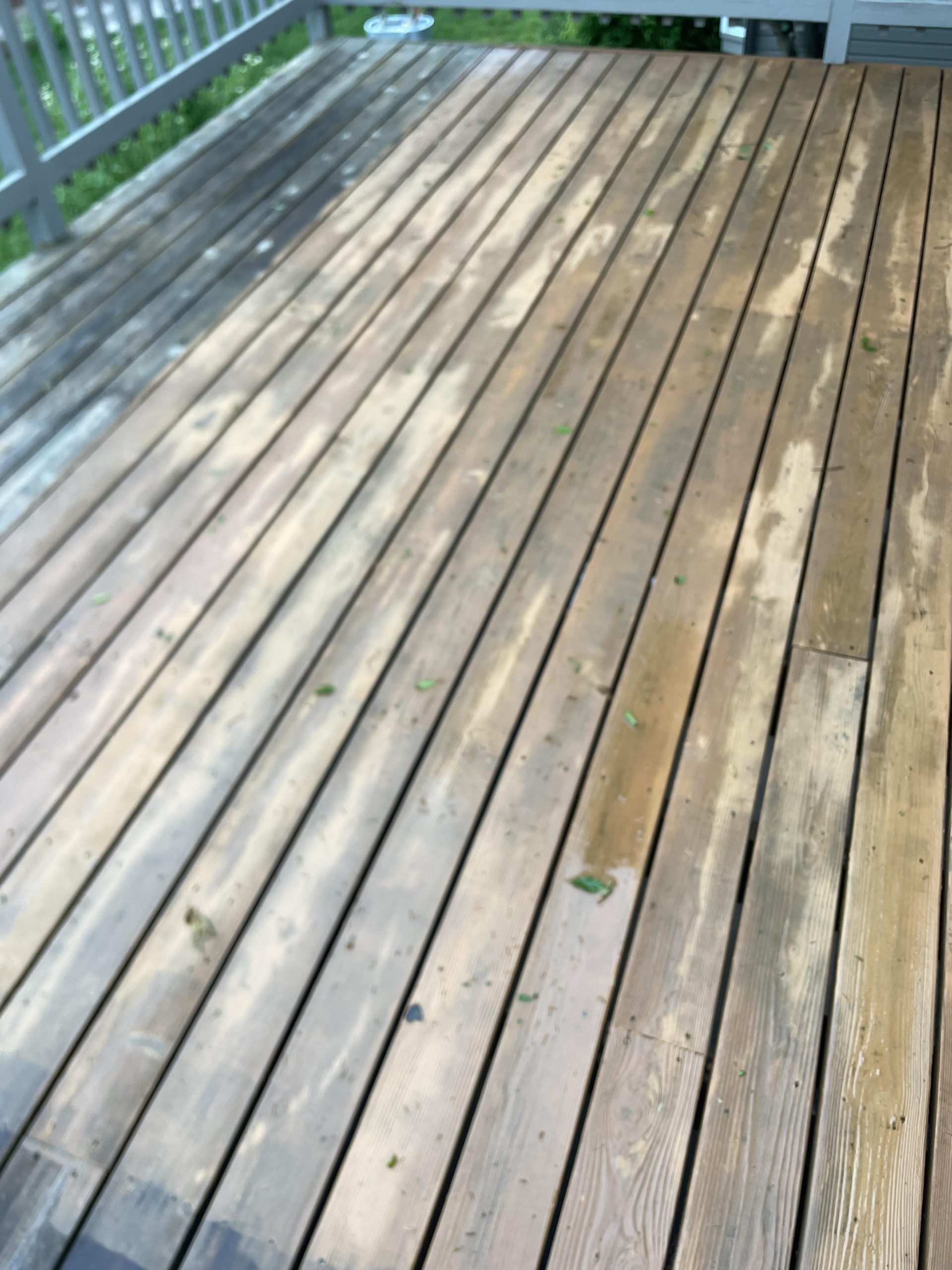

I stained a deck with Sherwin Williams super deck waterborne semi-transparent exterior deck stain. I finished at 4pm. By 8pm a light mist was starting that turned into a drizzle for several hours. It’s been wet ever since and now it looks splotchy (see the picture attached (left side of the image is not stained yet) . Do I need to strip everything and start over? Can I just recoat?
It is hard to tell since it’s half wet, but most likely if you have spots or splocthiness, you will need to remove and start over.
I stained a deck with Sherwin Williams super deck waterborne semi-transparent exterior deck stain. I finished at 4pm. By 8pm a light mist was starting that turned into a drizzle for several hours. It’s been wet ever since and now it looks like the picture attached (left side of the image is not stained yet) . Do I need to strip everything and start over? Can I just recoat?
No pics.
Added a picture above, thanks!

Hired a company to paint house and stain deck. They pressure washed, sanded, then stained with Cabot Australian Timber Oil. It rained two hours later. Water pooled on the wood. It looks awful, splotchy and scaly. The pics show it several days after staining was done. Contractor thinks “more stain”, I had to stop them and ask them to go get educated before doing anything. That’s what I’m trying to do here…
What an awesome resource to be able to ask the opinion of others to figure out what to do, thank you!
Adding more will not fix it. Remove and start over.
One more question if I may, could something else have caused this condition or is it rain water for sure? Thank you in advance.
It is rain.

I stained my deck two years ago and there was some rain spots on it after it dried. How can I remove these water droplets? I am getting ready to resand my deck and would like any suggestions as to how to fix this problem. Thank you
You cannot fix this outside of sanding it down to the bare wood or coving with a new coat of solid stain.
We stained our deck about 2 years ago. I think there was some dew that formed overnight and it has since added to the rainspots on the deck. Please look at the pictures and let me know if there is anything we can do? Or any suggestions before I apply another new coat of stain to the deck? Will restaining it make it go away?

Hello – Our deck is 12 years old, treated pine. The first time we stained the deck a few weeks ago, we first used Behr Wood Stain and Finish Stripper using a wire brush. Then we used Behr All In One cleaner to clean the deck. After 24 hours of drying we stained the deck using Behr Semi-Transparent Waterproofing Stain and Sealer. We did not realize it at the time but within 12-24 hours we had a weekend of rain (not hard) from a tropical storm. The stain was peeling up in several places after the weekend of rain to our disappointment, and to further add insult, we ended up really not liking the color. We were most concerned about the peeling, so we ended up using Behr Wood Stain and Finish Stripper and the wire brush again to completely scrape the new stain off the deck. We did not use the All in Once Cleaner this time because we figured we had just used it and the wood should be clean. It certainly looked clean, cleaner than the first time. We let the deck dry for a few days this time then applied a different color of Behr Semi-Transparent Waterproofing Stain and Sealer a little over a week ago. It had over 24 hours to all dry before rain. It rained this past weekend and the stain started immediately started peeling up. You could walk out on the deck during the rain and you could literally smear it with your feet. The attached pictures show what it looks like now after it’s dried for a few days. Seems to be getting worse. Do you know what most likely happened and what we should do? Thank you for your help!
The main issue is you are using one of the worst stains made: https://www.deckstainhelp.com/behr-deck-stain-review/
Read all the comments below the article.
You really need to remove all and start over with a proper penetrating stain: https://www.deckstainhelp.com/the-5-best-deck-stain-reviews-and-ratings/
Sorry to be blunt but the issue is not you or your prep but the poor Behr stain.
