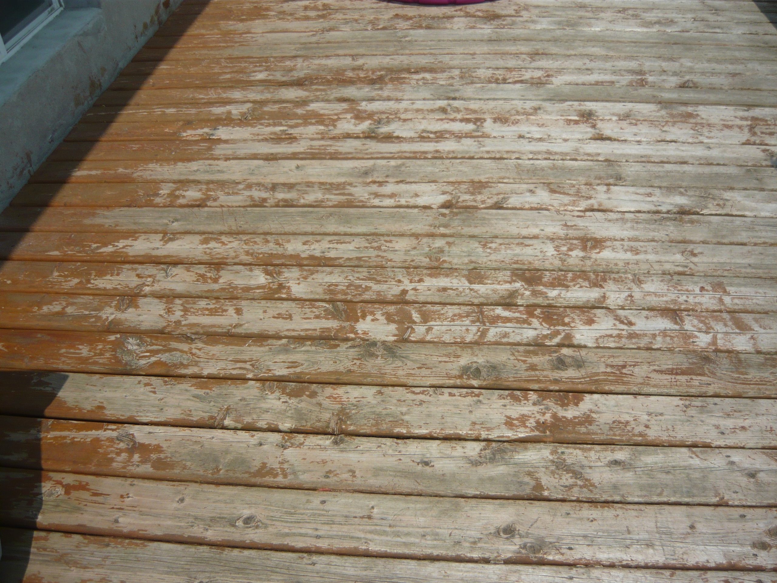

This product is complete junk. Do not purchase it! I bought 3 gals of Olympic Maximum Semi-Transparent Stain 716 Cedar Natural-Tone 79561C on Apr 8th 2022 at a cost of 3x$67.99 CAD plus tax. I cleaned all the surfaces and applied as per directions. It took a lot of back-breaking work and I am over 75yrs old. The product states a guaranteed 6 year life on decks. By the fall the stain/sealant was already starting to fade and peel off all the horizontal surfaces. By the spring of 2023 almost all the stain/sealant was gone. I took a picture of the horrible mess and contacted the company ‘PPG’ for a refund. They still have not acknowledged or responded.

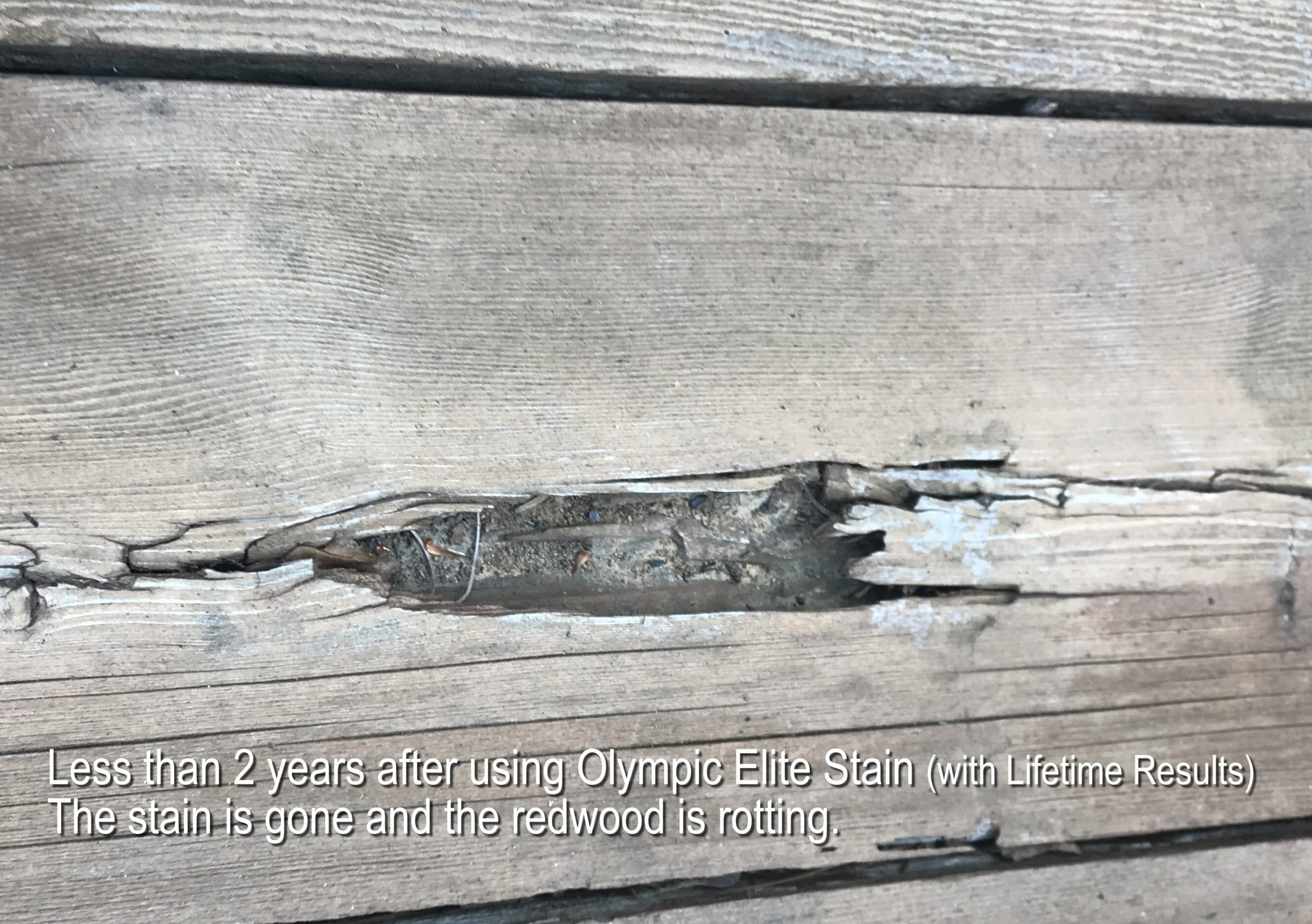

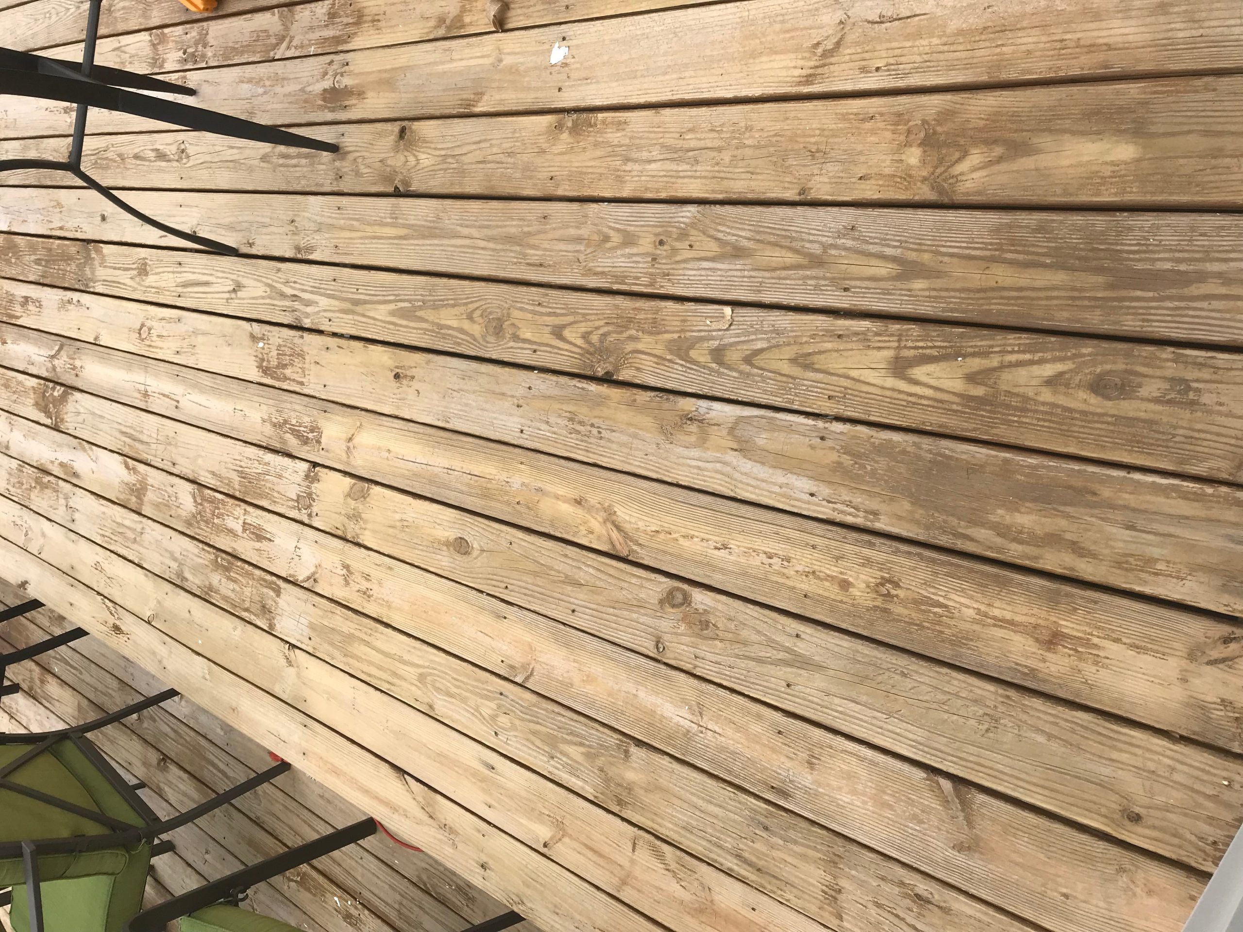

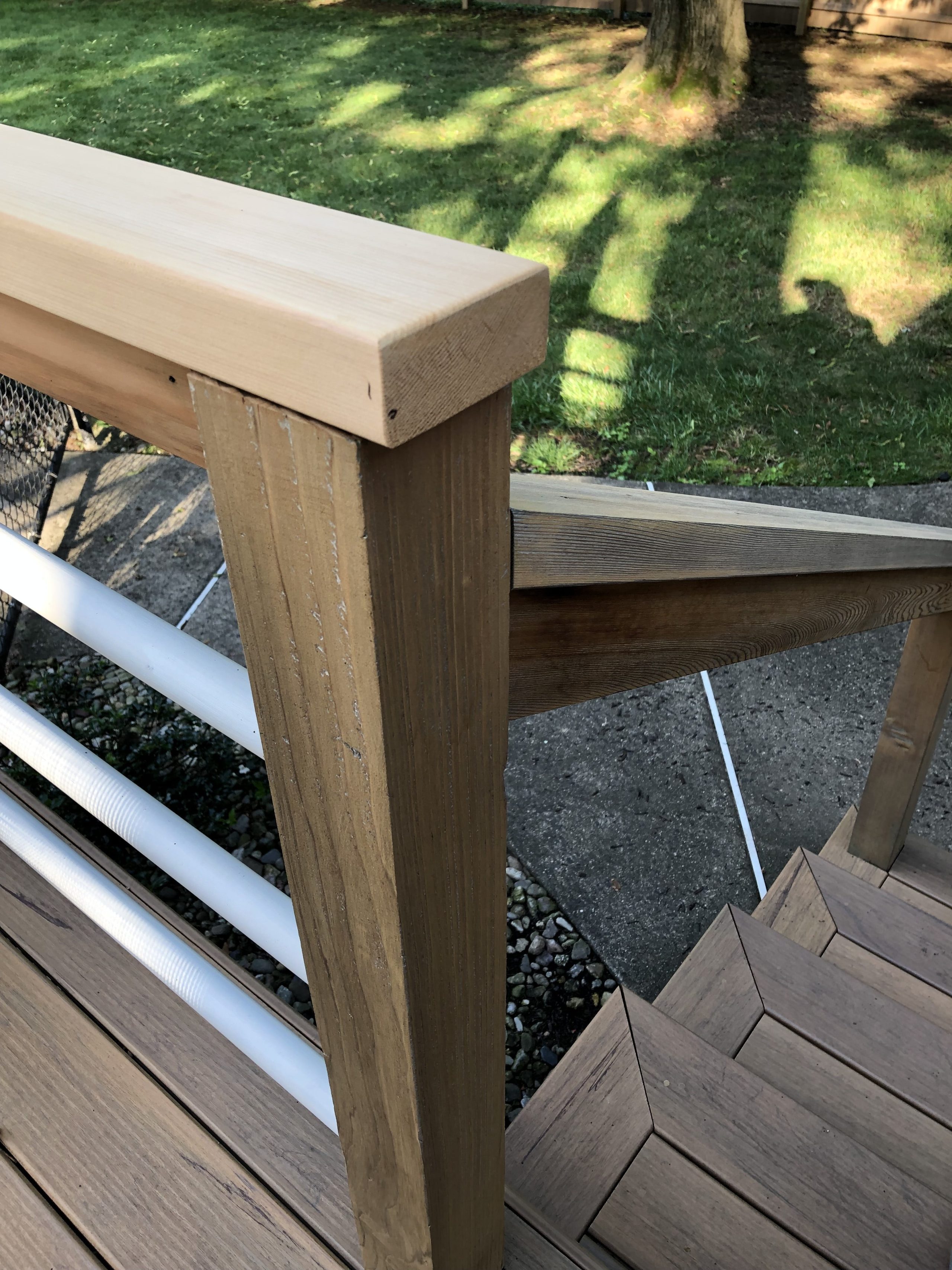

We used Olympic Elite Advanced Semi-Transparent Stain and Sealer on a very nice redwood deck in Oct. 2017. PPG shows a “Lifetime Results Guarantee” right on the can. The price was much higher than any stain we’ve used before. It required nearly 4 times as much stain. It wore off in less than a year (less expensive stains lasted 3 times longer), and in less than 2 years our redwood deck went from a really nice deck to several boards rotting. We are waiting to hear PPG’s response. Even if they do refund our money, it doesn’t account for the damage done by their deceptive advertising claims and incredibly inferior product. I’m convinced our deck would be in much better shape if we wouldn’t have used anything at all versus this stuff. How can PPG get away with this? They are advertising a lifetime warranty and guaranteeing this is their best “Elite” product when they surely must know their cheaper 3 and 4 year products last far longer than this one, cost far less, and actually protect wood instead of ruining it.
The deck was scrubbed and prepared very well with Olympic deck cleaner. All instructions on all the Olympic products were followed. The deck was in exceptional shape before application. The product didn’t even last a year and water was soaking right in. At less than two years, several boards are rotting and splitting and need replacing. Redwood decks are tough and rated for 30 years. Ours isn’t even half that old. Several of our exposed boards went from perfect to poor in less than two years after using this product. The stain went on like water and required over 4 times more stain than we ever used before. It seemed to soak past the top layer of the wood, then wore off the surface within a few months. So because of this product, I think water soaks through the top layer very quickly, then sits just under the wood surface and rots the boards faster.
On top of all this, their customer service was really poor. A Lowe’s representative called PPG with me. They were disconnected 3 times. Then they said they would email me a complaint form to fill out and didn’t. After 2 hours, I called back and they acted like it was my fault. Finally, I received the email and they asked every question under the sun about how I prepped it, how I applied it, deck condition, sq. ft., and more. I was very thorough in my response and I asked for a manager to call me. No reply or call yet.
See attached pictures. I have many more before and after photos.

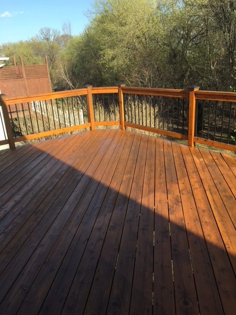

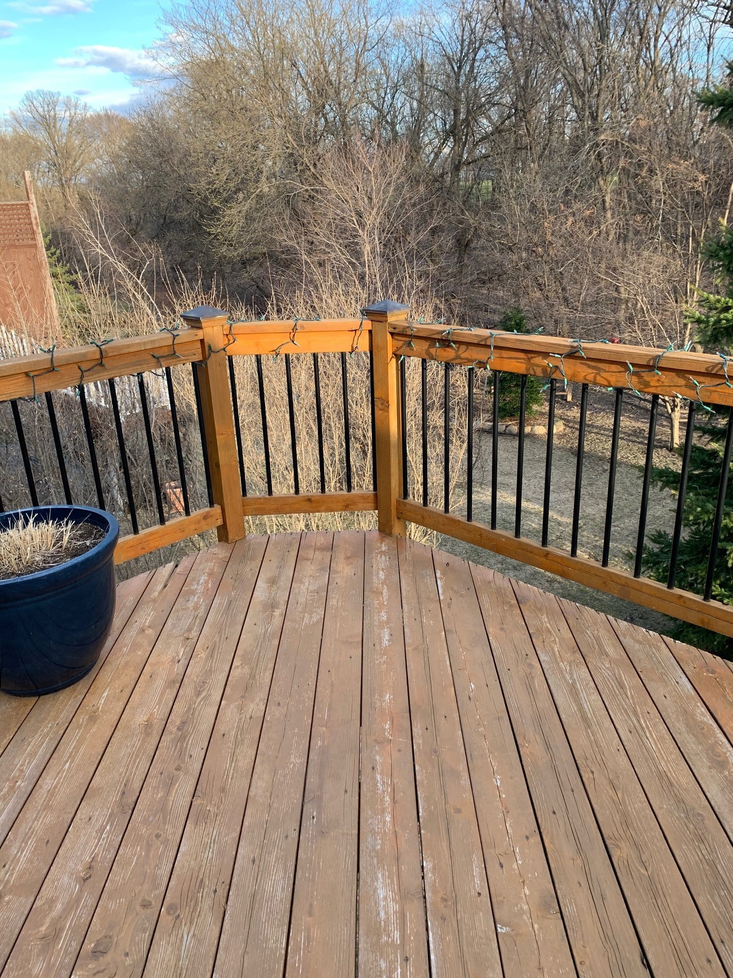

I used the Olympic Maximum acrylic/oil stain back in 2012 on a cedar railing. I recently sanded the railing down mostly to bare wood, but not completely as sanding close to other rail material was hard to get it to bare wood so there’s some spots on the vertical 4x4s where it’s not completely bare wood . What brand/type of stain would you recommend to re-coat? Do I still need to use a stripper or a brightener? I live in NJ.
Jon
Jon
As a follow up to my previous question, here’s a few pictures. Ideas on further prep and a compatible stain to recoat?
And thanks so much for your advice.
