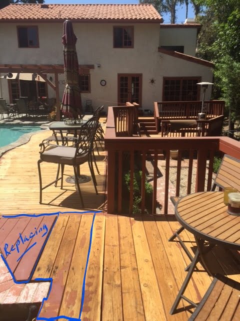

I have a large wrap around 10-year-old porch that was originally professionally prepped and stained with a solid stain that has been progressively peeling over the years. Many places we’ve pressure washed and repeated the solid stain but I see we’re losing the battle and I know I need to strip hand start all over with something that doesn’t peel. I know with work schedule I’m going to have to strip this in sections, my questions 1) can I work on stripping, sanding and neutralizing in sections then come back when I have time and do the stain all in one application? If so is there a time frame between the stripping/sanding / cleaning process and staining that I would need to redo possibly neutralize again right before I stain?
2) I just want to clarify what exact product you think would be the best for me to work on stripping, I know I’ll have to do some scraping and sanding
3) to avoid a solid stain look and peel is the TWP 100 Pro Series semi-solid oil scene the best that you would recommend?
I have a huge project ahead of me and won’t have to be doing this summer weekends and an evenings so your advice is greatly appreciated thank you
1. You can prep in sections. About 2 weeks is max before you should redo the cleaning.
2. You will need to power sand and or use a paint stripper like the RAD PaintStrip to get this off fully.
3. Yes, that would work for you.

I just had most my deck replaced, leaving only the structural posts. In the past they’ve had solid or semi solid stain that I want to remove before applying stain to the new wood. (I know it’s not going to exactly match).
The contractor is going to stain the new wood. Since only the posts have the old stain on them, I was planning to remove it myself to save some $. He suggested just using a sander, but I keep reading about deck remover-brightener – and in this article, power washing. I was hoping it wouldn’t be this labor intensive. If he was just going to sand anyway, I could probably do that.
What are the drawbacks and advantages? Is it worth hiring a handyman to do it? (Assuming a handyman would charge less than a general contractor.)
The only way to remove a solid stain effectively is to sand it all off.

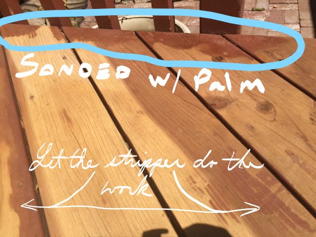

It is possible to remove. We used a 7inch polisher/sander. Try different grits until you find the one that works. It worked great! We have never refinished a deck before and had some stubborn solid stain. We managed to remove all of the previous stain.

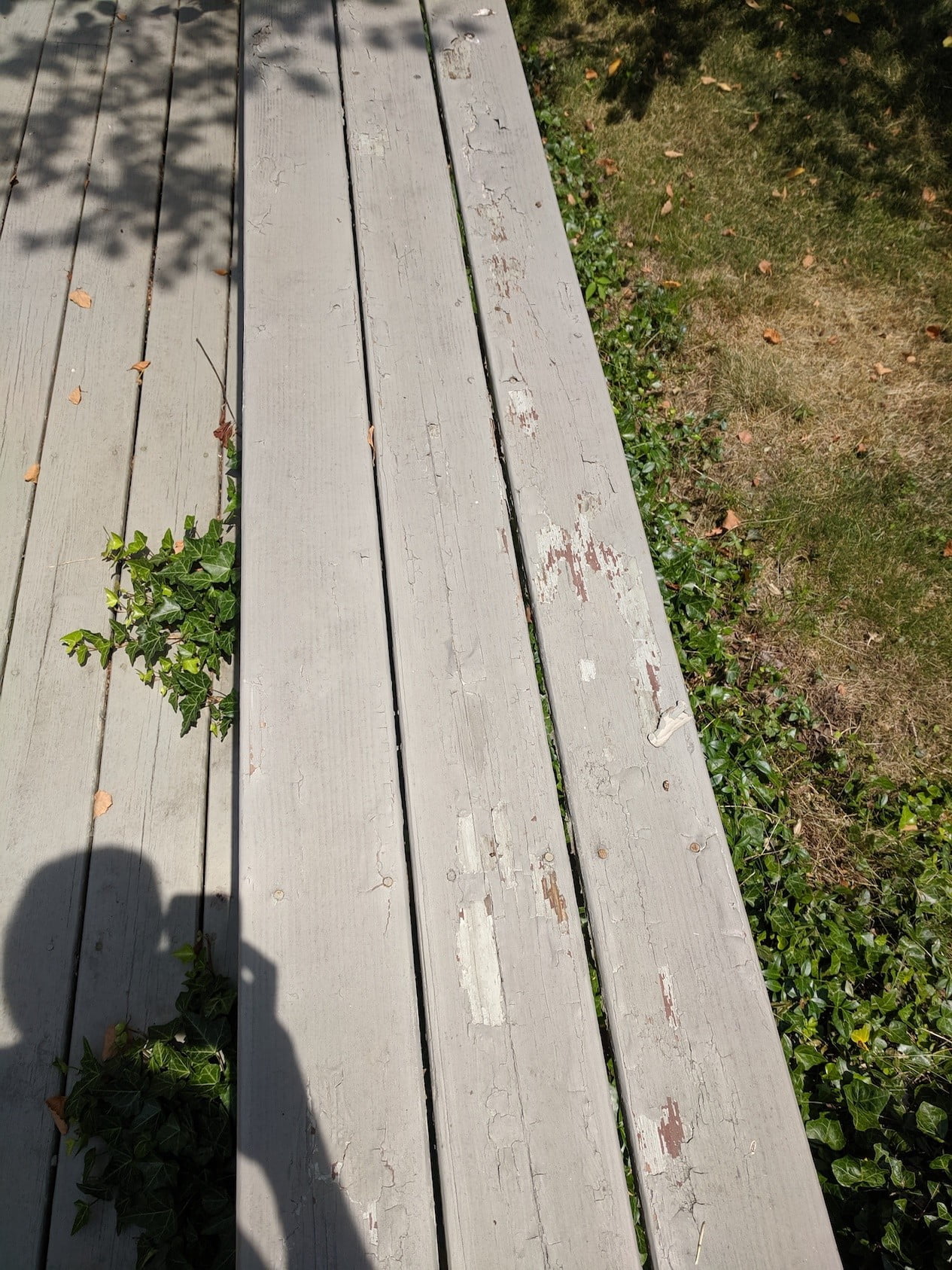

I’ve got a deck with a light gray Cabot solid stain. I have improved my skills but apparently not enough as the peeling has started again 10 months after staining it the last time. Though I like the look of a solid stain, I’m ready to throw in the towel. How effective will the restore a deck stripper (with additives) be on this Cabot solid stain? Thanks for taking the time.
You cannot remove a solid stain effectively with any deck stain stripper. You can use the RAD stripper to remove the loose and peeling stain and then cover the rest with a new solid stain: https://www.deckstainhelp.com/what-are-the-best-solid-color-deck-stains/

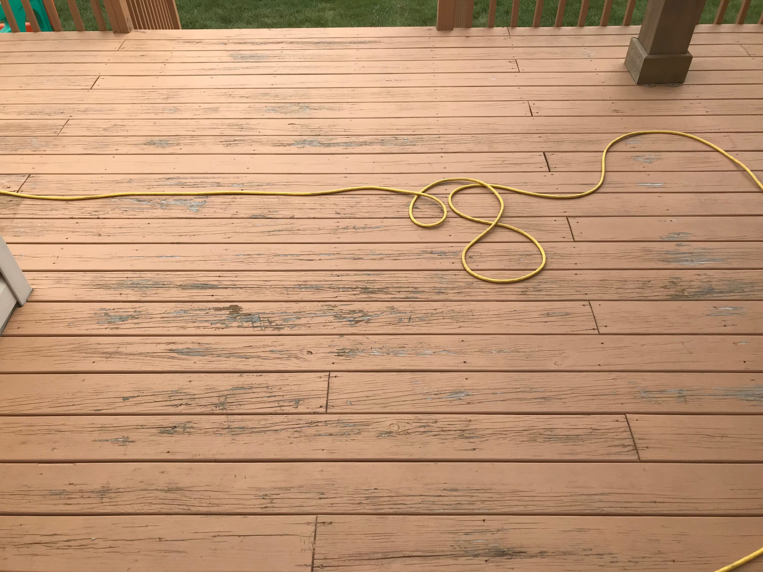

Our deck is stained in Behr semi-transparent stain, which is peeling. We have pressure washed the whole deck and used a stripper on half of the deck, but at least 50% remains on the area that was stripped and most stain remains in the area that was just pressure washed. We’re thinking of giving up with the stripper and sanding the whole thing. Then we would use a cleaner/brightener before staining. Would you advise a different method?
Also, if we get all this stain off, we’d probably want to use a different brand/type. This Behr stain has been a pain from the get go. Overall we prefer to be able to see the wood so we want to stay away from a solid if we can, but we want longevity, so if that means a solid, we’d do it. This isn’t a fun job. What stain would you recommend?
Last thing…our pergola has the same stain, but isn’t peeling. We’re thinking of painting it solid white. Would you recommend paint or stain? Brand? What prep would need to be done?
That’s a lot, but I would appreciate your input.
That would be best to remove it all if the stripper is not getting it all off.

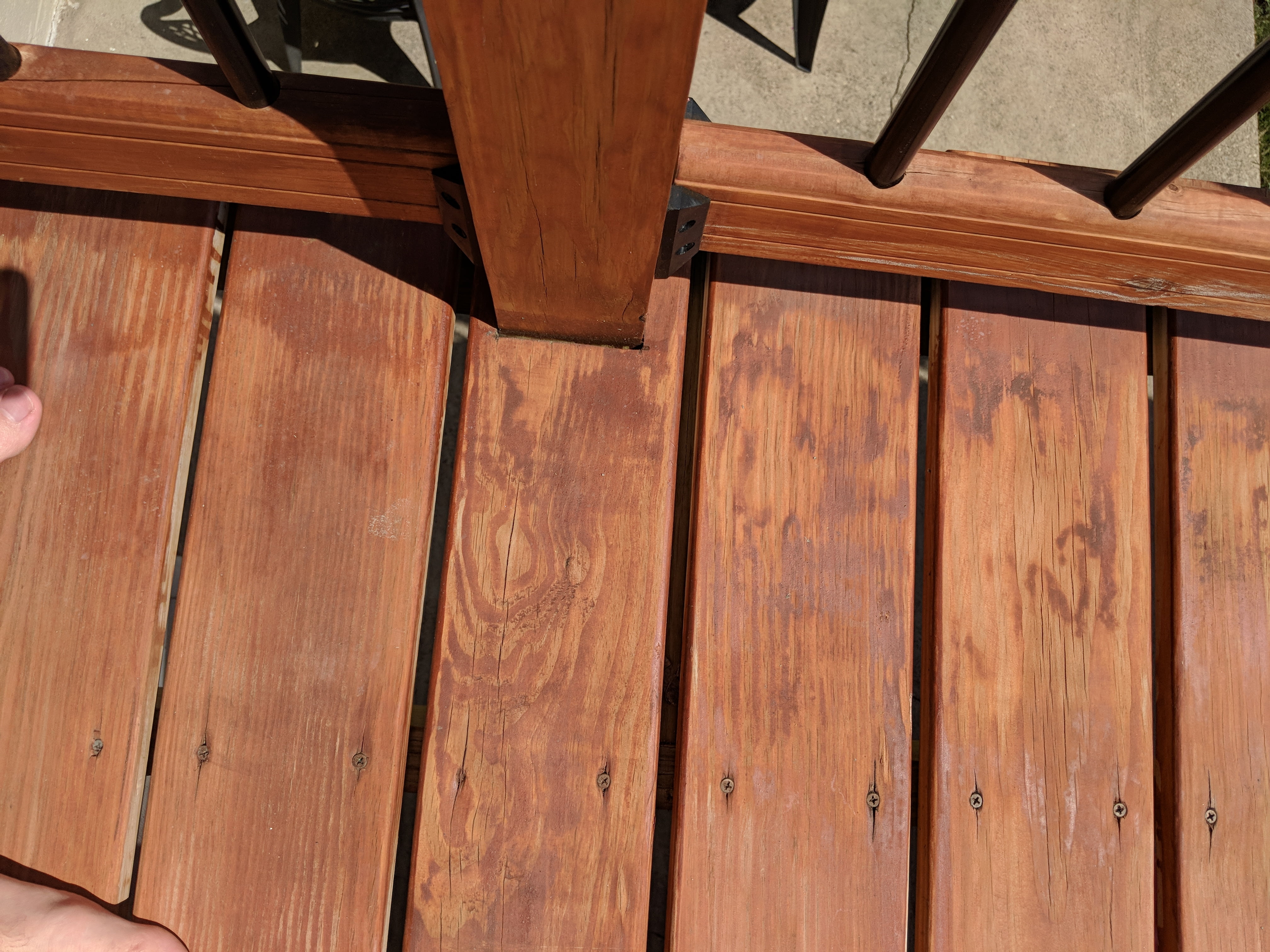

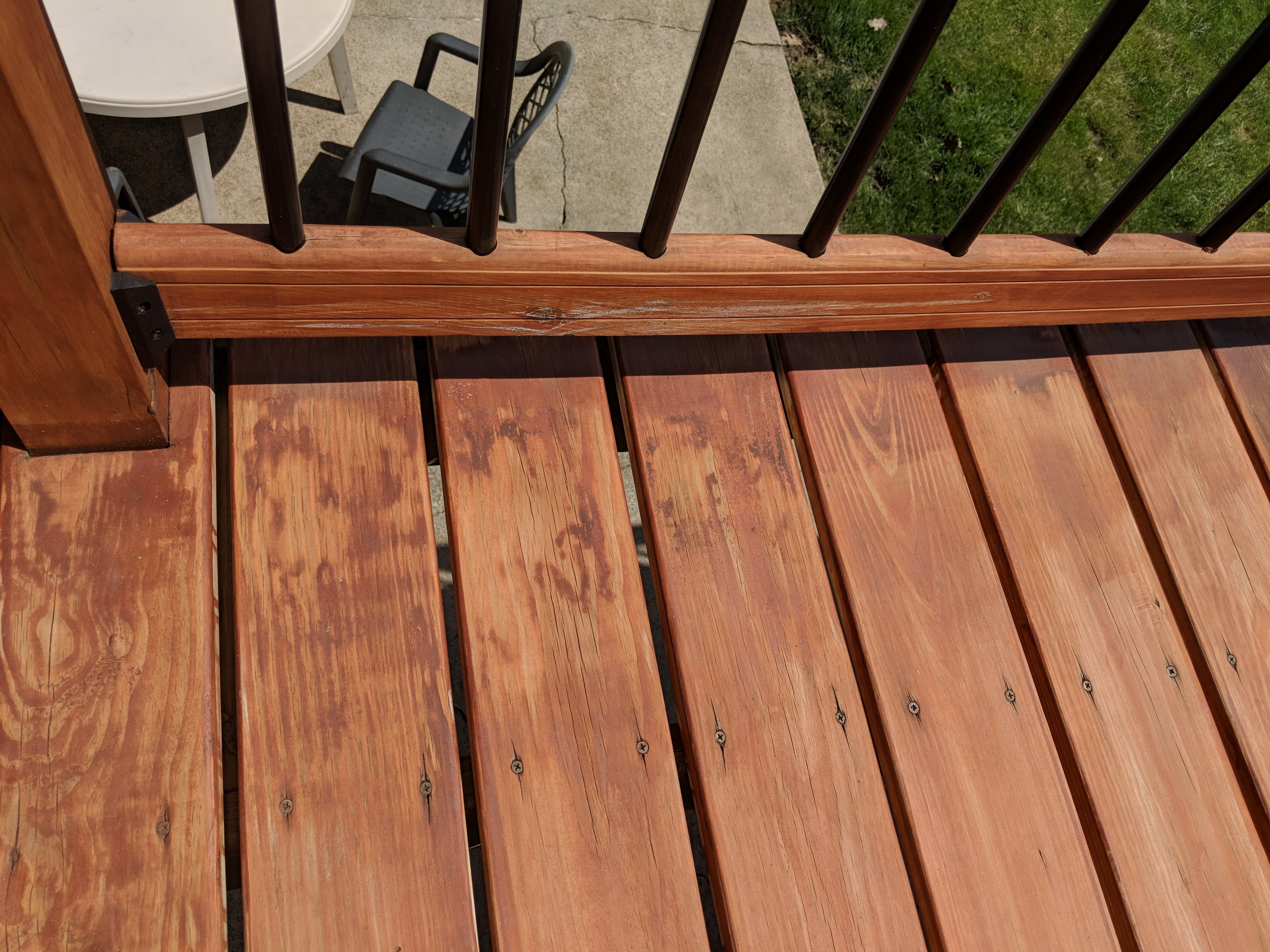

Just put semi trans parent from cabot on today, totally hate it. I’m hearing just power wash it off, would it be that easy?
Also, I attempted to use a graco sprayer, and I saw where u had dipping and runs on my railing. I tried to brush them out, but it appears I didn’t get to it in time. Will that that most likely be noticeable?
Thinking of doing the extra work to clean it up and do it all over again, any advice is appreciated
You cannot just pressure wash it off. We would need to see some pictures here for help with removing.

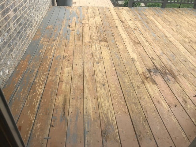

Looking for some advice on how to treat my deck going forward to avoid “peeling.” 3 years ago, we painted over the old homeowners stain color with a Behr solid color waterproofing stain and sealer. It worked out well, but we notice peeling every year and have to touch it up. We are trying to avoid this peeling on a yearly basis and we’re wondering what you suggest doing before we recoat the deck again with this Behr product. We just power washed the deck last week, and I also have been using a wire brush to get up most of the loose wood fibers that keep peeling, but we weren’t sure if you suggest using a “paint or wood stain stripper/remover”? I see mixed reviews on these products, and some people just suggest power washing and sanding off as much as you can before recoating with the stain again. We have had multiple people tell us to just power wash, sand and recoat, and we have had others tell us to apply a deck stripper and then power wash, sand and recoat. Any advice is greatly appreciated. Pics are attached as well for reference too. Thank you for your help!
Deck stripper and then power wash, sand and recoat is probably your best option but not guarantee it will not happen again. Your main issue is that your base coat is the Behr, and it is just not a good brand. Only correct way to fix is to remove all and start over.
Do you recommend a certain deck stripper to remove the coats? We are getting mixed reviews from everyone on certain ones to buy.
Try the Restore A Deck Stripper with both additives and RAD Brightener after: https://www.deckstainhelp.com/restore-a-deck-stain-stripper-booster-thickening-gel-review/
Awesome! Thank you so much for your help! Ordering it now. We have been all over the place and have talked to so many people so I really appreciate your help!

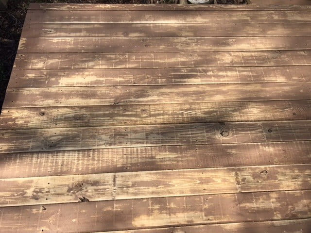

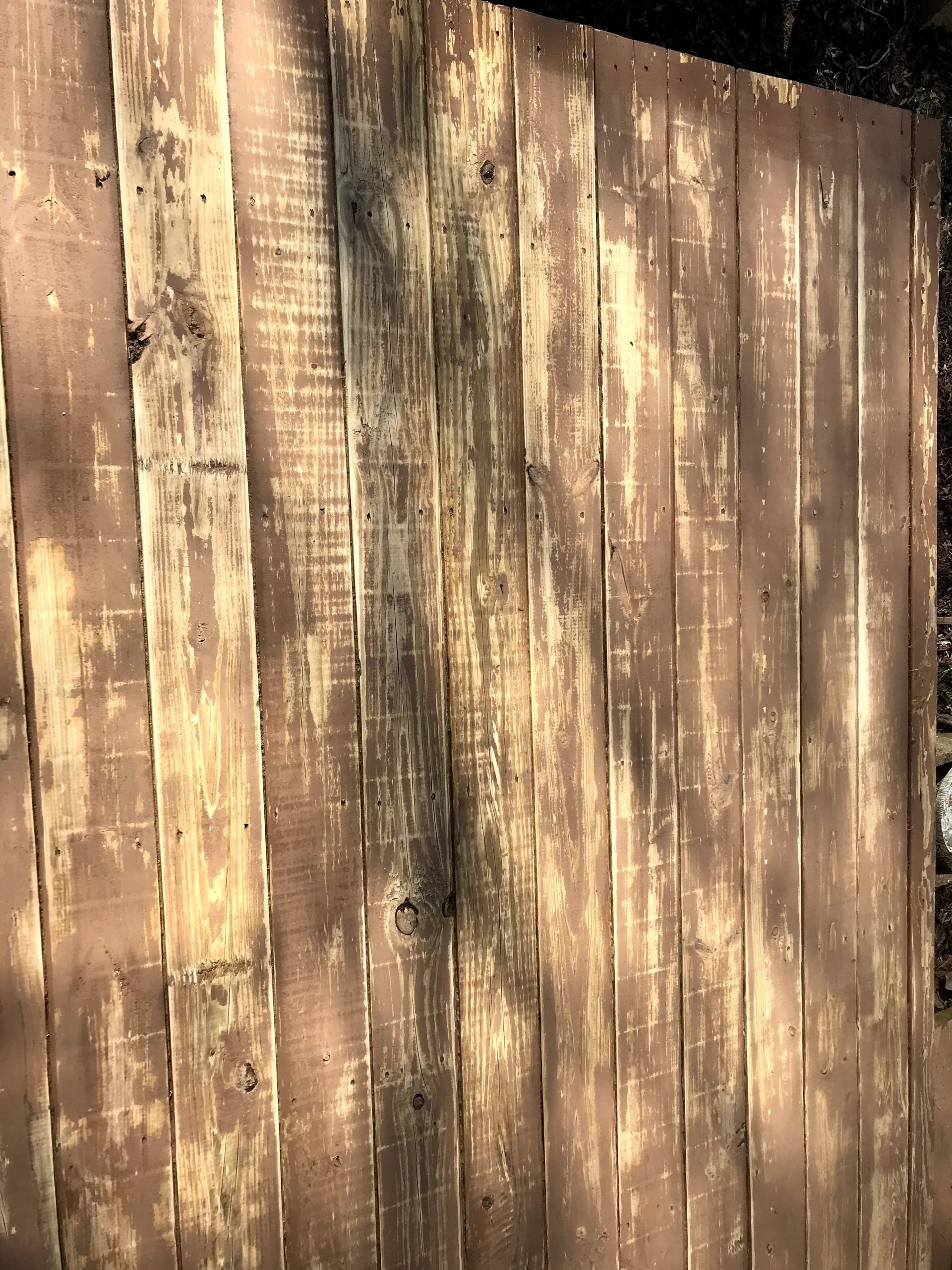

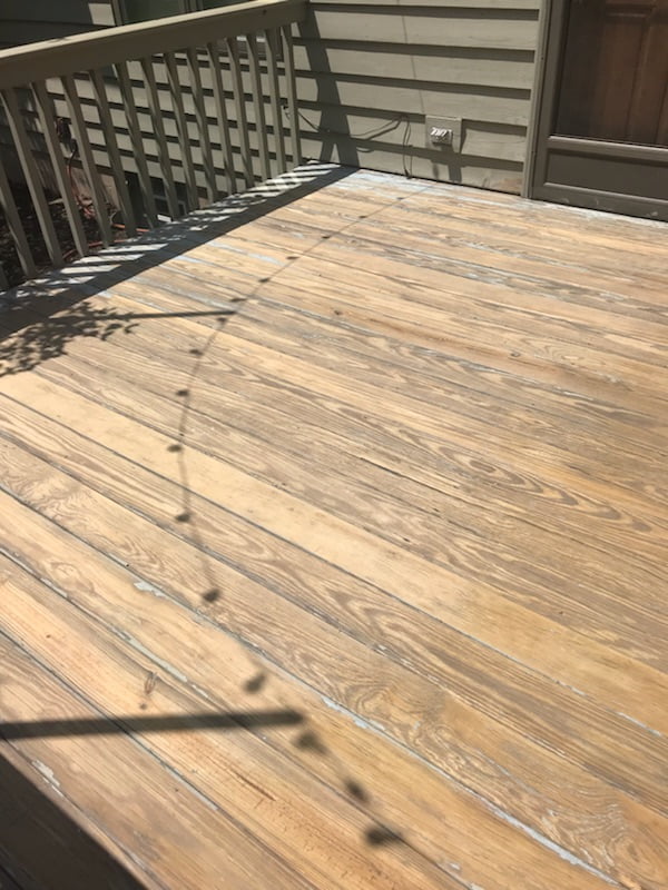

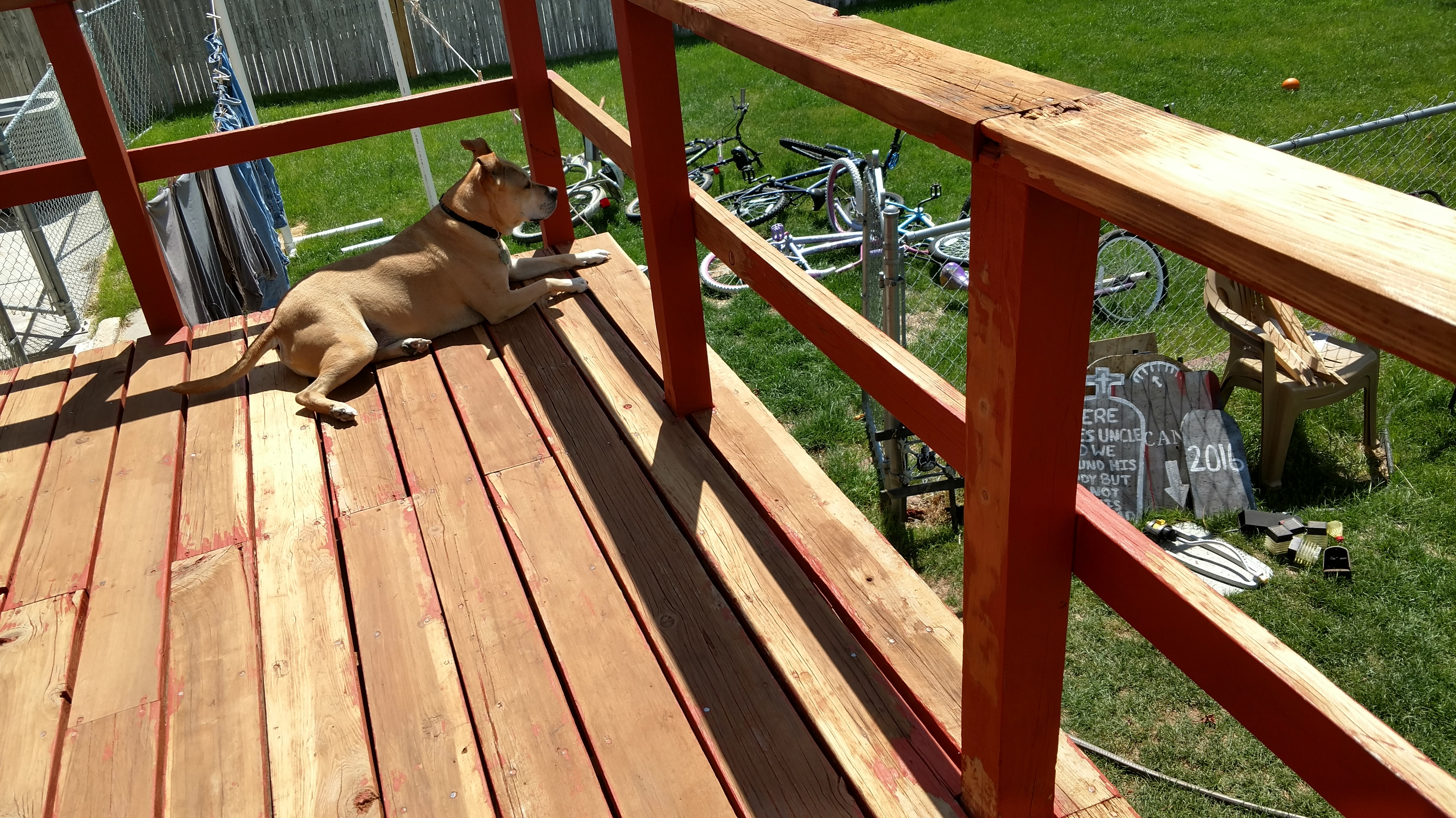

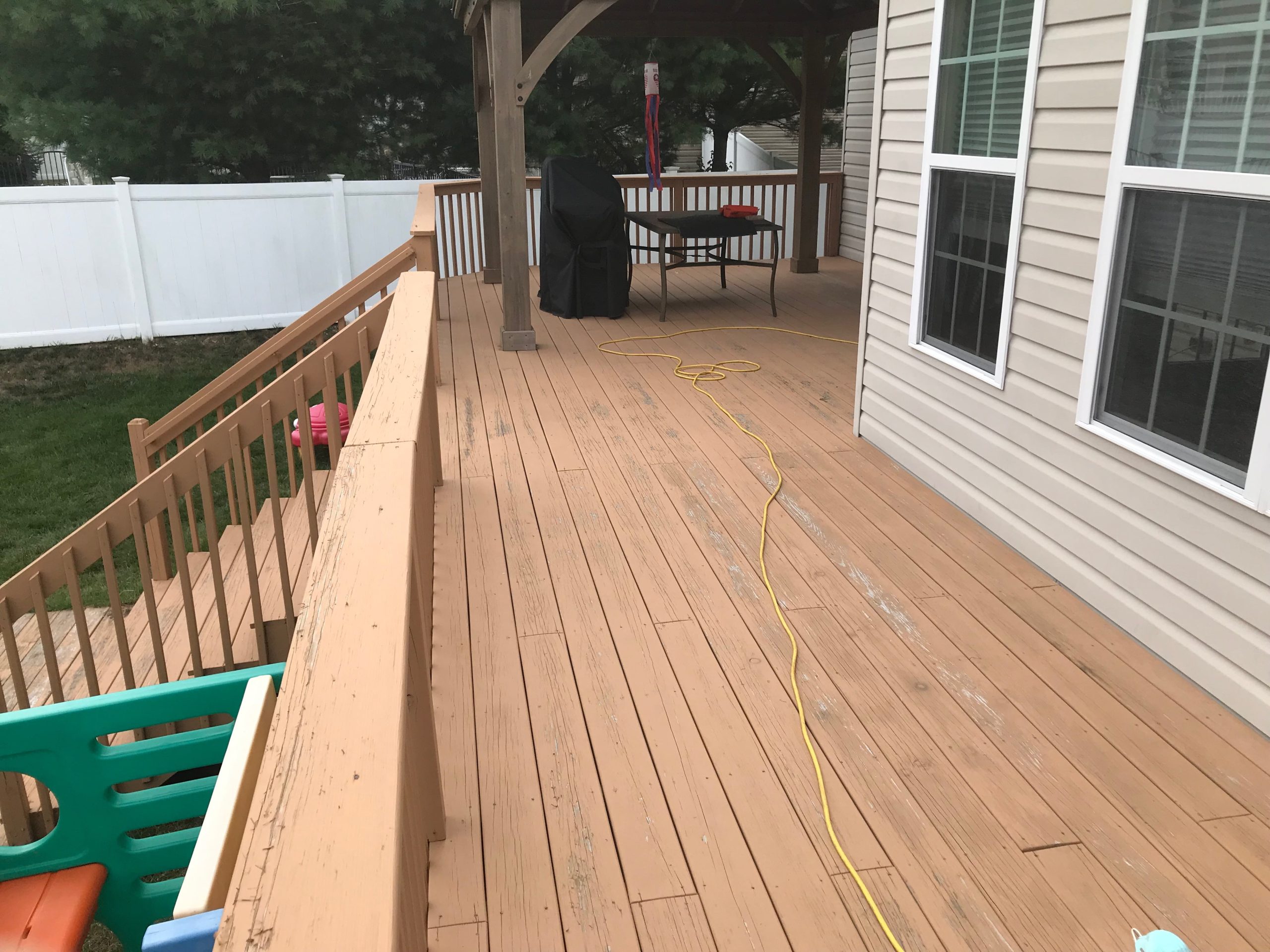

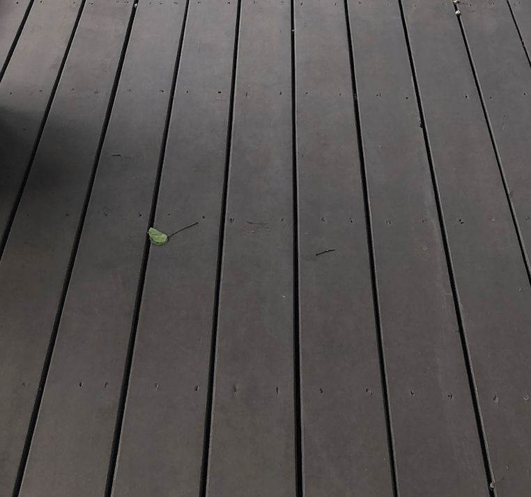

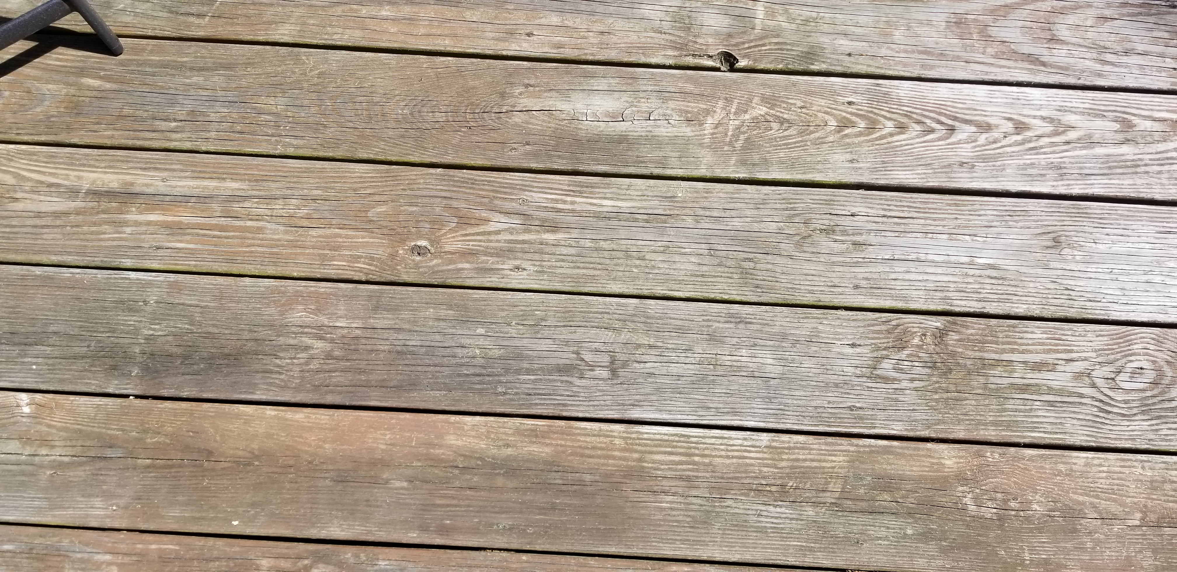

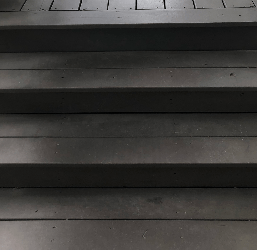

Thanks, again for the help. We spent two days stripping as much as we could, power washed, and neutralized it yesterday when we were done. We weren’t able to get all of the old stain off, but we stripped as much as we could. See pics.
We had a couple more questions before we stain. We noticed that you included an article for best solid color stains (Restore-A-Deck, Defy, and Flood), but we were wondering if it will be ok if we switch to one of these brands with small amounts of the old brand still present? We plan to sand a bit more before staining, but expect to not be able to get everything off. We don’t want to use the Behr product anymore (since it is the main issue and isn’t that good), but we just wanted to know if it would be ok to color match our old Behr color to a new one with Defy or Flood and use the new stain on top of this after.
We just want to make sure it is ok to switch to one of these better brands with the same color to avoid some peeling down the line. Let me know what you think.

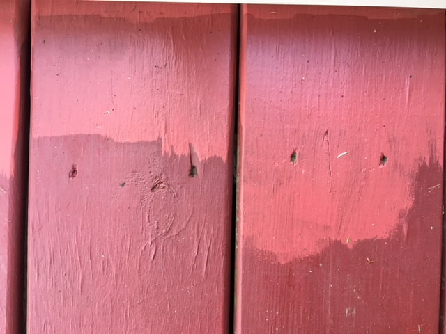

Pics are attached.
You can use a solid stain over this, just make sure none of the stain that is left is peeling. Any color you like will cover it. Does not have to be the same color.
Awesome! Thanks so much for the help. Is there any other solid stain that you would recommend or are the three in that article the best ones to go with?
Those are the best ones in our experience.

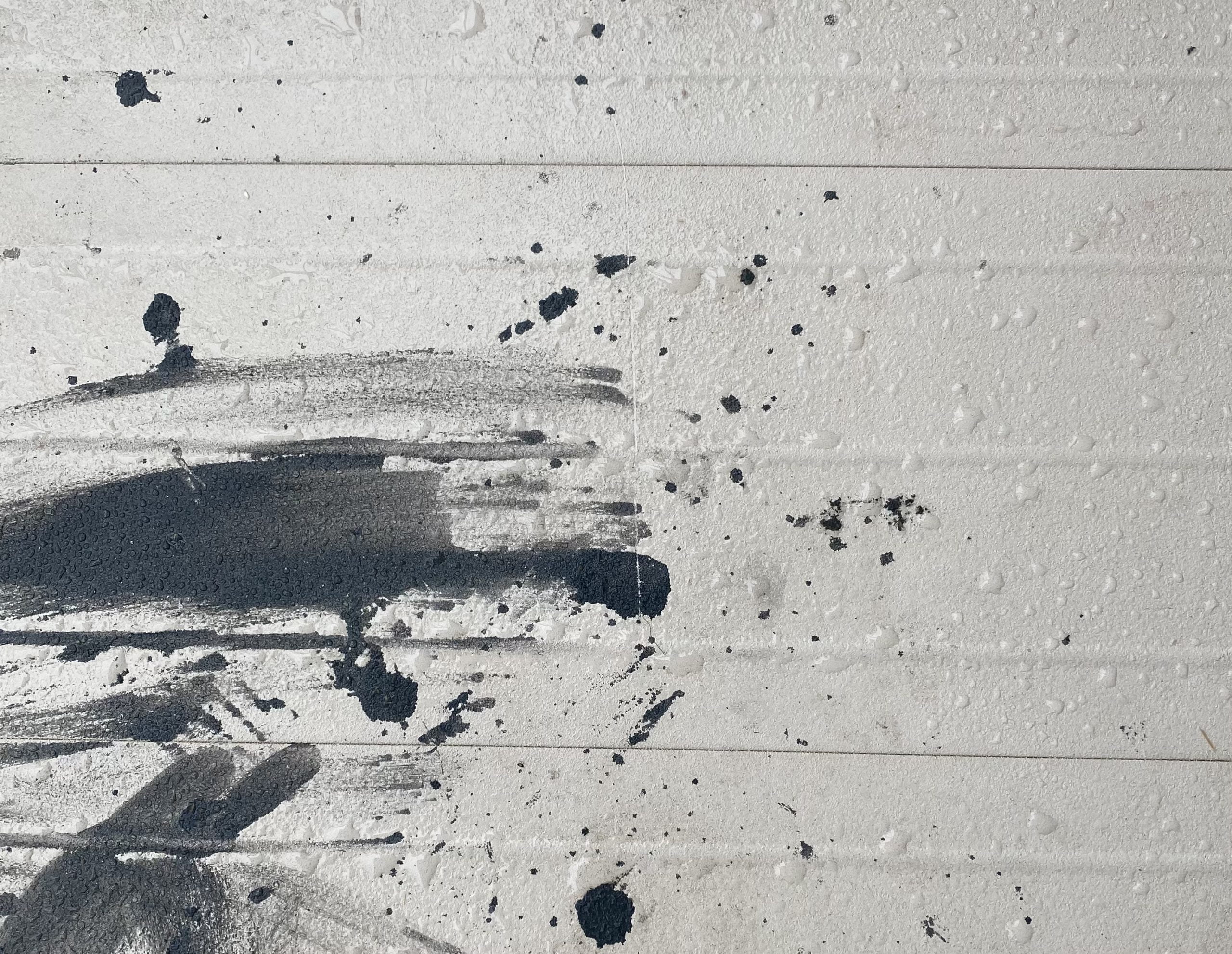

Hello. We have gotten wood stain on our non wood deck. Will these products work?
Send pictures.
Here is the deck
Deck
No, a deck stripper will not work. Not sure what will remove this.

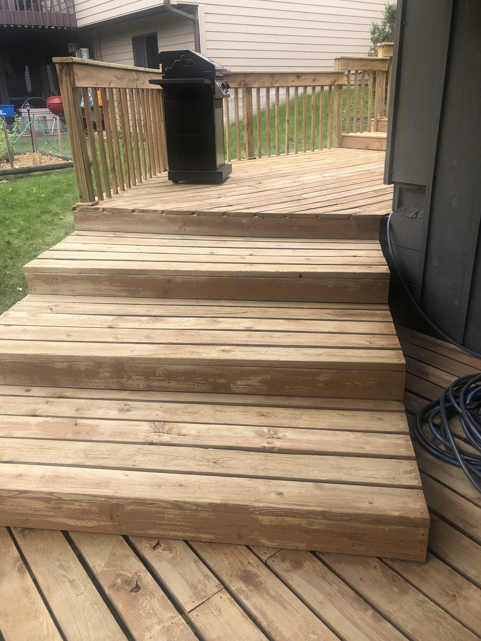

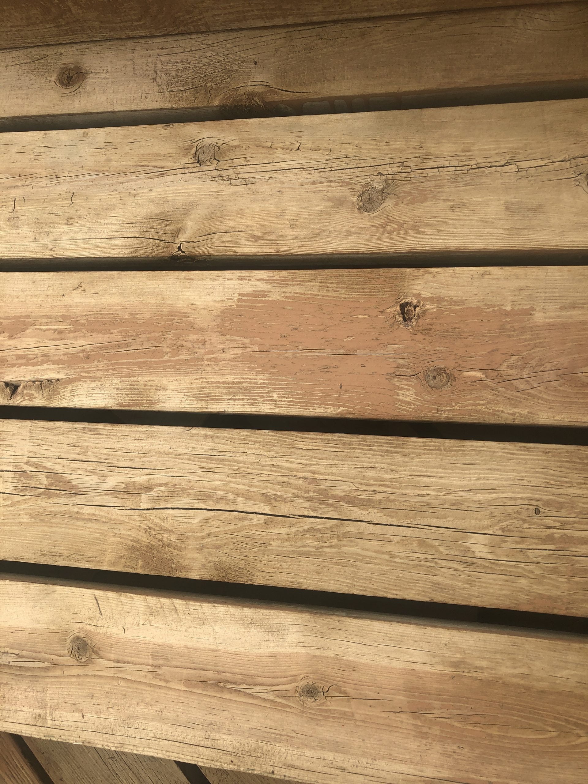

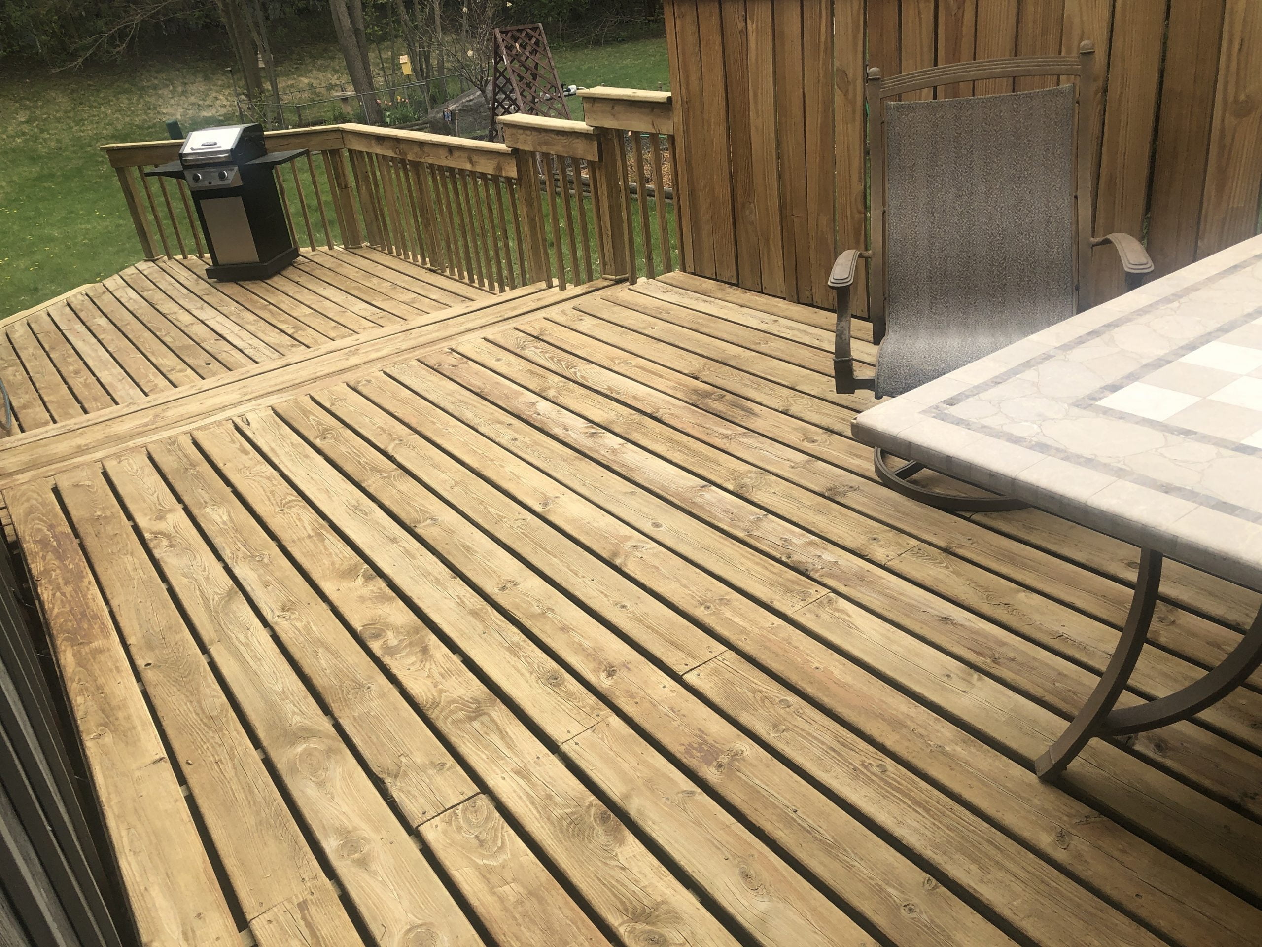

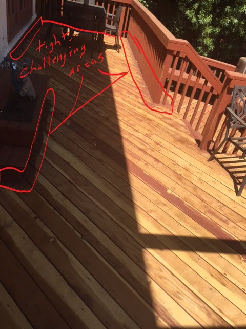

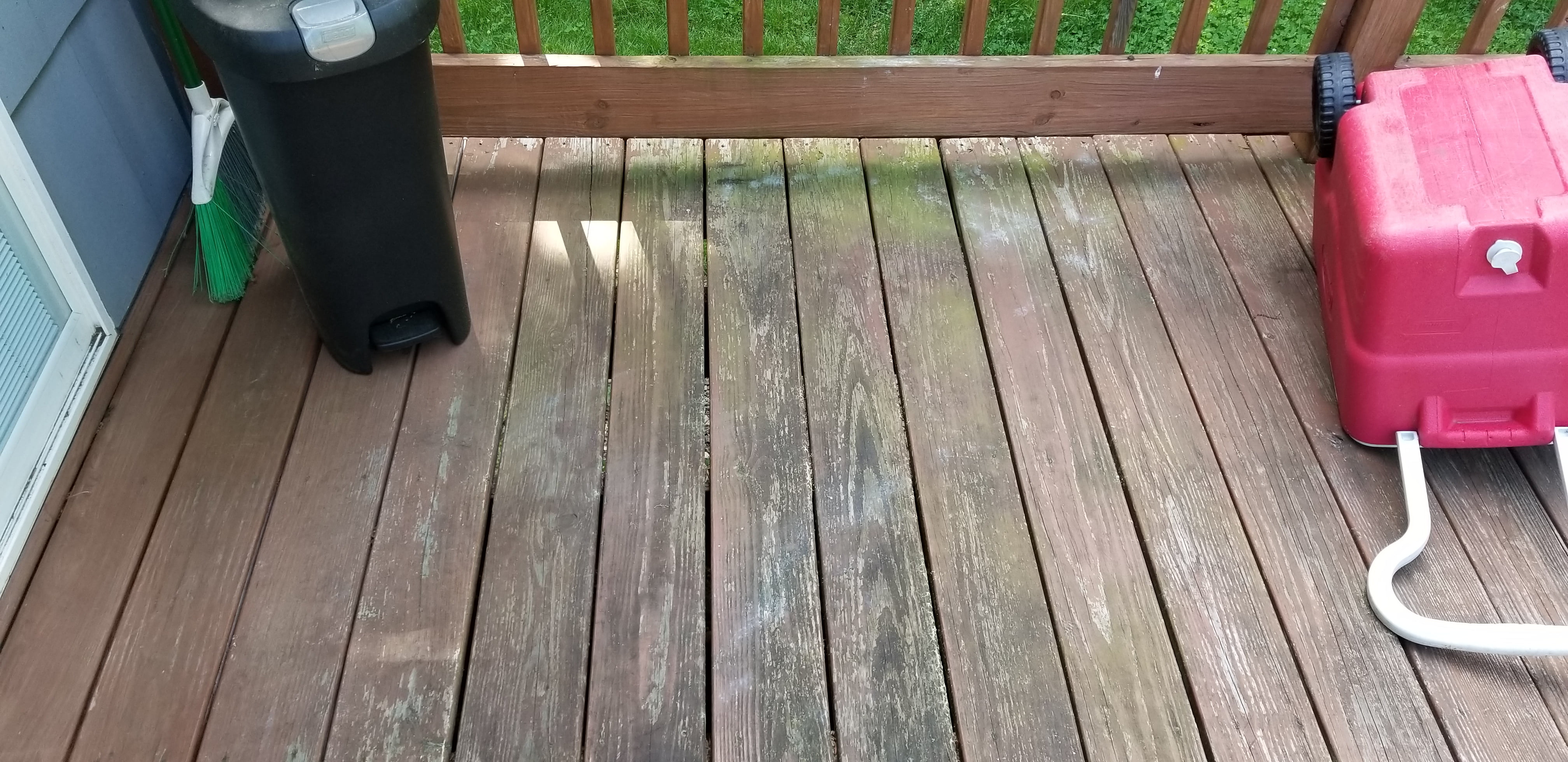

I just pressured washed our huge deck. We have different areas of quality- some of the deck looks great and brand new with no old stain, some has lots of stain still. The boards aren’t in the best of shape, but we would still like to get 4-5 years out of this deck before we replace with composite.
What would you recommend to do now- will sanding matter? Solid stain or semi-solid? Should we even bother with brightener?
I like the color of the raw wood as opposed to the heavy color in the before photos, but the quality of the boards/leftover stain won’t allow a clearer stain.
Another angle
You will need a solid stain to cover this and have it even: https://www.deckstainhelp.com/what-are-the-best-solid-color-deck-stains/

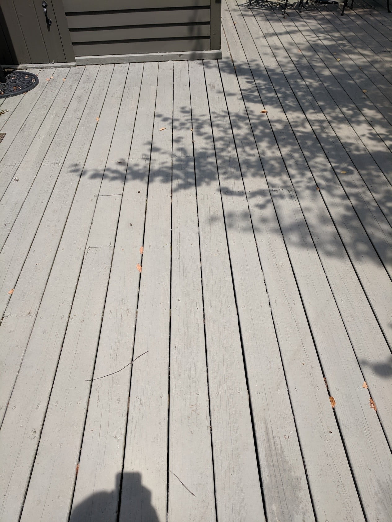

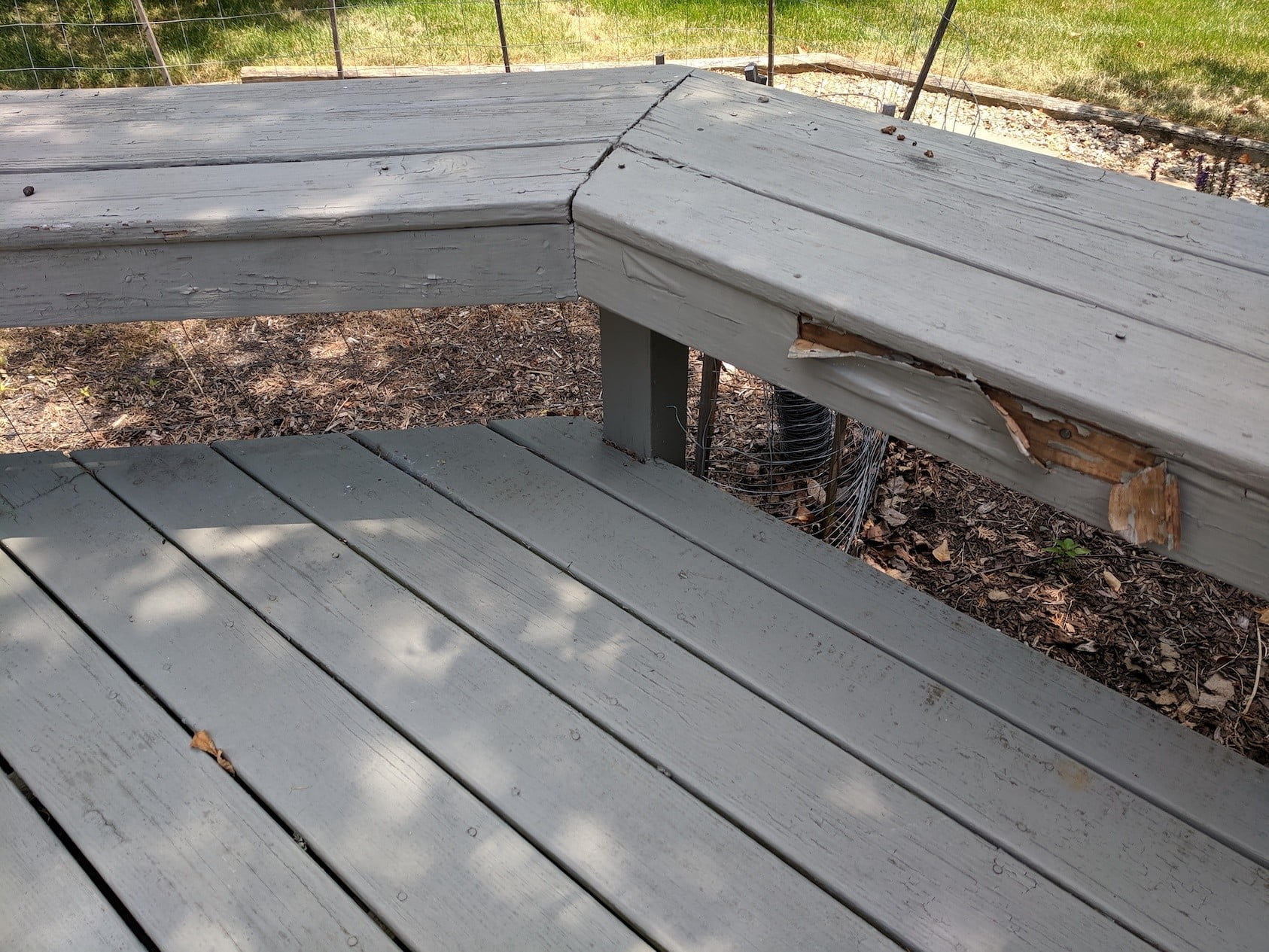

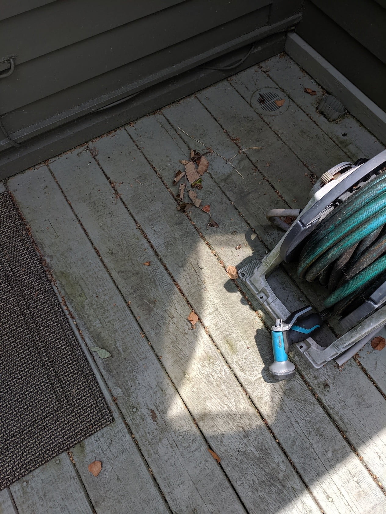

I need some helpful advice. I live in a condo and have to depend on the association to repair and stain my deck. Unfortunately, the association is not a strong one. I have been trying to get my deck properly cleaned and stained for the past three years. I have old boards, some previously used brown stained boards and two weeks ago, 4 brand new boards were added. What is the best method to get this stained properly? I only get the run around when trying to get answers from my condo association.
Post a picture.

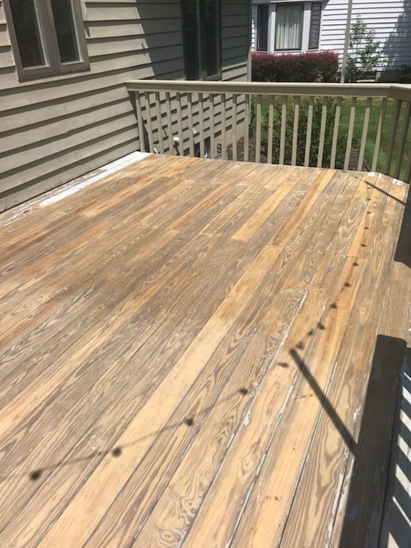

Here’s a pic of the deck floor. I don’t believe they can properly wash and stain at this stage, but need more information before I go back to the association. I appreciate any information you can share. Thank you very much.
You already have a solid stain on some of the board so the easiest thing to do is pressure wash for prep and apply a solid stain to call so it looks even: https://www.deckstainhelp.com/what-are-the-best-solid-color-deck-stains/

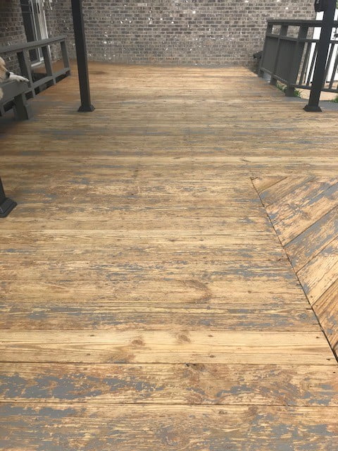

Hi, I have a similar situation to above, but my Superdeck can is labeled Semi-solid, but seems to show like a solid. I will follow the order above, my additional questions are, do I try to strip it with RAD and the additives first before sanding? And what grit is needed to take the stain off? I’ve read 60-80, is that correct also for removing solid stain?
Do you have a picture?

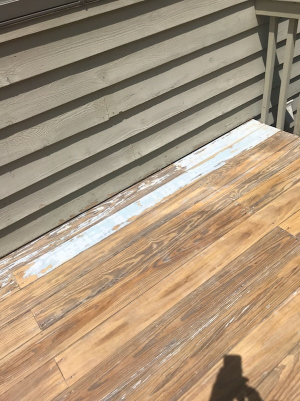

What has come off so far came off from power washing a few days ago. It was 2 coats of the Sherwin Williams Superdeck semi-solid, 3 years ago.
You will have to sand this off. The RAD stripper or any stripper will not remove this. 60-80 grit.

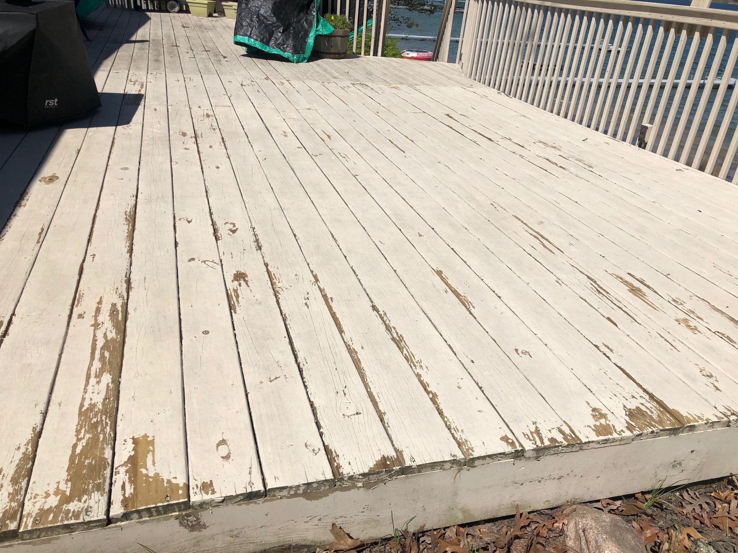

Hi, our deck has a solid stain that is peeling. We have cleaned, scraped, and finally sanded to remove all peeling. We are now planning to apply the defy extreme solid stain. After we have sanded to remove the peeling spots (about 50% of the surface is now sanded), do we need to use brighter before application of the new solid stain, or does solid stain not require it?
No need to brighten with a solid stain application.

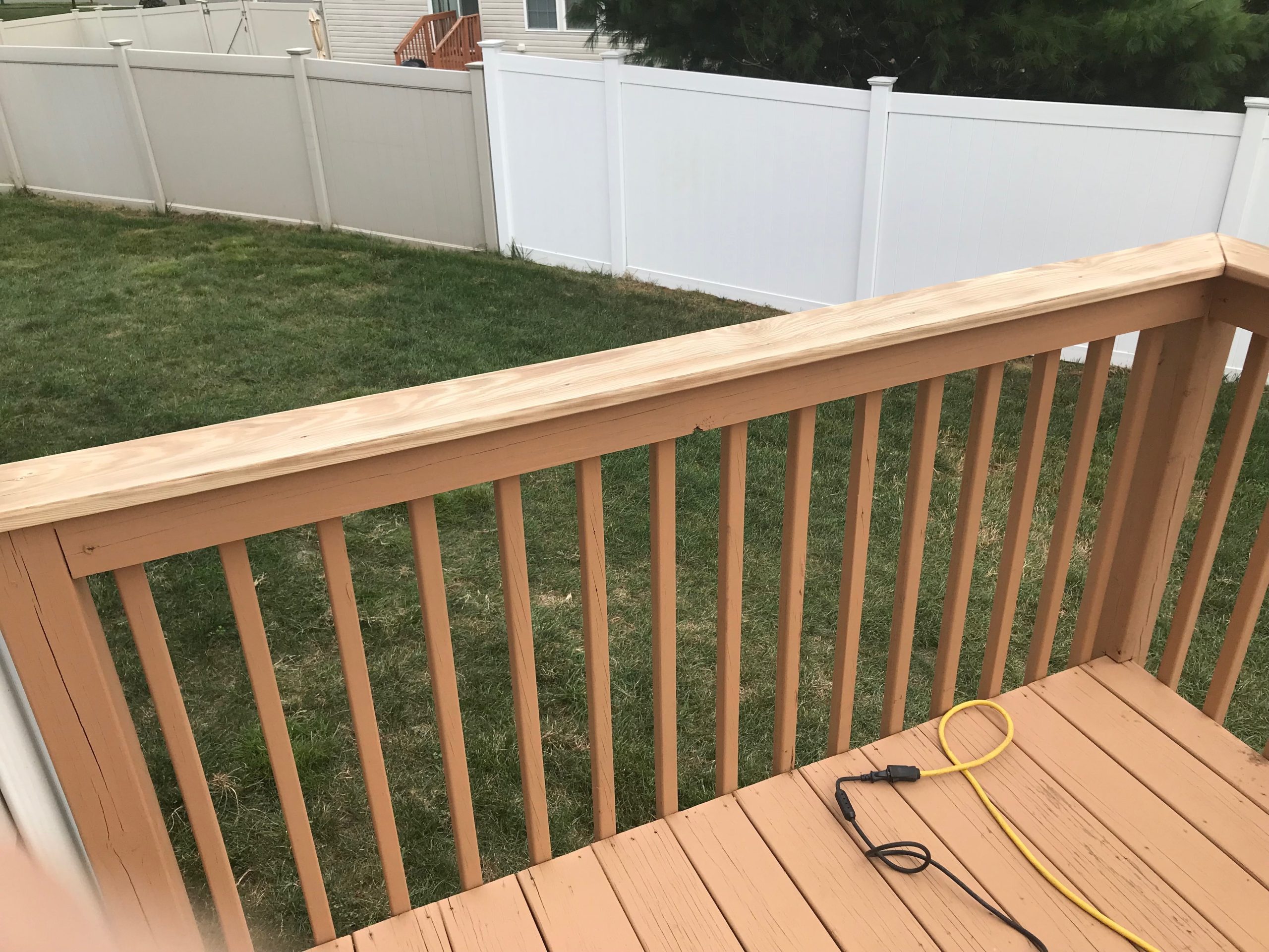

HI I started stripping the deck today and I found some rot and splintering in a few of the boards.
The splintering is on the top rails and I would like to replace them with new pressure treated 2×4’s and the rot is on one of the steps that I want to replace with a new 2×6 pressure treated board.

We moved to a new house in December down the Jersey Shore. It is a wooden deck of about 450 square feet with eight steps and a small landing to the lawn. The deck apparently is only 2 years old or so, but the previous coating is cracking and peeling and the wood takes on water and turns dark when it rains. I’m pretty sure the former owners left a can of the stuff they used: Behr DeckPlus Solid Color Waterproofing Wood Stain. I want to refinish the deck before it deteriorates any further.
I went to powerwash the old stain off, only the loosest parts came off, it didn’t really work on the good sections of wood. Either my little powerwasher isn’t strong enough, or it just needs to be sanded fresh.
So, I started sanding. I have a small 5″ hitachi hand orbital sander with a 2.0 amp motor. I went through six 60-grit pads just to clean one section of handrail, and it took me over a half-hour. A rough estimate gives me about 10 hours to get just the handrails alone, and countless more to get the actual floor and all of the spindles.
My questions:
1. Do I need some kind of paint thinner?
2. Do I need a stronger pressure washer?
3. Do I need a bigger sander?
4. Do I have to sand it completely down to clean wood, or can I go over this stain?
5. Is this a normal amount of labor for this scale project?
6. Is there anything else I’m missing in the process?
The only way to remove this fully is to powersand. https://www.deckstainhelp.com/how-to-sand-your-wood-deck/

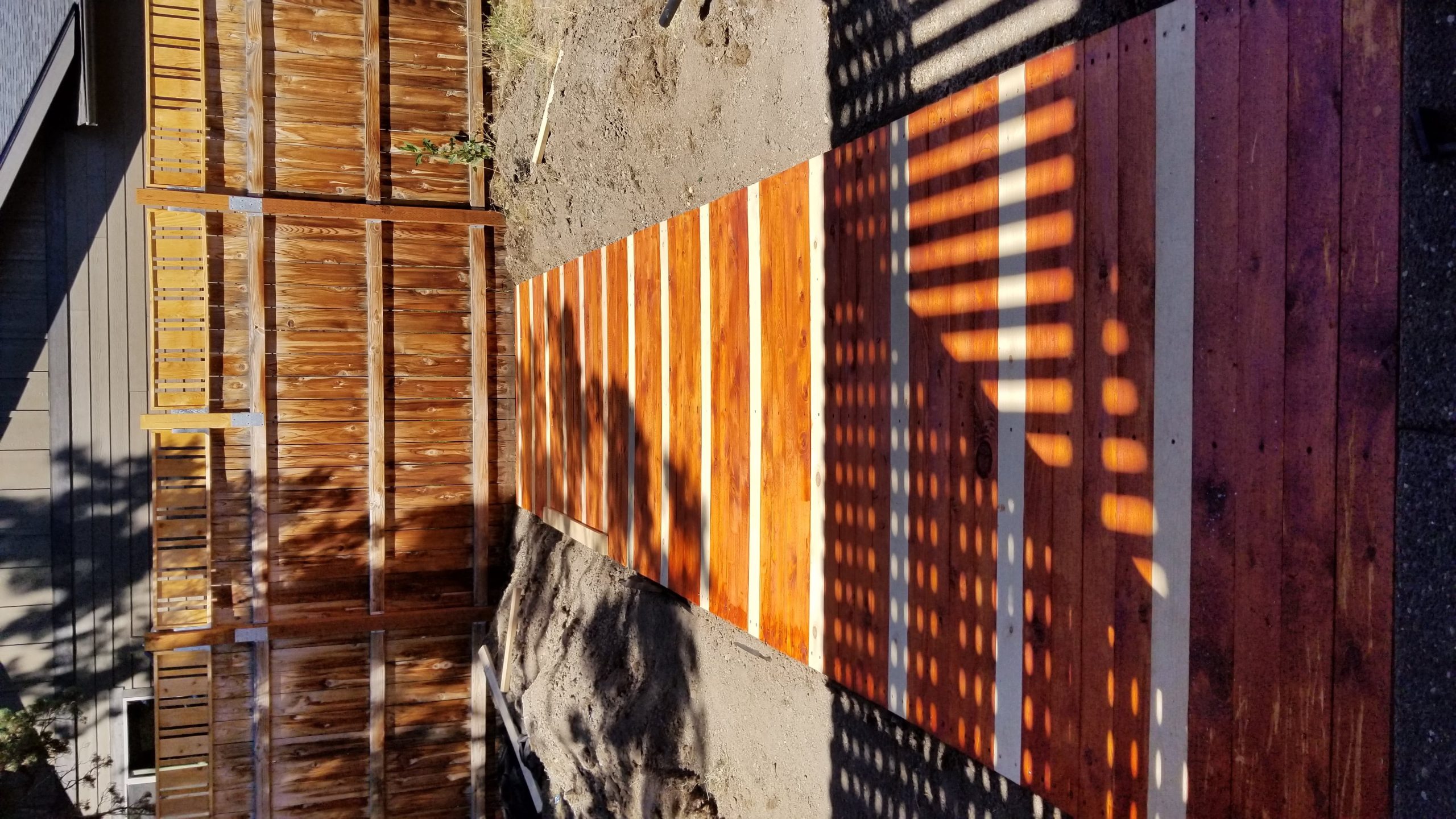

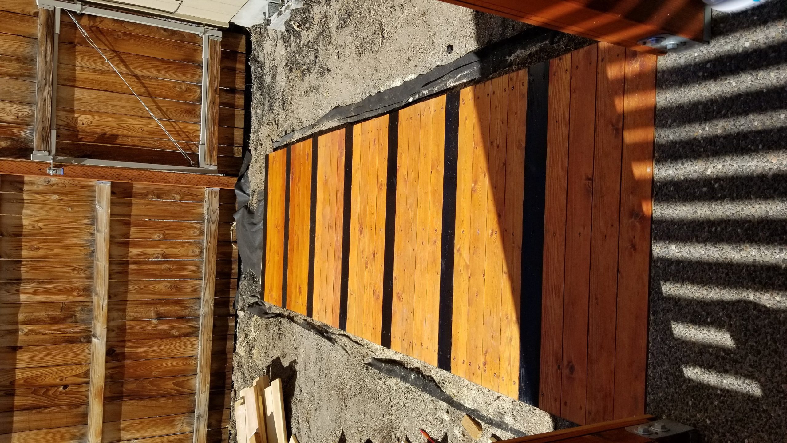

I have attached pictures. I used Sunfrog deck sealer in Mahogany Tone for the boardwalk that has the dark brown stripe in it. Nobody carries that product locally so I brought some wood into a local paint store to match the Sunfrog .That is how I came to use the Storm 2 Mahogany Flame stain. As you can see it is more red and I want to remove it completely.The Sunfrog was also used on my Pergola sothe Storm product doesn’t match very well. Thank you for any help.
Try this to remove: https://www.deckstainhelp.com/restore-a-deck-injectable-deck-stain-stripper-review/
Since it is newly installed, you may need to strip a few times to remove all. Make sure to use the RAD Brightener after you are done stripping.

I used Storm 2 Mahogany Flame Oil Stain on my boardwalk yesterday. Can I remove this product and how? It is too red. Thank you for your time in advance.

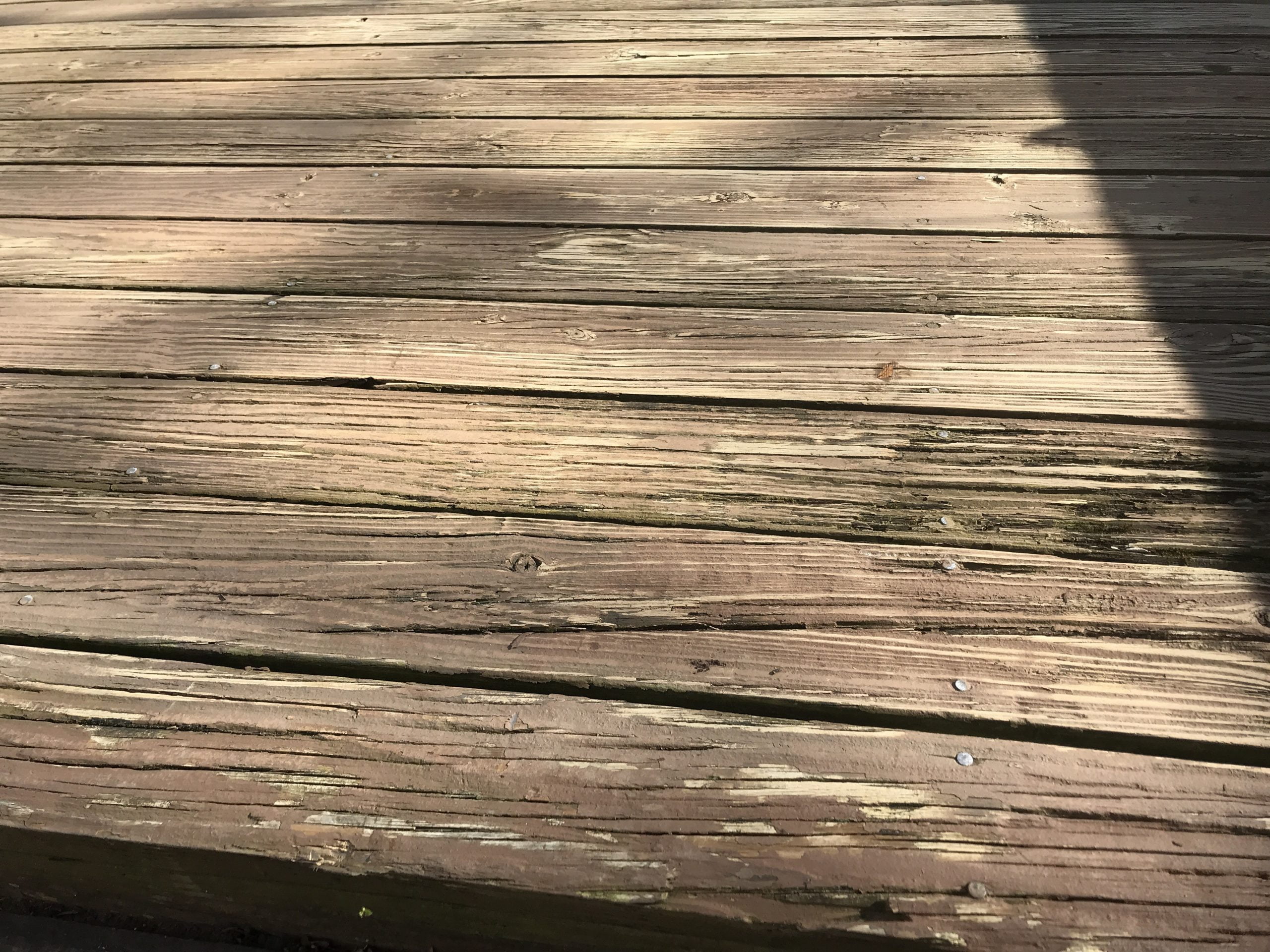

I have been reading past posts on stripping decks. I’m not sure how to handle my situation. Last year we stained our new cedar deck (waited 4-5 months) with Sherwin Williams Superdeck, waterbase, semi transparent stain. After this Minnesota winter over half of the stain on the decking came off. The rest of the rails need touching up. We are unhappy with the results and it was not easy to work with originally, so we would like to strip, brighten and redo with another product. (Oil base transparent) I’m getting the idea that we have to sand it all off, because of what product we used (water base). Now if sanding it all off is our only option to remove this, can we fix it by using the same product and having it last longer? Would switching to a solid color hide the fact that we fixed it? Do we need to stay with this brand? At this point we want it to look nice and could possibly deal with sanding at another time.
Strip off what you can and sand if needed what does not strip off. Brighten all after. Don’t use the same stain. It will repeat the issues. Using a solid stain will result in peeling eventually

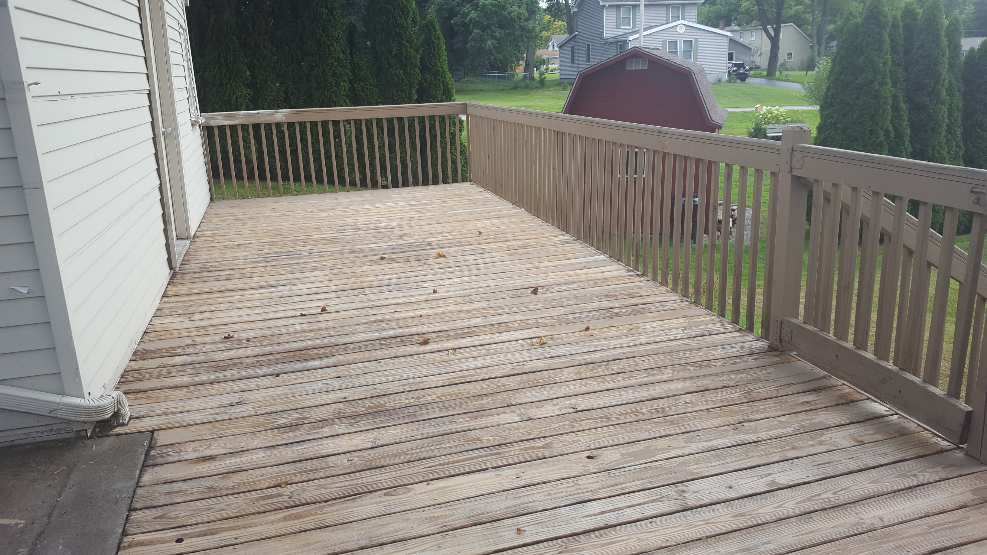

Have a deck which has 3 different shades of stain; a reddish tone , a light brown tone and a darker brown. Stains were applied by previous owners but they appear to be semi transparent because I can see the wood grain rather well except on railing. . In order to gain consistency of color I used a course/medium sandpaper sponge and sanded the railing, spindles and privacy fence.Brought it back to almost a very light brown on spindles and privacy fence but could not gain same results on railing(some red still evident) and fascia boards(muddy brown) . Purchased Ben Moore semi solid stain in an oxford brown color and tested it on small railing section and it dried to a noticeable gloss finish. What did I do wrong and how do I rectify it . Not sure about the color nor my decision to use a semi solid stain…HELP!
Post some pictures please.
Tried to send some pictures to :DeckStainHelp.com but was informed it was an invalid address
Post them here please, not in emails.

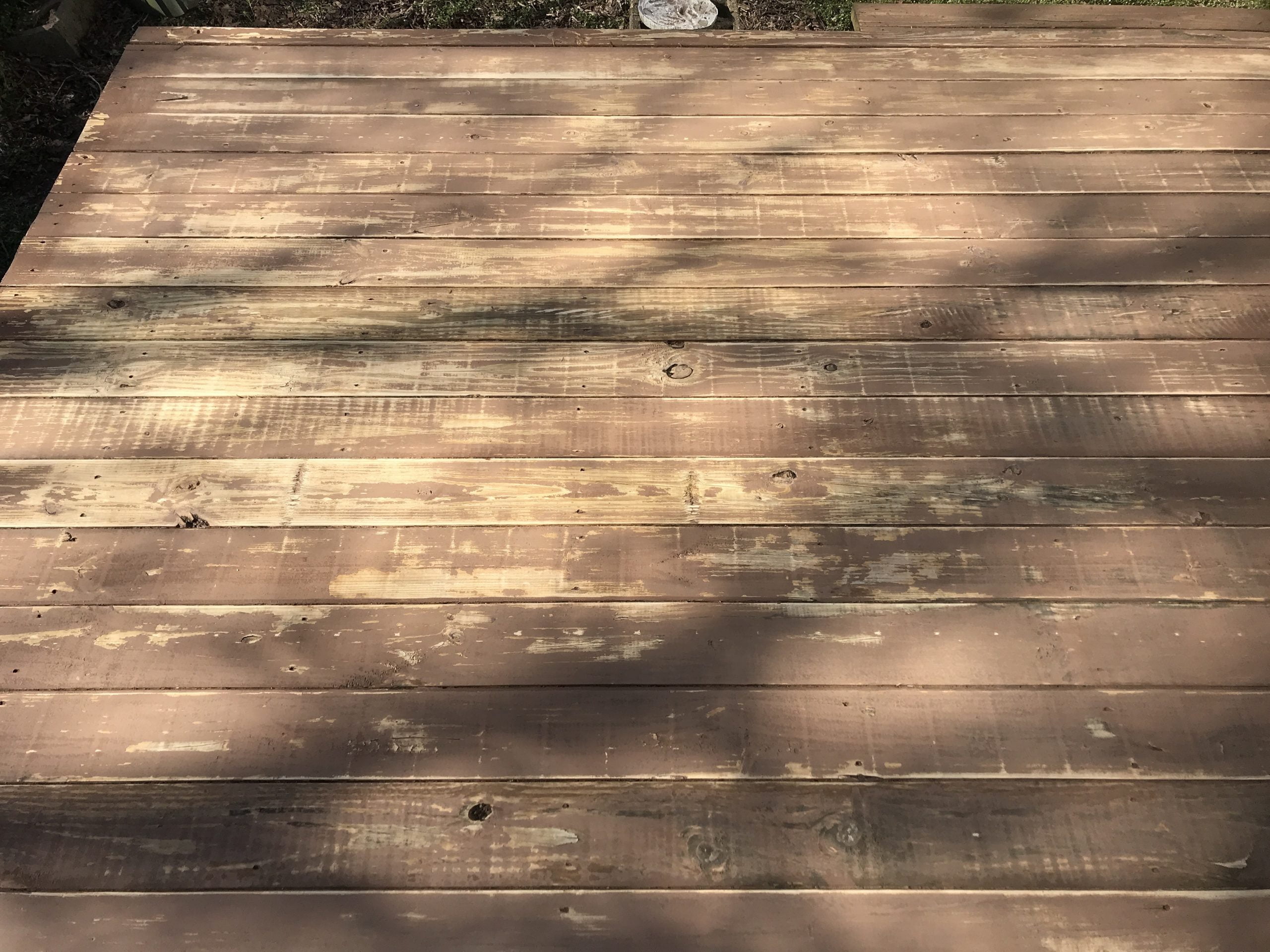

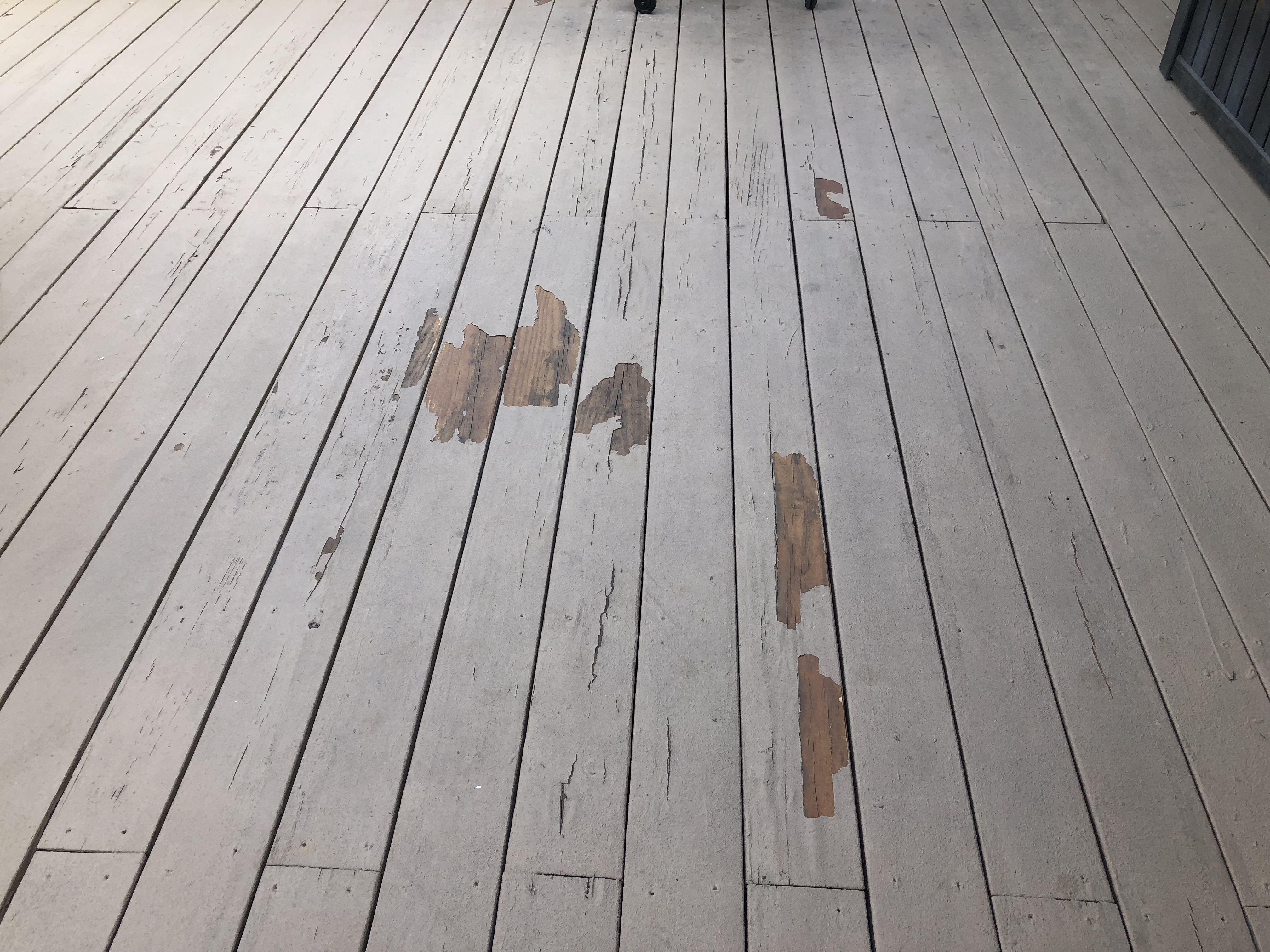

I stained my deck last summer and it looks really bad. Its patchy and blotchy as seen in the pictures. I sanded the entire deck last summer and would like to not do it again. What is the recommendation to remove the stain, stripper? Can I re-stain after?
What brand is that? It may not strip off fully so sanding may be needed.
Sherwin Williams SuperDeck
Water based or oil based version? Looks water based.
Yes it’s water based semi-transparent.
This will not easliy strip off. Strip off what you can and then sand the rest off. Brighten when done.

I have been sanding down my large deck to remove the solid stain. I’ve used the deck sander as you can see and removed a significant amount, then I moved on to the belt sander, and now I’m down to the palm sander.
My current challenge is that the palm sander is not lifting the stain, due to lack of pressure or weight that comes with it’s heavier counterparts. I’ve been using 24 grit paper on the palm sander, and while it’s sanding off the top layer its not removing it nearly as before. I have some really challenging spots to sand down so its impossible to put my body weight into it.
Based on what I’ve read Restore-a-Deck doesn’t remove solid stain and it’s not like I can go buy it off the shelf (on-line only), but that’s beside the point. I guess my question is; for those hard to reach areas and stubborn thick spots, can I apply, reapply & reapply (if necessary) a quality stripper? Along with my pressure washer, would that do the trick?
Thanks in advance for your guidance and any extra pointers you can provide.
A stain stripper will probably not remove that. Go to your local rental yard and ask for a floor edger that is used to sand interior floors. Use 80 grit paper. It should take it right off.
Okay,
The edge sander was a God send, thank you. I’ve moved on and completed palm sanding and for the we’re down to only solid stain between the board. Considering we have SOLID STAIN (but now 99.8% is down to bare wood) and we want to go semi-transparent:
1) Restore A Deck stripper will need a little more time and/or elbow grease to remove remaining solid stain, correct, or do you recommend a different stripper for solid stain?

I tried a deck stripper on my solid stain and now have a mess. White film and deck is not stripped. Will sanding take the white off? Tried pressure washing, cleaner, soap and water with no luck. Before I rent a orbital sand will it work?
It should. Feel free to post a picture.
well rented a deck sander and after 4 hrs not much has changed. The white is almost gone but the solid stain is still there. I like shabby chic but not sure about the curb appeal on a deck. Thank goodness I did not try to strip the other half of it. Did sand it with 120 to get the top dull so in time I maybe able to re stain that half. Now thinking of replacing the other half of the deck this summer. Wish I had read the instruction before attempting to strip that part. I distress furniture all the time for resale but never again will try to redo my deck. Lesson learned in Louisville.
Hello everyone,
This is the situation, we did a deck for a client we replaced all damaged red wood pieces and prep the rest so the client said he wanted a Red wood 330 solid color when he saw the results he didn't like it he said he meant semitransparent red wood 330 color , what should or I can do now?
You would have to remove all the solid stain by sanding down to the bare wood if you need to switch to a semi-transparent.
