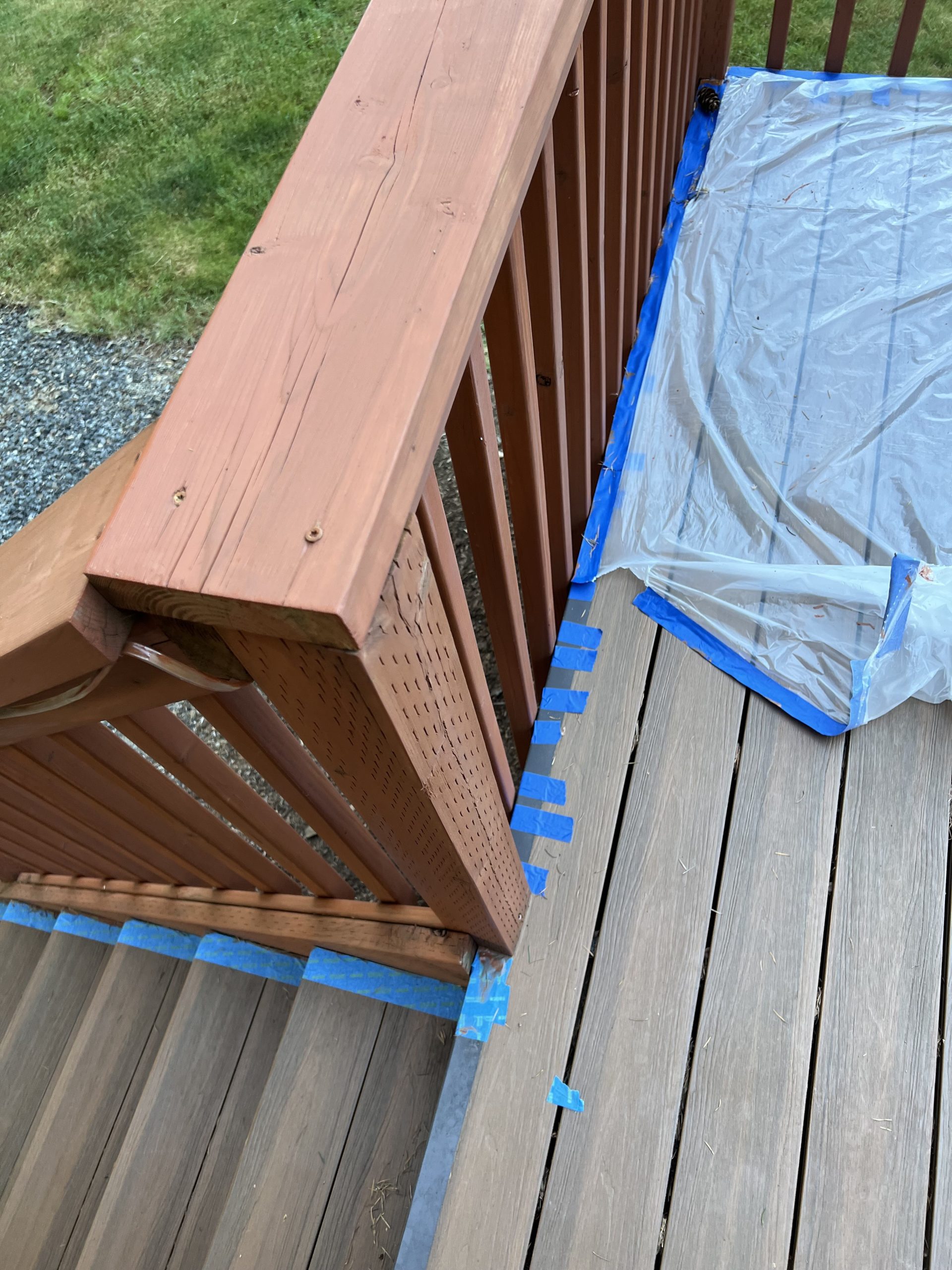

Now that I finished my deck project I thought I’d submit a review of the RAD products. My 500 sqft deck was stained with Pennofin back in 2010 then completely neglected since then. And I mean “completely” neglected. I didn’t have very high expectations coming into the project.
I couldn’t be happier with the results. I used RAD stripper and brightener kit for the project. This is industrial strength stuff so I took all the safety warnings seriously. I wore long sleeves, rubber gloves, painters mask and eye protection. I applied the stripper to 3/4 of the deck via sprayer before it clogged, then applied it via brush the last 1/4. After 30 minutes I rinsed it off with a 1600 PSI pressure washer using the green nozzel. It ended up removing 95+ % of the old stain.
After applying brightener to the whole deck I wasn’t completely satisfied how the brush application section turned out so I took another pass at it with the stripper. Then via a suggestion to a question I submitted earlier in this thread I applied another application of brightener to the whole deck and let it dry into the wood. Fantastic results. I ended up staining it with TWP Honeytone.
Before, stripping/brightening, and after photos tell the story.

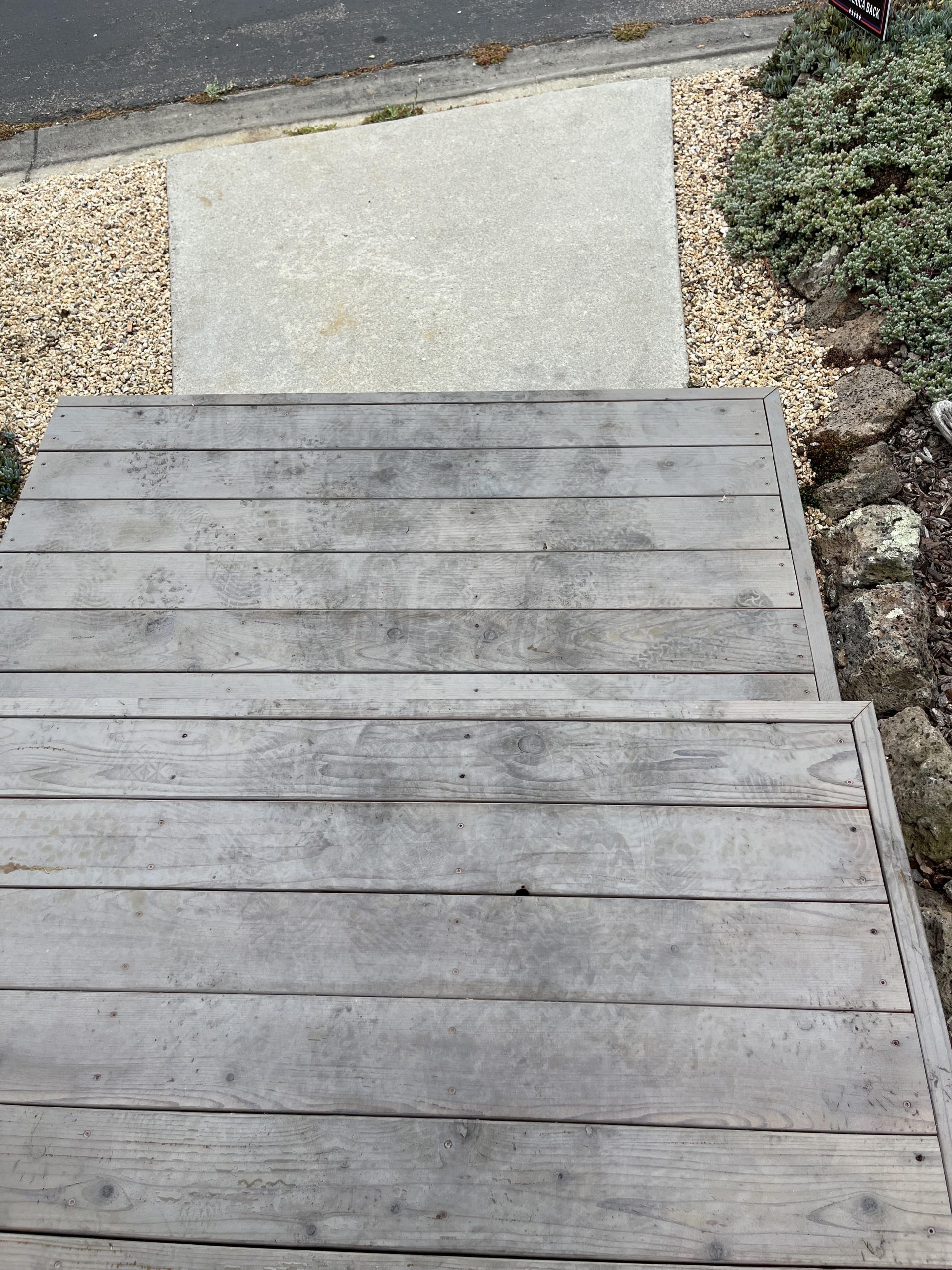

I need some advice on restoring a 15-year-old teak deck. It was cleaned and brightened with various products over the years, and oiled with Penofin oil, which still has some residue on it. I need advice on what products would be the best to clean, brighten, and what finish product would be the best to use to restore the beautiful color of the teak. Please help. It is a large deck and I would love to hire someone to do it, but have not found a contractor. I can do it myself with the right product. I am not sure if Restore-A-Deck is the right product for teak that has oil residue on it.
Yes, it is.

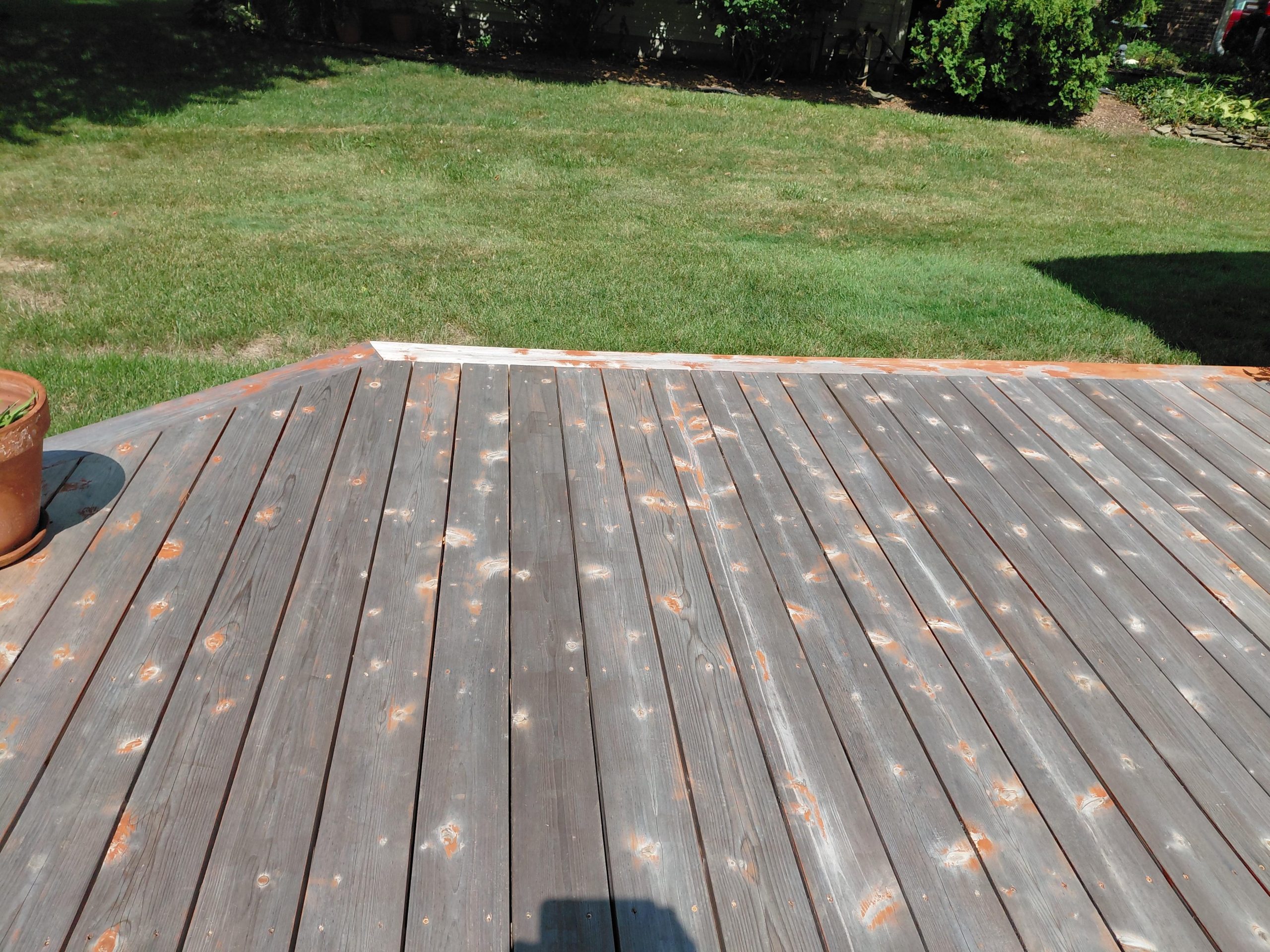

Post some picks. It might be metal that has rusted in your wood.
https://www.deckstainhelp.com/remove-rust-black-stains-from-deck/
Sounds like brightener will do it. Yes, its the metal flakes that have rusted. Screws are fine. Rest of deck is fine. Because wood has the armstrong clark on it assume I need to use the stripper first then the brightener? Or cleaner then brightener?. Brightener only? Thinking I need to get down to bare wood to get rid of all that metal dust. Doesn’t help that it kept getting walked on & then thoroughly soaked into the wood. Just wanting to confirm what combo I need to order. Thanks so much. I hadn’t been able to find the rust document.
Brightener only should work and then a good pressure wash rinse.

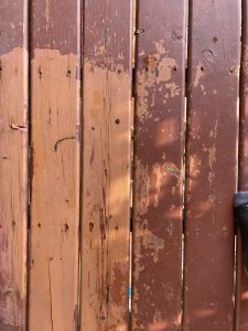

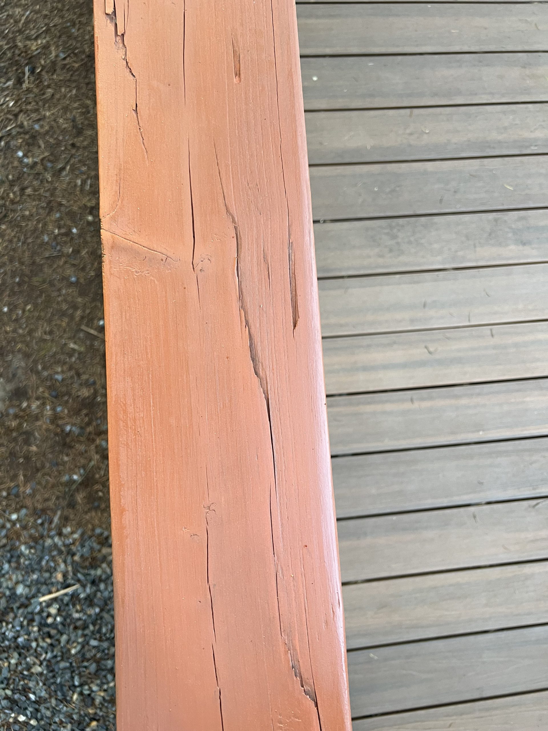

Wish I had found this site before I purchased a Cabot semi-solid New Redwood stain. The color is much darker than anticipated. Will this product be effective at removing a semi-solid stain? In addition, is it easier to remove a semi-solid stain sooner after staining (as opposed to waiting until next year to remove)?
Semi solids are one of the hardest to remove. You may need a paint stripper. Post some pics.
The intent was to match or compliment the base slats, but the final color of the stain is not really close to the sample color that I was shown
That is more of a solid opaque stain in appearance. A deck stain stripper will not remove it. See here for tips:
Thanks for the advice Scott
You are welcome. If you do not want to strip, you could coat over it with a solid stain color that you like better.

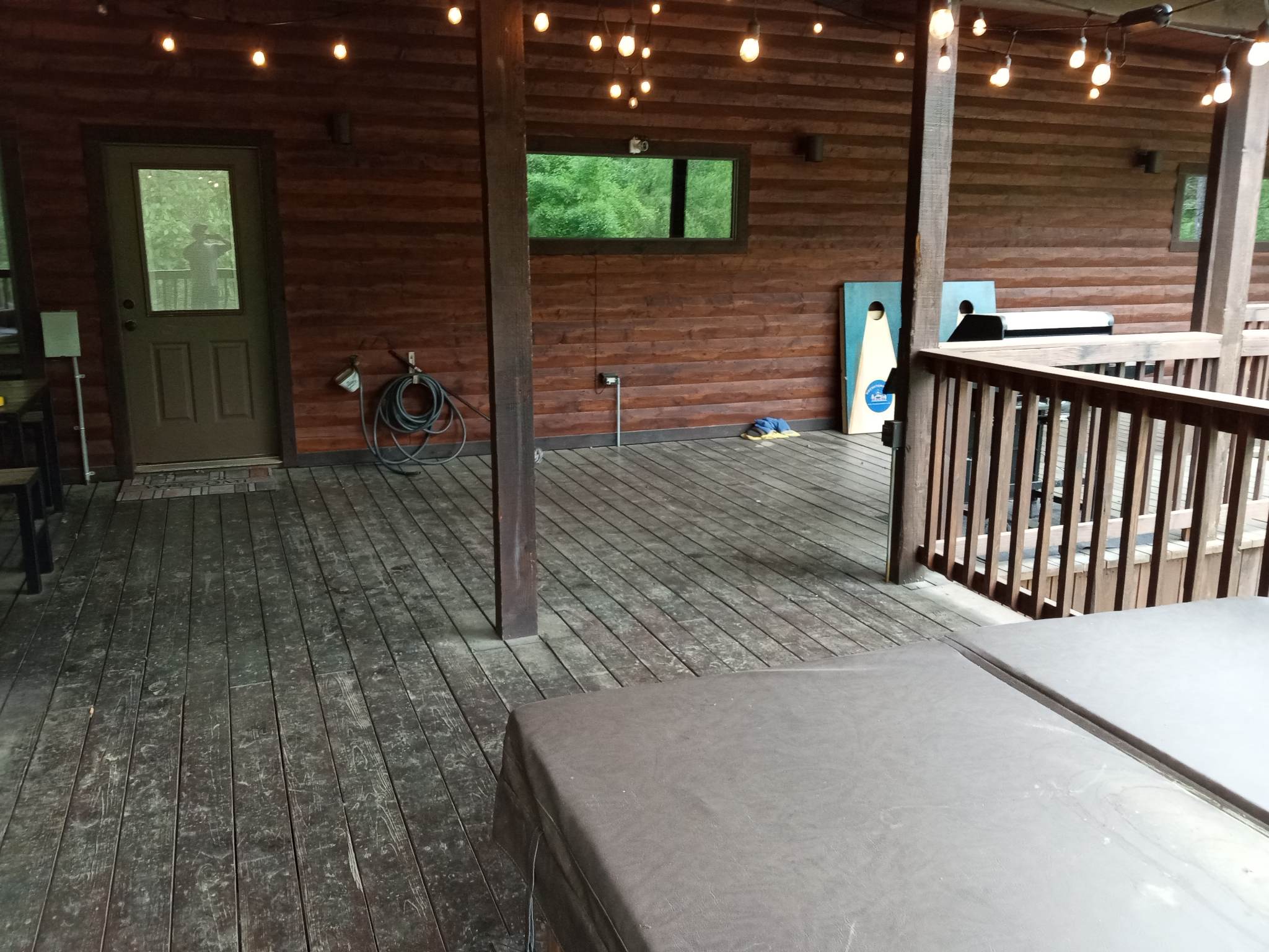

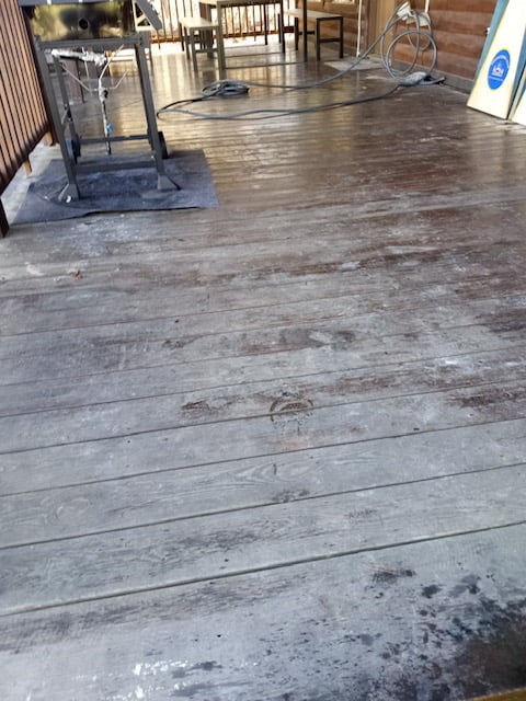

I have a rental cabin that was purchased 1 yr ago. At time of purchase, prior owners had deck restained. I am not sure of the product probably sikkens. seems like just within 1 yr, the deck showing a lot of wear and I want to restore. If I just use the RAD stripper, booster and thickening gel.
It is too thick to use a regular stain stripper, almost like a shellac. You would have to use this product to remove it.
Anything you do not want to be stripped will have to be covered as you will need to pressure wash it all off.
Is it possible not to strip it but just add a solid or semisolid stain directly on top after power washing? What product would you recommend?
Yes, if you want to use a solid stain, not a semi-solid.
Looking at my pictures, would there be a stain you recommend to hide the footprints that get on deck? I think they footprints from the gravel road are light in color. I was thinking perhaps using a lighter colored stain might be better. This would then probably require the full stripping using the RAD paint strip you mentioned.(thanks again for all your help!)
You can use a light-colored solid stain and that would not show the footprints as much.
I messaged RAD compnay and they were of the opinion that it would be difficult to protect verticals from the gel/powerwash off even with tape/tarping. What is your opinion?
I think the verticals are in good condition and would like to keep as is. Having to strip and restain the skirting, rails, cabin body would add alot of cost of materials and labor. hoping for your suggestions on how to get around this.
Yes, nearly impossible to just strip the floors and not remove some on the verticals. You could just power sand the floors.

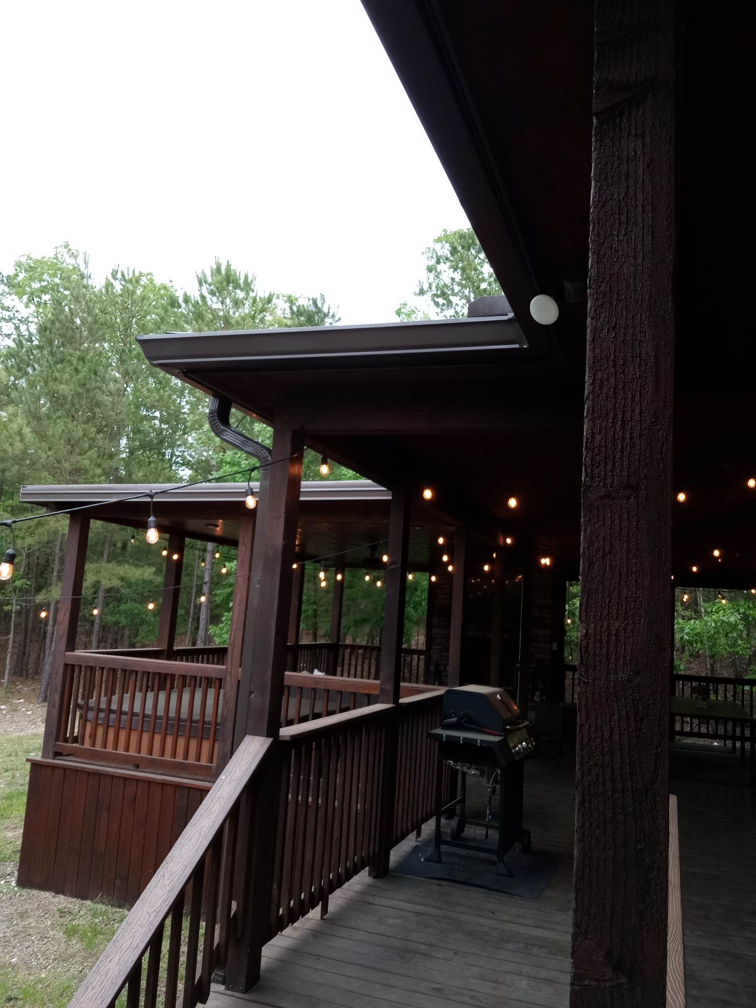

We live in northern Michigan and need some advice on the best way to remove this 4 year old deck stain. We used a Valspar semi-transparent stain; however, it appears to look more like a solid? Perhaps because the deck sits in full shade so it doesn’t get any sun fading or damage.

Can’t answer questions properly without seeing pics.
Hi Scott Paul, Wow, now a year has passed since this inquiry. Somehow, I overlooked, forgot and or rather did not use the #1 Purple Stripper” first. I have scrubbed the deck clean, then applied the #2 Brightener. I have no idea why I forgot the #1 Stripper in my haste. I think I was just going by the color and size of the packages and blue and purple are close in the shade. Sigh.. Anyway, I assume, I need to use step #1 Stripper because there is an old layer of oil based paint on the deck. Do I or should I do #2 Brightener again after? I am thinking the answer is yes to remove the stripper. I’m very irritated at myself that I did not pay more attention. Anyway, Moving forward-backward and forward. Thanks in advance
Post some pics for prep advice. FYI, deck stain strippers will not remove paint.
Will do. Thanks I understand the stripper does not remove paint. It is a prep step.

i have stained my porch railing in white, using Olympic solid stain a couple of times. My deck floor i used Olympic semi solid Sandstone a couple of years ago. My wife wants to use a Special custom mix Defy Solid stain that is white on the railings and change the deck to Defy Driftwood Gray. do i need to strip the railings or can i just stain over the existing. i suppose i will will need to strip the deck, What do you suggest
We would strip the rails to remove what you can and then you can cover the solid stain that does not come off. The deck floor has to be fully stripped.

I am using Olympic Premium Stain Stripper and trying to remove two coats of old semi-transparent stains. The top coat was applied five years ago (Bher water based) and bottom coat was applied 15 years ago (Cabot oil based). The Olympic stripper did a very good job in removing the top coat, however, it didn’t do anything for the bottom coat. I reapplied the stripper generously the second time but it didn’t dissolved or flaked off the bottom coat. It seems the Cabot stain penetrated and bonded very well to the wood fibre. Is this mean sanding is the only solution. Would the RAD work on this particular situation? I attached a picture shows stripped top coat (red) and remaining bottom coat (brown). Thank you for your help.
You have solid stains, not semi-transparent. You will have to power sand to remove this.
Will RAD stain stripper remove PermaChink Vista Deck stain? Also, I only want to remove the stain from the floor boards, not the railing. Do I need to cover the railing with plastic or tarp? Thanks!
Please send pictures.
I have read that before using the RAD stripper product you can thoroughly wet down surfaces such as doors, windows, siding, etc. instead of covering with plastic and/or tarps. What are your thoughts on this? Also, I have a cement patio below the deck. Should the cement and sides be covered with plastic or would thoroughly wetting the entire area down be sufficient?
Photos attached
We prewet and rinse all the time when stripping decks. It works but you have to be careful to rinse over spray right away and continually while working.
Cement will not be an issue.
