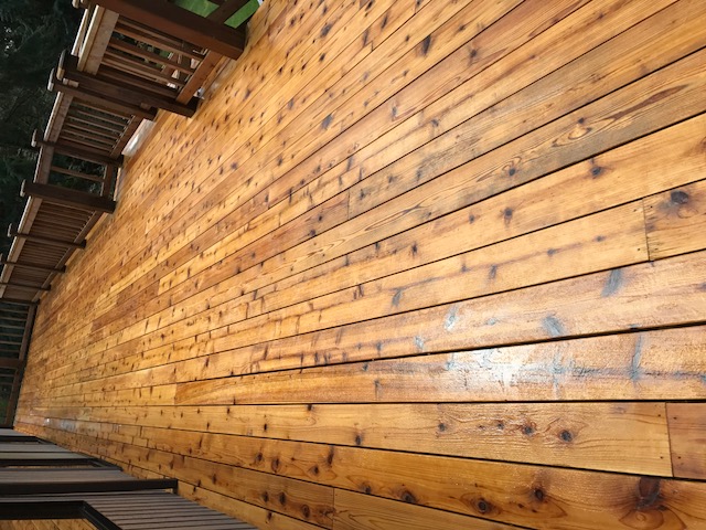

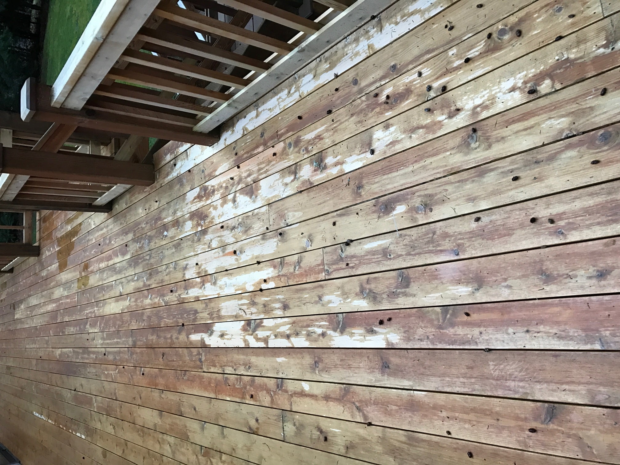

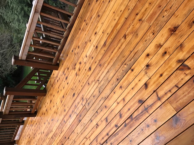

Now that I finished my deck project I thought I’d submit a review of the RAD products. My 500 sqft deck was stained with Pennofin back in 2010 then completely neglected since then. And I mean “completely” neglected. I didn’t have very high expectations coming into the project.
I couldn’t be happier with the results. I used RAD stripper and brightener kit for the project. This is industrial strength stuff so I took all the safety warnings seriously. I wore long sleeves, rubber gloves, painters mask and eye protection. I applied the stripper to 3/4 of the deck via sprayer before it clogged, then applied it via brush the last 1/4. After 30 minutes I rinsed it off with a 1600 PSI pressure washer using the green nozzel. It ended up removing 95+ % of the old stain.
After applying brightener to the whole deck I wasn’t completely satisfied how the brush application section turned out so I took another pass at it with the stripper. Then via a suggestion to a question I submitted earlier in this thread I applied another application of brightener to the whole deck and let it dry into the wood. Fantastic results. I ended up staining it with TWP Honeytone.
Before, stripping/brightening, and after photos tell the story.
Looks great!!

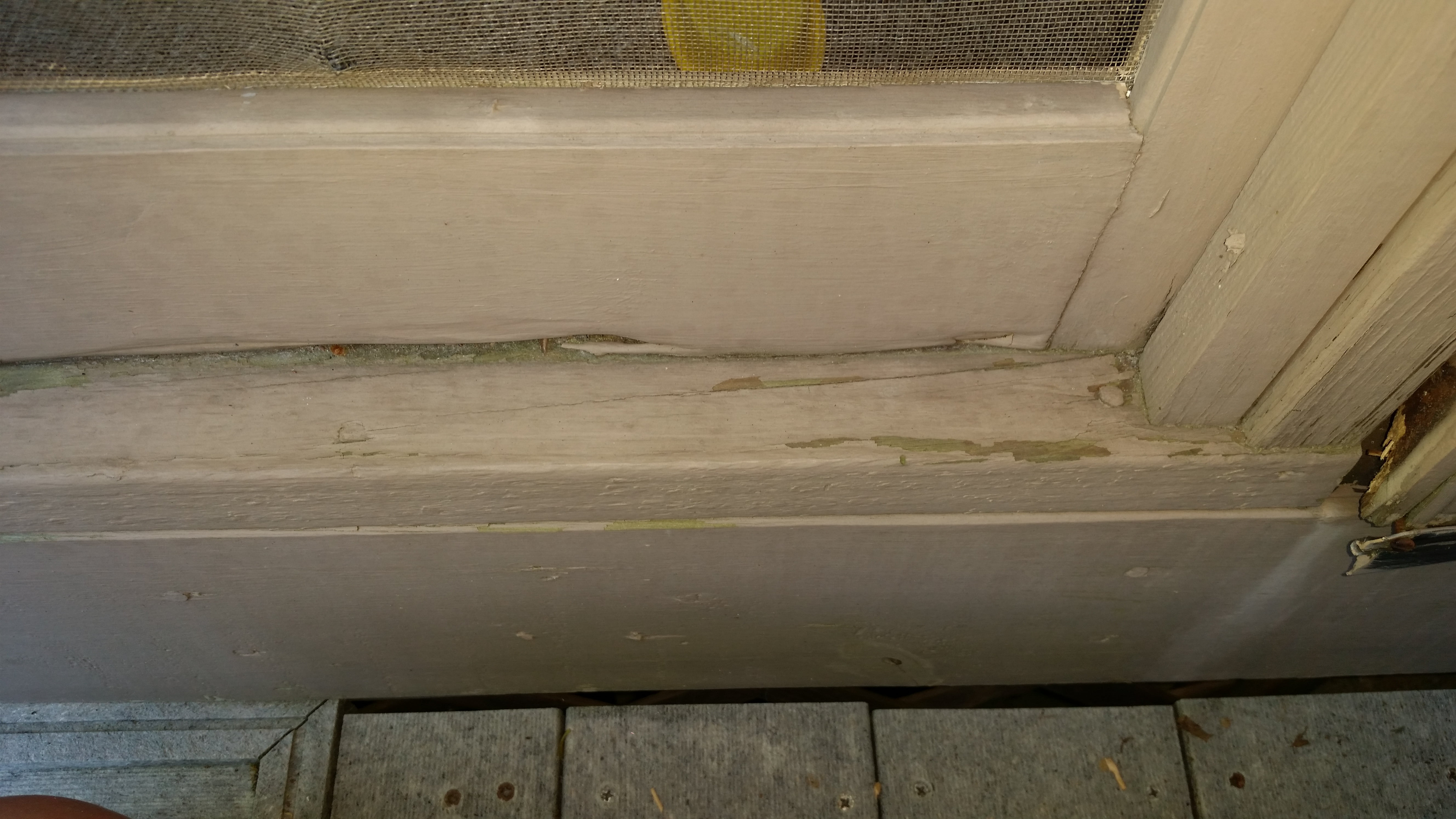

I’m wanting to remove the coating on the exterior of a 3 seasons room. The previous owners applied the coating so I do not know if it is solid stain or paint but I have included a picture. Is there a remove I should try our just scrape?
Scrape or sand to remove this paint.
Strippers will not remove a solid paint like this.

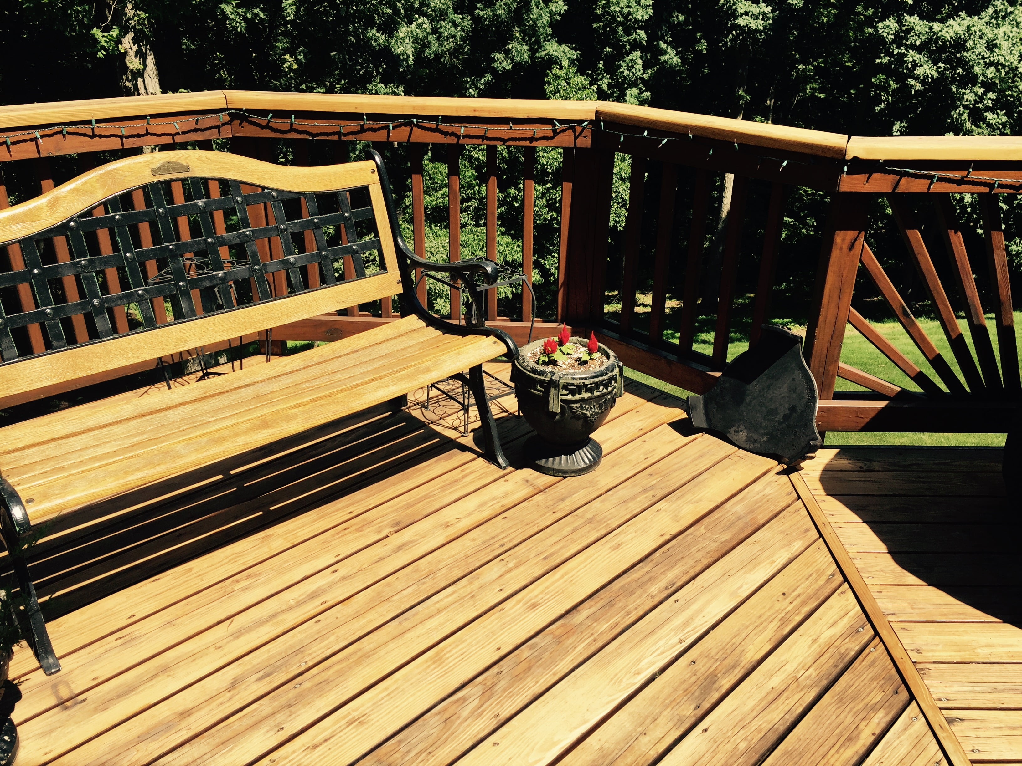

My husband and I faced the same problem as you last summer. Spent two (2) days on our hands and knees countersinking galvanized nails, I think my left hand took about 4 terrible blows from me missing or slipping the hammer off the nail setter. Ugh! Rented a big sander from the tool rental place and took off the first 3mm or so of the surface. Then stained with TWP. Took about a week of labor for us. Looks great!
Post a picture!
Someone who sees this pic might ask about the vertical wood…. well, I was too lazy to strip all 4 sides so I left it just like it was prior to stripping. I kinda liked the contrast. 😉
Looks good! 🙂
The coating on the floor looks light, probably due to all your hard work sanding the wood. Next year you may want to do a light cleaning to remove any dirt and apply another coat of the TWP.
Is that the twp honeytone? We’re restaining and my wife likes that natural look.
Yes, that’s TWP Honeytone

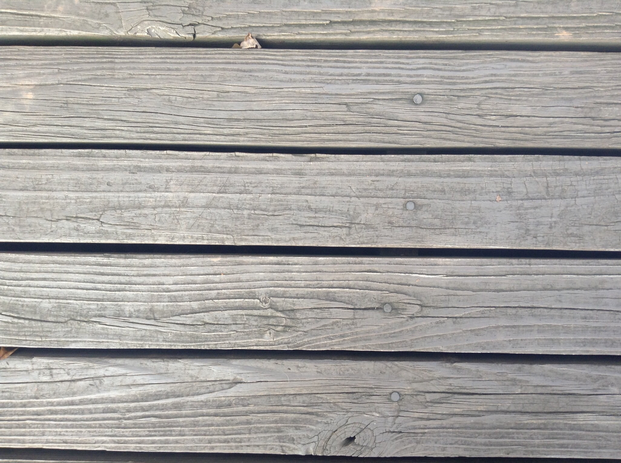

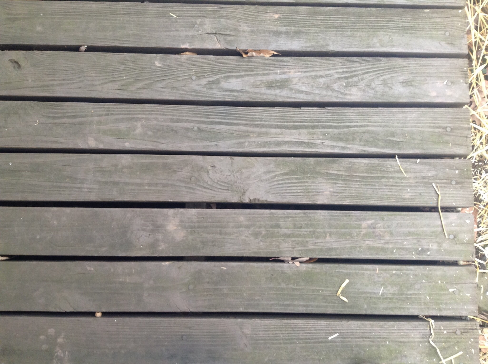

I have a 22 year old pressure treated deck in Buffalo, NY. Over the years I have applied both oil and water based clear sealers. The last stain sealer I used 4 years ago was Flood semi transparent. I just used Restore a Deck stripper and Brightener. It took a couple of coats of the stripper to remove the previous stain. Now there are a few specks here and there of the old stain that I can’t seem to get off. Biggest problem is that the deck was power washed too much and a lot of fussies appeared. The grain is severely raised on some boards. My next step is to rent a floor sander. I will brighten again after sanding.
Questions:
1. What grit should I use? Should I start with coarser and work down?
2. I want to put a semi transparent stain in a “grey”. I tested Defy driftwood but it gets soaked in and after two coats it doesn’t even look like there is a protective finish. I also tested Armstrong Clark grey. That went on more like a paint (thicker and more pigmented) however it did dry and the grain showed through but it is too blue for me. I als heard that Armstrong can wear off on clothes – is that true? I was thinking about getting a sample of TWP 100 in grey. They don’t make 1500 in grey.
Will I be able to get the 100 sent to me in New York?
3. I’m also looking for a product that in future years all I would need to do it clean, brighten, reapply. What product will allow me to do that?
4. Any suggestions short of tearing it out and replacing boards!!???
1. Use a floor buffer with a sanding pad. The white color buffing pad.
2. Stains are supposed to soak in 100% and not film on top with a “protective” coating or shine. The AC only rubs off if way over applied. We never have issues with it.
3. All three you mentioned will do that except TWP 100 Series is not allowed in NY.
4. Not really.
On the home depot site the white pads are polishing pads. Not sure if those are what you are talking about. Is there a grit number or are white color all standard.
They are sanding pads and are in the rental section. Typically 15″ in diameter.

Will this strip SW premium oil base semi transparent brown tinted stain? I have massive decking, stained by a professional . Early problems , SW said the wrong stain was used! Contractor has dropped the ball. Appreciate any advice.
Post a picture of the deck with the SW stain please.

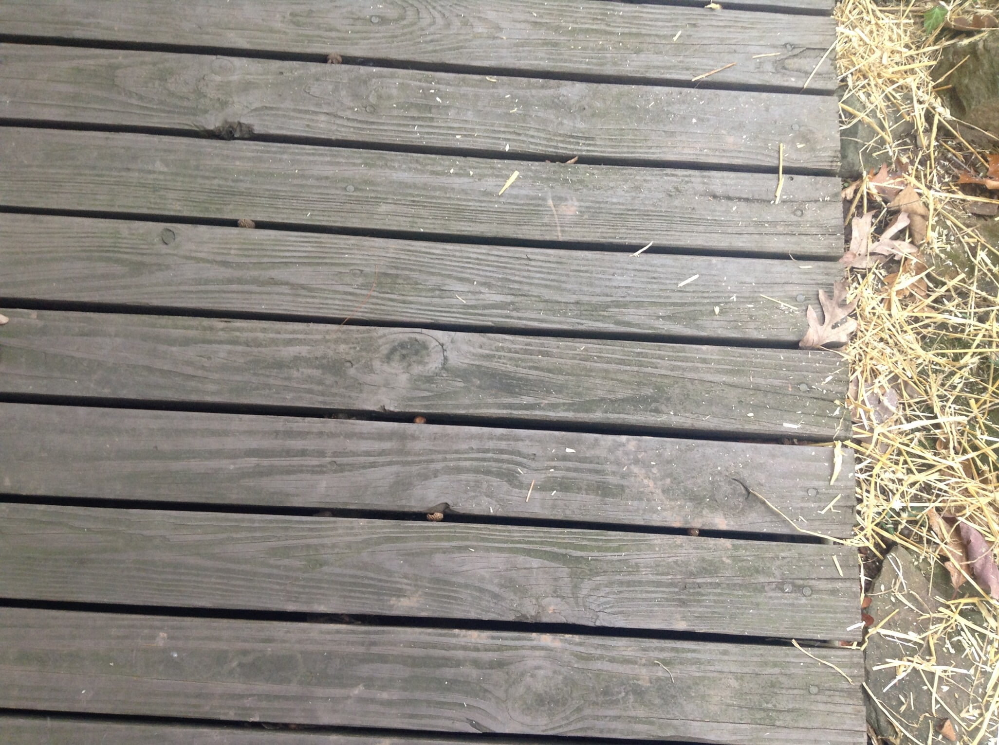

Deck is actually dark brown. These were taken about a year ago. It is nighttime here, if needed, I can take more tomorrow.
Is this how it looks corrently? If so, the RAD stripper and pressure washing will remove. Brightener will be needed as well.
I used CABOT Wood Toned Deck and Siding Stain, 3000 Natural, on a red cedar deck. The can says deep-penetrating oil, but this product started peeling after one winter. It seems to have adhered well to covered areas, but severe peeling in all exposed areas. Will RAD stripper dissolve this CABOT formula?
Yes, this should remove it. Apply and pressure wash off. Brigthen the wood after. If you have time, take a before and after picture and post your results.
Here are the before and after shots of my project. The RAD stripper kit did a great job removing the Cabot 3000, as noted in another post. I have additional pictures of the deck after it dried… in short, it will restore to its original beauty after completely drying out, and re-stained with Armstrong Clark Natural Tone penetrating oil. I think the wet, stripped and neutralized pictures are proof of that.
You did a great job with the stripping!! Looks really good. 🙂
