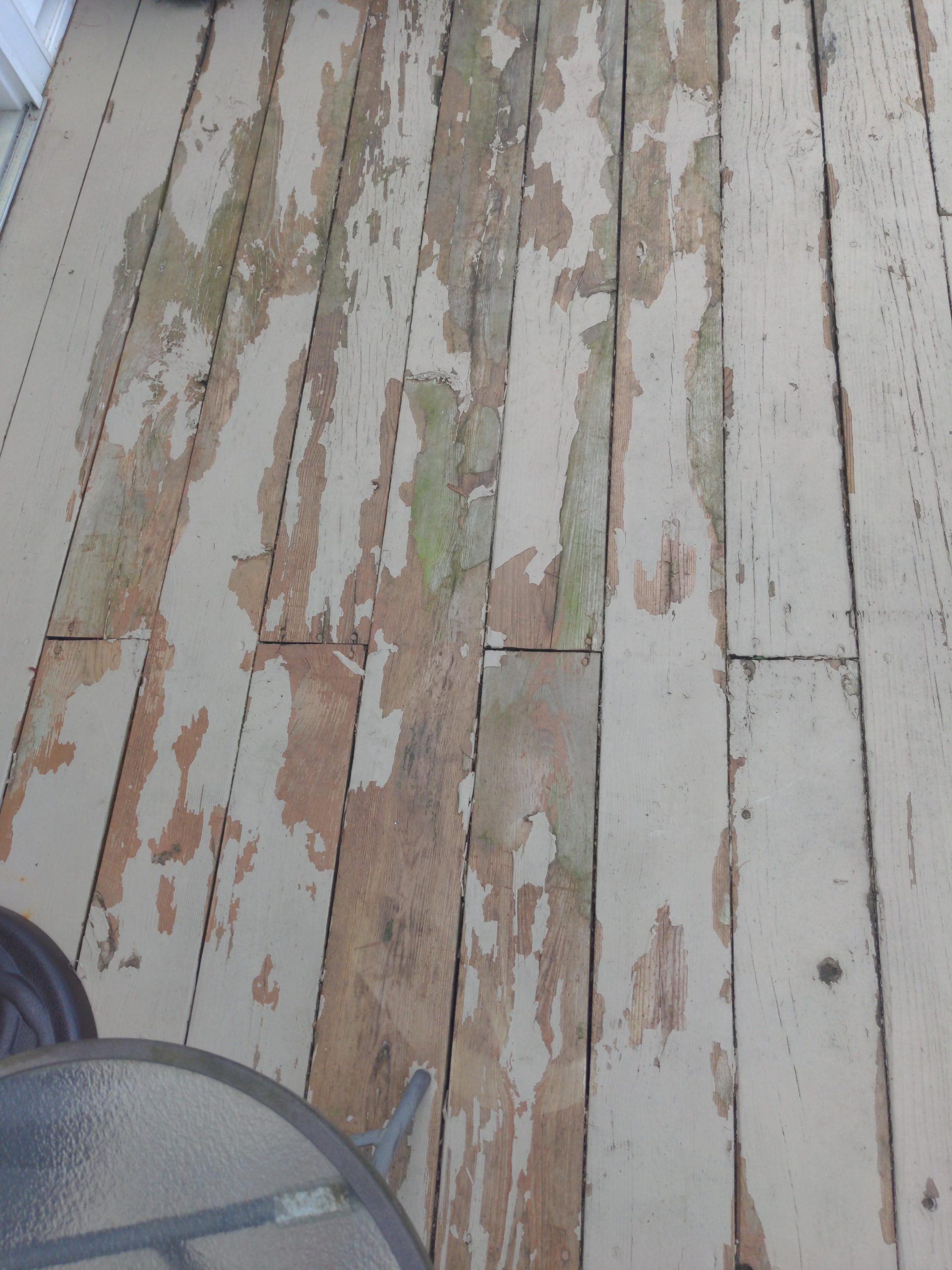

Of all the “Deck Resurface” products, the Rust-Oleum version peels the worst. It started peeling within a few months of application.

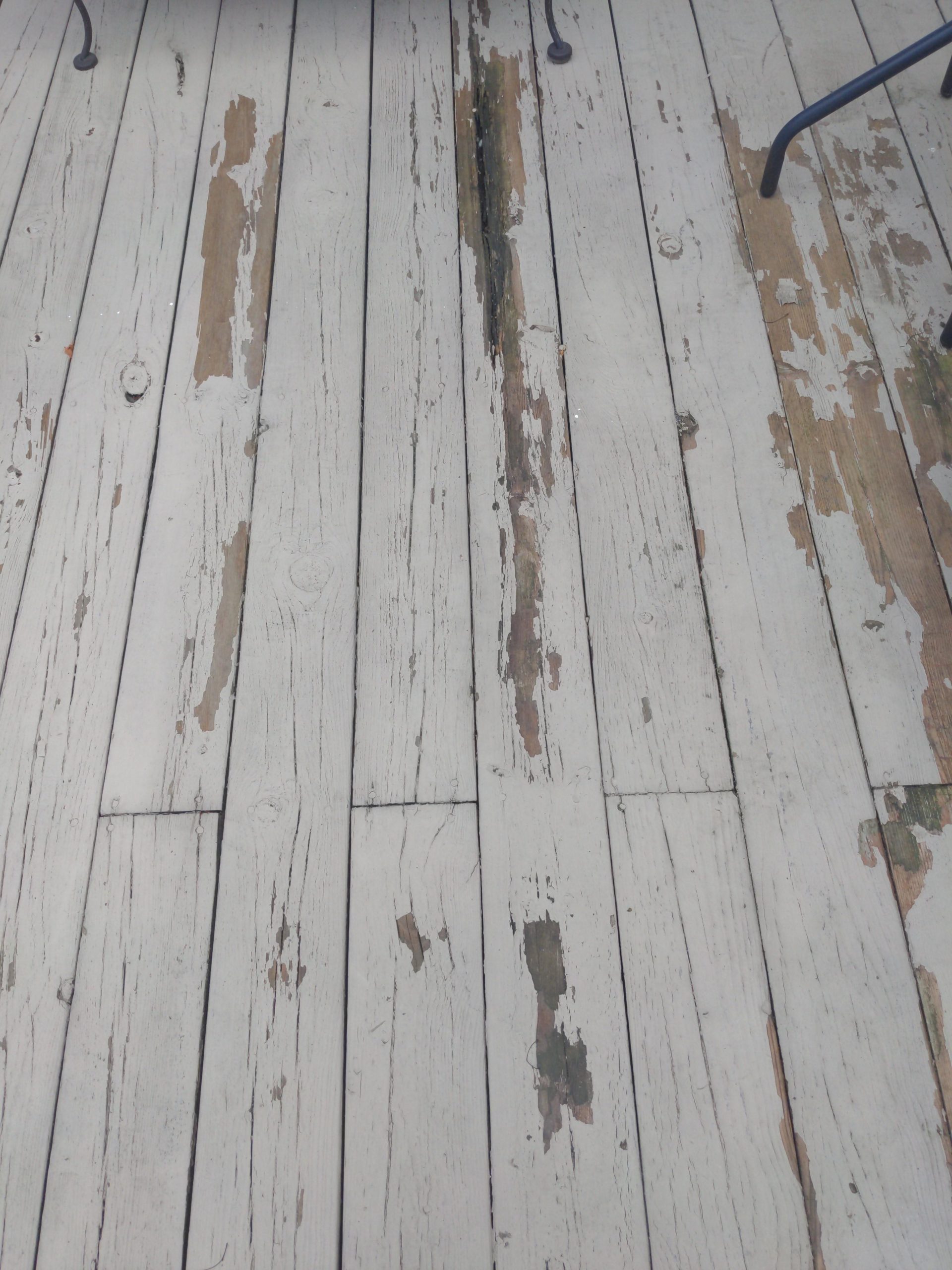

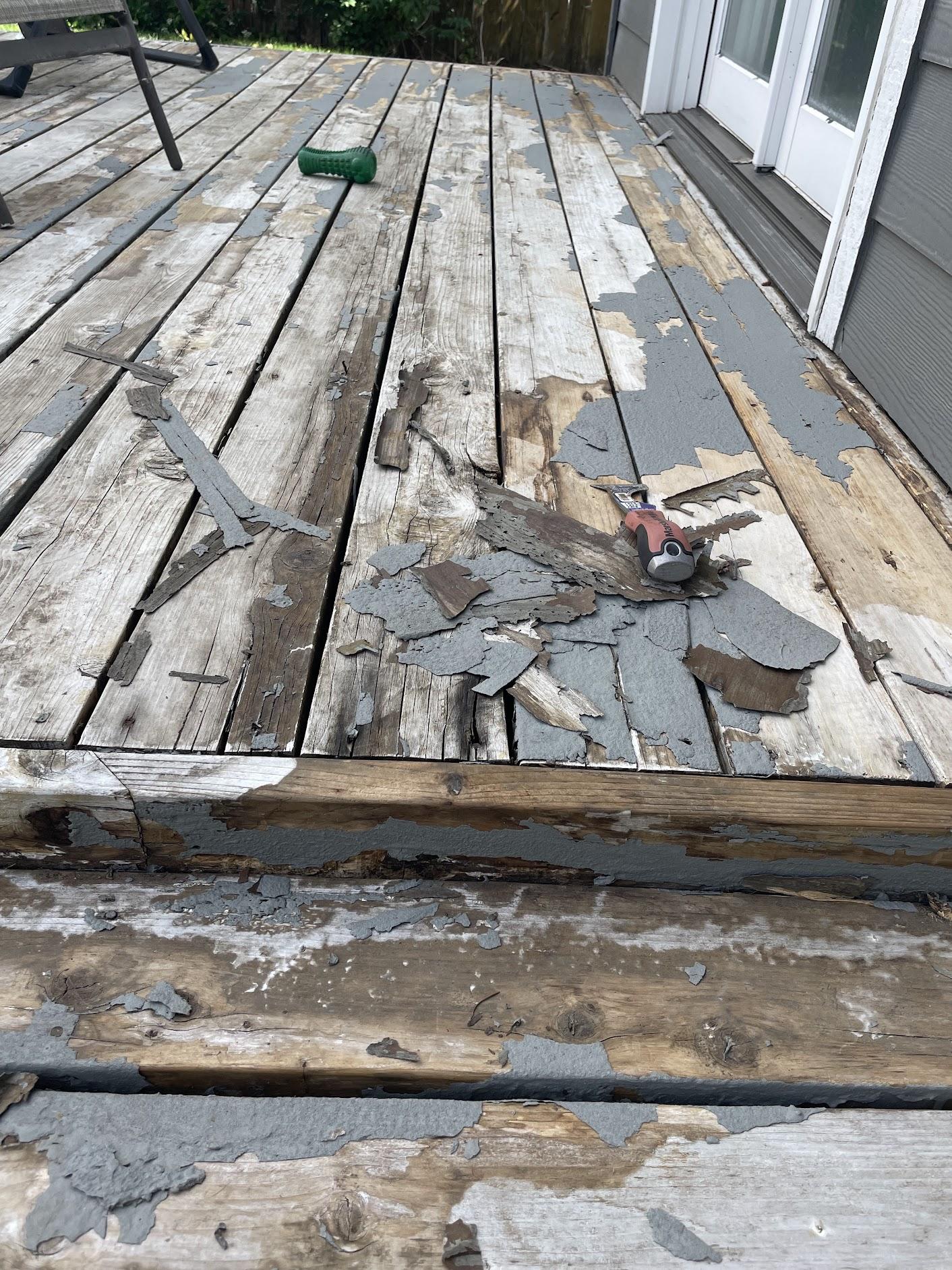

Ranger RE-18 Patch
Pretty much the same story as everyone else. After sending these photos to customer service I was told, “Based on the photos, it appears there was a moisture issue present prior to coating the surface.” Oh, ok.

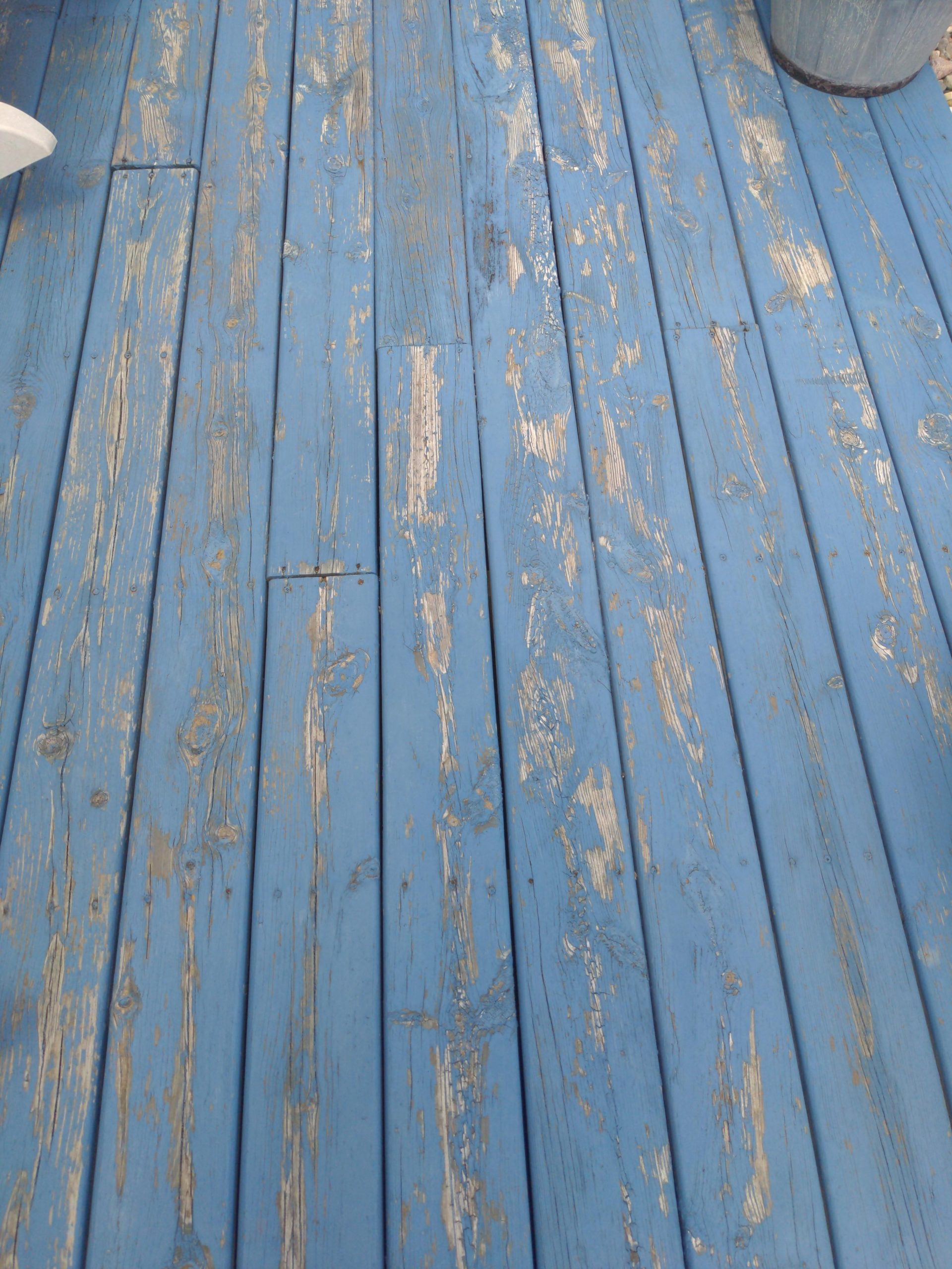

I painted two decks (front and back) with the original Deck Restore. I have herniated discs in my back, so this was a to really big project for me. It didn’t cover nearly as much as they claimed, so I had to go back to purchase more. It looked beautiful the first year! Now, two years later, it looks absolutely awful! It’s peeled up in several places places, but I can’t seem to remove it. Some deck boards are rotted now and will need to be replaced. I wasted my money on 7 gallons of this. I’ve used many different kinds of paint in my lifetime. This was by far the worst. I can’t say enough about how bad my experience with this paint was.
I did a huge deck in 2010. The only places I experienced any peeling was where my dogs had urinated in certain spots and the peeling didn’t happen till 5 yrs later. It’s now 2024. That’s 14 yrs later and just now having to redo whole thing. Only down side I could see was yrs when the pine pollen hits heavily some years. Hard to wash off is all in those instances.I used the original Deck Restore. Worked at Ace Hardware then. Had 2 German Shepherds whose nails would scrape any other regular stain off. I didn’t want to have to stain every year at my age.

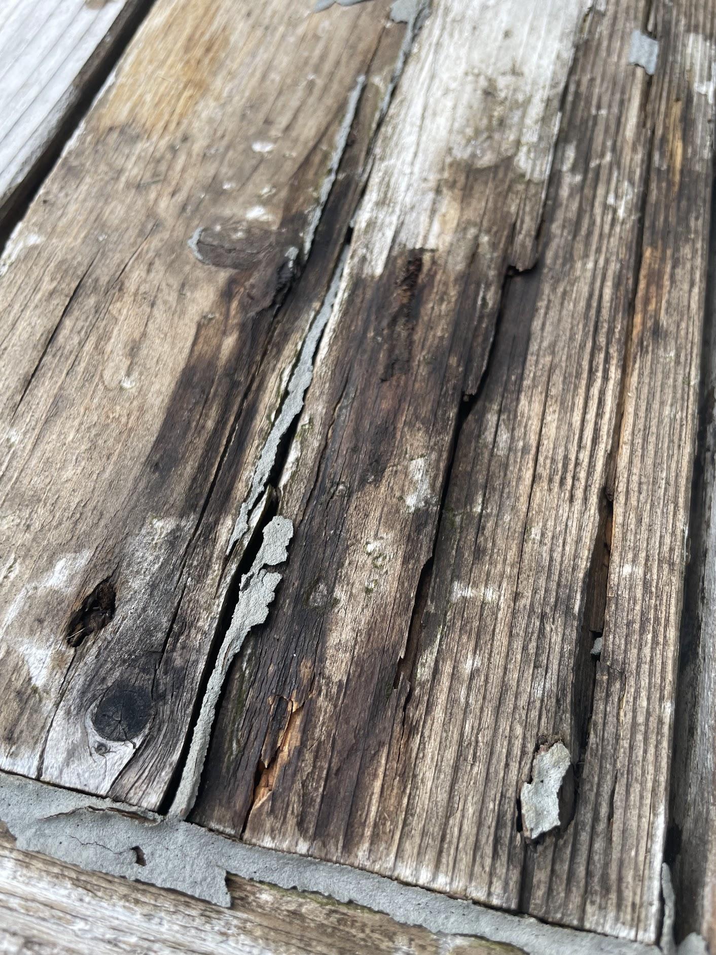

I can’t say enough how unhappy we are with the 10x. While it looks great when it first applied after 2yrs it has destroyed our deck boards to the point that, we will have to replace all the floor boards, It peeled off like wallpaper and then rotted the boards. There should be some compensation for this mess.

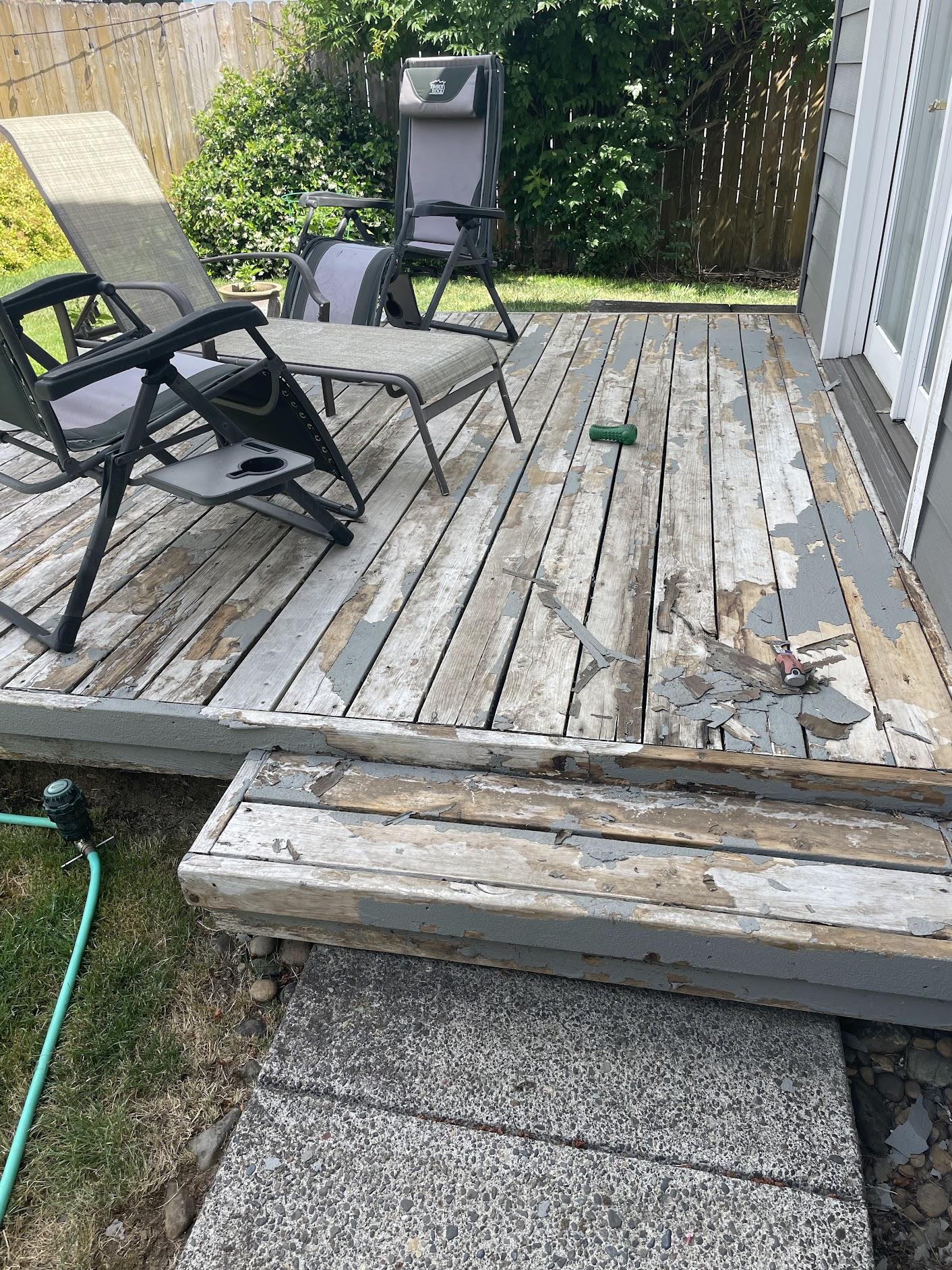

DO NOT USE ANY of the restore products for wood decks.
