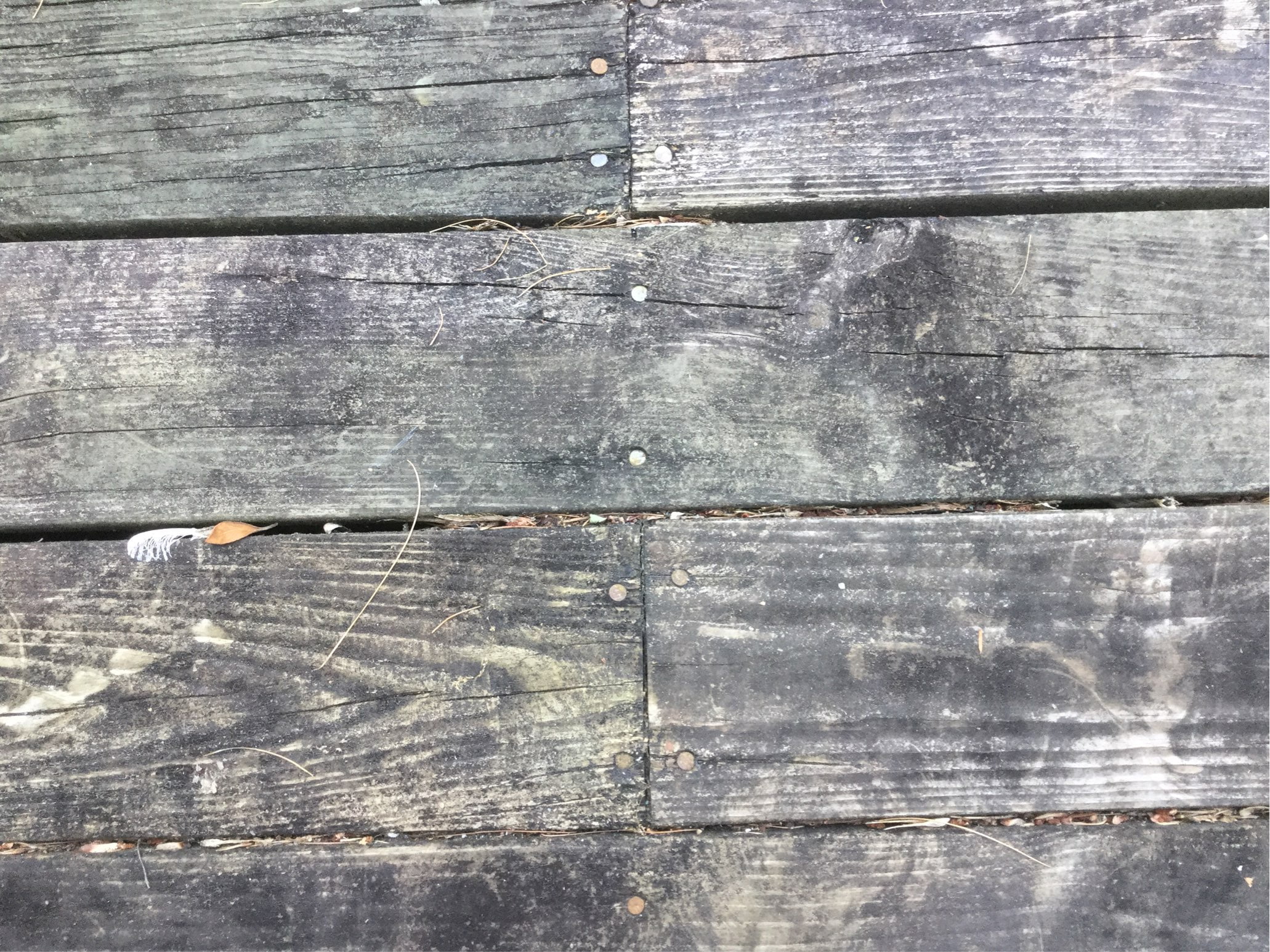

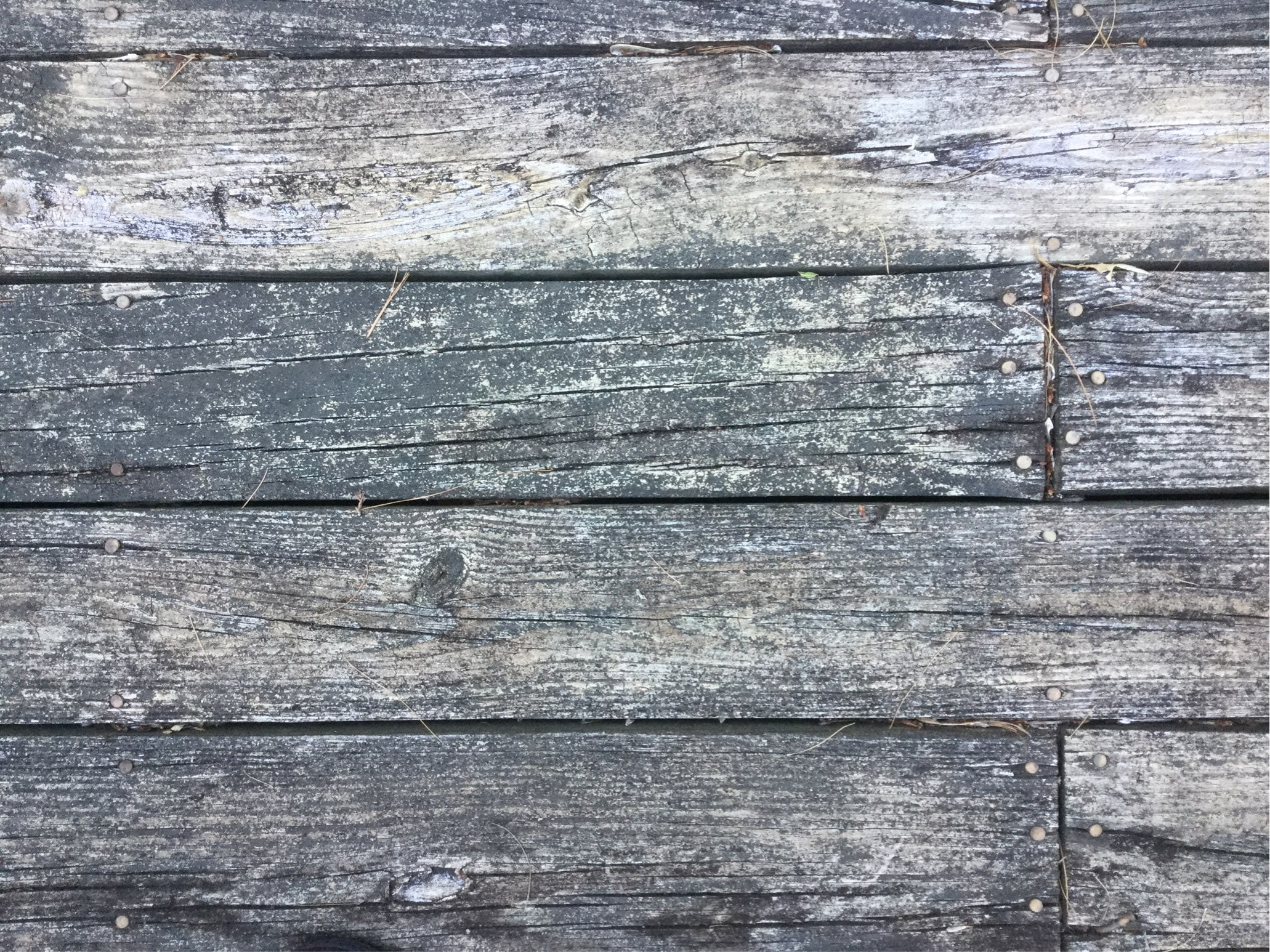

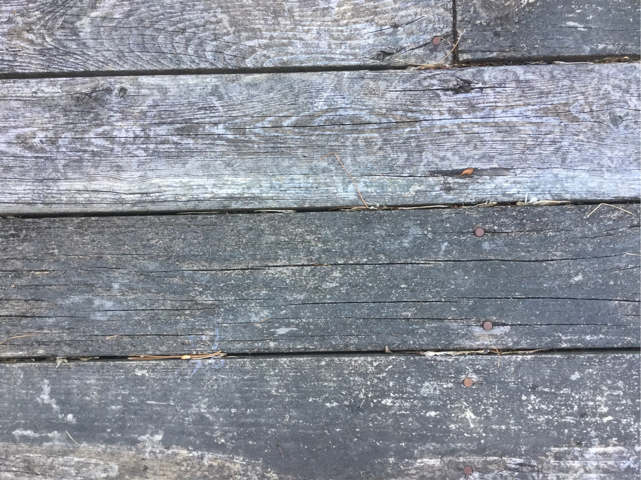

Photos attached…
Greg
Greg
I replied with 3 pictures, but I don’t see my reply so I don’t know if you got them. Please let me know if you did.
Greg
Greg
In addition to the appearance of the wood in the photos, there is splintering on quite a few floor boards – not enough to replace them, but enough to make me want to smooth them by sanding. Is sanding warranted in this case?
If you use nothing finer than 80 grit, why is stripping still preferred over sanding? Is it just that sanding is more work? That it’s potentially “destructive” if not done properly? Not guaranteed to remove previous coatings?
Just trying to understand when sanding is necessary (or acceptable)…

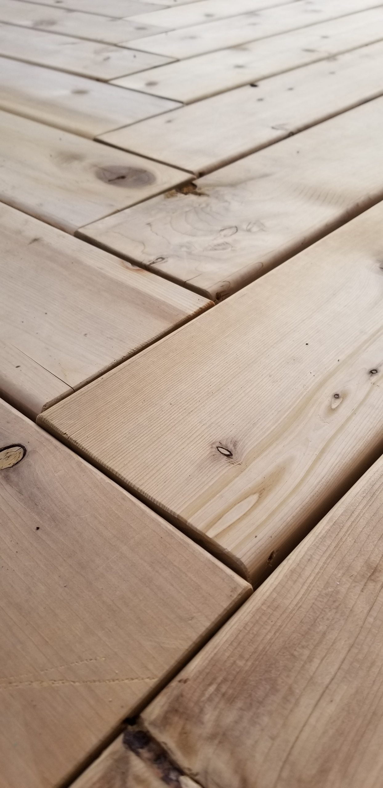

Okey Dokey, stumbled into this site and it's completely blown up my staining plans! My deck is existing but the decking was rotted so i removed all the 2X6 decking. The 2 x 12 joists below were in good shape so i power washed them and applied rust-oleum woodlife classic clear to the joists.
I am now installing Cox DuraPine dry 5/4 X 6 decking and was going to apply the woodlife classic to the 5/4 decking, followed by an oil based primer and latex/acrylic topcoat, am i messing up?
james conrad
james conrad
Well, i didn't really think about solid VS semi-trans or color at all to be honest as i thought i had time to decide that later with the woodlife classic & oil primer to protect the kdat decking after install.
Now that i am not going that finish route, it really doesn't matter to me whether it's trans or solid, i just want a finish that protects the kdat well and that is easy to maintain down the road, a quick power wash followed by a coat of the same product in a few years.

I installed KDAT from Yellawood on a large deck 7 years ago.
I applied Sikins Cetol stain and the boards are now splintering and cracking badly.
Is there a solution other than replacing the boards? I have heard about "Deck Over" and "Smart Seal", but am leary of those products at this point.

My Yellawood KDAT is ~ 2 years old. The Cabot stain I used failed (lots of mildew/mold). I stripped the stain now will clean and brighten. Should I only use one coat or go for wet on wet application. What is your stain reccomedation? Also from a cleaning standpoint, Cabot product has bleach in it. Cabot technical support recommends their product of course. Why shouldn't one use bleach based cleaner? Many wood organizations still reccomend a mild bleach and powdered detergent solution. Live in the Southeast.
JPL
JPL
I was going to clean to assure mold spores are killed. I stripped by sanding the deck. Being in the south do you recommend water based TWP or still go with oil. I had a very bad problem with Cabot oil but think I got some bad advise about needing a 2nd coat within 6 months (fall). Then applied a 3rd coat in spring, again bad advise.
