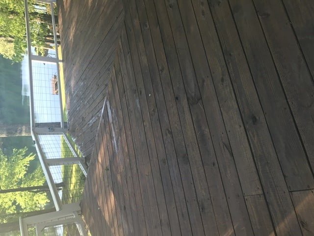

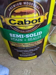

Hello, I stained a deck Saturday August 8th, I went back today (Wednesday, August 12th) and there are shiny spots on some of the boards. I used Cabot Semi-Transparent Oil Based stain. I Sanded it down and used wood brightener before applying stain. I rolled on and back brushed the stain into the wood and spaces between the boards. I called Cabot today and they said it usually takes 72 hours for a full cure. Monday August 10th (2 days after application) we had heavy down pour rain, I went back to see if I could stain today and the section I still need to stain is still soaked, so no go. As far as the other section that had stain applied; I read that you can apply mineral spirits to try and rub off the shiny spots. I’m letting the deck dry out for another day. If there are still shiny spots on it tomorrow is it safe to say that section is fully cured and I need to either; try mineral spirits or re-do completely..? Possible cure time interruption from the rain is what I’m hoping for.. Any comments and words of advice are appreciated.
