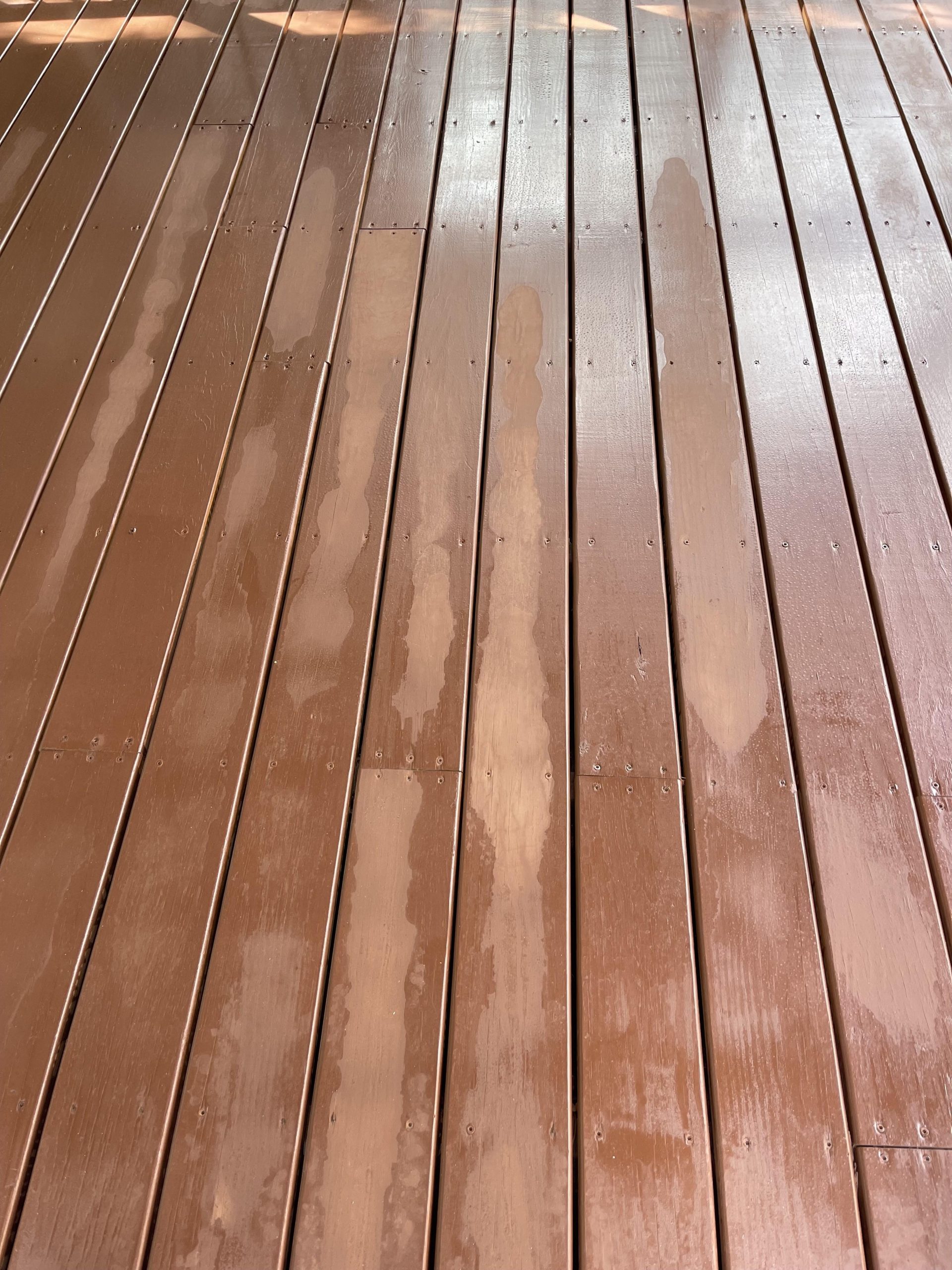

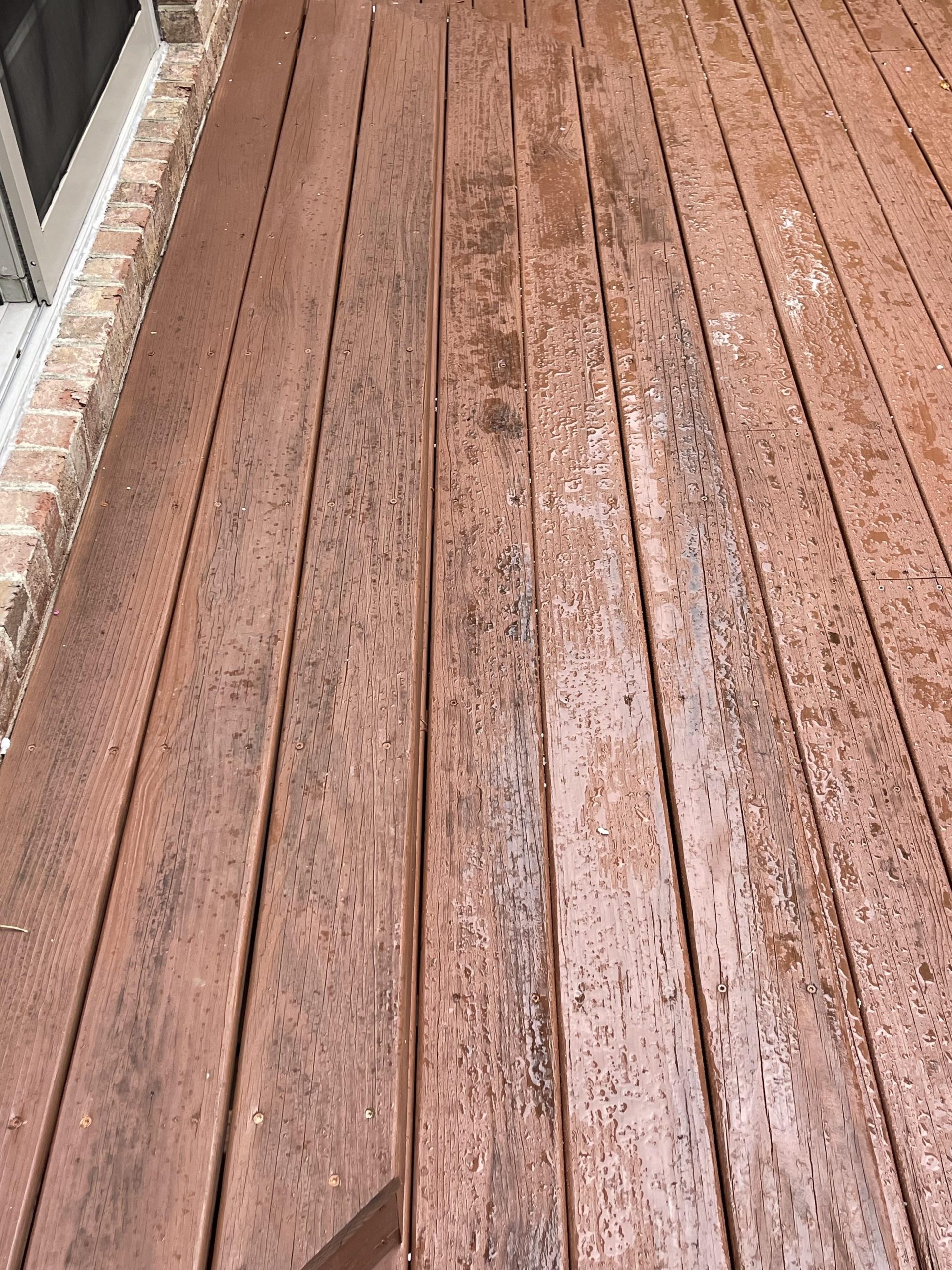

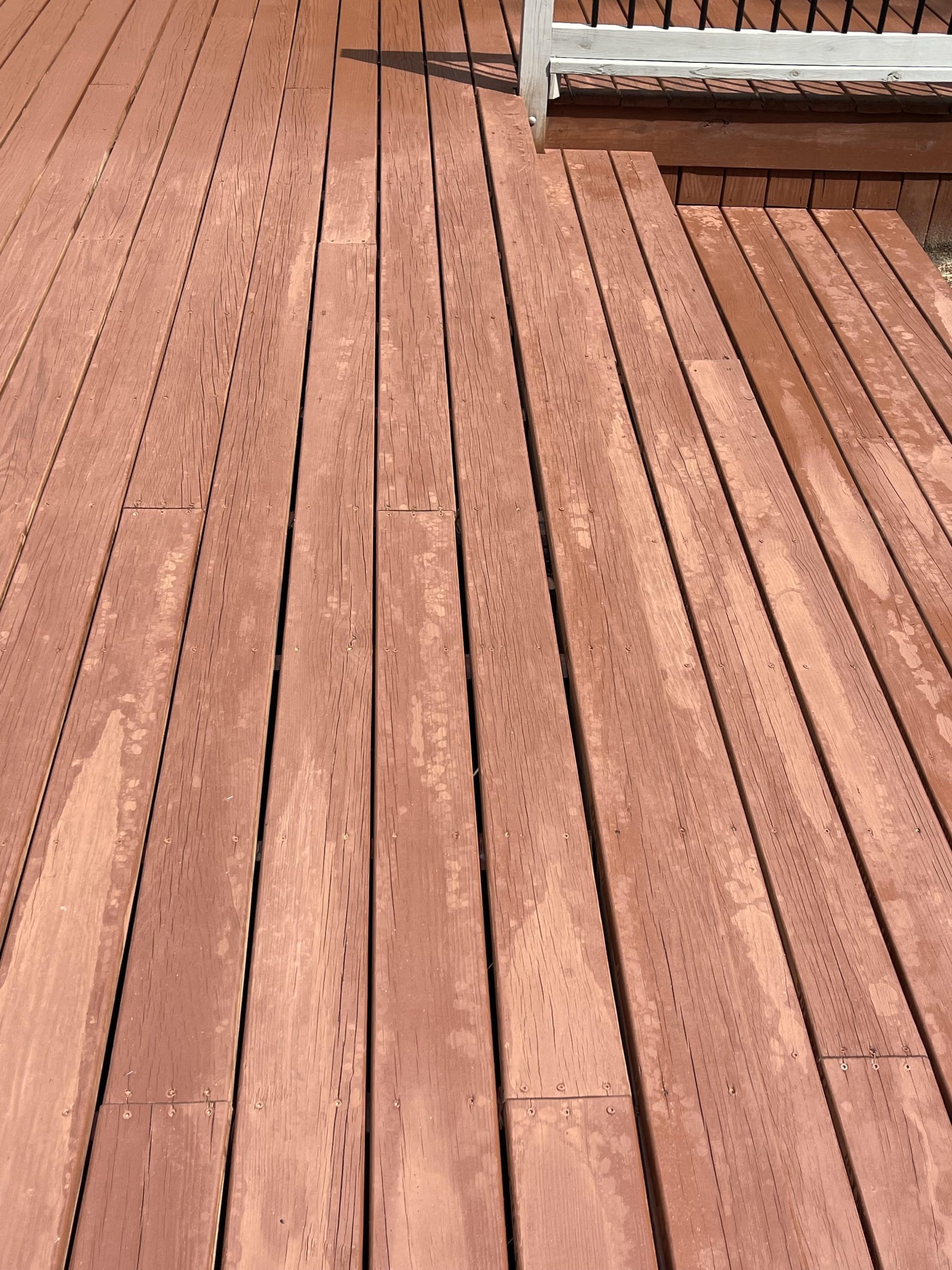

Scott – we have a large deck that needed to get stained. We powerwashed, then had a week or so of rain. After a day of full sun, the crew applied the first coat of stain. They had lots of touch-ups to do, etc, so they came back a couple days later to finish the job. As they were almost finished, there was an unexpected downpour. The last stain they applied washed off. It’s been raining 3 weeks straight now. And where water pooled from the first stain application, mold is growing. So… my question, do we use something like RAD Guard now – before the second coat and touch-ups. The forecase says more rain for the next couple of weeks. The crew says don’t worry, they’ll make it right. But does that mean sanding down and a redo?
How to fix properly, we will need to see pics posted. As for RAD Guard, that would go on when the stain job is completed and fully dry.
Here are 3 pics–two of them show the result of the deck and covered gazebo after the second/touch-up application was washed off by a sudden rain storm. The third pic shows the black spots that are showing up. It’s still raining! I’m wondering if there’s a way to make it right without sanding the whole thing and starting over once it’s dry.
You will have to remove everything and start over to fix this with the same Cabot semi-solid. The other option is to go over all this with a solid-color stain, as that would mask the issues. That would be a lot easier but it will look fully opaque.
I forgot to mention, we used a Cabot Semi solid for the stain.

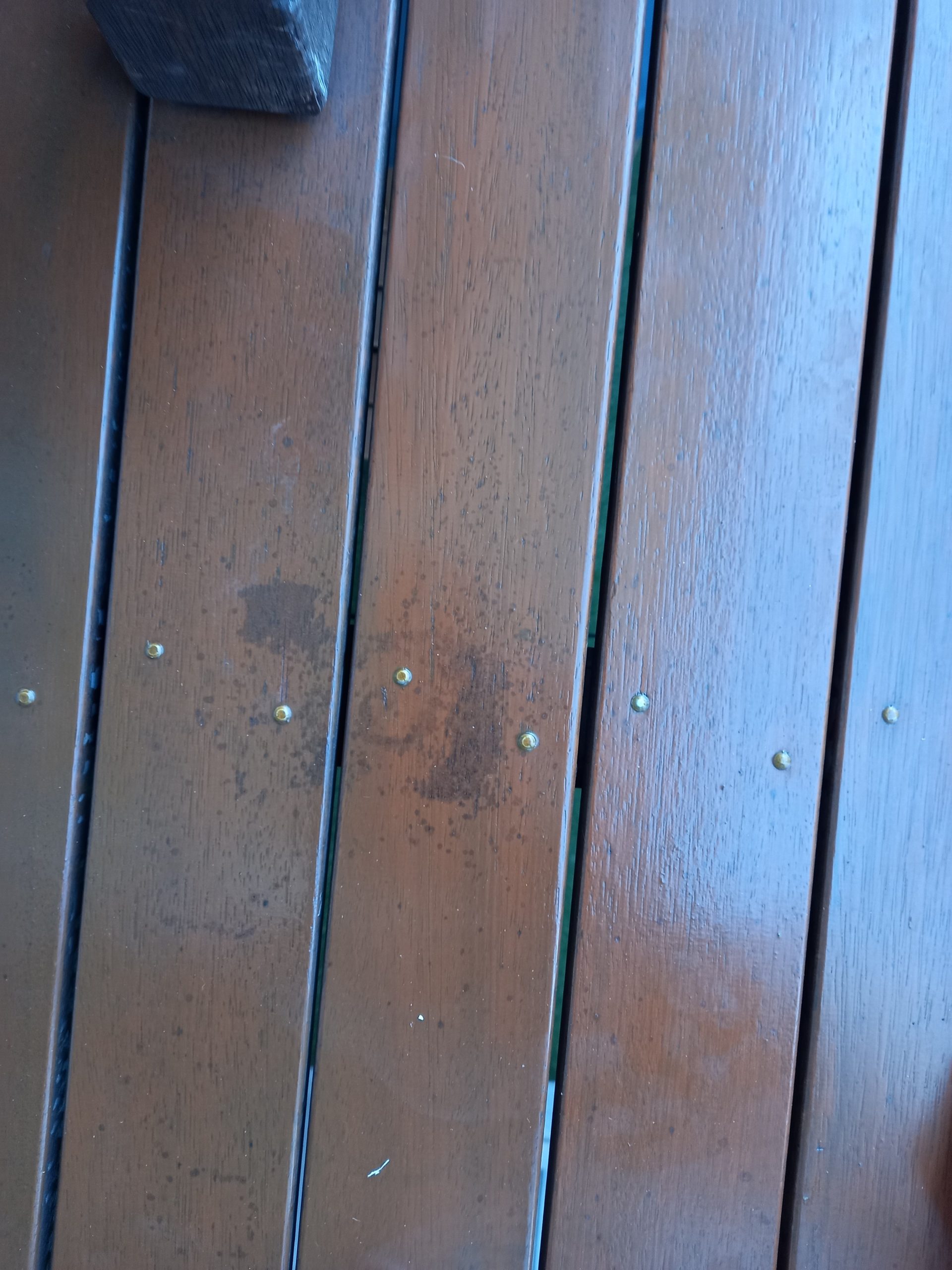

We have a Sikkens-coated Kwila deck, laid approx 6 years ago, with exactly the mould appearance and pattern in your top photo. Currently only 4 boards (out of 25) have been infested after an extended rain period this year. Scrubbing and surface mould treatments haven’t had any positive impact, so it appears the mould is below and into the layers of the sealant. I’m concerned the mould may worsen / spread and may weaken the integrity of the deck – and this is apart from the aesthetic of mouldy boards? Does the issue need to be addressed, and what would you recommend? The deck has proud studs which would prevent sanding, so if these boards need to be stripped back are you able to advise the easiest / best approach?
You cannot strip this type of Sikkens (the shiny DEK version). The only way to get it off is to power sand. Sorry.
Will this mould cause issues if nothing is done?
Probably not.
