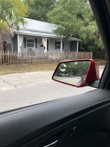

Another question! Fence is about 9 months old, am getting ready to stain it for the first time. Can’t seem to get this black areas cleaned off. What is this stuff anyway? Power washer with cleaner lightened but didn’t remove (not too experienced w power washer so only used the 25 nozzle). Pictures for reference.
Mildew. If the cleaner cannot get it off, try bleach. 1 part bleach to 4 parts water. Apply, let sit for 10 minutes, rinse well when done.
