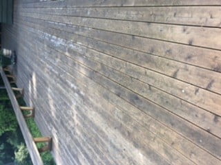

antony mau
antony mau
Get my deck replaced with new cedar board. We stain it with the cobat oil based stain(australian timber oil) before put it on, unfortunately lots of mold developed after 2 week, there is couple rainning day in the last couple week. Now we were suggested by local paint store to stripped it off or sand if off then re-stain it. Which way is better? What kind of products will you recommand to stripped the mold off but less damage to the wood? Thanks!
Admin
Reply to  antony mau
You need to strip off the stain fully, it will remove the mildew as well:
Let the new wood weather properly, as you did not do this prior:
Stain with a better stain that does not attract mildew. Try Restore A Deck:

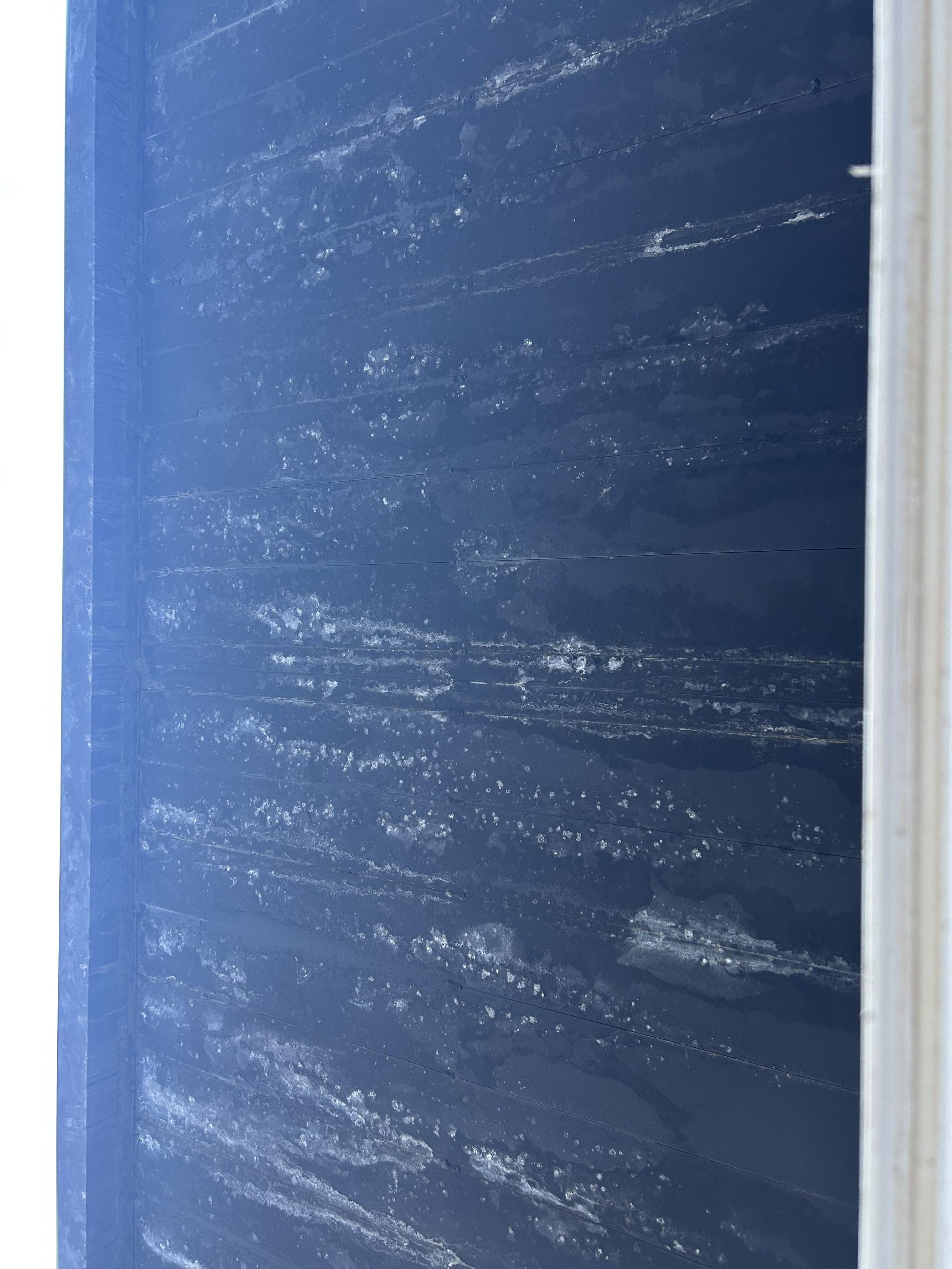

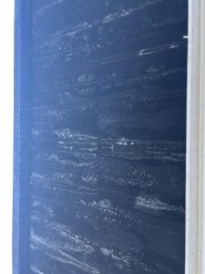

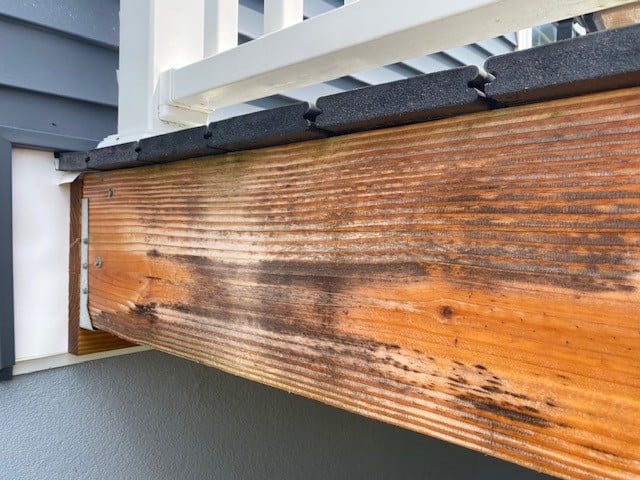

Marilou Carriedo
Marilou Carriedo

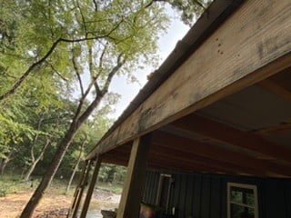

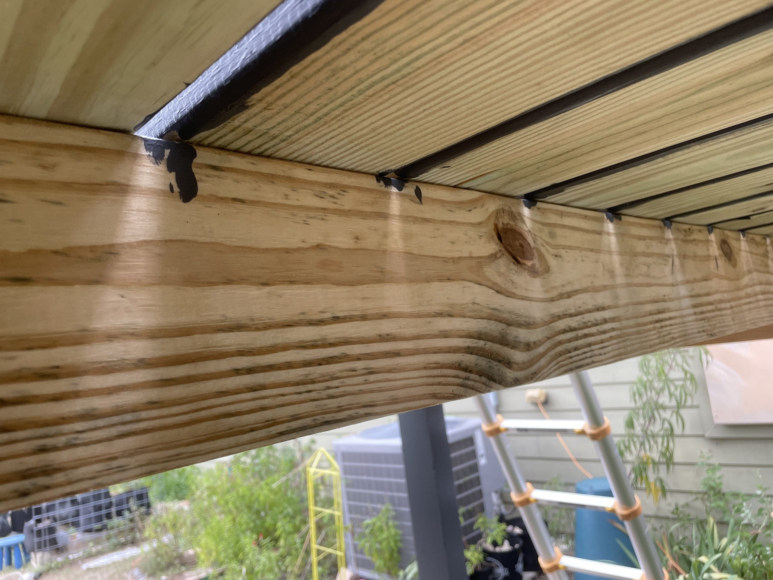

This photo is what I see looking up at the balcony above me. Again, Management states the maintenance supervisor visually verified it as water stains and not mold. I value your professional opinion. Thank you, Marilou
IMG_2477
Admin
Hard to tell from the picture. If mold or mildew is present, you can spray some bleach on it to kill it.
Marilou Carriedo
Marilou Carriedo
Thanks for your recommendation.
Marilou Carriedo
Marilou Carriedo
Thank you for your response. Hope the photo clarifies. LMK if you’ve received the photo.
Thank you, Marilou
IMG_2477
Marilou Carriedo
Marilou Carriedo
I’m suspecting mold that’s visible from my ground unit apartment from the balcony deck above me. Management states that it’s simply water stains. Who should I contact to confirm whether it’s mold or just water stains?
Your response is greatly appreciated. Thank you.

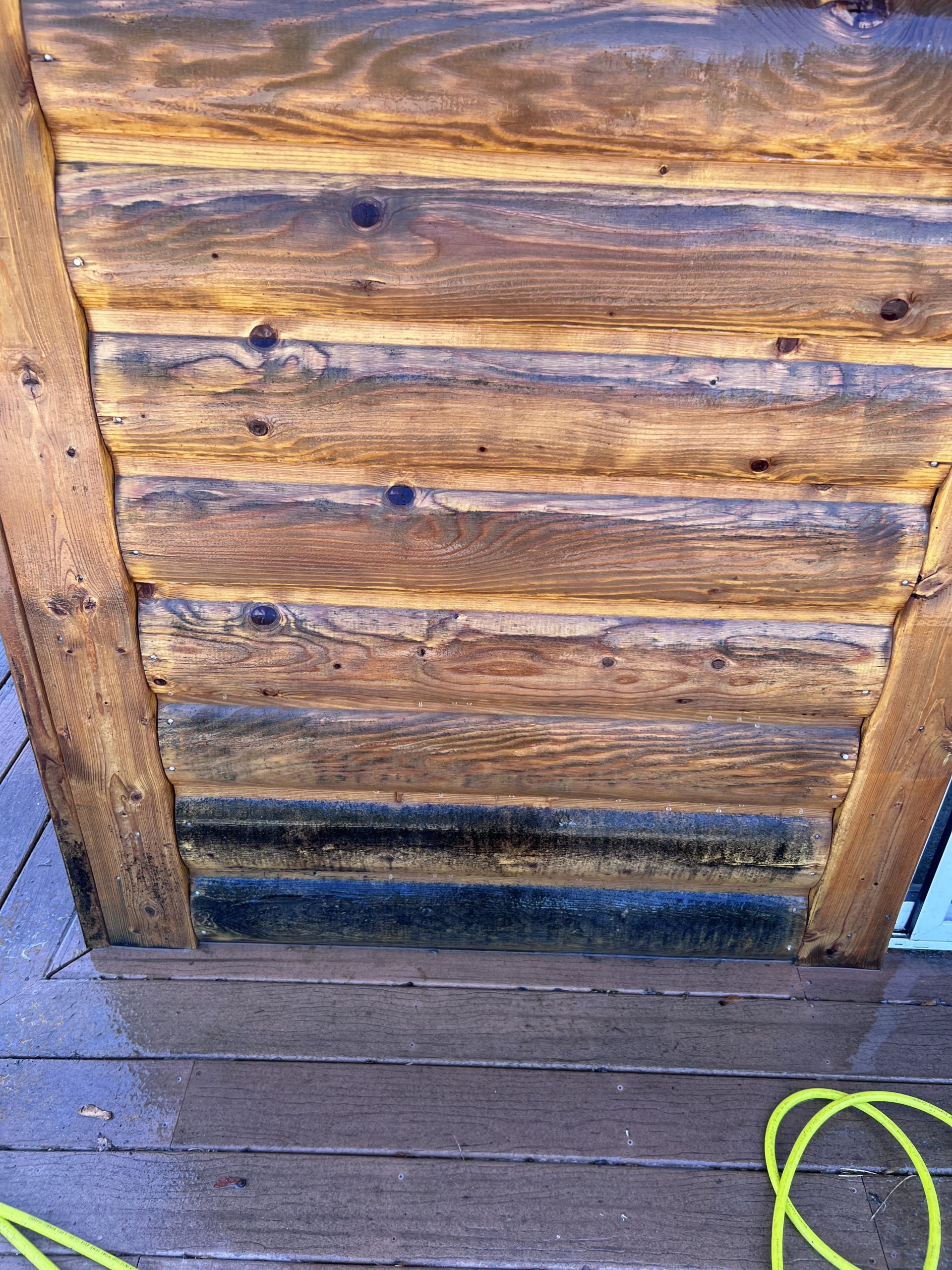

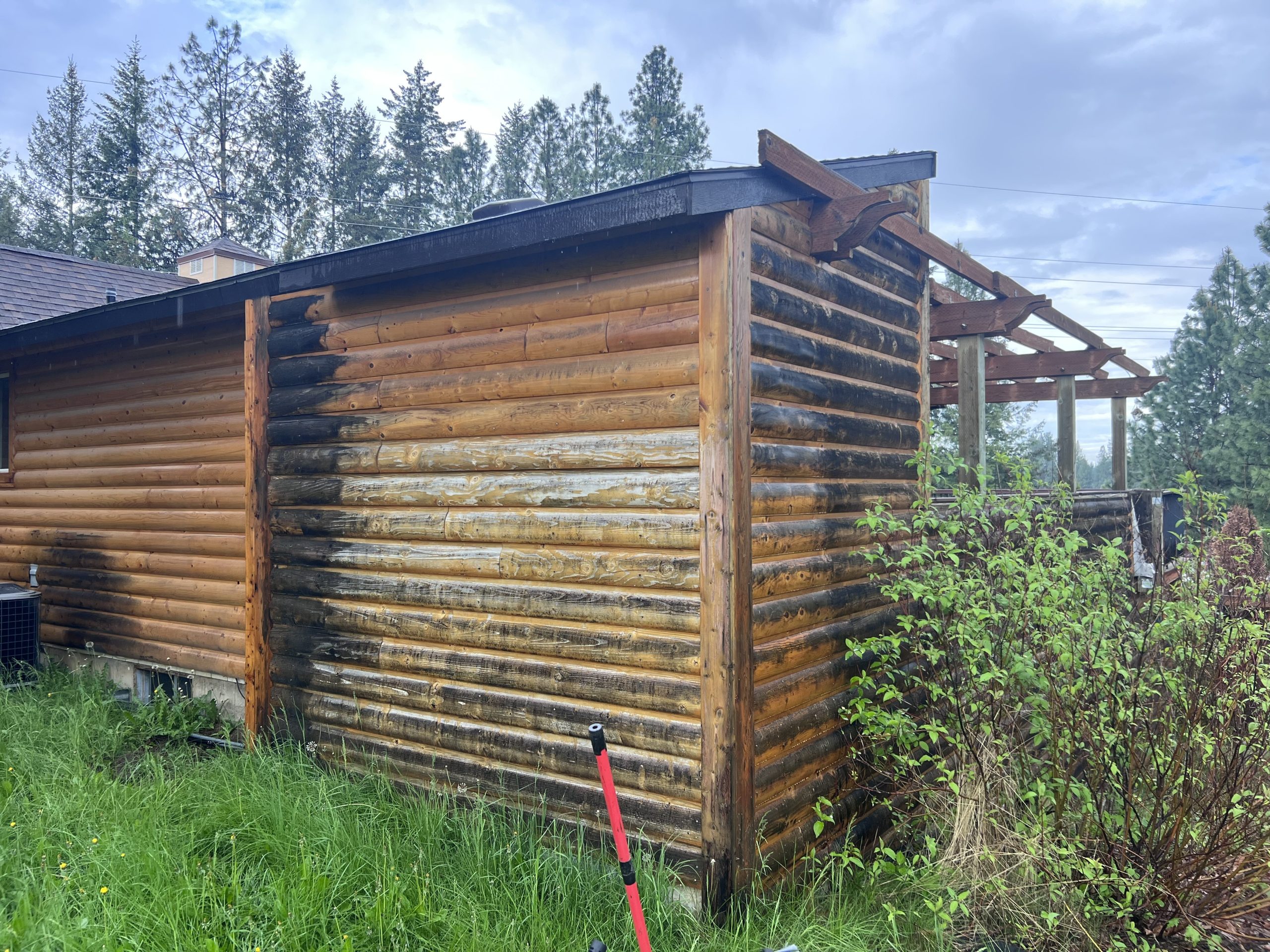

Working on restoring this faux log siding, used mold armor house wash then pressure washed, then belt sanded. When we applyed the data in two days after cleaning, then wood turned really dark. Tips on what to do.
Admin
Reply to  Robbie
You need to remove all down to the bare wood and then brighten it for prep. To remove Messmers Timberflex, you will need to media blast the coating from all wood.

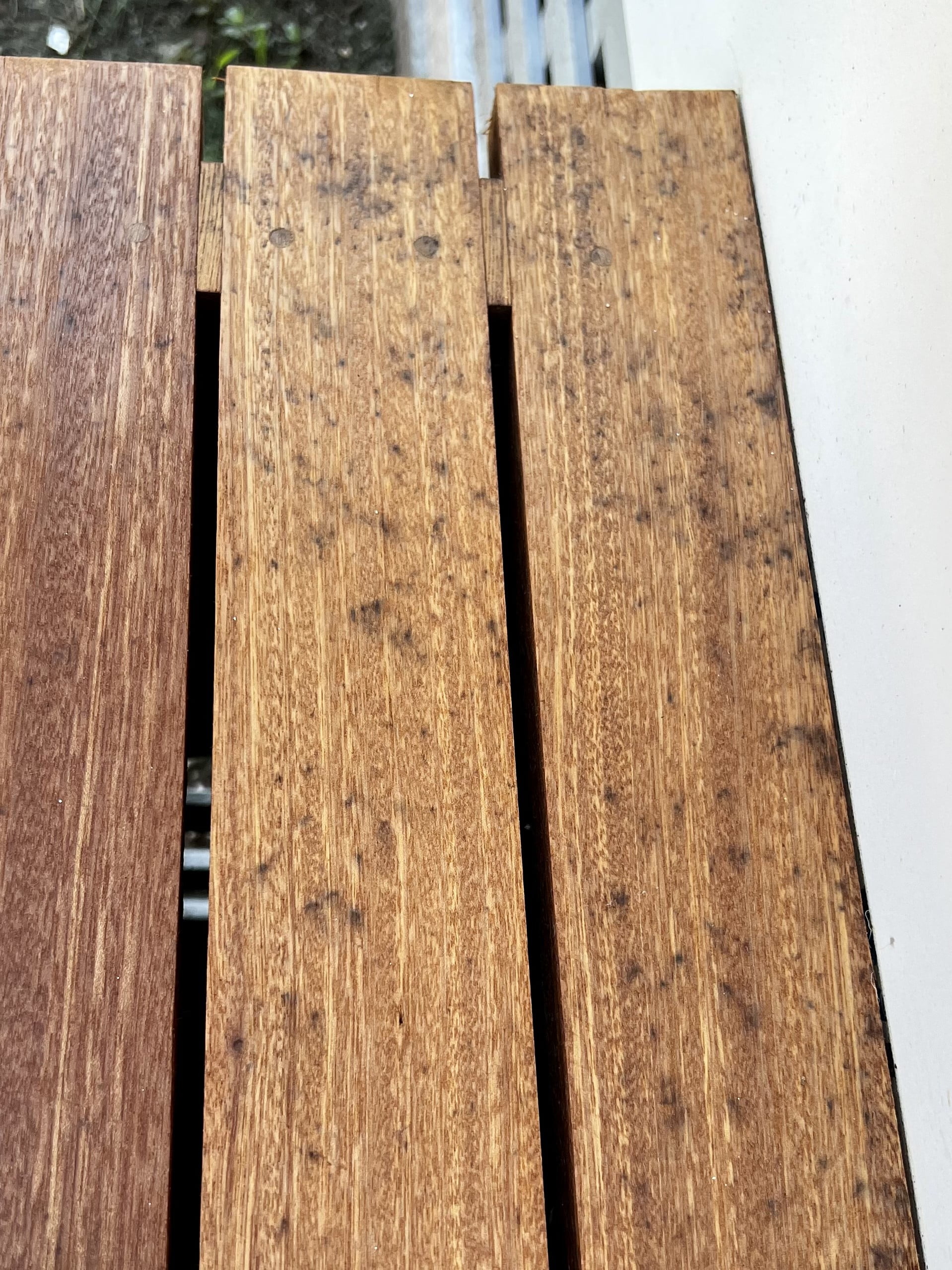

Christy
Christy

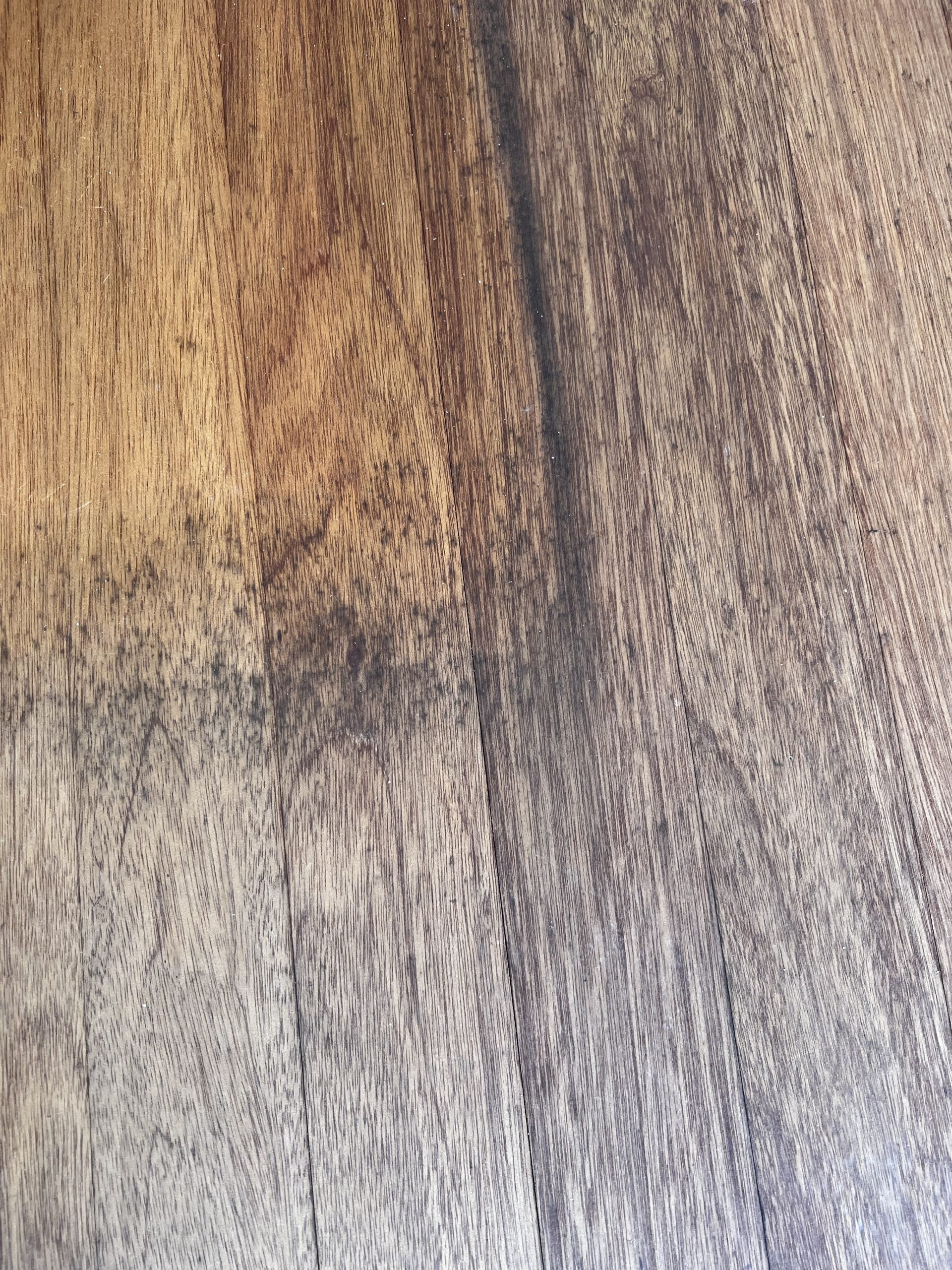

We have a mahogany porch that was installed 6-8 weeks ago. I am now seeing a significant amount of what appears to me mold spots. Could this happen so quickly if they properly stained/ sealed the porch?
Christy
Admin
Reply to  Christy
Yes, it can happen but it also could be rust.

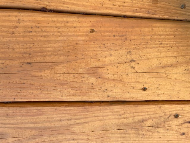

Teresa
Teresa
We had a new redwood deck built, completed about 8 days ago. Two days ago blue-ish/grayish spots started appearing (see photo). Is this mildew? What do we do? Do we use a product now to clean it off and keep cleaning periodically until it is time to stain it? Do we wait until spring to stain it? We are in Northern California.
Admin
Reply to  Teresa
Looks like rust from the building process. Prep and stain in Spring.
https://www.deckstainhelp.com/remove-rust-black-stains-from-deck/

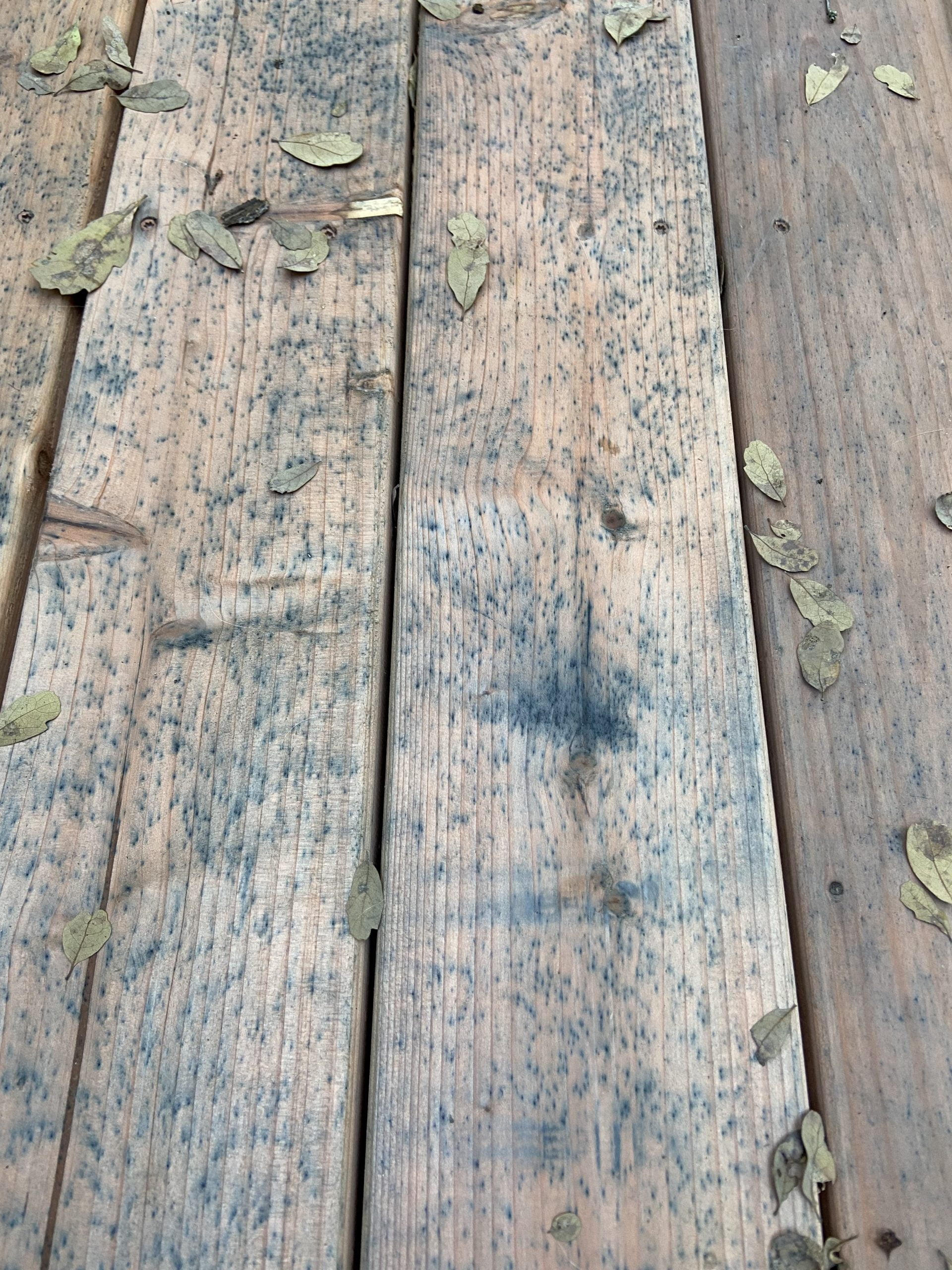

Katie
Katie

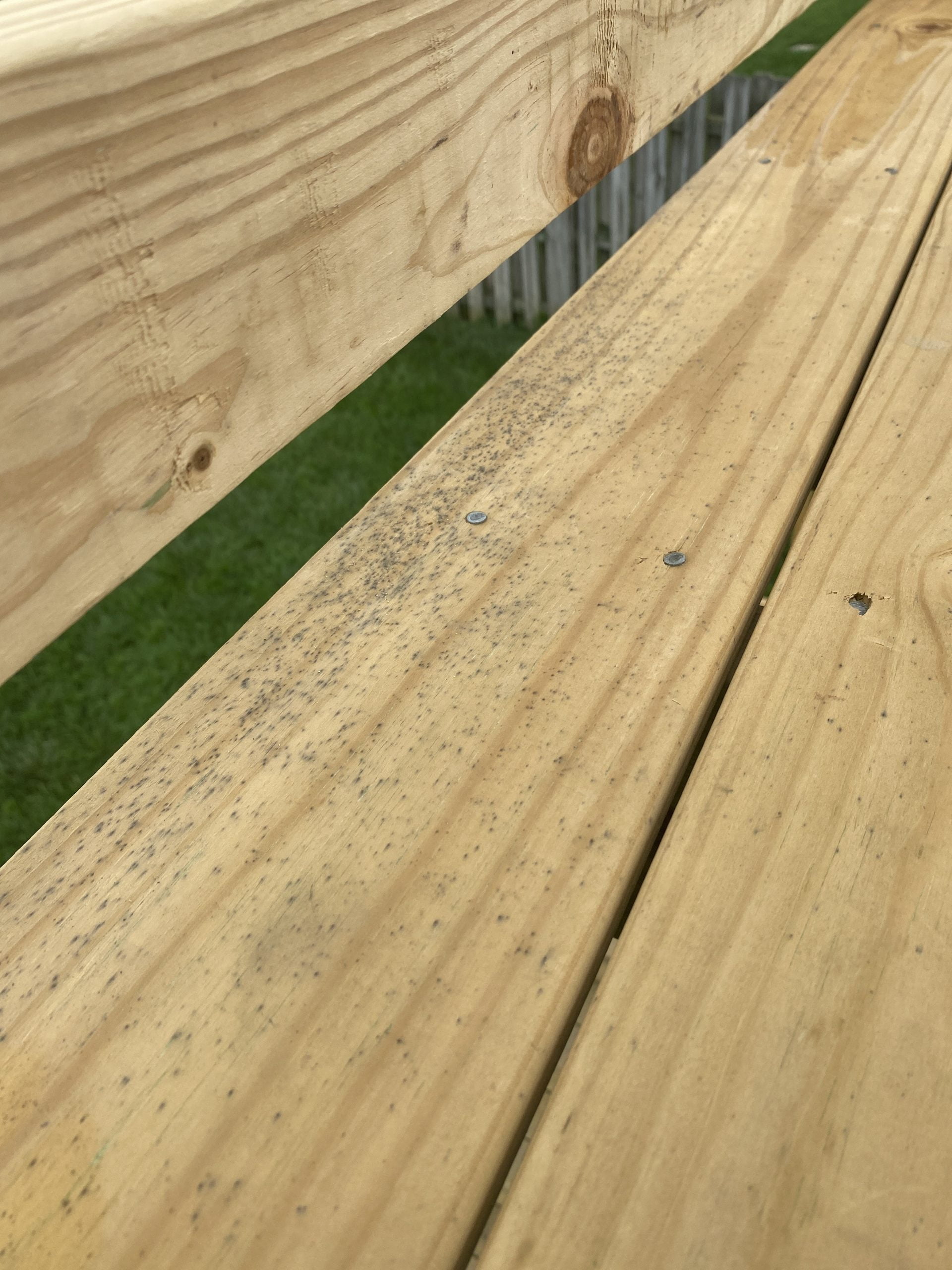

Hi all! We just had a new deck put on with treated lumber. Maybe 3 weeks old. I just noticed we have one board with what I think is mildew spots? My builder said it happens and it will sand off. Is this true?
I can’t wipe it or scrub anything off. It appears embedded in the wood. The deck is not stained. Any suggestions? Should I worry ?
Admin
Reply to  Katie
It is rust or mildew and will come off when you clean and brighten the deck for prep prior to staining.

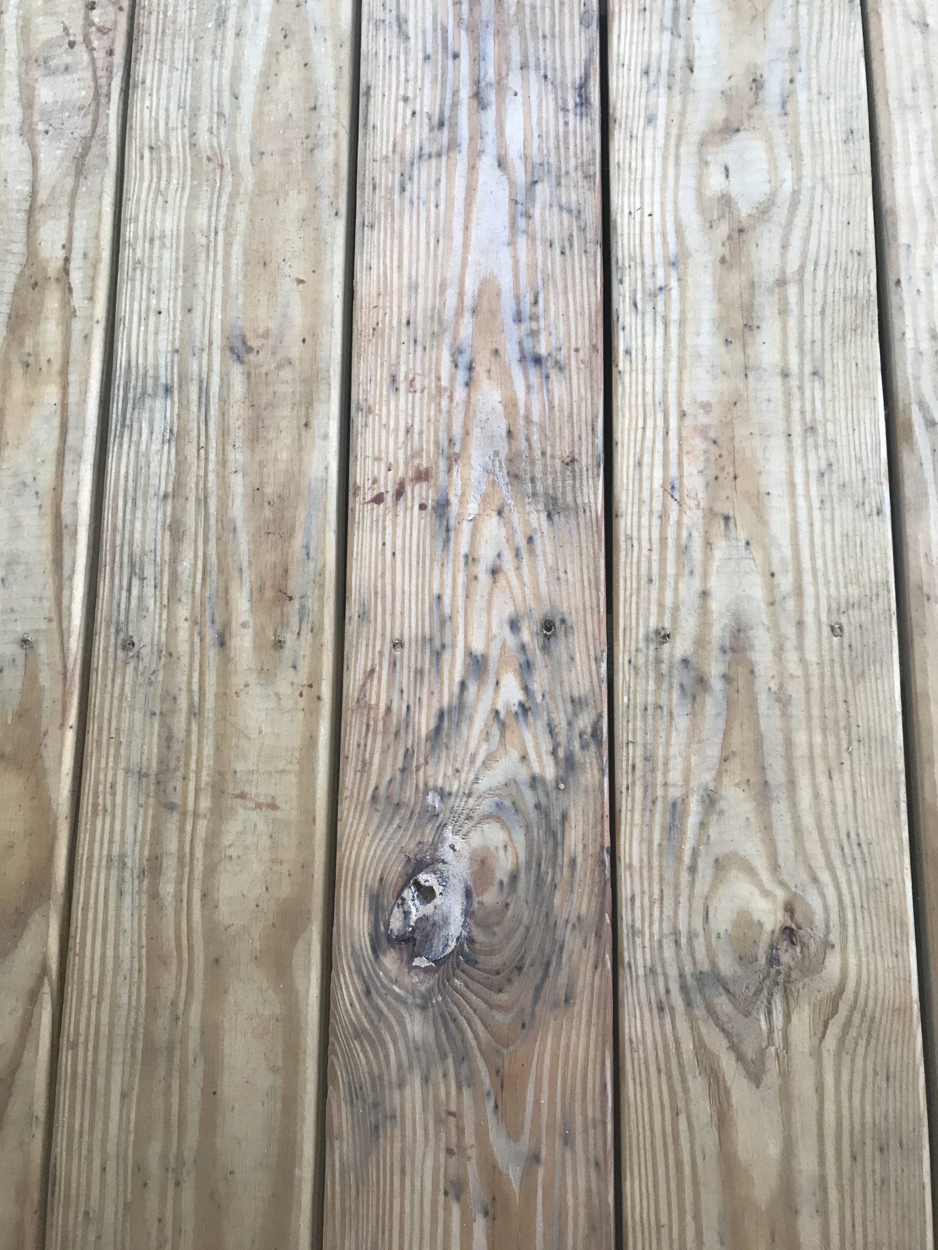

Tara Tomita
Tara Tomita
We recently built our deck just a couple of months ago. It is pressure treated pine. We let it weather for about 6 weeks, cleaned it with Cabot problem solver wood cleaner, sanded with 60 grit paper (I now realize we did this backwards) and then applied Cabot Australian Timber oil-based stain. Just a few days after staining, the deck is covered in little black spots which appear to be mold/mildew. We live in Hawaii.
1. Do you think it is because of the oil based stain or because we cleaned before and not after sanding?
2. Also, regrettably, we applied epoxy bondo wood filler to cracks. Any suggestions on how to remove this?
3. Would cleaning and brightening remove the black spots? Or do you suggest stripping first with RAD and pressure washing it off? Then sanding if needed? If we need to sand, do we then clean and brighten, and wait 48 hours, before applying the RAD stain?
I wished we would have come across your site beforehand!
Thank you!!
Admin
Reply to  Tara Tomita
That is mildew or rust. Did any metal get on the wood? Steel wool, etc? Either way it has to be stripped off and started over. Brightener as well. The only way to remove the wood filler is to scrape or pry it out.

Is this mold/mildew on our Redwood deck? At first I thought it was pollen and dirt that got stuck to the old stain which then turned black from sun exposure, but after doing a bleach spot test in the corner and seeing the bleach uncover the wood underneath, I thought it must be mold/mildew. So I tried the OxyClean method with power washing it off, but that did not work. Maybe I didn’t make the OxyClean mix it strong enough. When dried, the black stuff is hard as a rock and almost looks like the wood is burnt/charred. What would you suggest to the black out? Will restore a deck really do that?
Admin
Reply to  Lucas
It does not look like mildew. Maybe old deck stain that has turned black? A good deck stripper and pressure washing should remove it.
Lucas
Lucas
It turns out they sprayed our deck with Thompson’s water seal, which contains paraffin (wax). Although oil based, normal deck strippers won’t get the paraffin off apparently. An “award winning deck contractor” (so he said) said you can dilute ammonia 4:1 to get Thompson’s water seal off. Not sure ammonia is good for redwood and might cause discoloration (not that its a new deck by any means). Otherwise purchase a hydrocarbon remover. Any product you know of designed specifically for removal of paraffin containing deck sealers?
Admin
Reply to  Lucas
You can strip it off. Use any deck stain stripper followed by a wood brightener. We do it all the time.
