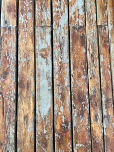

Peeling Deck Varnish
Why Polyurethane is a Bad Choice for Decks
Your deck is constantly exposed to extreme weather conditions—rain, snow, sun, and fluctuating temperatures. Because of this, selecting the right stain or sealer is crucial for protecting and maintaining the wood.
Polyurethane, varnish, and urethane coatings are not designed for outdoor decks. These finishes create a film on top of the wood, producing a glossy or shiny look. While this may work well for indoor wood surfaces, it fails quickly on exterior wood when exposed to:
  • Moisture: Polyurethane traps water underneath, leading to peeling and blistering.
  • UV Exposure: The sun breaks down polyurethane, causing it to crack and wear away unevenly.
  • Weathering: Once the polyurethane fails, you’re left with a difficult-to-remove finish that requires extensive sanding before reapplication.
How to Restore a Deck with Polyurethane Failures
Unlike deck stains, polyurethane is not formulated for outdoor use and must be fully removed before recoating a deck. Strip and/or sand the wood surface until the polyurethane deck coatingis removed.
Keep in mind that sanding a deck may limit the wood’s ability to absorb stains. Therefore, sand the surface lightly to ensure that the wood retains its natural, rough texture. Check out my post that reveals my top three rated wood stripping and removal products, which are manufactured by Restore-A-Deck (RAD).

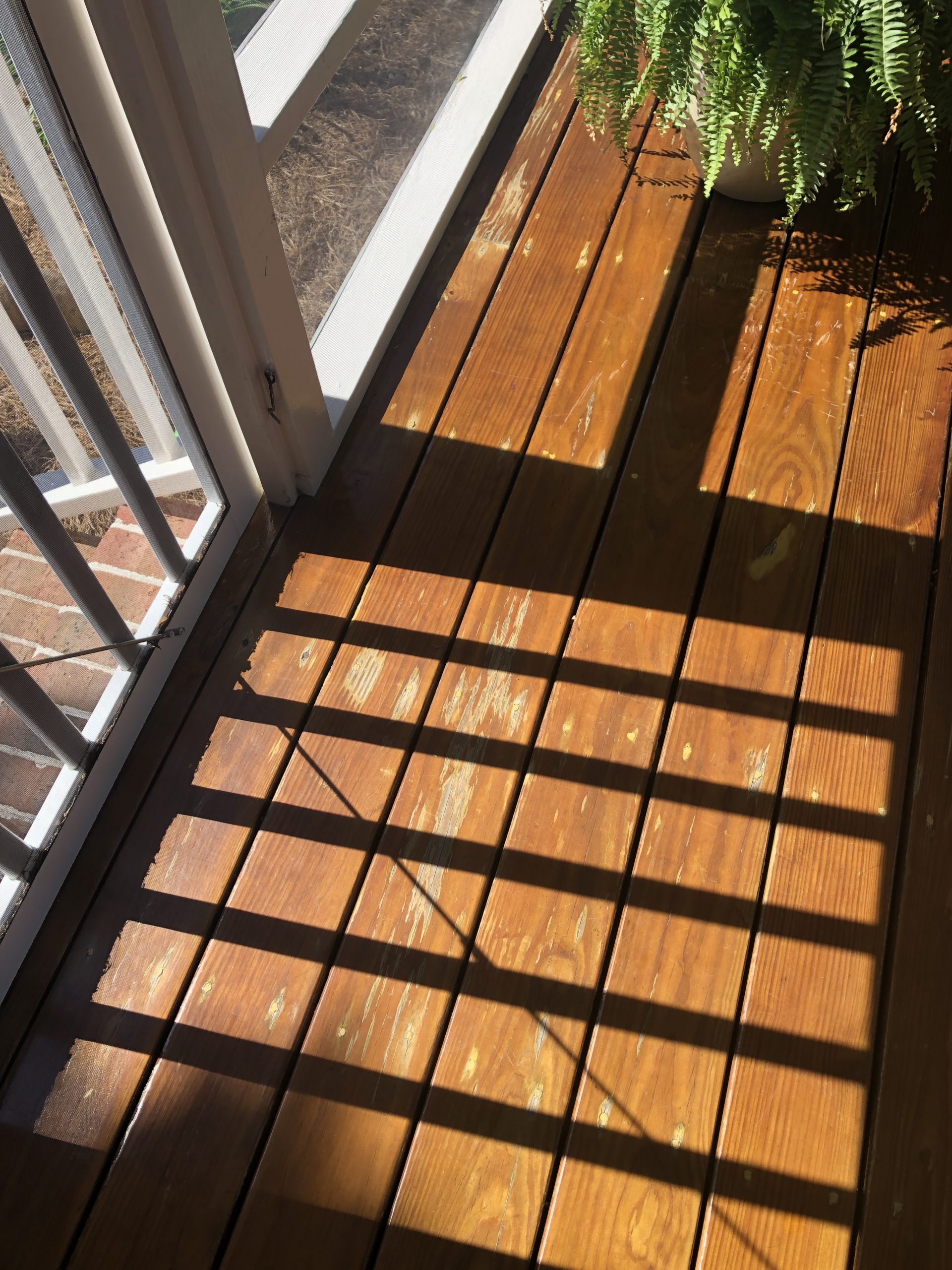

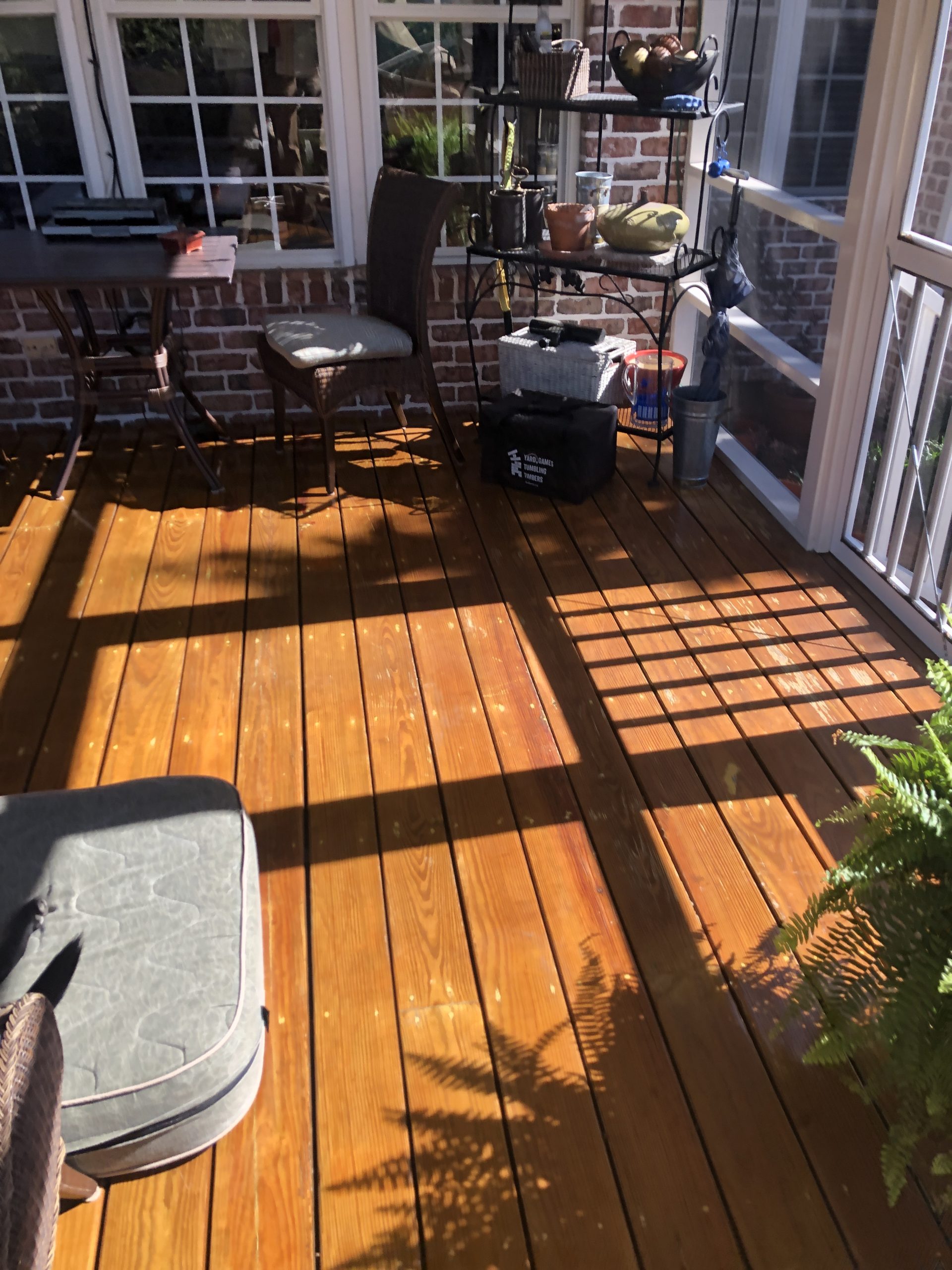

Hey there. So my contractor just built a beautiful deck, but then one of his crew applied a coat of interior poly on top of it. I told him he needs to remove it so we can put something more appropriate on (a transparent stain likely), but he’s pushing back, saying we can apply something on top of it. Like an outdoor clear sealer. I’m arguing that it won’t work, as the outdoor sealer won’t stick to the poly, and the poly will just crack and blister pretty quickly.
Can you please chime in so I have some back up? What would you do? Chemically remove the poly, and then let it sit until spring, and then stain? (It was build a few weeks ago). I live in Vermont, so it will get some serious weather this winter.
