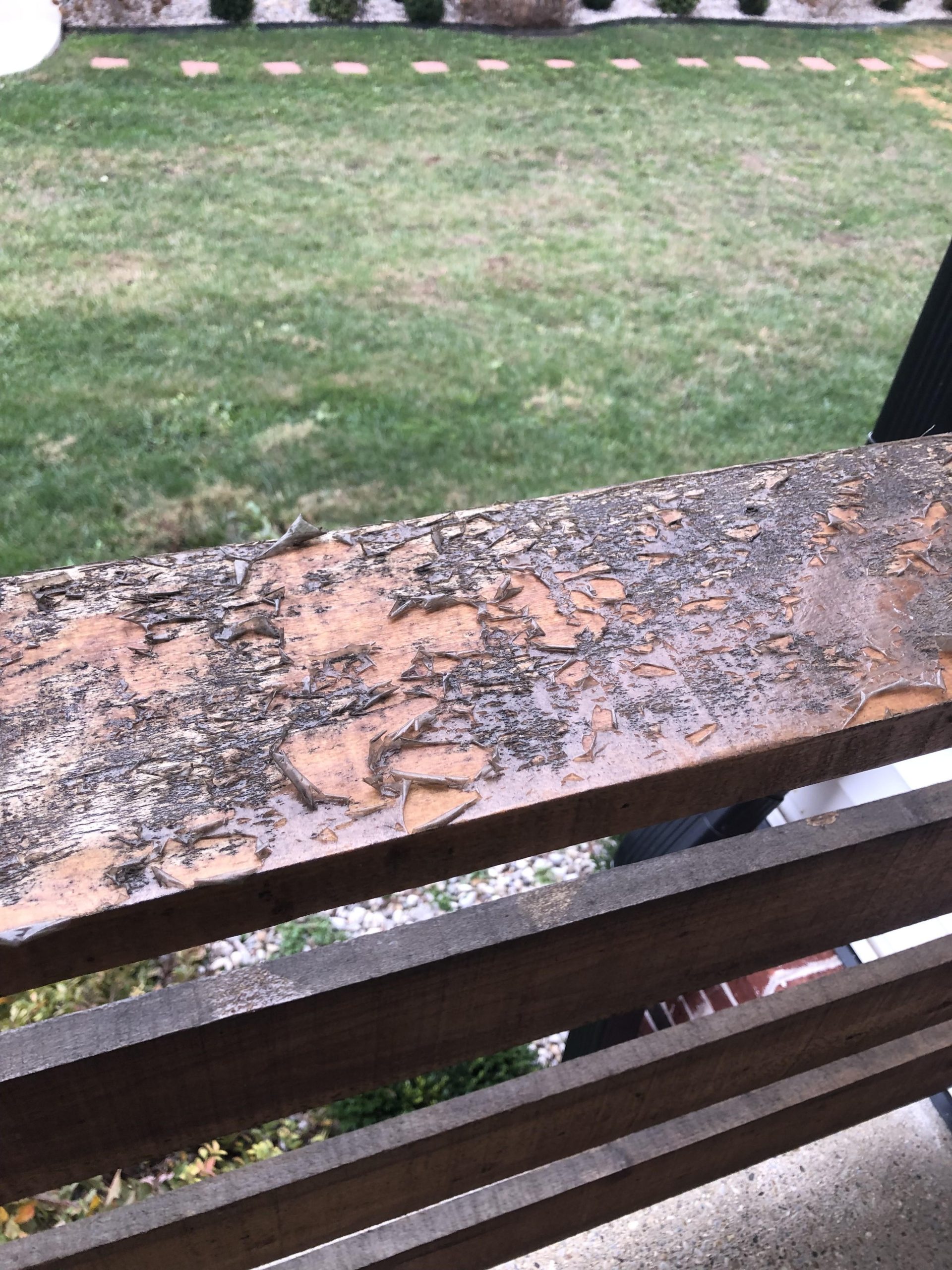

Why Polyurethane is a Bad Choice for Decks
Your deck is constantly exposed to extreme weather conditions—rain, snow, sun, and fluctuating temperatures. Because of this, selecting the right stain or sealer is crucial for protecting and maintaining the wood.
Polyurethane, varnish, and urethane coatings are not designed for outdoor decks. These finishes create a film on top of the wood, producing a glossy or shiny look. While this may work well for indoor wood surfaces, it fails quickly on exterior wood when exposed to:
- Moisture: Polyurethane traps water underneath, leading to peeling and blistering.
- UV Exposure: The sun breaks down polyurethane, causing it to crack and wear away unevenly.
- Weathering: Once the polyurethane fails, you’re left with a difficult-to-remove finish that requires extensive sanding before reapplication.

Peeling Polyurethane Deck
