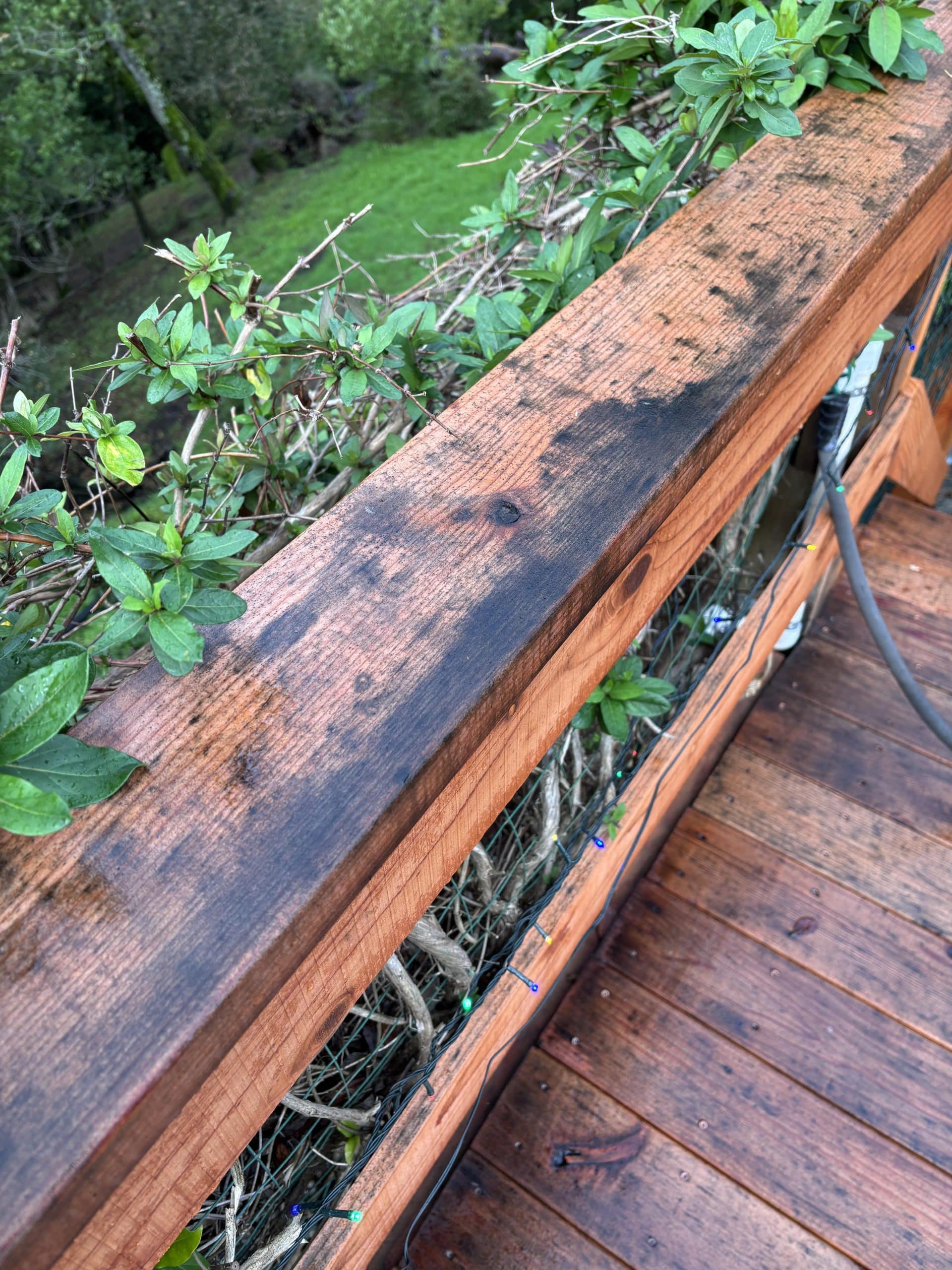

I’ve got a new redwood deck that is growing mildew like crazy, What can I use to kill the mildew?
Are you sure it is mildew? Post some pics in comments.
Actually I miss spoke. It’s mold.
When you prep for staining, the mold/mildew will come off. Look at this for prep:
Best then treat with a stain that does not attract mildew/mold.
After it is stained, you can try this over the stain to help prevent the mildew from returning:
