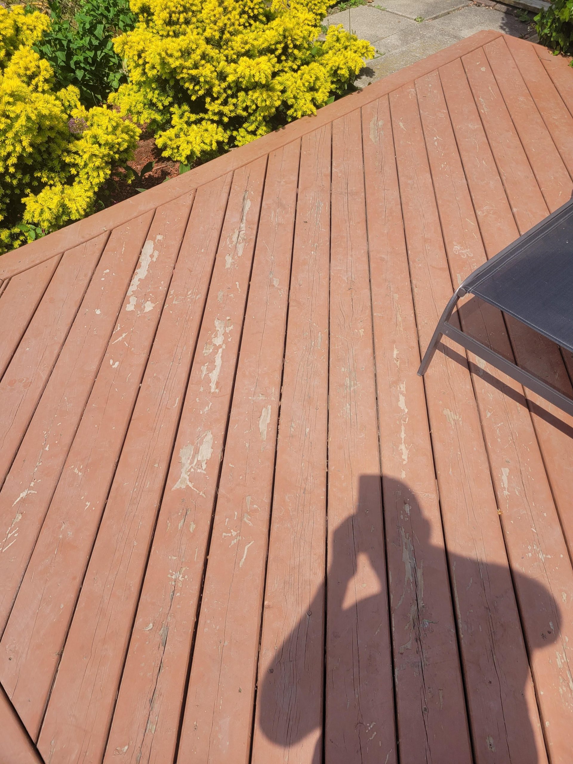

This is the deck right now
That is a solid stain. You would have to power sand to get it all the way off:

Hi, just wondering what I should use as stripper? The ones sold at the mainstream stores don’t seem to have good reviews.
Post some pictures of what you are trying to remove.
Here you go. As you can see, the stain has peeled off/is peeling off in some areas. In some place it is not as bad.
You have a film forming acrylic stain that has been applied in multiple layers. This means it is very hard to strip fully, almost like trying to strip a solid stain. No stripper will remove it easily or completely so you will have sand to get it all off after stripping. Brightener would be last.
Ok thank you for the tips!

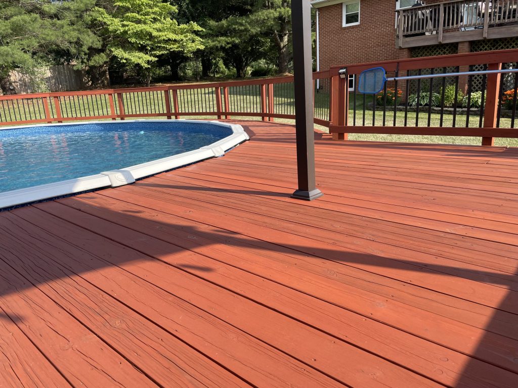

Please give your honest opinion. I live in Mississauga, Ontario. The first image is of my deck, picture on the right is the look im going for (grey) . Can you suggest a stain type (semi solid or solid) and a reliable brand for my type of deck. If prepped correctly, is their any brand that would give me this look?
You just need a two-toned deck in two solid stains. Try the Restore A Deck Solid Stains:
https://www.deckstainhelp.com/restore-a-deck-solid-color-stain-review/

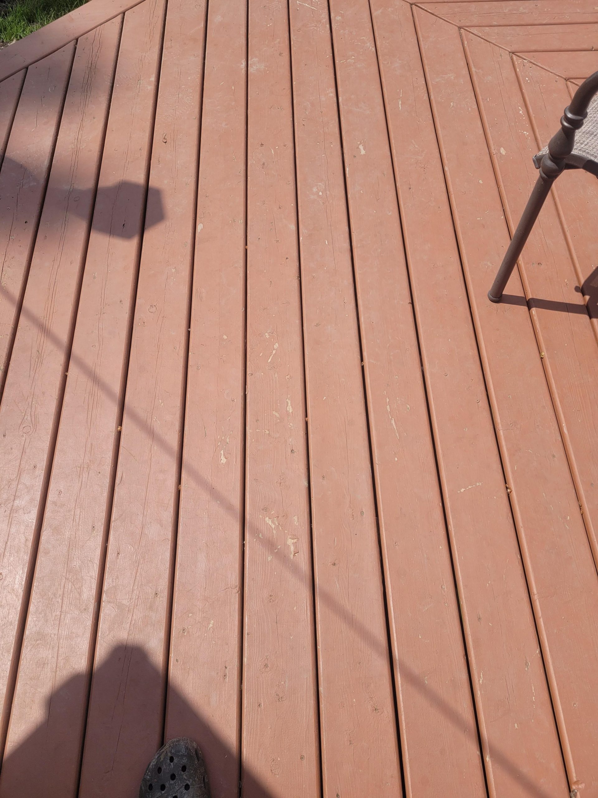

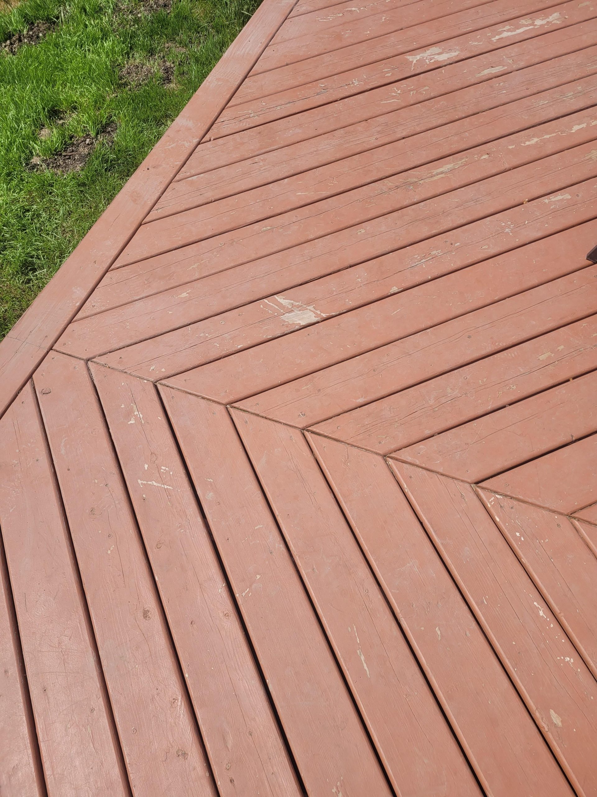

Live in Canada (across from Detroit). I have a 25 year old pressure treated deck. Stained over 13 years ago. This past June I power washed and sanded. Looks great. 1. Can I still stain this time of year? 2. I believe I only need to clean and brighten (no stripping) Can you confirm? 3.Which stain & colour do you recommend if I want a natural colour? 4. How many coats required?
1. Yes.
2. We would need to see pictures.
3. TWP 200 Series or Armstrong Clark.
4. Depends on current condition and stain brand.
Here are some pictures.
Clean and brighten for prep is okay. Try Armstrong Clark stains, two coats.

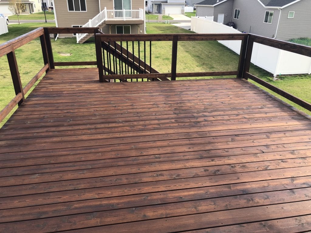

Hi
I consulted this site last year for advices on staying my 15f X 16f deck .
This is the result last week after using SANSIN Espresso 17
Thank you guys
Sam
Montreal
Canada

I live in Edmonton Alberta. Last year I prepped and used a solid color stain on my deck (about 15 years old). This year it is peeling like crazy! I would like to “start over” with Restore a Deck or TWP. Are these products only available for on-line purchase? If so, would I have to buy them from the US website? Please let me know!
Check with them directly for help buying. As for the solid stain that you have now, you will have to sand it off fully to fix it.
Thanks. Will any products assist me with stripping or is sanding the only option? I would like to do this as efficiently as possible.
You cannot strip off a solid stain fully. Needs to be sanded.
