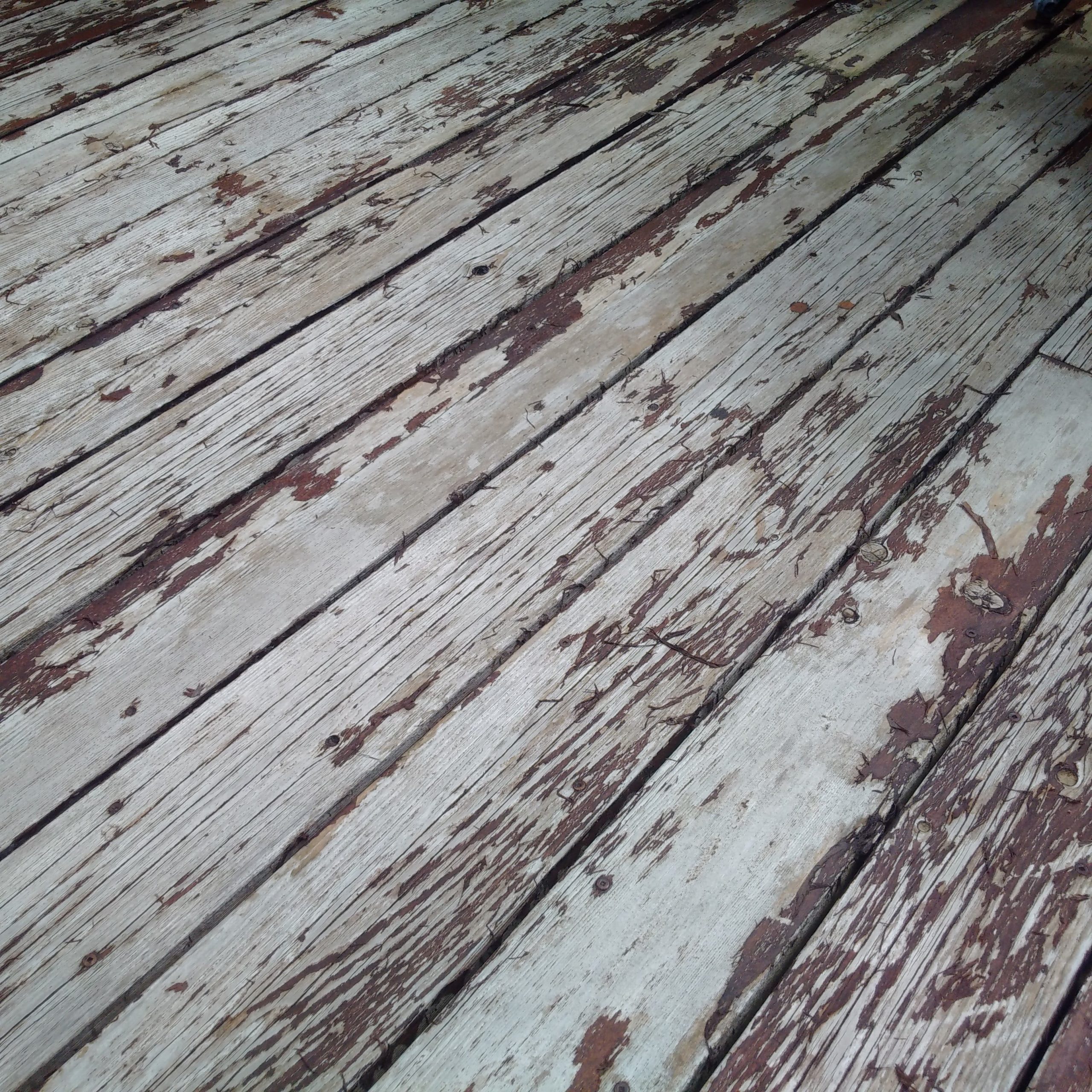

We’ve got a 12 year old cedar deck. Been painting, and repainting it now for several years. We are the original owners and built it ourselves. Now, more than ever, it needs to be completely redone. Looking for your qualified advise on which protocol to apply and which products to use. We live in Toronto. So far, we haven’t found an ideal product for our beautiful cedar deck and its maintenance is been painful thus far… . Appreciate hearing from you!
Galina
Galina
Here are a couple of pictures. Thank you for your help!
Galina
Galina
Here are the pictures. Thanks for your help!
Galina
Galina
have you received the pictures I sent? It appears to me that the pictures disappear, after they get posted…

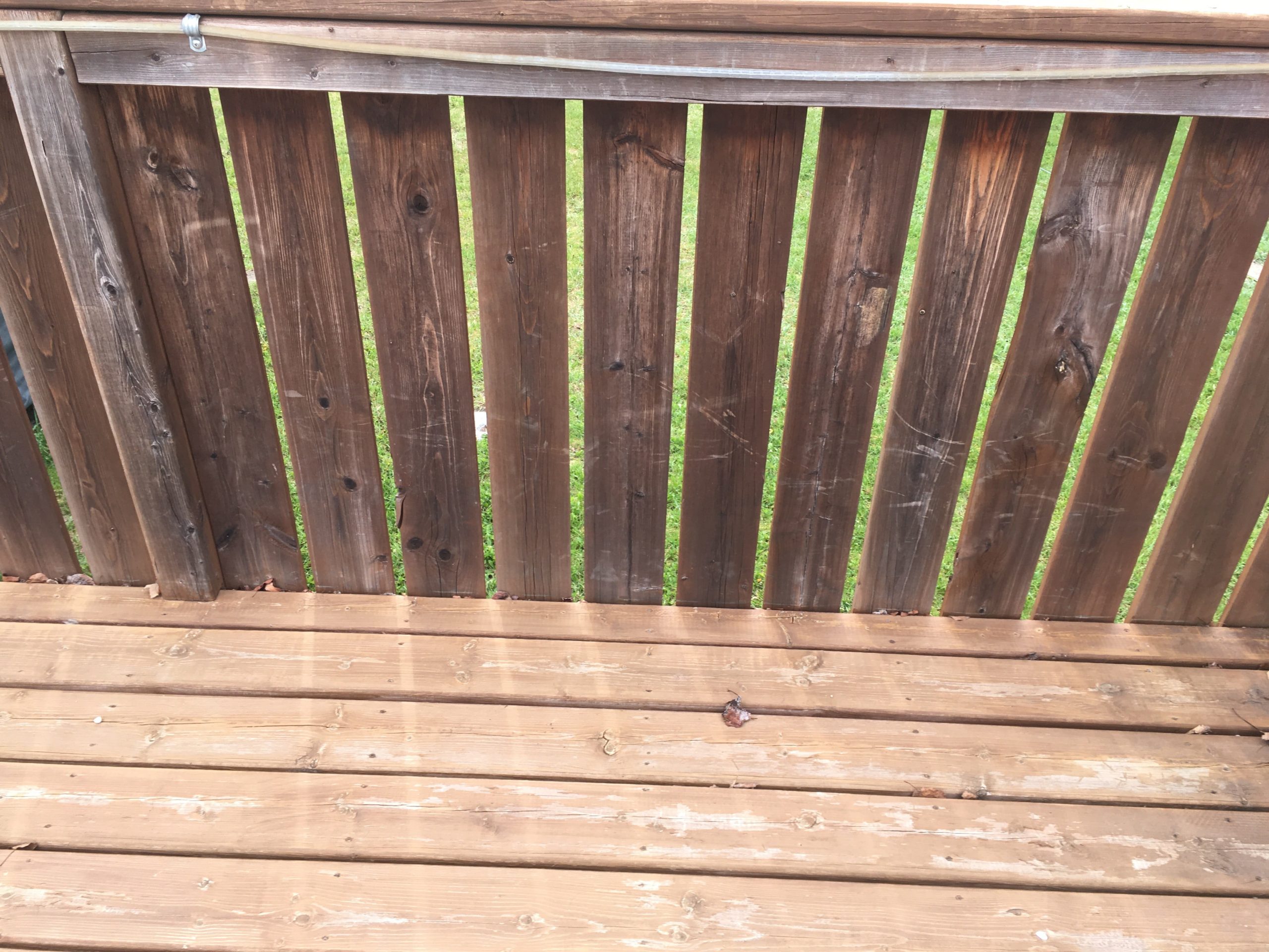

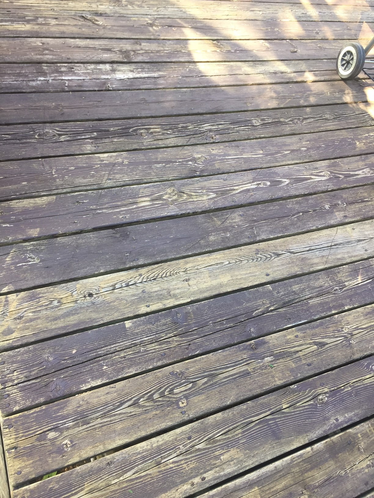

After 3 years of living in my home, I notice the deck is slippery and has lots of algae. Yesterday I powerwash the deck to get rid of all that algae. I was quite surprised that lots of the old stains came off as well. Although the deck doesn’t look so good, but it is clean and safe! Now, I am concerning *only* with getting something to protect the wood so it will last. Unfortunately, the more I read, the more confuse I am because there seem to be so many steps I’ll have to do. Help! Please recommend as to what I can do to accomplish my goal. Making the deck look good is nice but is not a requirement. However, putting on something that last AND also protects the wood well is crucially important.
Attached are a few pictures of my deck after the power wash.
Much appreciate for any help you can give.

I installed a new pine pressure treated deck last September. I live in Newcaslte, Ontario and it gets full on sun all day with no shade. What’s the best stain and where can I buy a Restore-A-Deck cleaner & brightener and TWP deck stain.
Peter
Peter
Per your request here is pic of deck referenced below #comment64695
Peter
Peter
