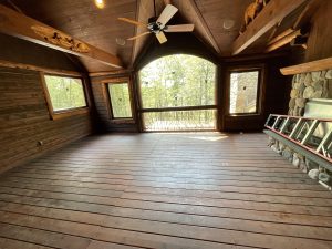

As for the best product for your cabin, I would need more info on what you are trying to accomplish.
Scott, a question for you. I’ll be working on a log home. I’ve got different areas of the house to strip. We tinted new logs darker to match existing areas 8 years ago when last stained. Now the tinted areas are darker so we strip them and do 2 coats of stain and things match. I’ve oredered the powder to try it out. How long is the product useable once mixed? I’m looking at adding the gel also as it’s vertical siding and will apply through a pump up spayer. Do you recommend scrubbing prior to pressure washing?
The stripper does not have a shelf life once mixed, so you can use it whenever. Scrubbing may be needed. It varies based on the difficulty or removal.

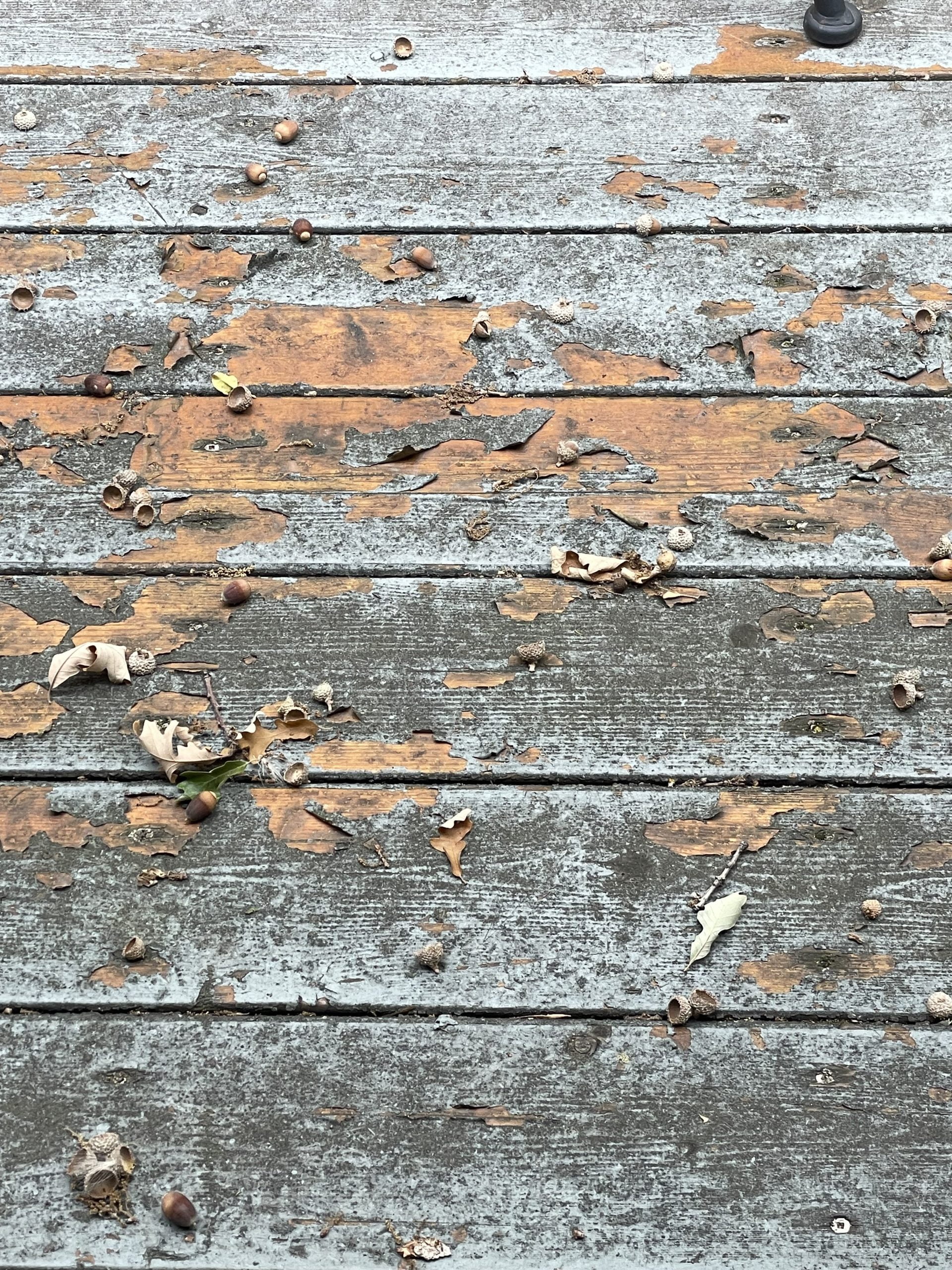

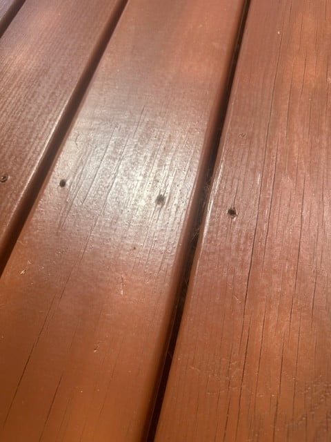

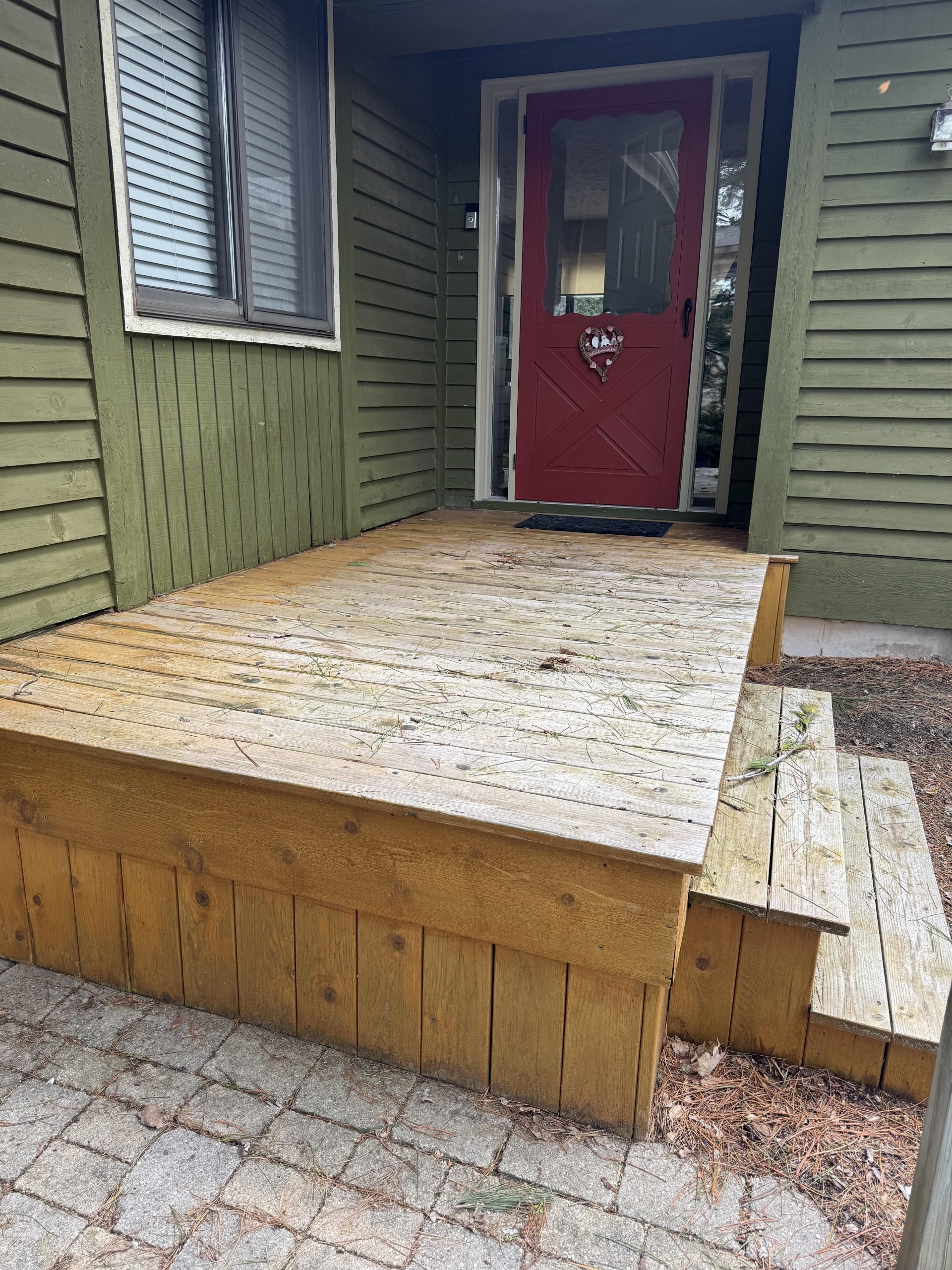

Hi, We used a Home Depot brand stain stripper, sanded, and power washed our deck and were not able to get all of the old stain out. It’s a 55-year old deck in Connecticut. What do you suggest for stripping all the remaining stain? What do we use for brightening; and finally what transparent stain do you recommend? Also do we need sealer after staining the deck? Thank you in advance for your recommendations!!!
What you have is a solid color stain. You will need to sand and or use a paint stripper to remove it. Tips:
You may want to consider a two-toned deck, as it will be tough to remove the solid stain from your railings. Tips here:’
No need to apply a sealer over an exterior wood and deck stain.
ok thanks. In some of your videos you said there’s something to brighten the wood after removing stains (increase the ph). Is there such thing?
Yes, brighten after:
https://www.deckstainhelp.com/product/restore-a-deck-brightener-only/

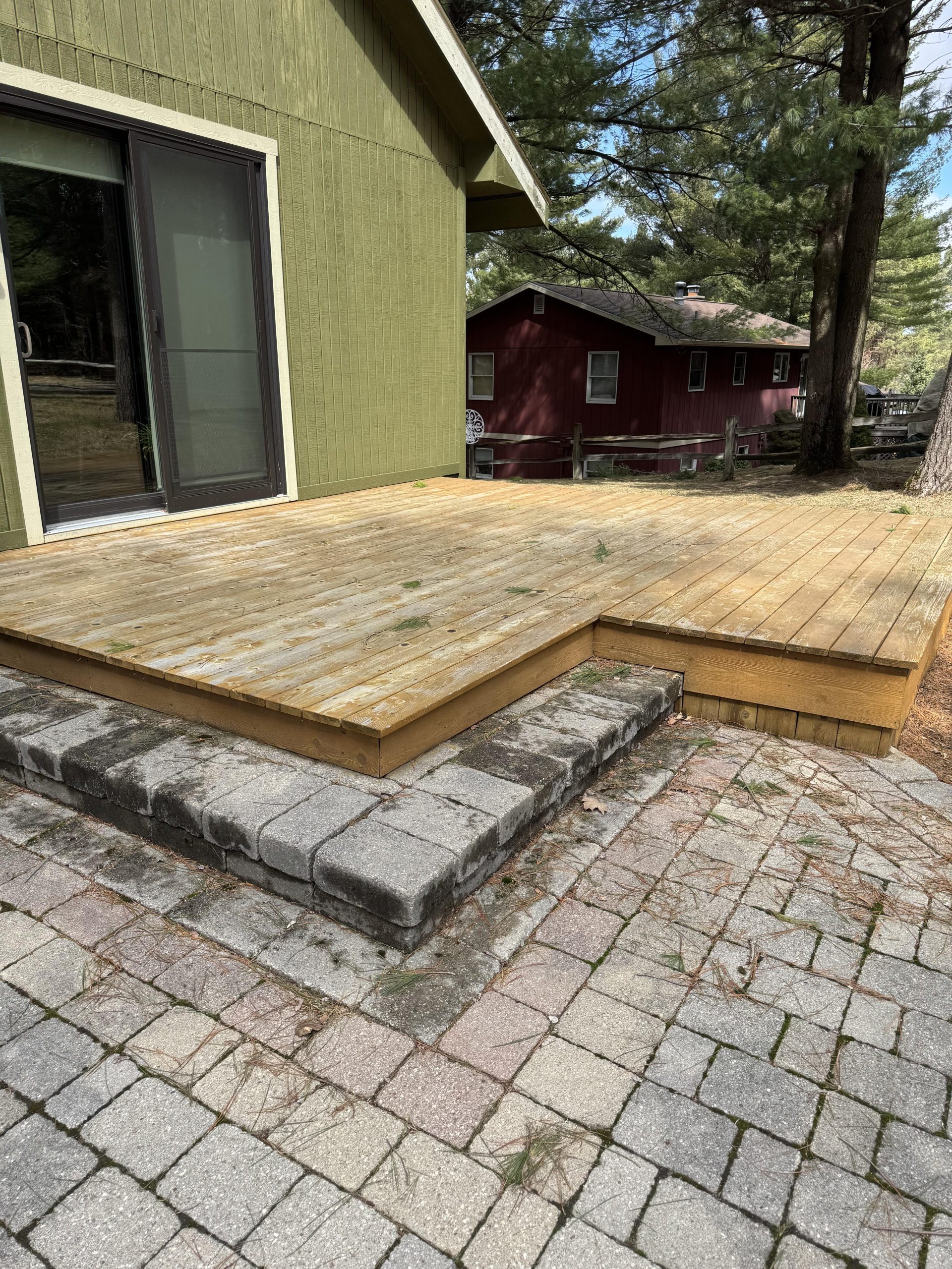

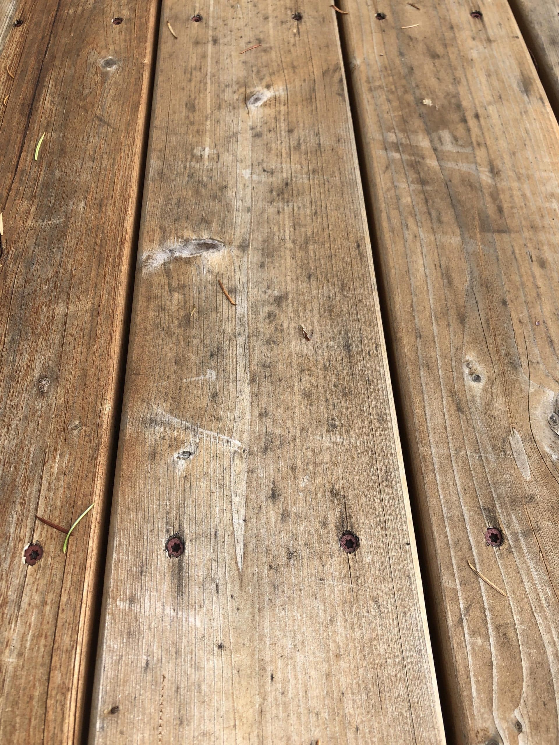

I have a old deck which appears to have no treatment by past owner. Thinking of using the Retore-a-deck cleaner and then the Brightner before I put a stain on it. Looking for recommendation.See attached
No pics, but yes, that will prep the wood. For the stain, use a penetrating stain such as Armstrong Clark or Restore-A-Deck:

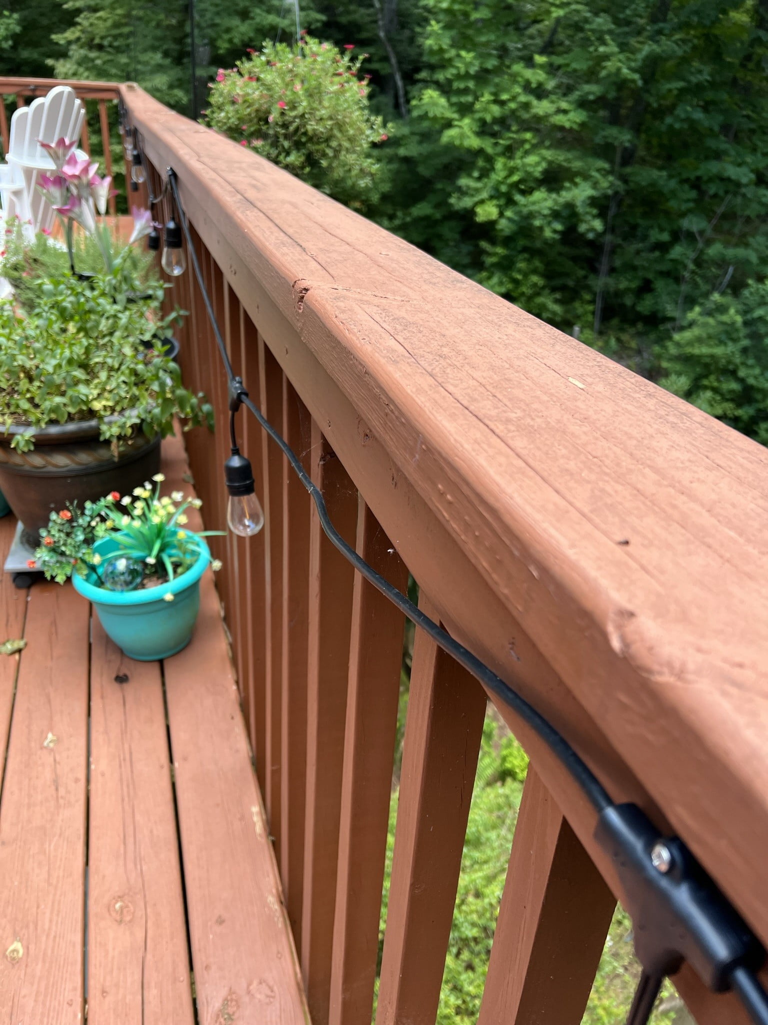

Do not know what stain is on railings but appear to have a sheen so I think perhaps a type of sealer was put on them. Wish to revert to a semi-transparent stain with no sheen so that maintenance will be simpler. Would the Stain stripper work on this so as to switch to semi-transparent stain be recommended in this case.
We would need pictures to see what would work best. You can add them in the comments.
here are the pictures, sent the earlier but there were 5 so I guess they did not go through.
Still no pictures. Most likley they are too large in size. They have to be below 2mb.
Will try one more time but pictures are 1.2mb and there were only two.
Try one at a time.
here is one
Here is the second one. they are jpeg format.

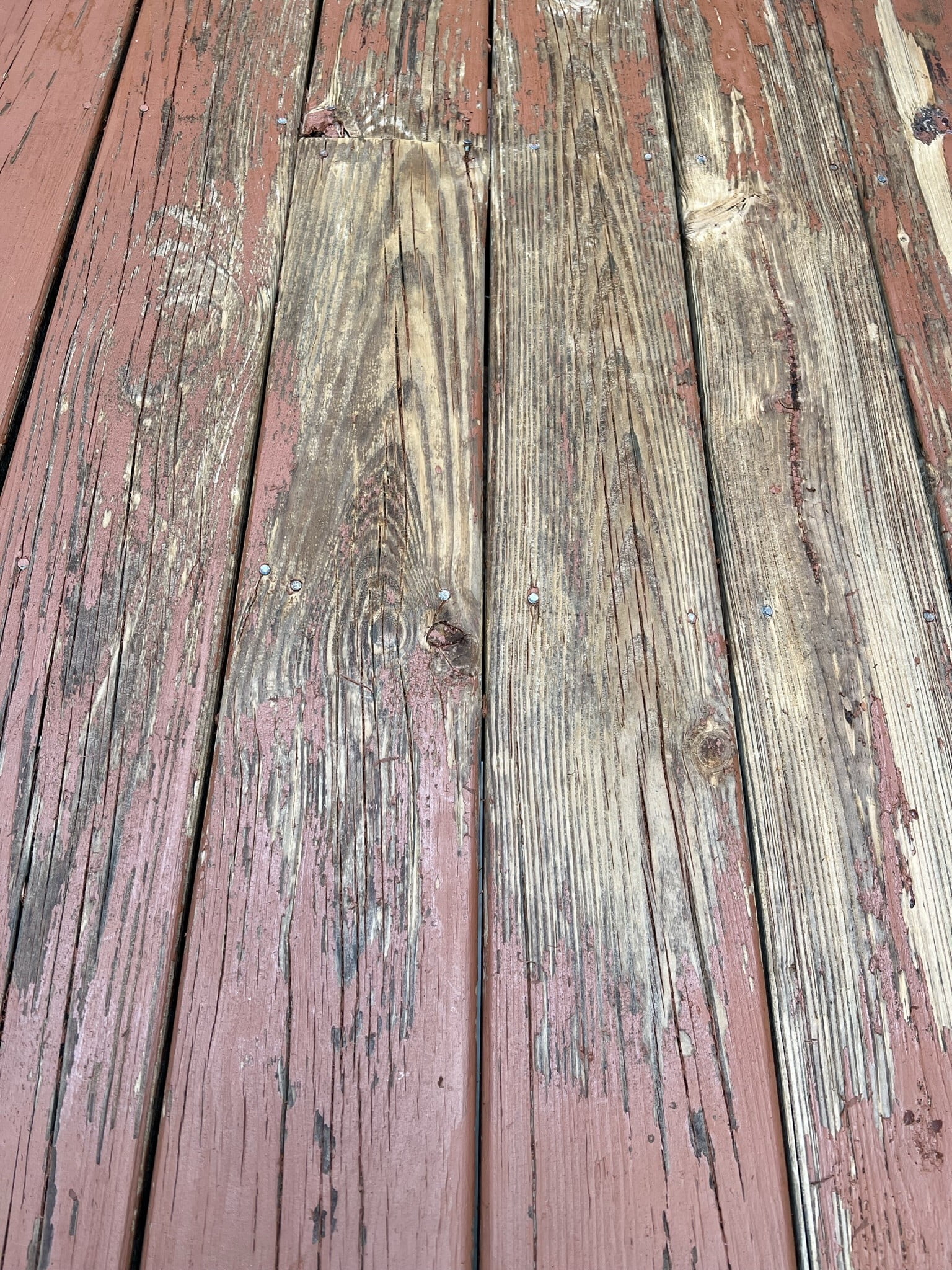

Thanks for the information, Scott. What stripper would you suggest for a 14 year old pine deck that has 2 or more coats of Sikkens oil based stain and appears like a semi-solid stain at this point? The deck is covered but open to the elements. Thank you.
You are better off power sanding this, and stripping and pressure washing in an enclosed room is nearly impossible to properly do.

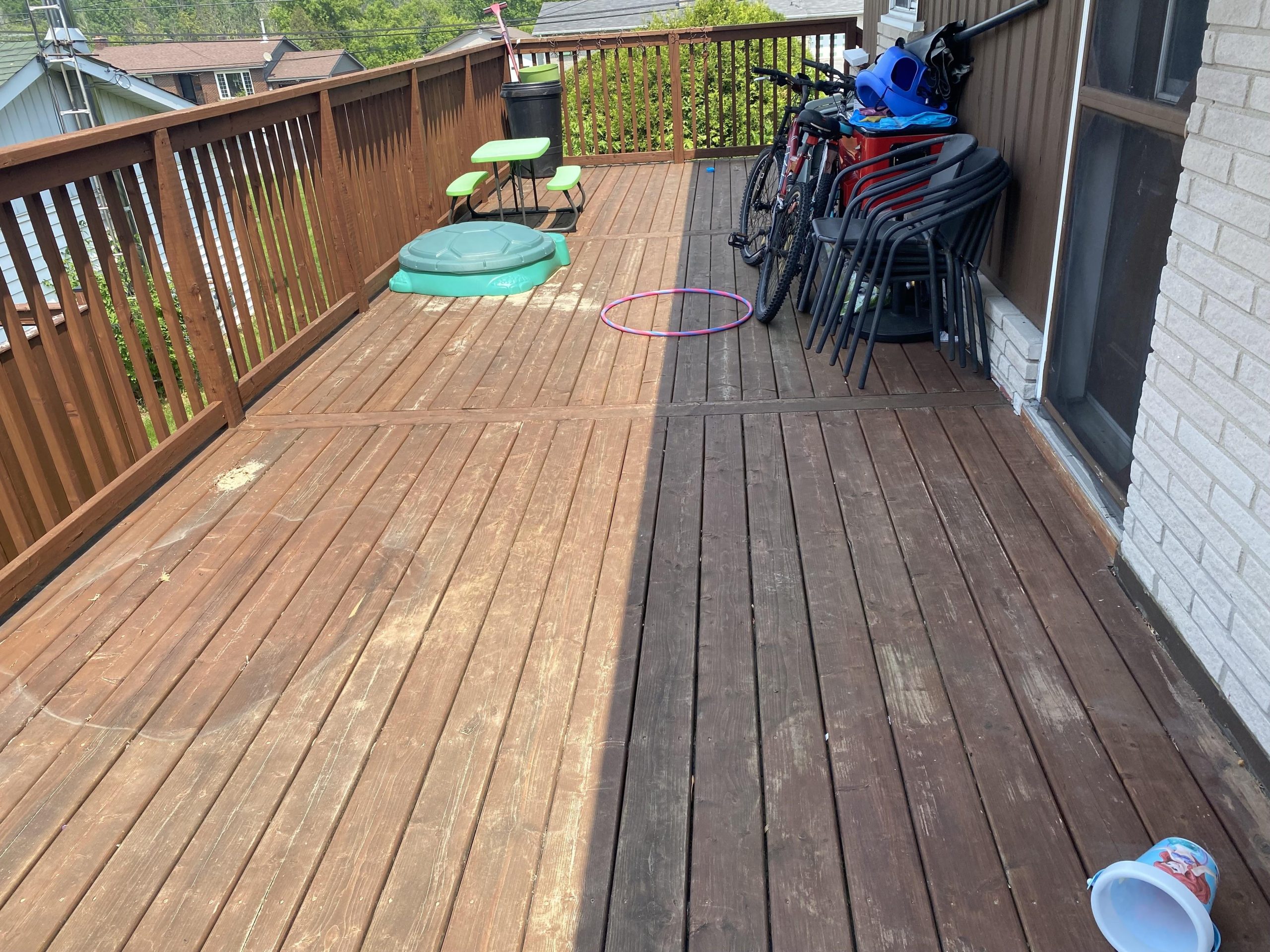

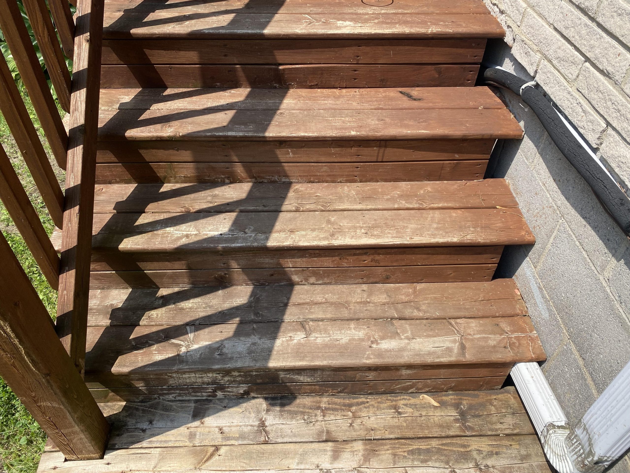

My deck is about 5 years old. Been stained twice with Sansin Pressure Plus semi-transparent. Both times, the finish would wear and flake.
Should I strip, brighten and reapply a new brand of stain?
Can I get away here without sanding?
I’m in Ontario and have limited options for l products.
Strip and brighten for prep first. Sand if needed to remove any stain that does not come off with the stripping. Use a proper penetrating stain so it does not happen again. Armstrong Clark stains or TWP 200 Series. You can buy all online from this site.

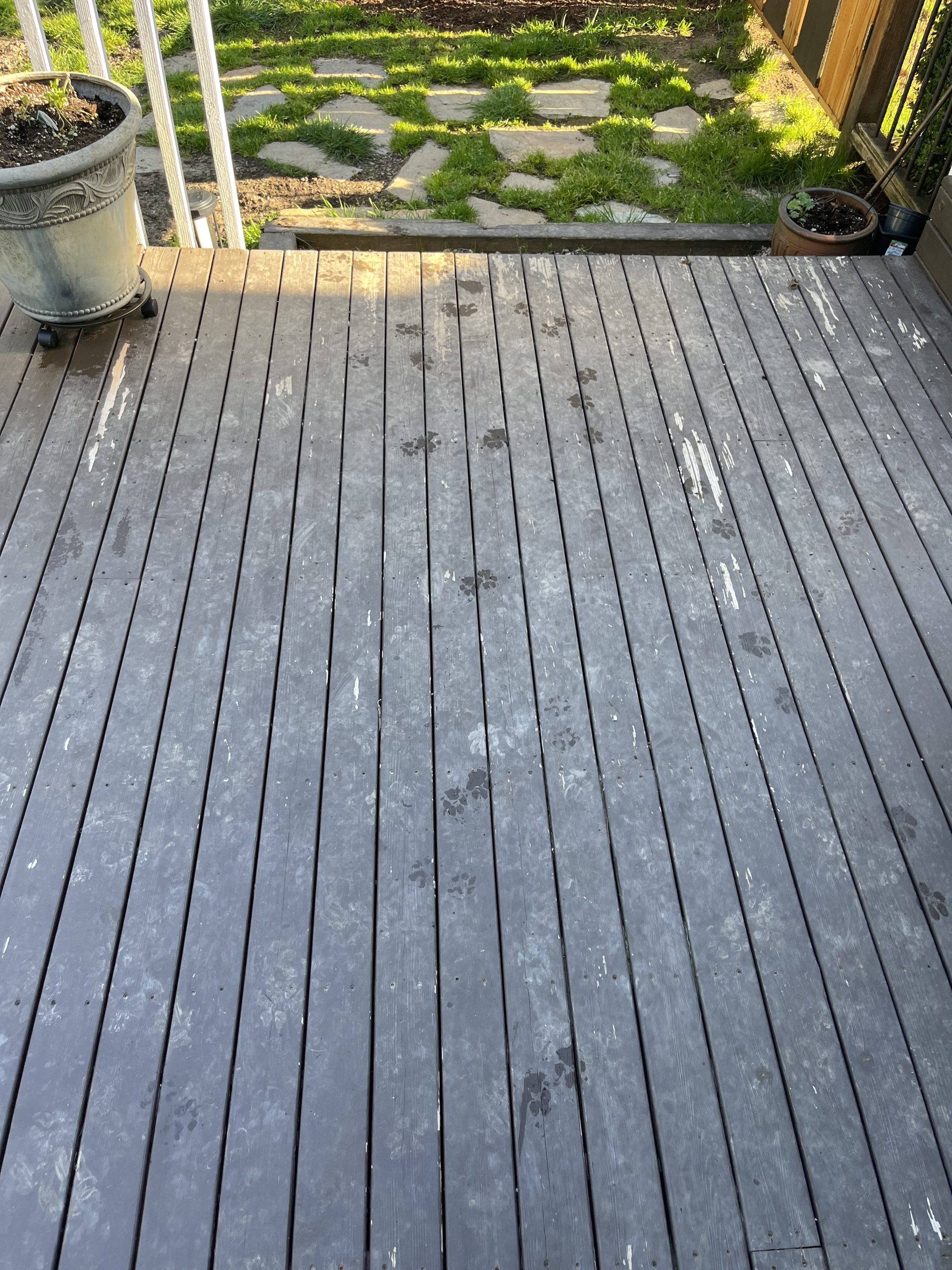

I failed to mention that I want to change the color of the stain to match the color of the trim which is darker than the siding.

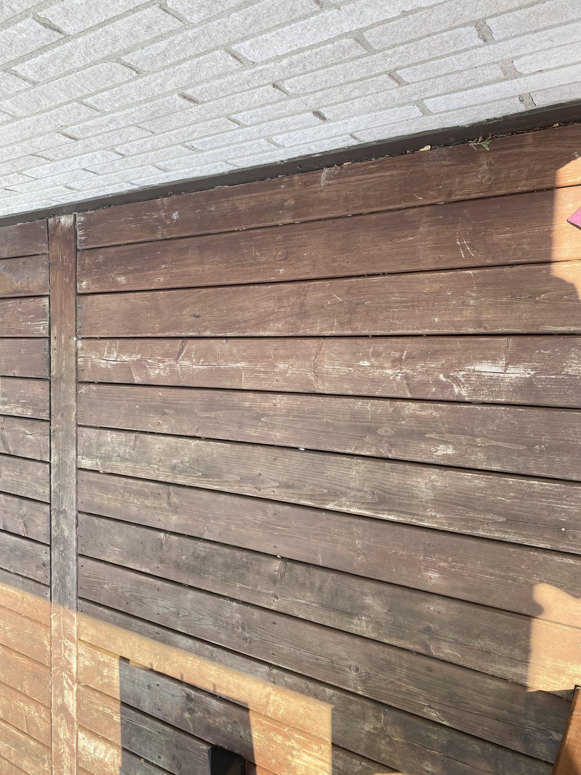

The current coating looks opaque, like a solid stain. What stain brand is it?

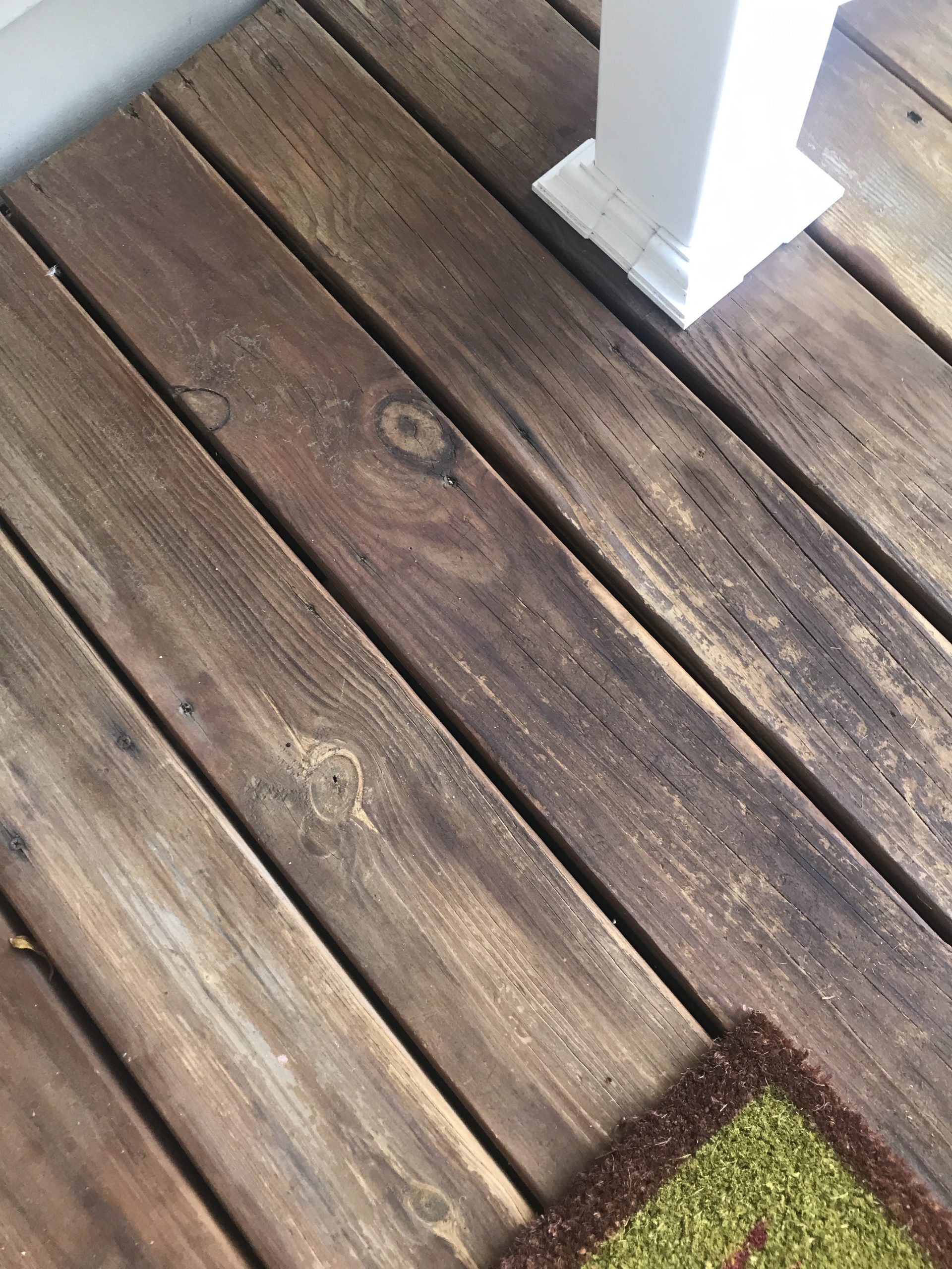

We purchased a home that has an oil-based transparent stain on the back porch, landing and steps down. Do the recommendations you state apply to removing oil-based stain also? If not, what would recommend to remove an oil-base transparent stain? Thank you, Roxanne
Please add pictures in the comments so we can offer proper advice.

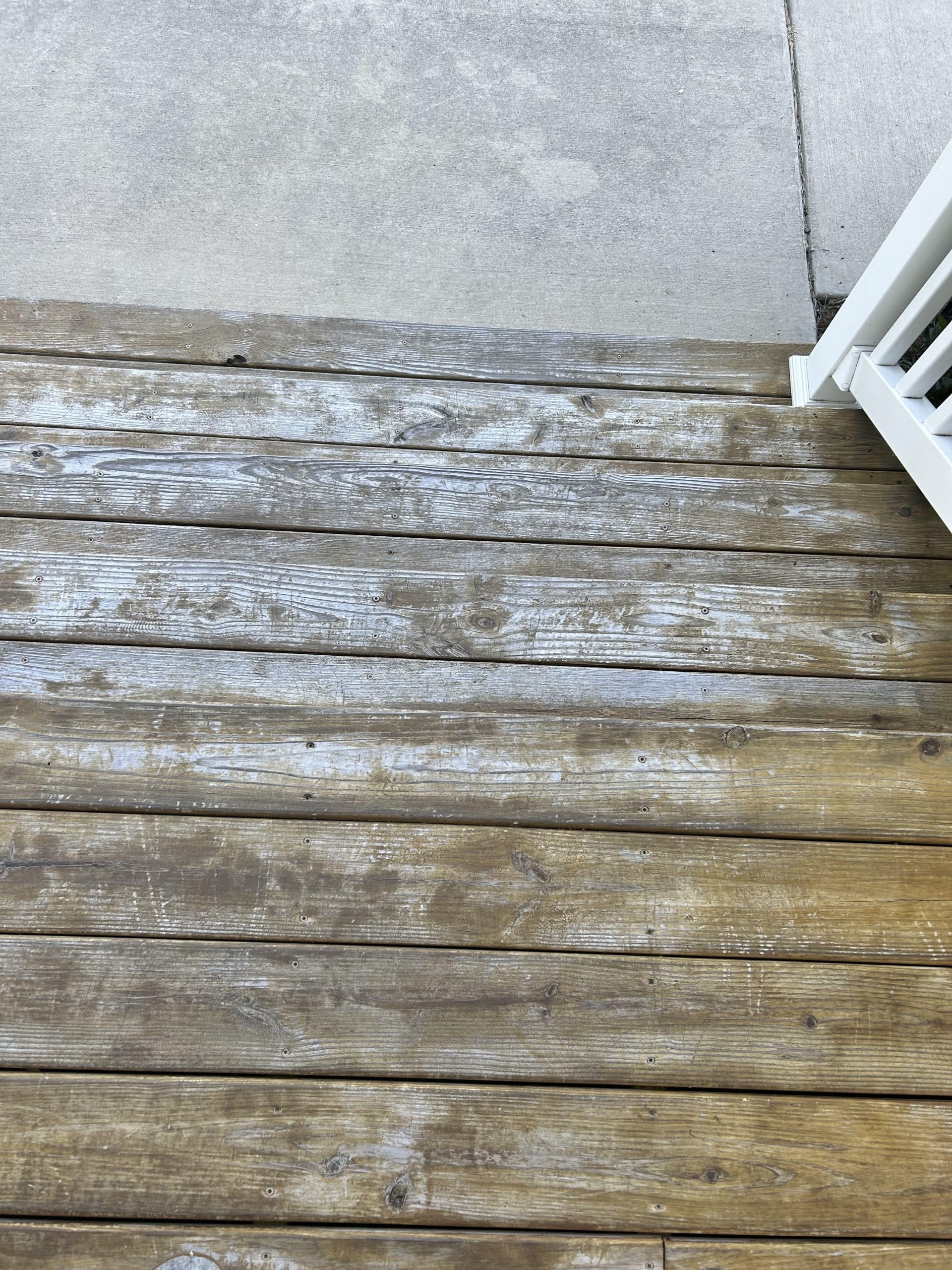

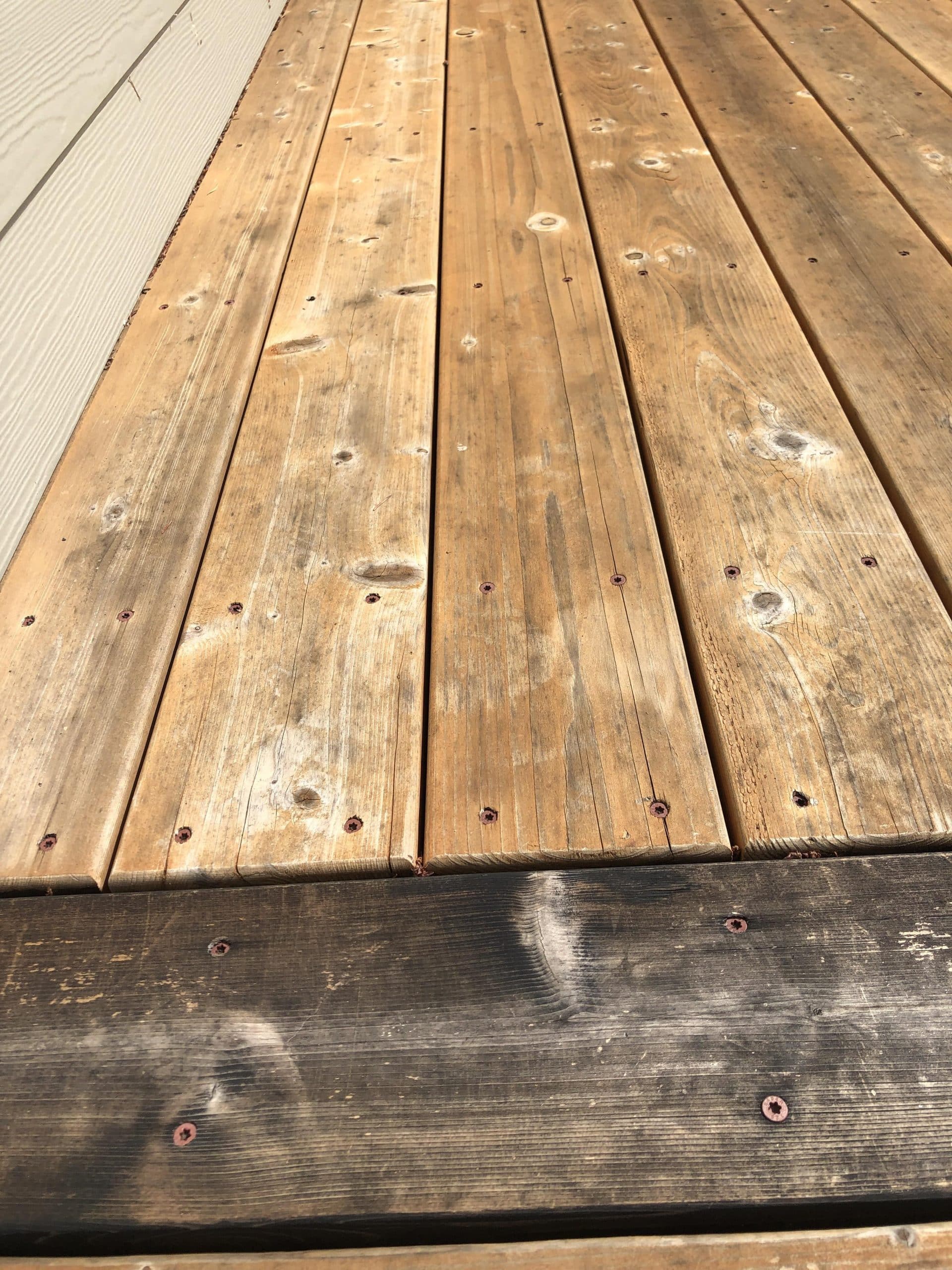

I have a 5 yr old cedar deck and have used RAD products 2 times. There are some areas ( under deck furniture) that have some semi transparent stain needing to be removed. Should I use stripper and then brightner, or stripper, cleaner, then brightner before applying semi transparent stain again? Would Armstrong Clark stain be better than staying with water based RAD semi transparent?
Pictures?
Attached pictures.
Stripping and brightening would be easier for the prep. AC is a good but not better.

I have a 24 sq. ft. “Stoop” + one step, that needs attention. I bought the condo 7 years ago and have no idea what the previous owner put down. I’m hoping you can tell from the photo. I really don’t want to rent a power washer for such a small area. What would you recommend? Thank you!
Pressure washing while using a stripper and brightener is the easiest solution. Other option is to power sand:

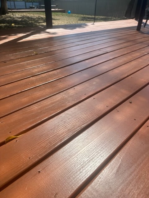

We just had two decks stained with Cabot Semi Transparent Redwood stain. It seems like the stain was applied very heavily as it is shiny and tacky. It almost looks like paint. It makes the wood very hot and slippery. What is the best solution at this point? One of the decks surrounds a pool.
To fix you would have to power sand this all off.
Oof. Ok, is that what you would recommend given the photos?
If the stickiness does not go away then yes.
And can you explain why sanding vs any kind of stripper or a combination of the two?
Strippers will not work very well with a newly and over-applied stain like this.

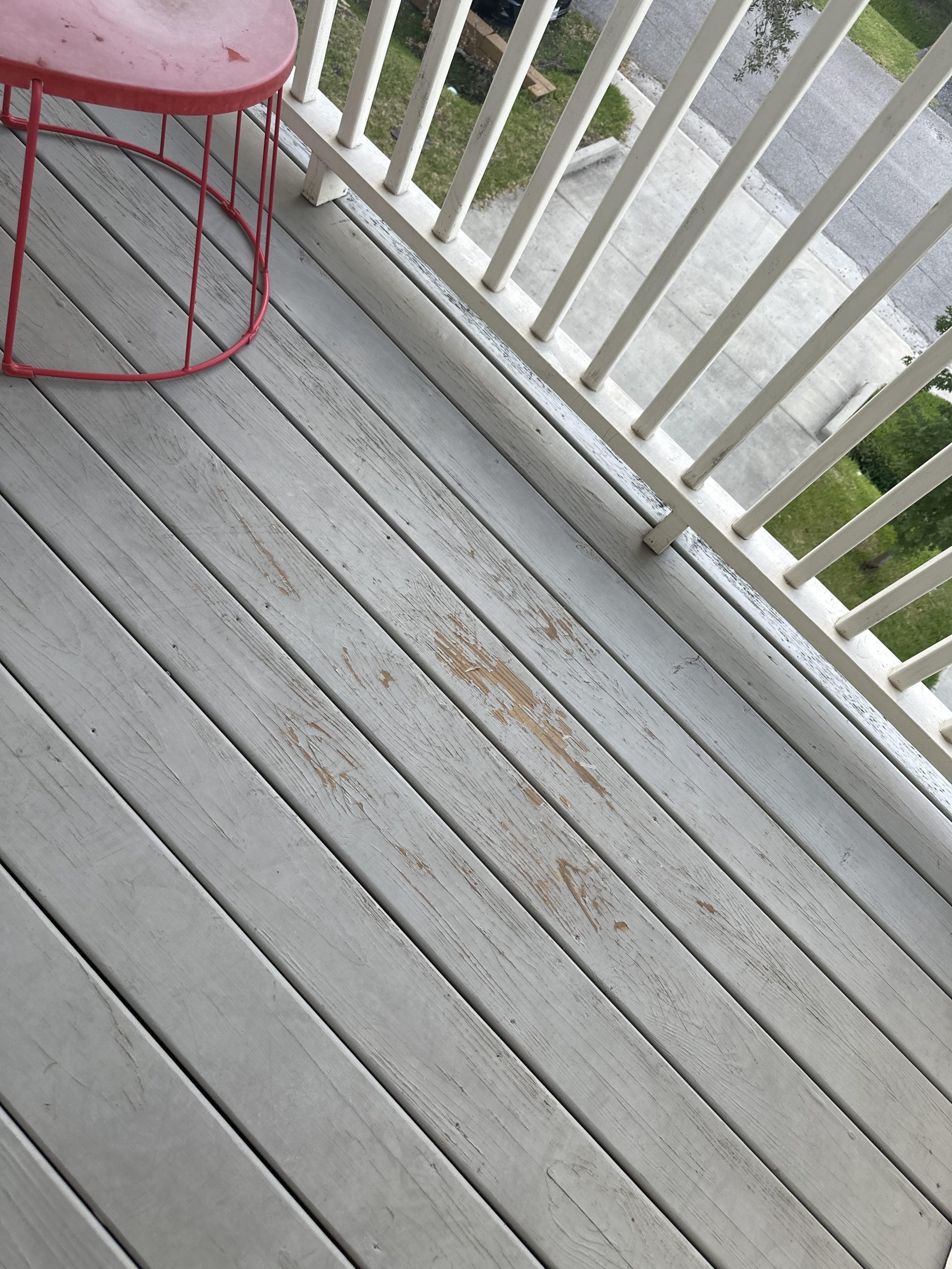

Please help! (in the last pic, we tried a stripper as a test. we also pressure washed) Thank you!
See this for tips: https://www.deckstainhelp.com/how-to-remove-a-solid-color-deck-stain-or-paint/

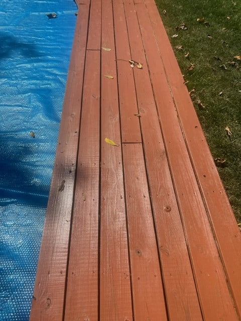

Looking for recommendations to strip and restain 800sq ft deck. Existing coating is Thompsons semi transparent. Deck is on second level supported by painted structural beams. Is stripper going to damage the painted beams. Will restore a deck do the job. Please advise
What you have on the wood is more of an opaque solid stain. Thompsons lies about their opacity. Problem is that a deck stripper will not remove this fully. You can strip off as much as possible but then you will need to sand to get it all off. You would have to do this if you want to use a proper semi-transparent stain. The other option is to remove what is peeling and then cover the rest with a solid color stain. https://www.deckstainhelp.com/how-to-reapply-a-solid-color-deck-stain/
