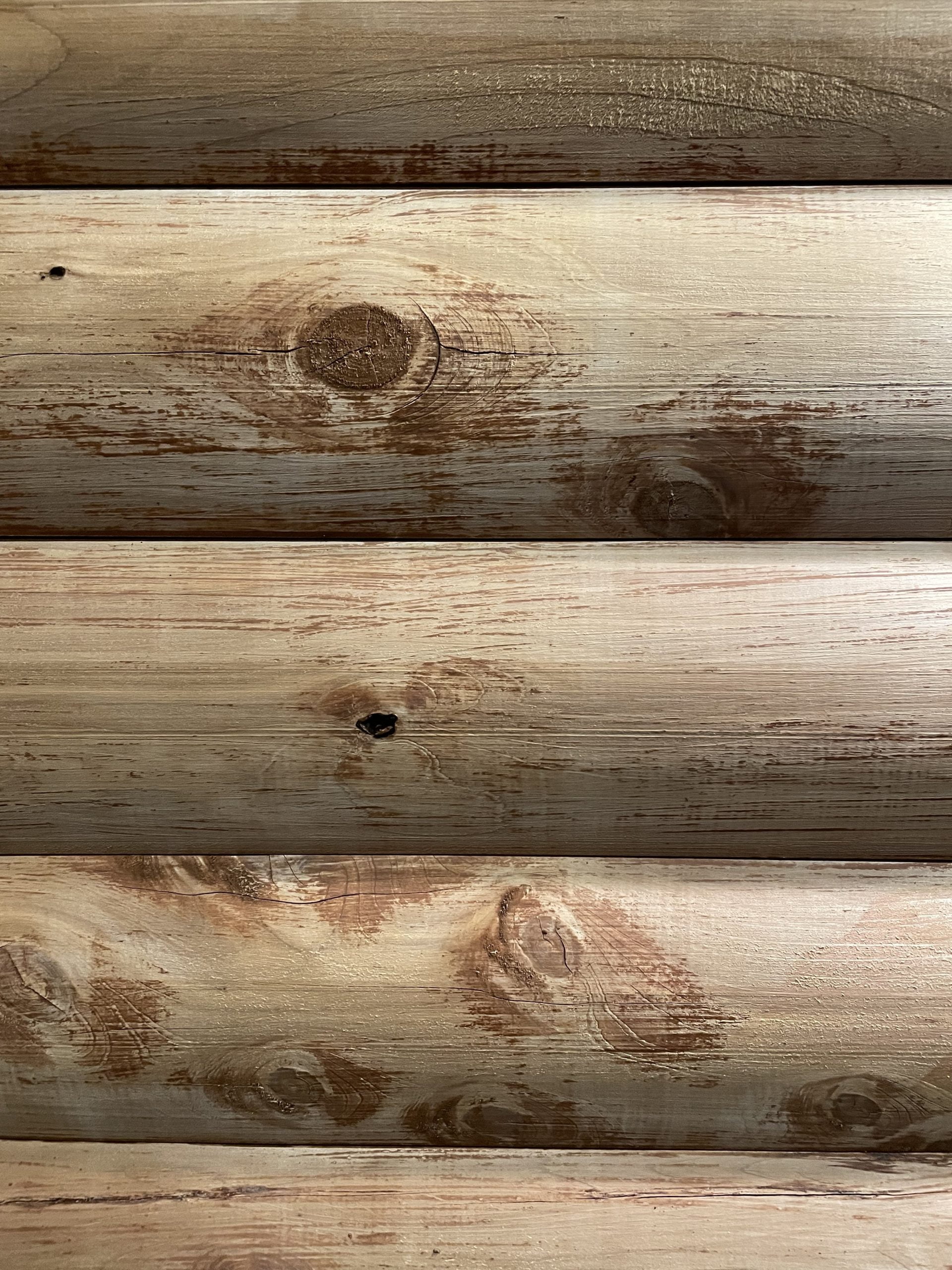

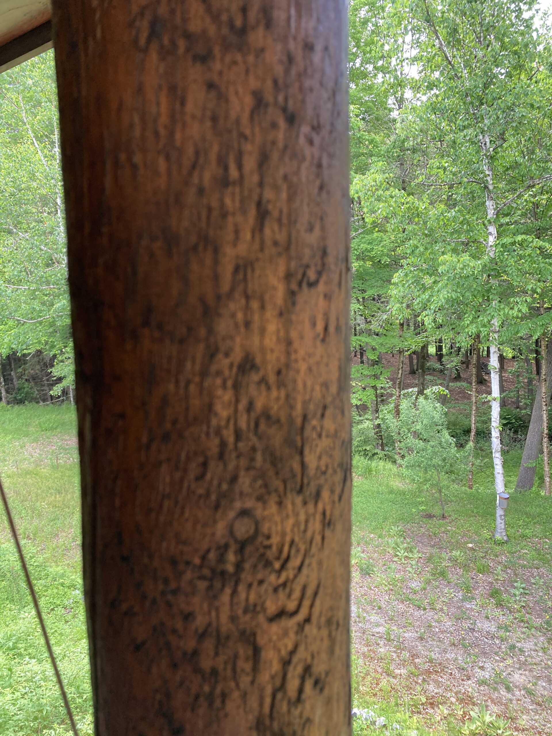

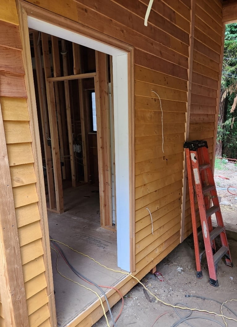

We’re renovating the Lake House. We choose new pine log siding to replace the old log siding as the house addition would not match on the entire house. I am a long time customer of TWP and that was easy to go with them again. My question is with the new wood how long do I wait to stain, and if it turns grey can I stain over that without removing it? I read about mill glaze, the resins on smooth surface from milling blades. I read to wait 5-6 months prior to staining.
The old cabin wood was very dark and we want to get this as dark as possible. Going with dark walnut TWP 1500.
Eric
Eric Steffy
Eric Steffy
Ok. Will the TWP not adhere as well if it is grey? Is 5-6 months a long enough wait period or can I lightly sand and stain sooner?

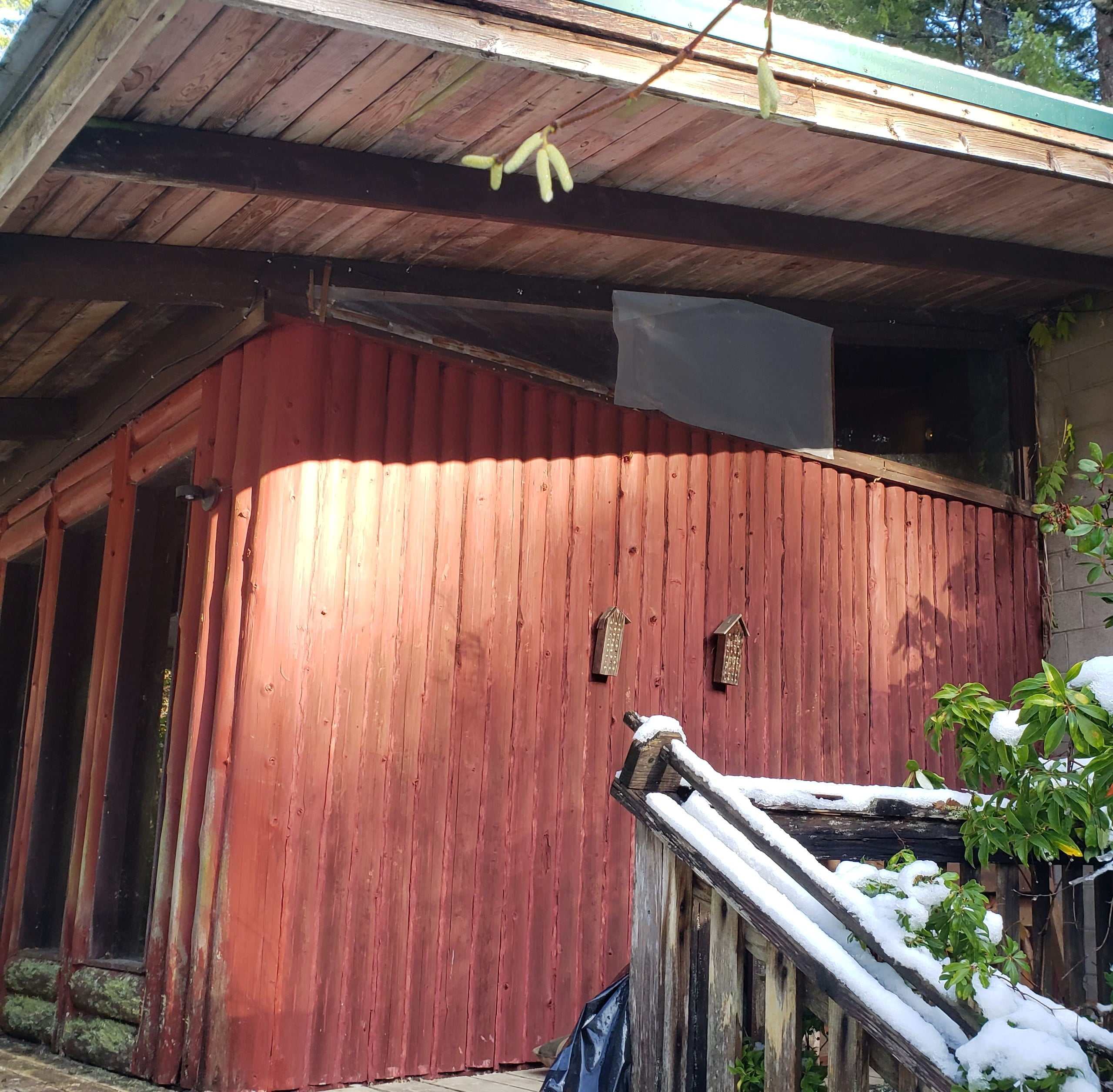

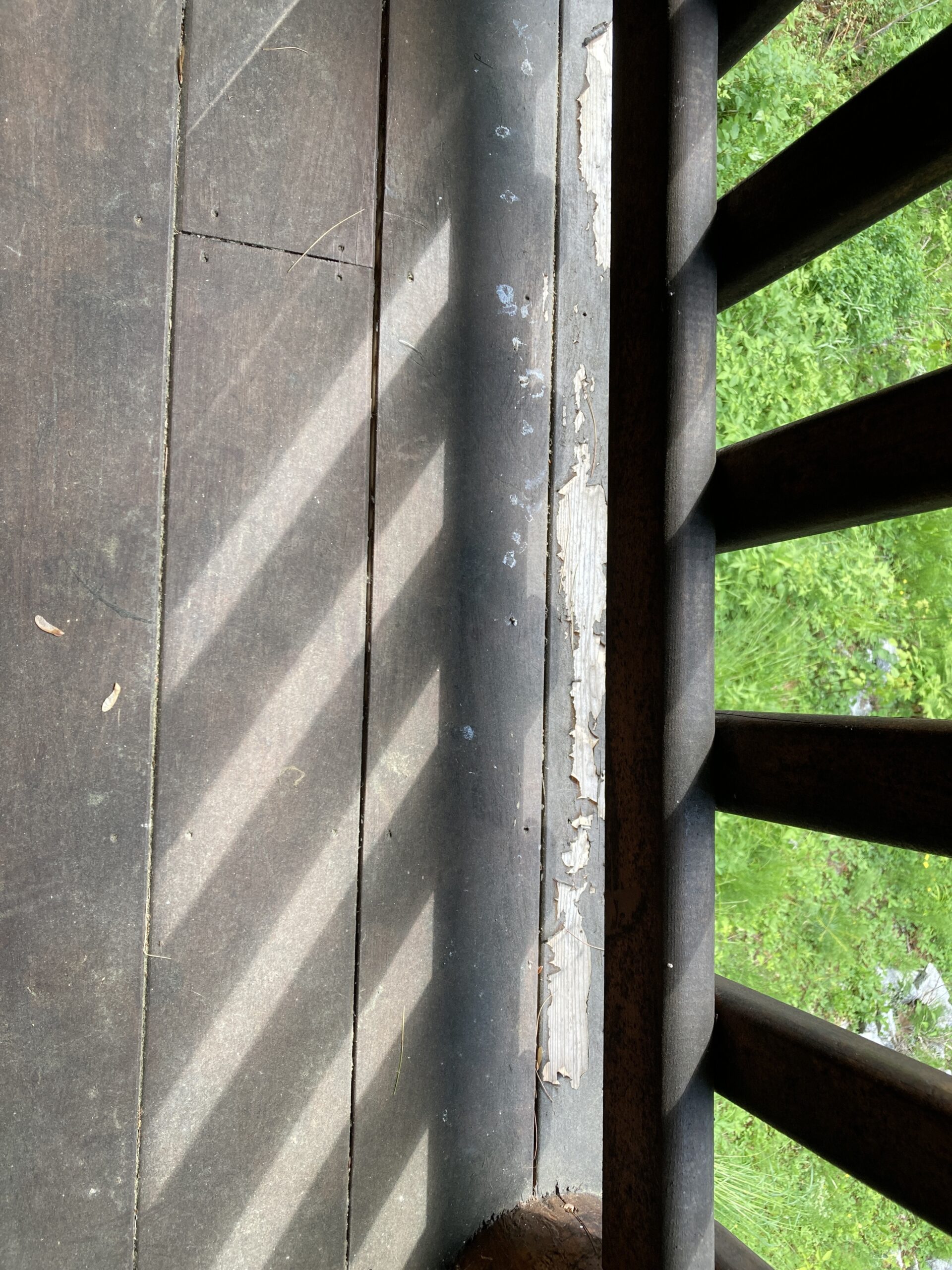

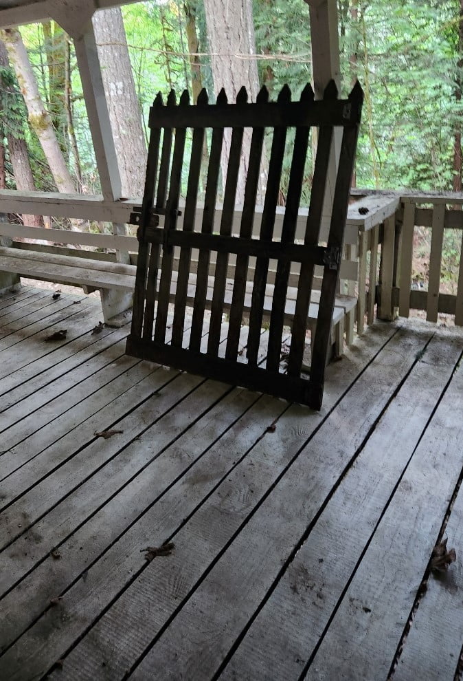

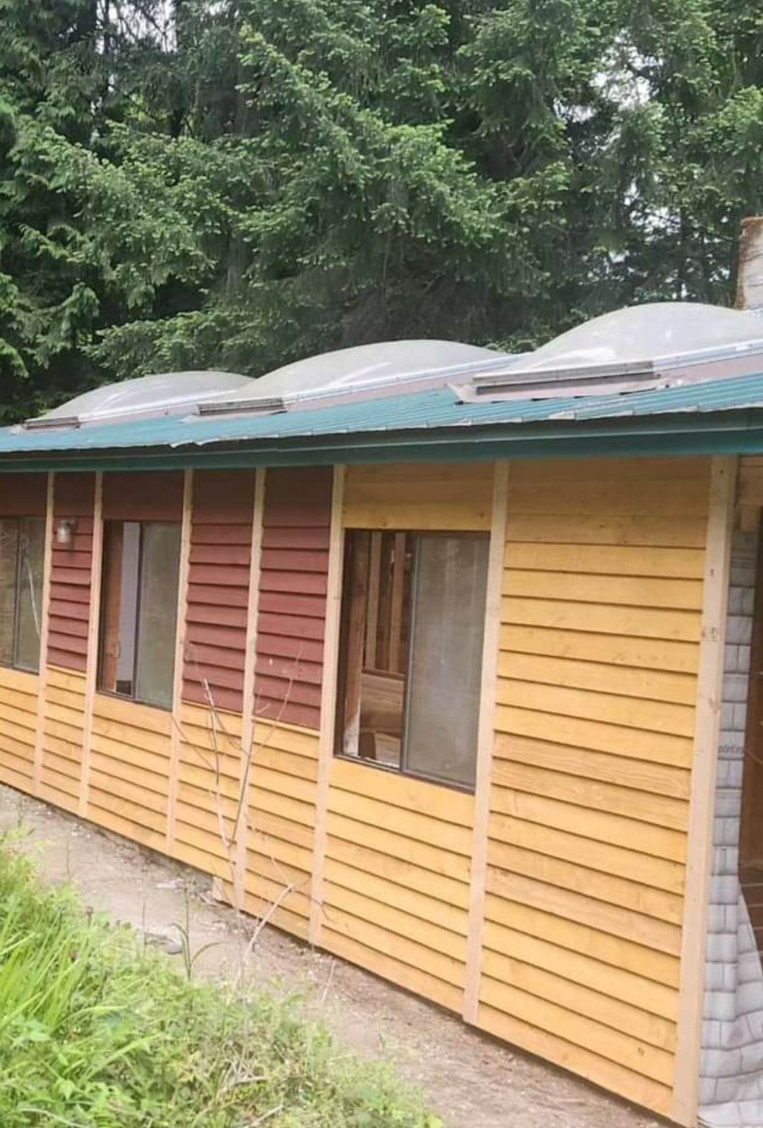

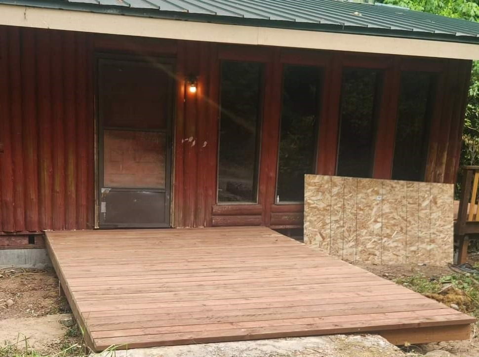

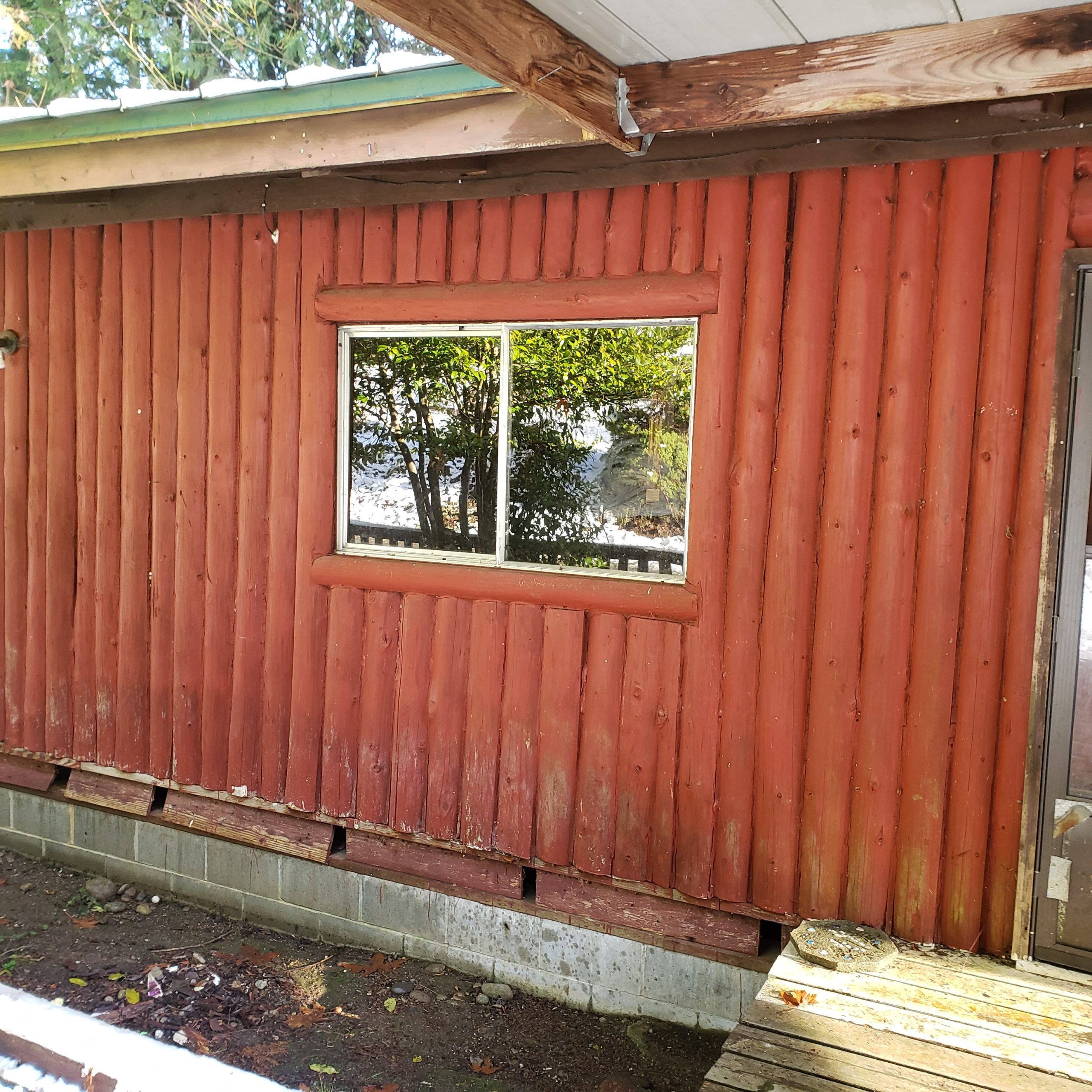

Just bought this stockade log fixer, ADU, and pole barns remodeled from the 50’s onward using wood from the property.
There’s a variety of surfaces including: old fir logs, old rough sawn fir decking, railings, benches and fir clapboards, as well as new cedar clapboards and treated railing and decking added by us. Pole barn is getting new T-1-11 and Hardie board.
Media blasting everything this week, then hoping to find a coordinating line with products in the same color and finish for each surface.
Was planning on using Cabot, in one color for the different applications, but this is not advisable anymore, correct? Even if we could find the original high VOC oil formula?
Looking at TWP, AC, and RAD stains, it doesn’t appear that one line has it all. Will we have to just mix and match?
Do any other recommended lines exist that have color coordinated products for:
-Semi-solid penetrating oil for the logs to cover discoloration
-Solid stain for clapboards to cover discoloration
-Semi-transparent stain for new decking
-Acrylic resurfacing product for old decking (planning rebuild soon)
-Acrylic solid coating for cement boards
Also, do we need a brightener after media blasting?
FYI
-In Washington state 8b, fungus of many kinds
-One side of house heavily treed, other side faces full weather
-Old decking is covered, new decking is open
-Everything treated with Borate for insects
-Old paint blasted off
-Color needed is dark brown
Morgan
Morgan
Ok, thanks!
Cabot does have all those products available in the same colors, and they do seem to magically match regardless of species/age/opacity, which is why we thought we had a foolproof plan.
But the new formulas are such a flop, we’re forced to pivot to a new brand. Thanks to this website though, at least we won’t waste time and money on products doomed to failure! We will take your advice and find a mix that works.

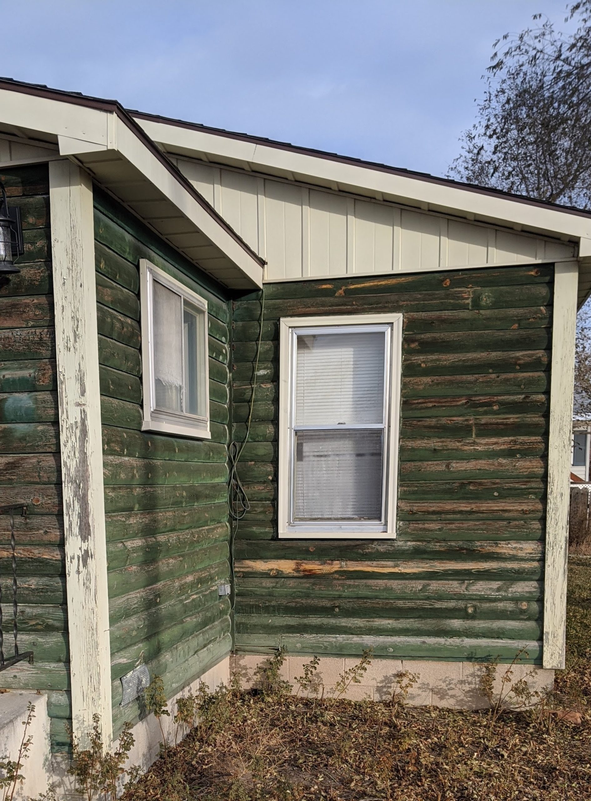

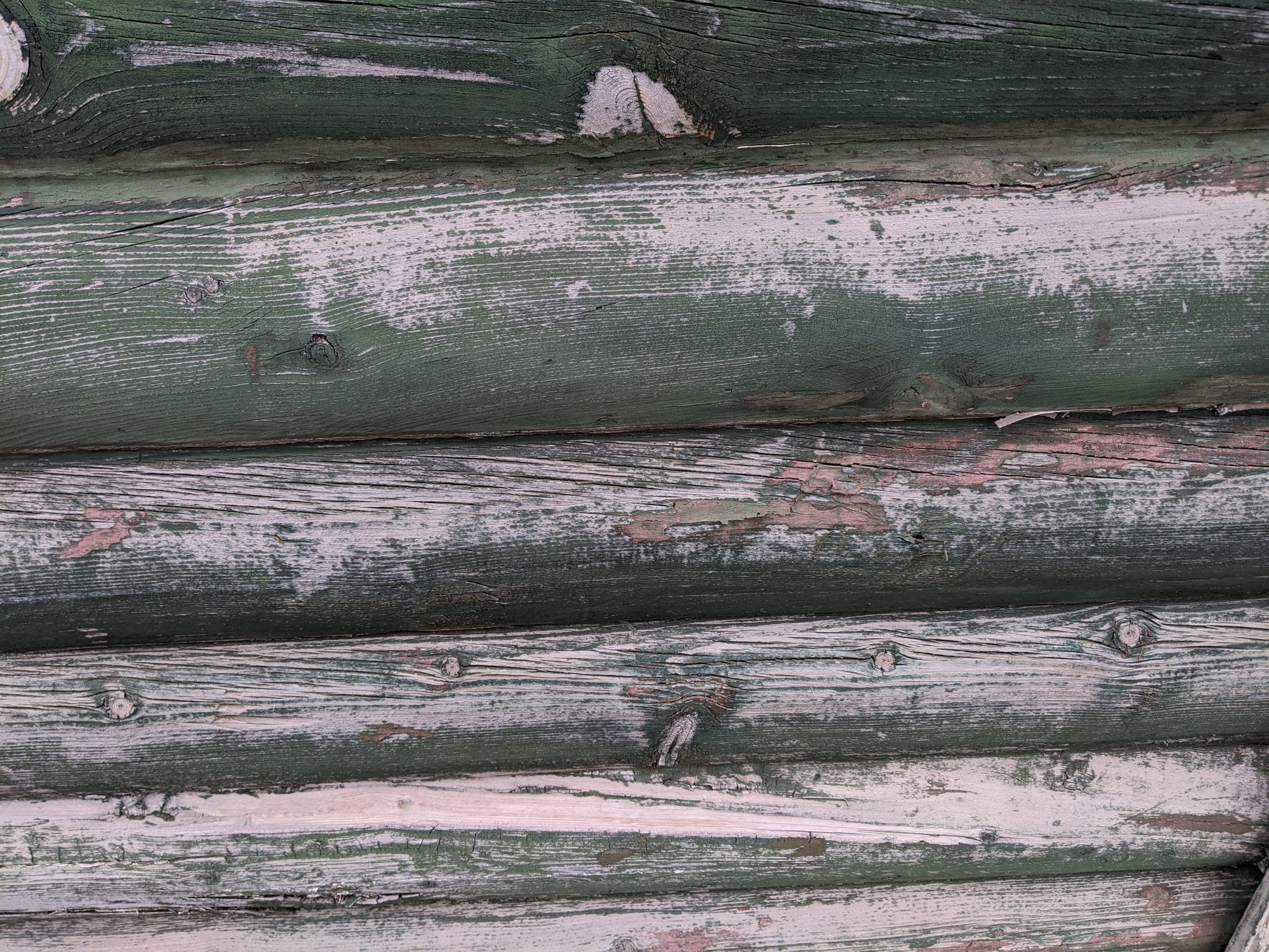

We purchased a log home that hasn’t been cared for. At some point they painted it green. We’re going to get it walnut blasted and then stained. The company doing the blasting recommend Messmers, I was thinking Lovitts. What do you recommend? TWP?

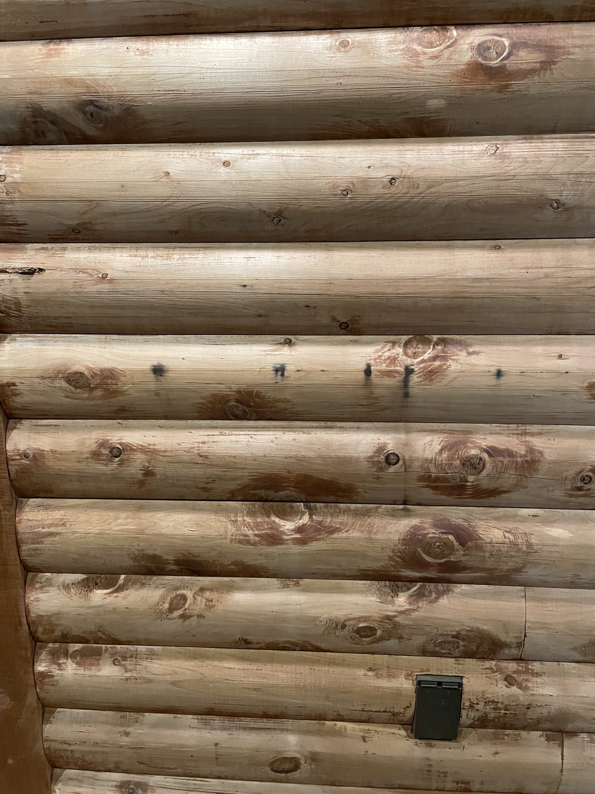

I have a 5 year old cedar log home. I used a semi transparent water based stain from Sherman Williams(regret)and now and stripping off the stain and want to go with an oil based stain. Looking at Cabot’s or TWP but my question is you can still see some of the latex in certain parts of the logs, not much and with it being cedar don’t think it will be noticeable. Would oils based over those places hold up? See pic below
