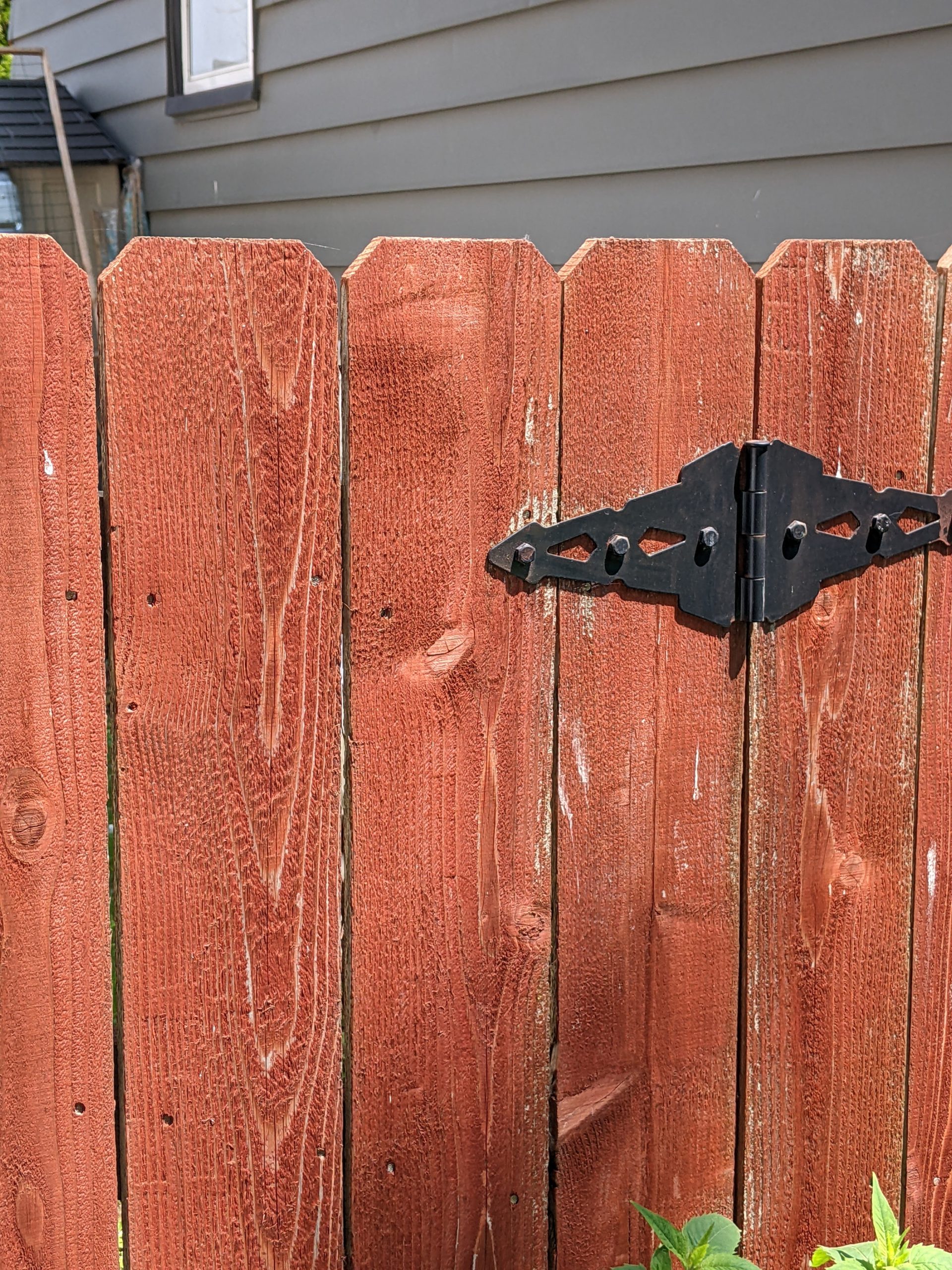

Applying TWP 100 Series in Dark Oak to Wood Fence.
https://youtu.be/xH6RnzN4M-c

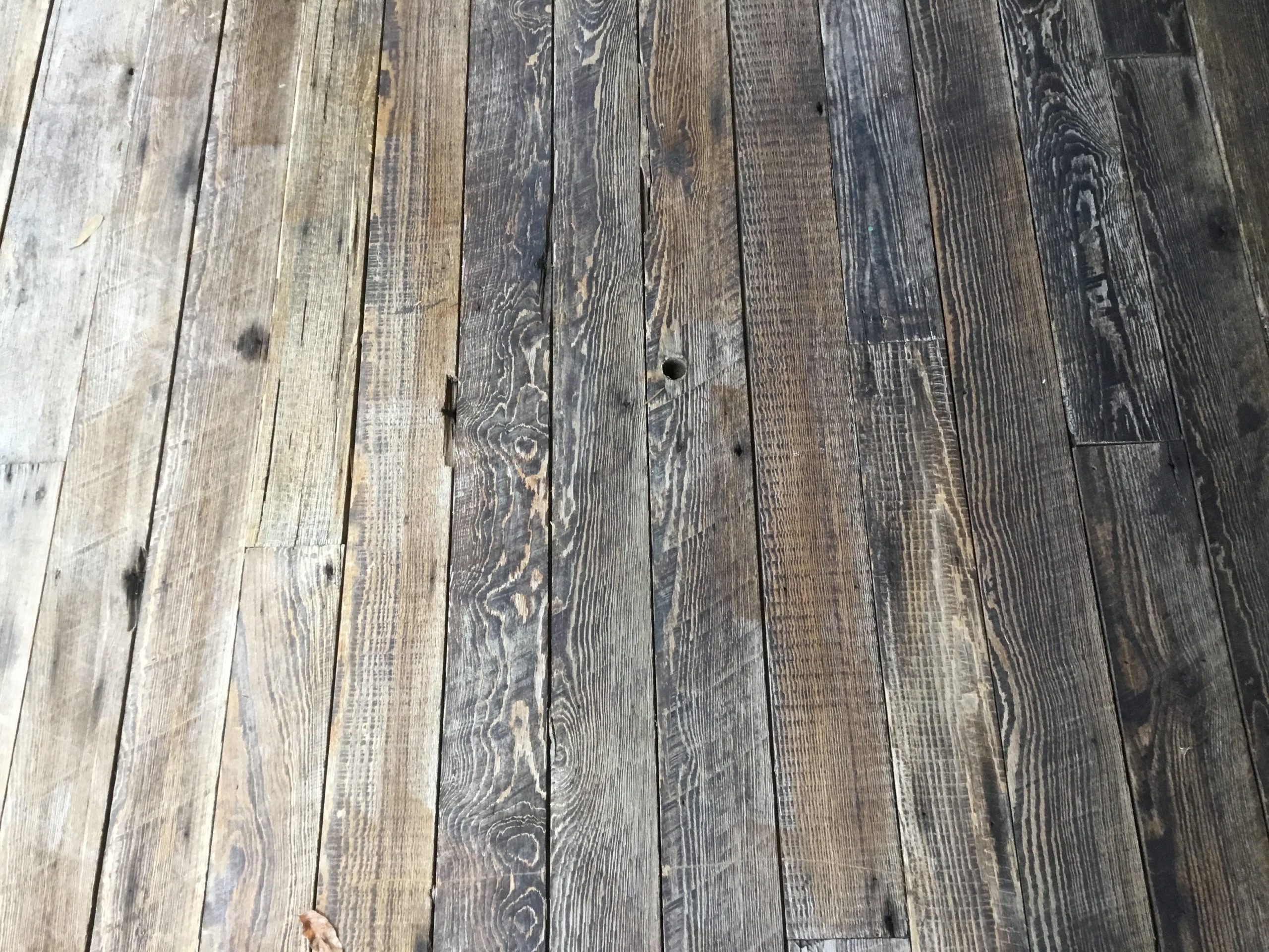

We have old pine boards under roof as our outdoor porch flooring in Louisiana. We pressure washed and are ready to put a sealer. What item and color do recommend? We like the rustic look.
You will need to strip or sand all the old stain off first before using a new stain brand like the TWP.
So once the old stain is removed, which TWP do you suggest and what color ??
Any color that you like will work. If you like dark brown, try the TWP Dark Oak in the 100 Series.

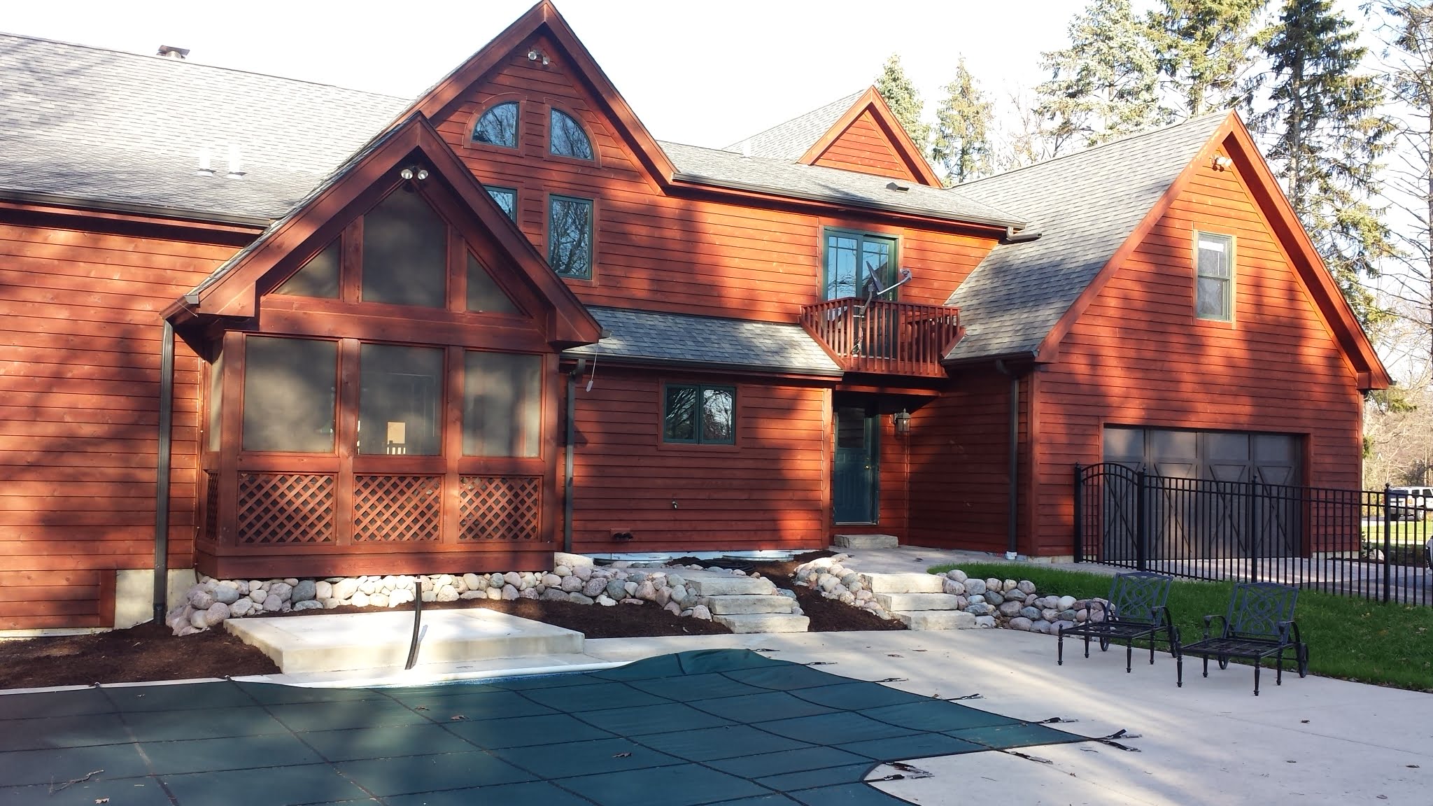

Found it at local PPG store. Thanks. I applied TWP 1500 in 2015 on my all cedar home. Love the look and performance of stain. Just thinking of a change in color. Attached are photos of my home in TWP 1500 Rustic Oak. Awesome product!
We would stay with the TWP as it looks great. The solid stain will look like a paint.
Thanks, I agree. Was thinking semi-solid or solid would stretch out time between maintenance coats.
