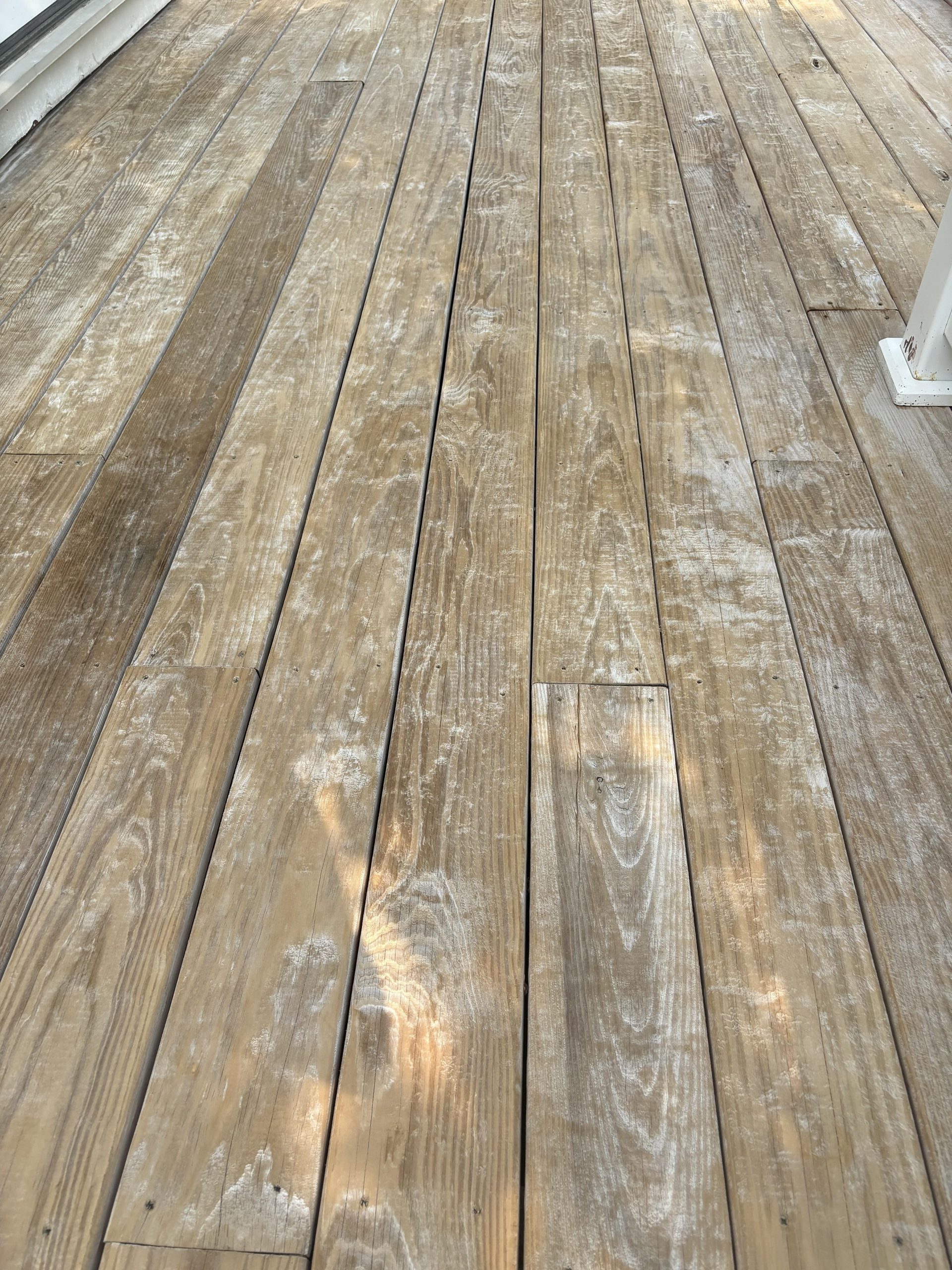

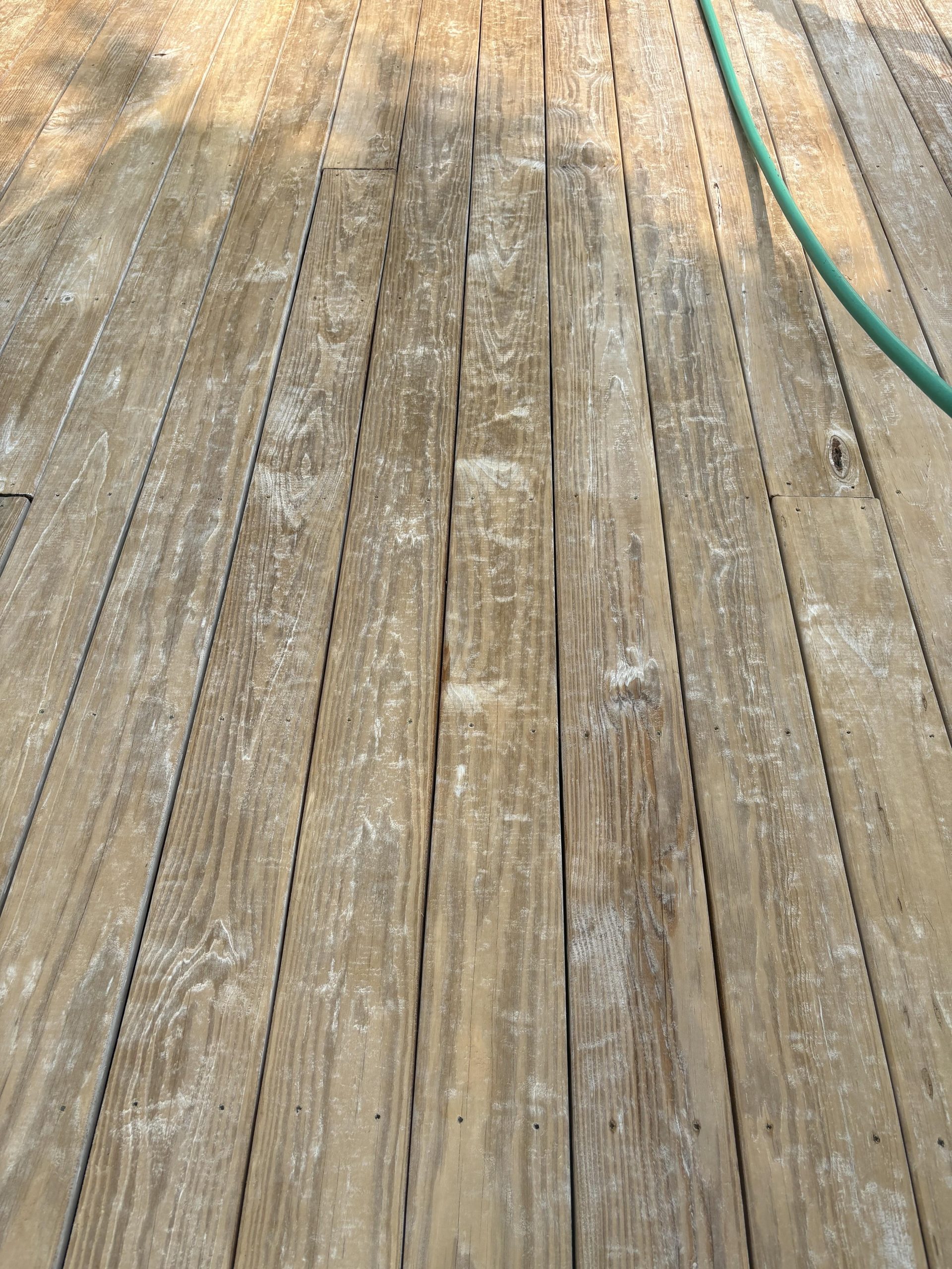

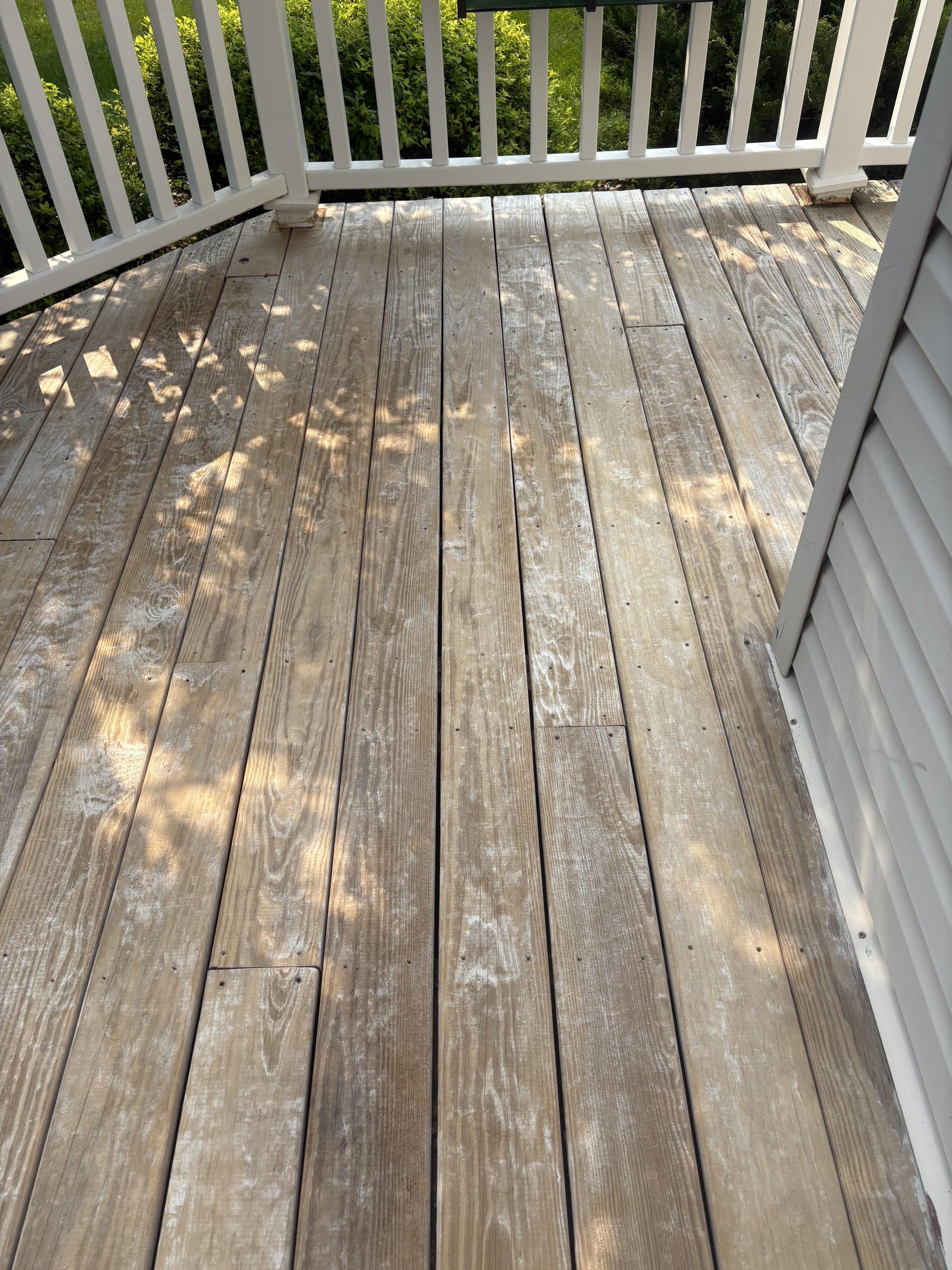

Pressure treated deck in Wisconsin installed in April 2024. Weathered 15 months. We cleaned and brightened using RAD products. Now there is a white film over entire deck. We have Armstrong-Clark semi transparent cedar stain but not sure if we need to do something else before staining. Thanks for your info
That is furring from the oxidation that was not removed fully. See here:
In many cases, it does not show when stained.

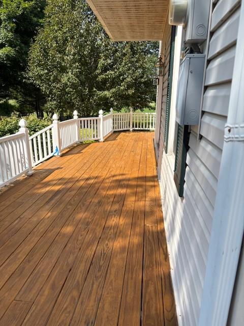

We lightly sanded and applied one coat of Armstrong Clark cedar with a pad. The AC stain was really easy to work with and soaked in nicely. The weather was not very conducive to drying….90 F and humid…but it dried quickly and looks good. Thanks for your help.
Looks great!
