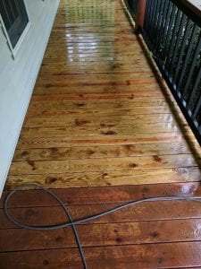

Update: My contractor just finished stripping and brightening our back deck using the HD-80 & Citalic kit from Woodrich. He never used this product before but I think he will for now on. He said they both worked great! Here is a link to before/after photos. Note the "after" photo is before staining but after using the stripper & brightener/neutralizer. If link below is not "clickable" you'll have to copy & paste into your browser.
RJ, he did a great job with the prep!
We thought so as well. Oh…I just uploaded a new photo to that link I posted above. The deck is now stained using Armstrong-Clark's Rustic Brown in semi-transparent. Not too shabby I believe.
Thanks so much for the pics! This is exactly what we are going to do with our deck.
