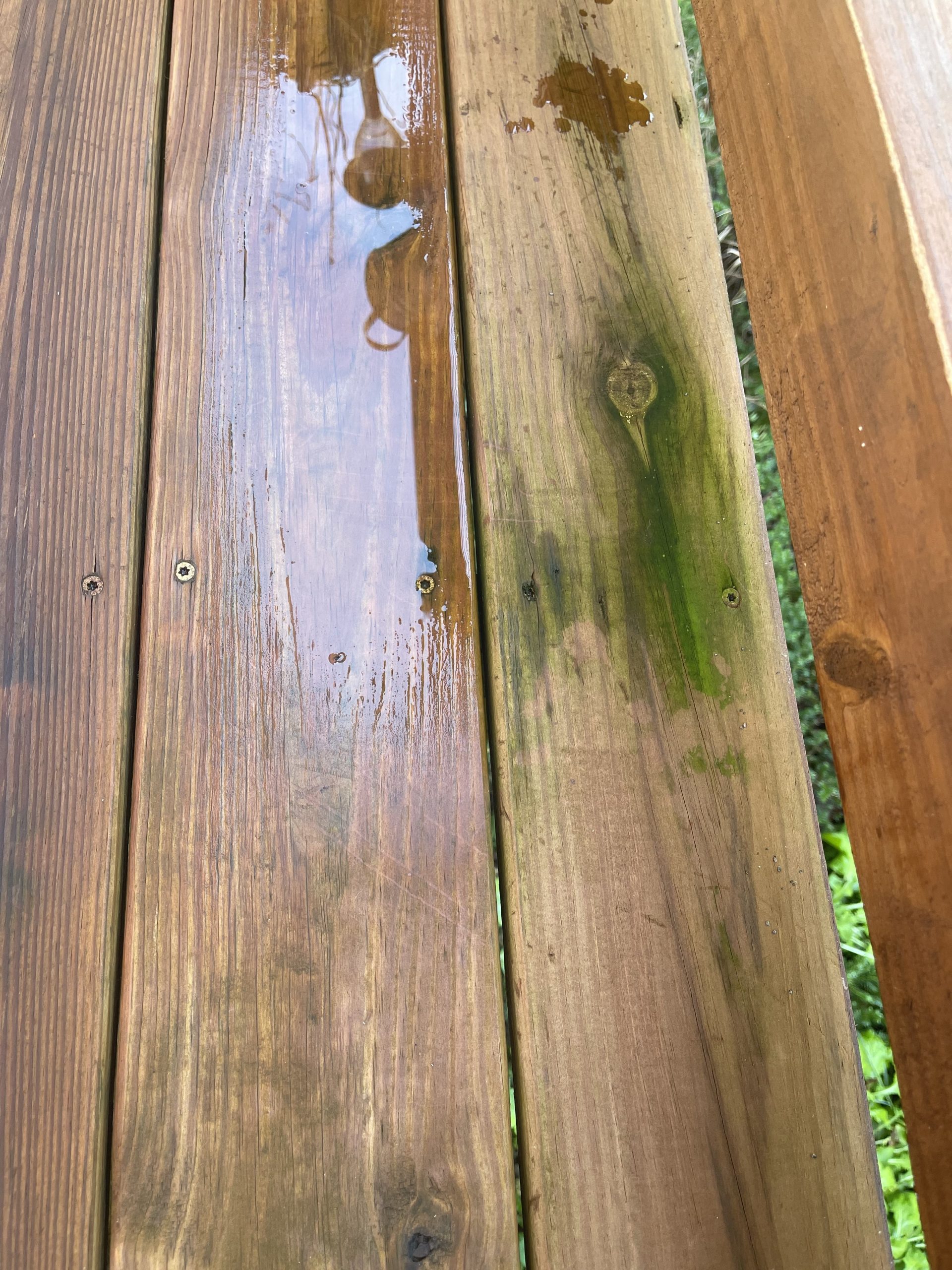

Used RAD cleaner and brightener then stained with RAD light walnut in spring of 2021. Now I have green mold/mildew. What is the best course of action?
That is algae on top of the stain. Try a product called “wet and forget” and see if that helps.

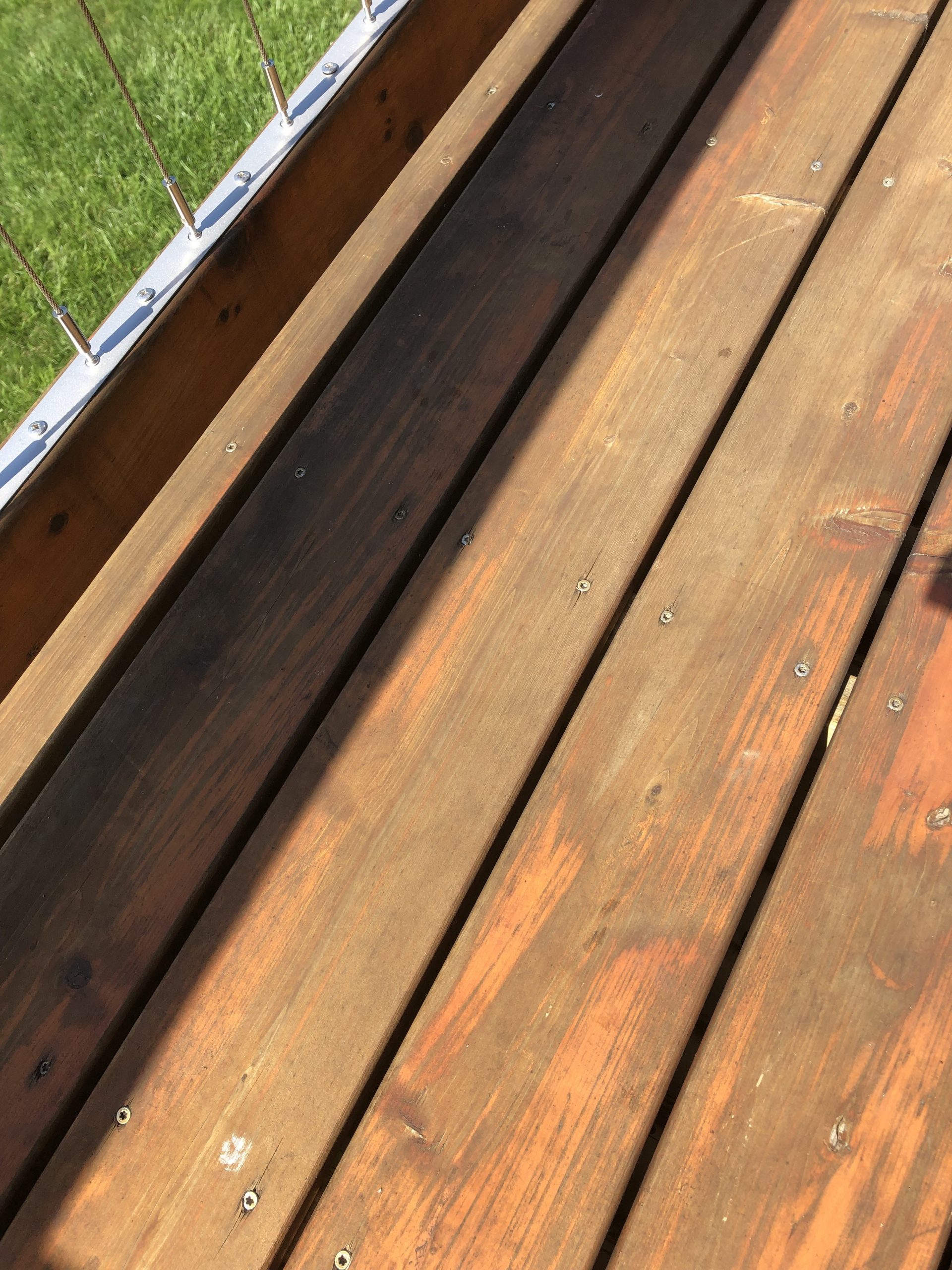

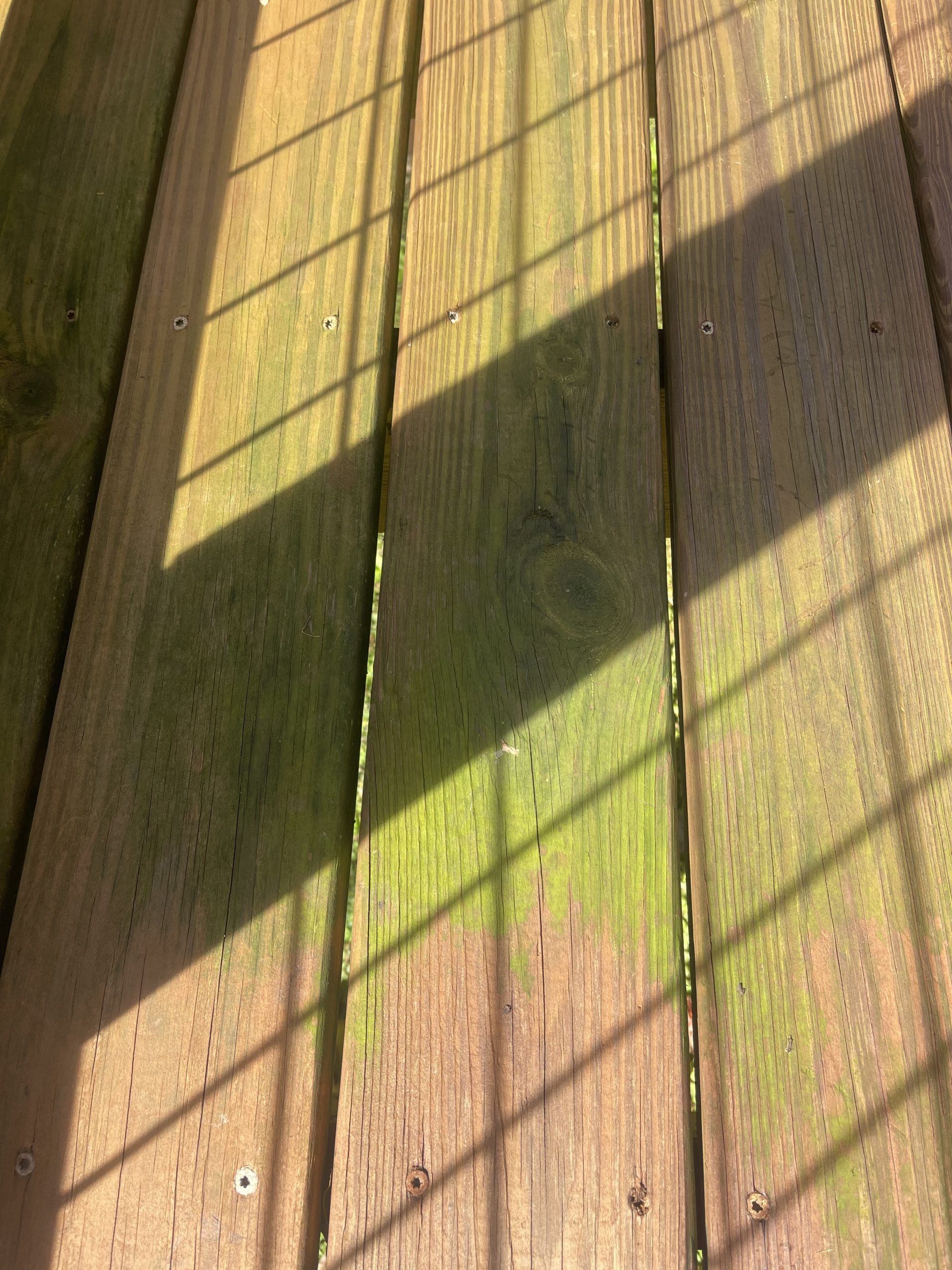

Don’t know if these will provide any information. Under furniture and along shady wall still looks pretty good. Open, sunlit areas (now cleaned) were dark with a layer of something that came off with RAD Cleaner and pressure washer.

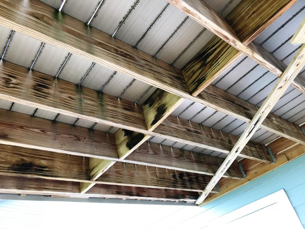

I found there are mold under my deck, most on the wood part and only a little on the AZEK matirals (attached the picture), would like to ask your kind advice how should I deal with this issue, thanks.
Try a bleach mixture of 1 part bleach to 4 parts water and spray it on those areas to kill the mildew and mold. Make sure to wear protective clothing.
Can I use the Wet and Forget as well? Thanks
I doubt it will work for this.

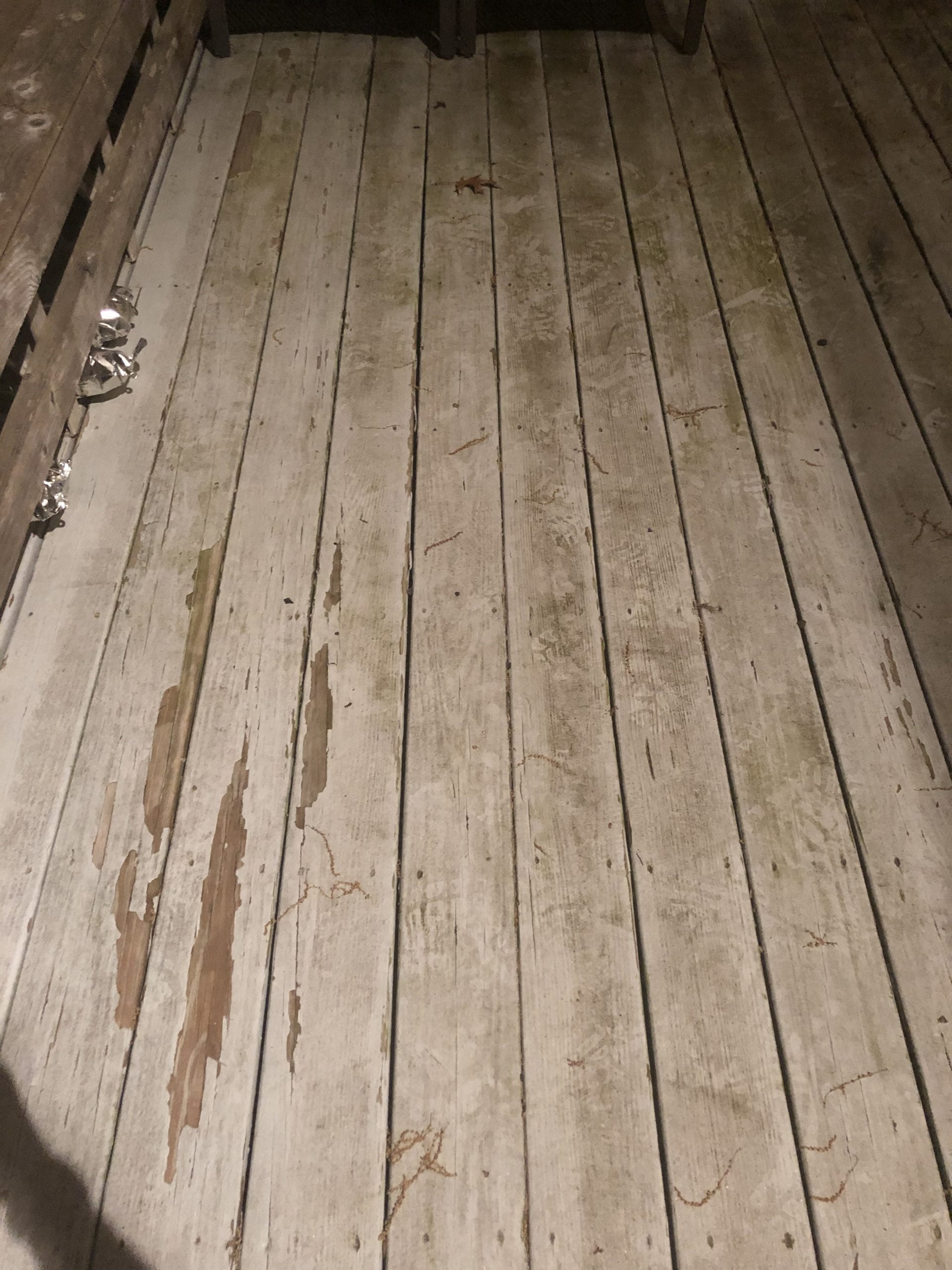

I have this deck that barley gets any sun at all. I finished it with something like a tough coat. As you can see it is now peeling and has mold and mildew. I want to either clean it or strip it and clean it. In the end I would like to go with a stain that won’t peel and will help with the mold and mildew. Any suggestions on how I can make this visually pleasing, please advise.
You will have to power sand this off as strippers will not remove it. Once removed, use one of these top brands: https://www.deckstainhelp.com/the-5-best-deck-stain-reviews-and-ratings/

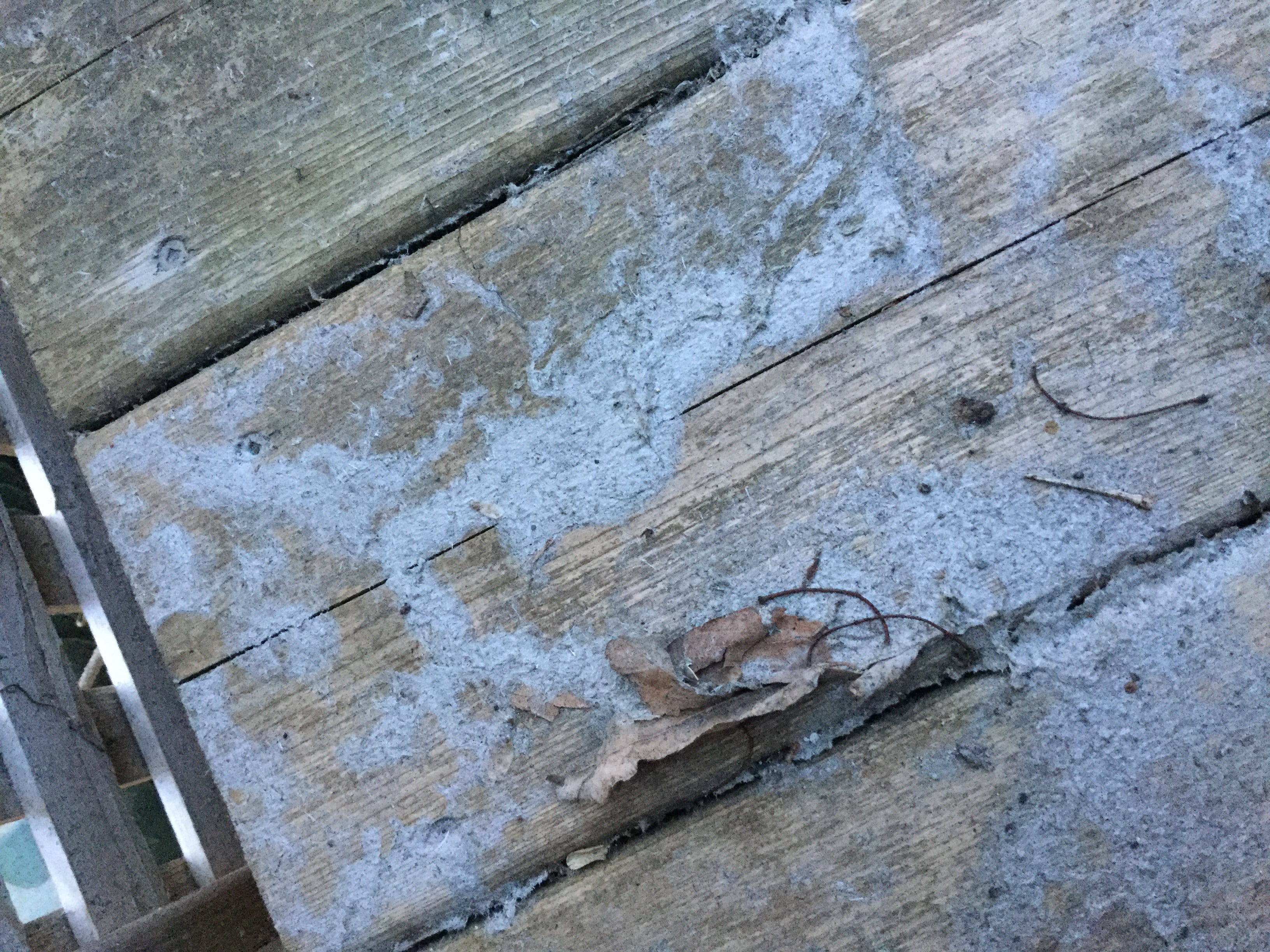

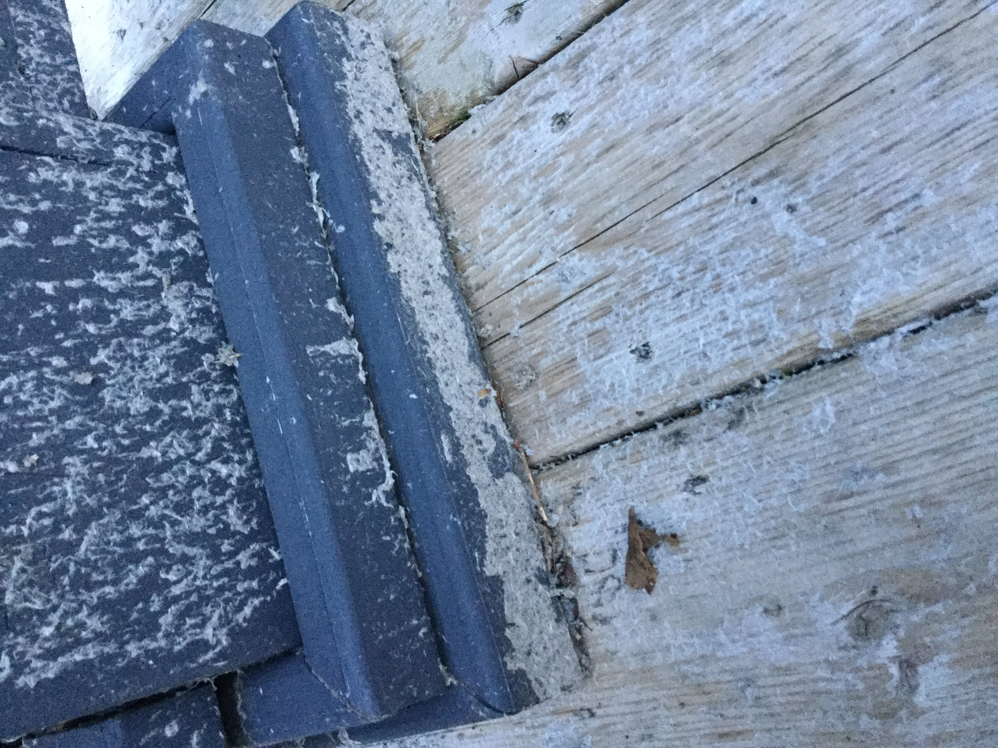

After the winter snow disappeared our cedar deck which we have left natural has a greyish film on it. It reminds me of a wet tissue that has dried in the sun. Is this Mold or mildew? We have wet it and swept it but it remains in difficult areas. Can you explain what happened and is there something we need to do in the future?
Post a picture.
Here are a couple of photos.
Sheila
Looks like wood pulp. Not sure why it is there. Pressure wash to remove.
Thanks for the reply. It turns black when wet and can then be brushed off. But it is hard work. We live in Ontario. Could it have something to do with all the snow we get. We don’t shovel it in the winter. Also we were told pressure washing harms the cedar. There is no other finish on it.
You can use a pressure washer as a rinsing tool.
Pressure wash it with a bleach free deck leaner then use a clear wood sealer on it. Ask at a ‘good’ diy store that knows about it.
