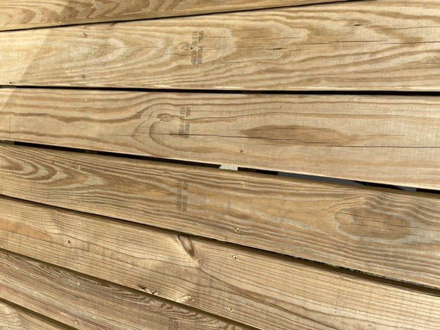

Pressure-treated decking, when new, tends to have very annoying ink stamps on the wood when processed at the mill. Lumber is stamped at the mill according to its grade. An American Lumber Standard Committee (ALSC) grade mark and an American Wood-Preservers’ Association (AWPA) tag certify the lumber’s quality. These stamps are very troublesome for owners to remove before applying a decking stain that is either transparent or semi-transparent, as the ink will show through the stain.
Scott’s Pro Tips for Stamp Removal on Deck Boards
Sand First, then let Wood Weather Naturally
Since most decking stain manufacturers want you to let new wood season and weather before staining it is advisable to do these steps:
- Right after installing the new wood, lightly sand all stamps off with 60-80-grit paper and sand with the grain of the wood.
- Let wood weather for 2-4 months, as the stain manufacturer you are using suggests for new wood.
- Clean and Brighten all decking after the weathering for the stain prep and even out the appearance
- Apply stain. Please read this about New Decking stain
The reason for sanding first and then weathering is to make sure the stain will apply evenly. If you were to sand the ink sports right before staining, there would be a solid chance that the stain would take lighter in the sanded areas, resulting in a very uneven appearance of the deck stain.

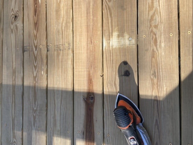

Before I sand the rest of the ink, does it look like I’m doing it correctly so far? Light pressure along the length of the board? Thank you.
You should be fine as long as you weather and prep after the winter.

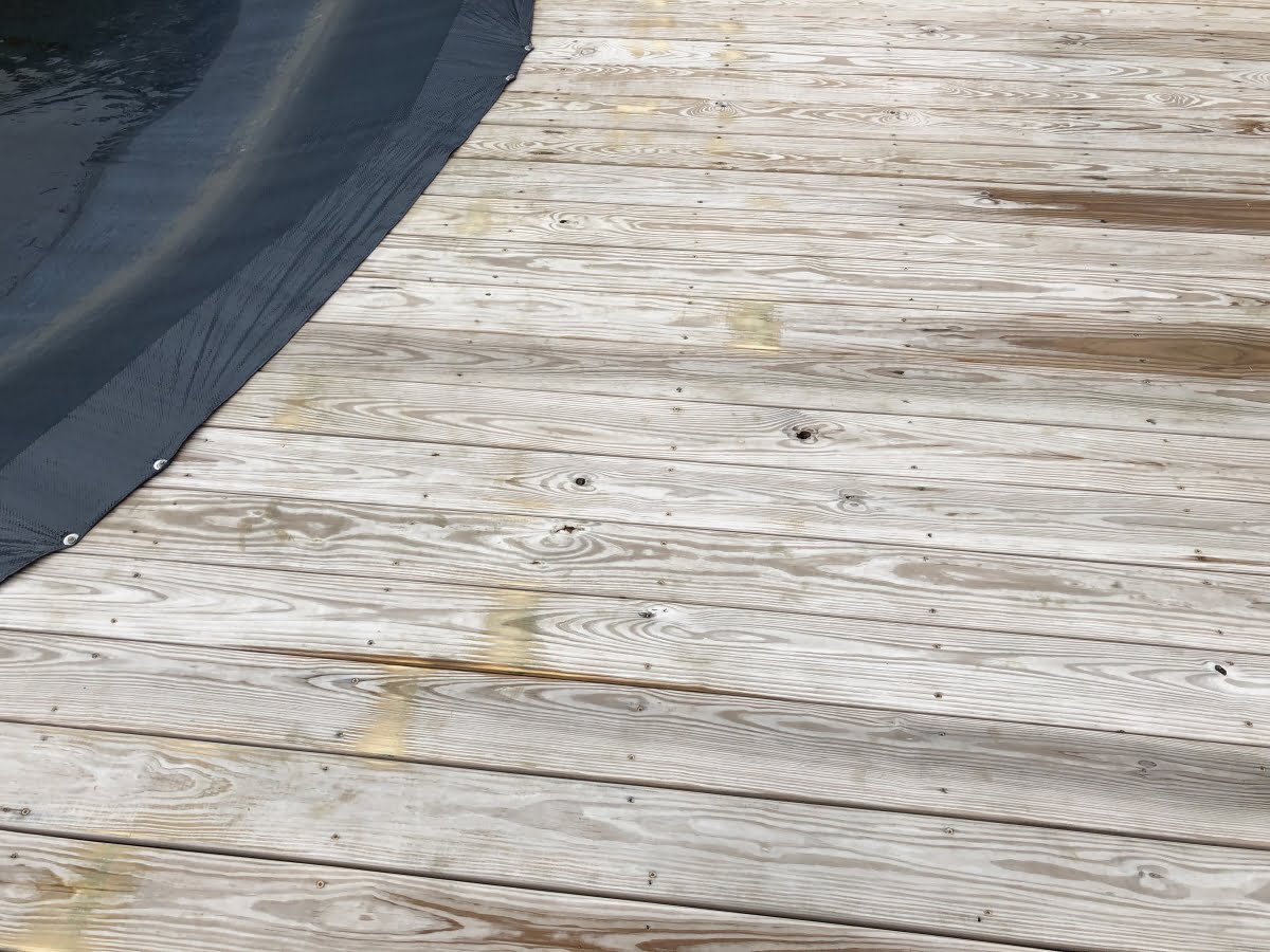

Hi again, I’ve read all the comments but want to be 100% certain I’m doing the right thing so my deck doesn’t stay discolored. Most of the boards have been weathering since June/July and the ink has faded some but not completely. If I sand the ink spots with 80grit Diablo sand paper, using a mouse sander, in the direction of the length of the boards, I should end up with white spots that will disappear once the boards weather over the fall and winter? I can use enough pressure to remove all of the ink? Aiming to stain with TWP 101 Cedar Natural or another semi natural look in early March in Georgia. I get nervous at the thought of having to wait until then to see the white marks disappear, or worse that I’ve done something wrong trying to remove the ink. As always, thank you.
Your sanded spots will even out after weathering and prep in the Spring.

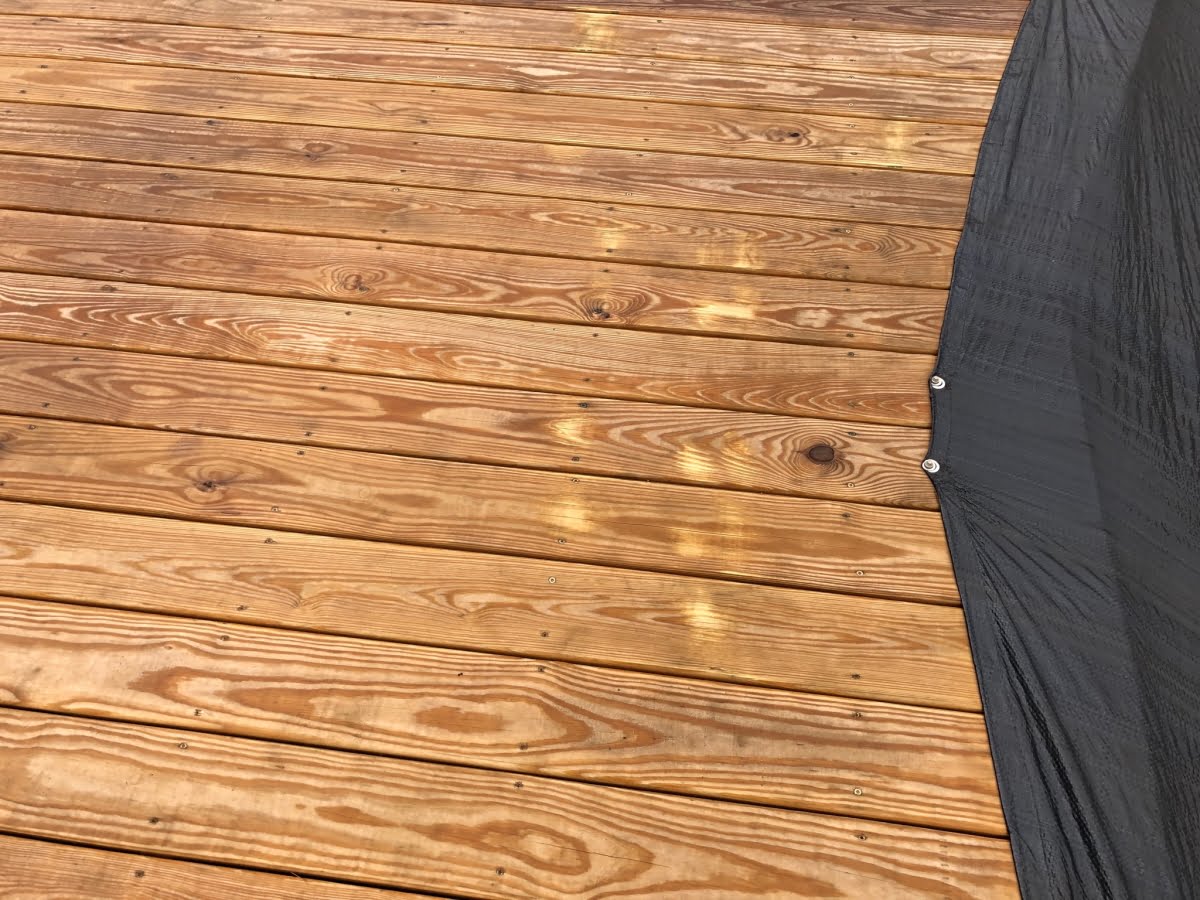

We just sanded off the stamps on a pressure treated deck installed 6 wks ago. The sanded spots are quite light in comparison to the rest of the wood. My husband used 80 grit but he had to use an electric hand sander to get them off. I’m just looking for some information as to how this will even out in color with the rest of the deck. Is it going to age quicker in the sanded areas because the wood grain was exposed and then result in an even wood tone overall? Just wondering how these “light spots” will catch up with the rest?
Let the wood age for 3 months or so after sanding and then clean and brighten all wood after.

I installed a new deck last fall and did not remove the stains then. I just sanded them off now and have lighter spots where I sanded Is there anything I can do to make them blend in/
To even the wood grain out you will need to let it sit as is for 2-3 months and then clean and brighten the wood for the final prep.
